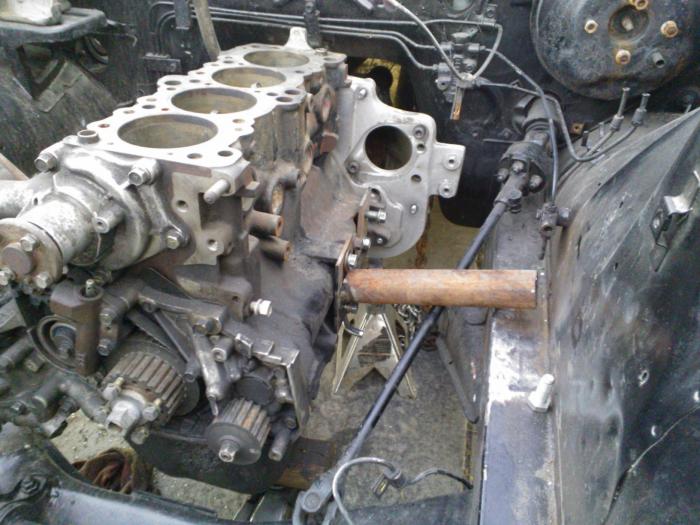

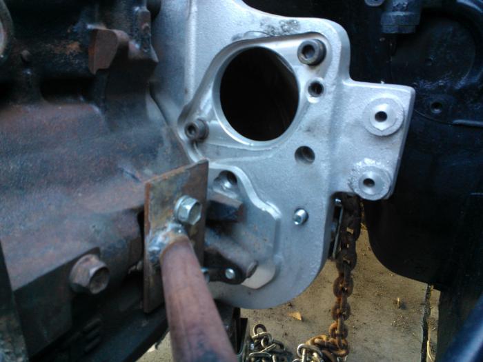

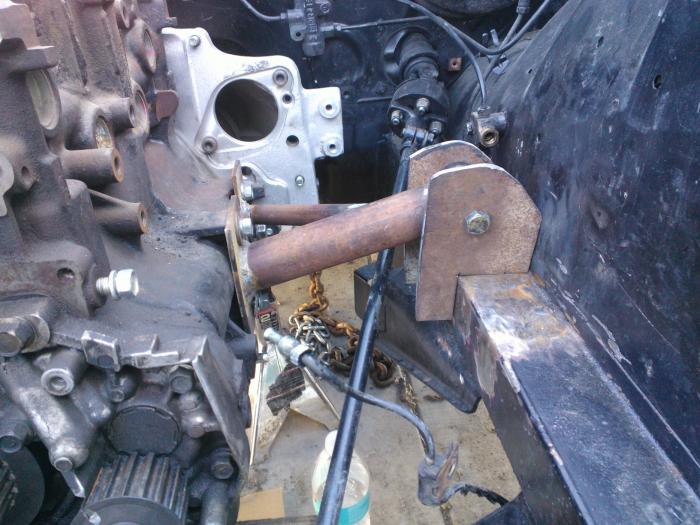

I started fixing my mistake of a motor mount today. Moving it over the original mount holes on the block. I didn't get to far today, long day at work so wasn't feeling to froggy. Here is what I got going on for the mount now.
The mount has about an 3/4" to the steering rod and ill be tieing in a piece of 1/2" pipe from the other plate of metal bolted to the bock. Should work alright.

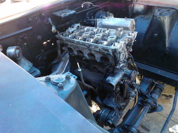

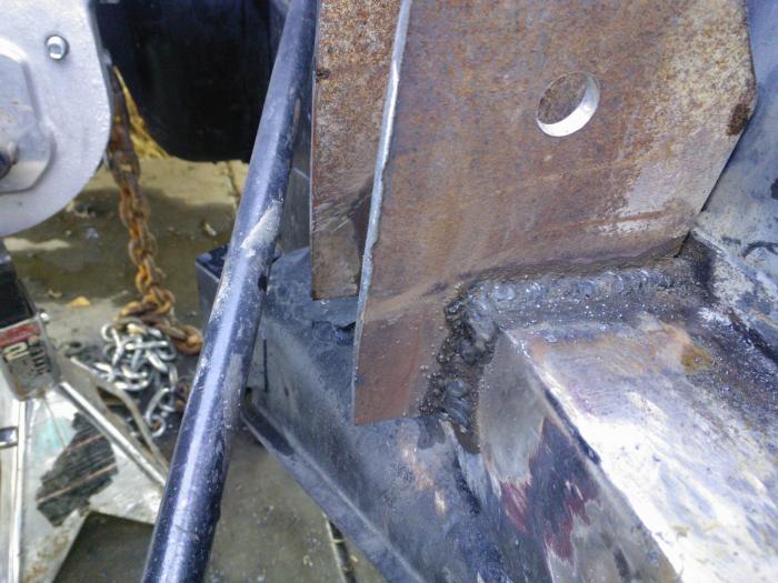

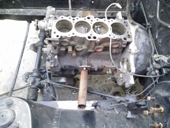

So i finally finished the mount, again, but it turned out pretty good. Still need to trim up the back part of the mount so the starter will fit. brake line is close but it'll make it. I should be picking up a 2g head for 50$ that I am going to use to mock everything else up with, and maybe a pacesetter turbo manifold if i can get it cheap.

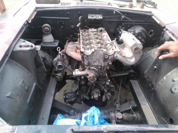

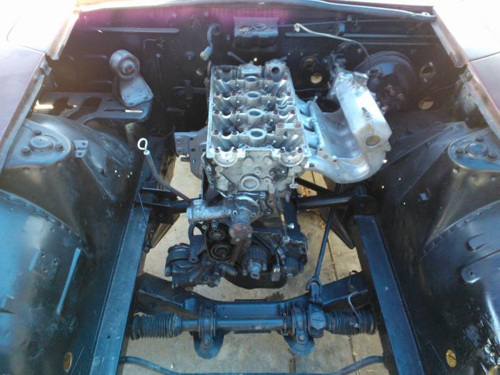

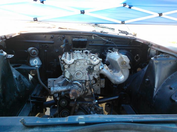

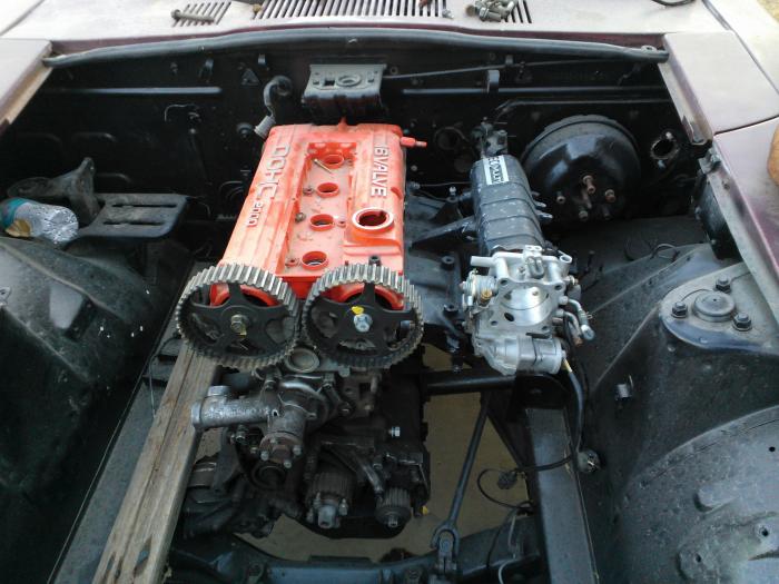

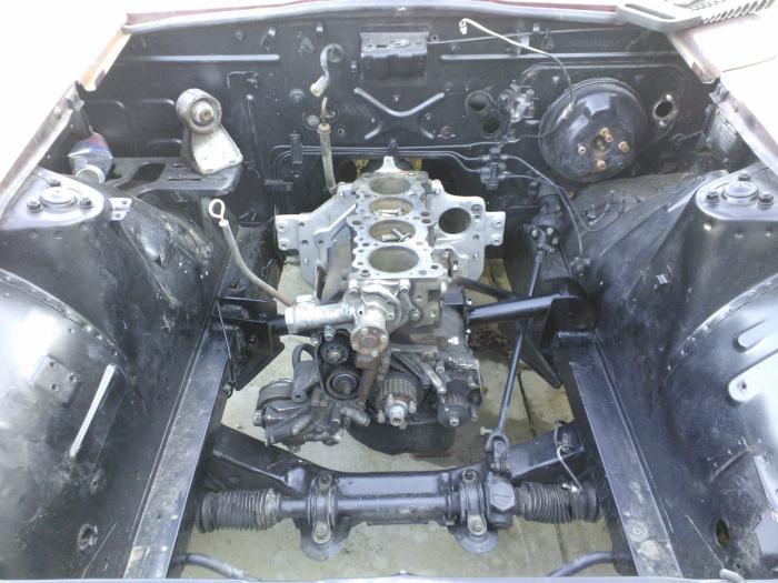

So I finally got the 2g head for mock up on the 280, only 40 bucks and it looks like a pretty decent core too. I threw the intake on there just for kicks(i know its backwards) to see kinda what i was working with. Think I talked my buddy into selling his hx40 so once i get that I can start making a manifold. Never made one before but want to try :hellyeah:.
The daily driver has been taking up most of my time lately so things are moving slow, but here are some pics.

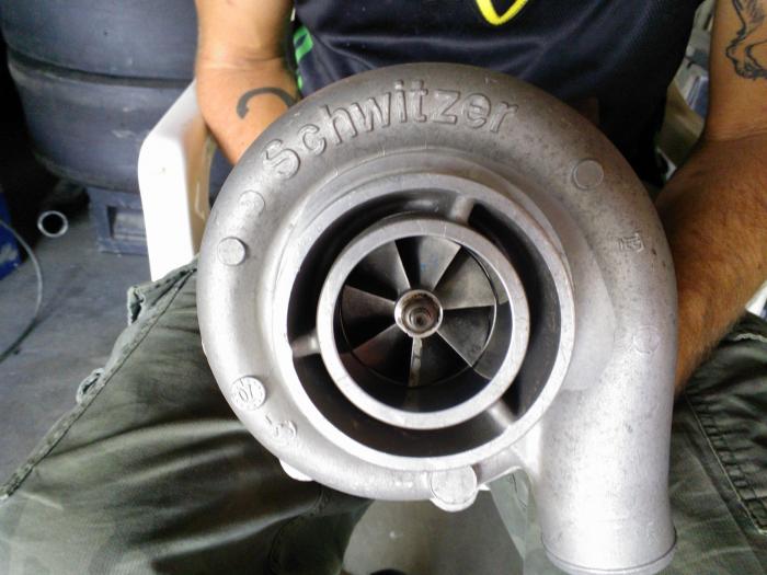

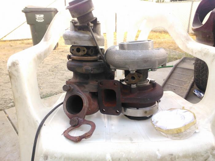

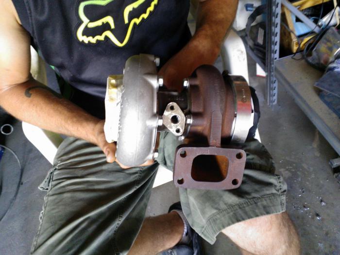

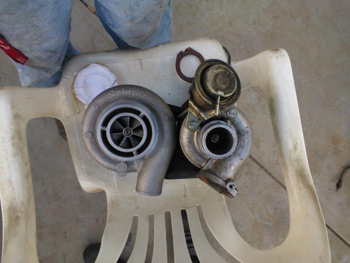

Great news every one!! I finally got my buddy to sale a turbo for a SUPER cheap price :thumb:. Its not a hx35 like iv been looking for but i think it will work, its a pretty much brand new S256. Got some pics of it of course.

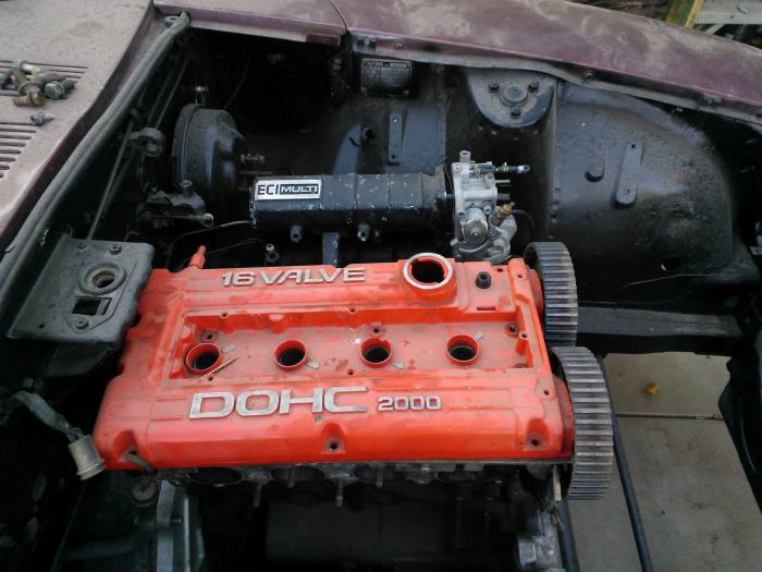

This is the stock 14b put on for looks :D

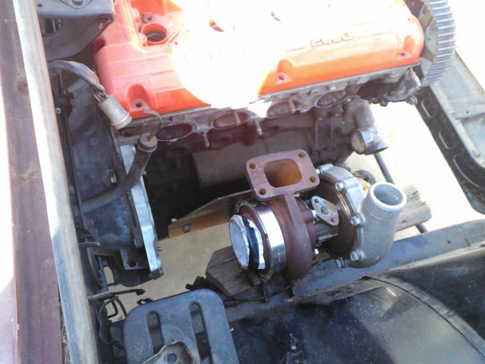

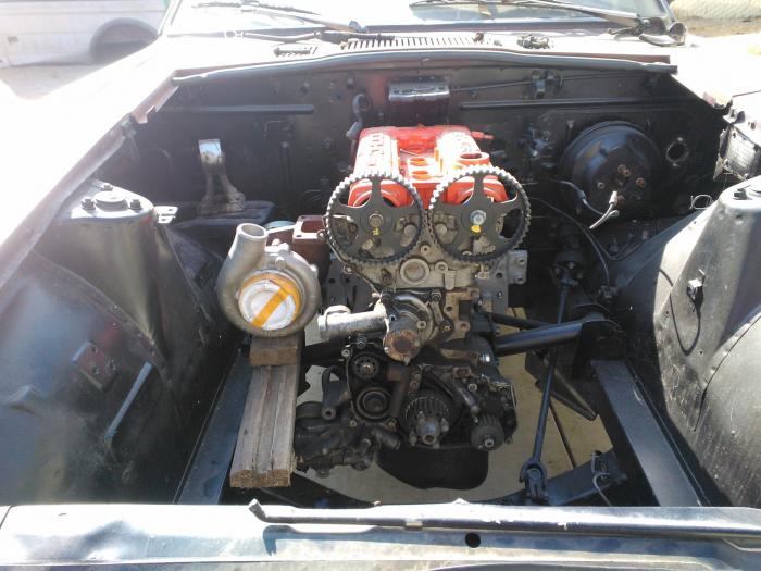

Few pics of S256 sitting in engine bay, it will probably be flipped and ran top mount.

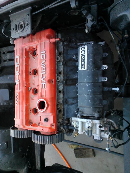

Well I got a critical piece to this puzzle to, my intake came in!! It is a stock 1g intake manifold that had already been modified for a RWD configuration. Intake looks great you can hardly tell it use to face the other way at all. Im going to need to get a spacer buecause the 90 TB I have is hitting on the FIAV that is non-removalbe. The TB had been bored out rebuilt so ill just get a spacer and some longer studs.

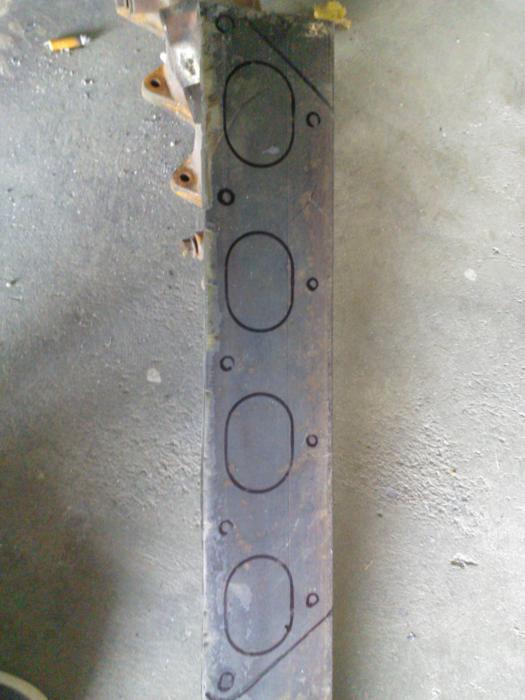

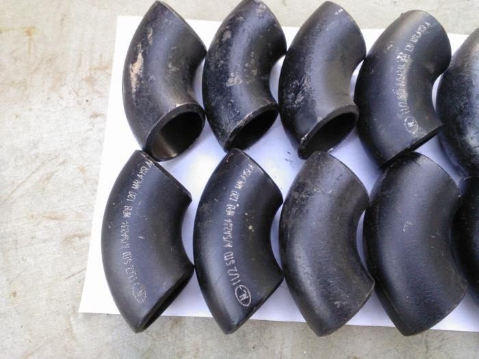

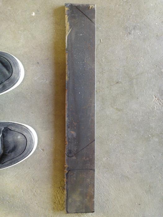

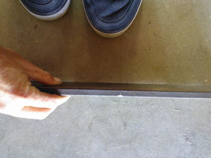

Long time no update sorry about that but I have started making a little progress. Bought some 90 degree butt weld fittings, I got 1 1/2" but looking at it now they seem a little big. I am going to use them anyway see what it looks like. Im going to make some flanges out of 1/2" mild steel flat stock.
