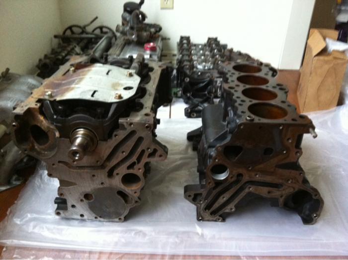

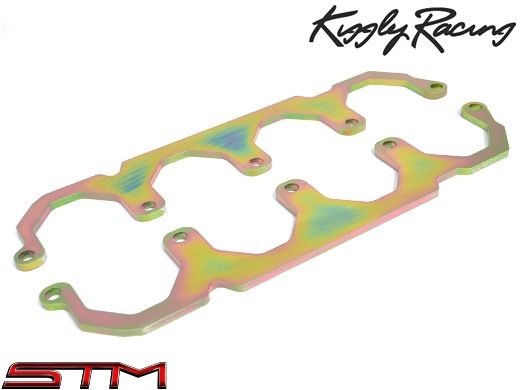

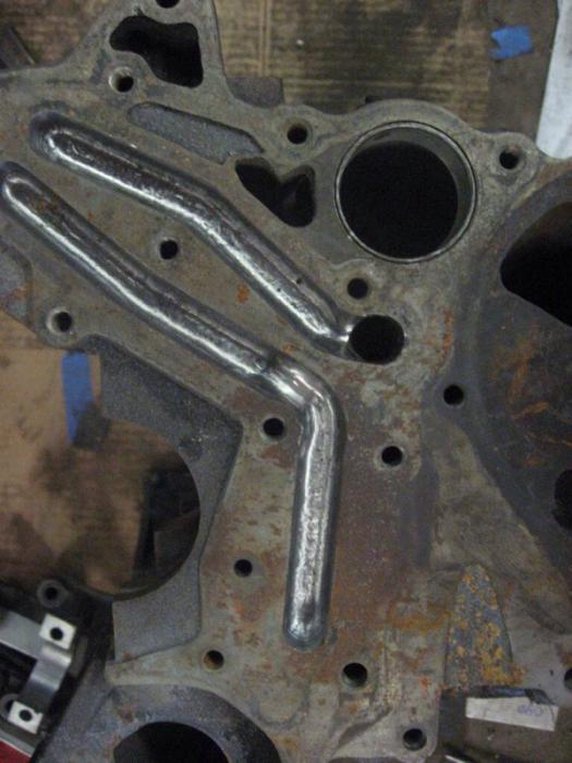

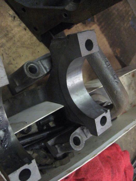

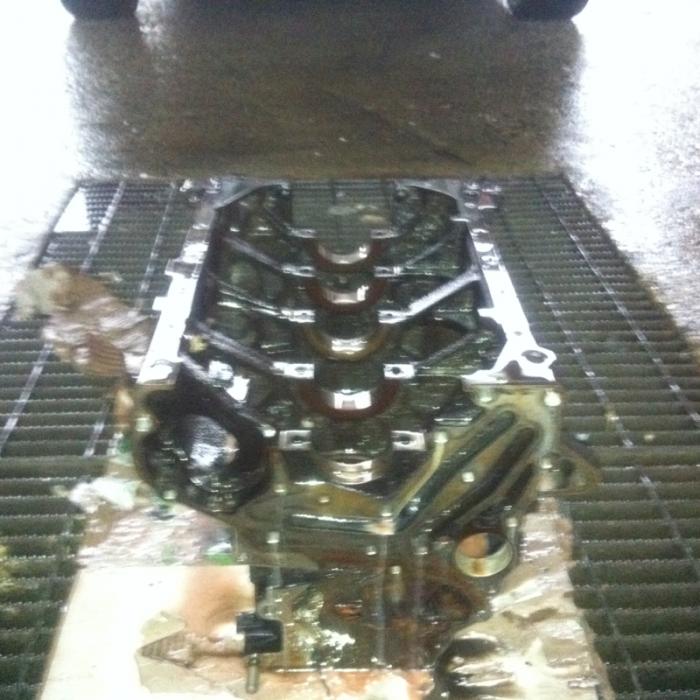

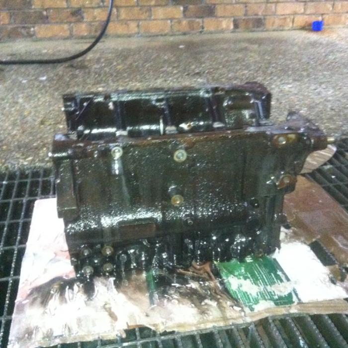

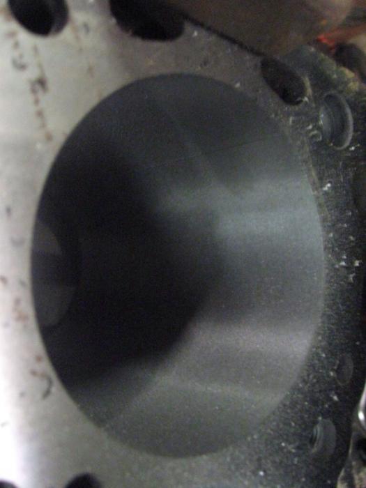

I'm starting this thread simply for the fact I want you guys to know what I'm doing step for step. And to get opinions if you may have them. This is not my first build, but this is my highest goal build. I've owned 2 DSMs before this and both were 7bolts. I will post as I go and update as the build progresses. Keep in mind this build is starting from scratch. The block is now at the shop and when I have more time I will post what's being done to it but here's a few pictures of the block. Also opinions on rod and pistons? I'm using the stock 6bolt crank, it's 1000hp capable. Update I promised earlier, 6bolt is getting decked, bored .020 over, and line honed for the 6 bolt crank. Crank will be refinished. 6bolt oil mod. Will also be having him throw in some new bearings not sure what I'm going with yet. Maybe some ACLs. I'm also ordering a kiggly main girdle. BLOCK LIST: Std 6bolt crank, Manley H beams, Wiseco Piston heads w/ rings, BSE, kiggly main girdle Feel free to give me your opinions! I'm solely focusing on the block build at the moment, then I will move to the head intake mani,exhaust mani, turbo, etc I'm super exited about this build!! dde04

Well your certainly not short any blocks or heads for this project. Will it be a stroker motor or will you be spinning the 2.0 crank. What turbo will you be running also, looks good can't wait for updates. Always intrigued in motor builds :D .
Don't know how I missed that in first post, looks like nice setup.
Well your certainly not short any blocks or heads for this project. Will it be a stroker motor or will you be spinning the 2.0 crank. What turbo will you be running also, looks good can't wait for updates. Always intrigued in motor builds :D . Don't know how I missed that in first post, looks like nice setup.
I'm spinning the 2.0 for now. It's all I need for this build. And I think ima run a holset hx40 6blade I'm still doing my research on turbos I own a big garret t 28 but that's no where in the ballpark of what I need for my goal. Any opinion or preference on turbo?

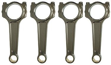

I decided what my internals will be: and is being assembled at Dale's shop.

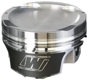

Wiseco 1400HD pistons + Rings
Manley Turbo Tuff rods

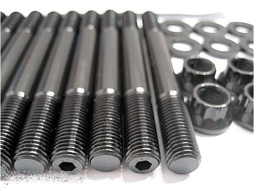

ARP main studs

Kiggly main girdle, for higher RPM stability.

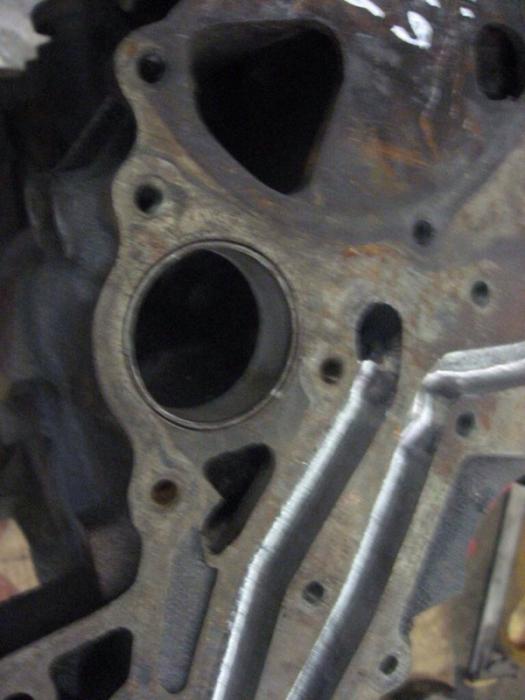

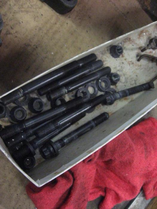

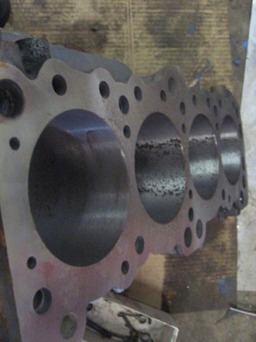

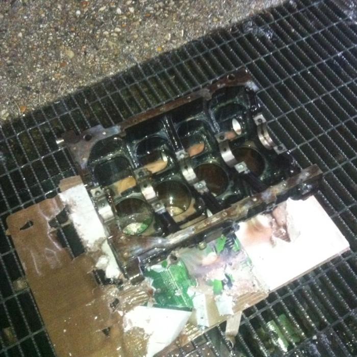

Update!!! Got some pictures on the progress of the block. It's slow going. The following pics in order are. BSE bearing flip, Oil mod, Arps used in the line hone, mains after line hone, bore .020 over, 85.5mm with torque plate, and decked!!! Waiting on pistons so it can be honed for tolerances.

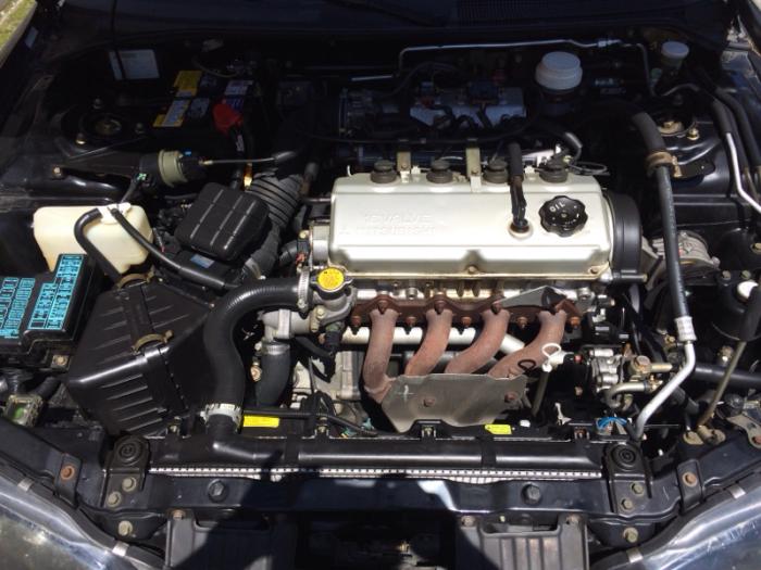

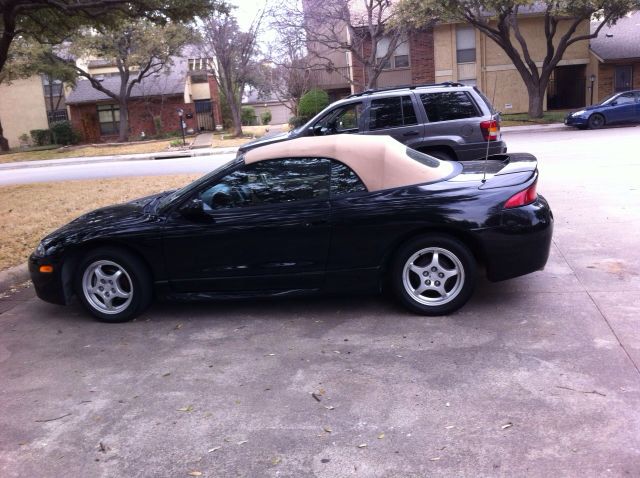

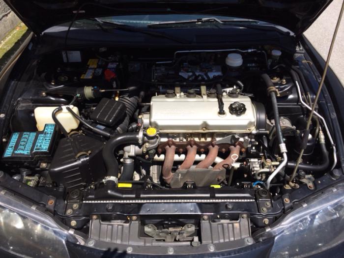

Ok so update, haven't had much chance to get more work on the block, will continue to update as the 6bolt build progresses. But I however do have some exciting news!!! I bought another spyder which will be the spyder I drop this 6bolt in!! I found the car in dallas with only 70k miles on it, I have the maintenance history paper work on this car dated all the way back to 98!!! The one owner who bought it he took great care of the car!! Interior is in amazing condition the car itself is just "wow" the engine bay looks brand new the cleanest I've ever seen a stock bay, btw the car is completely stock!! Which is what I was looking for!! Never been modded or dogged, it was owned by an old guy who drove it to church on the weekends, it was kept in a garage!!! As you can tell I'm super excited about it!! Subscribe!! I'll post some bay pics tomorrow!! So you can see how awesome this find is!!!
That black paint is just SEXY, damn nice find bro! Keep us updated.
And fwiw, i think when you get that engine in and you put down 500hp or more you are going to be going awd quick. I spent no time or money setting my car up to launch but it would roast the tires even in 3rd. That was roughly 450-500whp just a guess off my airflow. It wasnt much fun. But, there are plenty of guys who have some sick fwds out there and they CAN and do launch successfully. Its all in the setup and boost control. Best of luck to you and thanks for another build thread. Cant wait to start mine
Nice purchase on the Spyder!! Looks as if it was well taken care of.
Thanks man and it was I couldn't be happier on the find!!
That black paint is just SEXY, damn nice find bro! Keep us updated. And fwiw, i think when you get that engine in and you put down 500hp or more you are going to be going awd quick. I spent no time or money setting my car up to launch but it would roast the tires even in 3rd. That was roughly 450-500whp just a guess off my airflow. It wasnt much fun. But, there are plenty of guys who have some sick fwds out there and they CAN and do launch successfully. Its all in the setup and boost control. Best of luck to you and thanks for another build thread. Cant wait to start mine
Thanks man and yeah eventually I will go AWD. I working on finding a donor car now, may just do the engine swap and AWD conversion at the same time no sure yet depends how the hunt goes.
Black spyders are tits :) Looks clean, good luck with build sir!

Have you already purchased your rods? If not also consider Carrillo and R&R H-Beam rods. They are around the same price, but much lighter and are 800+ hp capable. Plus then you don't have to worry about machining the block to clear the manley turbo tuff rods.
