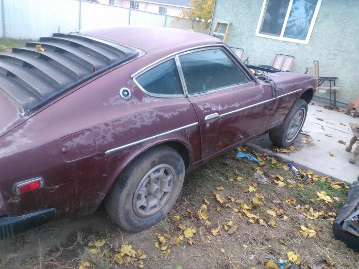

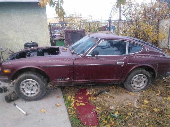

In the first post there is an attachment with a pic. I want to paint the car grey, I think I am going to buy a paint gun to go with my compressor and see what I can't do. Really want to do most of the work myself.

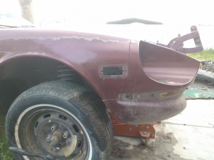

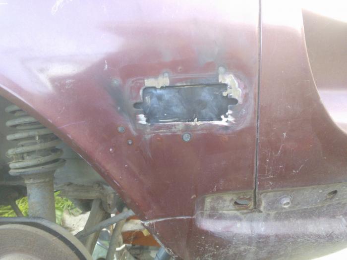

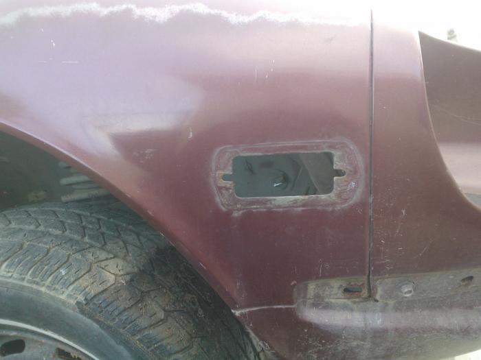

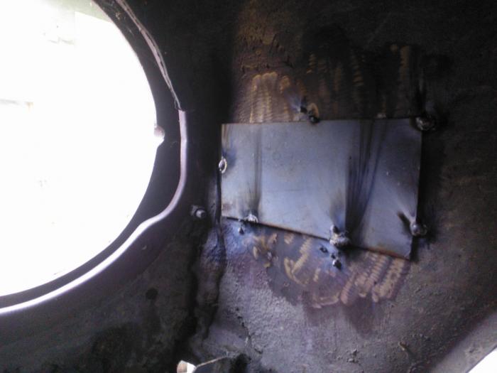

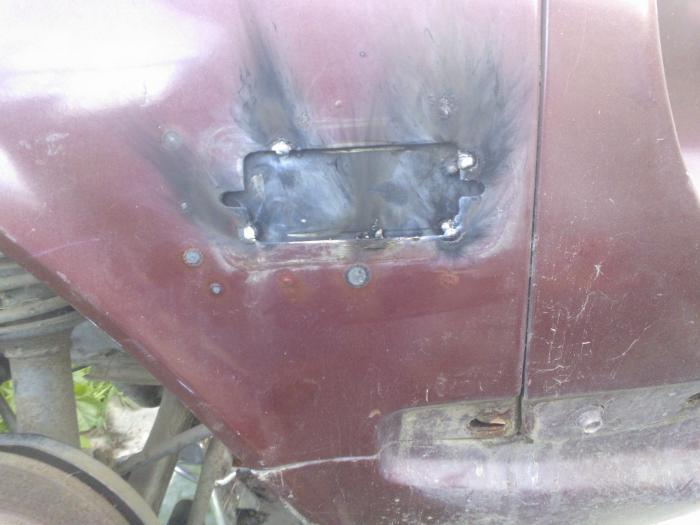

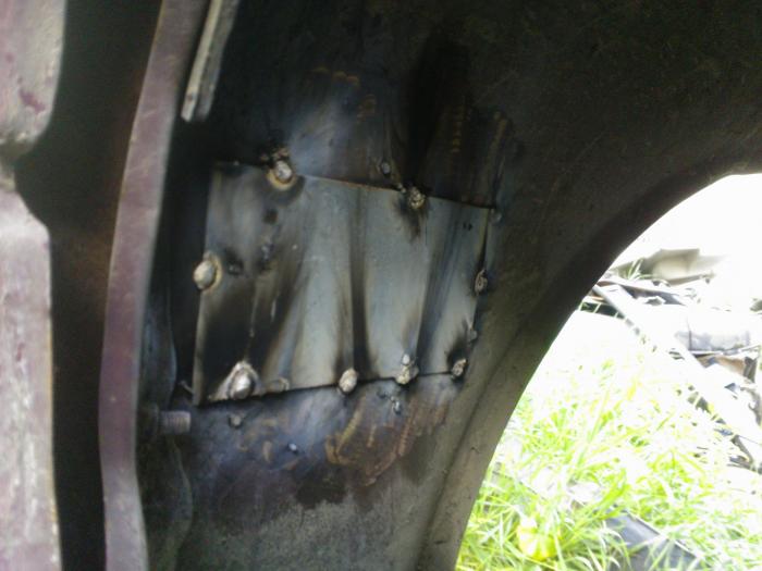

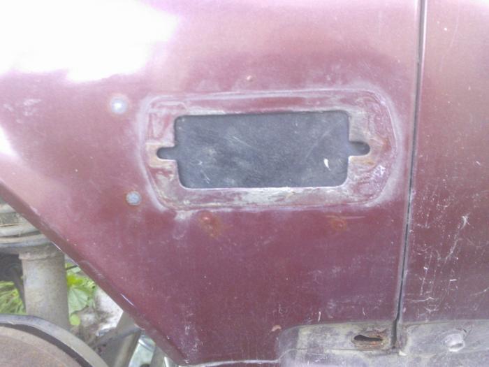

I did cut out "weld" and piece of sheet metal to the inside of the fender to cover one hole. I was going to try and weld it flush but I have a gasless MIG welder so it likes to get things pretty hot. So instead I am just going to have to use a little more bondo :).
Here's a few pics so you know what I am talking about.
The hole.
My Patch
You should also consider removing the side trim, the chrome part. i think it would look better too, but thats my opinion LOL.
On the patch, you'll finish it up with some bondo?

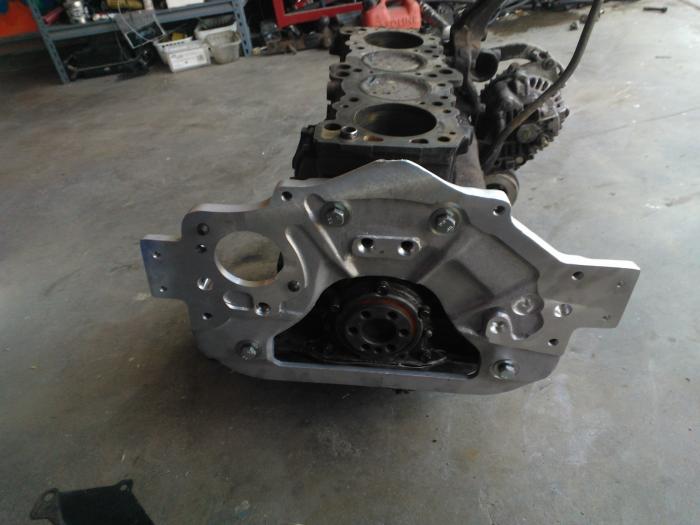

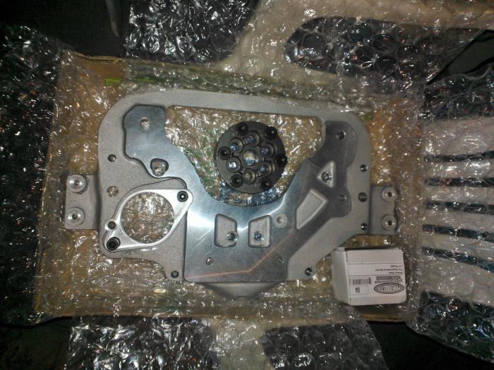

The adaptor plate is here :hellyeah:!! Hopefully I can get it bolted up to the block and mock it up in the car with the powerglide next week, start making some real progress. The plate looks awsome, Bill really knows his stuff thats forsure.
Here it is in all its glory.

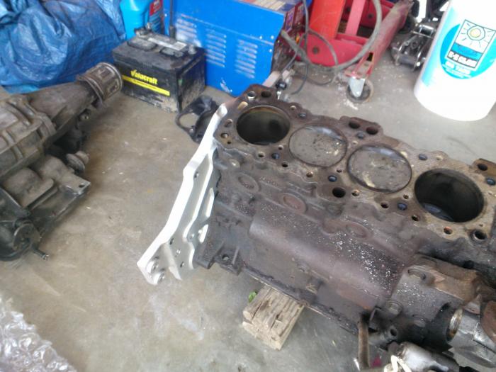

Well i got the DD driving decent (good as its going to be till new head gets here) so I got a little bit done on the 280.

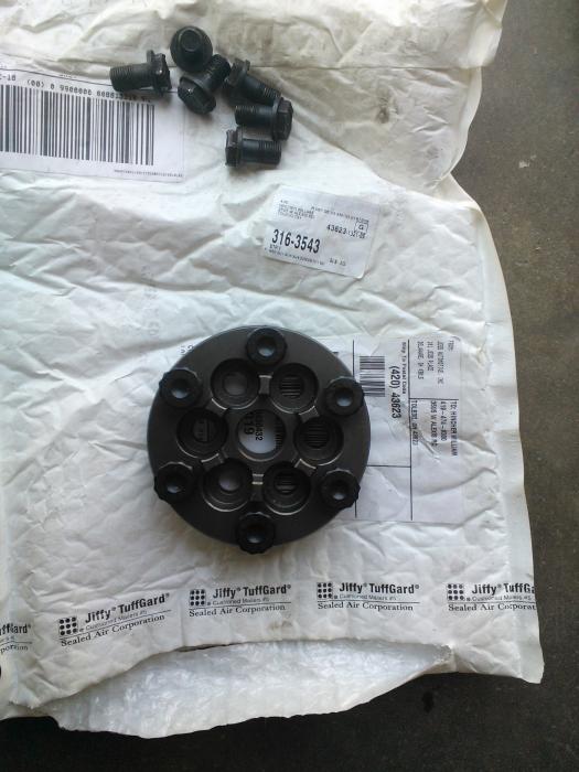

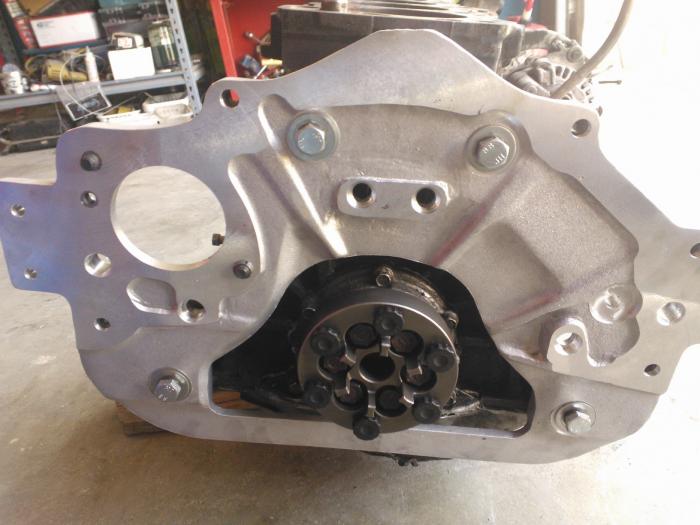

Messed around with the adapter plate for the GM trans and it looks super sweet on the block:hellyeah:. I only was able to bolt the adapter plate and flex plate coupling on until l can get some transmission bolts for the powerglide. Bill (Bills auto fab) claims you will break your crank before you break his coupling.
Well what you all want to see more pics!!
The plate lined up prefect to the block, no fudging around at all.
The unbreakable coupling haha. It doesn't come with a dowel to line it up but there is only 1 thousandth of a gab so it really has no choice but to sit straight.
coupling and plate bolted on.

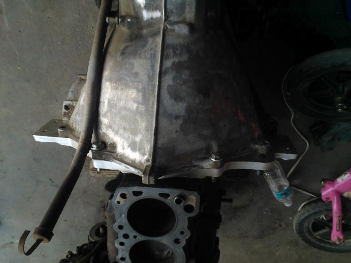

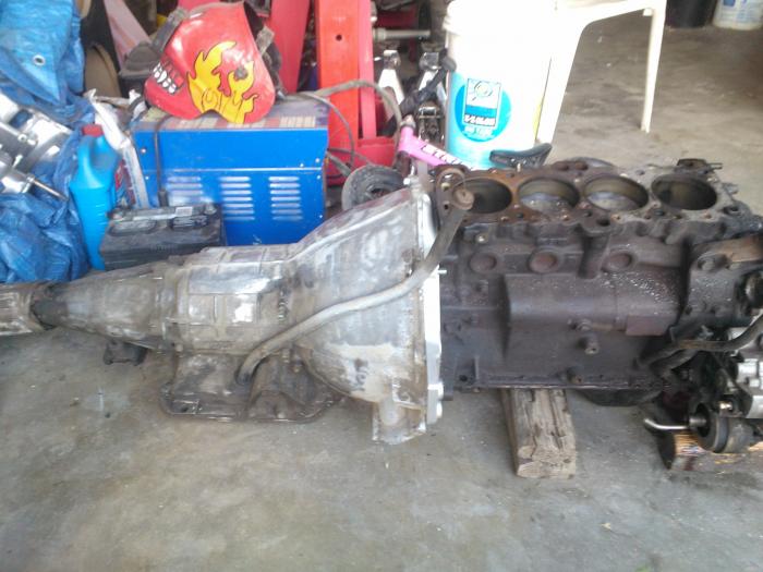

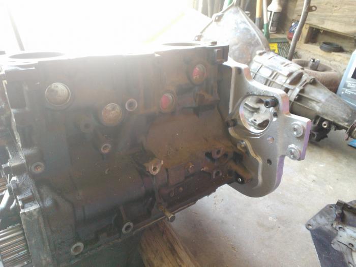

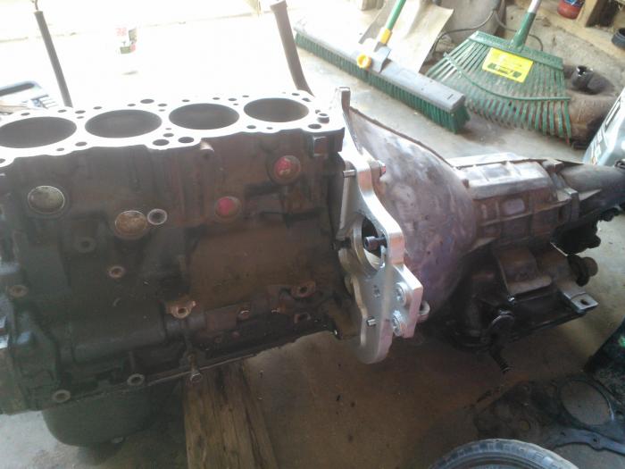

Its finally a 4g63 mounted to a Gm Power-glide, minus the flex-plate and torque converter. I have an old converter laying around but have no idea what stall speed it is so ill most likely be buying one when I find out more or less what I want. Still needs a Toyota starter, this thing is going to be frankencar haha.
I'm going to try and get it mocked in the car this weekend(if this random rain stops).
Few pics.
