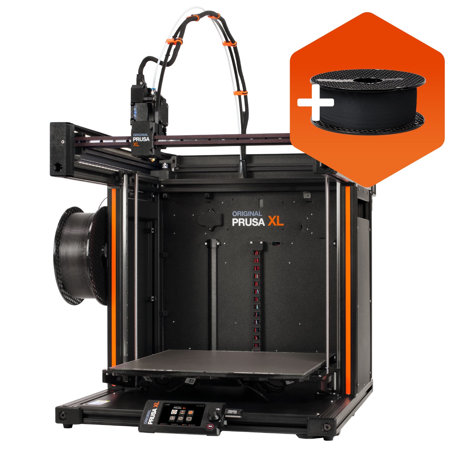

One to consider is the soon to be released Prusa XL. Multiple head options with automatic changing, CoreXY, huge size, built in enclosure shade option, smaller heat beds comprising the overall print bed... to name a few things. It's pretty awesome. I put a downpayment on mine when it was announced, maybe not the smartest to be an early adopter but since my MK3S is functional I'm not too concerned with growing pains. Not cheap though especially when decked out with multiple heads!
