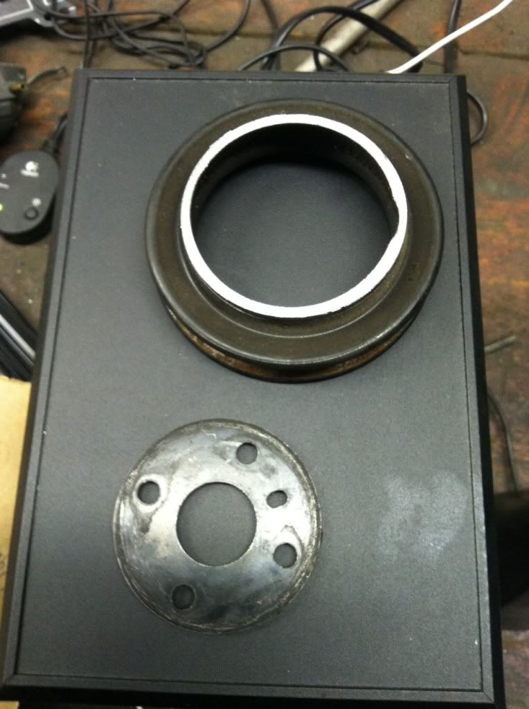

And while you were at deleting rotating mass on the balance shaft sprocket, maybe ditch the power steering pulley as well??
You need that pulley, or at least a spacer to keep the alignment on the water pump/alternator belt.
Turbo placement was decided around a few factors. The biggest being my collector design, it takes up alot of space and pretty much deemed the stock location unusable. Next was where could I put the charger and have the least amount of bends (and shortest pipe) to the compressor inlet and on the Turbine outlet. As far as the compressor outlet having a 90*+ bend in it, that is obviously not optimum, not to mention its close proximity to the high temps of the header. On that same note, that bend has a decently large radius and also allowed for a more gradual transition to the 2.5" piping.
As for as the power steering pump pulley goes, already fix it, just hadn't posted any pics. cant just delete the pulley as 1990AWD stated, but I got around that.

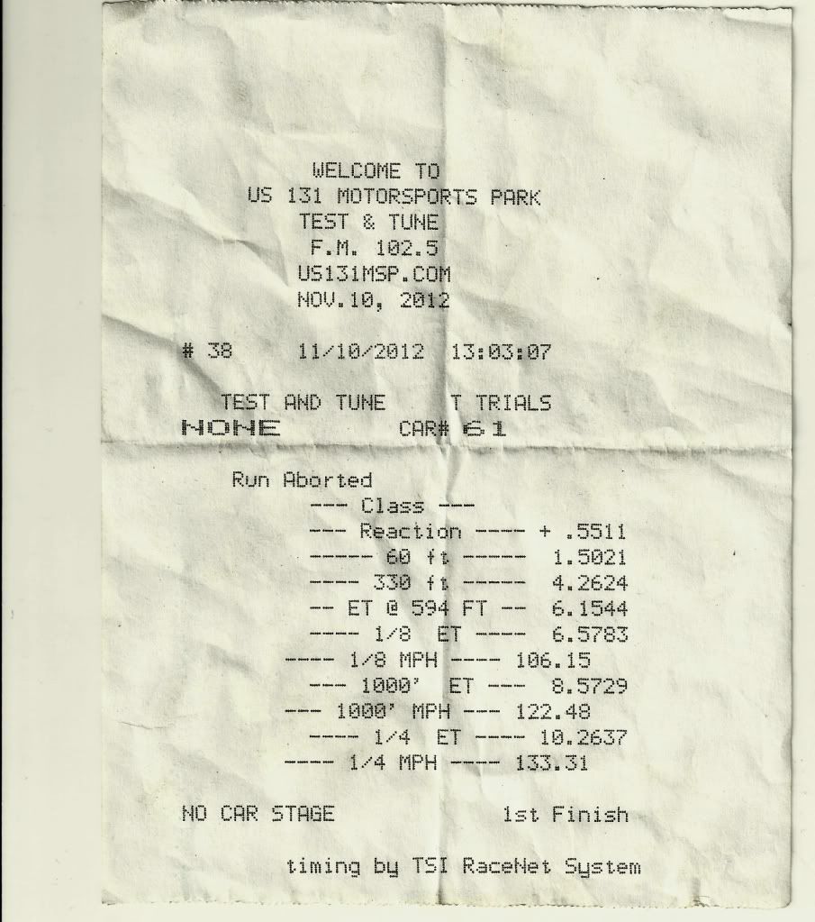

Here is the time slip form the pass in the video. Made 4 runs, this was our best. We were fighting traction issues all day. We've got a few things to improve for next week, and we'll be at it again.

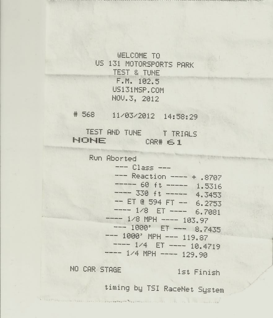

Time slip from the pass:
