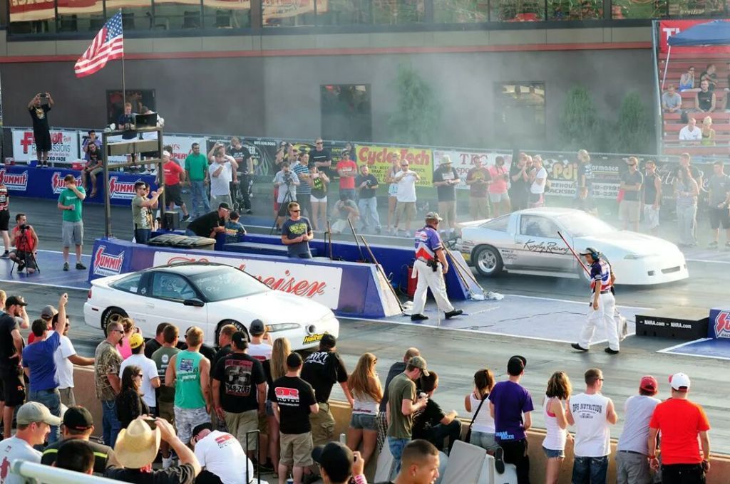

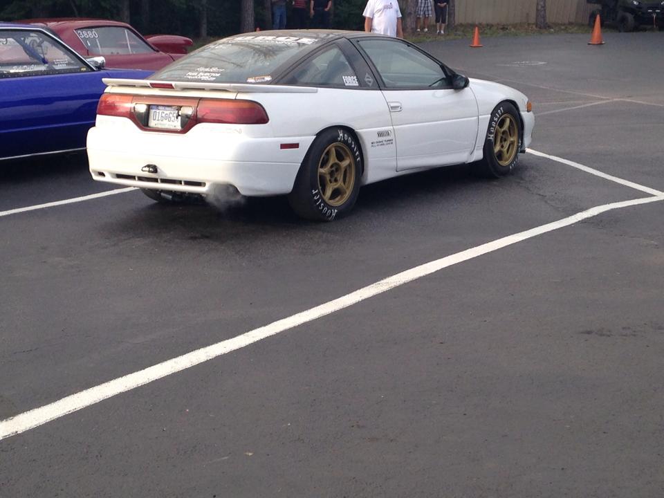

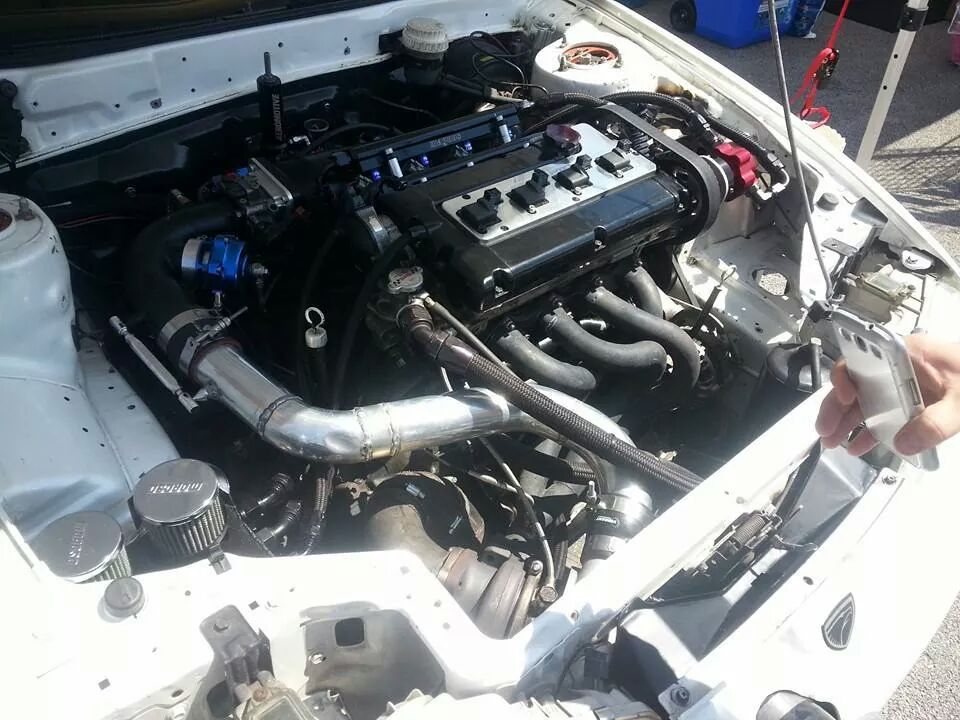

So, Yet again I haven't update this in some time. The last I posted I still had the FP manifold on the setup. I wasn't able to get the combo spooled on the converter using the FP manifold. For testing purposes we thought we would try my old header to see if that would help. Turned out it made a huge difference! My spool times instantly went from 21 seconds to make 7psi, to 18 seconds to make 16psi. After some tweaking these numbers have improved greatly. This goes to show that a proper header design can have large affects! People that spend time to make, un equal length, headers with a poorly designed collector are definitely leaving hp and transient response on the table. We saw gains of 10-15 ft/lbs under the boost curve with our header over the FP manifold. Once we got the combo working well enough to make some passes I went bracket racing. On 25 psi we running 10.40s at 134 pretty consistently. Turned it up to 30 psi and 9.90s - 10.0s @ 138 were the average. typical 60 ft became 1.45-1.47 depending on air and the track prep.

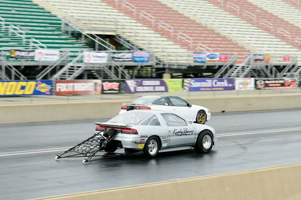

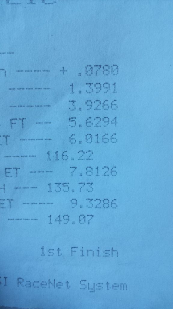

Last Wednesday I decided it was time to turn it up to 40 psi. On the dyno this netted us 600whp at 8300. I had to make several short passes for my IHRA license. Doing this worked out well since I was able to dial in the tune a bit more. It was also kinda fun seeing peoples reaction when I'd lift at the 1/8th and still run 10.0s :). On our first all out pass we Broke the FP Black record with a 9.32 @ 149.
