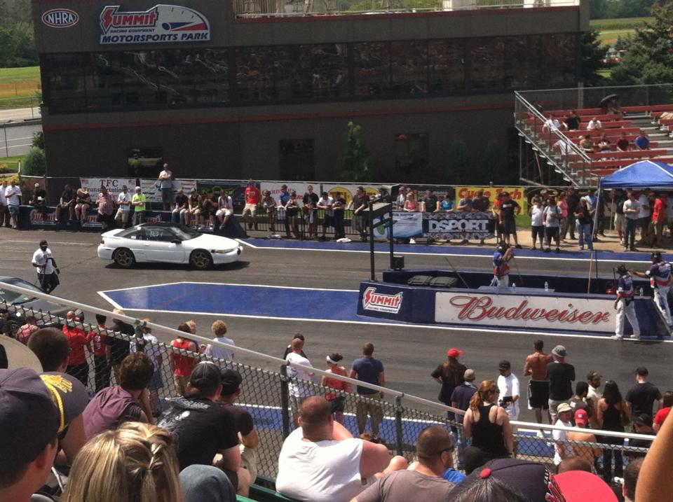

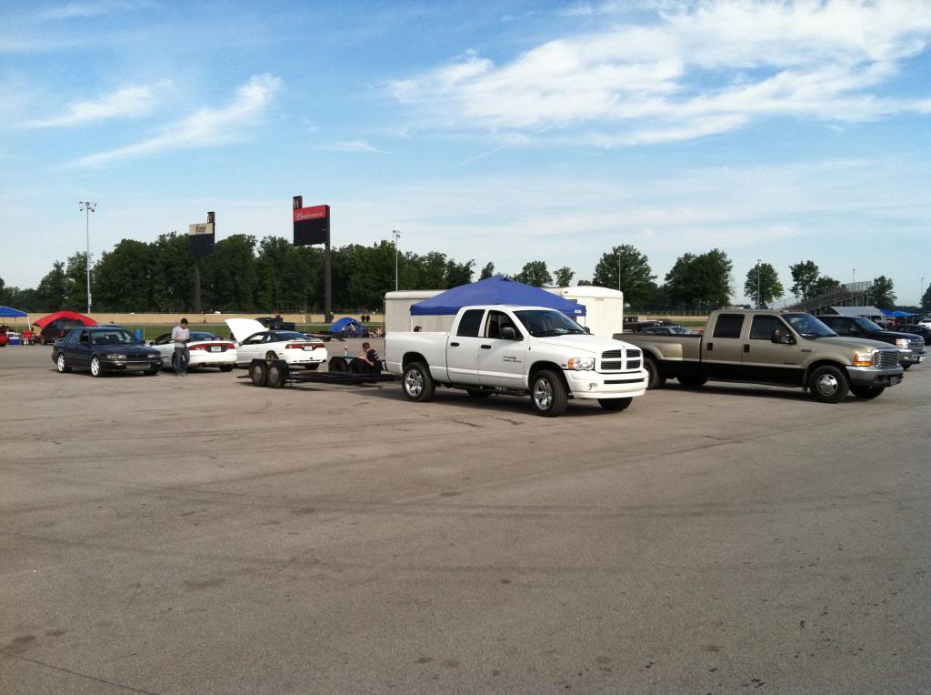

Shootout:

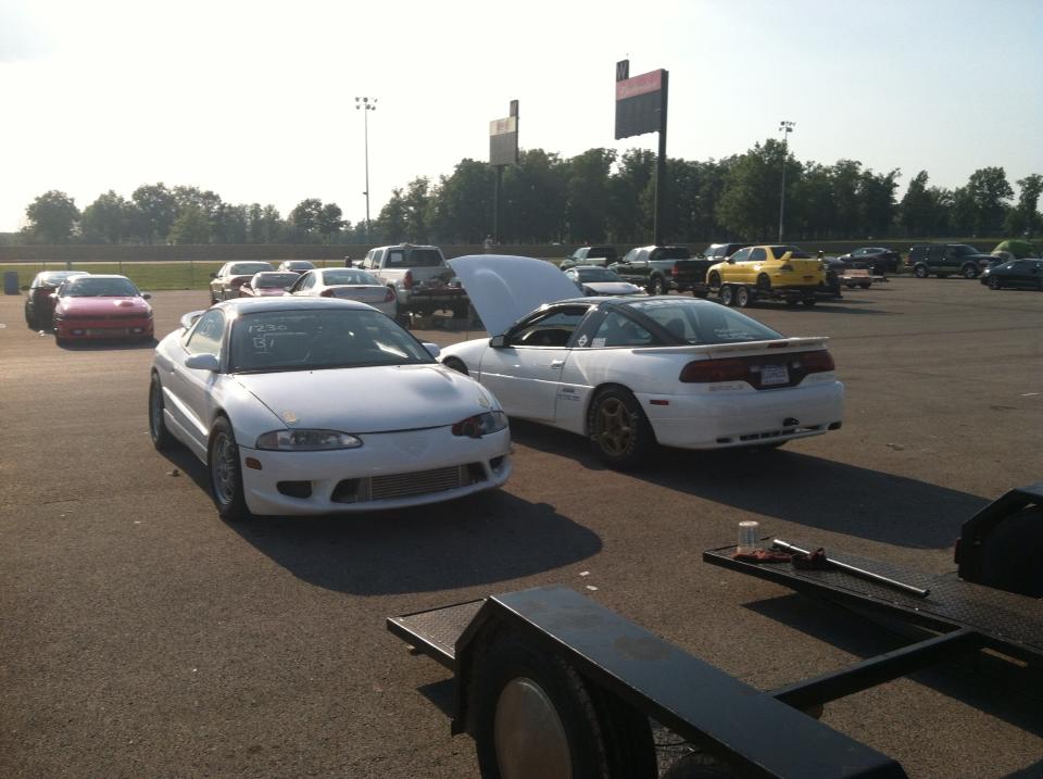

Drove the car to dinner Friday night, that was pretty fun cruising with John, and our friends from Detroit that came down to support us. First Time on the street with the 1/2 filled block, and also with the new converter. Engine and trans temp stayed in check the whole time. The converter acted very well on the street as well, drove damn near like stock. Although Brad is a pain to get in contact with at times, he seems like a very good guy, and his converter is second to none.
Saturday at the track went well. On my test pass the vacuum pump quit and I couldn't hold the car back. Went a 10.05 @ 142 with a 1.67 60ft time :( My dad pulled the vacuum pump apart and a valve was broken, he then took a .008 feeler gauge and made a new valve for it, worked great. First round of Qualifying went a 9.73@143. I called it a day and helped dial johns car in a bit more.
Sunday's plan was to only make an 1/8th mile hit just to make sure everything was ok. When I first got there, I took the car out and drove it around to get some heat into the drive-line and what, made a small pull and called it good. Went to help John and got a text saying my front tire is flat, wasn't sure what to think about it. I borrowed an air tank form Kiggly (Thanks Guys!!) and filled the tire up. I apparently ran over something and it punctured the tire. It was small enough that the leak was slow. My plan was to air up the tire since it was holding air way long enough to make a pass. Went out for the last round of qualifying and the 60ft felt good so I let it eat, went a new personal best of 9.69@144. I had also dialed the timing back into it(I had pulled 2* from the dyno because I was unsure about what the frontal pressure would do). Something in the drive line started knocking at the top of first and the beginning of second gear. Had me nervous, when I got back I checked all the U-joints and everything seemed in check. By the time I turned off the track the leak had gotten bad, by the time I made it back to the trailer the tire was flat. So in a scramble Chris (who won DSM Max effort) found a plug kit and we plugged the tire (do not do this, its dumb!). yes it was sketchy and had me nervous.
First round I had the by, and just cruised down the track to try and save the drive train, and the tire which was holding air vary well. Second round I was still very concerned about the tire, and the drive-line (mostly the tire). I had to make a good pass. Car came up on the converter slow and was very soft through first. I thought I had launched in 2nd, but then I heard the tell tail sound of a massive boost leak. Still managed to win the round with a 10.77@128 at 25ish psi. In hind sight, the boost leak may have saved the drive-line enough for the final. Came back to the pits fixed the boost leak, checked the tire and prepared for the final.
Final round went well, the tire plug held. The drive-line noise was much worse, lasted all the way until 3rd gear, I actually almost bailed as the noise got louder, then changed tone, then went away.. Went another personal best of 9.63@145 and got the win!
Today the tire was flat,not surprised. Looked under the car and the noise was the drive shaft hitting the floor bored due to the amount of movement in the rear carrier bearing. I'll have to find a solution for that soon. Plans as of now are to fix the drive shaft, and make sure the coupler doesn't come off again. Then I'll toss the 16g back on and try to break the 16G record again. I've gotten lots of positive feed back about the car, and after not getting any money for winning the SAT class, the feedback makes me feel great! Need to thank Kiggly racing, Fuel Injector Clinic, ECM Link, and everyone else that has helped me along the way!

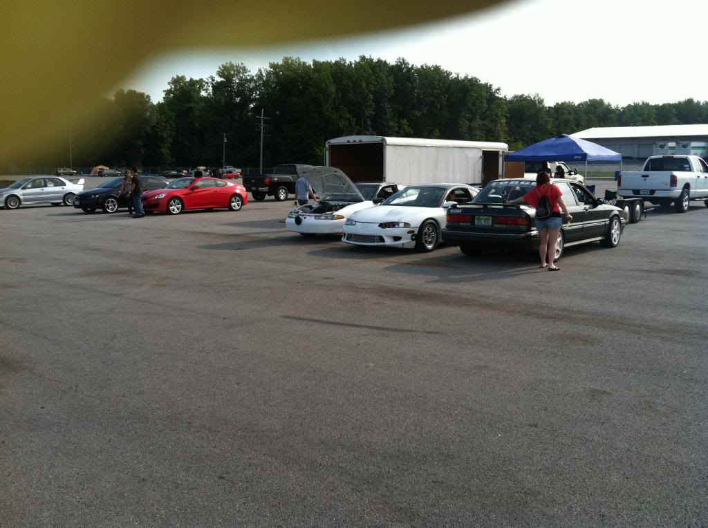

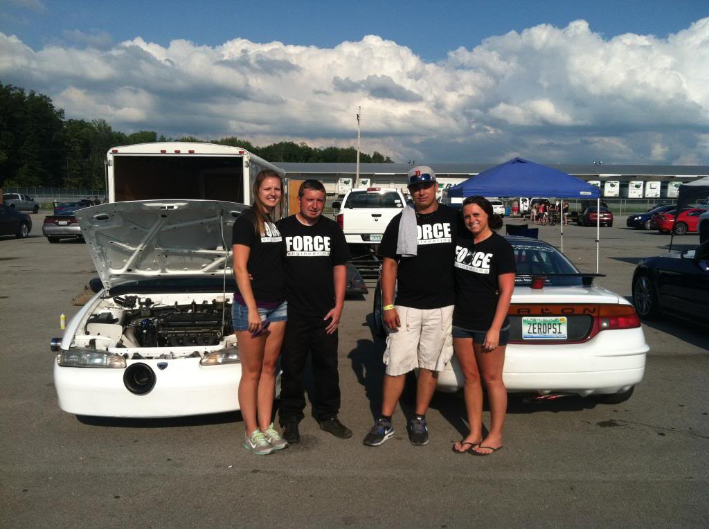

Pics:
Love this pic! thanks

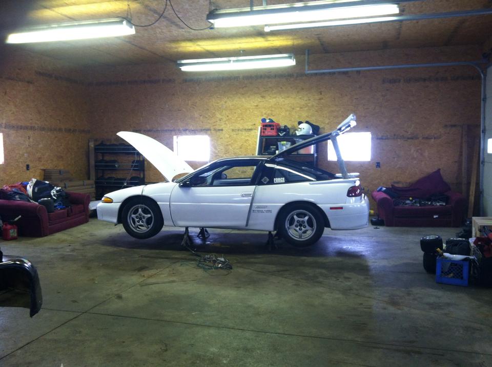

How the car sat right after shootout

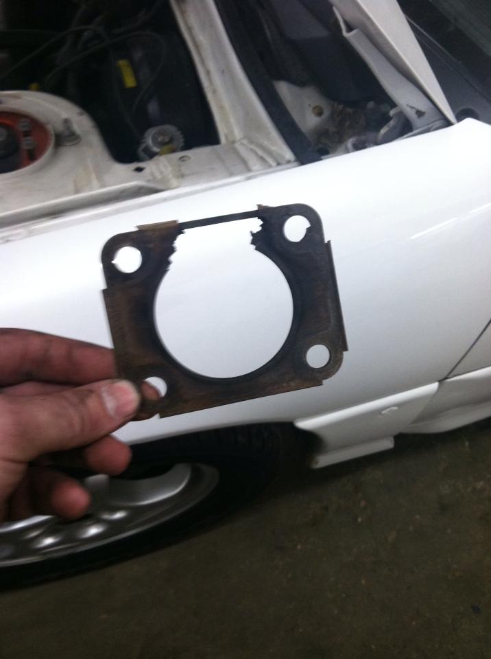

Fixed this gasket and a boost leak at the compressor outlet (Both happened before shootout), and made a few dyno passes
Car made 546whp at 38psi, was 509 @ 41psi with the leaks.

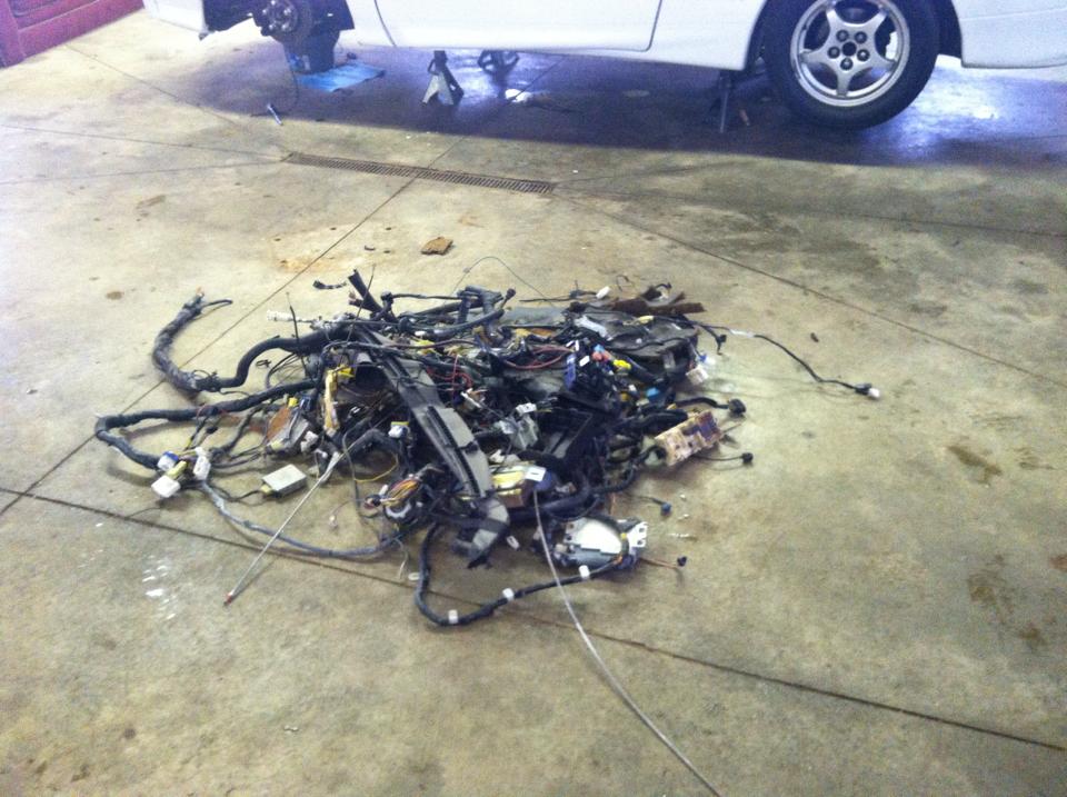

Change a few things on the car over the winter and I'm still working on finishing everything up. I finally pulled more weight out of the pig, gutted all the wiring, which was 54lbs! and remove the sway bars, the rest of the heater box, and a hand full of other things.

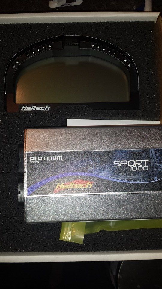

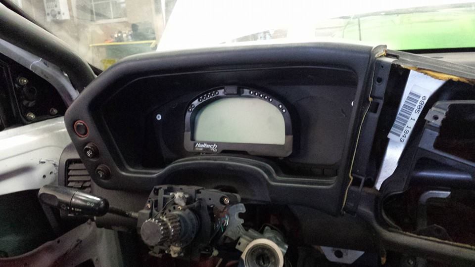

Sold my DSMlink and moved to a Haltech Sport 1000 ECU with a hand full of goodies that allow me to log several different channels of data to further our R&D at the shop. The ECU works directly to the IQ3 dash, so i removed all my gauges and purchased the IQ3.

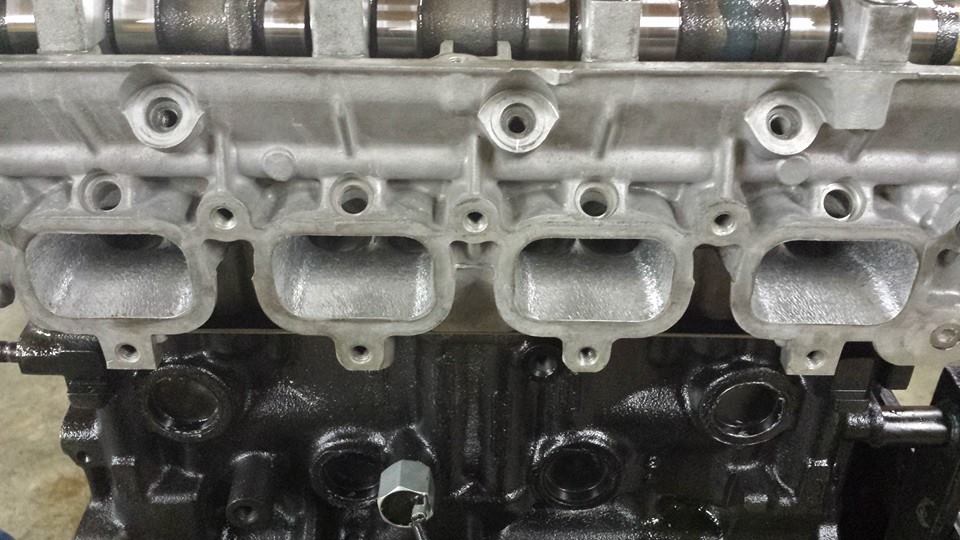

Also went through the engine, Added and a crank trigger setup to work with Haltech setup. I'm also trying a new "rough" port finish in an attempt to keep fuel suspended. Engine was in perfect shape, didn't need to change the bearings, or the rings. Added an oil heater so I can start the car in the winter.

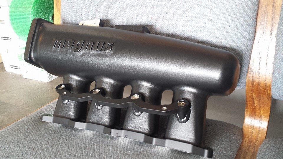

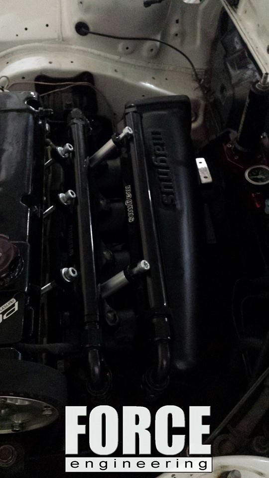

I sold the Hawver intake and bought a Magnus V3 manifold with dual rail setup.
