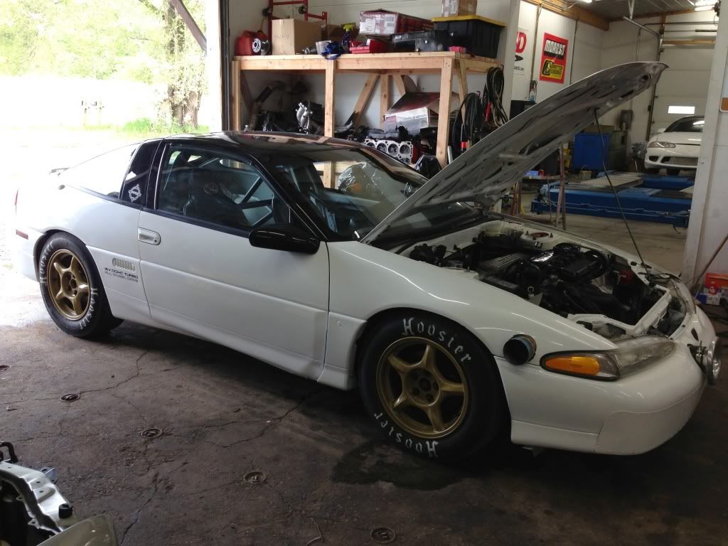

got the car done finally.. have to take picks of the cage and a few other things I've changed and get them up here for you guys.

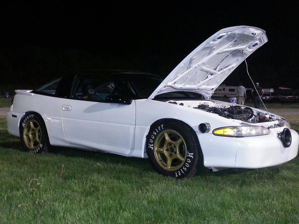

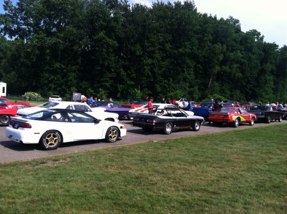

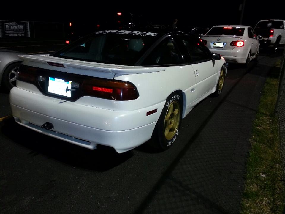

couple pics from the track:

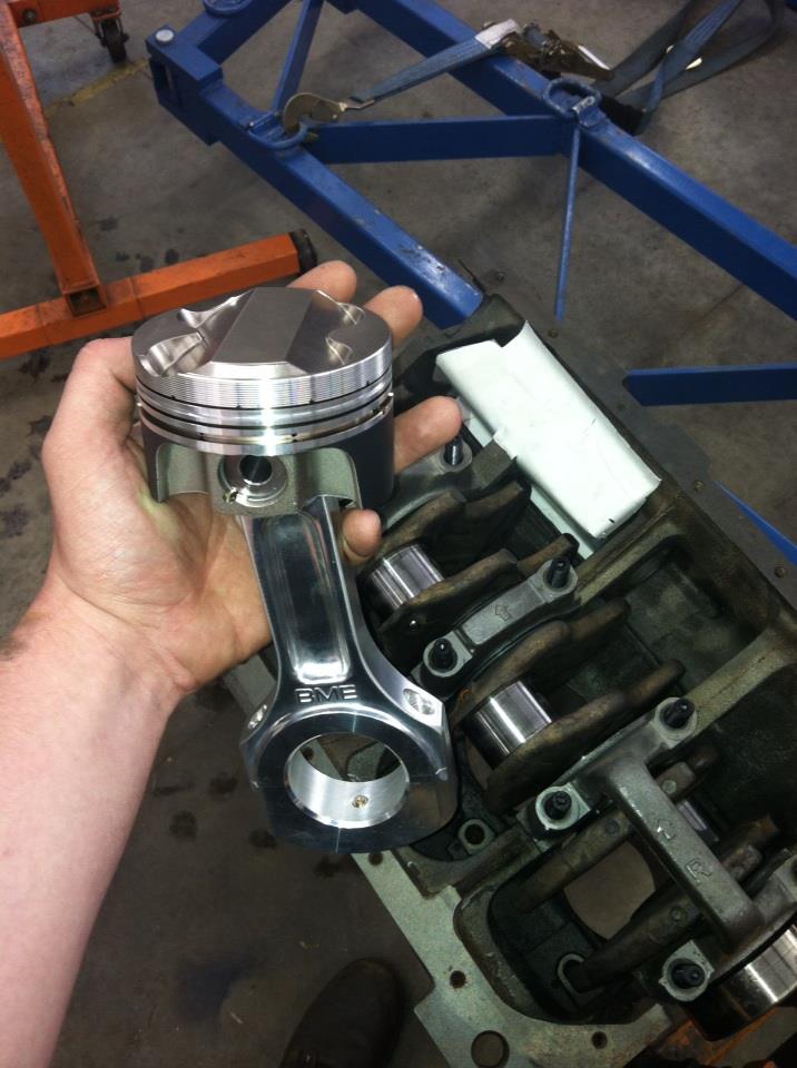

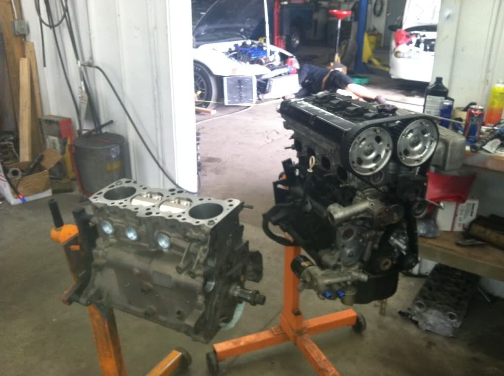

Thought I would take a second and update this for every one. I've been bracket racing the car off and on, and cruising it a bit as well. Now that Shootout is around the corner I'm trying to get a hand full of things ready. The biggest being the new BME rodded lower end. I have a list of other things to change/add to the car before shootout as well. On that list are things like deleting active toe, Magnus billet t-case cover, and a few others. The new bottom end is a BME aluminum rod/Wiseco piston combo. Standard rod length, 11:1 compression, Kiggly main girdle and a windage tray i'm currently working on.

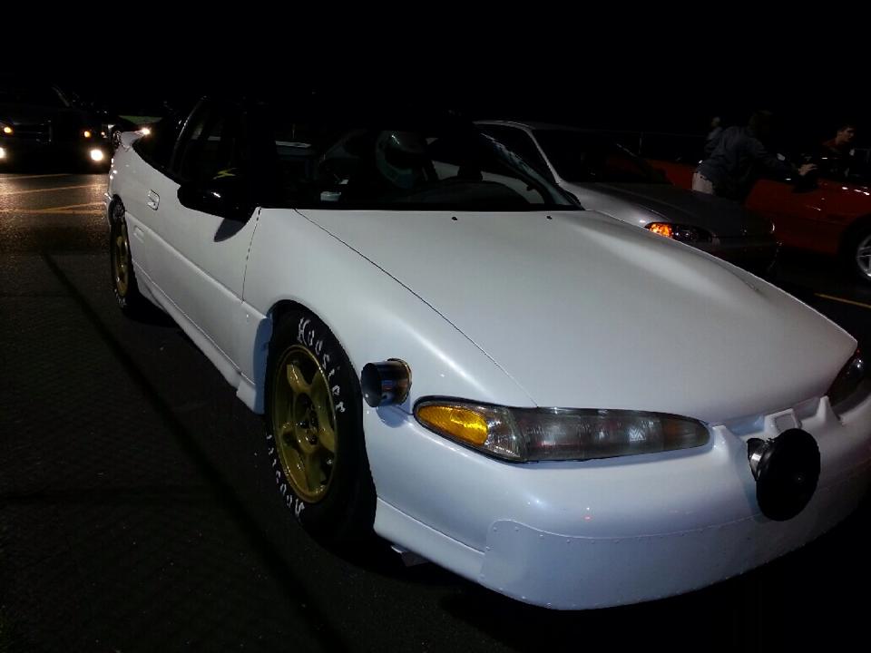

Pic from bracket racing last week:
New bottom end:

Big dome pistons are so sexy. I can not wait to see what it will do.
Have you thought about welding the combustion chambers and shaping them like a clover leaf? It is a lot more work but it will keep the piston weight down. I like to see that 16g with 13:1++. I seen how much more power on low boost 12.5:1 (calculated after the cc process and compression tested 265psi) can do. I built many 13:1 b20/vtec engines for Honda guys and always wonder what they would do if they were boosted.

I kept the compression ratio lower on this because I don't know what path this car will go down in a year or so. Thought it better to keep the compression where it wouldn't limit me. I build a lot of crazy N/A stuff as well, never have welded to a piston though. Usually I'll make a mold of the combustion chamber and send it to the piston manufacturer. They cut that into the piston, then I'll finish them by hand.

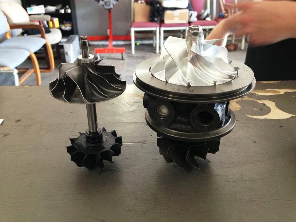

Finally got the new engine & turbo installed
I've had the new combo on the dyno once so far, its looking promising. I've already exceeded my previous power number by a bit. The biggest issue right now is the converter, I was thinking I'd be able to stall the new combo, and I was wrong. I can make 5psi on the converter, but that is no where near what I need to make. I sent a converter and a check to Bradco on Friday, hopefully I'll get it back in time to make a test pass before shootout, but that isn't looking good. I'm hoping to have the car back on the dyno tonight, and see what its got. I'll post up a dyno sheet tomorrow if i'm able to get it done tonight.

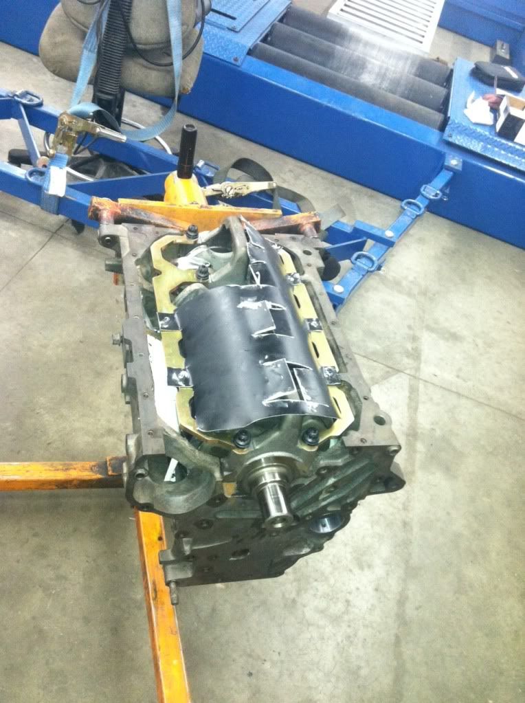

new short block:
Swapping everything over

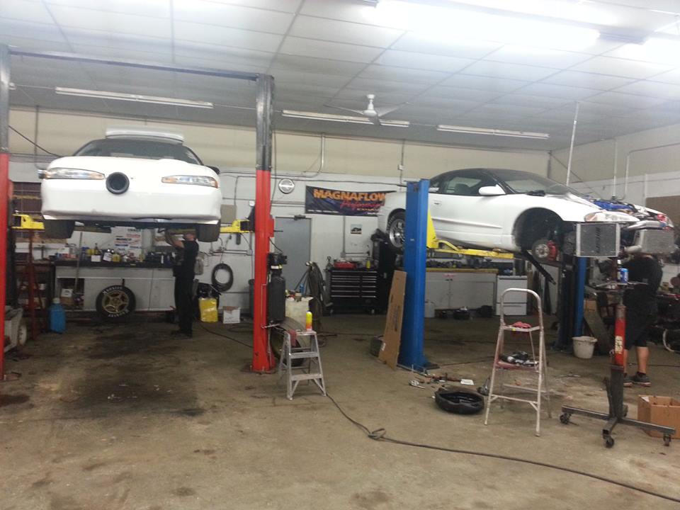

John and I working late along with Paul Volk, and Joe Whalen..

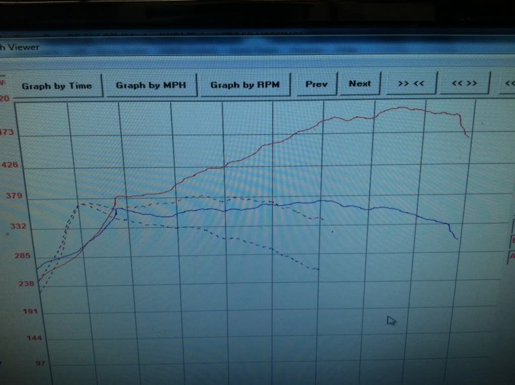

Well I've got the tune close on the dyno, time to make some test hits. Car made 376TQ @ 6700 and 509HP @ 7500. The dotted line on the graph is what the previous combo made. I'm going to pull the engine out Tuesday night in preparation for the new converter (which will be here Wednesday). Also have an oil leak at my crank case vent fittings that I'll have to fix.
