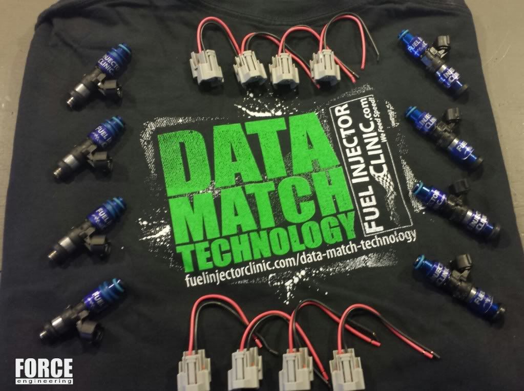

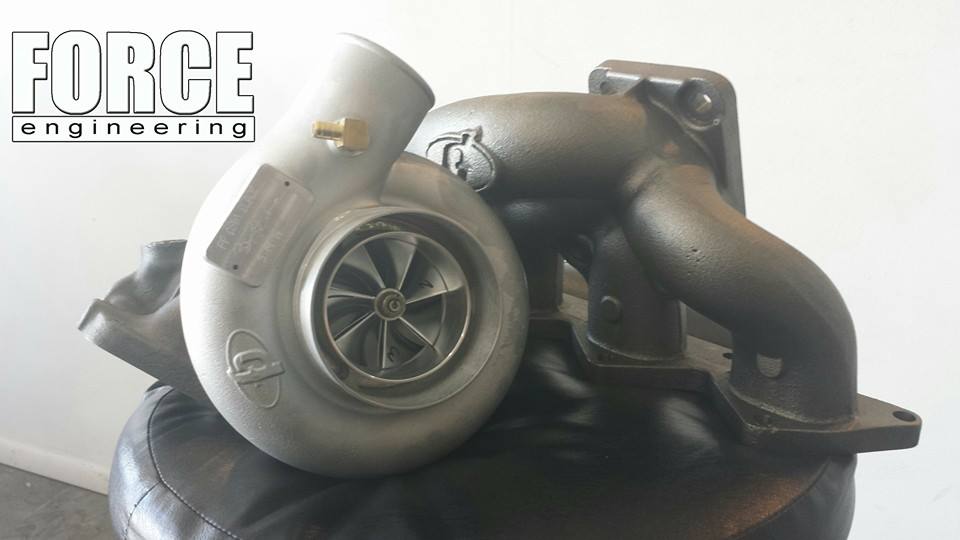

My 2014 Turbo setup showed up! Thanks to FP for help and support!
Thanks to Forced Performance, Fuel Injector Clinic, Haltech, and Kiggly Racing for the help and support!
Thanks to Fuel Injector Clinic for helping me out on another season. I've got to get to work now! lots to do.

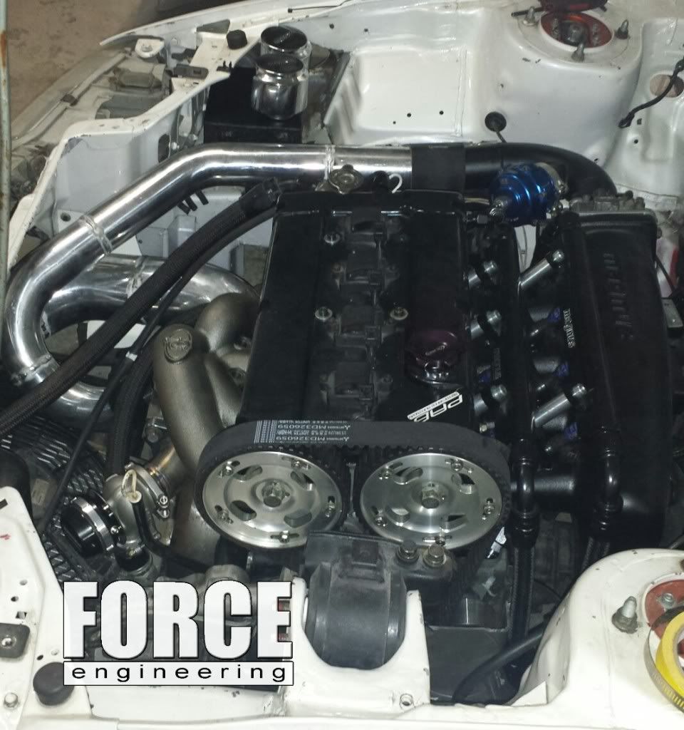

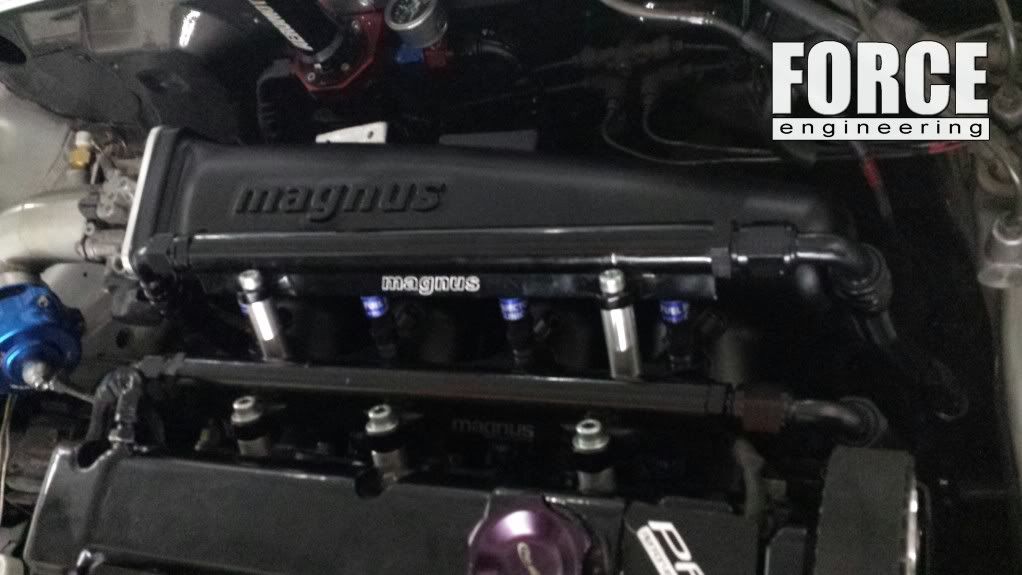

So last night I got the injectors installed, and the new intake pipe made.
Turbo intake is super slick man!
Thanks man!!

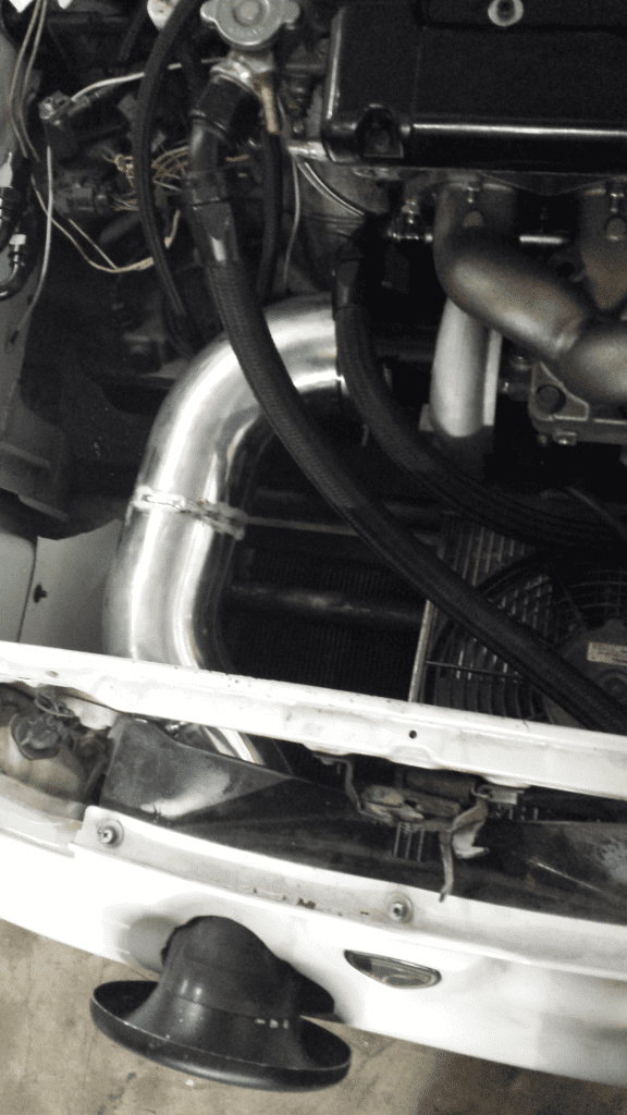

All the charge piping is finished and the catch can as well.

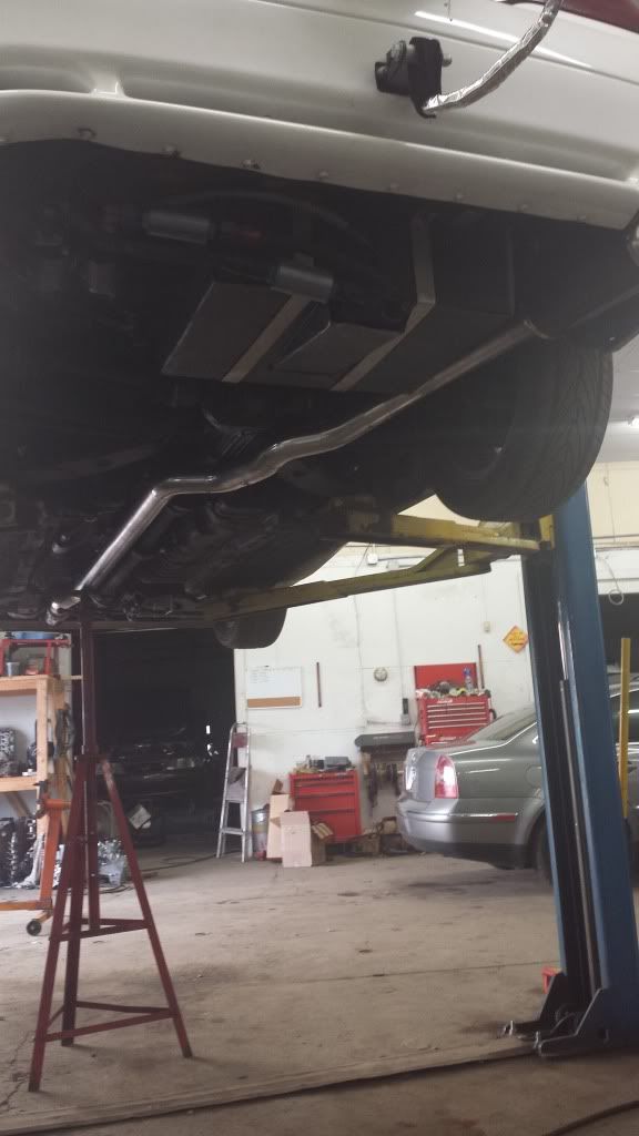

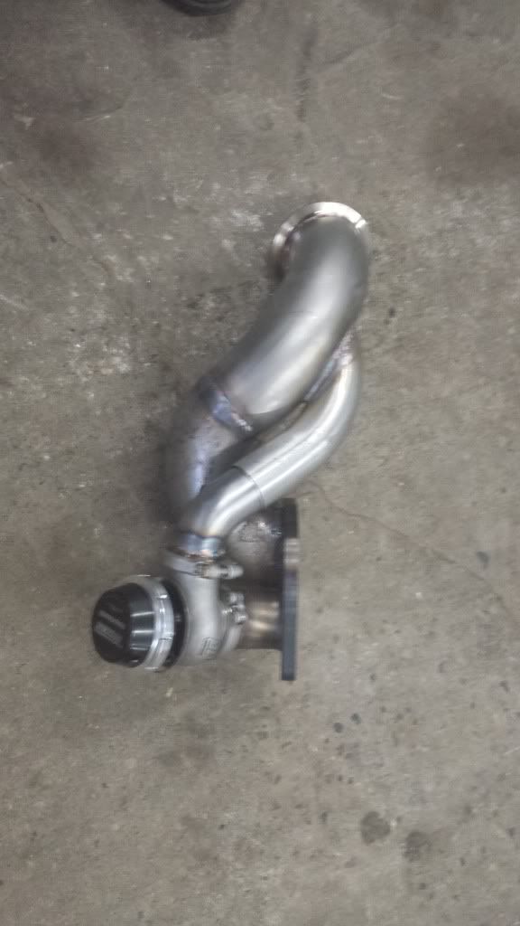

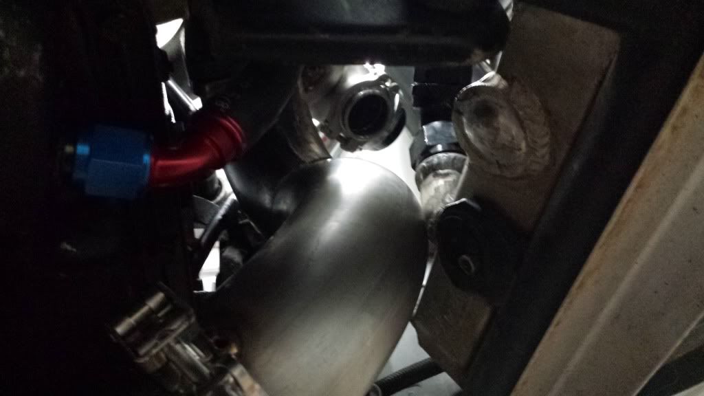

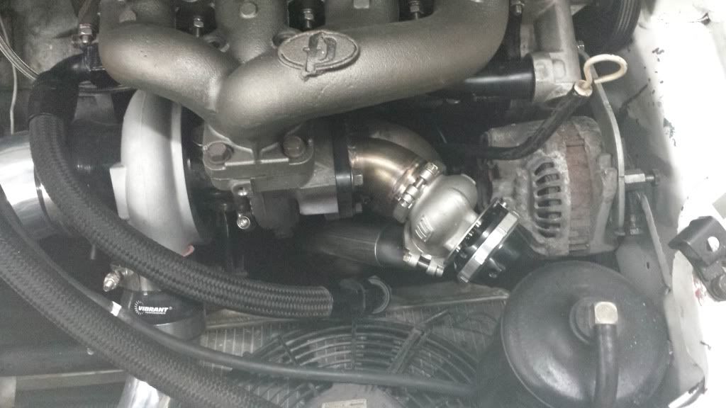

Started on the exhaust

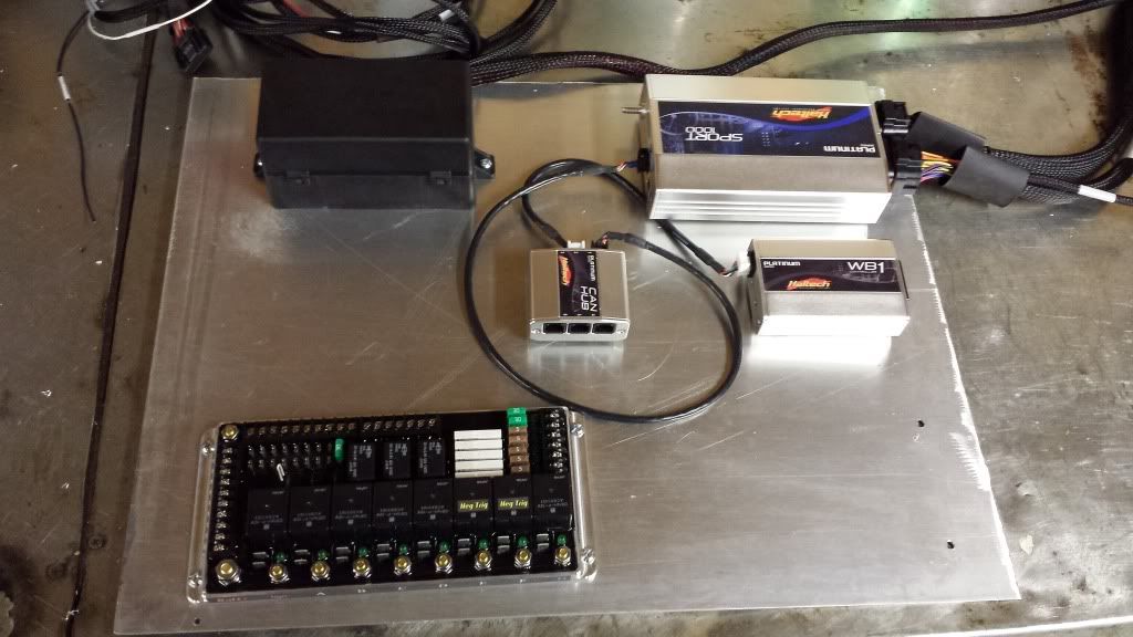

Started on the wiring

I finally had time to finish the exhaust up. Just have to add an O2 bung and some clamps, then I can mount my wring board and start running wires.

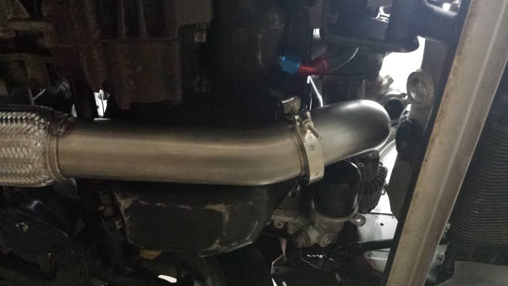

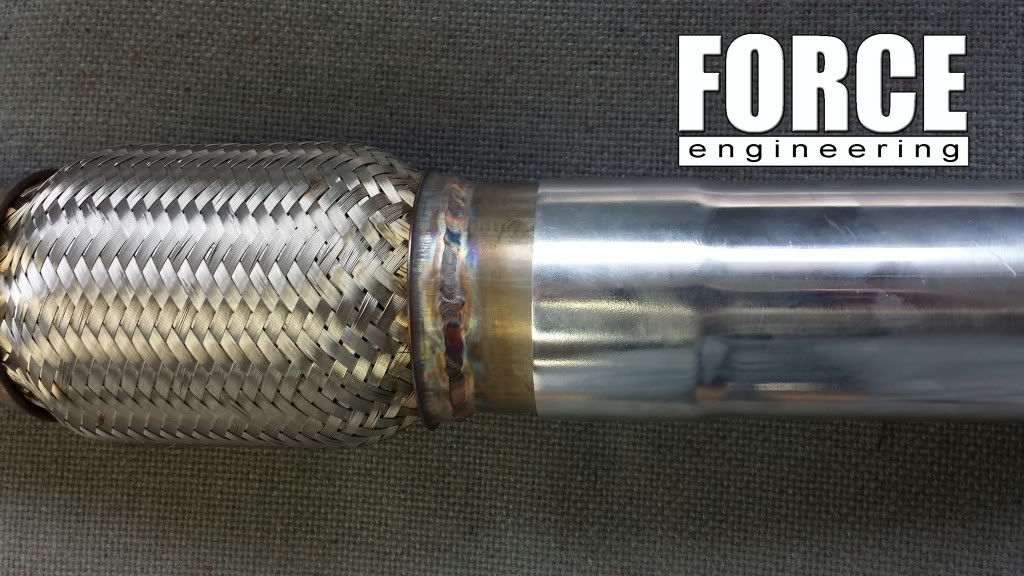

No V-band, slip fit with a T-bolt clamp. Something I thought I'd try.
Spent alot of time tucking this thing up in there.

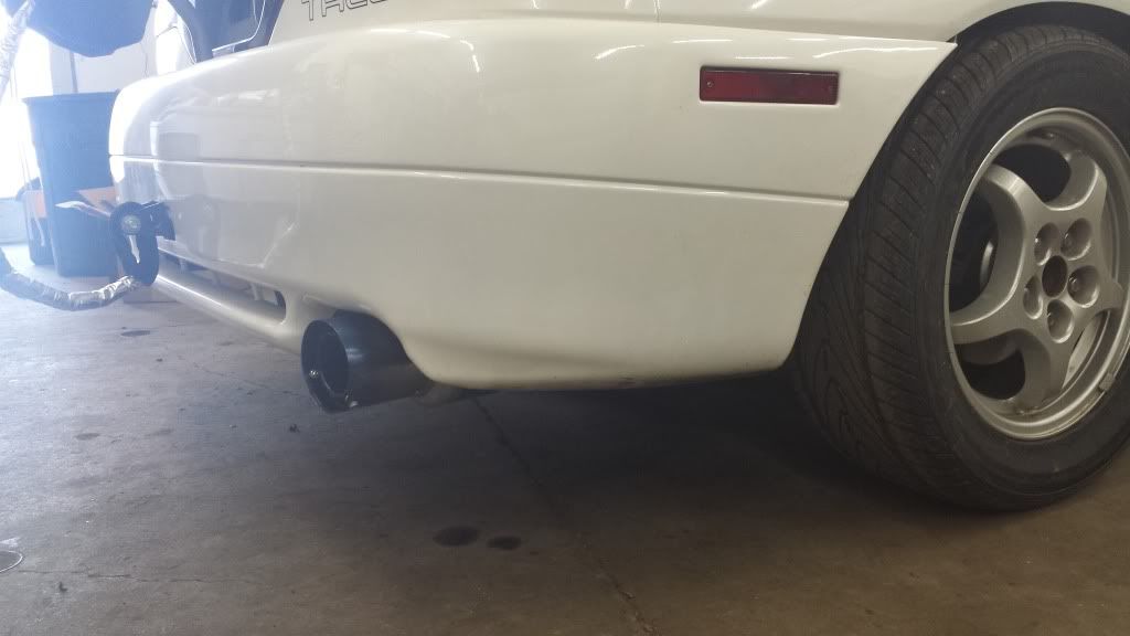

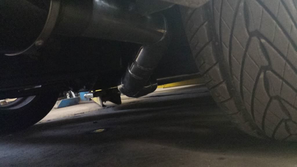

What the exit looks like. Yes its a cheap carbon/stainless/titanium Megan racing muffler, Don't hate! LOL
Still makes me nervous, but its lowest parts are right in-line with the tires. should be ok.
