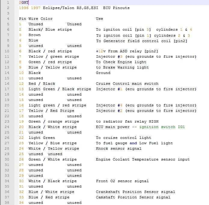

to use the 98-99 ecu on a 96-97 you would have to repin the connector to match the 98-99 pinouts
here are the 96-97 ecu pinouts
1996-1997-2gnt-rs_gs-ecu-pinouts_1-jpg.620118

battery temp sensor is built into the ecu. it assumes that the battery and ecu are the same temp since they are in the same area of the engine bay.
