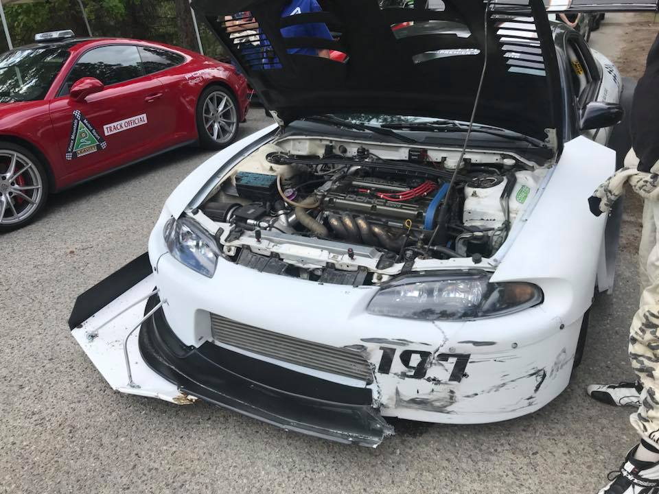

I had quite the weekend at the hill climb. First run up the hill i put the car into the wall about 31 feet from the finish line. :(
So i spent the rest of saturday fixing it. Rad support and drivers side headlight were pushed back about 3 inches. Fan was smashed into the turbo(and melting) and the rad needed a little jb weld to keep it from leaking where the center of the fan poked into it. Also, had to built a new front splitter over night in a much simpler form which ended up working not too bad. The original one was bigger and had diffusers in it. Made a huge amount of downforce to the point that at 160kmh the front of the car was skipping along the ground. The smaller splitter proved to make quite a bit less downforce without the diffusers and was very noticeable with the car going from a little loose to a little tight..(which is ok for a hill climb with roads only a little wider than the car.

And the aftermath...
2116255891965375

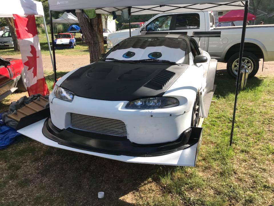

and after the repair...
2116735085250789
So...get the car back together and start getting my confidence back sunday. The car feels a lot different and i am a little scared of it now. LOL!

When i first looked at it i was pumped....this will be easy to fix. And then i tried to close the hood again.... It flexed enough without breaking on the impact so that was cool. But when i went to close it again and saw the smoke coming off the fan cause it was melting into the turbo i knew it was worse than it looked. The lower rad support was pushed back close to 4 inches and the upper was back about 2.5-3 inches. Headlight was an inch or so low(still is a little low...got some more pulling to do there) But...hooked the car to my brothers welding truck and pulled everything straight enough that the hood closed on the hood pins so it is pretty damn good. Some duct tape and some white spray pain...good to go. ALSO....building a splitter from plywood seemed like an amazing idea now. I may not even switch to something more legit since this is so easy to fix in a very short amount of time. Ill find somewhere to save another 20lbs and call it good. haha!
