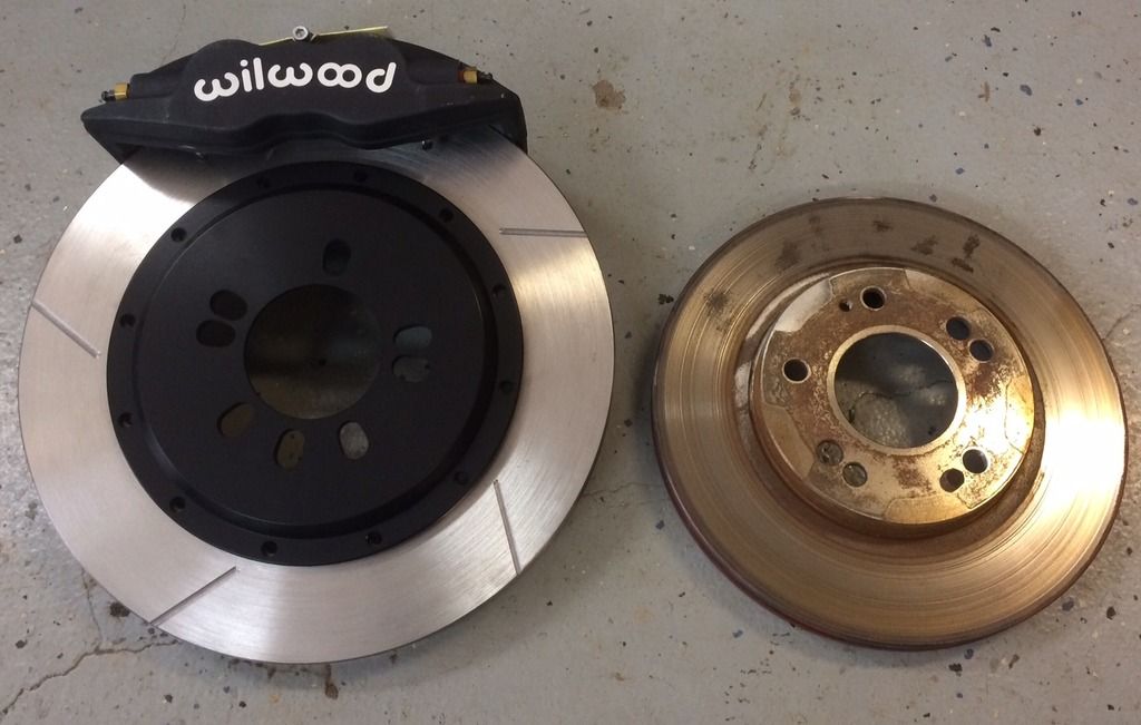

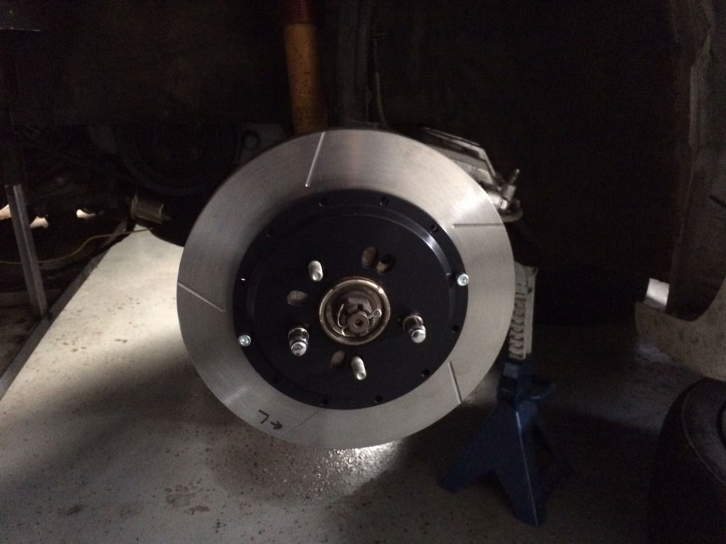

Comparing the stock AWD front rotors to the Wilwood kit.
The rotor sitting on the hub. If you order these make sure you know if you have the stepped hub or not because they will send you different centric rings depending on that. One stud missing because I am in the process of putting ARP studs in.

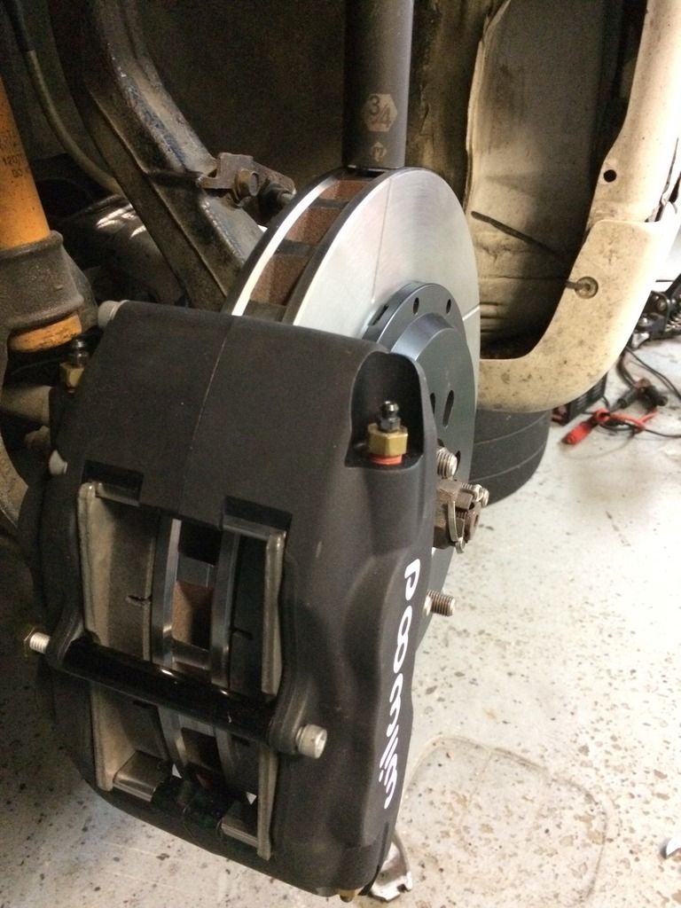

Caliper Mounted...the bracket fit nicely and i only had to use 1 0.015inch spacer to center the caliper perfectly on the rotor. Socket sitting on top just to show how thick the rotors are. They look like they are from a 1 ton truck. It is AWESOME!

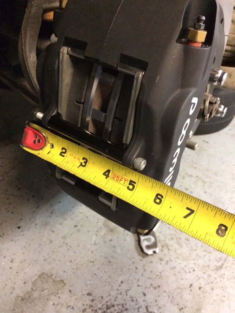

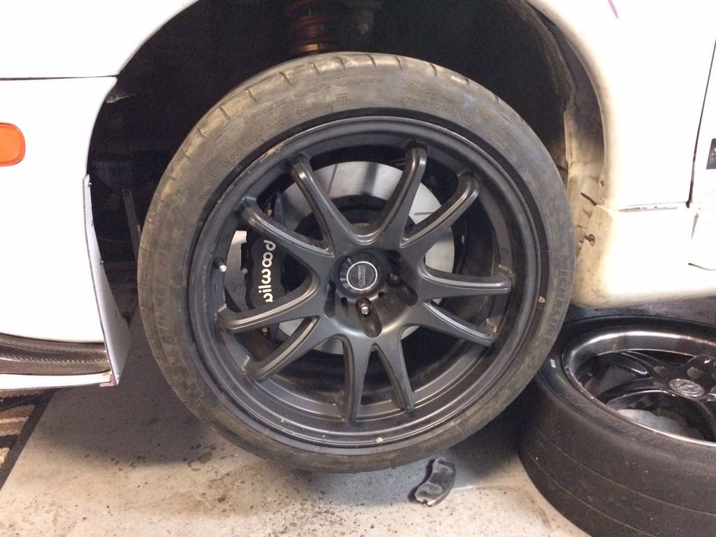

These calipers are very wide. The pads are 20mm thick and as i mentioned the rotor is 1.25 inches so your biggest issue will be clearing the spokes of the wheel. I have now put all the bolts in that hold the hat to the rotor but was just test fitting things for now so that is why they are not there.
Here they are with my "New" wheel mounted up. This is an 18x10 with +15 offset and a 275/35 tire mounted up just for test fit. There is tons of room with these wheels but my old wheel sitting on the ground wouldnt even close to clear the spokes. The 17 did clear the barrel of the wheel.

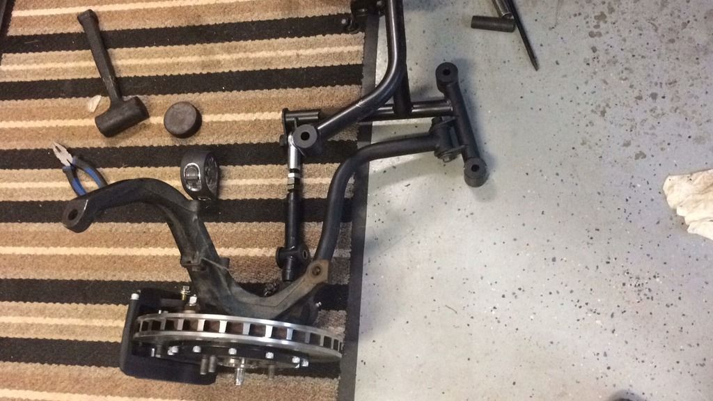

Tubular Front Subframe...work in progress.

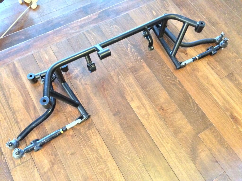

I got this beautiful piece from True Street Tuning. Josh is great to deal with and i look forward to getting this installed.

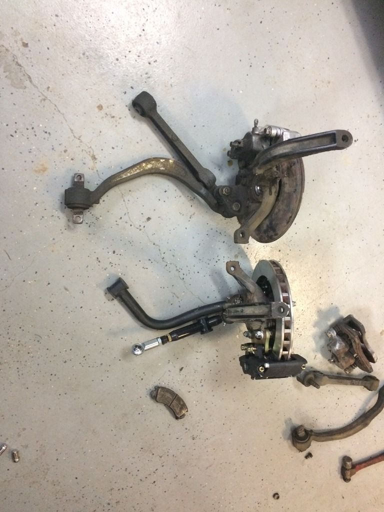

As i mentioned in the post above I will talk about the weight of the brakes and lower control arms. The lower control arms from Josh's kit are about 6.5 lbs for the pair vs 12.9 for the stockers per side. The rotors weighed 3lbs more than the stockers and the calipers a whopping 9 lbs less. Simple math here would say 12 lbs a side drop in weight. In actuality that didnt happen because there are the adaptor brackets and all the hardware and what not as well which i didn't weigh initially. But, the result is still very good in my opinion. The stock setup shown along side the new setup here was 62lbs and with the new goodies on it came out to 52lbs. 10lbs less per side!! And that is before we take into account the sub frame weight loss! I dont know how much more the new wheel and tire combo will weigh since i dont have the 315 slicks that are going on there yet. But, i don suspect it to be more than a few lbs different. If i can go from 10.7 inch brakes/225 slicks/ 17 inch wheels to 13.1 inch brakes/315 slicks/18 inch wheels and be net negative on weight I am going to be very happy.
Just mocking things up before i put the whole thing in the car. I am Canadian so there has to be a hockey puck involved in every job. As far as i can tell it looks like everything should work fine.
Right now i have everything but the power steering rack out of the car. Just need to do that and then the stock subframe can come down. From what i can tell at this point the sub frame itself is right around 20lbs lighter than the stock one. I will need to make a new "north/south" bar that the front engine mount is on which will also be tubular and i would hope be lighter than the stock one. As for the sway bar it sounds like i can weld some tabs on the new subframe to accept it pretty much like stock. Waiting to do that as well as I have some RM sway bars coming. I will update once i get a little further on this part of the project.

Dude... that front subframe is the sexiest thing I've ever seen. I had NO idea someone was making one. Is it built with better suspension geometry in mind? How much did it cost? (you can PM me that if you'd like)
