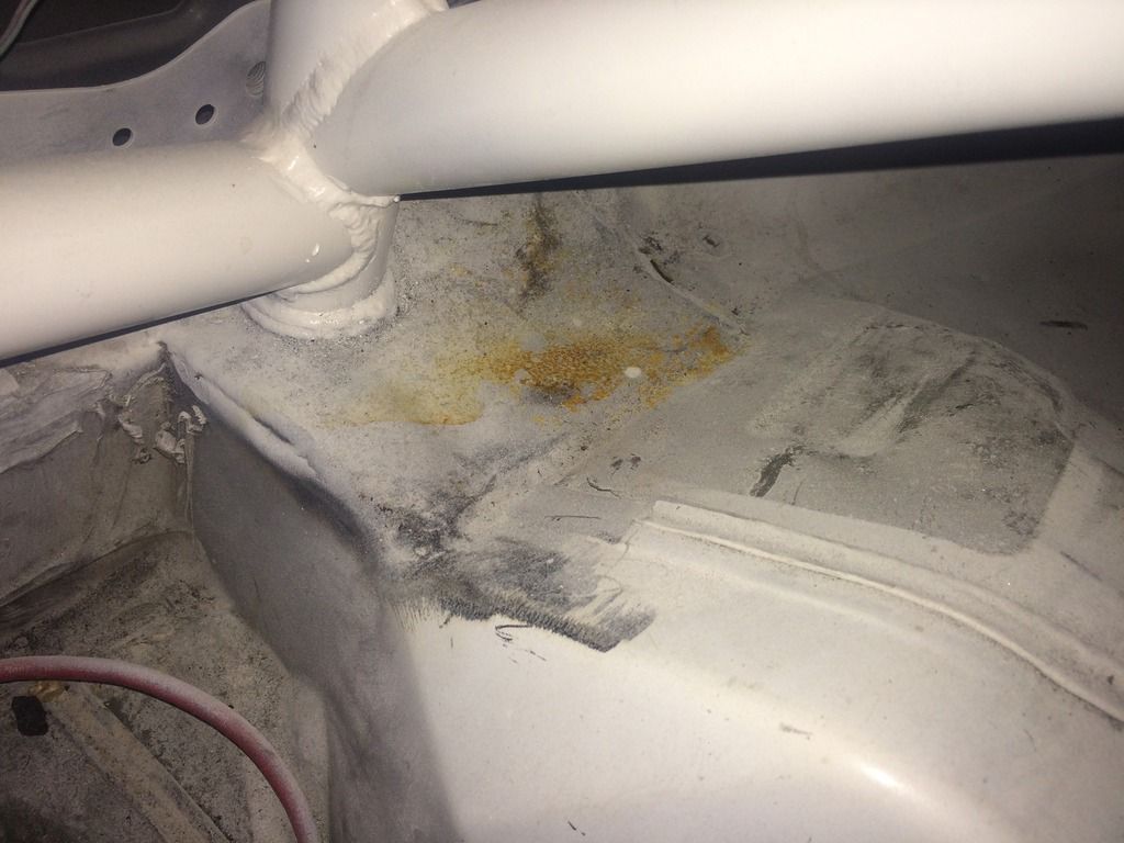

    The cage only needs straight bars from the top front corner of the side windows down to the bottom front mount plate(easy to do after the fact) and the full "x" put into the main hoop. I do not need the full "x" for just a driver but if I ever run an event that needs a condriver then I will need that. Then the car is full wrc spec.

    Regarding the cage, I was referring to how yours is welded directly to the body of the car. Ideally you want to weld steel plates to the body of the car, and then weld the main cage structure to the plates. Without these reinforcements, the cage bars can simply push through the thin sheet metal of the body in the event of a rollover or serious crash.
    Here's a couple examples:
    I'm no expert in cage design, and don't know what specs you're required to meet for you racing body and event tech. I'm just pointing out what I've seen mentioned in various cage building threads I've seen done over time.
    I thought these were the modifications you were referring to when you brought up making additions to the cage later on. As you can imagine, these additions would be hard to add later on, which had me confused. It sounds like these aren't the additions you had in mind, though.
    Never the less, excellent craftsmanship on the cage. The entire build is great, and I'm really looking forward to seeing what you do with the car next season.

    It is welded to the correct steel plates at all attachment points.

    Oh, ok. It looks like it's welded directly to the body in the photos you posted above. My mistake.

    No problem man, hard to see in those pics. Here are some close ups. The FIA specs for mounting feet are at least 120cm^2 in area and at least 3mm thick. I have them 3mm thick and they are all larger than 120cm^2.

    Ahhhh, now I see. Looks great!
    I was a bit dumbfounded looking at the craftsmanship of the cage overall, and not seeing it mounted to plates. I couldn't make sense of it. Thanks for the extra pics.
