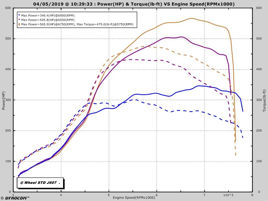

When are you hitting full boost? It looks like it's hitting hard right after 4k.
What size turbine housing?
It is hitting full boost about 4600. Retarding the intake cam to "cam card spec" lost me about 500 rpm of spool but picked up a boat load of power up top so it was worth it. This is on the FP30 exhuast housing.

Here is the dyno graph! 20psi first pull of the day vs 26psi on a 15lb wastegate spring and 31 psi on 20lb gate spring. 14 degrees of timing and 11.2-3 afrs gas scale on E80.
