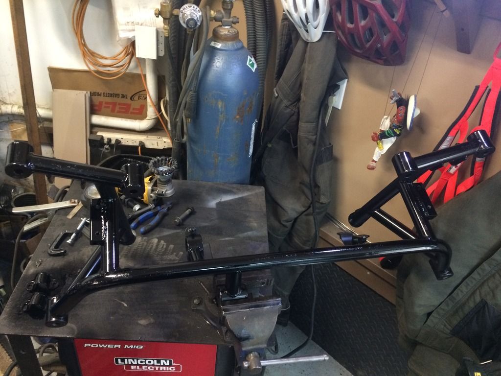

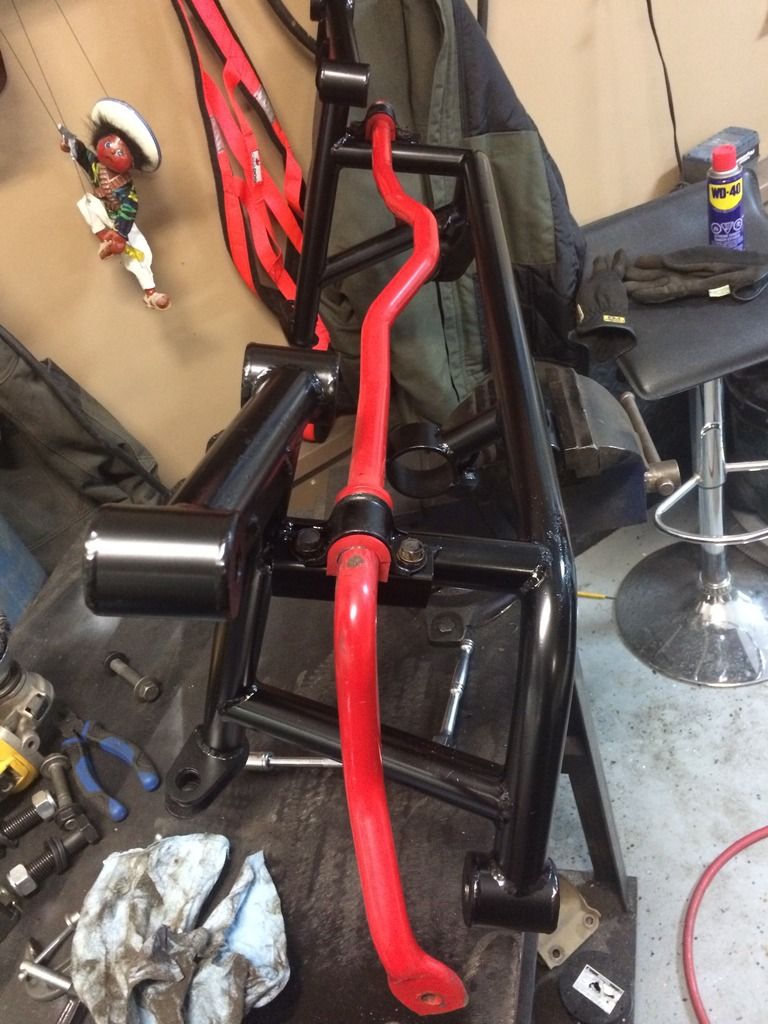

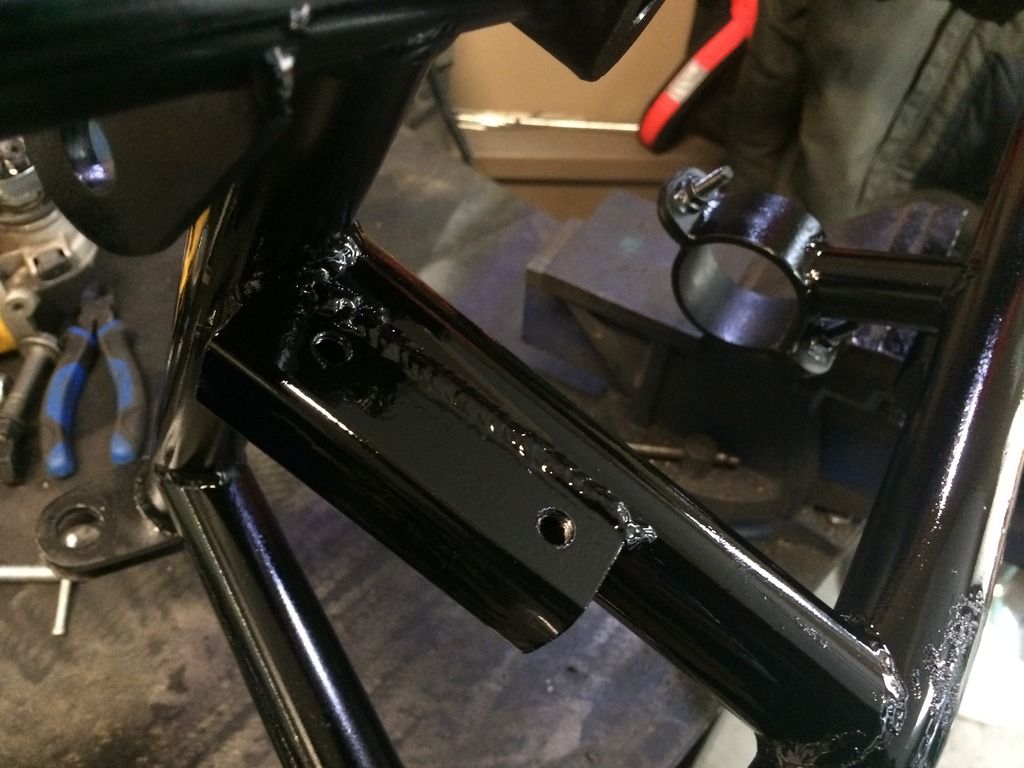

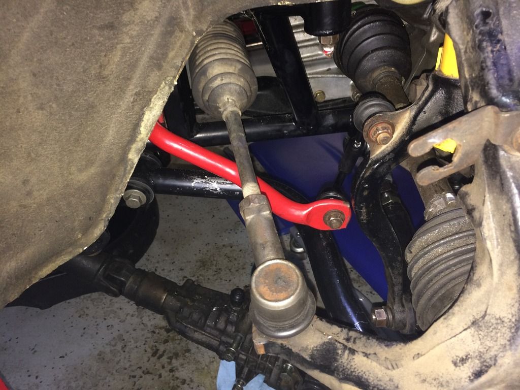

So i got the sway bar mounted to the sub frame. I used some 1x2 square tubing and welded that on the uprights behind the steering box. I also used rear sway bar saddles instead of the fronts because they are flat. It is a tight fit and took a little bit of massaging to the fire wall to make the bar clear and full suspension travel. The other issue was that the shock mounts are moved in a little from stock so it is also a tight fit on the sway bar end links. I modified the stock end links to fit by flipping both ends to face the same way. Here are some pics of the mounts and the subframe/swaybar/suspension in the car.
Sub frame with both mounts welded on and painted
Close up of one of the mounts
Sway bar on
Sway bar and frame in the car. Notice the modified end link. I think this should work just fine.

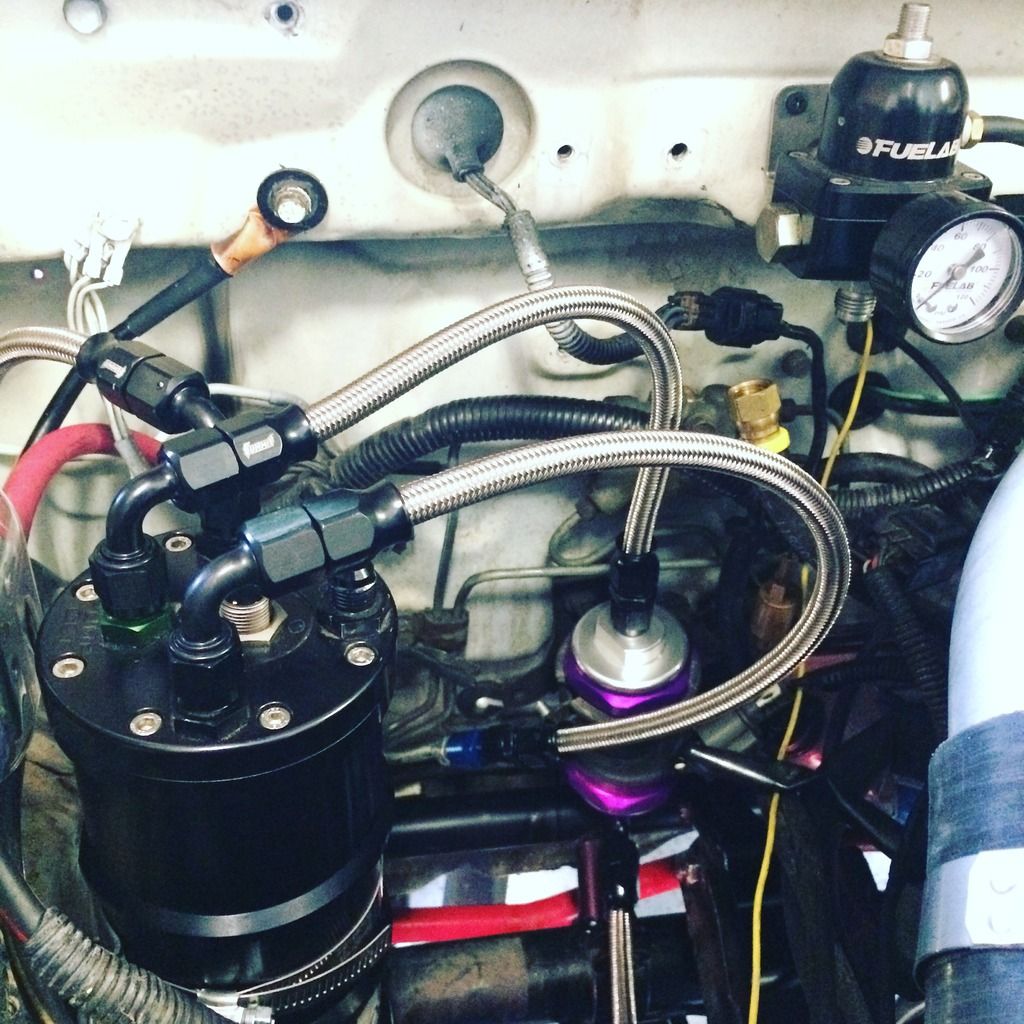

The more fun project is the Radium Engineering fuel surge tank and teflon lines with 450 walbro for my E85 conversion for this year. I have a little wiring to do and the return from the regulator to the surge tank. Aside from that it is good to go. System uses a 340lph lift pump in the tank and then as mentioned a 450 wally in the surge tank that goes to a fuel lab filter and finally to the rail. Then it goes through the regulator which returns to the surge tank and then the surge tank returns to the stock fuel tank.
Not quite finished but you get the idea...

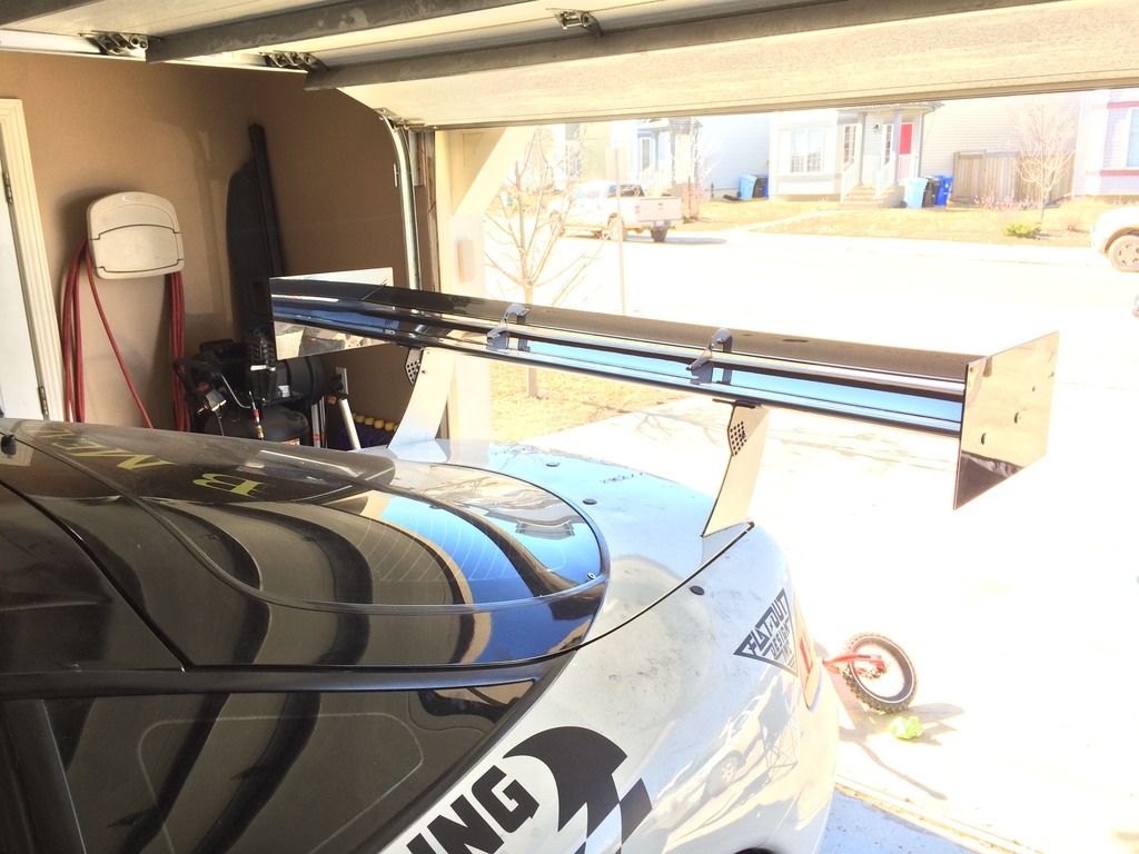

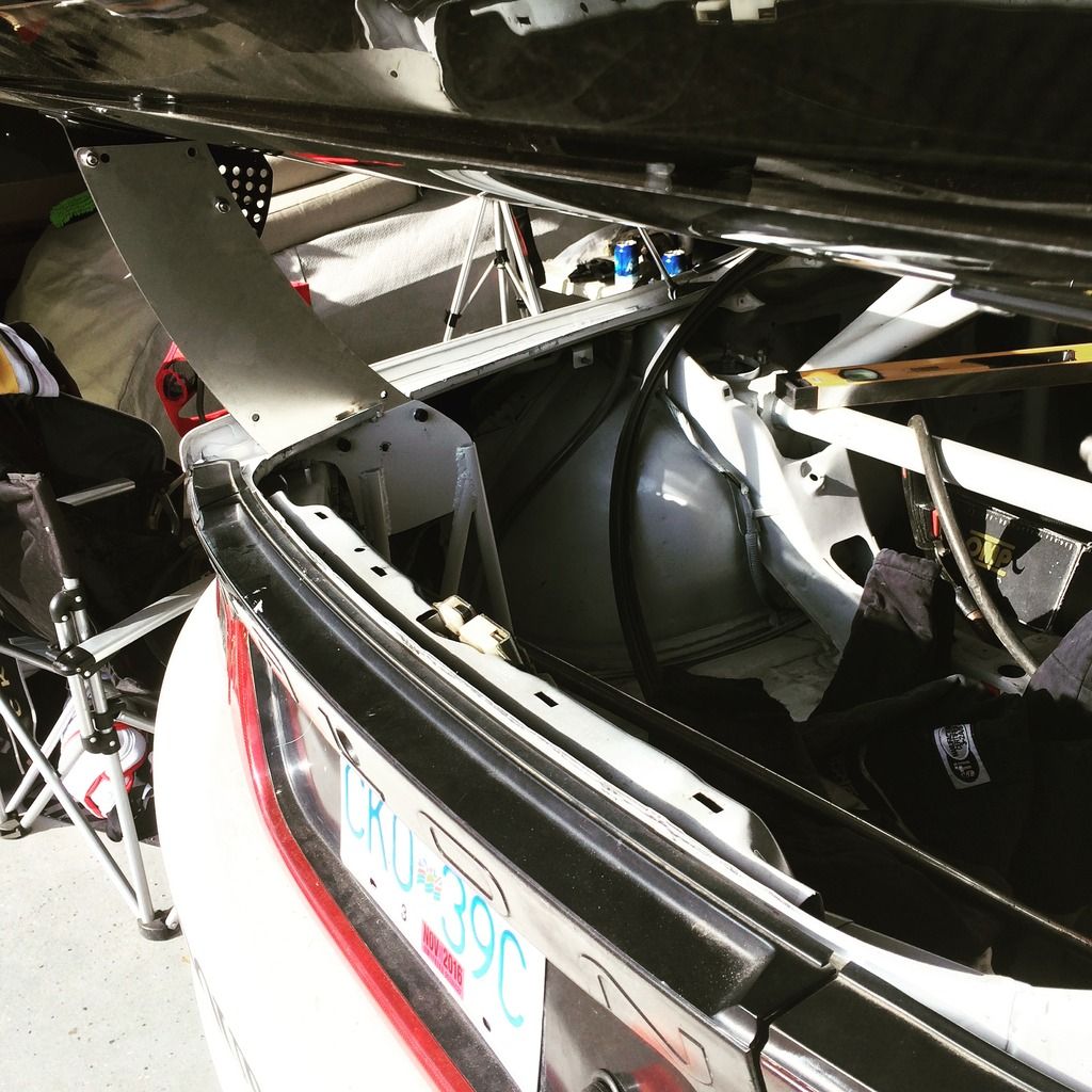

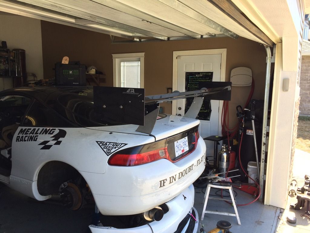

I got my 78 inch APR GT1000 installed over the weekend. Really happy with the results. Need to clean up the hatch lid a little and it will be good to go.
Here is a shot of the inside of the trunk...sorry it doesnt show the floor. Not much to see there anyway. Just the 3/4x.065 tubing mounted to a plate welded to the floor of the trunk.
Cut the notches in the hatch lid so the wing pedestals slide through nicely. I like the look...nice and clean.
Front 3/4 view. Sorry i cant really get a good shot of the whole car yet as it sits. Once i have it on the wheels ill pull it out and get a better picture. The wing sits so the main element is about even with the top of the roof.

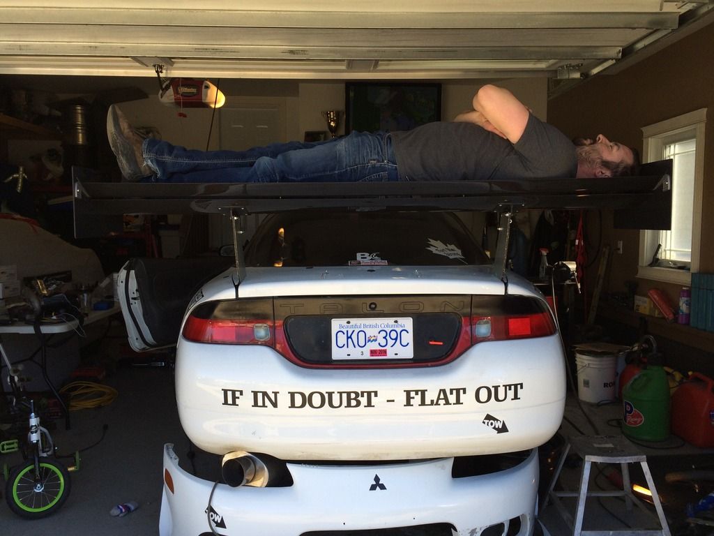

That was a lot of work...Nap time. LOL. I am 6'1" and 240 lbs...wing didnt move at all. I will likely throw some bags of sand on it and sit a couple people up there just to be sure my welds are not going to crack. But, initial feeling is that it will be plenty strong to handle the downforce.
Slicks should be here in the next 2 weeks and i can get the car sitting on the ground again and finish up the last few things. The Aero kit should be here in the next month or so. I wont have it on for the hill climb this year but hoping to get it on this summer and test so I am ready for next years climb.

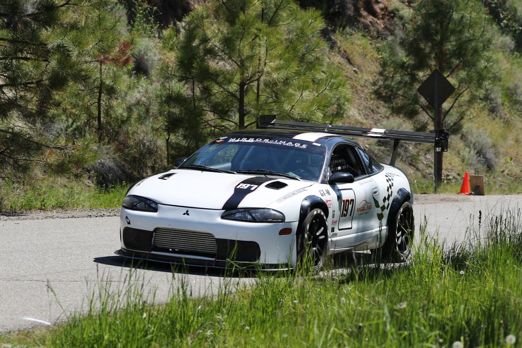

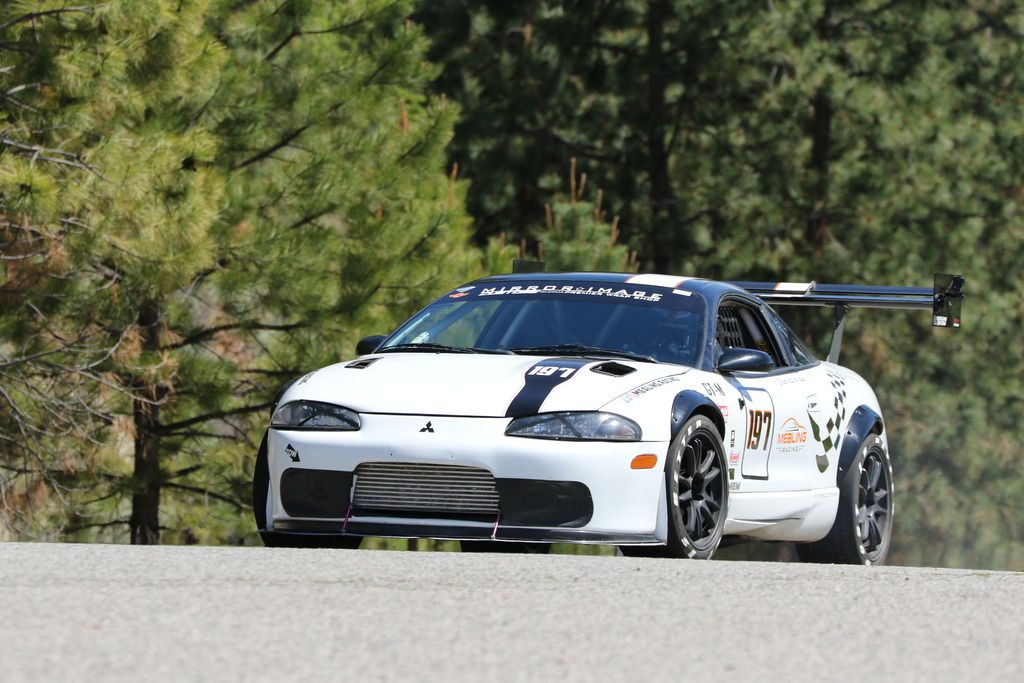

So i had a really rough go at the Hill Climb this year. First i was struggling with the alignment...just didnt like the feel of the car. So i played with that the first 2 runs on day 1. Got it sorted and then the 3rd run on day 1 i had the little 2 inch long rubber line from the wally 450 to the outside of the surge tank split...lost all fuel pressure so that wrecked that run. Then the first run of the day on day 2 i had a plug wire come off the coil at 8000+ rpm and 30psi and it took out the head gasket(im guessing hydrolocked a little with ethanol). SOOOOO no good runs in this year.
Only positive news is I still managed a 2:05 just "cruising" up the hill on one of the alignment setups i didnt like. I had to wring the cars neck last time to get a 1:59 and i was literally waving at corner workers and what not on the 2:05 run. With the APR GT1000 and the 285 BFG r1s's the car has huge amounts of grip.
Couple shots from the climb:
The tubular front sub frame.....
It still needs some work. I am going to convert the inner mount of the compression arm(Rear curved bar) to a uniball with a urethane bushing on either side of it. ANY movement in that joint causes the alignment to wander around. It should be a simple fix.
Aside from the lower arms needing to be designed a little stronger (mainly where the shock mounts) i think the setup is going to work well. As with anything when you are working with something fairly new and untested there are issues to work around. Im confident i will have this working perfectly for next year.

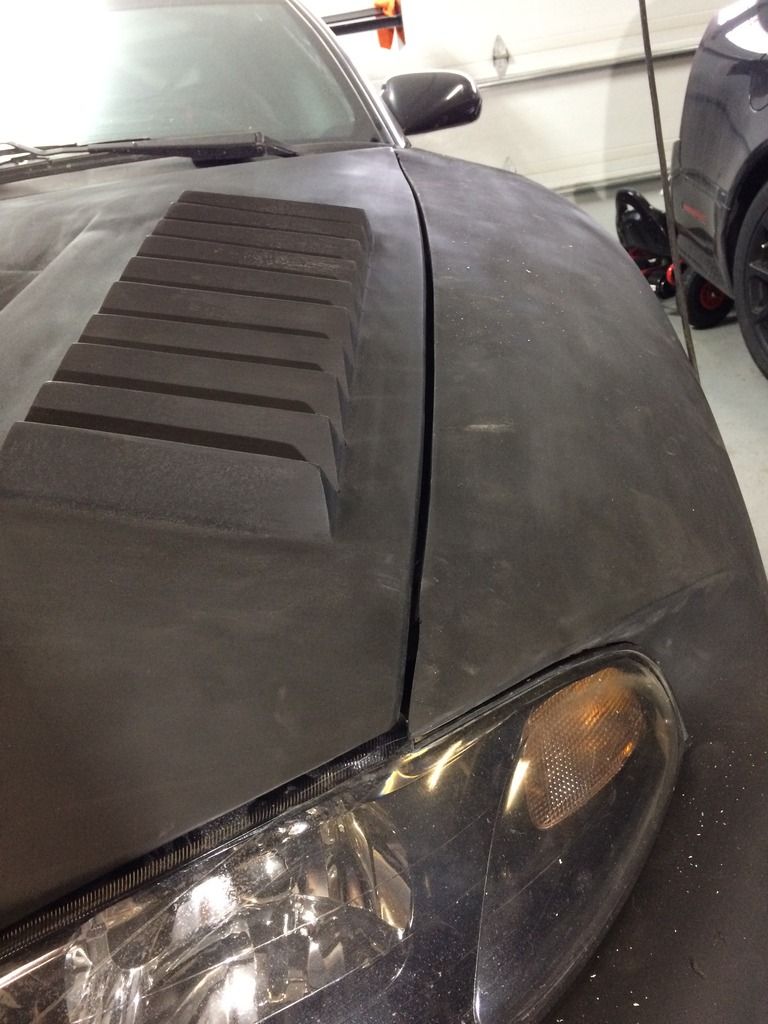

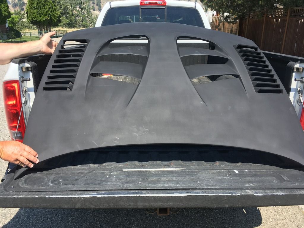

The aero kit is in my hands now(at my dads place for the time being) and I will have it at my garage in august after i return from summer holidays. Here is a teaser of the Hood...the quality looks FANTASTIC and i cannot wait to get this all installed this winter.
I will update more as i get the aero package installed on the car.

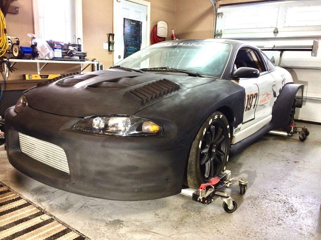

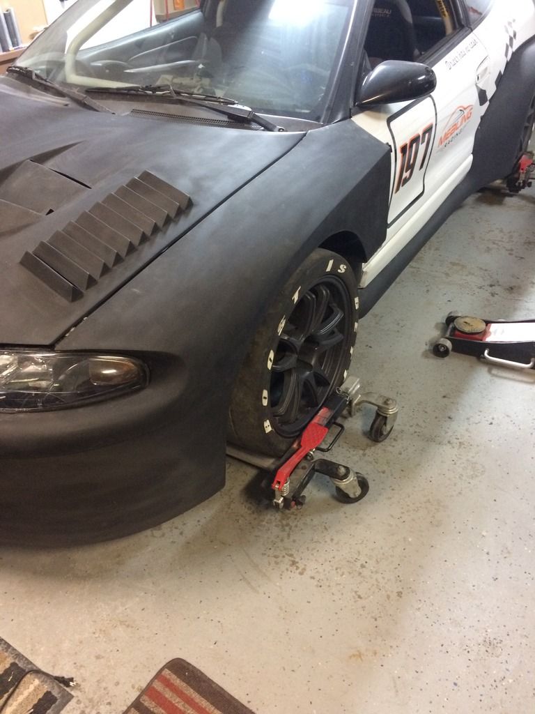

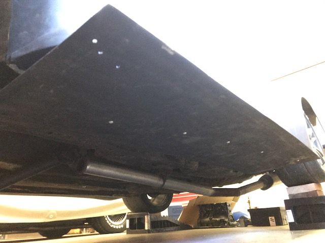

Ok...I am in the middle of moving so progress has been a bit slow. BUT i have made some progress. The kit is fitting really quite well considering it was the first one out of the moulds. Ill just let the pictures do the talking! PS....follow me on facebook and instagram at @mealing.racing....i update that much more frequently as you can imagine.
With the side skirts just propped up to see the look and fitment. These will take a bit of custom work to mount.
Bumper trimmed to fit the intercooler and just hanging from the middle. It fits amazing. The hood has no latch or pins on it yet so it is stitting up a touch. It will take a little adjustment on the nose of it to match the profile of the bumper perfectly but nothing crazy. You till notice the rear wheel is quite a ways inboard. In that picture it is sitting 3 inches in with Andrew designing it around 2 inches for the best aerodynamics. He ran his at about 1.5 to find the happy medium between looks and performance. I currently have the wheel sitting at 1.75 inches but that is not shown in this picture.
The fitment is awesome as far as I am concerned...not show car good but easily going to work for a race car.
Cant wait to get the side splitters and front splitter mounted.

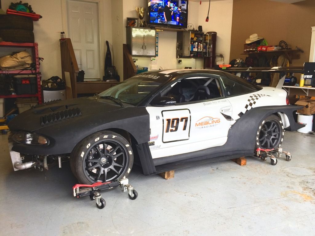

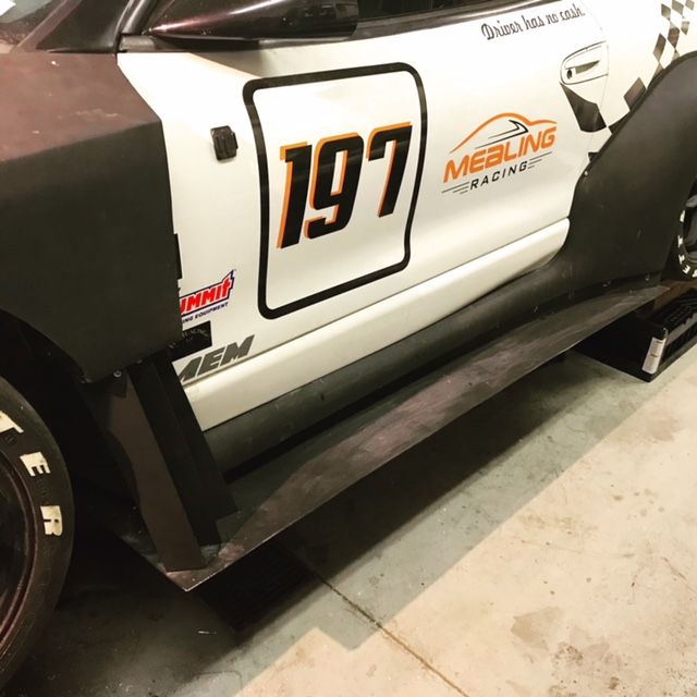

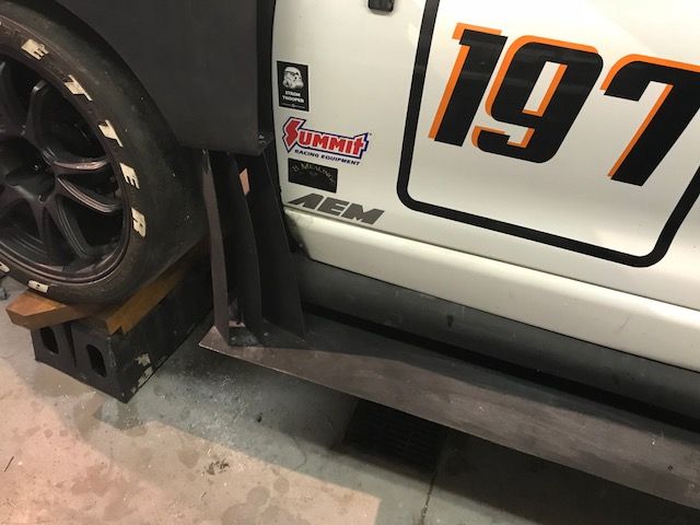

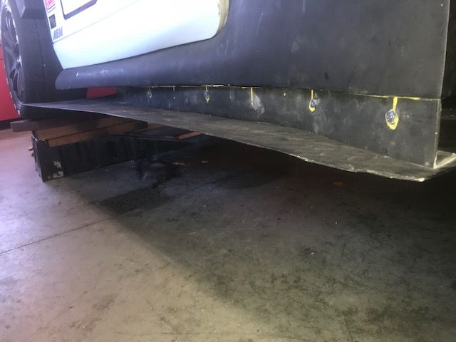

Got the side splitter on the drivers side properly mounted up!
Louvers are riveted at the top and bolted with m6 rivnuts at the bottom.
Side splitter goes about 18-24 inches(varies along its length) in. Hex bolts will be changed out for some nice smooth button head allens...but for some bloody reason they are proving a bit hard to get. GRRRRRRRRRRR
Not a great pic but you get the idea!
Will be working on getting the passenger side sorted out this weekend and then the front splitter and rear diffuser. It isnt a massive amount of work but juggling work and kids and life makes it take awhile. Goal is to have it ready for the middle of april for a shakedown track day and then off the Knox Mountain Hill Climb on May 19-20th in Kelowna, BC, Canada!
