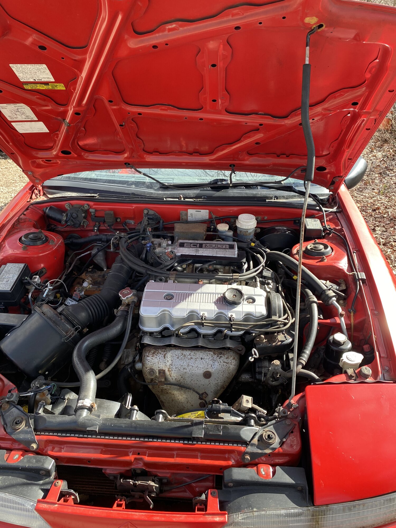

1991 Plymouth Laser Base
1.8 5spd

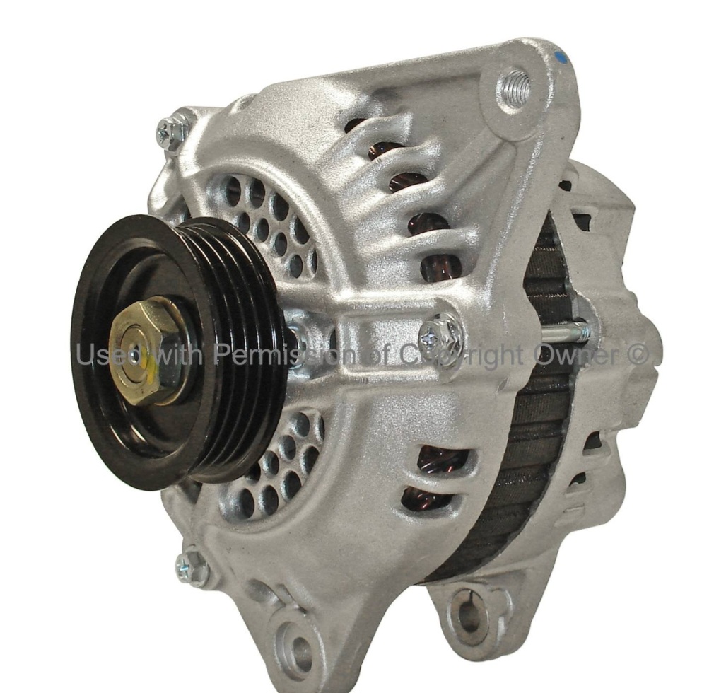

@BLACK'98DSM , do you know if the 1.8 shares the same alternator? THANKS!
I'm not sure if he will know, but I consider him a very good source, especially on NA stuff. There are other great members, but they're not as active currently. Chime in guys! :)

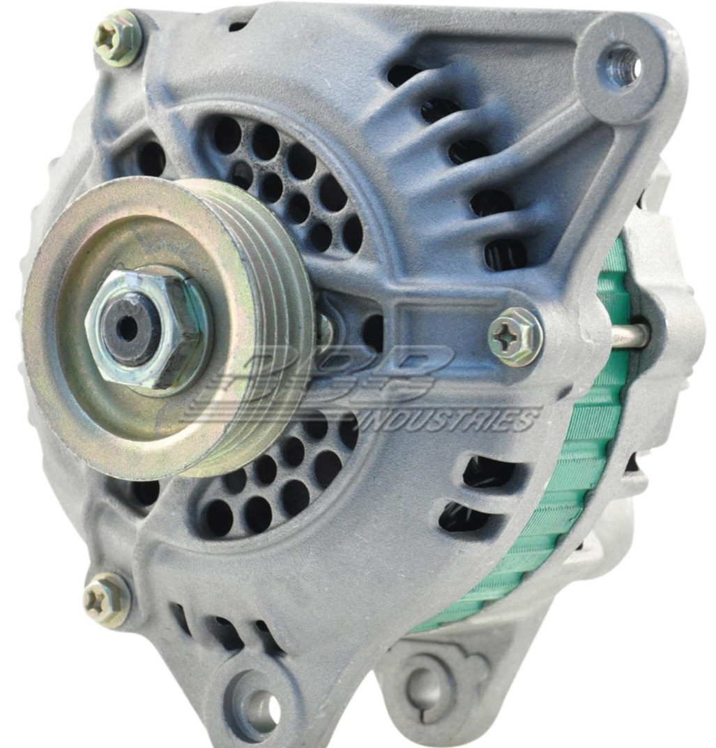

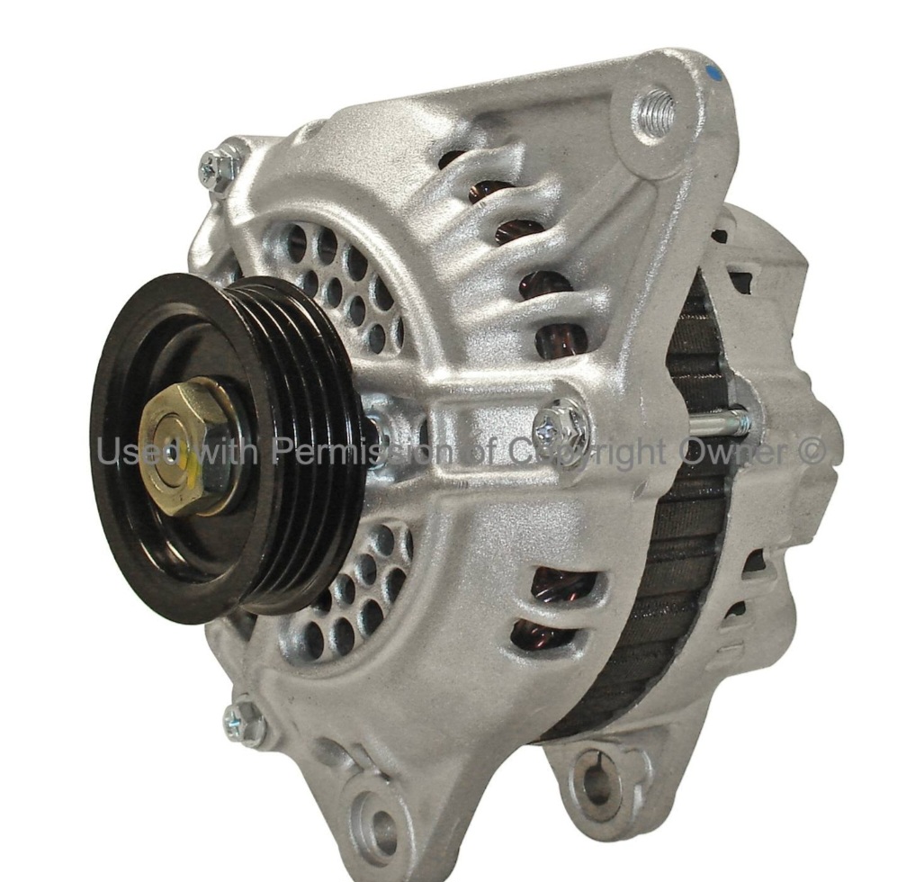

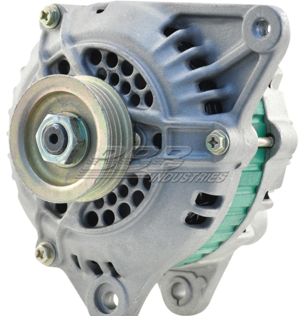

I actually looked into this once fortunately. I wanted to buy a non accessorized 4g63 to swap in my 92 GS 4g37. The alternator itself is likely interchangeable while the pulley should probably be swapped. The 4g63 has a larger diameter pulley, likely due to a difference in harmonic balancer diameter. I had a 4g37 and 4g63NA alternator laid next time each other once and I think they'll interchange but I didn't bolt them up. I'm also noticing that the OE alternators were 65A for the 4g37 and 75A for the 4g63. But that shouldn't be a problem since you can buy the 75A and 90A for each.
4g63:
4g37:
Thanks so much Solomon! :thumb:
Do you have any idea if the connectors for the alternator are the same on this 1.8L motors alternator? I can't imagine changing plugs just because of the difference in motors myself but I don't know.

Well I appreciate you getting some other members involved, you guys seem so helpful and welcoming over here! Not sure if you guys have ever messed with any other vehicle platforms but the car enthusiast communities can really be hit and miss when it helpfulness😂
4g63:
4g37:
Thanks for the info, I’ve never had these parts in front of me so I really had no way of knowing all that😂

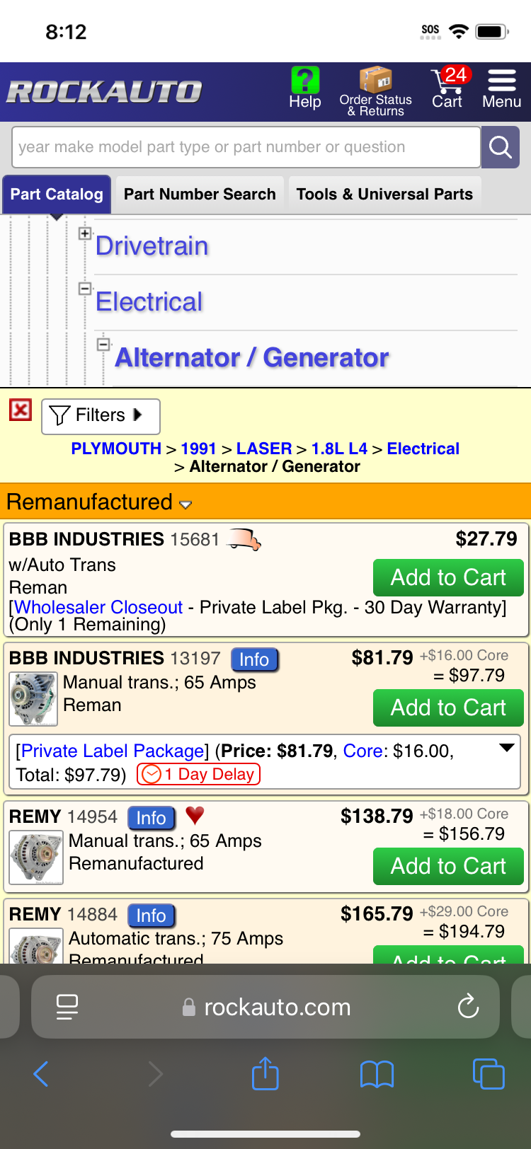

So on RockAuto the 1.8 has the option for a 65amp for manual transmission cars and a 75amp for automatic transmission cars. Assuming they are the same other than the output I’ll probably just pick up one of these replacements for an auto. Specifically this nice little $27.79 guy in my screenshot😂😂 I know it’s a gamble but I’m gonna cross my fingers and order that one sometime next week or the week after.

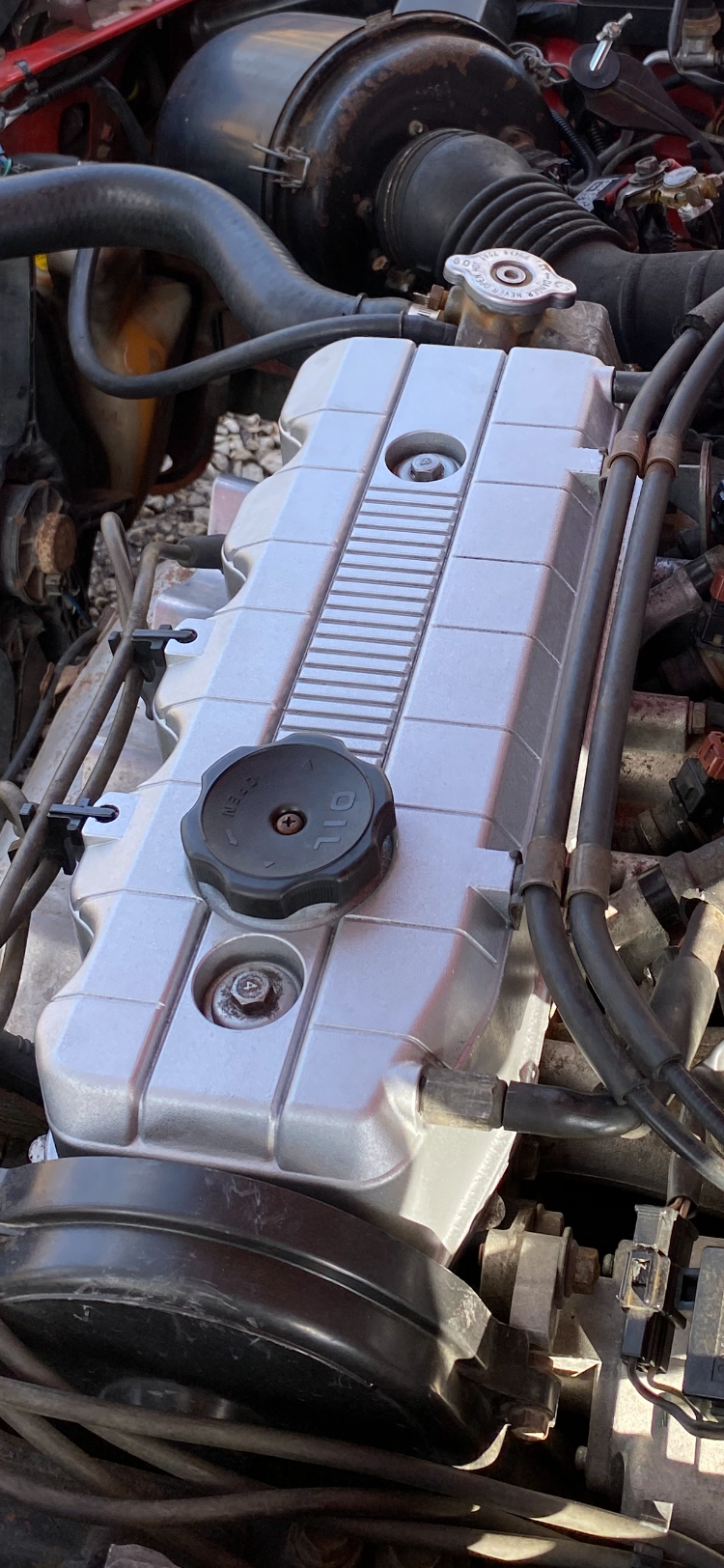

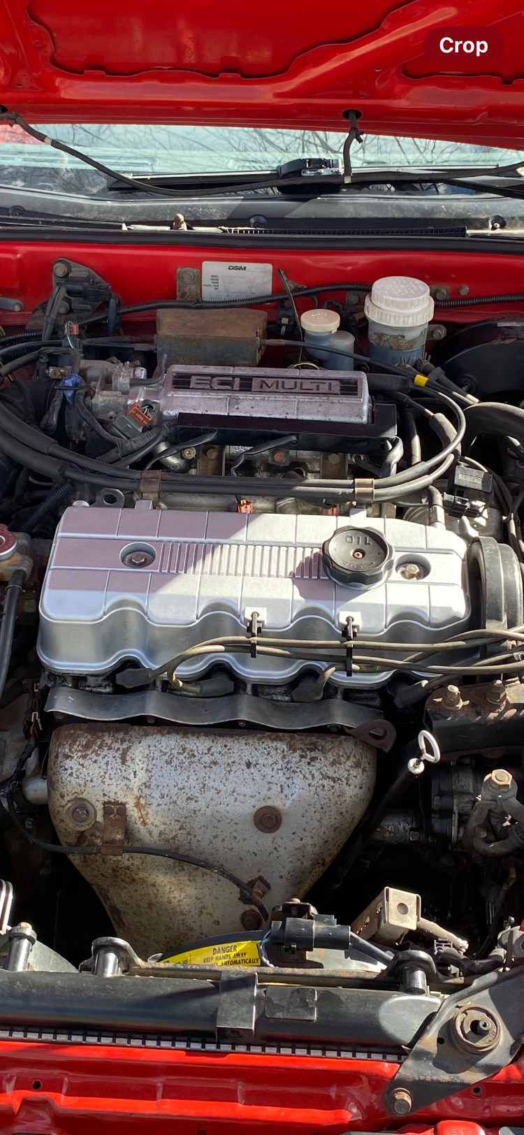

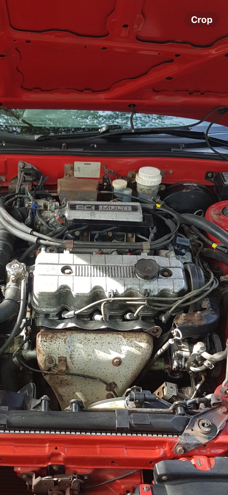

Also I got bored yesterday and had weather in the 60s (?) so I decided to clean and paint my valve cover. Very happy with the results, the paint was some old metallic silver engine enamel I got on sale for $1 can, so I’m pretty surprised it turned out so well. There’s some mistakes in person in a few spots but overall it almost looks factory😁
I’d suggest taking care of that exhaust heat shield next. It will help clean things up and look much better under there! :thumb:
Yeah, I plan on finding some black exhaust paint for that. Should clean it up real nicely👌

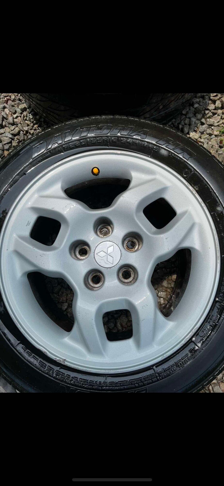

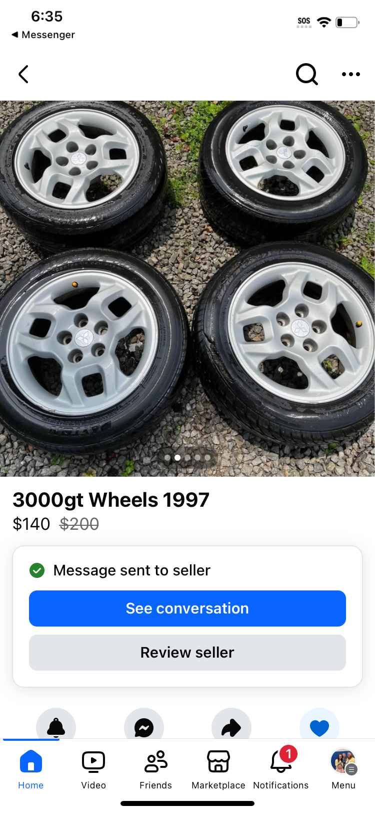

Found some wheels today that I’m hoping to get in the next few weeks, they appear to be 16x8 3000gt wheels and they’re going to look amazing imo. 😁

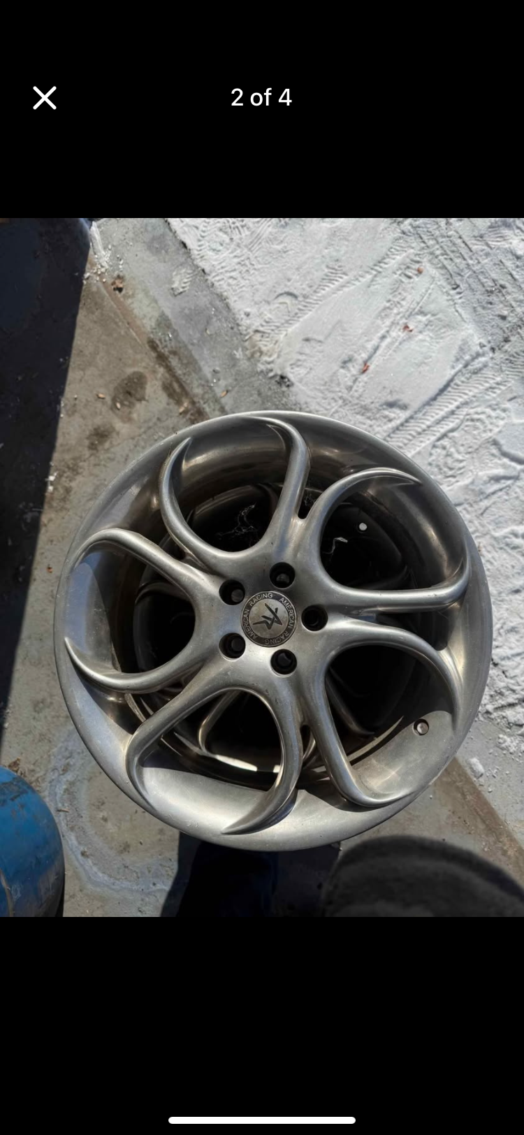

I’ll be ordering parts tonight, and tomorrow im going to possibly pick up a set of wheels for it! I know they aren’t everyone’s cup of tea, but they really feel like one of those “period correct” things and im really wanting to get that 90s look👌
American Racing Snipers: 17x7.5
Going to order some cheap 205/50r17s for them and I think they will look mint once cleaned up!
How do those wheels compare in weight to the ones you have now? I would go for the lightest wheel possible. That will bring performance gains to the car without engine mods 😃
