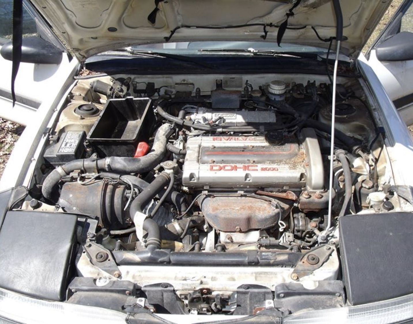

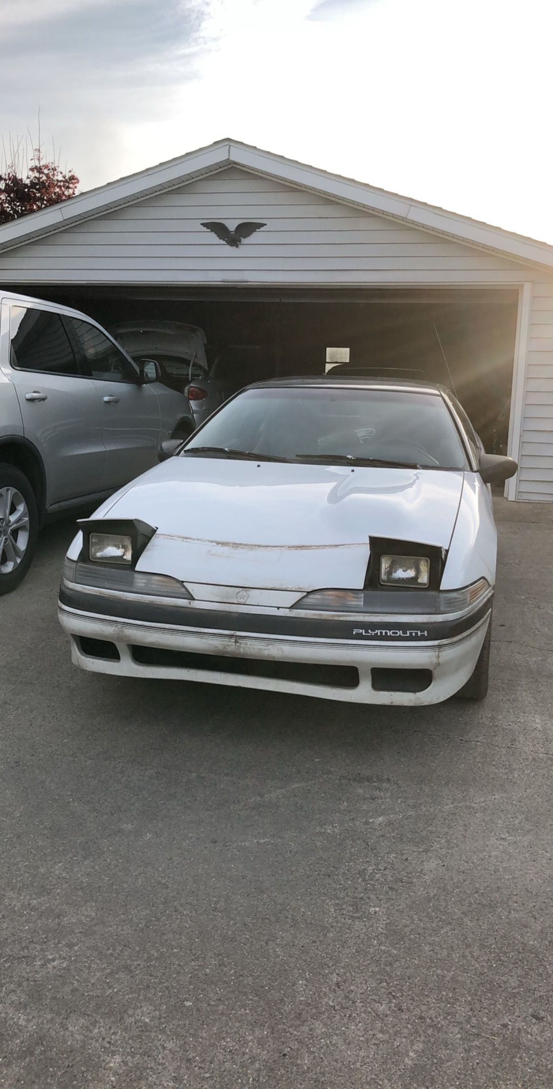

1991 Plymouth Laser RS

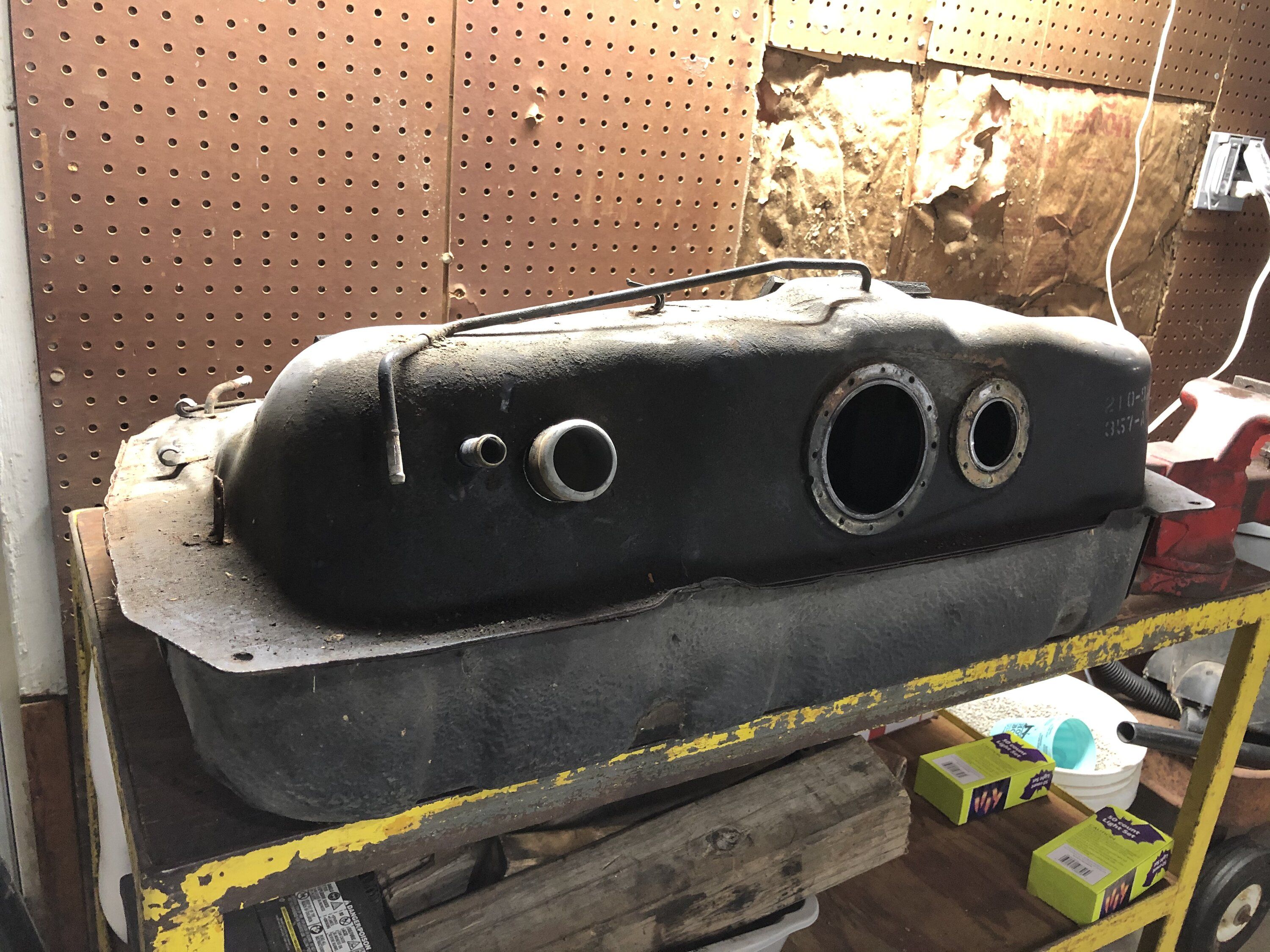

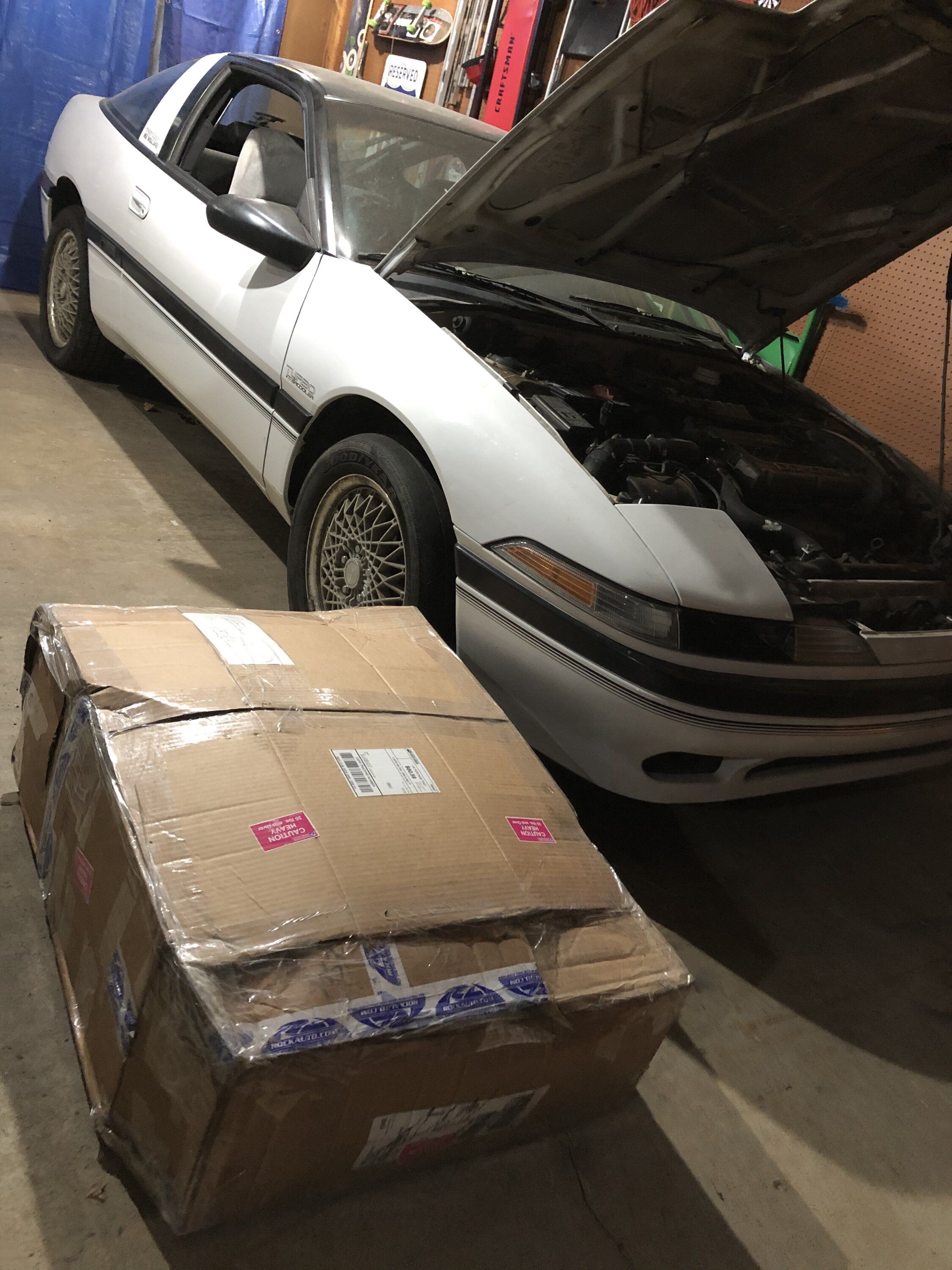

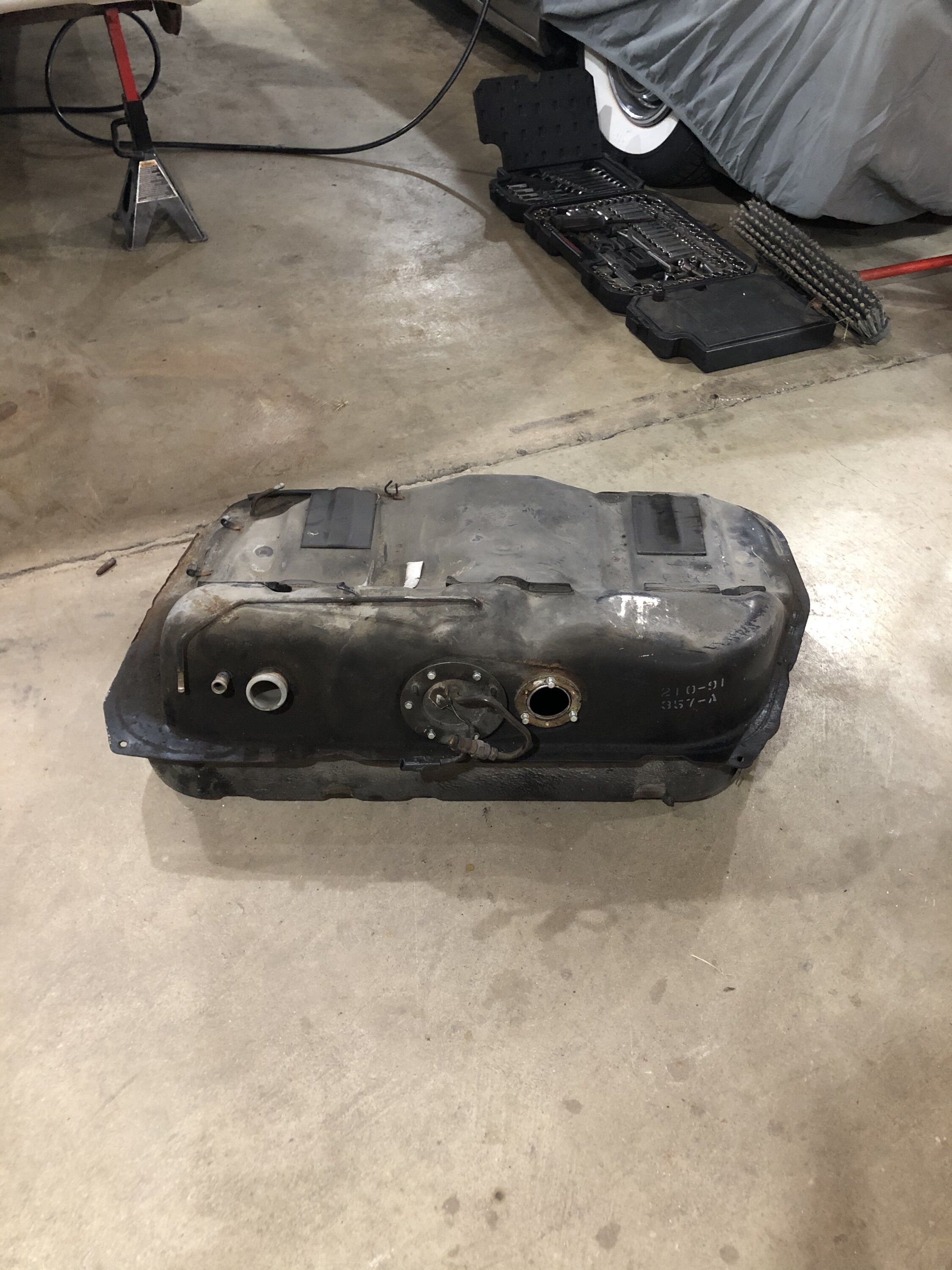

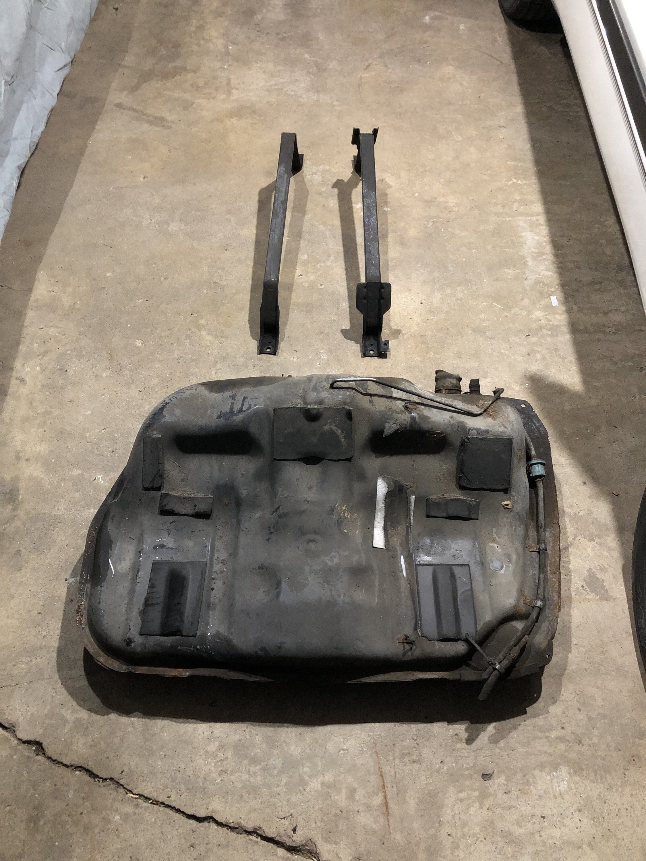

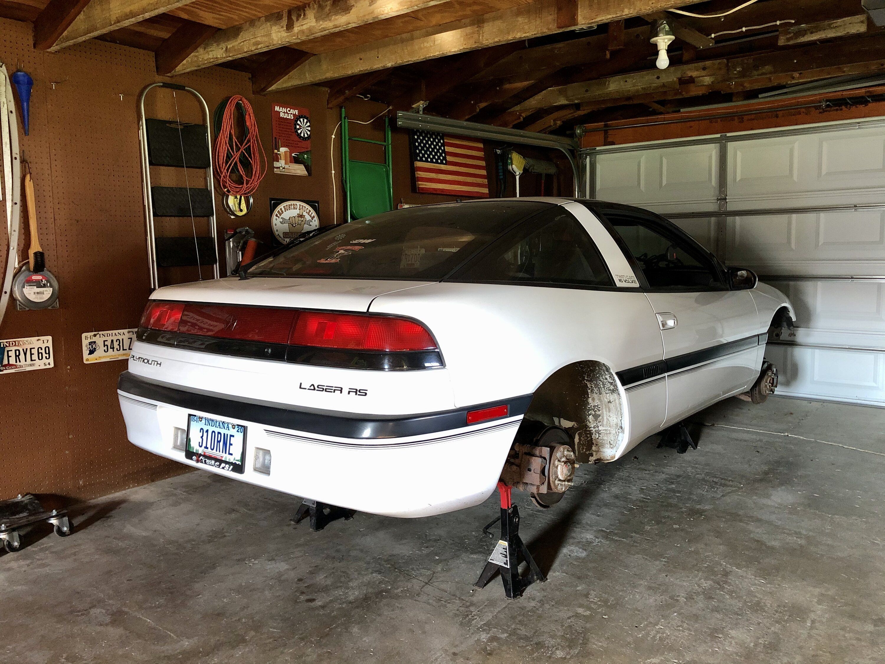

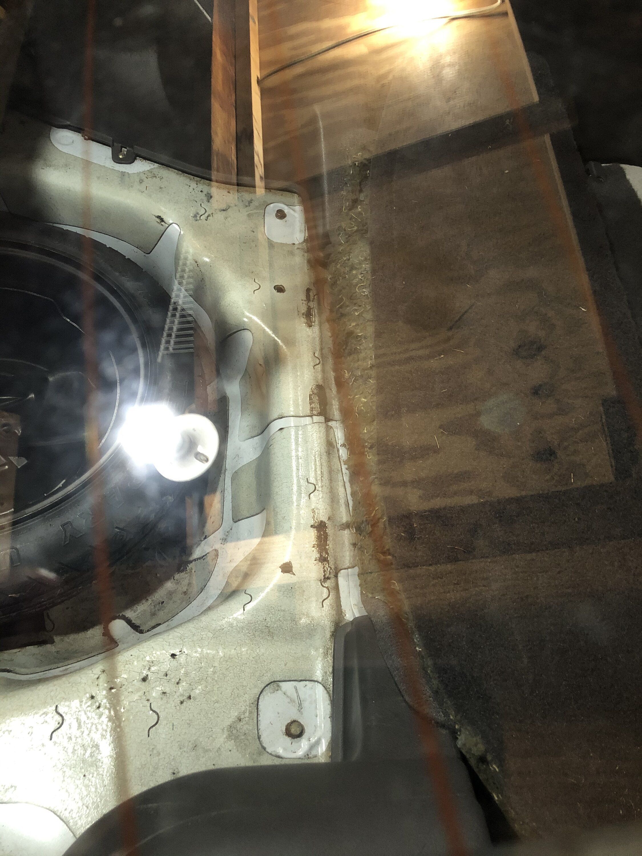

10/16/19 - Used fuel tank & tank straps arrived

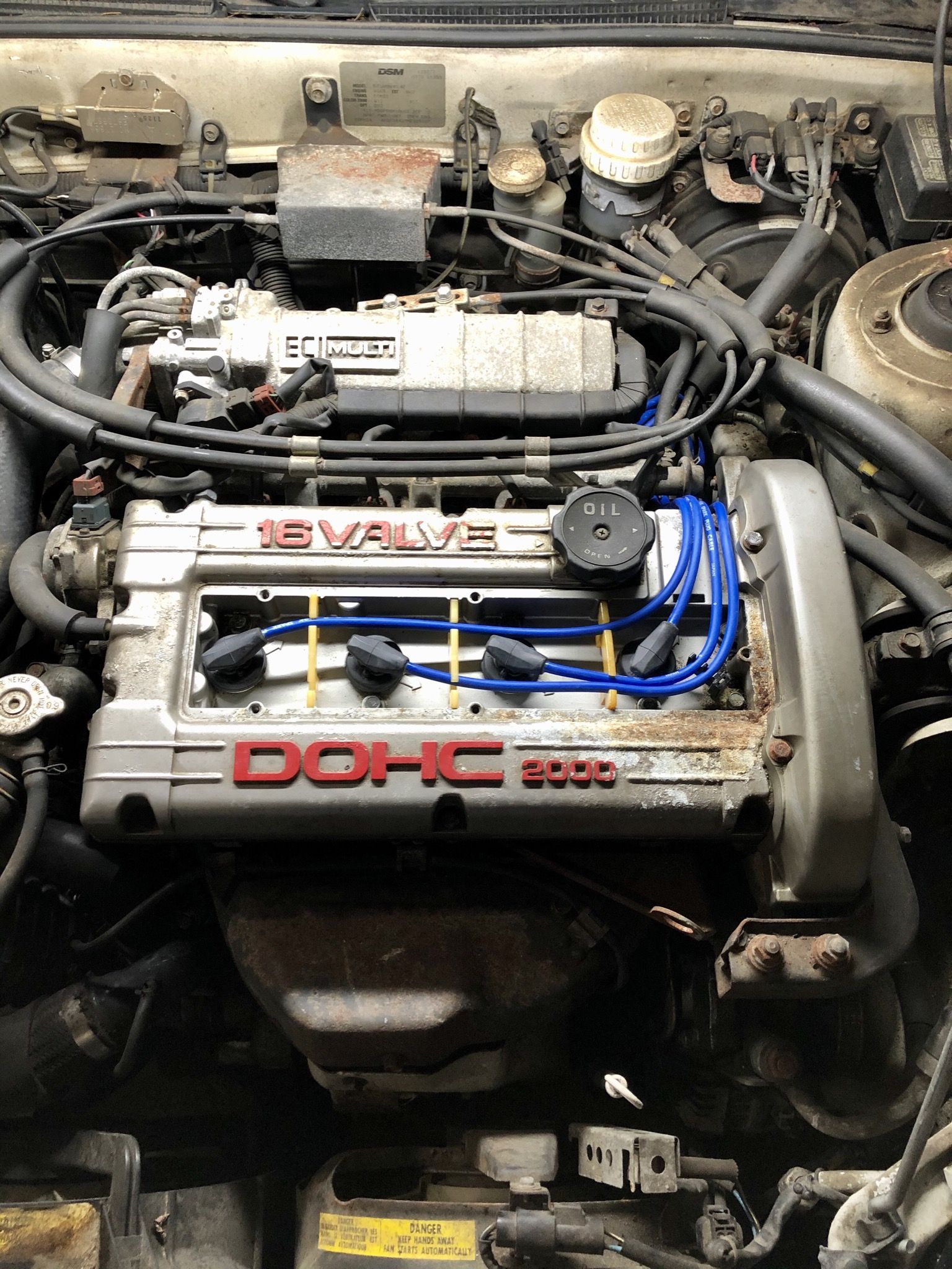

01/08/20 - New plug wires arrived

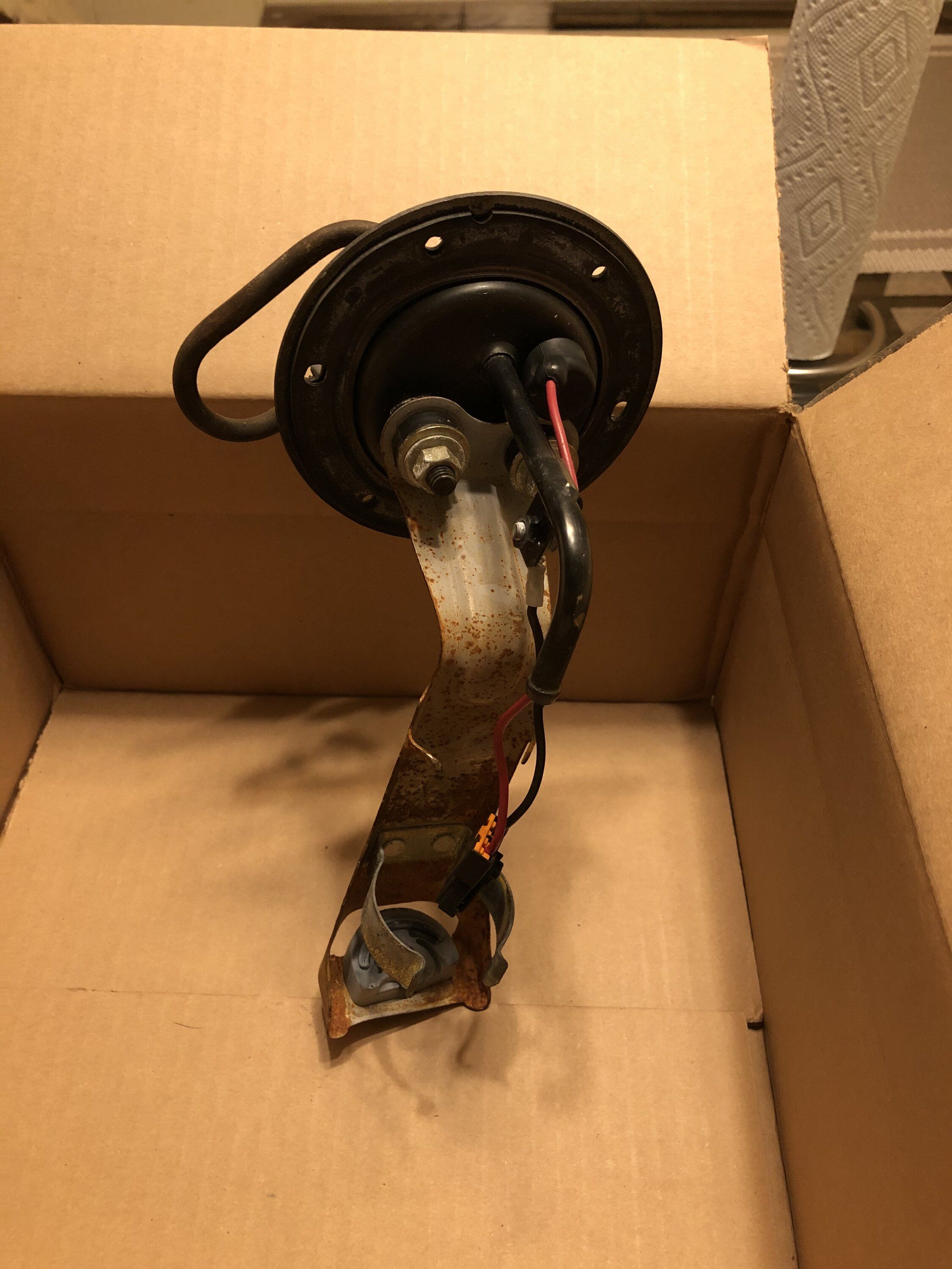

01/09/20 - Used sending unit arrived
01/10/20 - New 255lph fuel pump arrived
01/11/20 - Plugs, Wires, Fuel Filter Replaced
03/10/20 - New fuel level sensor arrived from Japan

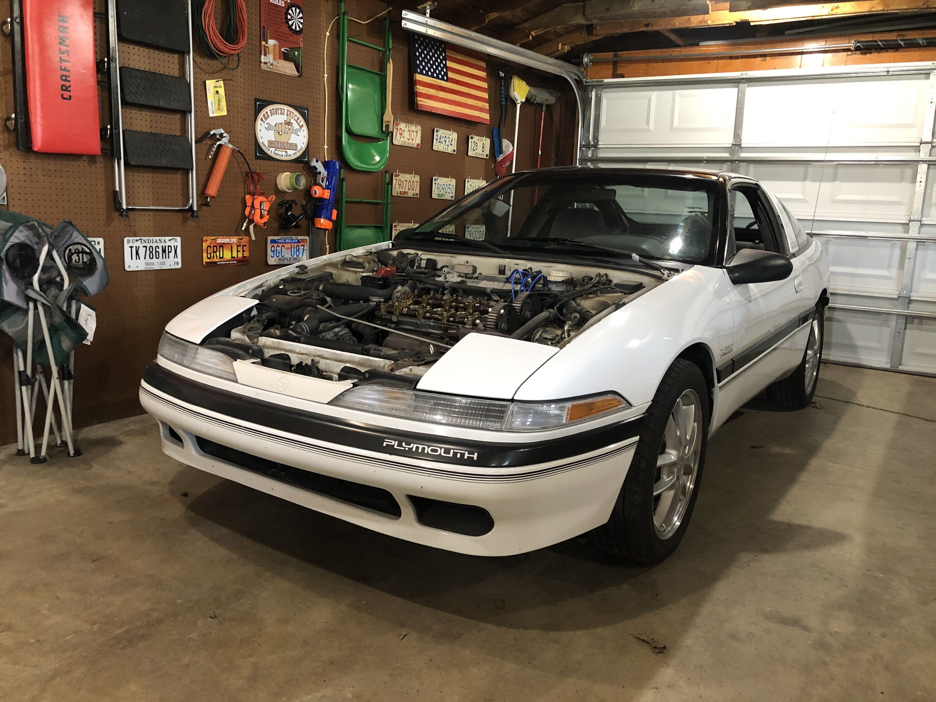

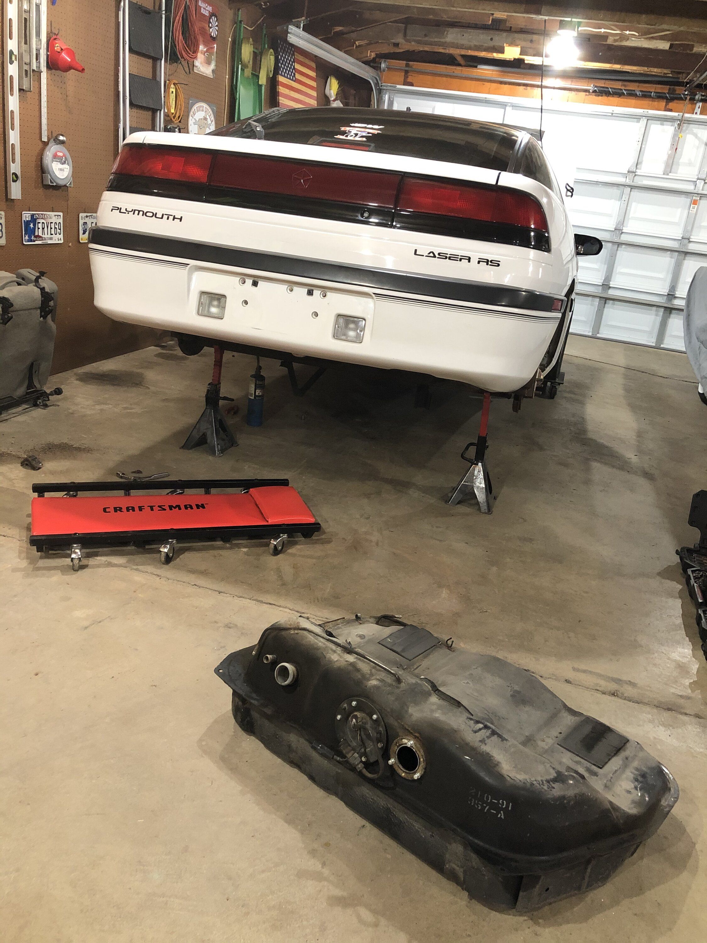

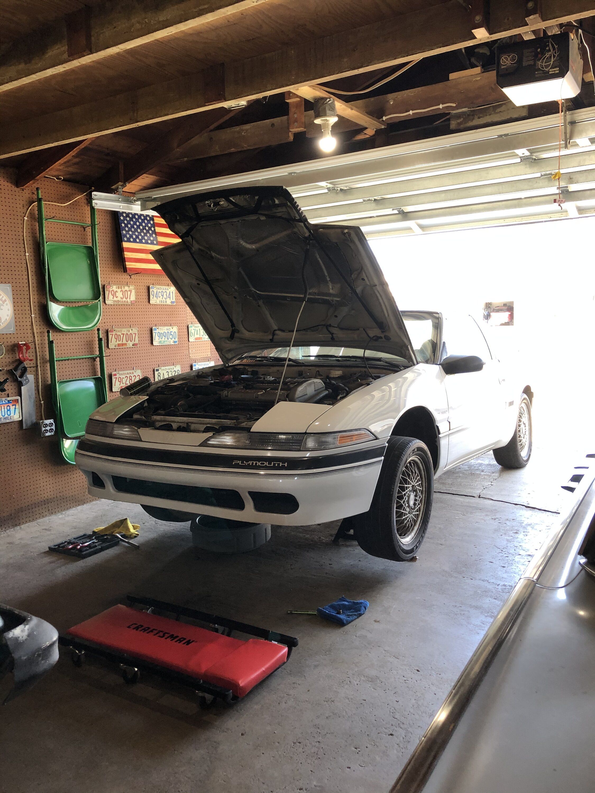

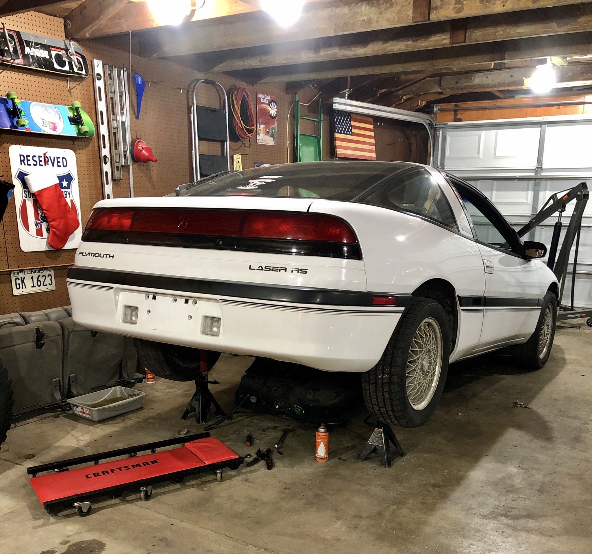

03/27/20 - Fuel tank swap and parts installation begins
03/28/20 - Tank install completed & first time running in months

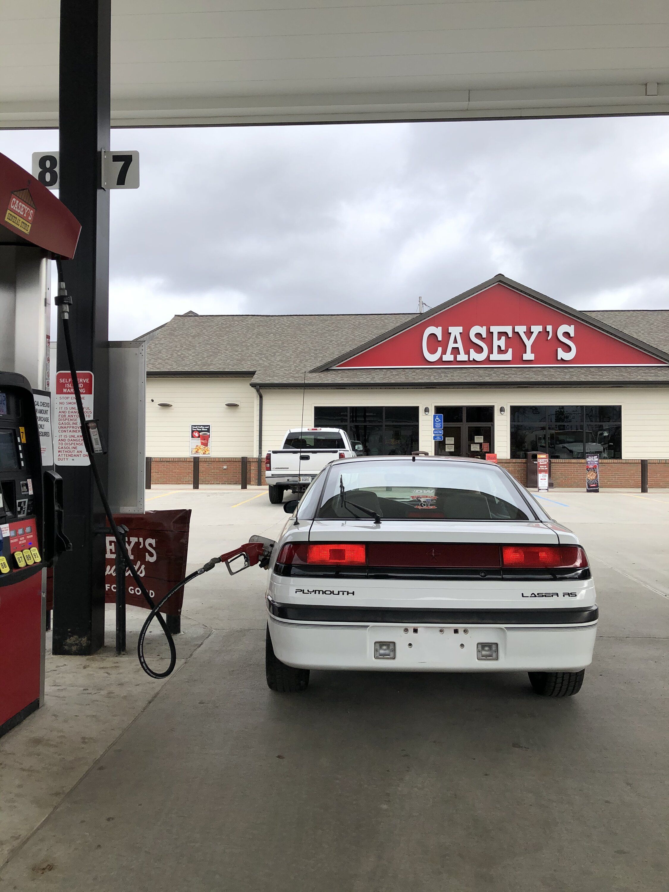

03/29/20 - First time ever driving the car further than down the street - First time at the gas station

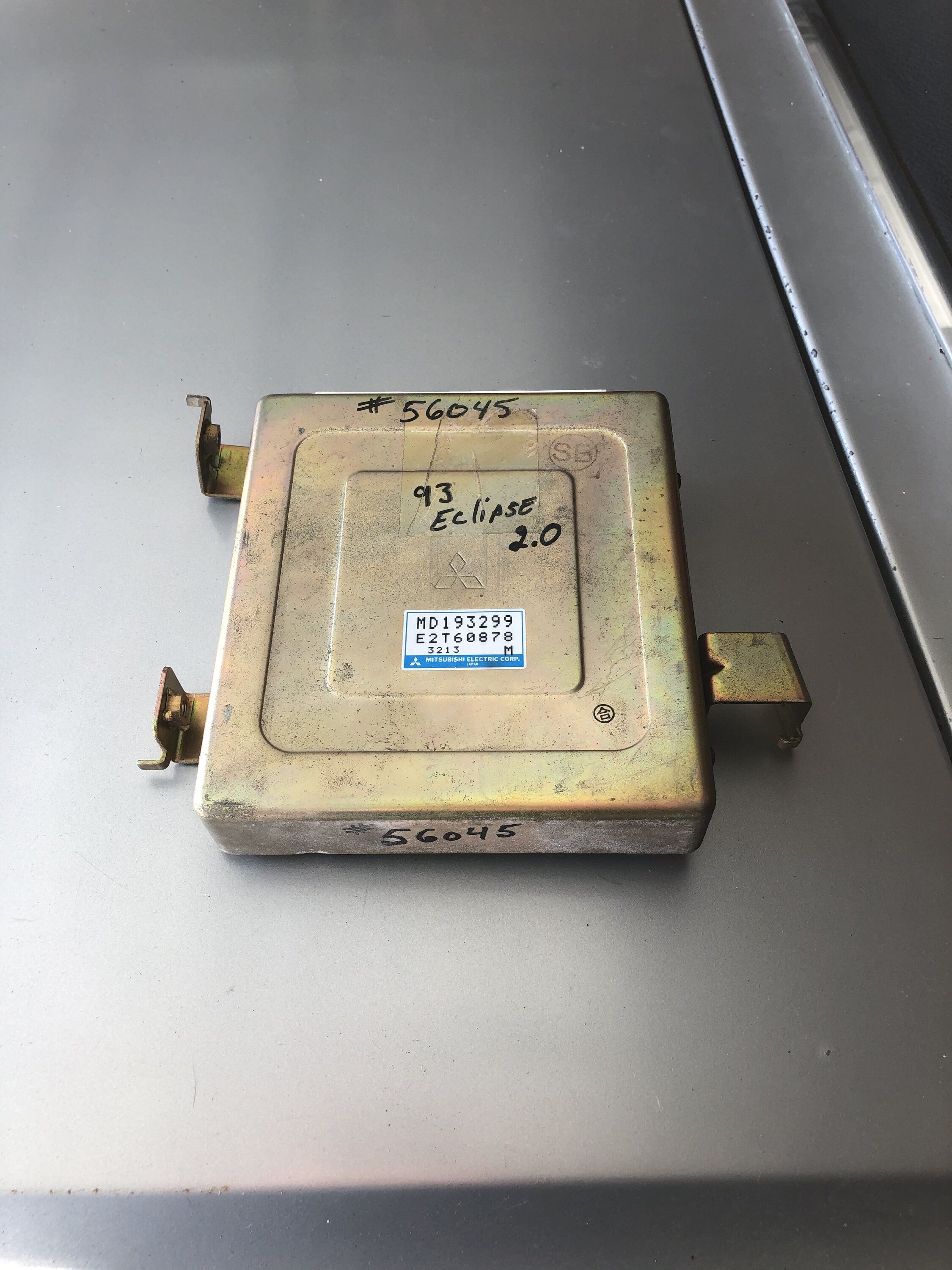

03/29/20 - After doing some testing and removing the ecu, found that the caps were leaking, and the ecu was bad

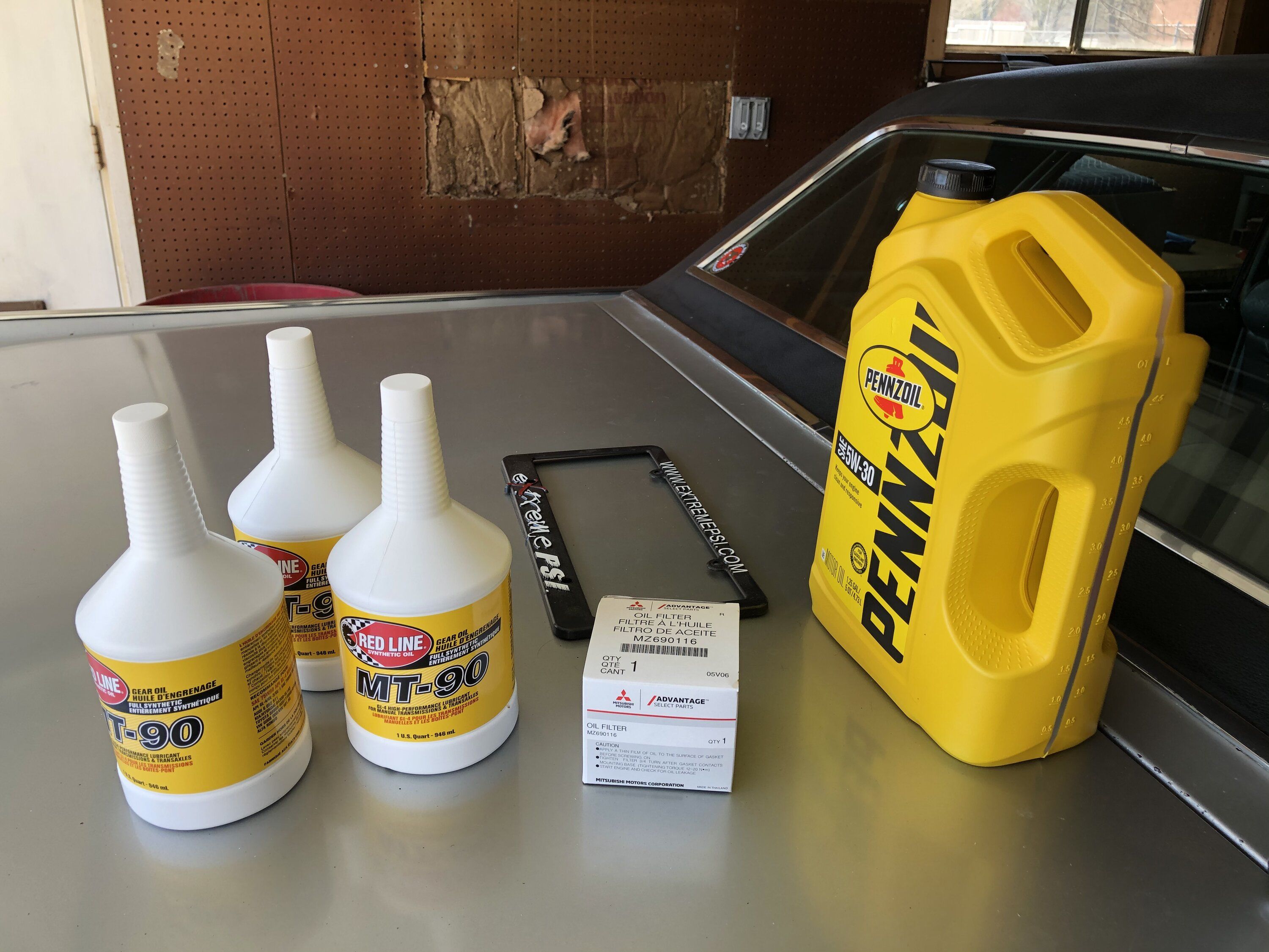

04/08/20 - Changed Engine Oil & Transmission Fluid

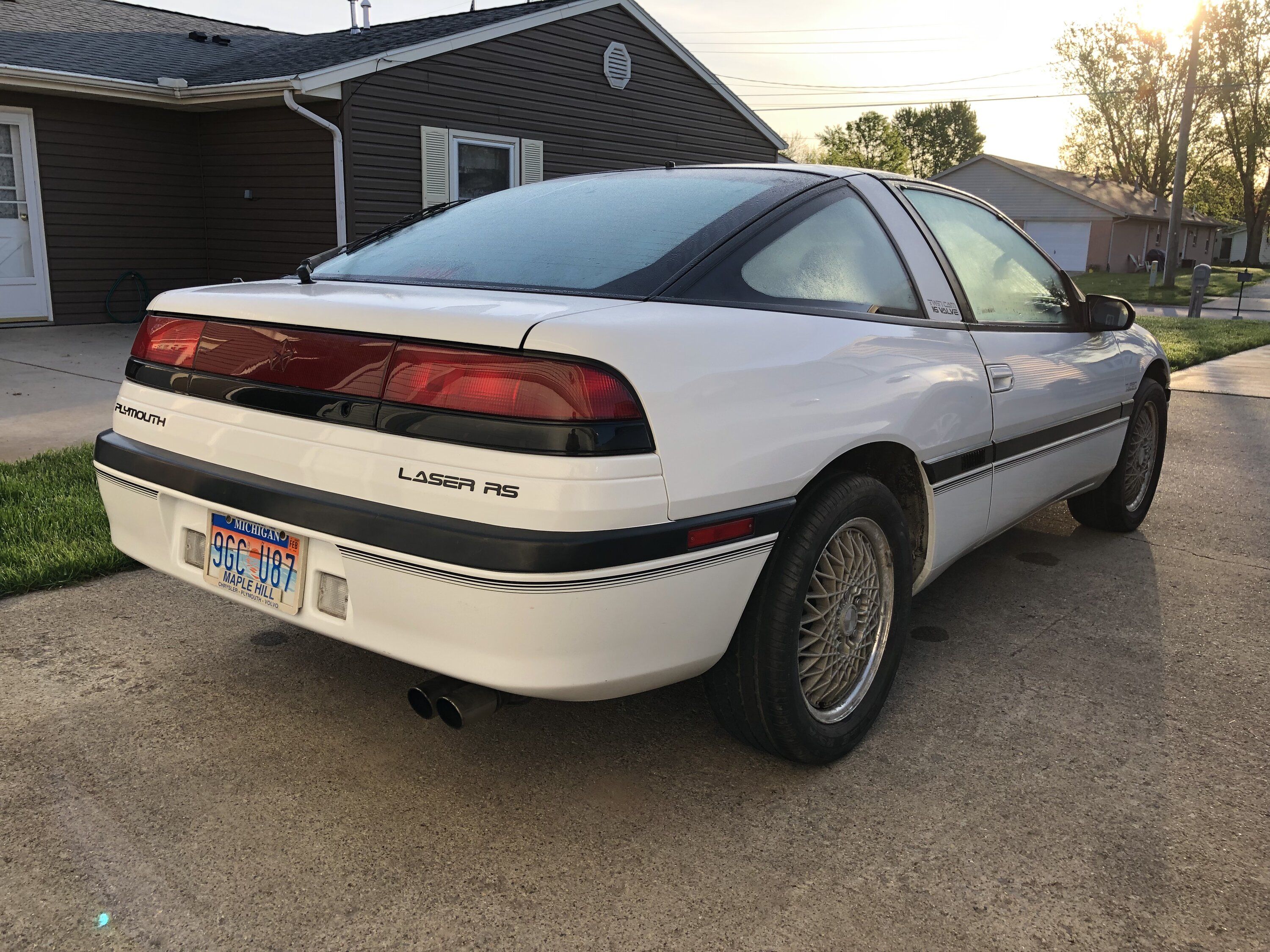

04/09/20 - Replacement ECU arrived & installed - First drive above 30mph

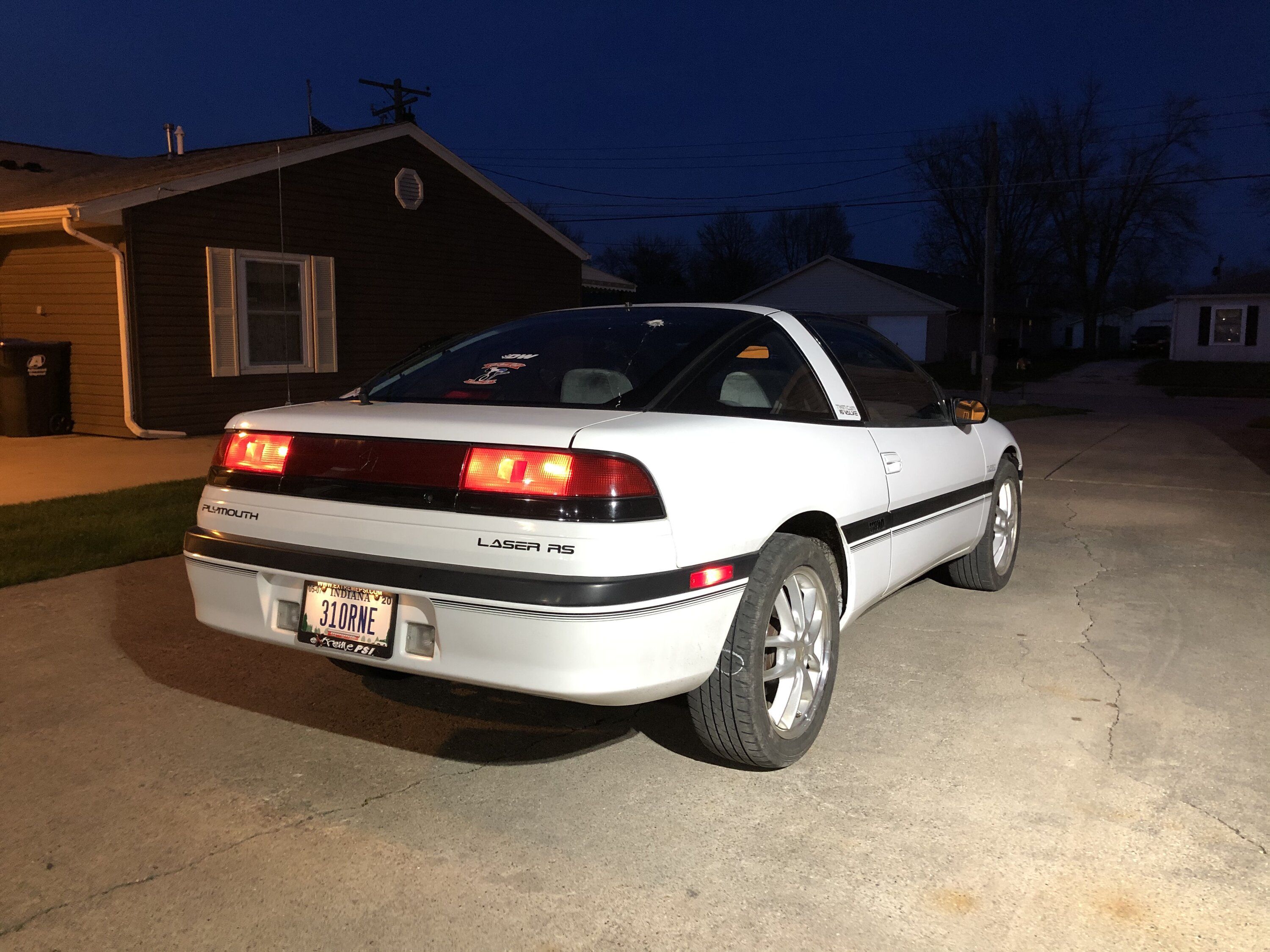

04/11/20 - First time driving the Laser to work

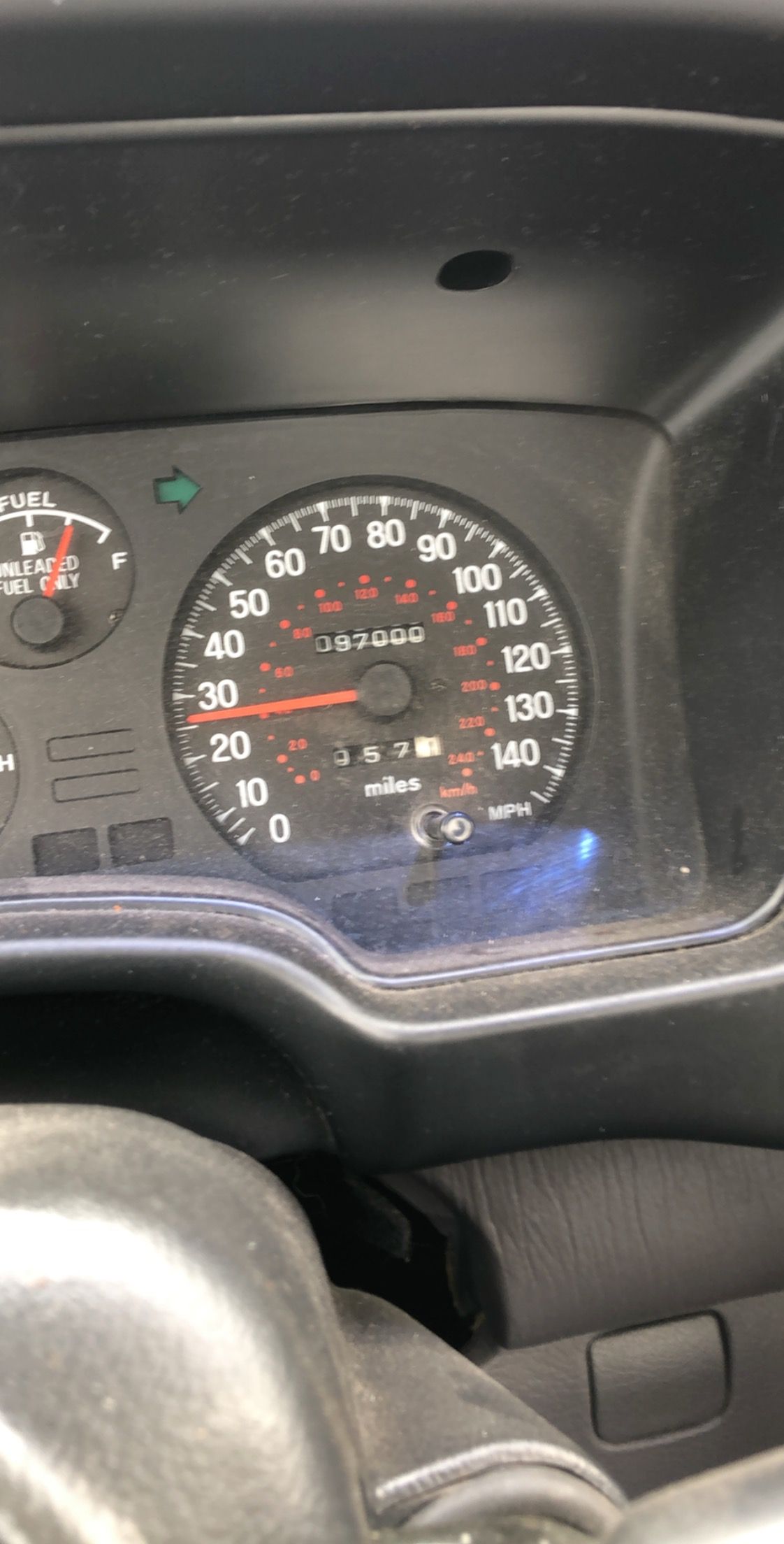

04/14/20 - Odometer hits 97,000 miles

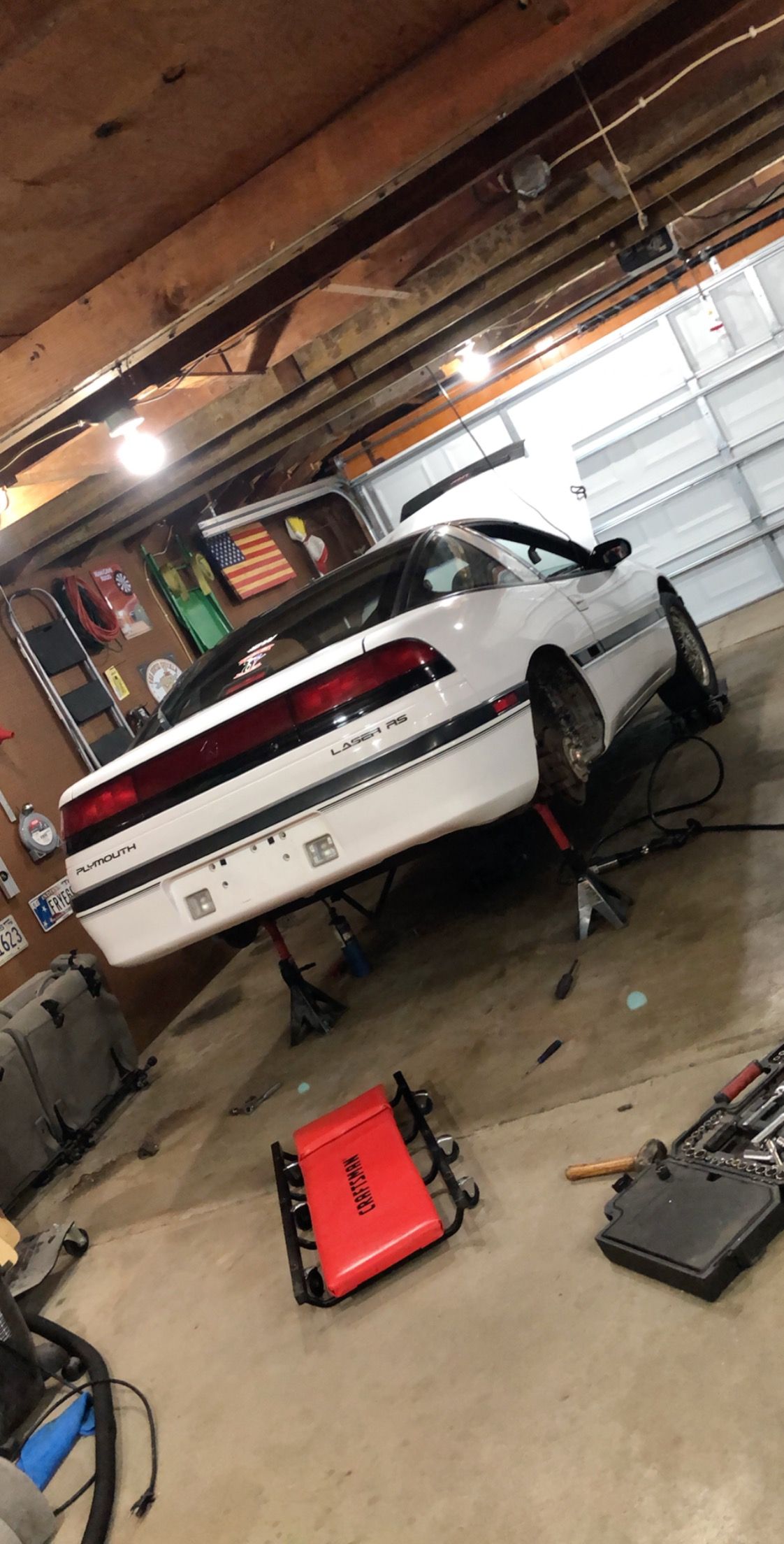

04/19/20 - First time weighing the car, 3,180lbs - 3/4 tank w/ me & 1 passenger

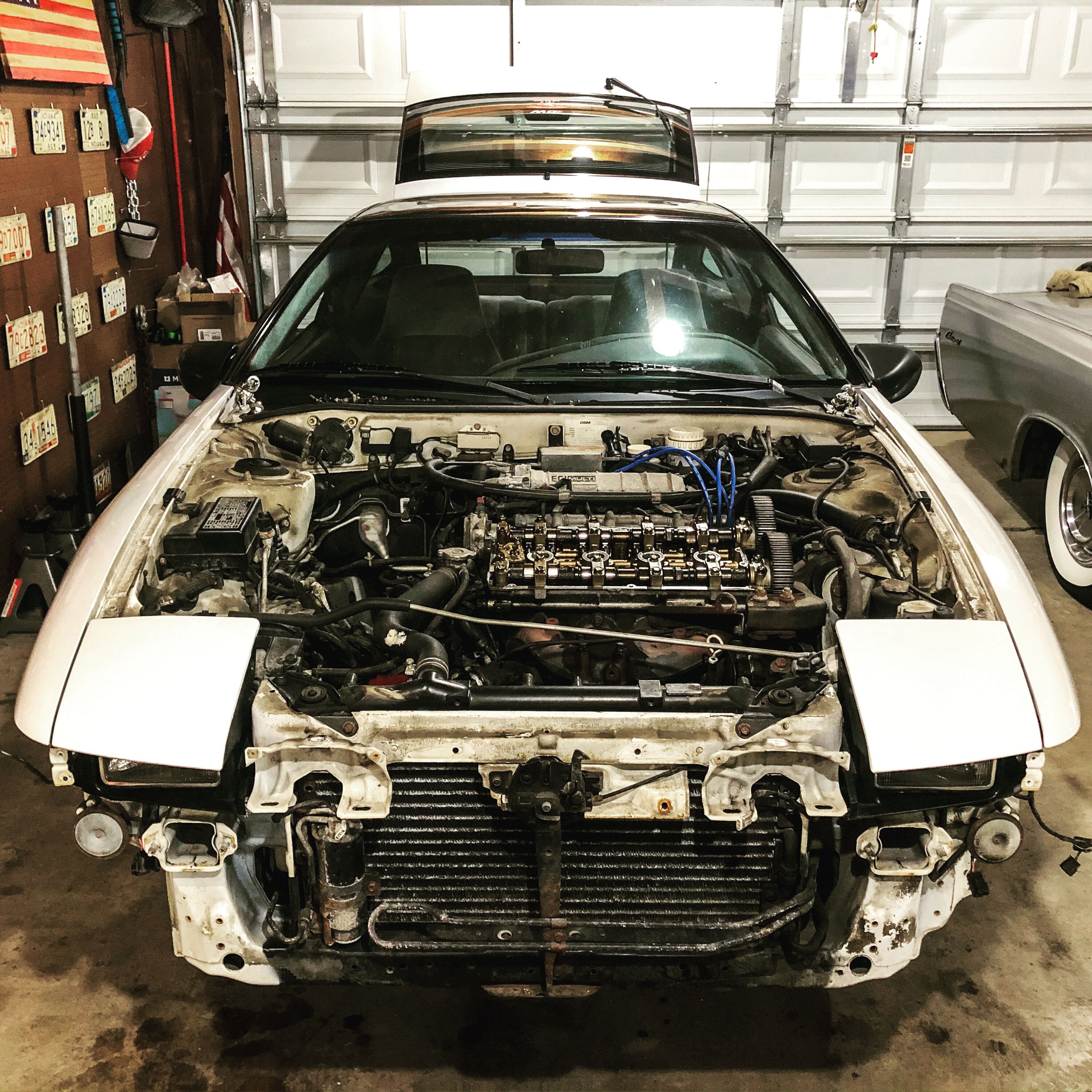

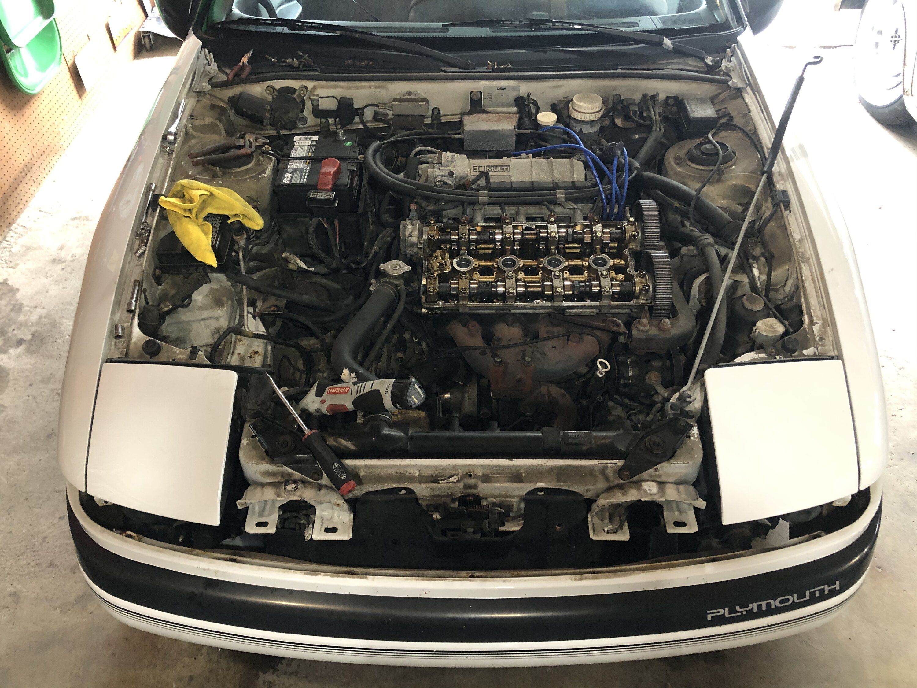

04/25/20 - Timing Belt Lets Go...

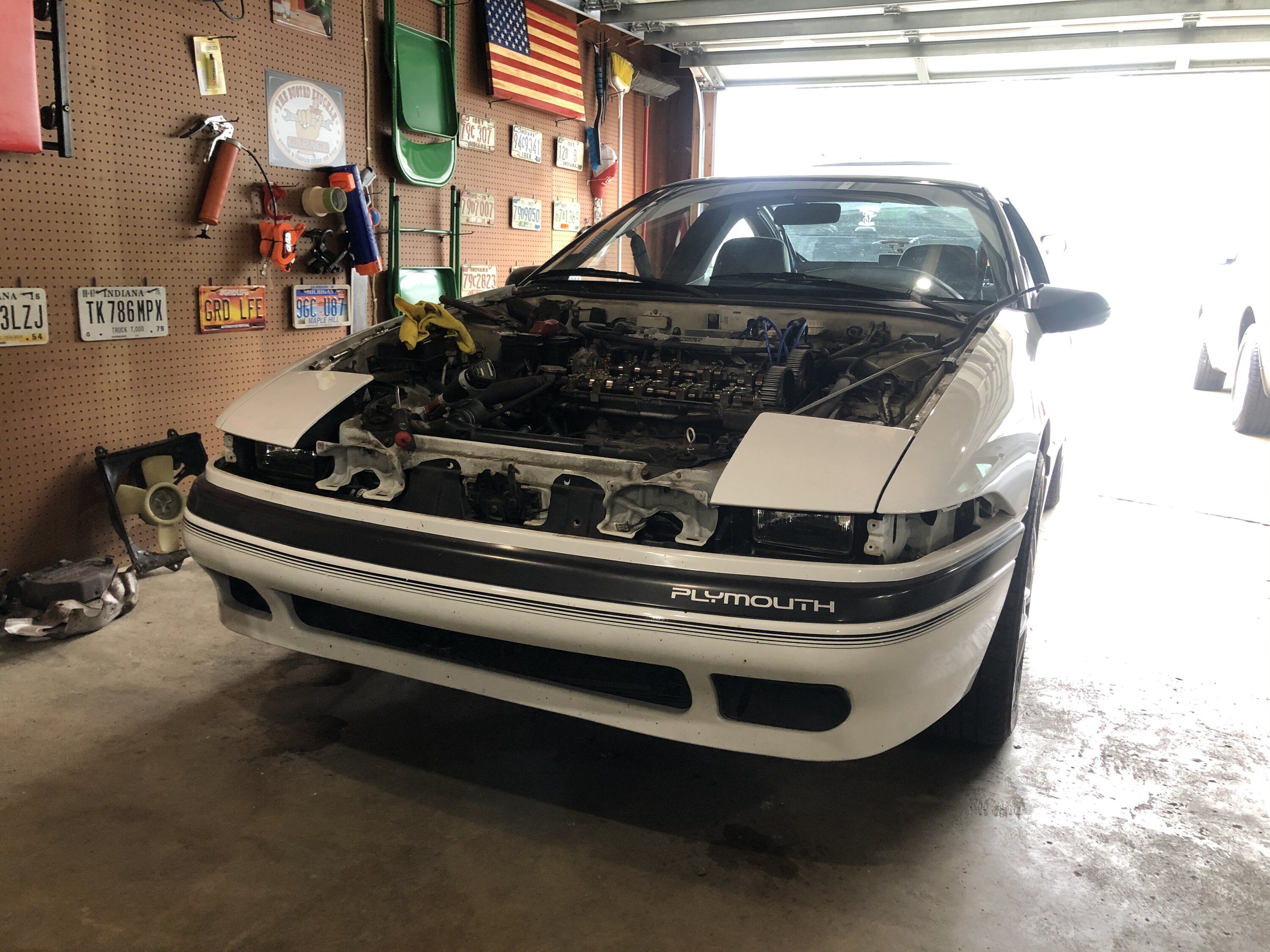

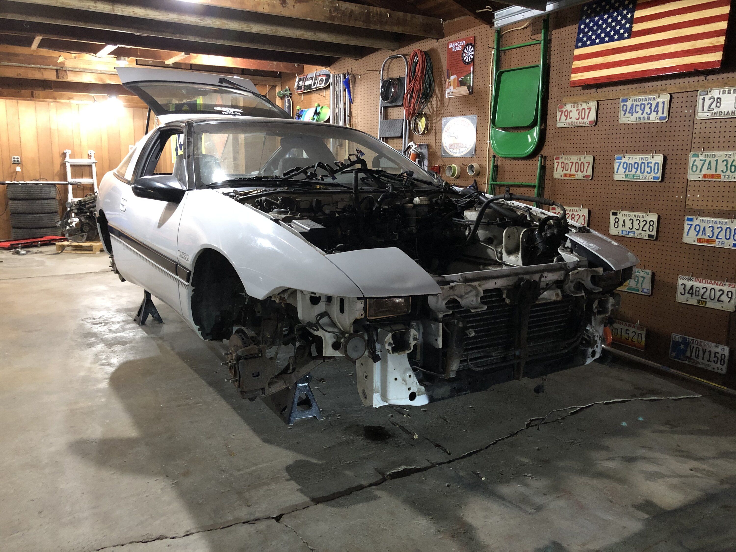

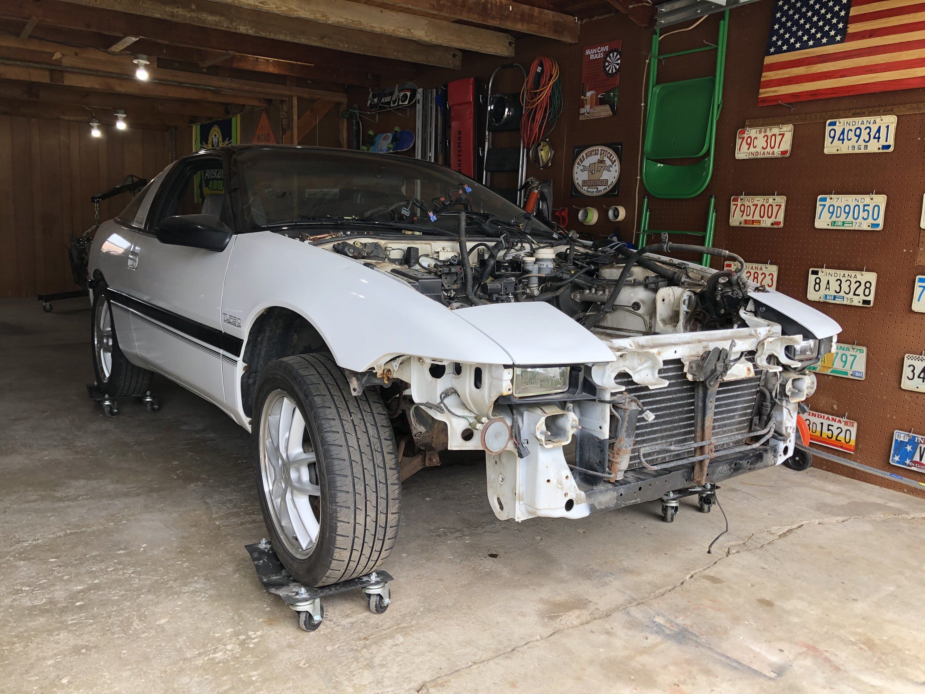

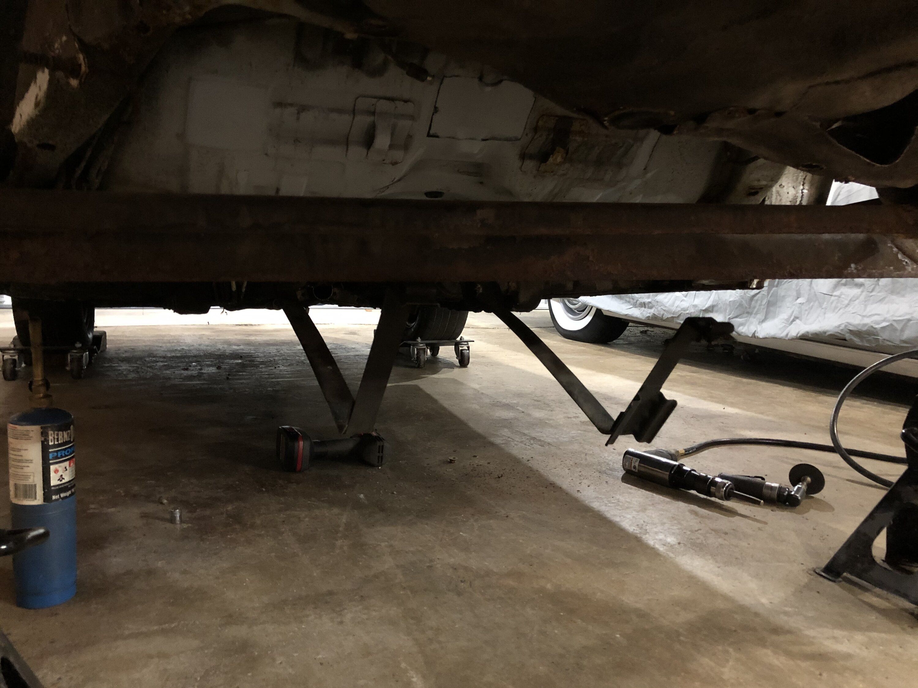

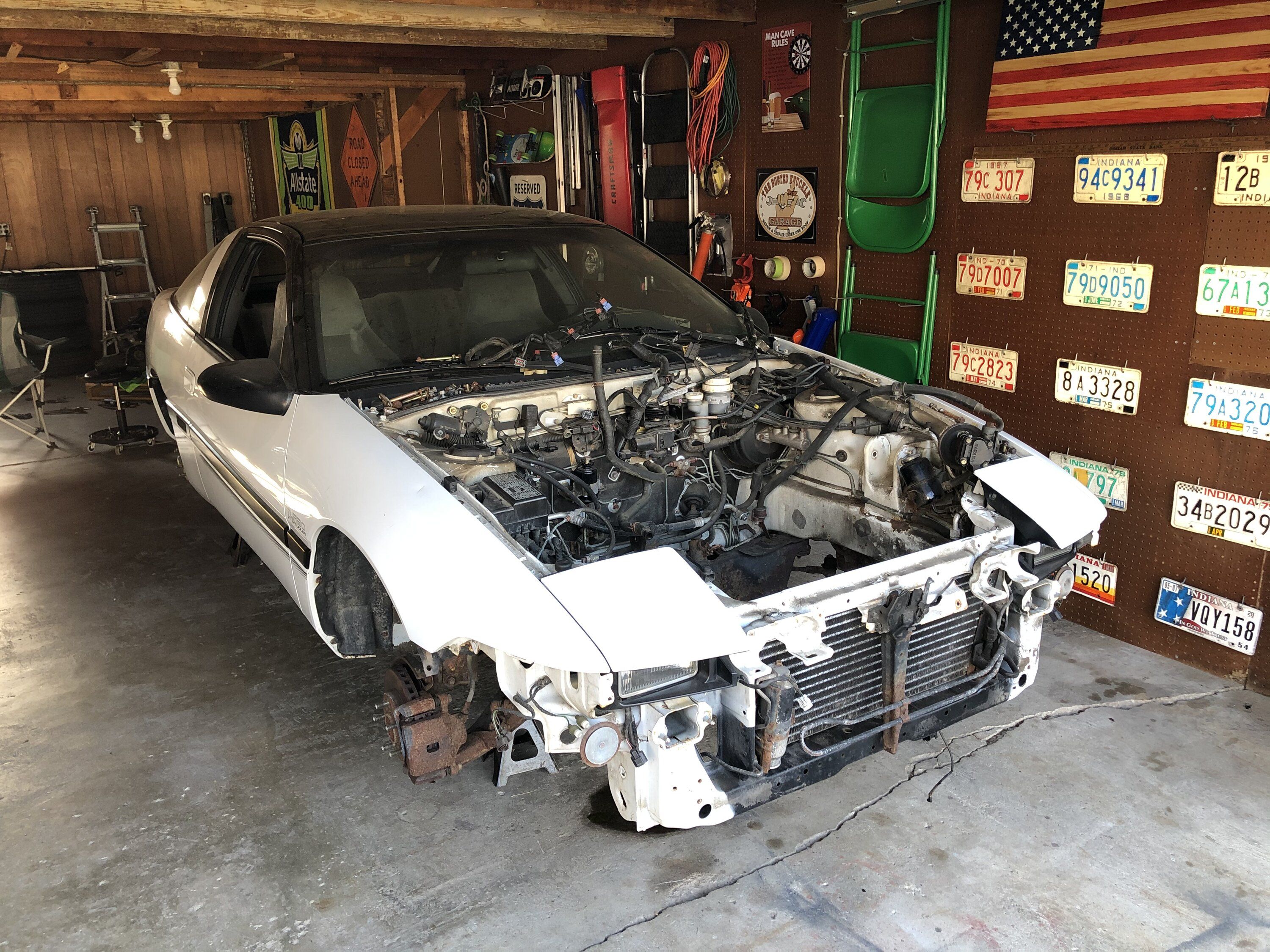

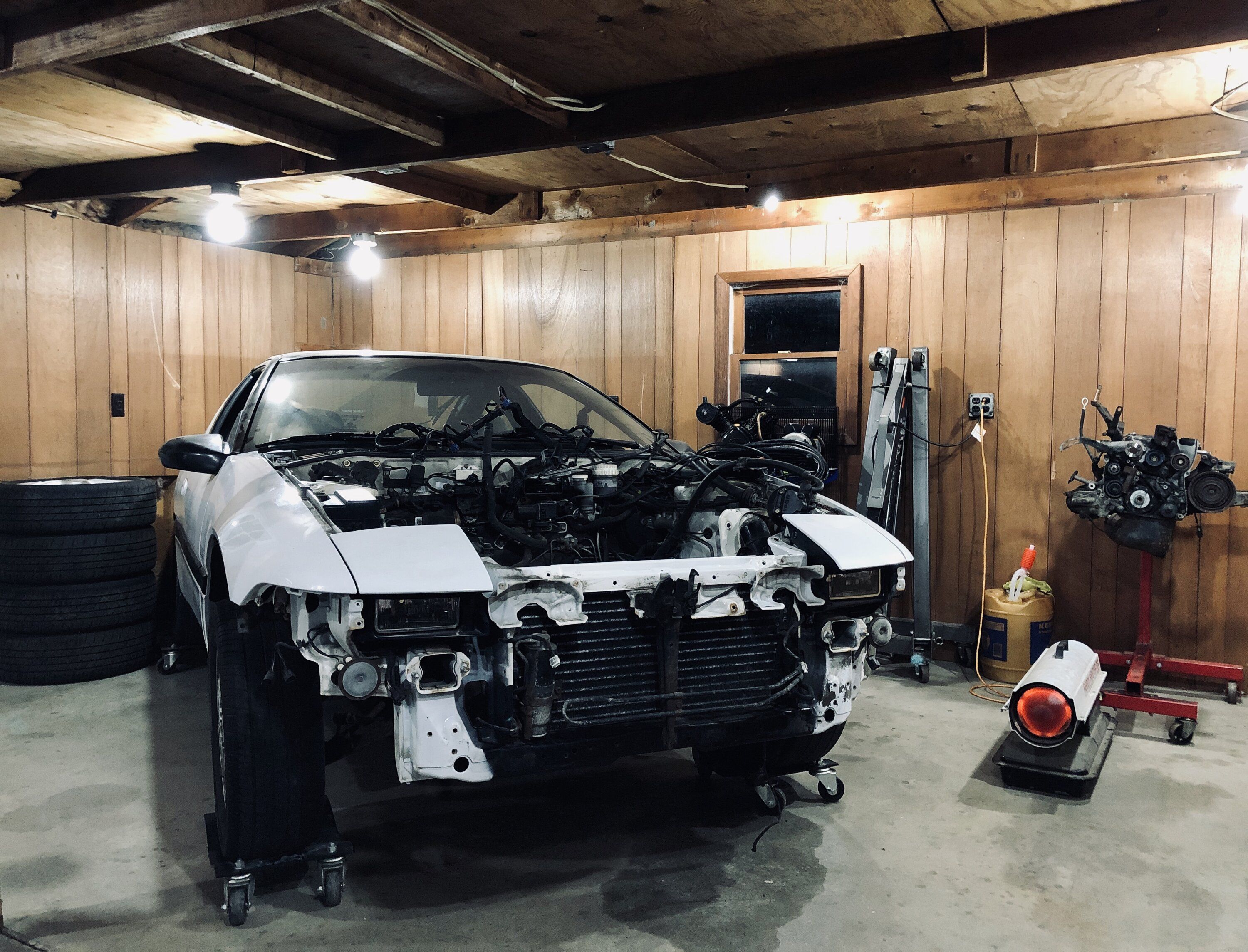

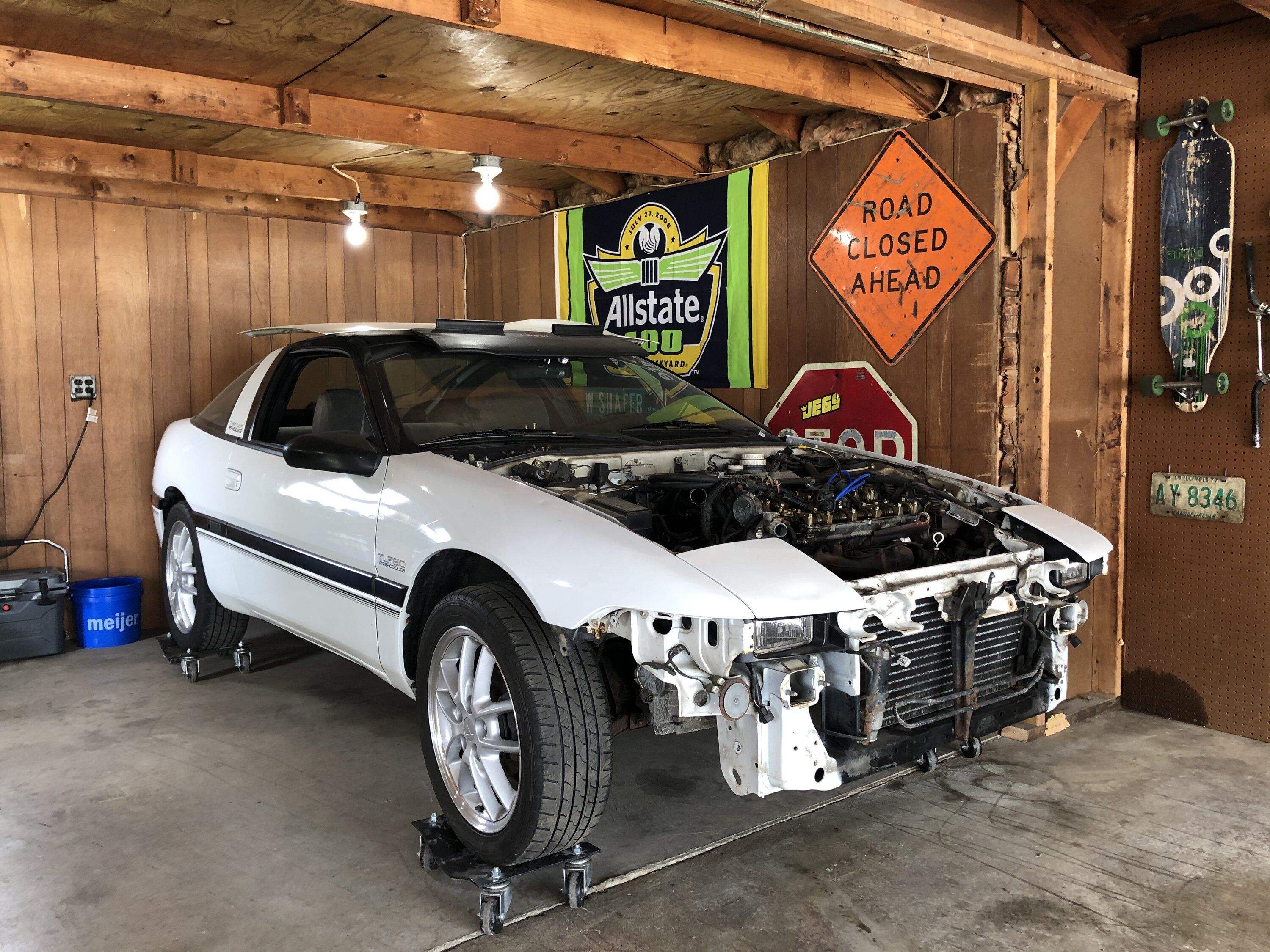

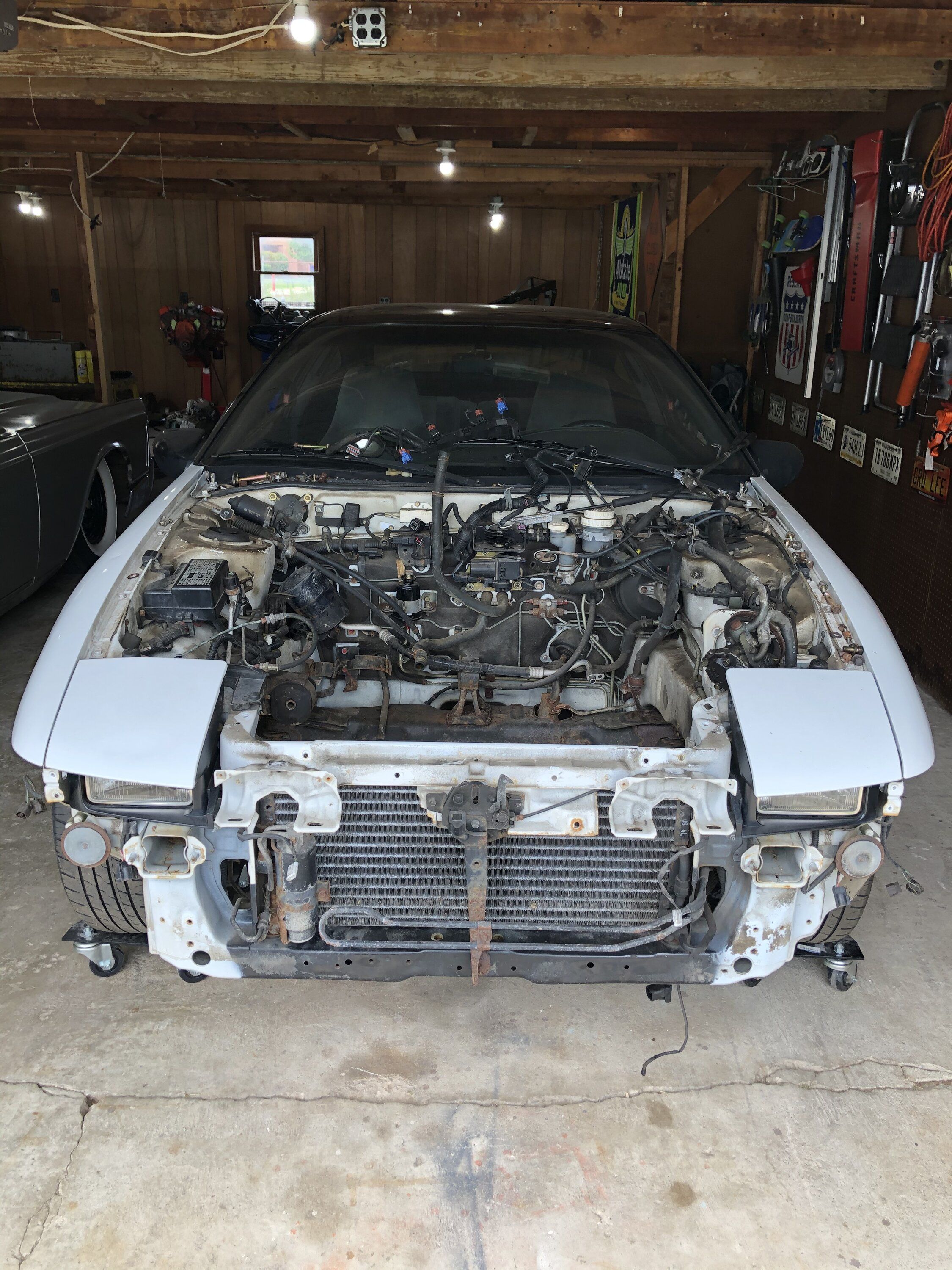

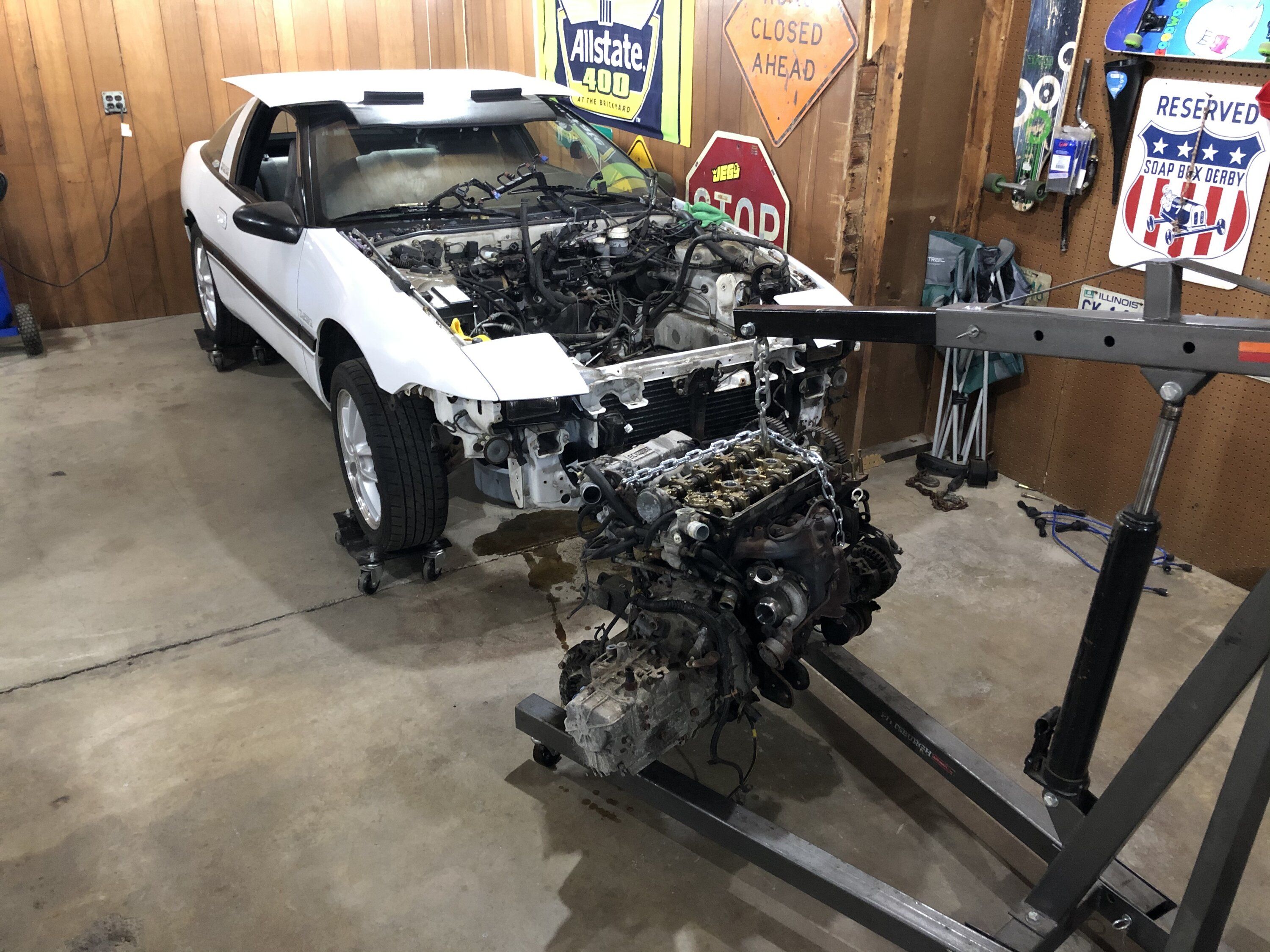

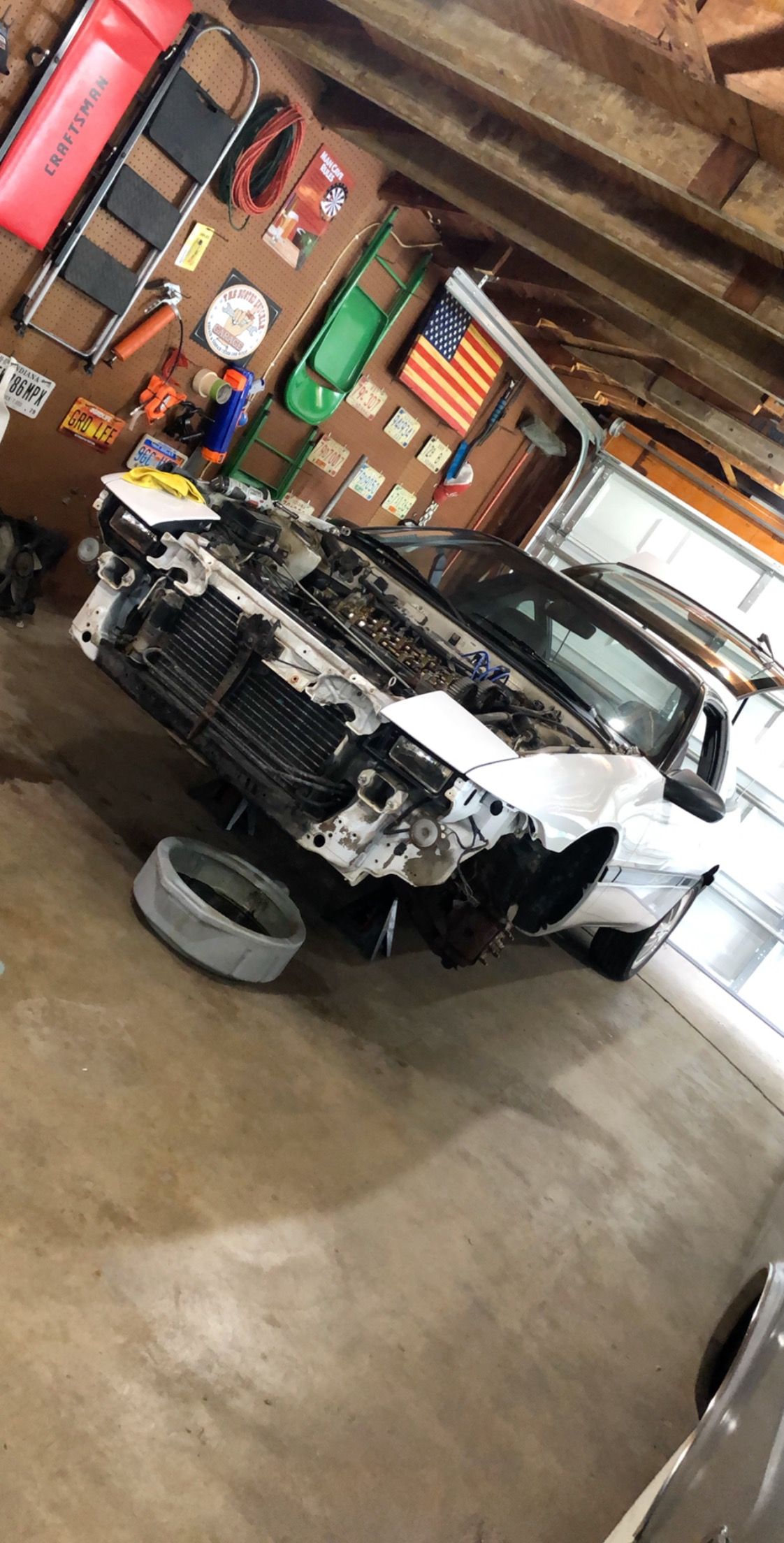

04/26/20 - Tear down begins

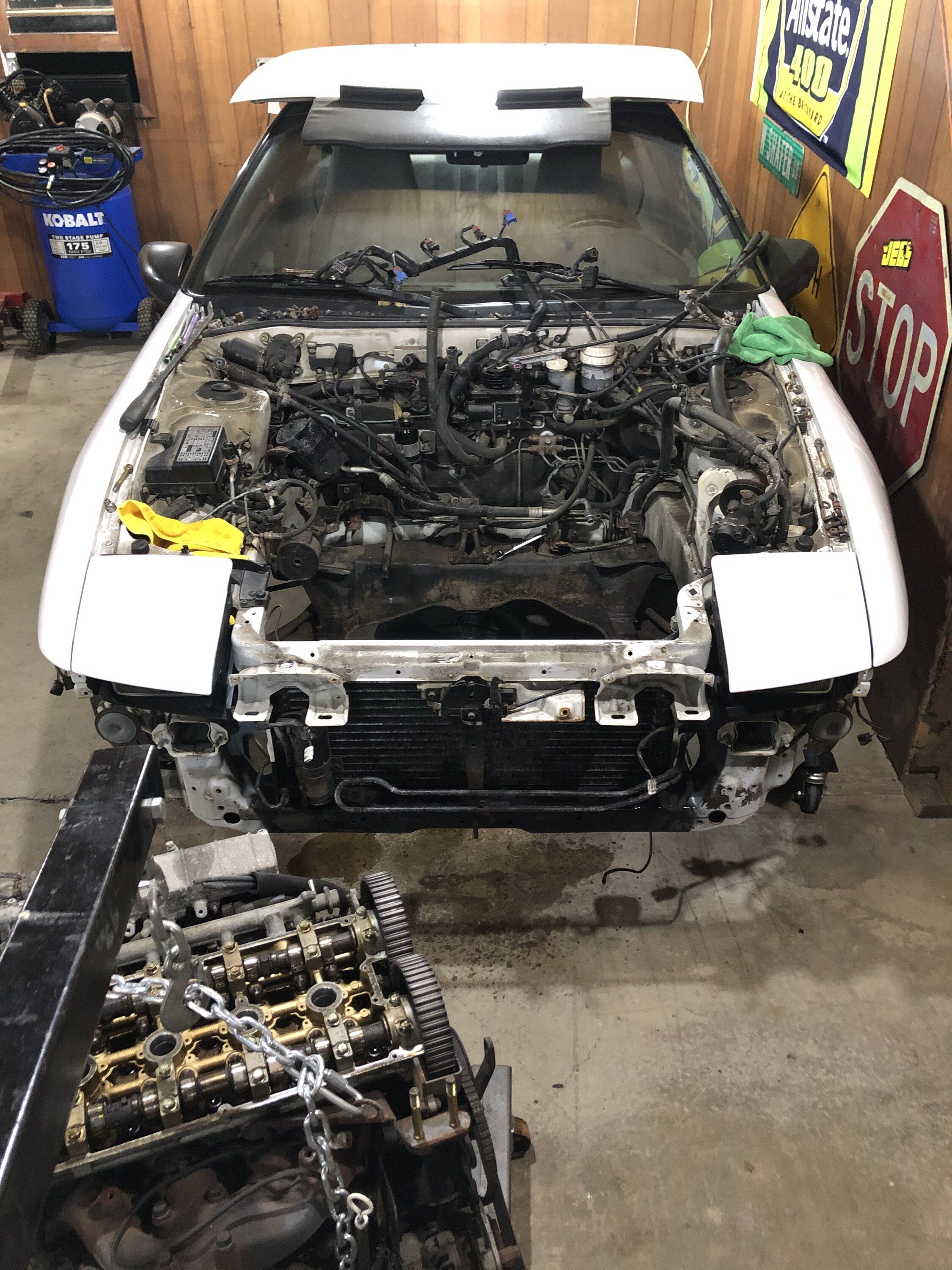

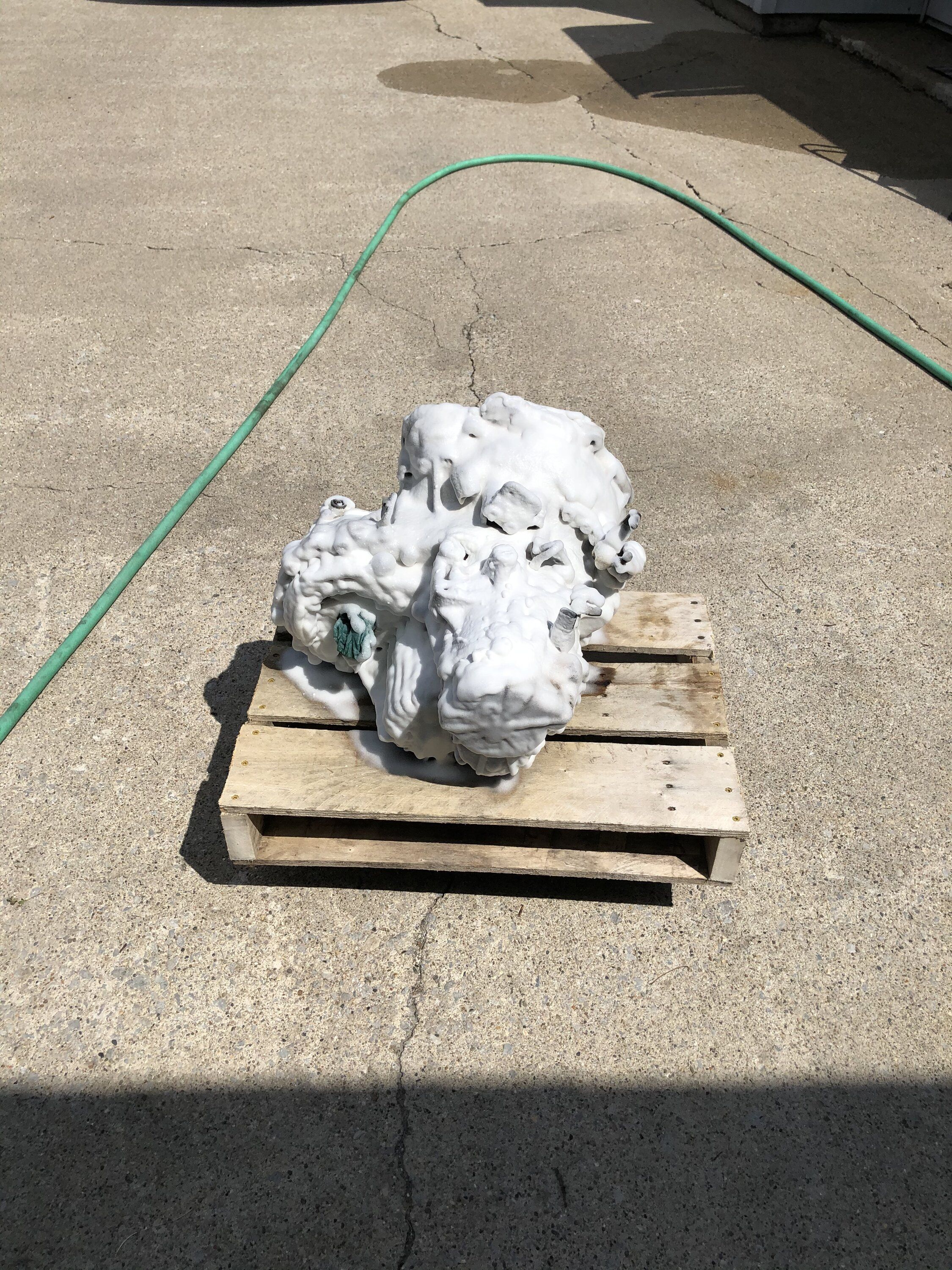

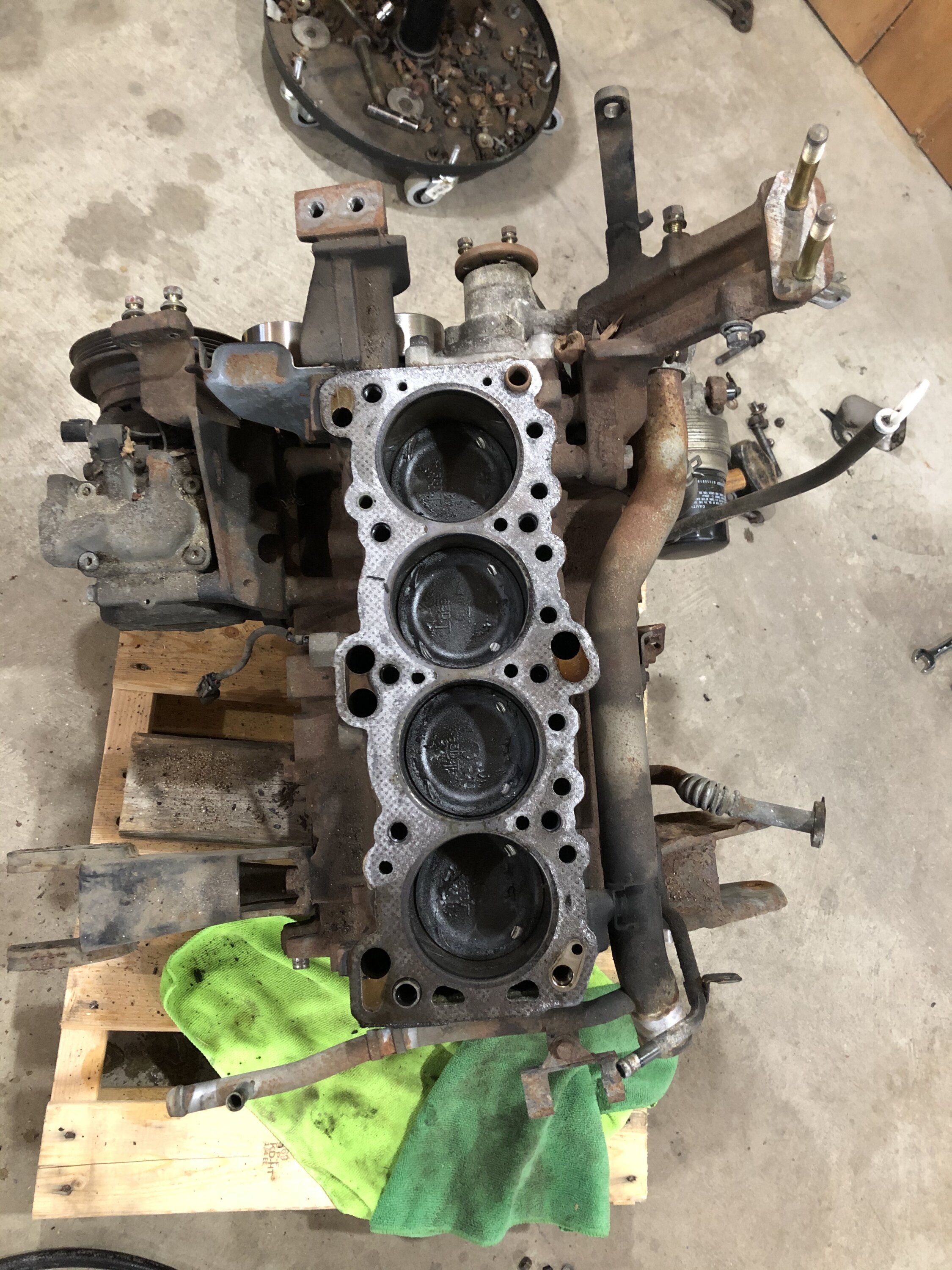

07/01/20 - Engine & Transmission Pulled

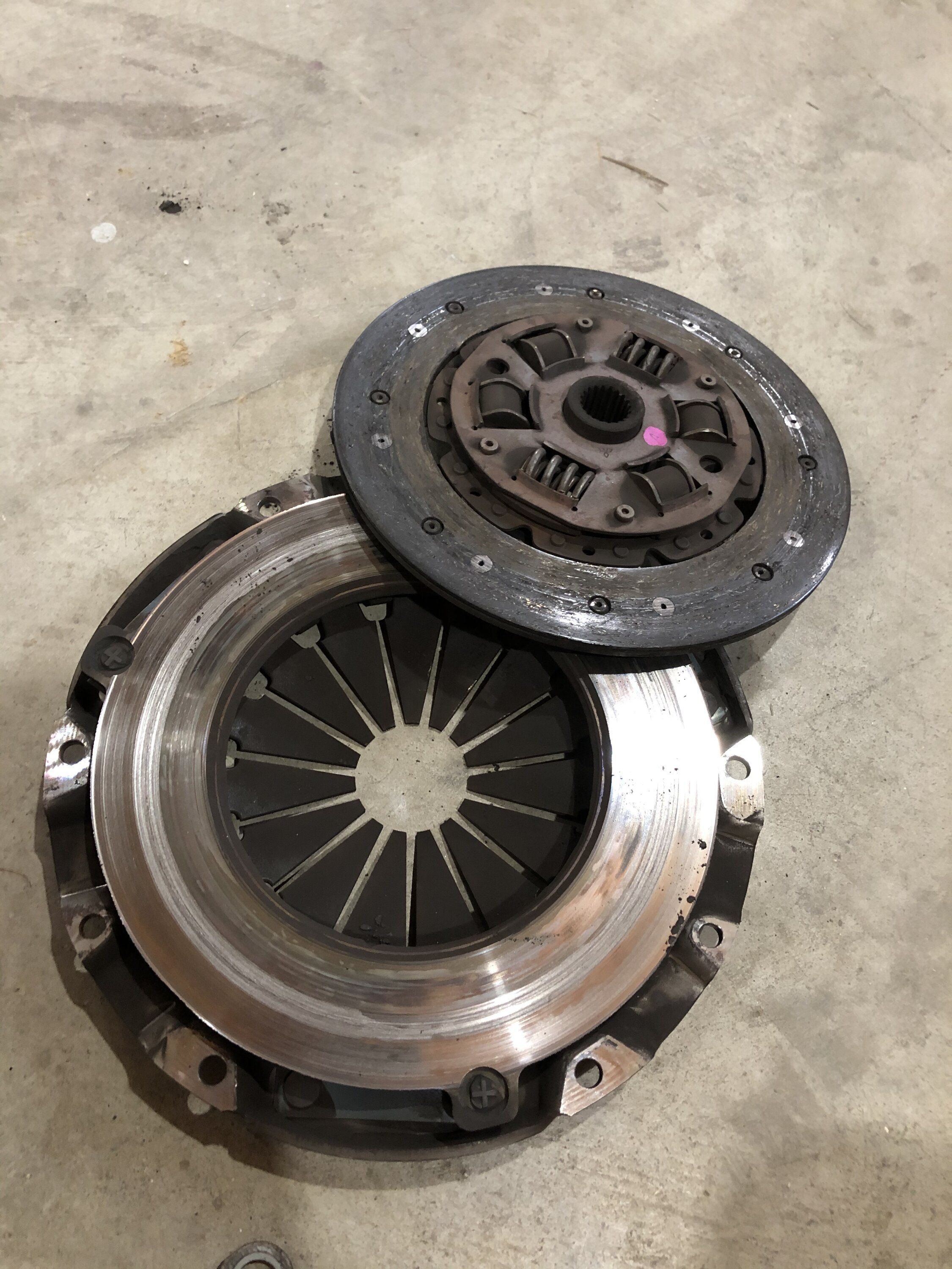

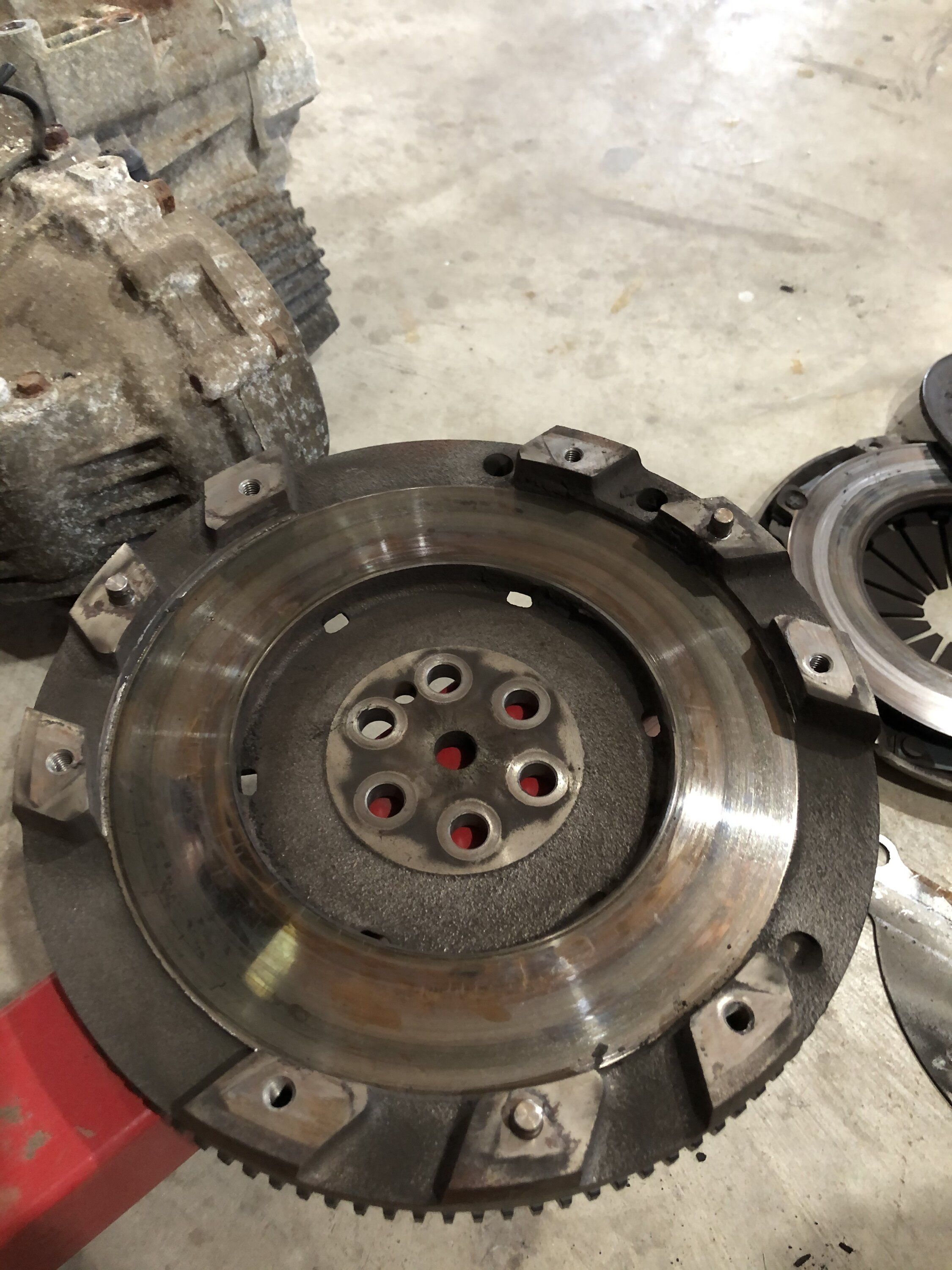

07/16/20 - Separated Engine & Trans, Found original clutch, flywheel, and pressure plate bad

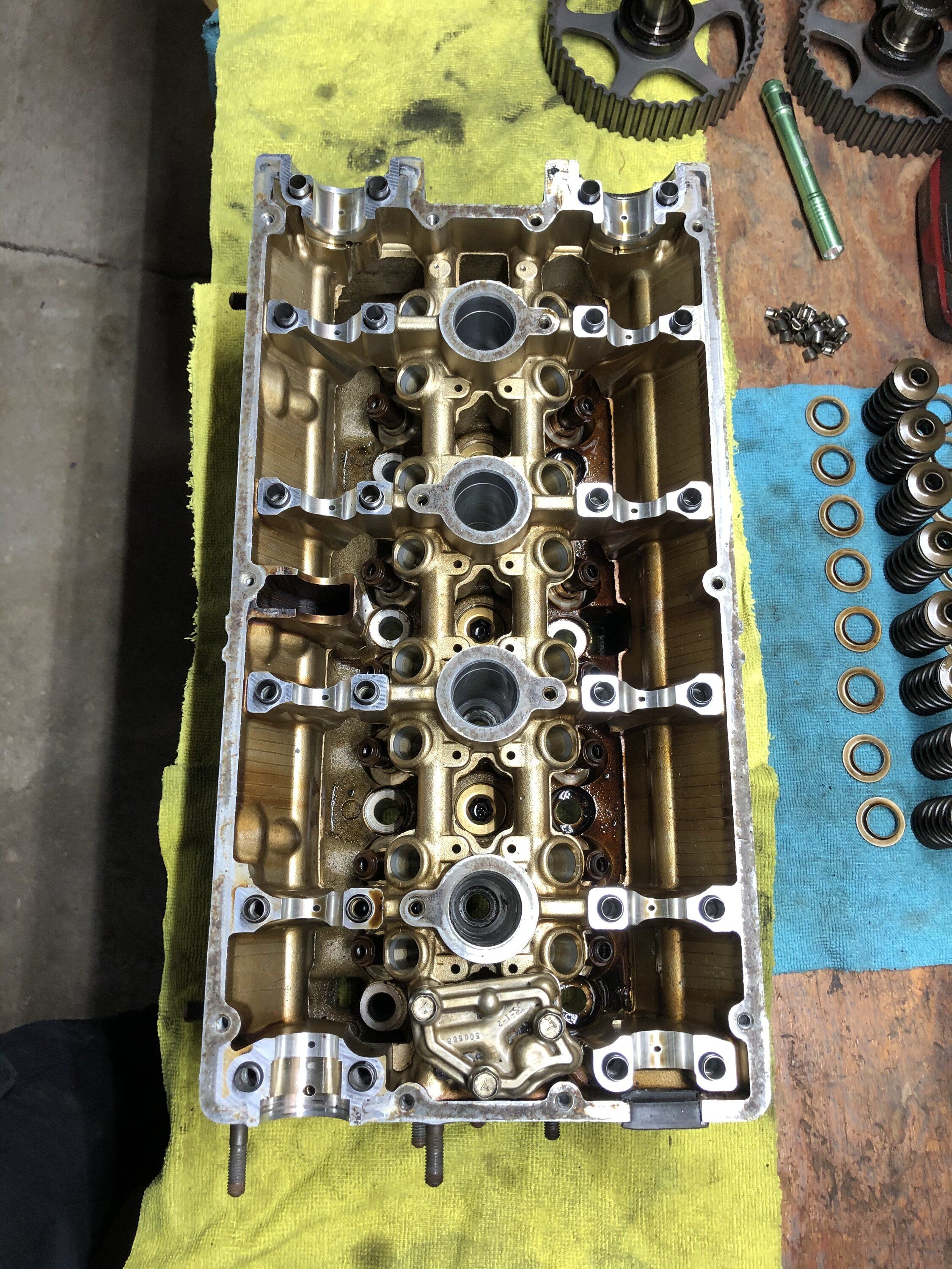

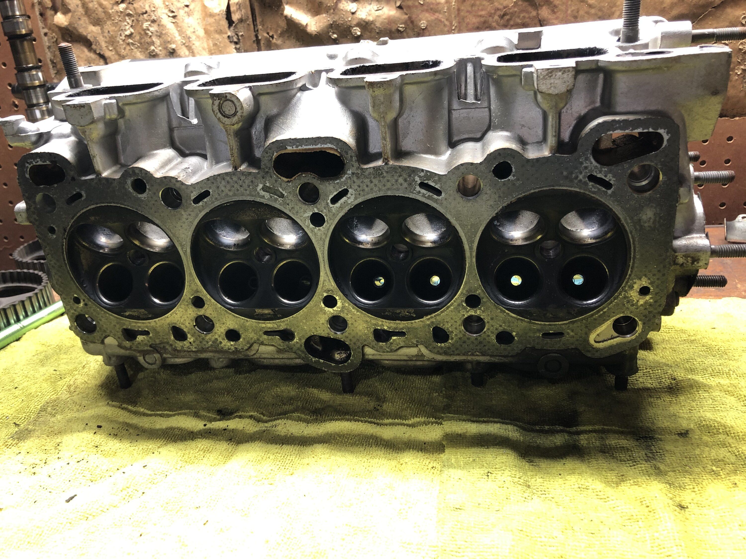

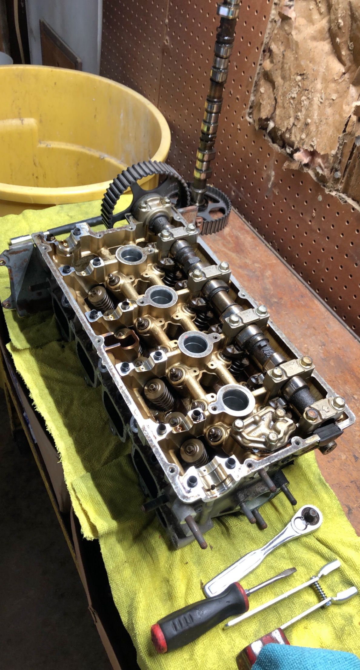

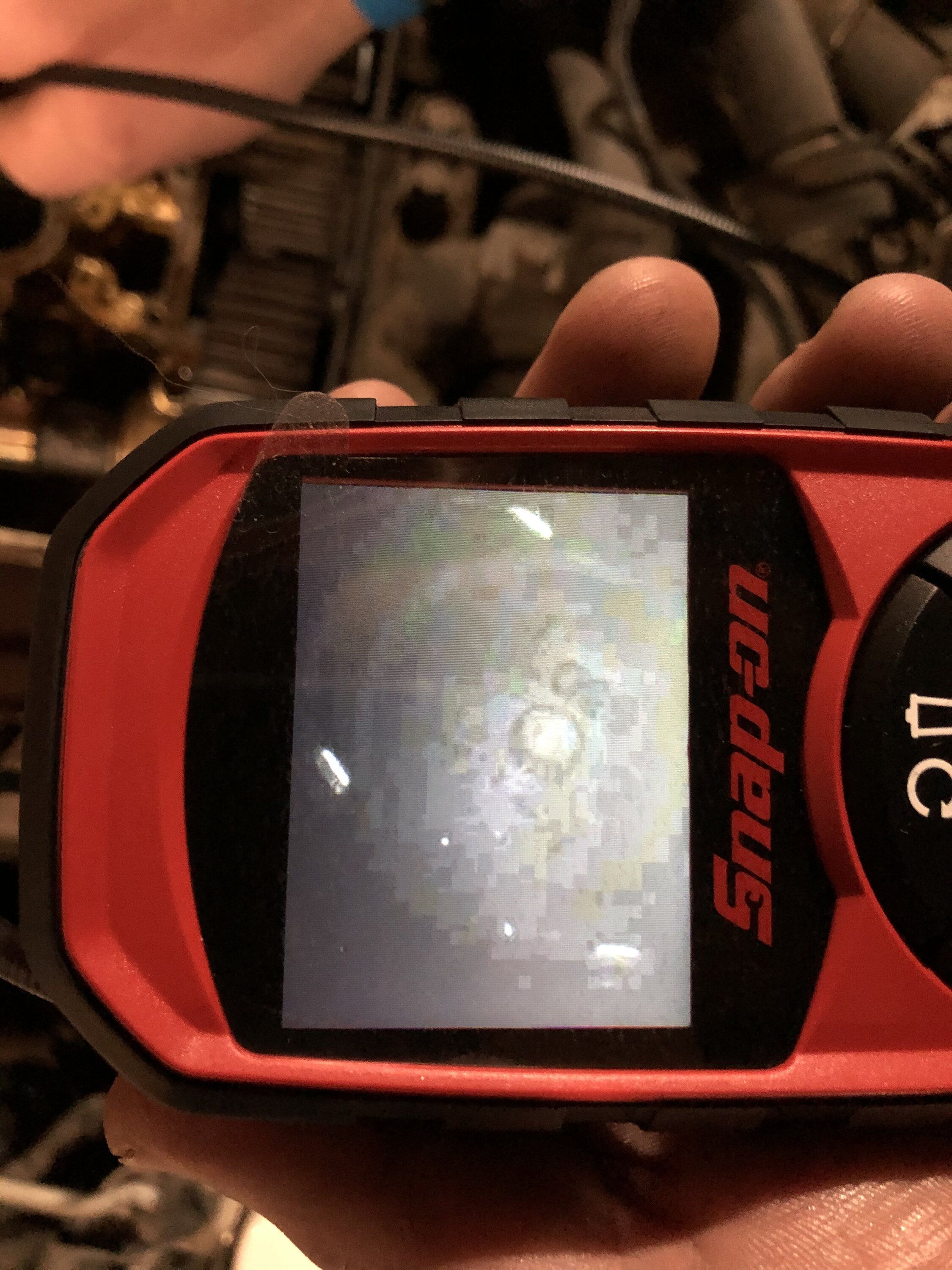

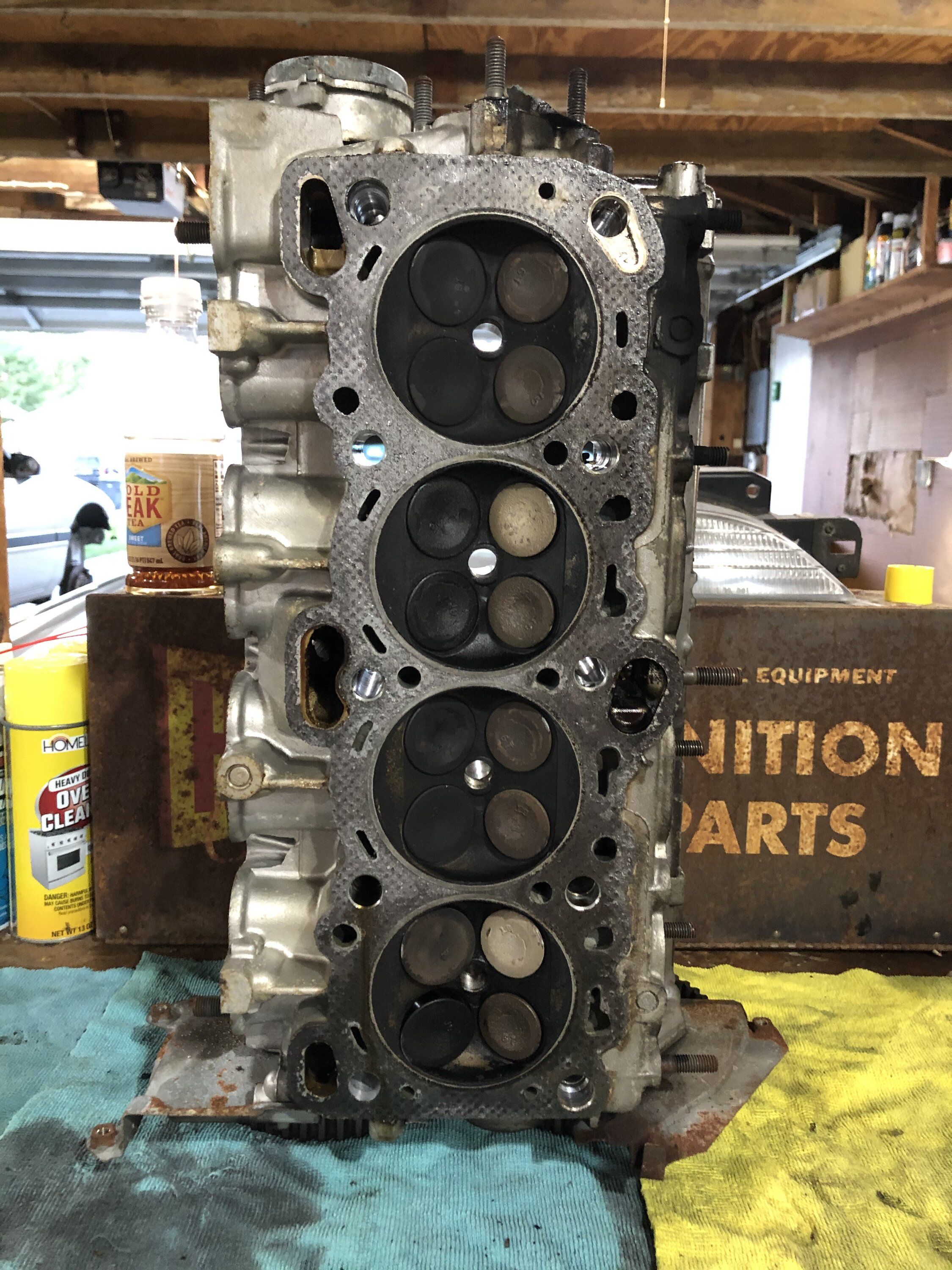

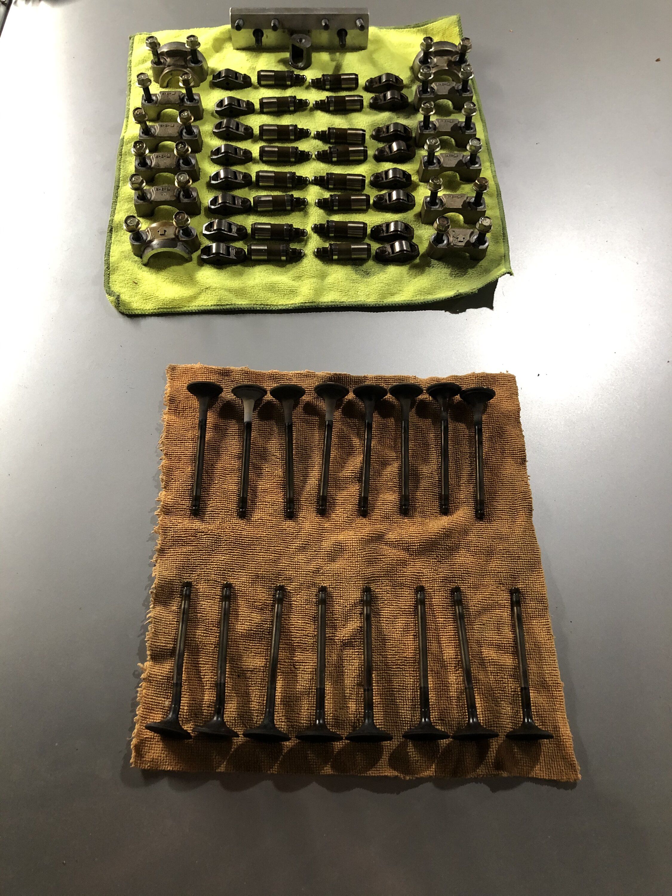

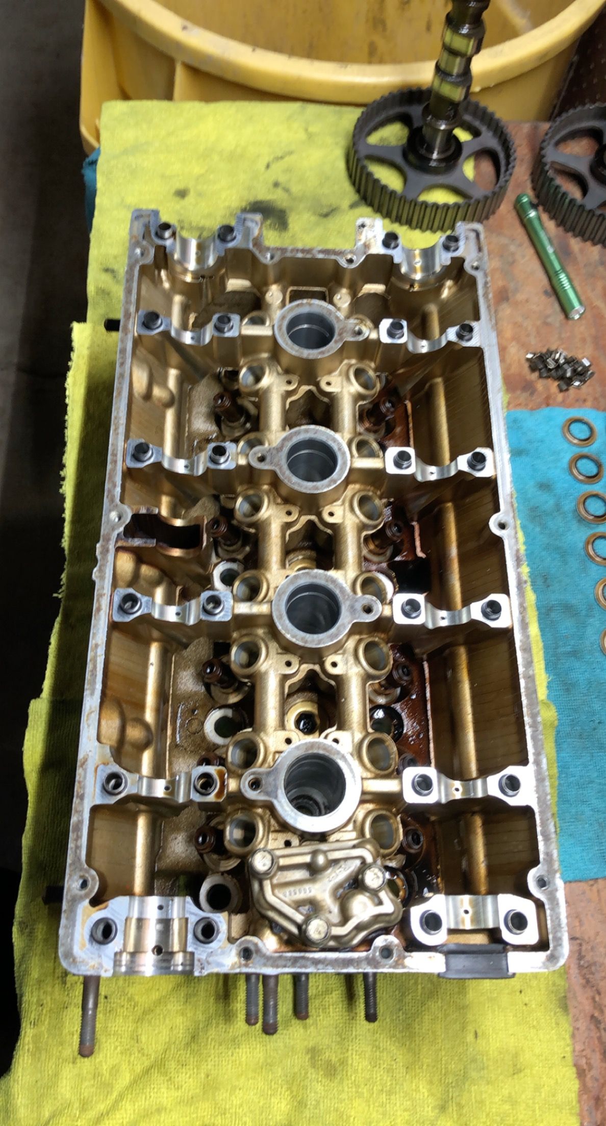

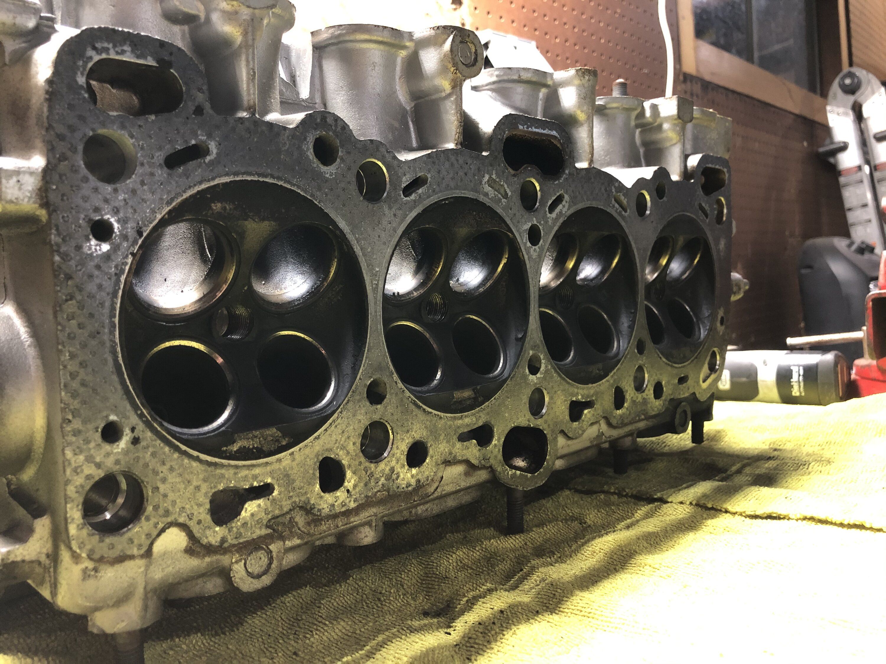

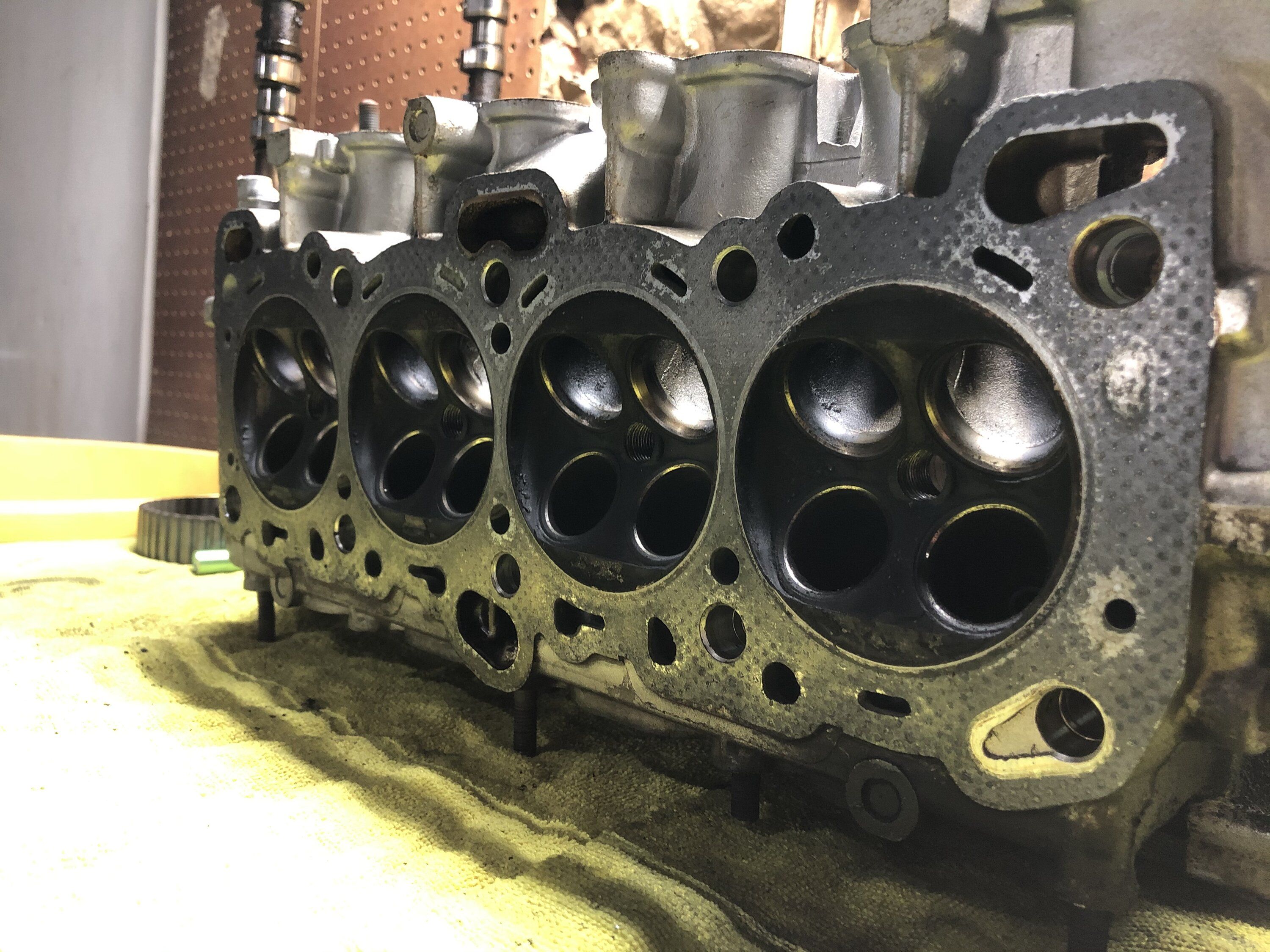

08/18/20 - Separated cylinder head from the block, found multiple bent valves and piston damage

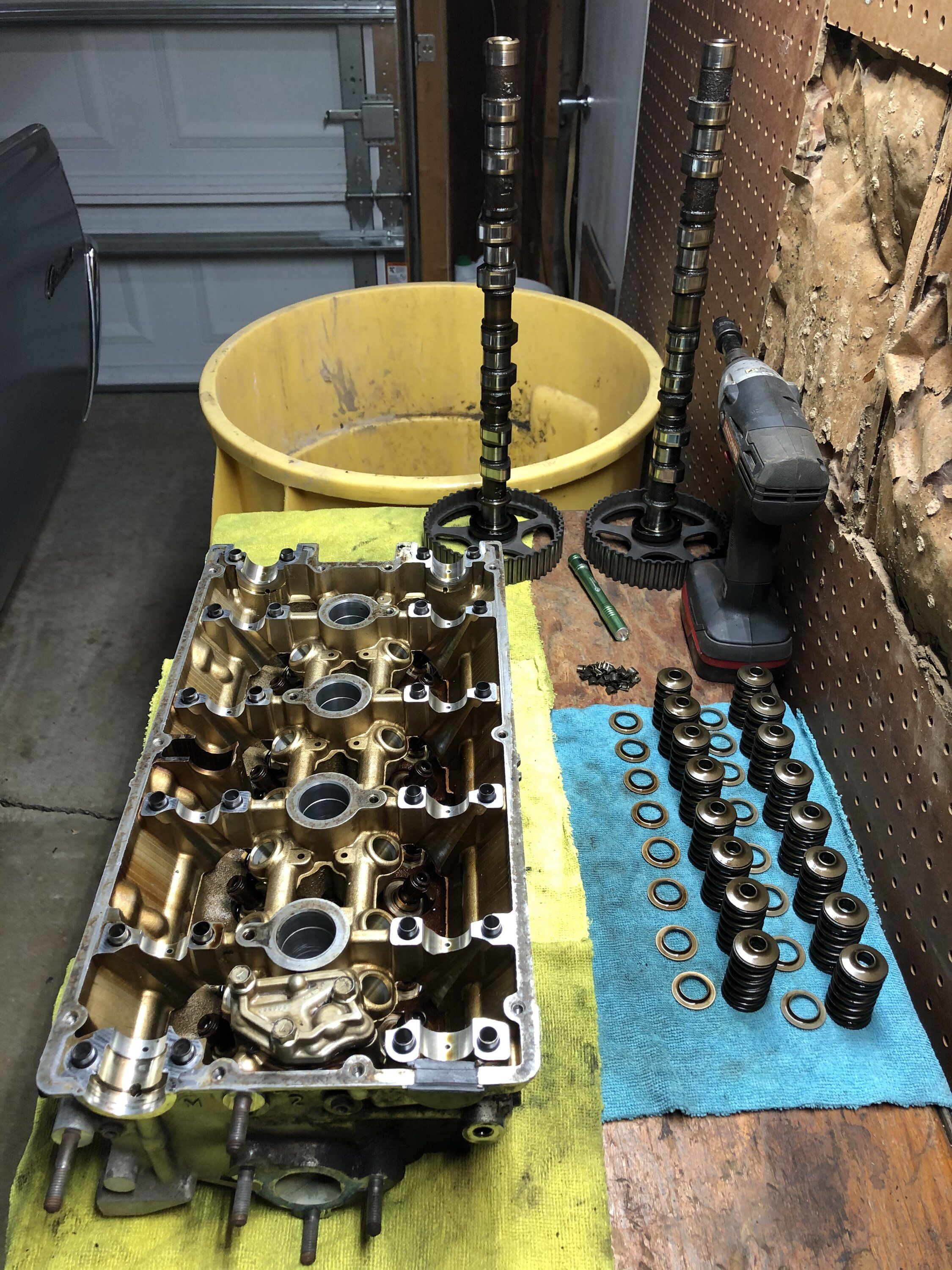

10/13/20 - Cylinder head tear down begins...
@pat white I knew the belt needed replaced, was trying to work out some other odd ball issues I was having with the car first. Figured it would have held on in the mean time, but it didn't. Took a chance, went against my better judgment, and took an L this go around. So back to square one unfortunately, it can only get better from here!
