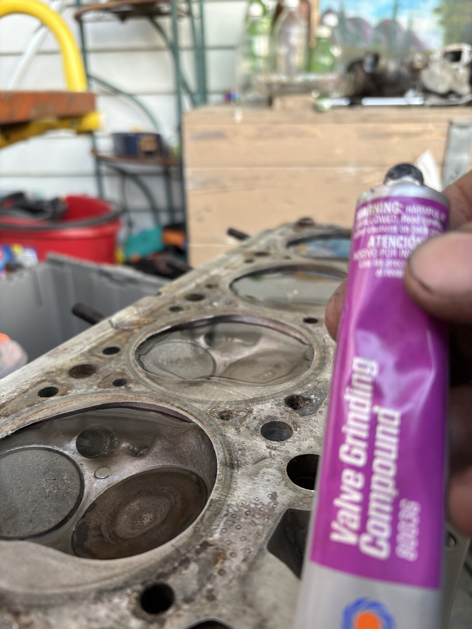

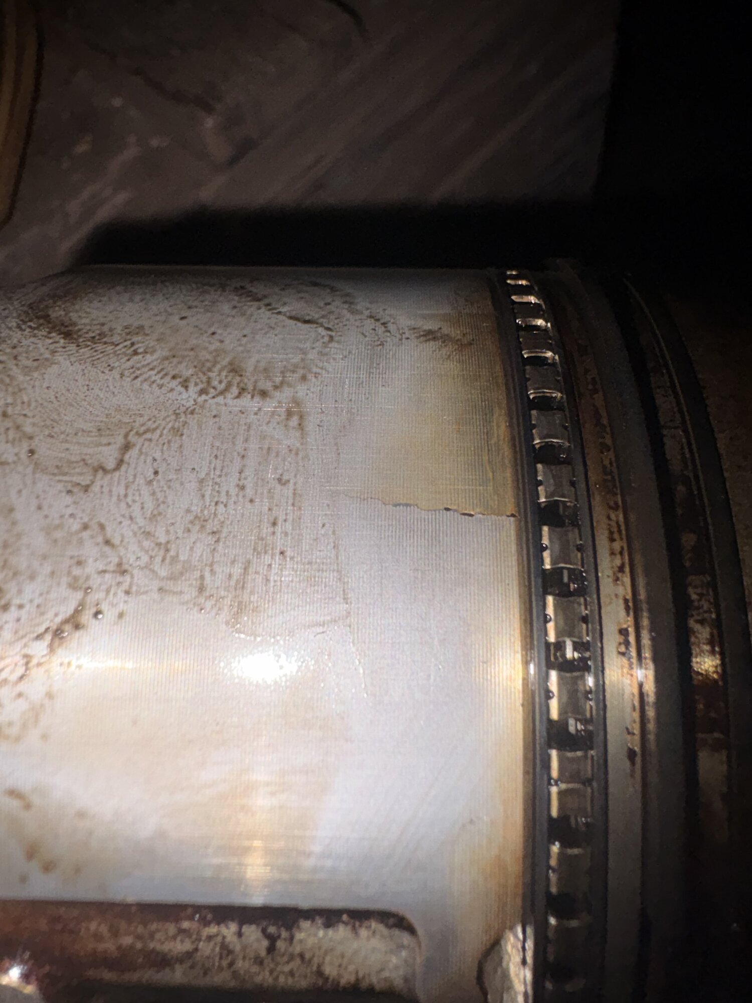

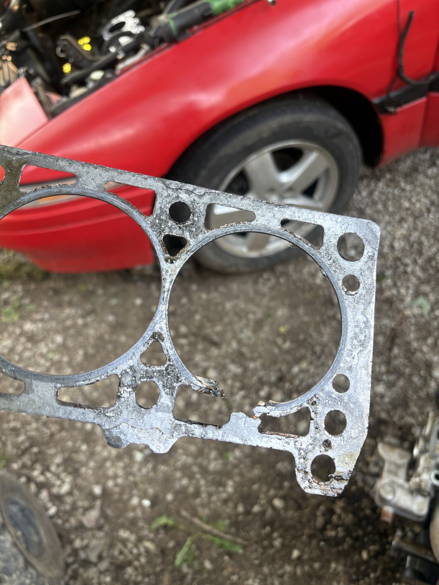

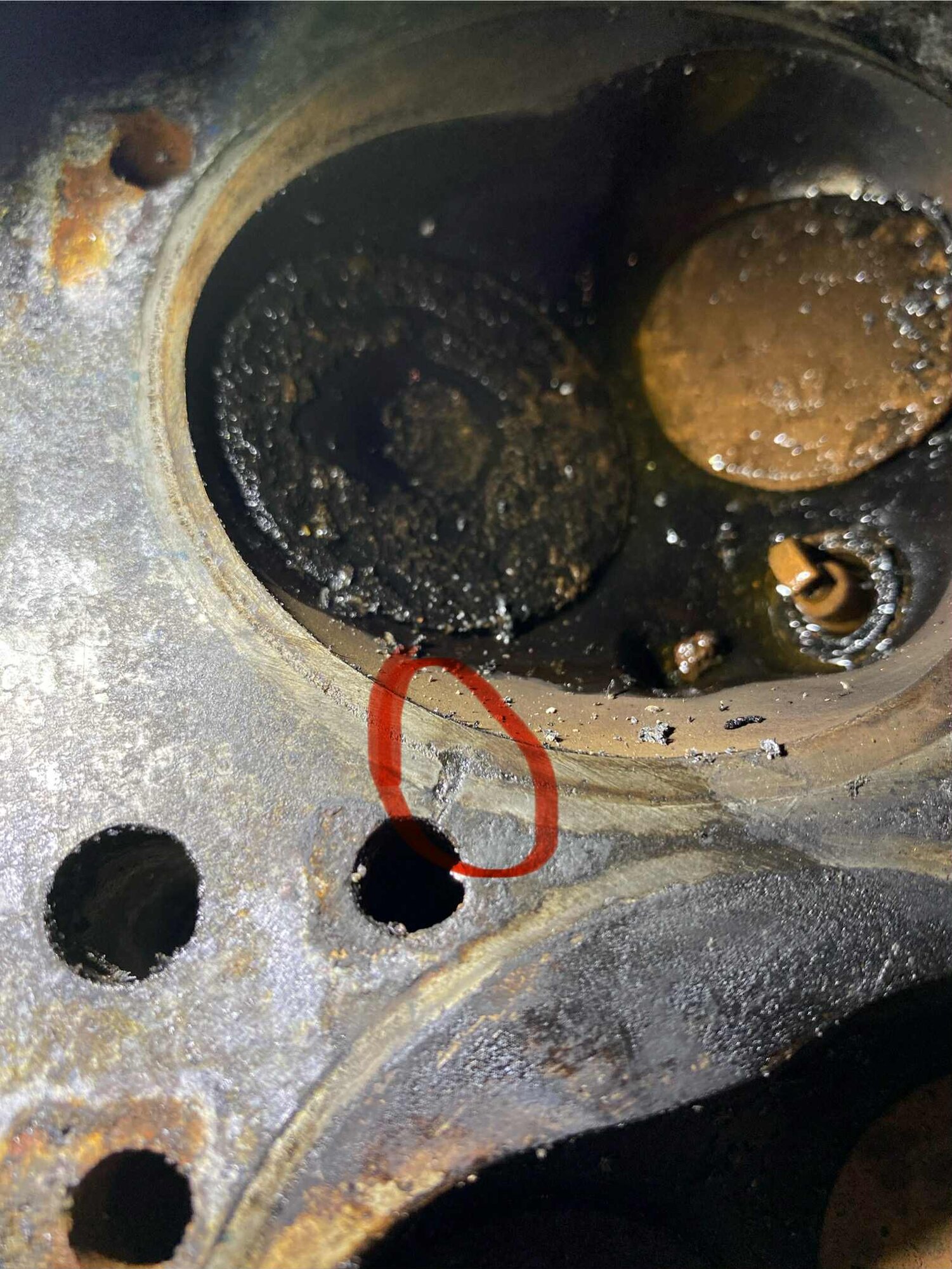

The only righteous repair is to have the block decked. That passageway between the top of the bore and the water jacket has gotta be milled away. I know that's a hard pill to swallow and a buncha work but from the other issues you've mentioned along w/the pics I'd say your rings have problee seen better days so the engine needs to visit the machine shop.

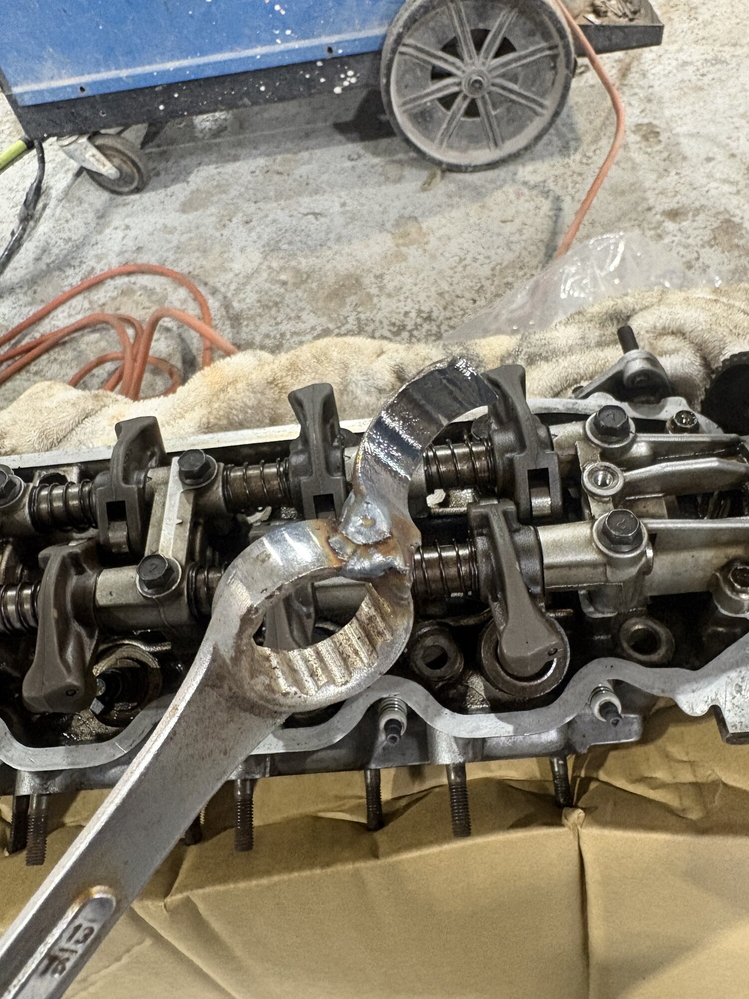

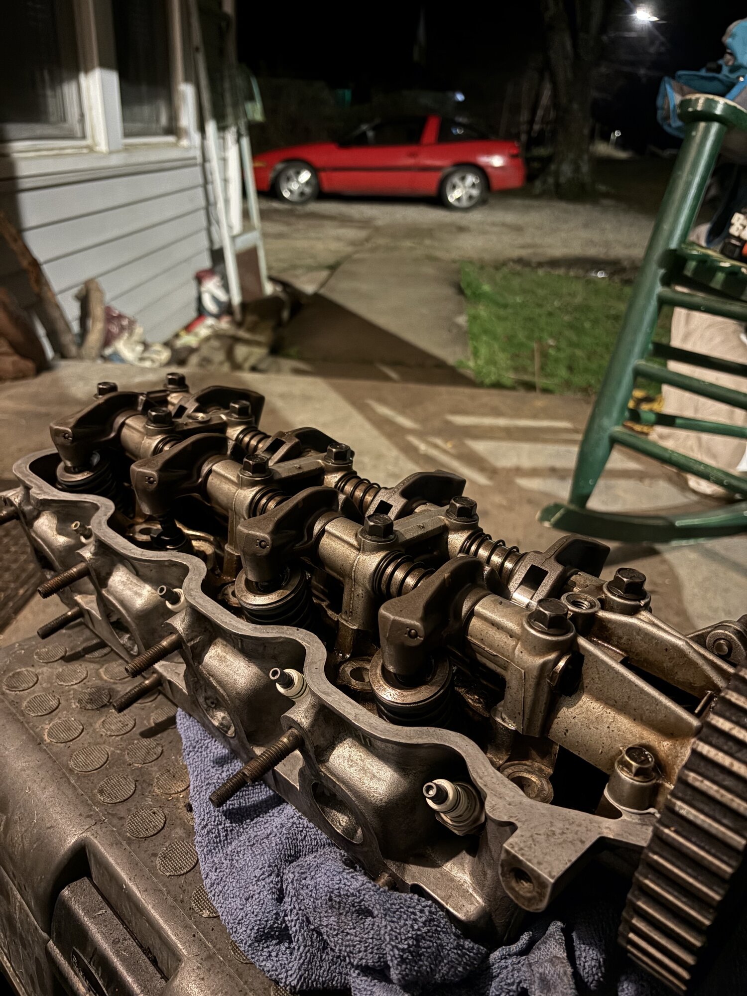

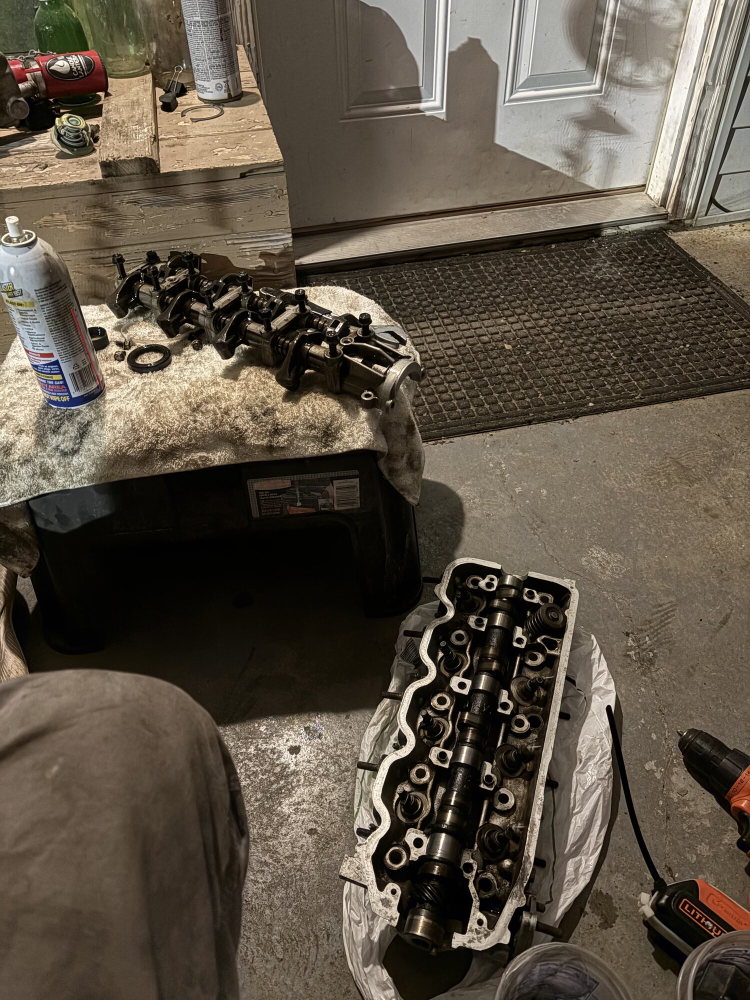

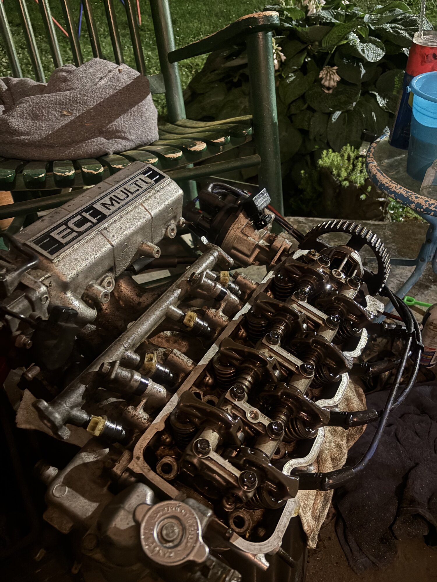

We’ll thankfully the blocked had nothing wrong where it wore into the head, thank god. I picked up another 4g37 from a local jy that supposedly just had a broken timing belt but turned out to have a seized cam😬 the cam seizing resulted in 2 bent valves, some shitty can journals and a bottom end absolutely full of glitter. I was planning on cleaning that block and head and dropping it in until I realized that the main bearings and rod bearings are toast too. My new plan is to finish rebuilding this head with 2 new valves and seals annd drop it onto the running block. When I pull the head I’ll pour atf in the dead cyl and water in the combustion chamber of the head to see where my compression is going. If the valves leak water into the ports that’ll tell me I only need to install the head. If the head olds water but the atf in the dead cyl drains then I’ll be dropping the oil pan at the same time and taking a piston and rod from the junkyard engine and putting it into the engine in the car(cleaned throughly with a new rod bearing of course).
Was planning on ordering parts for the head this week but my car decided it needed a new battery, so maybe next week or so. I’ll post again once I have either blown it up or fixed it😂

If the block isn't badly scored in any of the cylinders you can hone it w/a stone or ball hone and a drill to help seal the bores but a fresh set of file fit rings would help too. You can pick up a set of rings pretty cheap from Rock Auto ($32 for a set). Take some green scotchbrite and solvent and clean up the pistons (especially the ring lands) file fit some new rings to the honed bores and slip 'em onto the pistons and you'll have a poor mans rebuild! Doin this simple stuff will add many miles to your Laser!

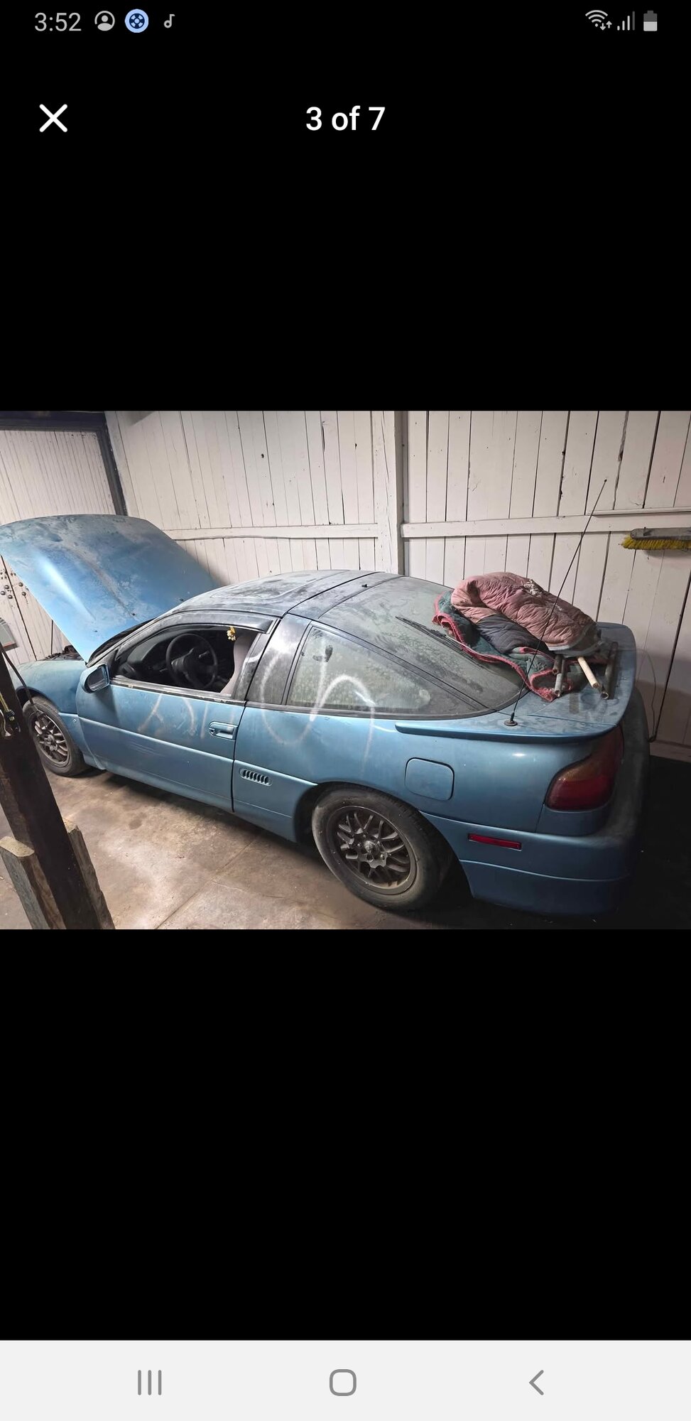

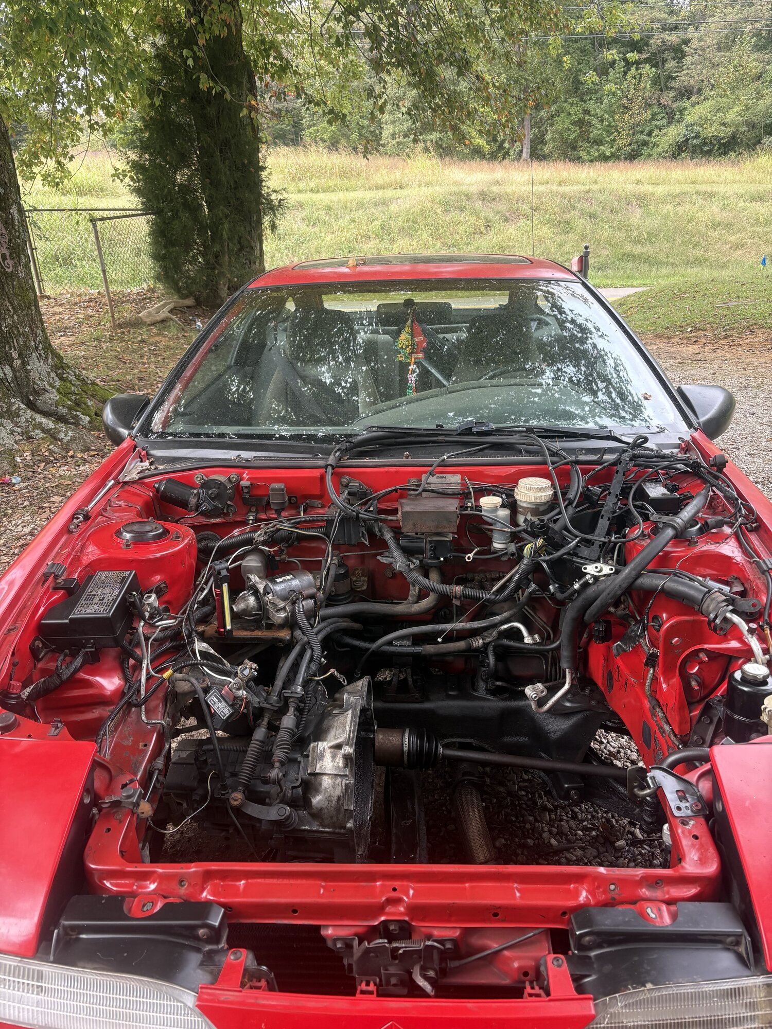

So I've talked the wife into letting me get a parts car and if I can find one for sale withing a few hours from here in late feburary than ill be ditching the current junkyard block and head I have in favor of the donor vehicle engine. There's one for sale right now that's 3 hrs away 94 talon 2.0 nt for 1k obo, if that's still there when I have the money I'll be going to grab it. Will.i be able to use a 94 ecu/harness in a 91 car? And had anyone ever ran a flat hood with a 4g63? Maybe with the timing cover off?
I'll attach a picture. As of now the car is still running and getting me to work every day on 3 cyl. I still have issues with the mpi kicking off but since I figured turning the ignition switch kicked it back on it's not really been a problem. I'll post again when I have an update.

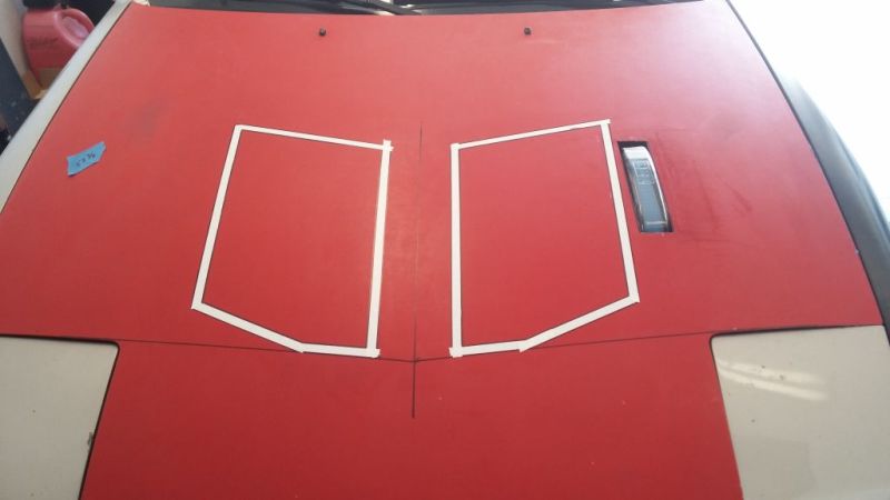

You could swap the engine bay harness and ECU into your Laser but the flat hood on your Laser won't clear the 4g63 cam pullies. Never tried it but I doubt even takin the upper timing cover off will help it clear.
Any idea what kinda shape the Talon is in? Might be better to just build that one.

sadly the talon has no title otherwise I would. I guess I'll have to be on the lookout for a hood too, or I'll modify this one to fit. I saw where one guy slotted the hood for the cam cover, if I absolutely have to I can do that. Hell maybe I can make my own bump in the hood to clear it, I do work in a body shop now.

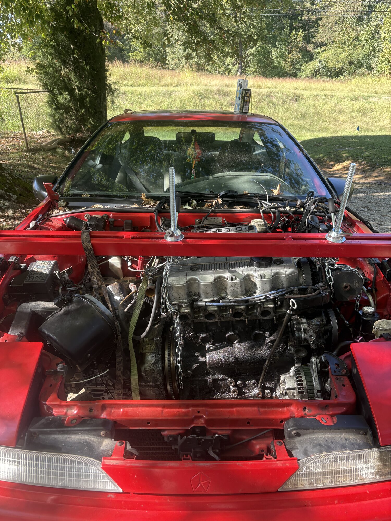

Update: So I have been driving the car to and from work every single day since the last time I posted and as of now days ago it is JUST NOW running on all 4 cyl again. I never ended up getting a parts car, we simply didn’t have the funding I expected to have. So the new game plan was to just limp the car around on 3 cyl until I can swap my rebuilt cyl head and a donor piston, or it blows up and I’m forced to rebuild my engine I bought from the junkyard that’s full of glitter. Some how the car made it until I had a 3 day weekend to swap the head, and a donor piston and rod from the junkyard engine with new rings and a rod bearing(I assumed cyl 3 cyl wasn’t firing because of blown rings from hydro locking). As it turns out I was wrong and right at the same time😂 the piston had a crack just below the oiling ring and I assume that’s where my compression was going. Any who I got the car back together and accidentally clamped the pcv hose between the head and block when reinstalling and messed up the gasket causing it to blow within 3 starts. Finally a week later and I have another gasket. I swapped it out and I’ve been driving for 3 days now all over the place and other than some smoking(previous blown hg left tons of oil and coolant In intake tube and manifold) I’ve had no issues at all. The car runs great and has as much power as a 4g37 can and for now I’ll be happy with that. I’ll update again if any major changes happen👌

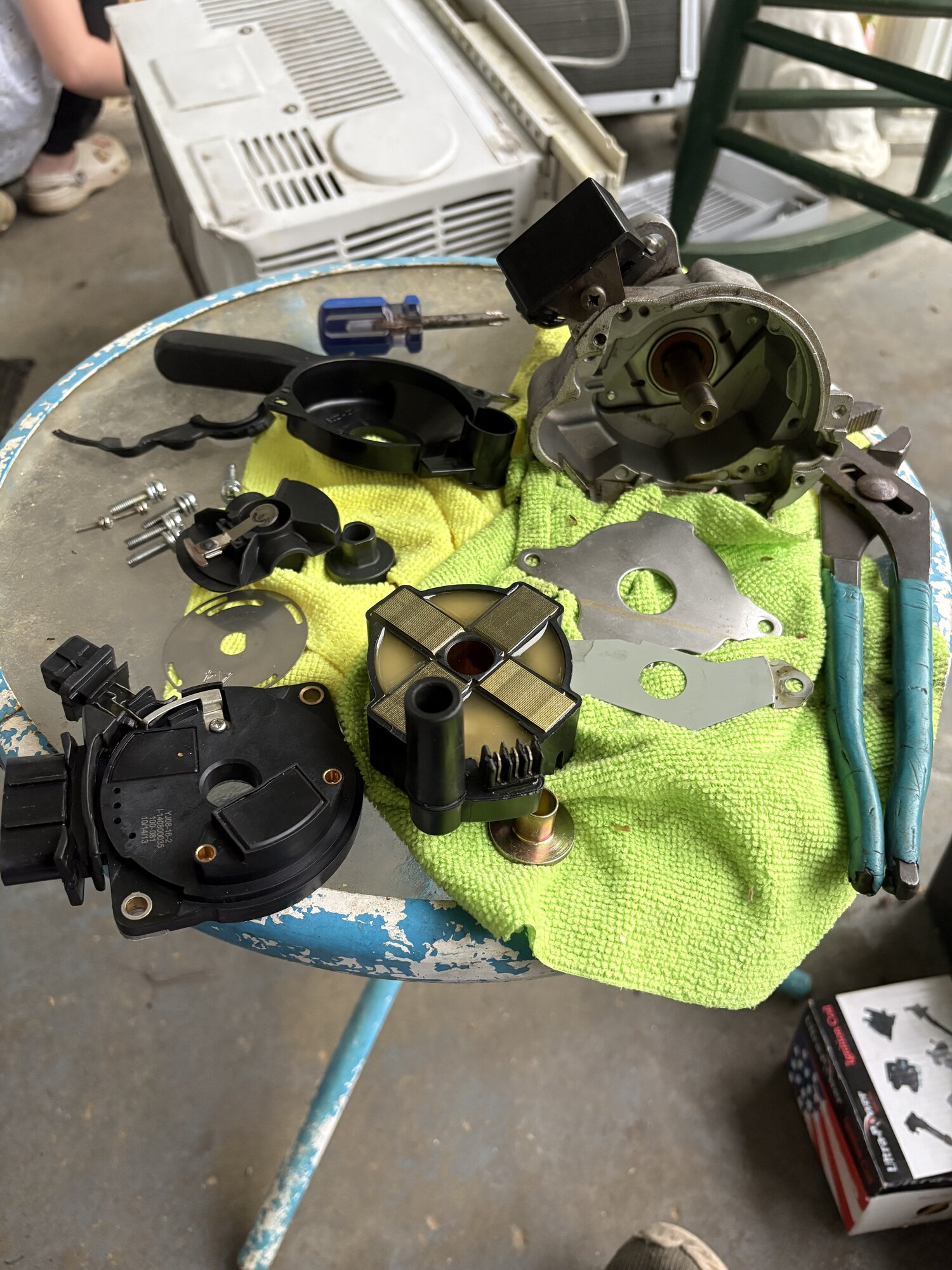

I might take you up on that distributor sometime, the car is still randomly losing tach signal occasionally and the only 2 possibilities left are the distributor or the ecu
Good chance it's the distributor or wiring causin your issue but it could be the ECU too. I'll have both available.
The wiring to the distributor was bad so I replaced it w/a longer lead and used bullet connectors on the wire ends since I had broken the flimsy connector at the distributor while changing the timing belt tensioner pulley. Wrench slipped and destroyed the connector!
Update: The car is still running great! Well mostly😂 The issue with it dying randomly became more frequent and finally the distributor officially kicked the bucket last week. I was able to get a new Chinese unit from eBay for a little over $100 and got it installed a few days ago and the car had been running perfect ever since.
