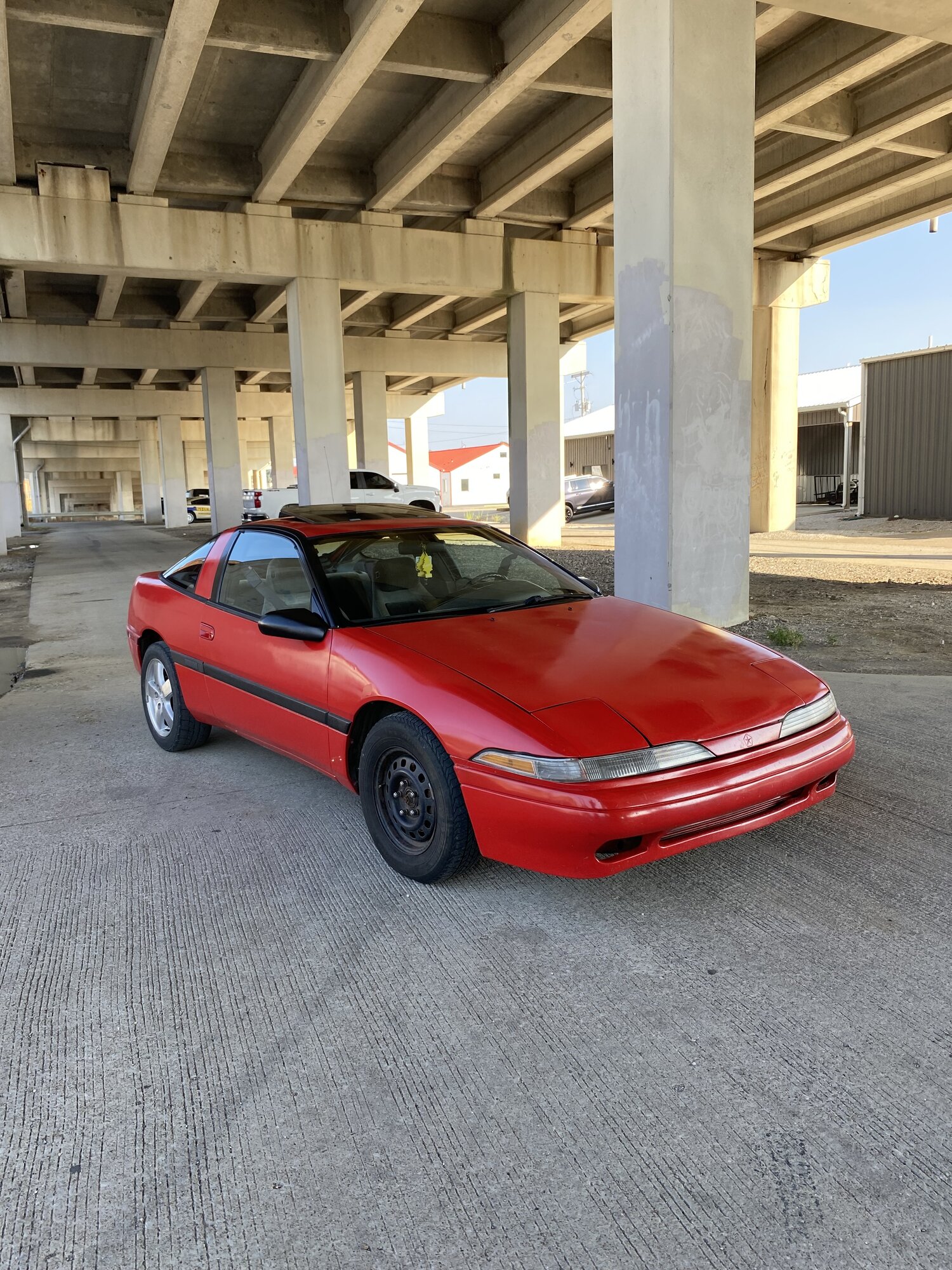

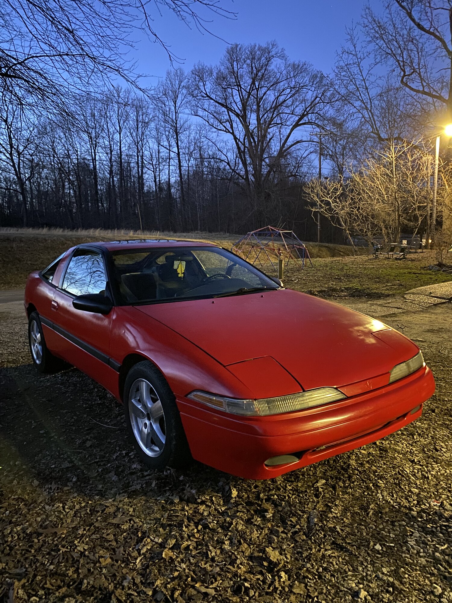

Update: she’s back on the road!

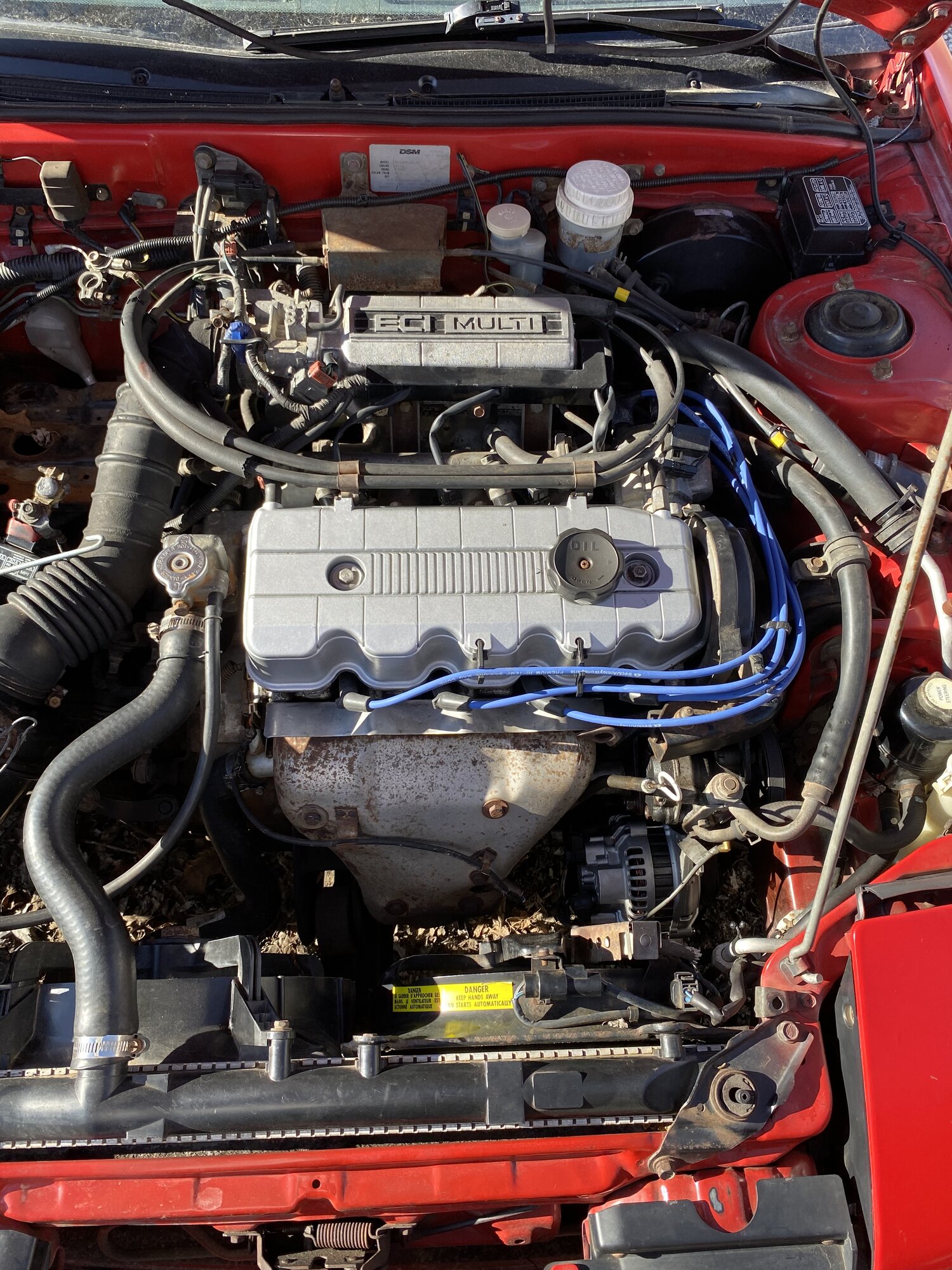

Got my $22 alternator installed and it works as it should. I also installed new plugs and wires, Ngk plugs and I forgot the brand of wires but they were on sale for $1 on RockAuto so I had to get them😂 they’re nice, although the box looked to be from the late 90s LOL. Says they have a magnesium core? Idk if that’s even that different from a regular plug wire. They look nice though!
Pic below

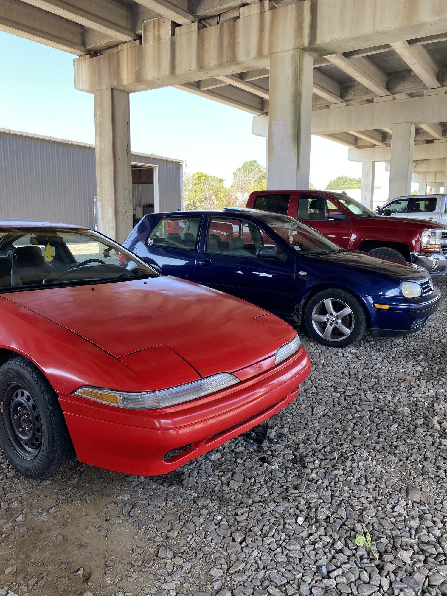

Also some pictures from cars & coffee last weekend. Got parked next to a nice 2g talon tsi, was stoked to not be the only dsm there this time!😂

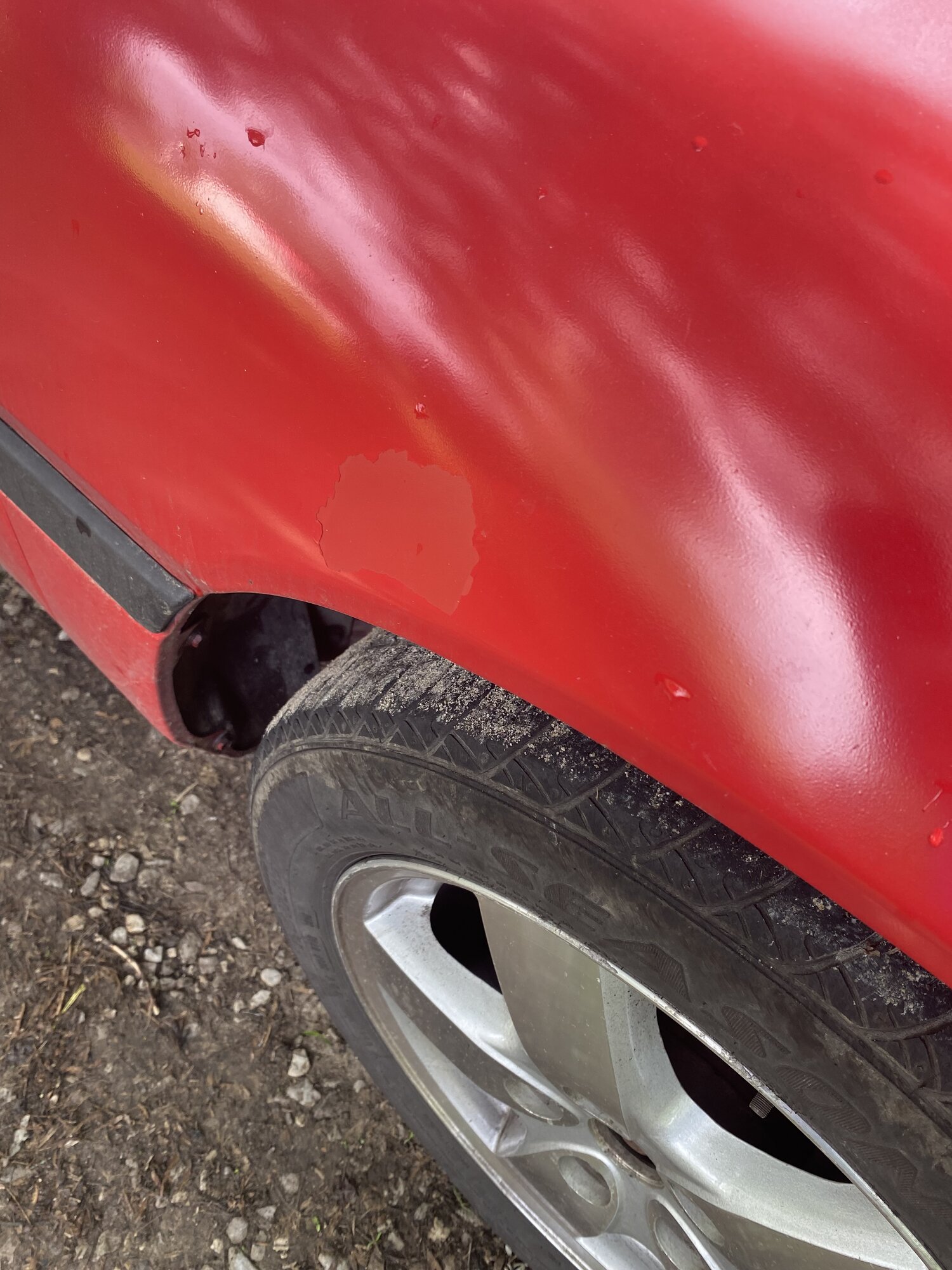

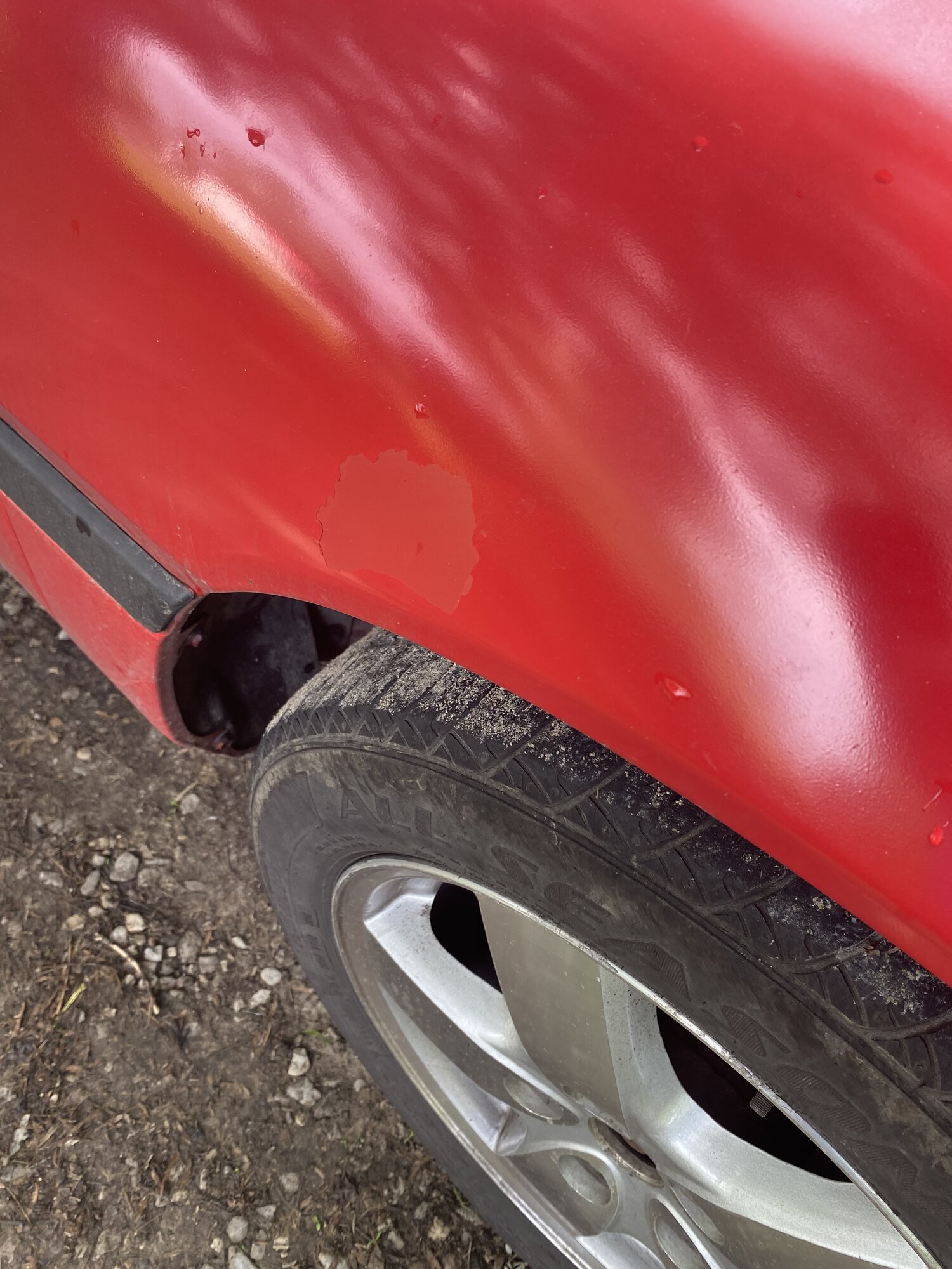

The paint is coming up on a year old now, and so far everything is hanging on pretty well aside from this big spot on the fender where the paint flaked off a few months ago.

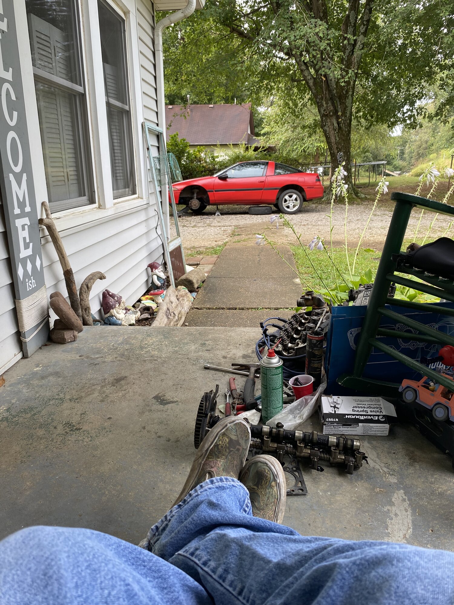

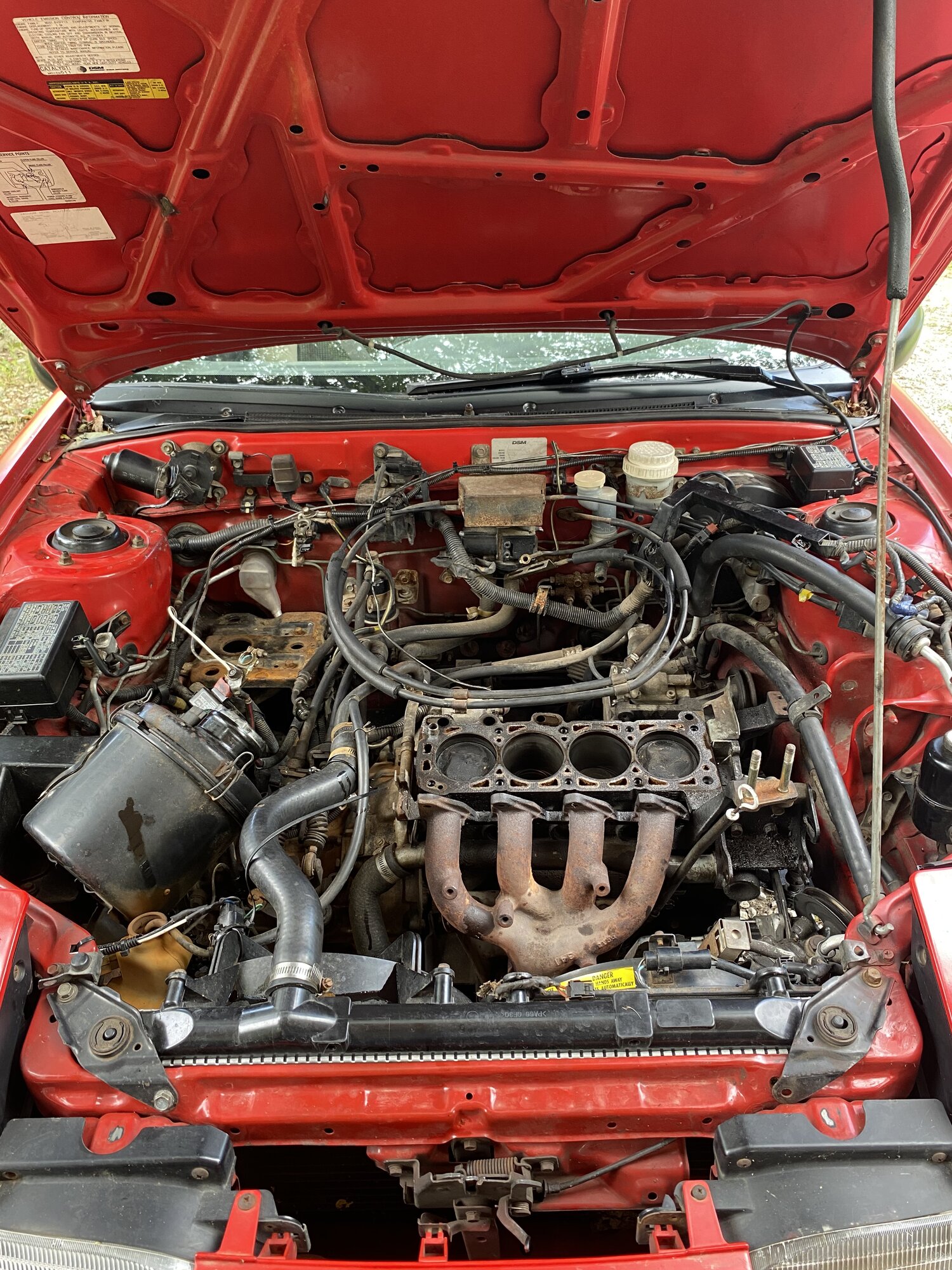

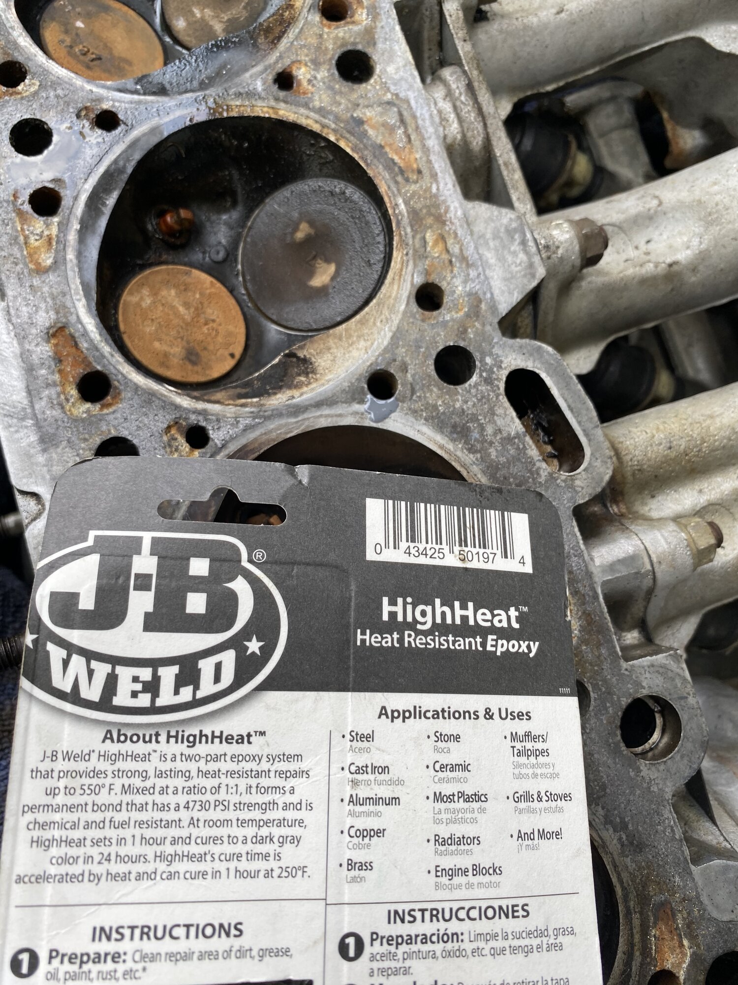

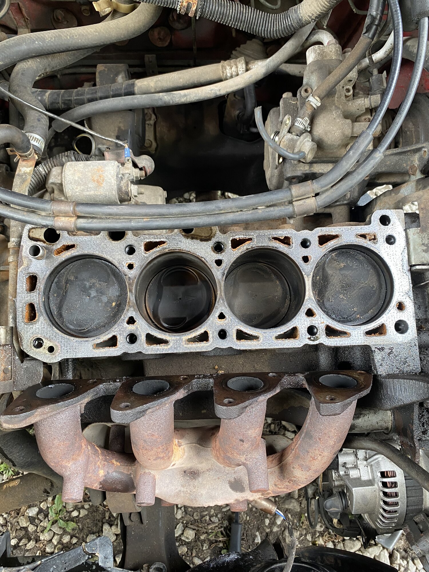

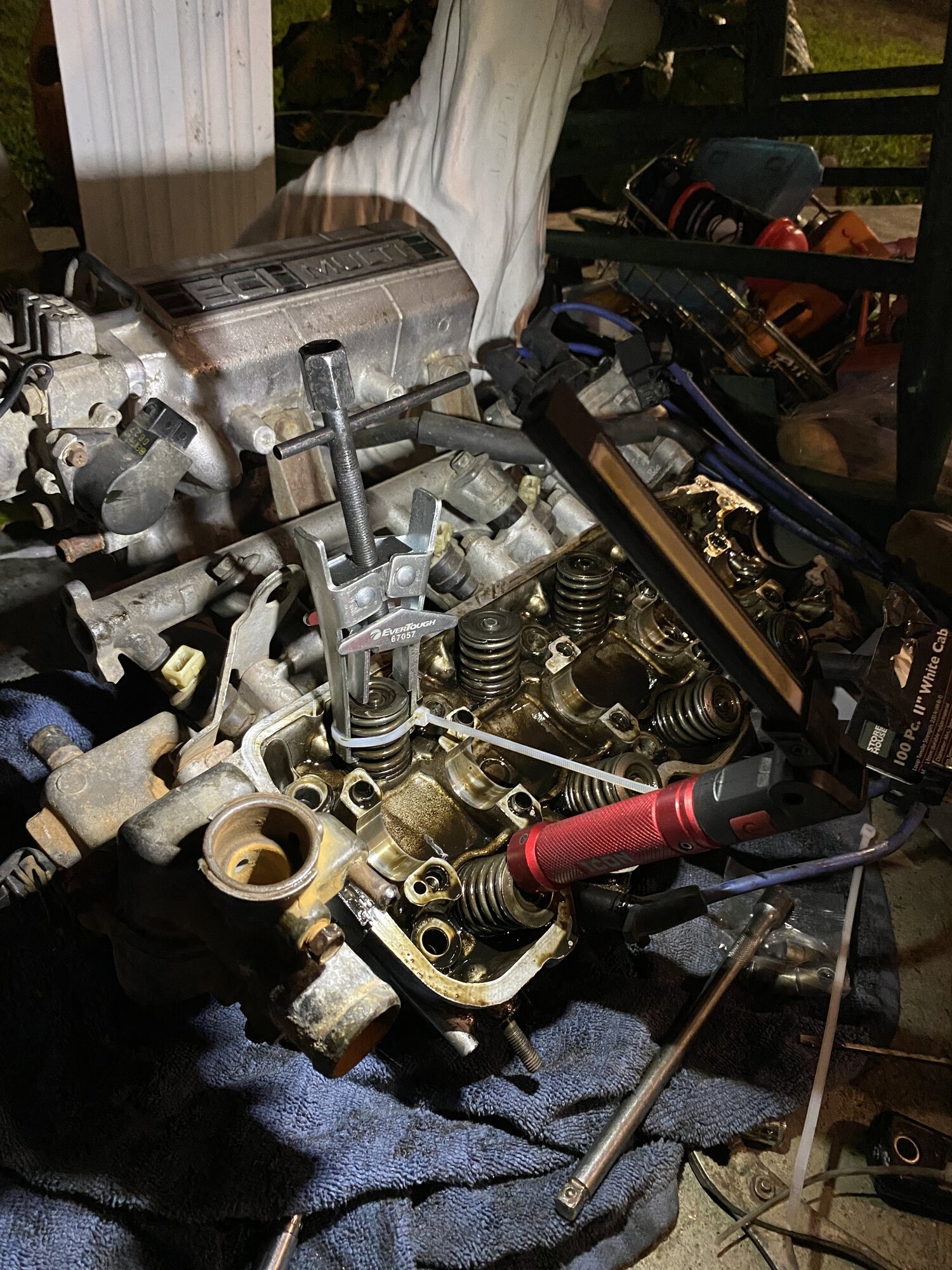

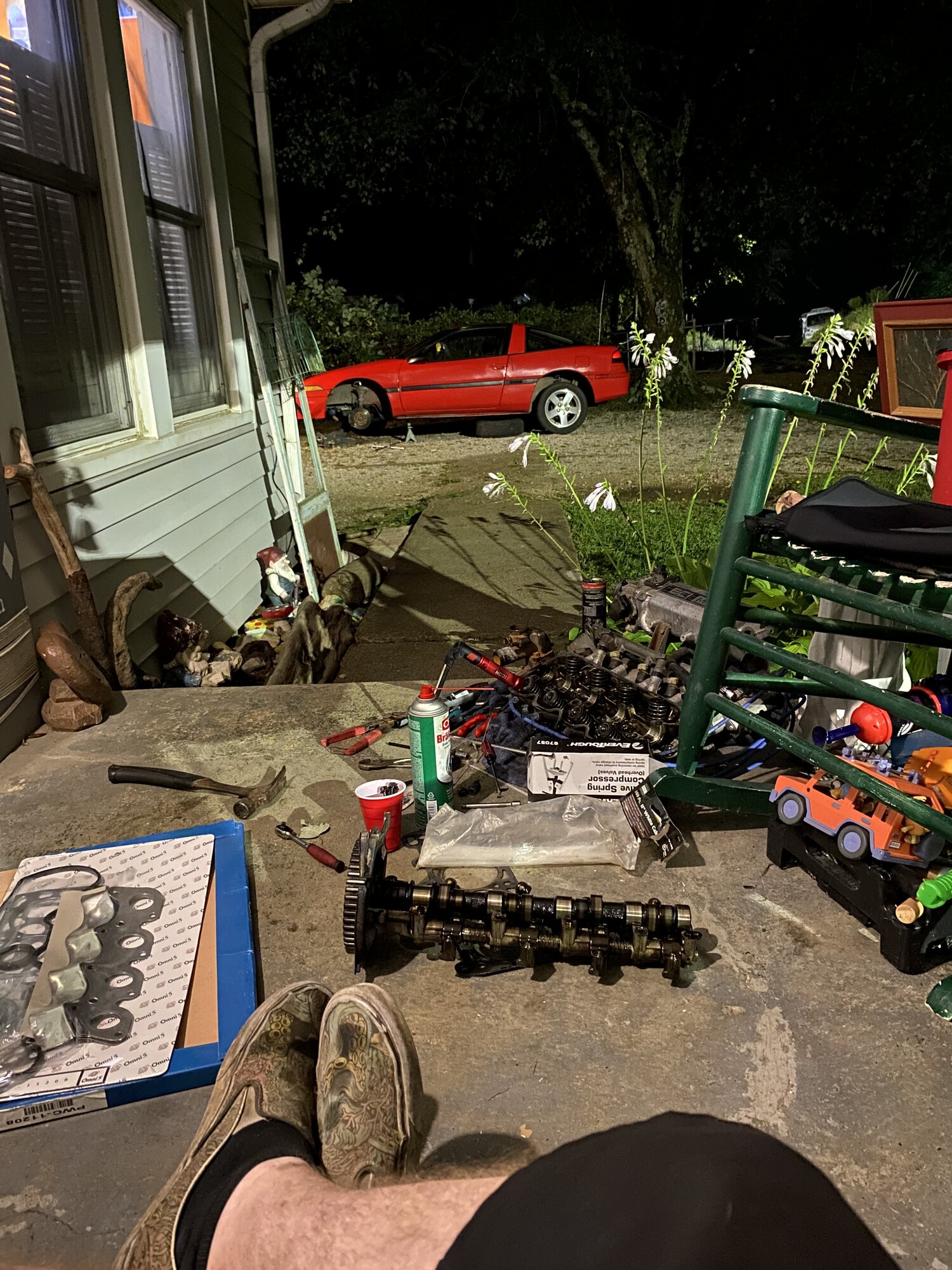

Hey guys, it’s been a while since I’ve posted an update and I’ve finally done some work to the car to give an update on😂.
Since I got my wife’s pathfinder running properly (cam/crank position sensors) i decided to finally tackle the head gasket! Well that and the oil finally became milky.. so yeah it had to be done😬

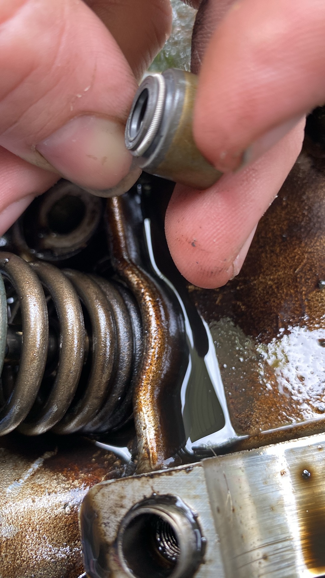

I decided I’d go ahead and relpace the valve seals, front main seal(old one was leaking heavily), balance shaft belt and timing belt along with the head gasket. And I did all this in my gravel tree-covered driveway 👌and the head work on the front porch😂. For the most part everything went as expected, the head gasket WAS blown between a coolant jacket and one of the 2 middle cylinders, and im assuming since I drove it so long using coolant I created the void that I found in the head that probably widened over time to the size it was.

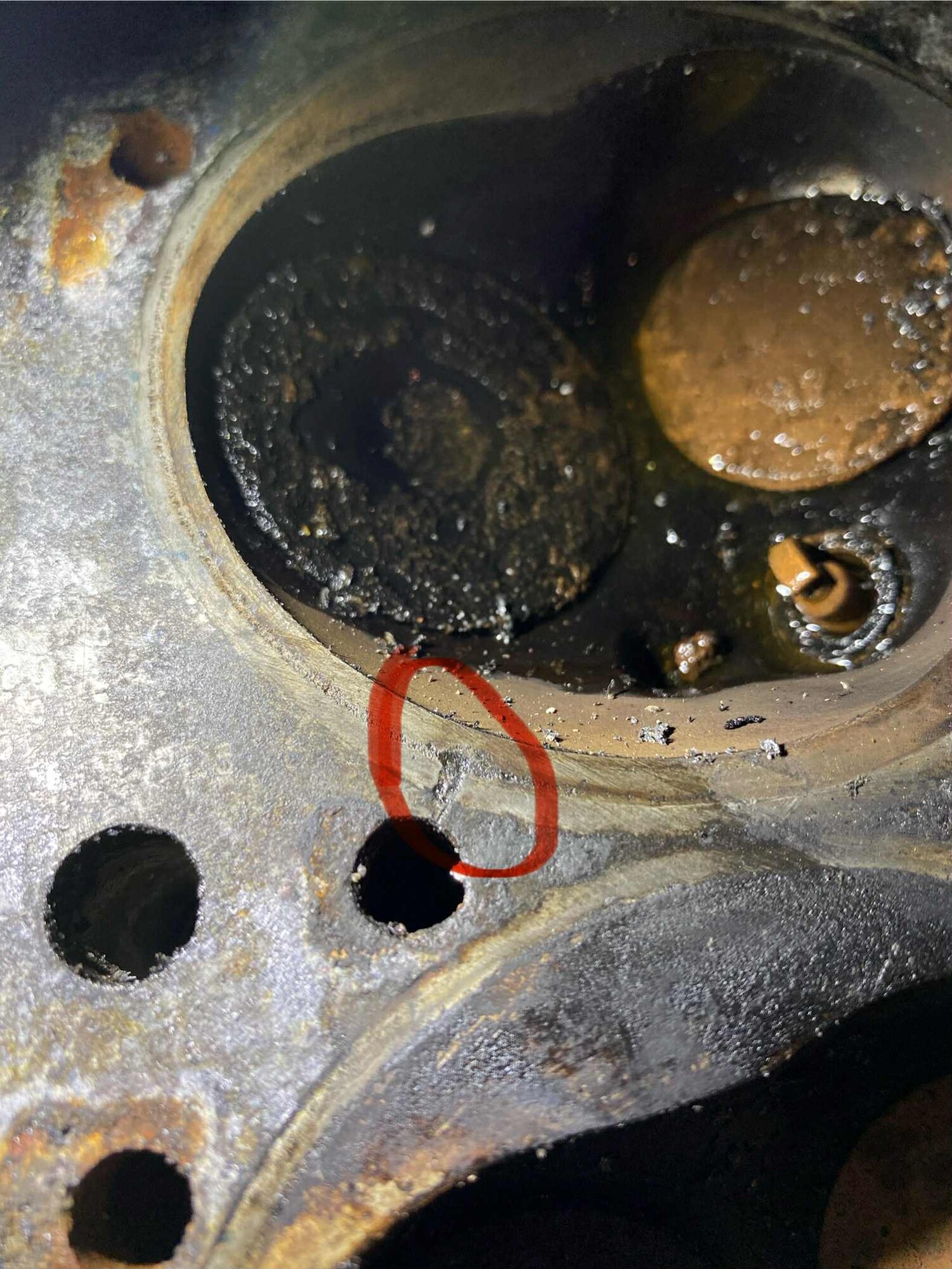

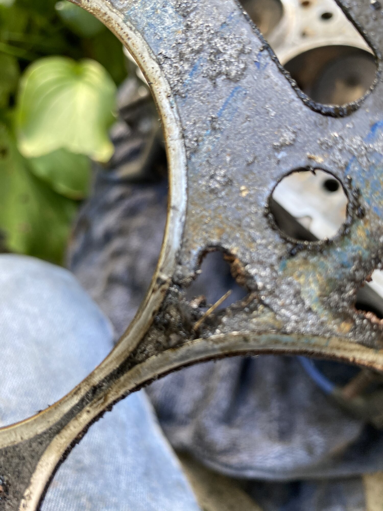

A smart person would get another head or have this one milled(although it was pretty deep). But I don’t have the money to spend at the moment to do either of those things so I figured the next best thing would be to fill the void with high temp jb weld and level it with the surrounding material👌.
Did it work? So far yes, but only time will truly tell. Im. Or consuming any coolant anymore, and I don’t seem to be burning or losing a significant amount of oil anymore either. I have only put about 100miles on it total since reassembly but so far it’s running better than it ever has since I’ve owned it!

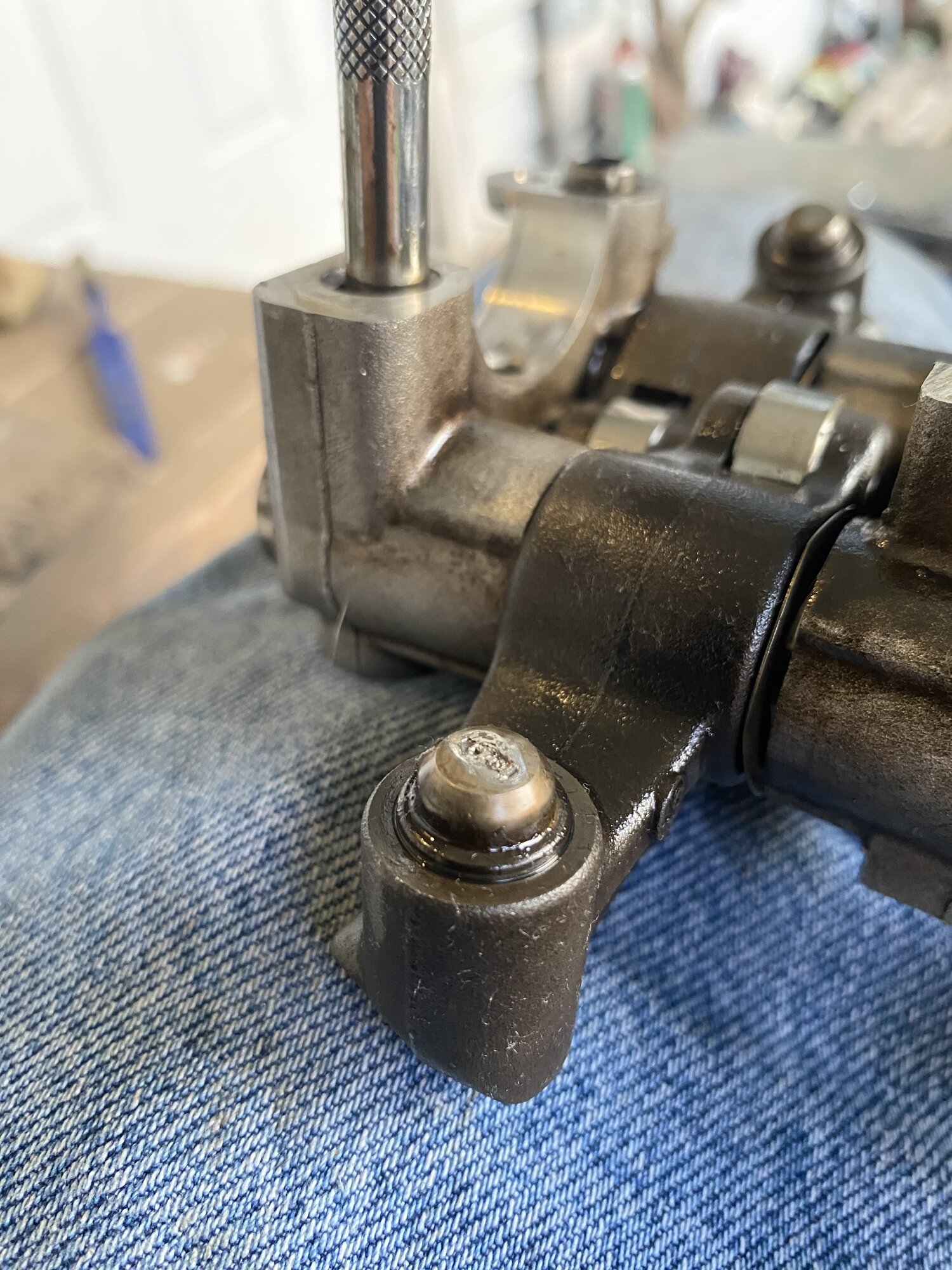

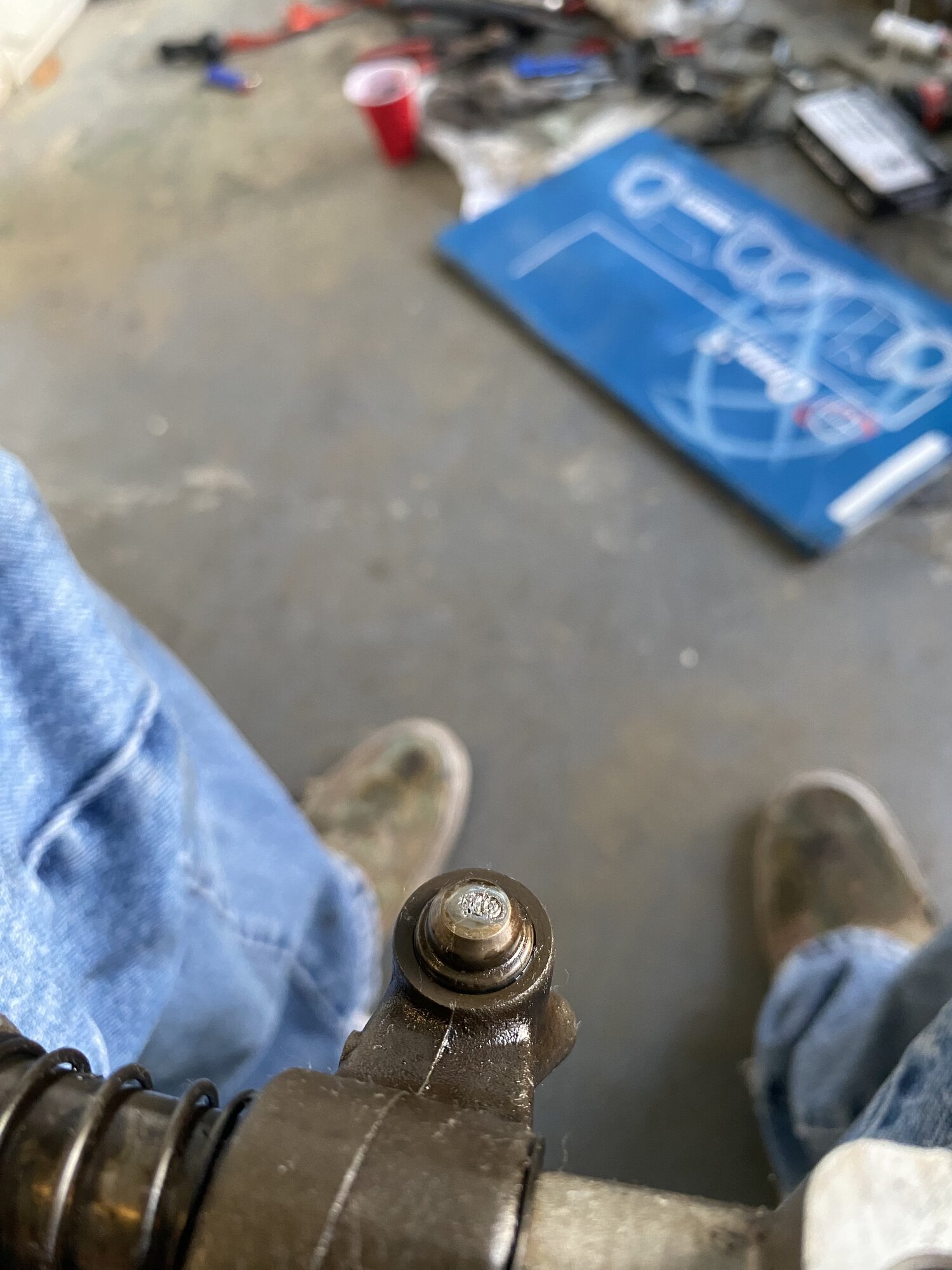

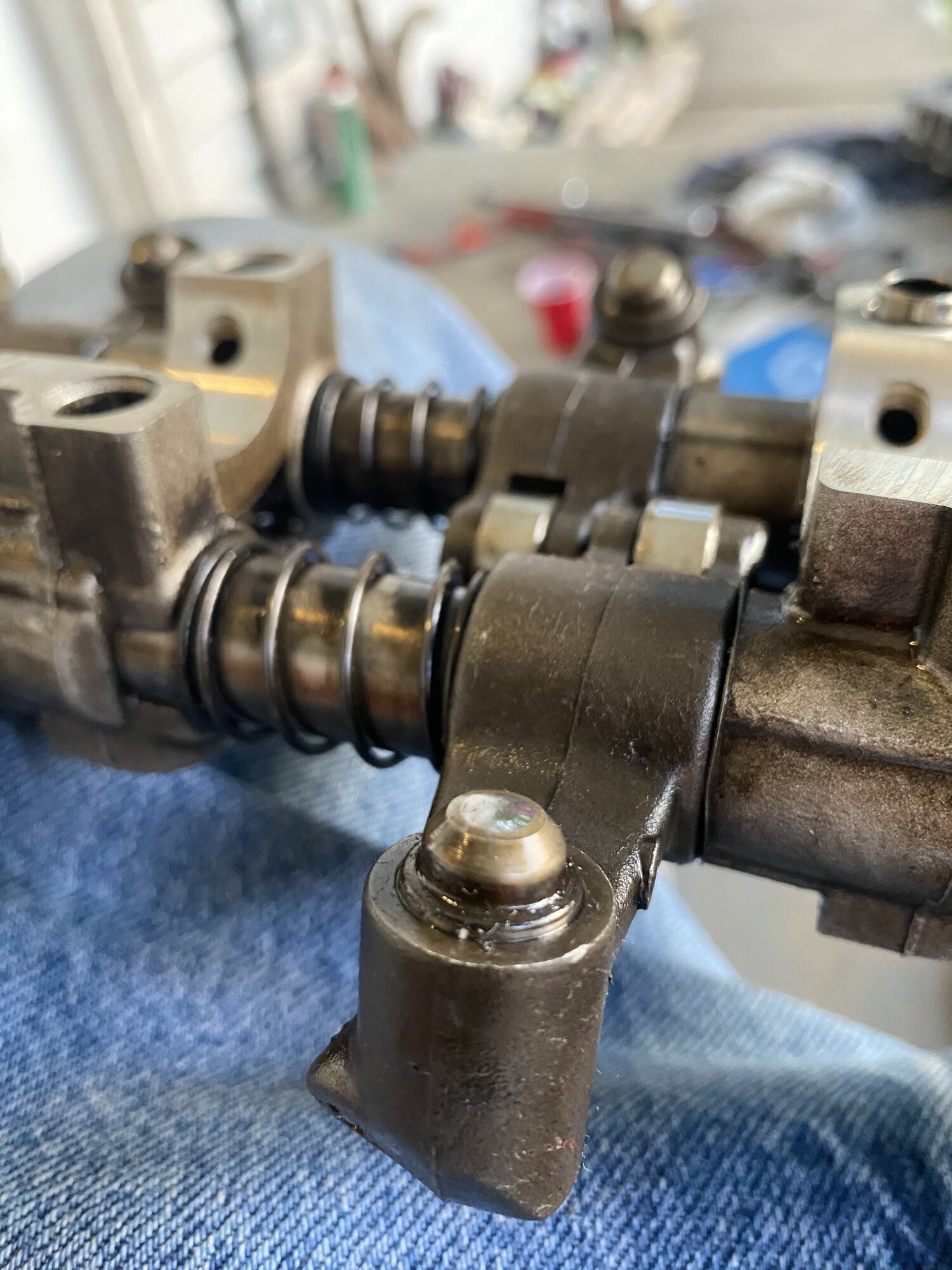

On another note my lifters/valve lash adjusters look trashed. I didn’t have any new ones so sadly these went back in. Surprisingly enough there is minimal valve train noise!
So yeah, it’s fixed, but it’s still more or less a ticking time bomb LOL. I plan on tracking down another engine or cylinder head sometime soon because I’m sure this fix won’t last forever.

I hope your luck is better than mine. I had terrible luck with my 4g37. I either had a cracked block or oil filter housing. It kept mixing coolant oil even after replacing the cylinder head. Hope that works out for you!
So far my oil looks good so hopefully it stays that way.

Well it’s been a while since I’ve posted(probably because there hasn’t been any good news😂)
The jb weld failed a few days after I posted my last reply. I tried to take the easy way out and try my luck with “bars head gasket stop leak” and it went about as bad as it could. The car started consuming way more coolant and missing on 2 cyl instead of 1 so the head had to come off again. I tried my luck with the jb weld again trying to be a bit more precise prepping the area and sanding it perfectly flat( tried leaving it a little high last time hoping to add clamping force by doing it and it was a mistake). I put the head back on and got it running again and so far I’m not losing any coolant BUT the cyl I did the repair on is completely dead now. No issues with the valve train anymore, I replaced the bad lifters on cyl 2 and 3, I tested for spark and it’s good, I moved the injectors around and the miss didn’t follow so all that leaves is lost compression in that cyl. I’m assuming the stop leak is to blame one way or another. Either so much coolant/stop leak got into the cyl that it stuck the rings to the piston or it hardened on a valve seat and isn’t allowing it to seal.
The car does still run on 3 cyl but I know that’s not healthy so I try not to drive it.

The only righteous repair is to have the block decked. That passageway between the top of the bore and the water jacket has gotta be milled away. I know that's a hard pill to swallow and a buncha work but from the other issues you've mentioned along w/the pics I'd say your rings have problee seen better days so the engine needs to visit the machine shop.
My 92 Laser w/a 4g37 and only 140k on the clock just died last night so I feel your pain man. When I say died, it was an ugly, smoke filled, oily death complete w/ some of the most horrendous mechanical squeeks, shrieks and groans you can imagine ... before it finally locked up. Was tryin to nurse it the 30 miles home and it made it to within a mile and 1/2 of the casa.
