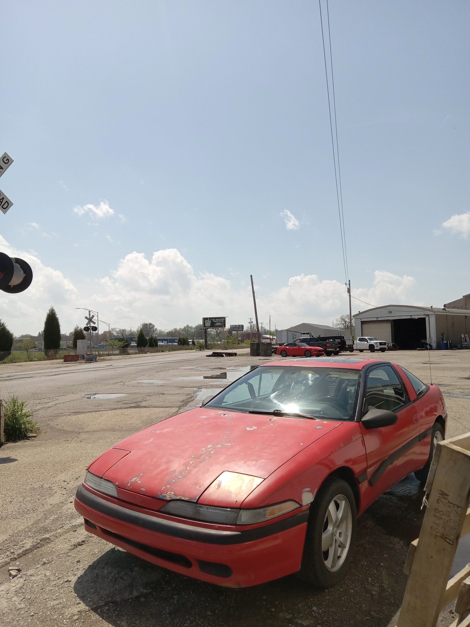

1991 Plymouth Laser Base
1.8 5spd
Update: Let's play the game "Where in God's name is all my coolant going?!". Is it all coming out of the top of the rad? Nope, replaced it. Is it the Oring on the cooland crossover pipe? Nah, just replaced it as well.. all hoses in good shape including the heater hoses+the 2 going to the intake...
I tried to idle my car with the coolant cap off today until the bubbles(trapped air) stopped.. it did not.. I ran it for like 40 minutes and they never stopped.
MAYBE the intake gasket could be leaking internally, but considering I've been pinging the shit out of this thing for the past 4 months I'd say the headgasket is probably the culprit. Gasket kit comes with the intake as well so it will get replaced too anyways.
Anywho... Yeah I'll be grabbing the cheapest Hg kit rockauto has to offer, so wish me luck😅

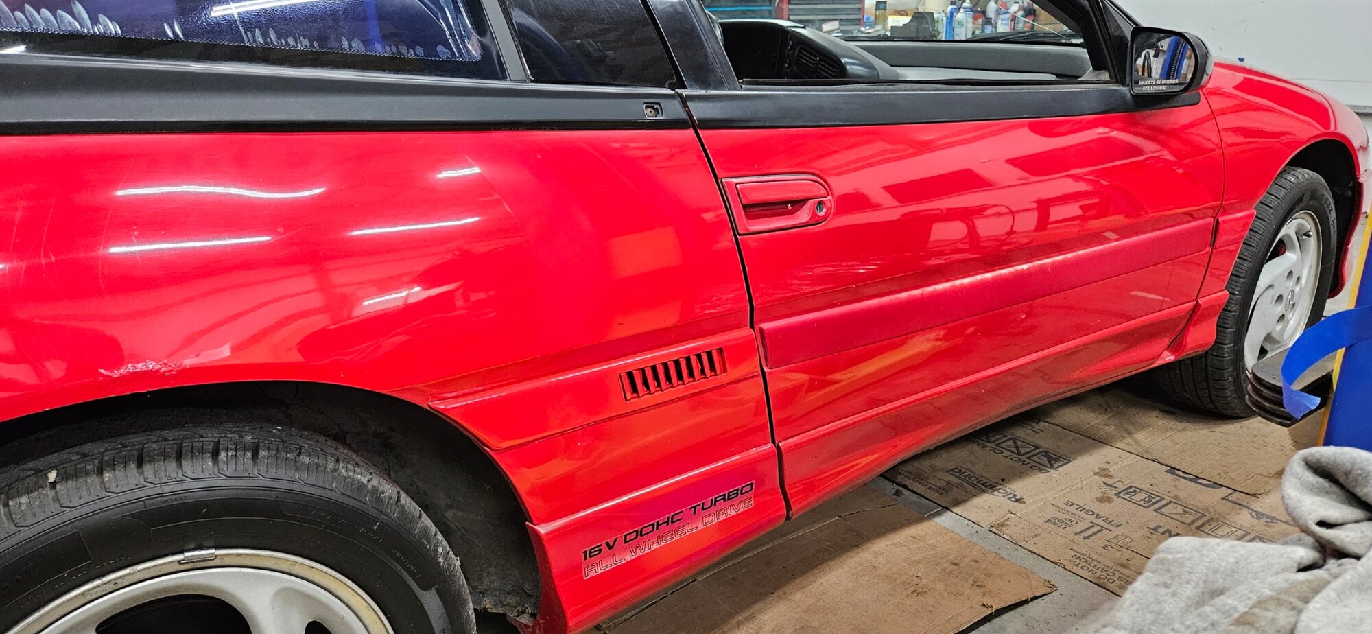

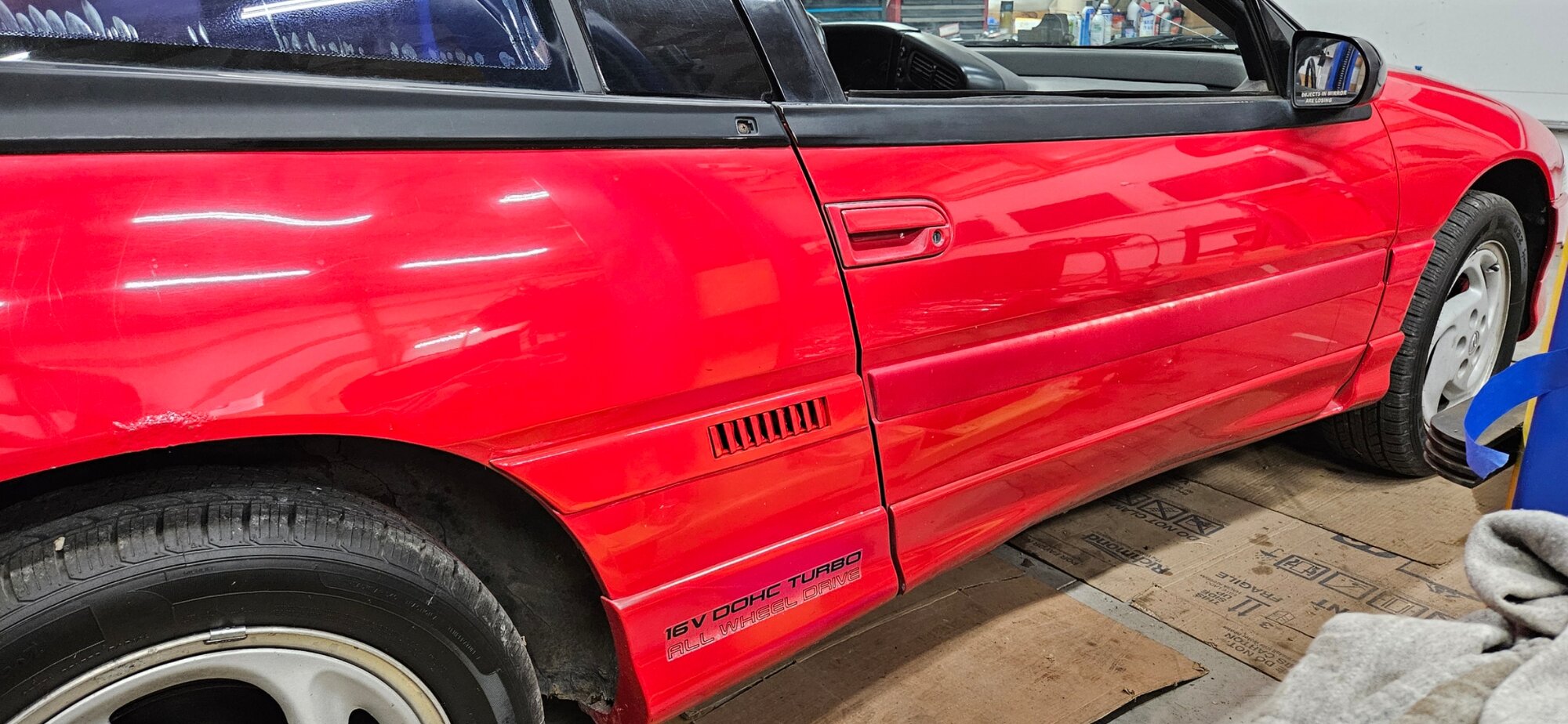

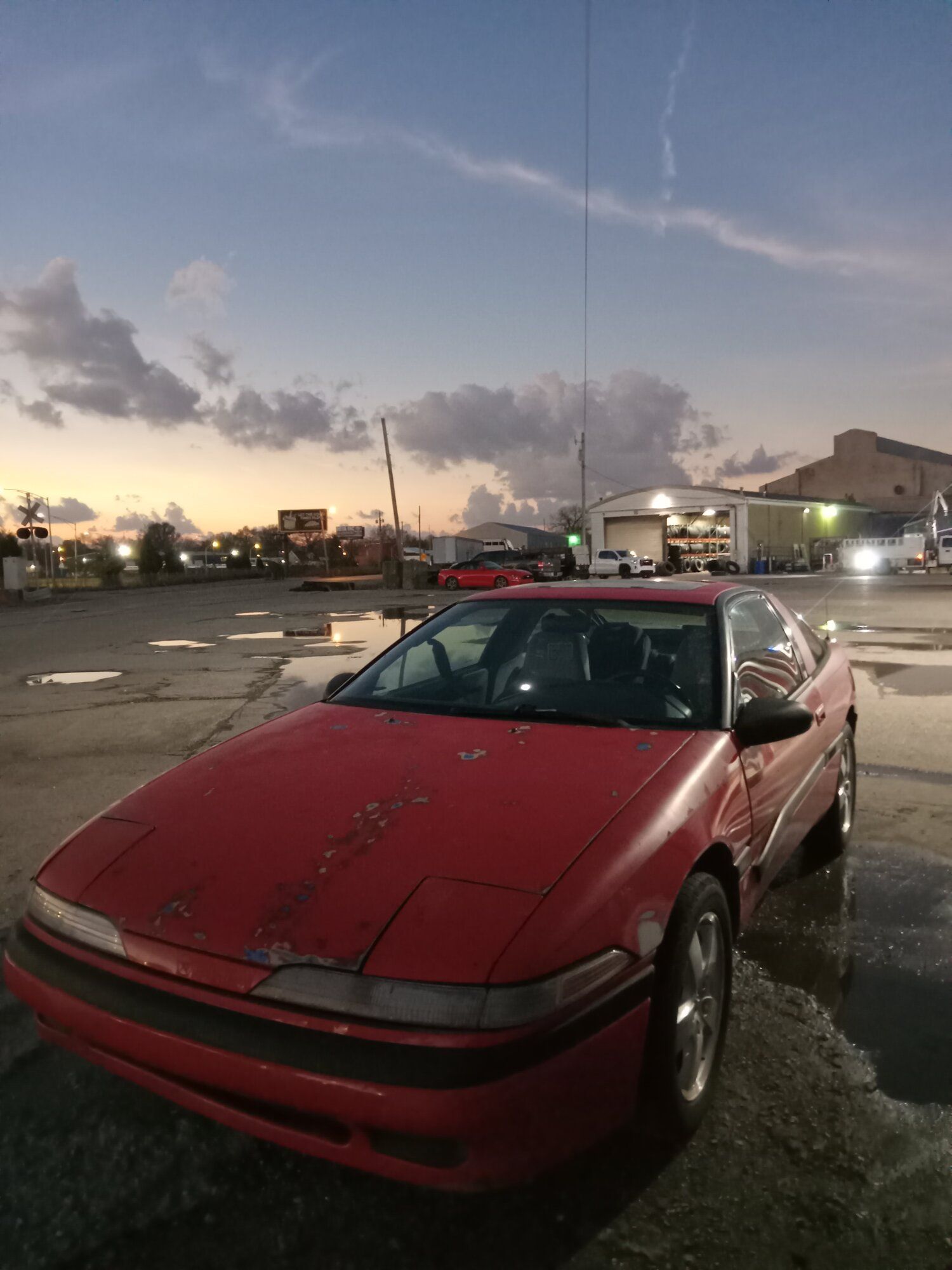

I want to thank you for your post of the Laser. I have a 1990 exactly like yours!
I used the Rustoleum Apple Red paint to touch up my 1990 TSI (Built the same day, same plant, same color but AWD not FWD like my Laser). That paint is a super close match. I needed to touch up some moulding on the Talon and the Apple Red paint looks GREAT!
Photos for comparison......
Thanks and Happy DSMing!!!
Marty

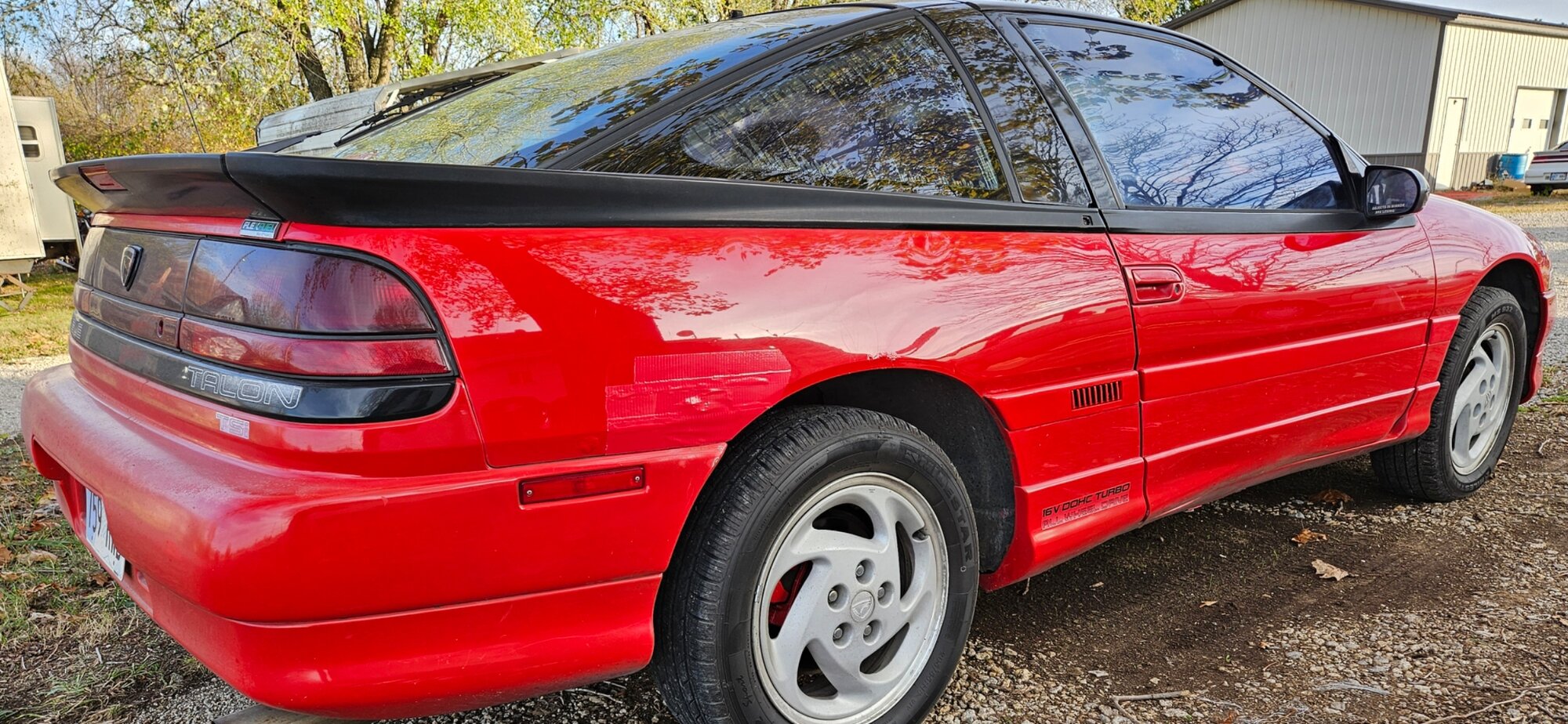

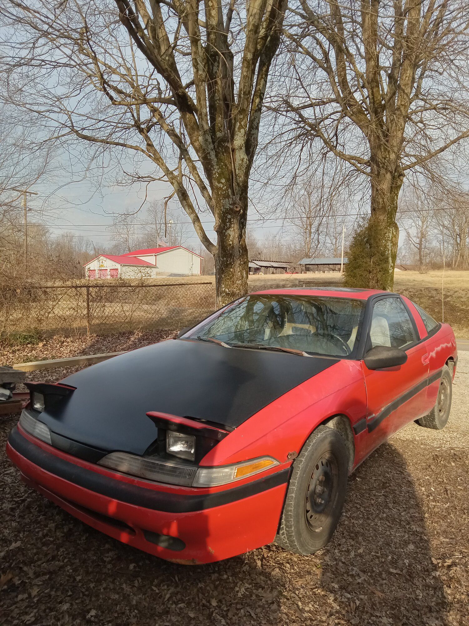

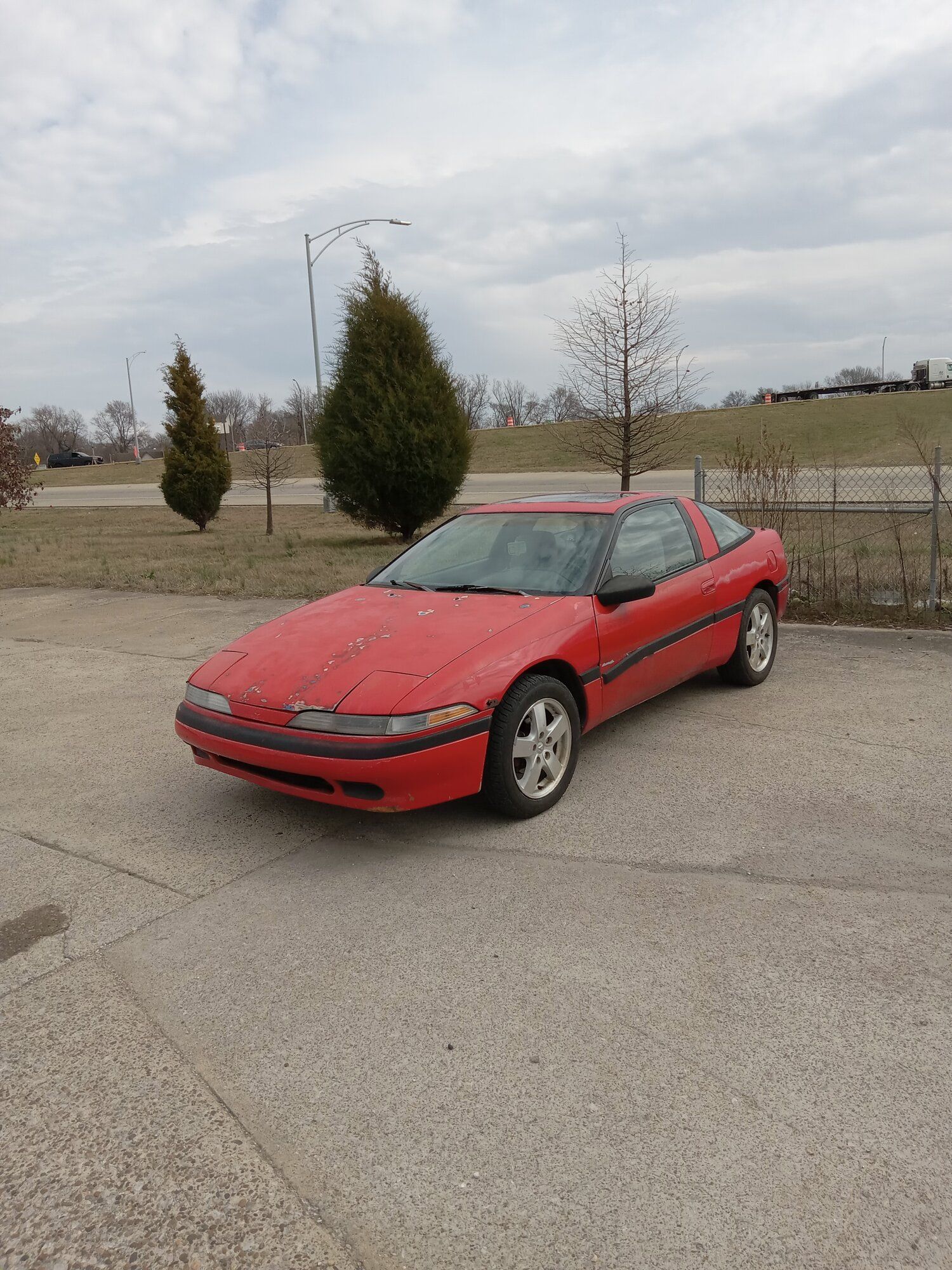

That looks great! And yeah I can't believe how close it is, my door jams match so well and I love it. I've painted 4 vehicles prior (rattle can, no doorjams) and to have it all look factory at a glance is just awesome to me.

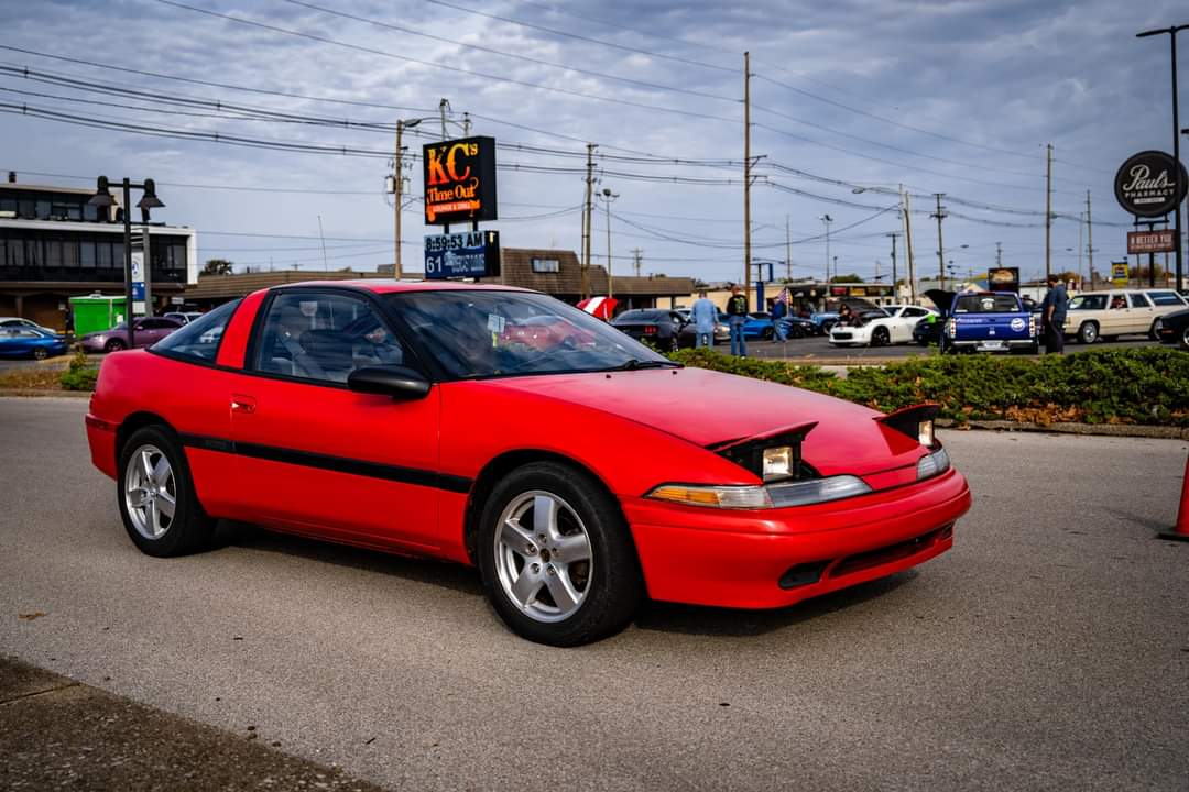

Oh man, a non-"power bulge" hood? I thought those were only in 89 but apparently it must be a 1.8 thing. I've never actually seen one in the wild.
I'm thinking they were on all 1ga 1.8 cars, then when they shifted to 1gb they all just had the same hood with the power bulge. Dont quote me though, these are mere assumptions based off dsms I've seen for sale over the years 😂.

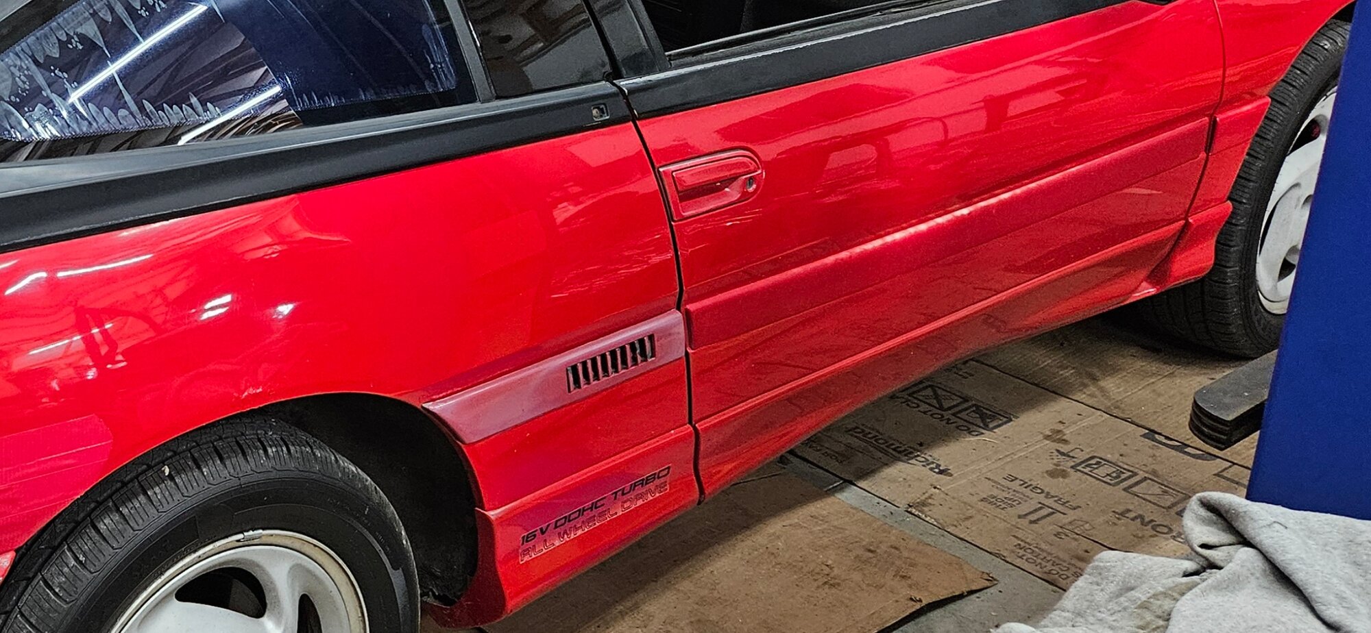

Your paint color, out in the sun, baking. I can't tell the difference unless I am at a certain angle. I went ahead and did the door moulding today. The front fender moulding is still faded so I will probably do it later tonite. I really do appreciate the car and posts about it. Lasers are cool and "unsuspecting". :cool: Mine is an RS.

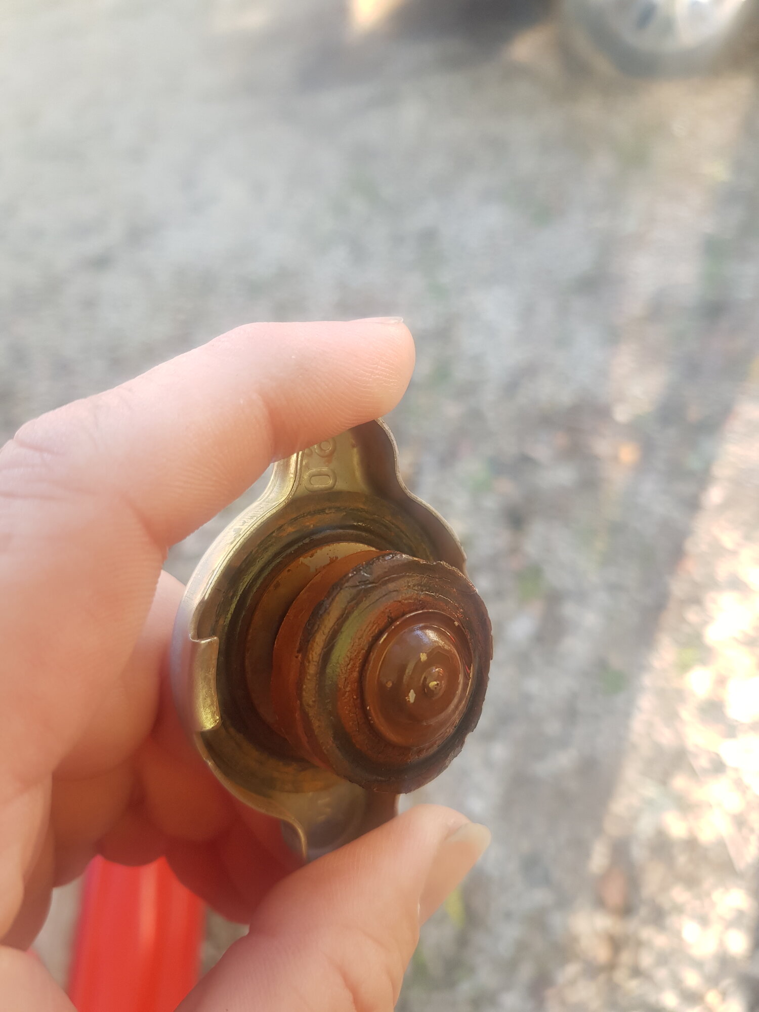

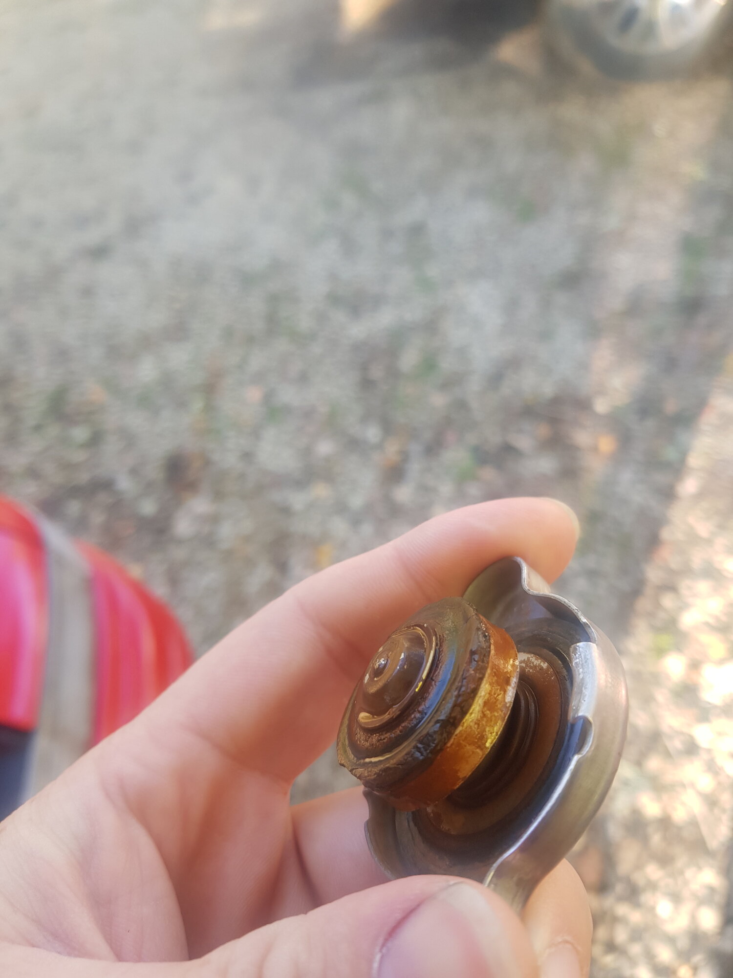

Pics of the cap
Is it only pushing it out of the cap/overflow?
That cap seal looks like "toast"...:hmm:
I agree, radiator cap is toast. Easy/cheap to replace and see what happens. Looks like it could use a good coolant flush, too.
Keep in mind, antifreeze has protection from rust/corrosion and also a lubricant for the water pump. So try to minimize how long you run strictly water (not to mention freezing conditions).

The bulge is 100% necessary on a 4G63 equipped 1G. On a 2G it's just for looks. You CAN cut the supports off the hood in that spot for the 1.8 flat hood to work, but it's flimsy AF and tends to be wavy near there.

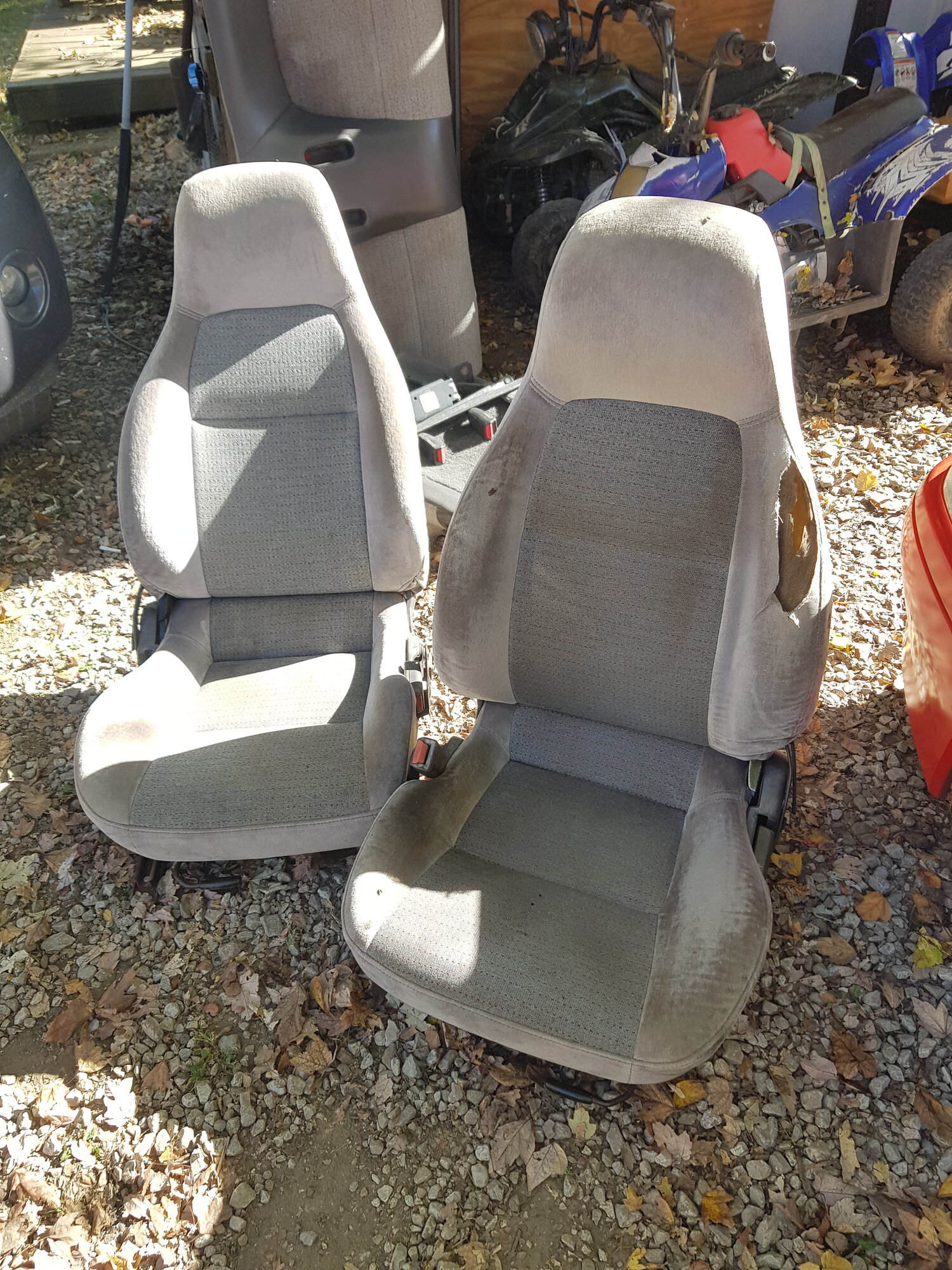

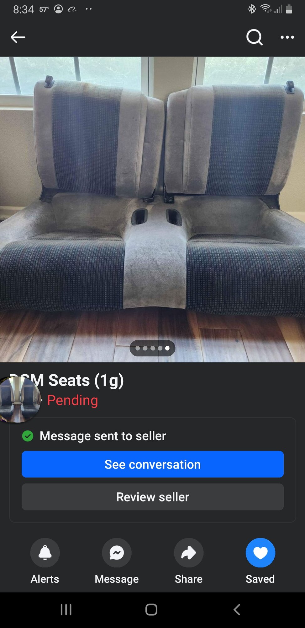

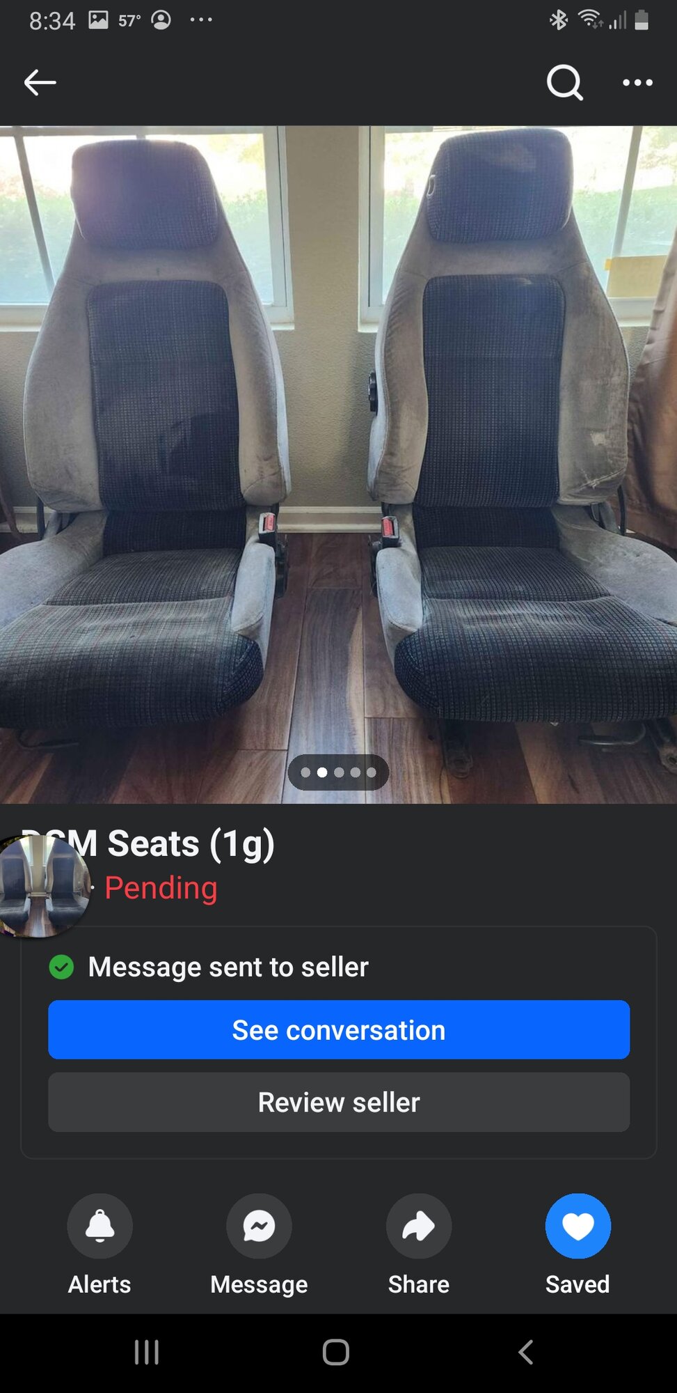

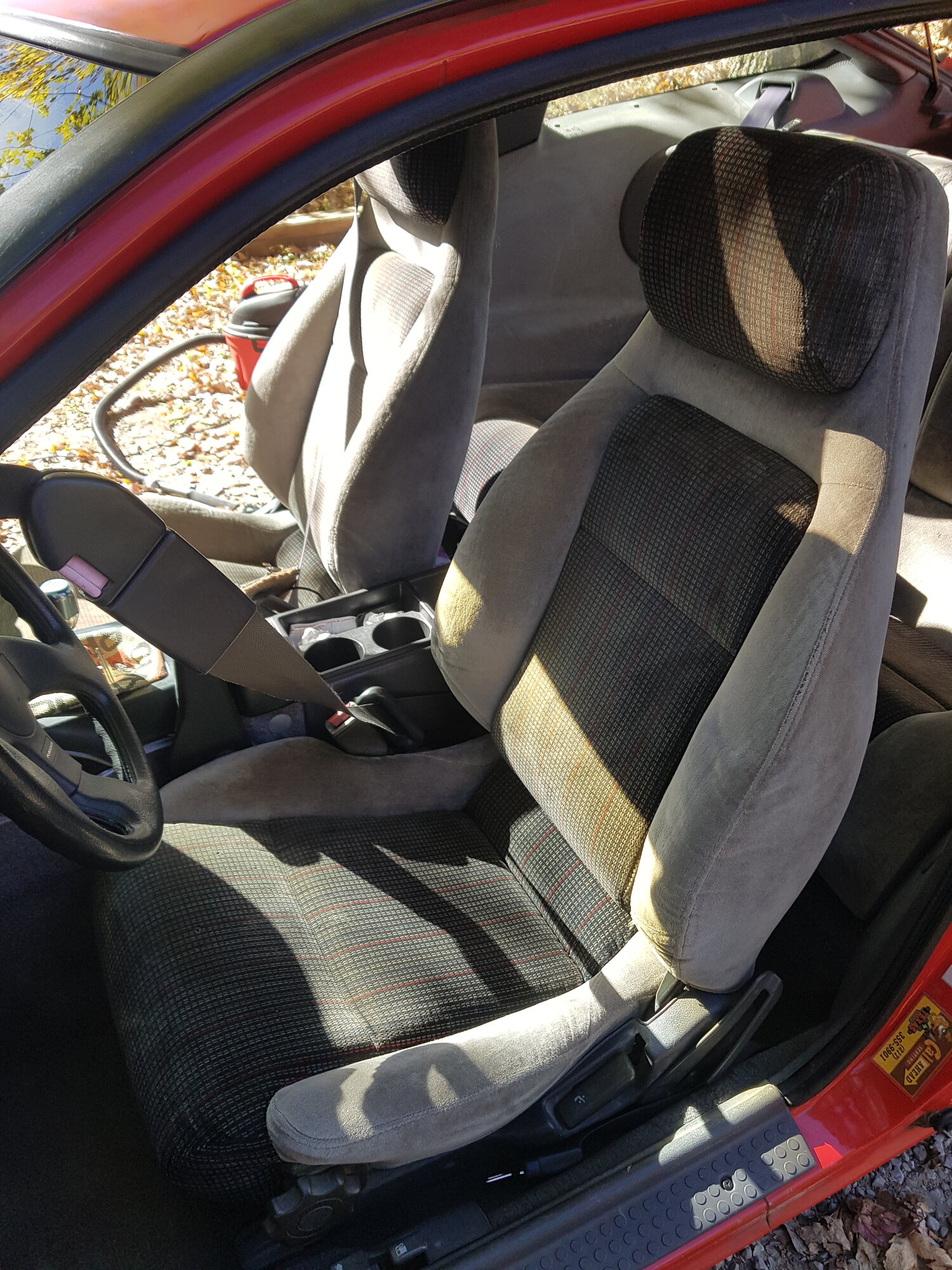

In lighter news I found some free seats from a turbo car on marketplace!! They're 3 hrs away from me and I'm going to grab them tomorrow, which I will also come back and post pics of them in the car later in the day.
Super sucks to hear about the surgery, man. But, just follow the surgeons orders and you'll be back up and doing backflips in no time. :p
Those seats are clean! Gotta love the cloth.

I just got the front 2 seats in but it's too dark now to take a picture so I'll have to tomorrow after I get the tears in. I love them though, the bolsters are so nice and these have adjustable lumbar as well so that's nice😅

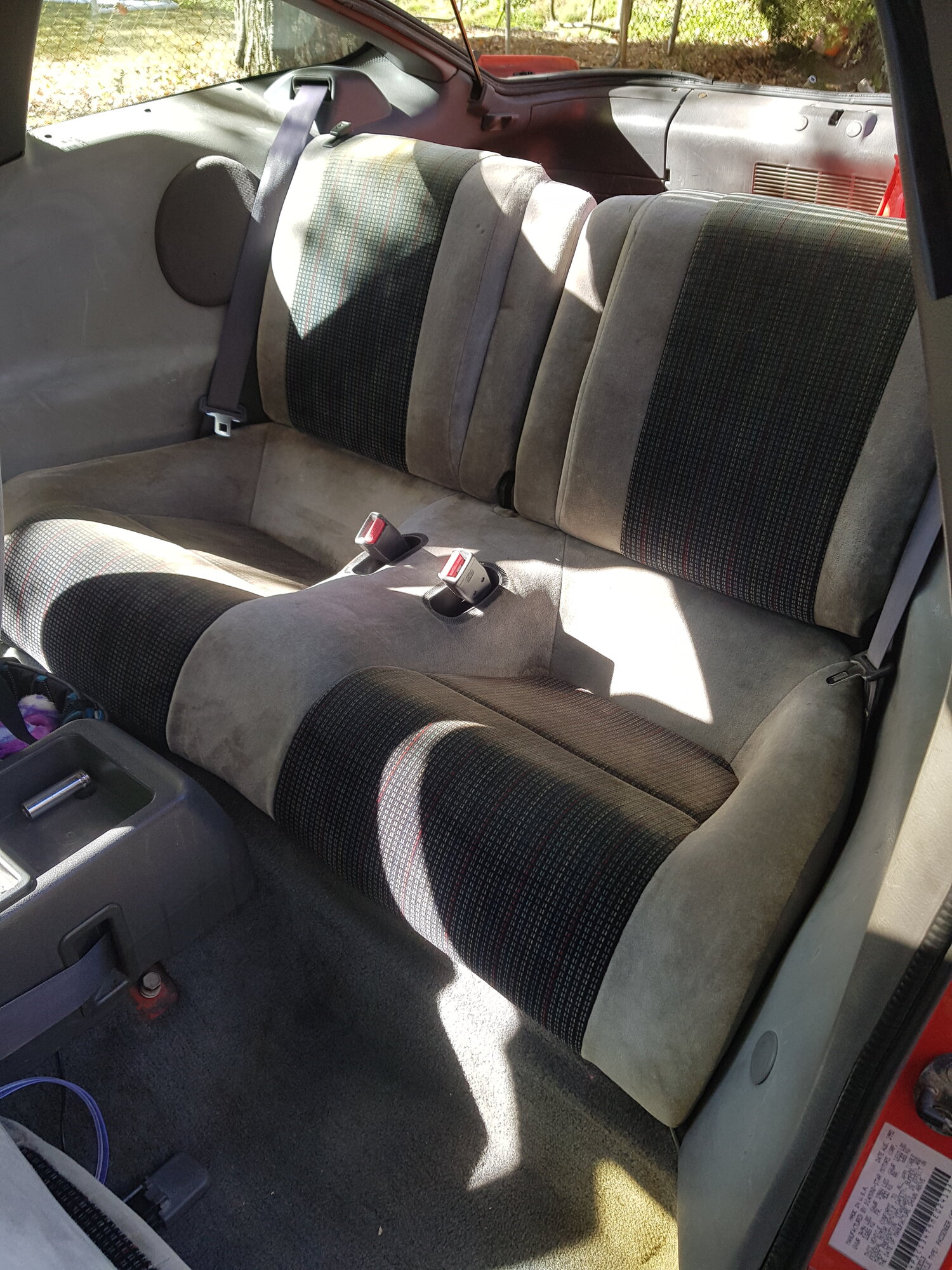

Update:
Got them cleaned up and installed, they're not perfect but their in better shape than my old ones plus they're a hell of an upgrade over my factory base seats. Of course I forgot to take a before picture, but here they are outside the car.
I'm quite pleased with them, as are my kids LOL.

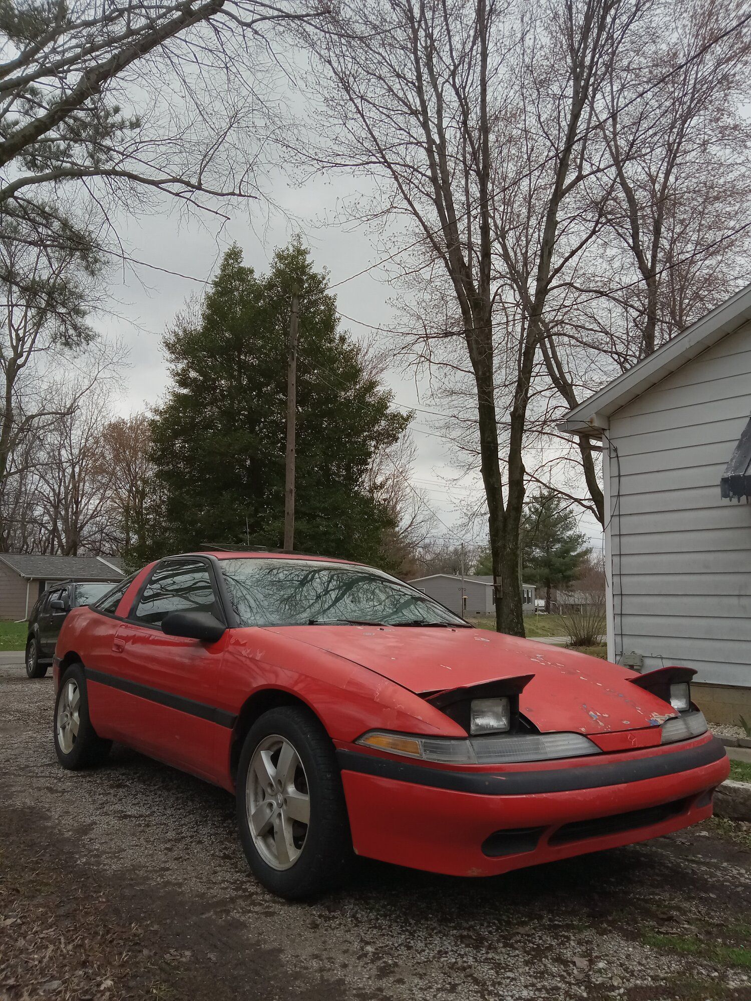

Boy your car turned out really good. I want to say thanks again, I can't tell what I painted on my 1990 TSI, can anyone else? I ordered more paint just for matching when I do the body work on that back fenderwell.and replace the hatch on my 1990 Laser RS that got hurt. The duct tape on my TSI kinda lures in the unsuspecting souls.....and keeps the birds nests out :oops: ROFL

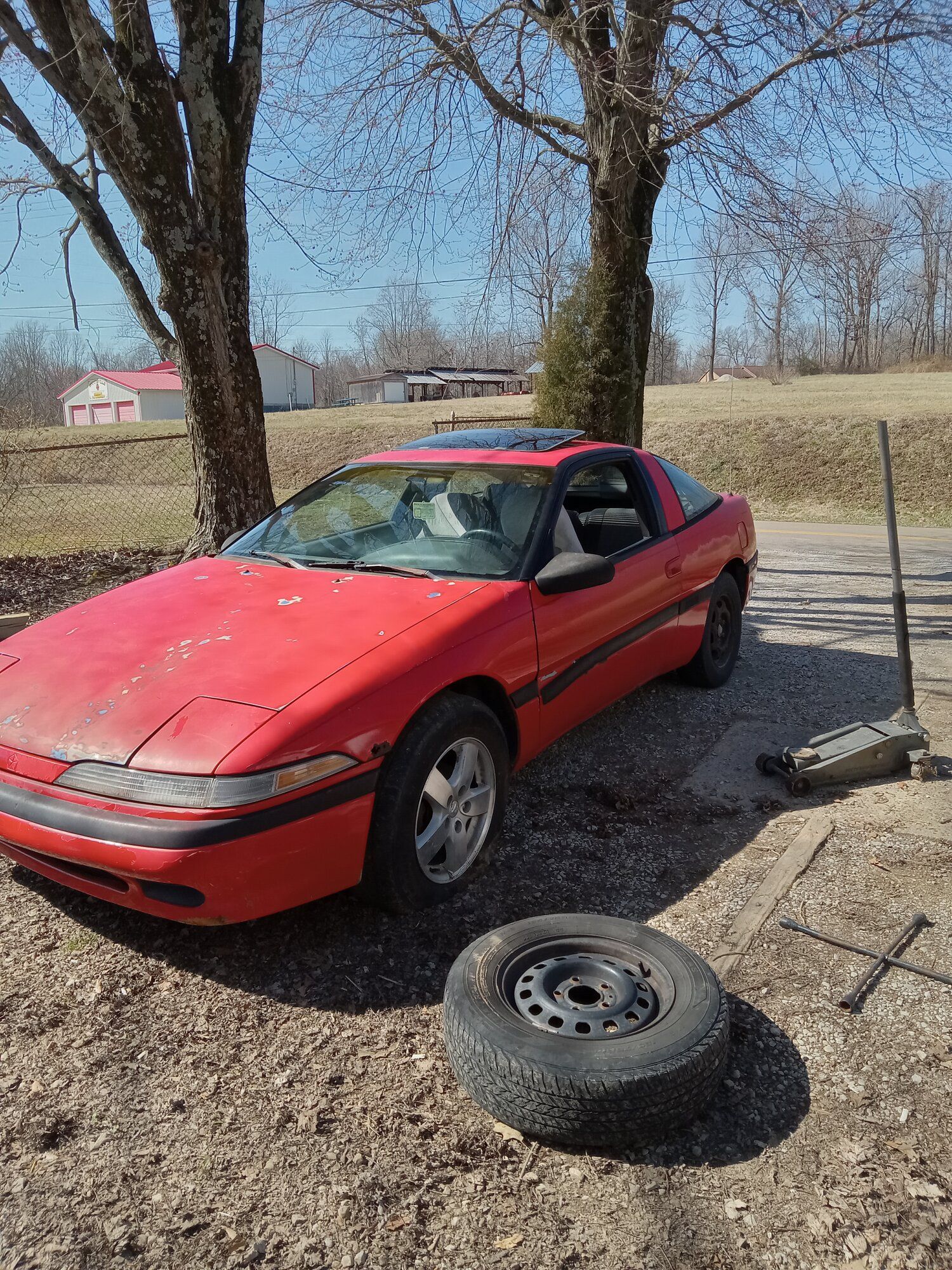

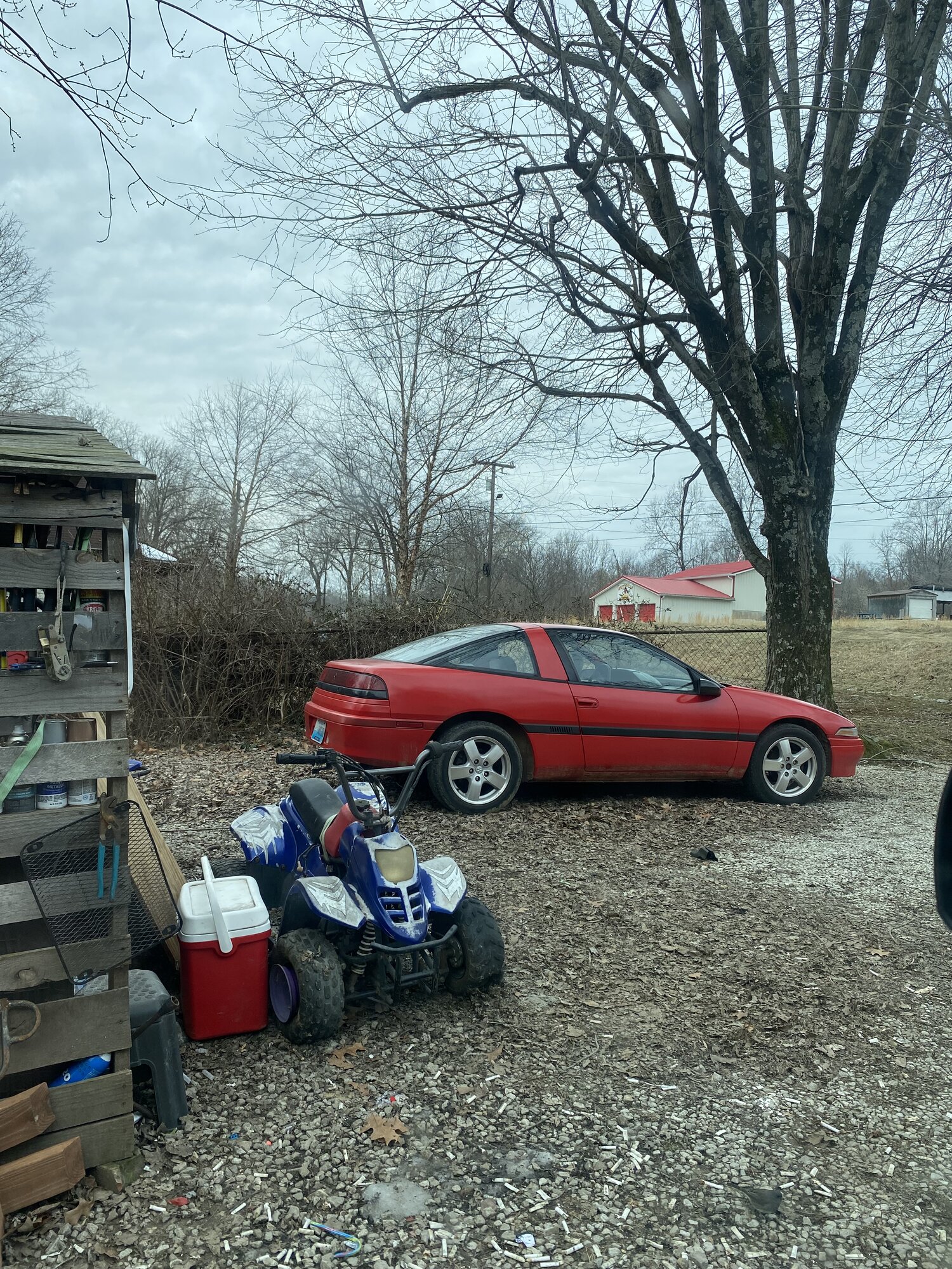

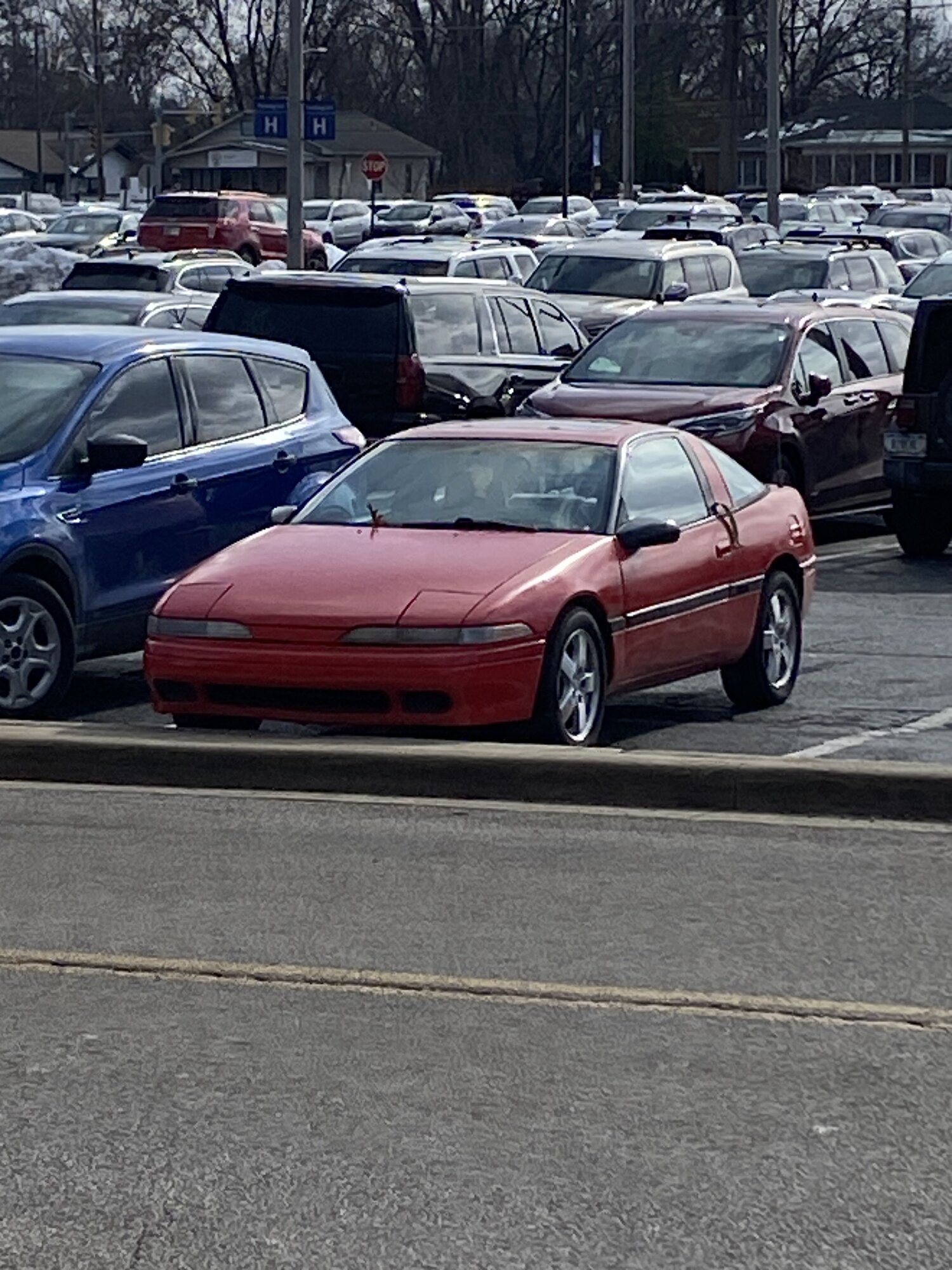

Recovery from spinal surgery has been an endeavor but I’m finally getting back to my normal routines mostly. Today I decided I was going to drive my car for the first time since my surgery back in November, finally! Not that I haven’t been driving at all, I’ve been driving my wife’s 2010 pathfinder since I was 3 weeks post op. The surgery corrected the angle of my lower spine via L5-S1 spinal fusion. Before the surgery I had severe compression on the nerve for my left leg, making it difficult to press in the clutch or hold it down from time to time… Today I got in my car and had no issues at all pressing the clutch, or holding it in. In all honesty the car overall is alot more pleasant to drive than the pathfinder even with my healing state. The pathfinder tosses me around everywhere where the laser actually has bolsters that hold me in place.
Anywho the car did great. I threw a battery in it this morning to take my kids to school in it and after like 2 straight minutes of cranking it finally stumbles to life😂 I should probably mention that it was only 9degrees Fahrenheit this morning so tbh I’m happy it started at all. I drove it for what seems like most of the day running errands and had no hiccups what so ever… until my alternator stopped charging about 7 miles from home..😂 thankfully the battery just barely got me in the driveway.
I’ll be looking into that later in the week when the temp decides to move out of the single digits, but I assume the alternator is bad. No telling when it was last replaced.

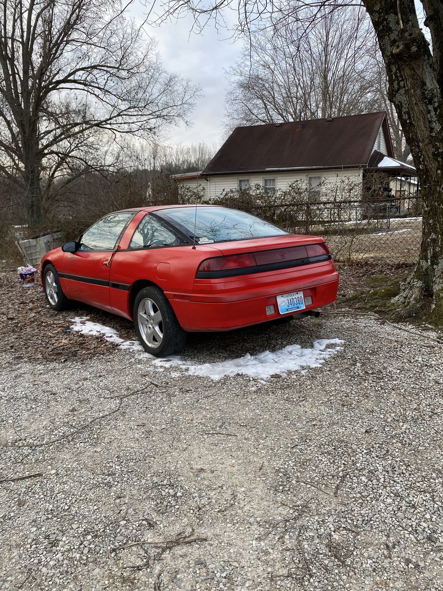

Here’s a few pics of the car from today and one from all the snow last week. Also threw in my X-rays I just got a few weeks ago that show the brackets, it’s gnarly.

The car is looking very good and I'm happy you can drive her. My 90 Laser looks exactly like yours (minus a hatch glass that a tree limb took out a few months ago so I have her sealed up with 8 mil plastic sheeting).
I have a spare hatch when it gets warmer :thumb:

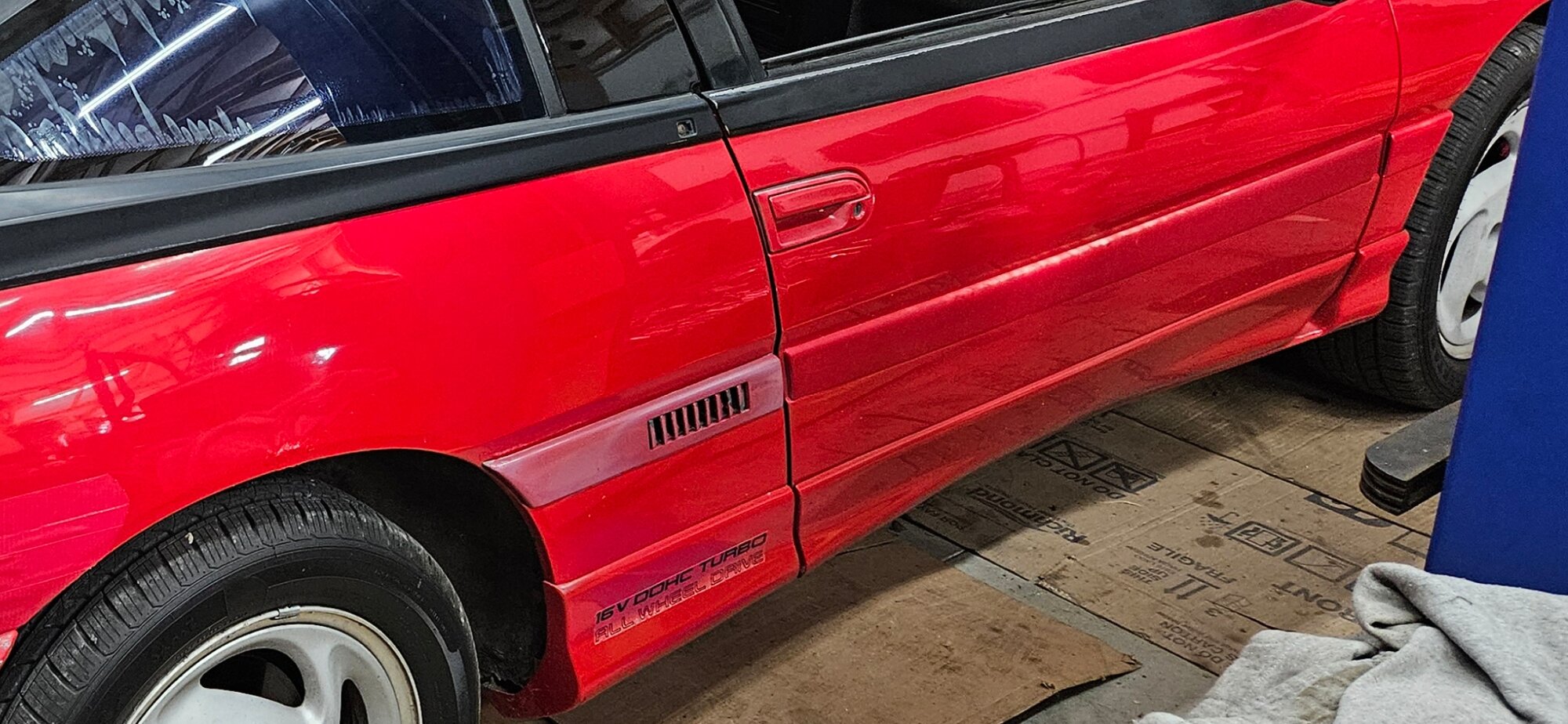

How did you reattach your door side moulding? I need to fix a couple myself.

Car coming along great though! I love how beastly even the FWD versions of my beloved 1Gs are in the snow.

As for the side molding that I reattached..
I had been telling my wife that I needed some double sided tape for that and she took it upon herself to pick me up some from the “as seen on tv” section in our local dollar store(we live in the middle of nowhere). I don’t have the package anymore but I think it’s called Alien tape or something silly😂 some really chunky and kinda stretchy double sided tape that I assumed at first would hold for like a week. But here we are, half a year later and it shows no sign of movement😂😂😂
My advise would be a 3m double sided tape from an automotive paint store, I believe that’s what we used at the collision shop I used to work at.

As far as snow, I never actually took it out when any was still on the roads, it had all dried up mostly. And thankfully, my tires are suuuper bald, like bad enough to be sketchy in the rain, I don’t think they would make it far on all the ice we had.
