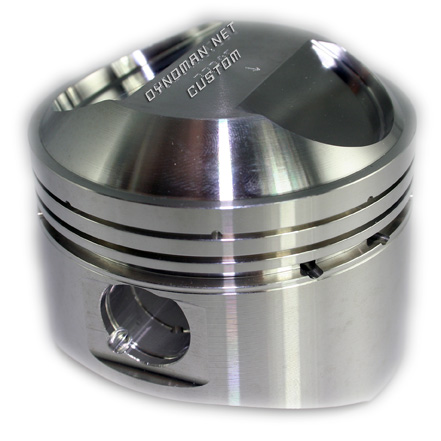

First, I know what a piston is called in relation to the cylinder. Trust me. http://www.dynoman.net/images/engine/piston/customPiston1.jpg BUT, because I hate you analytical ####s can you click on the link above and tell me what SHAPE that is? The cloud of white smoke is from the overflow most likely, It could also come from a burst hose. I've never seen a head gasket so bad that its shooting steam from between the head and block BUT, show me a picture. I'm down for learnin.

Now, on to the analytical part: A spark plug can't ignite coolant... Its the fuel and air that actually burn first then take the coolant with it. And after reading the second part of that sentence. I'll ensure you know you are retarded and leave it at that. Good luck on working on your car.:thumb:
