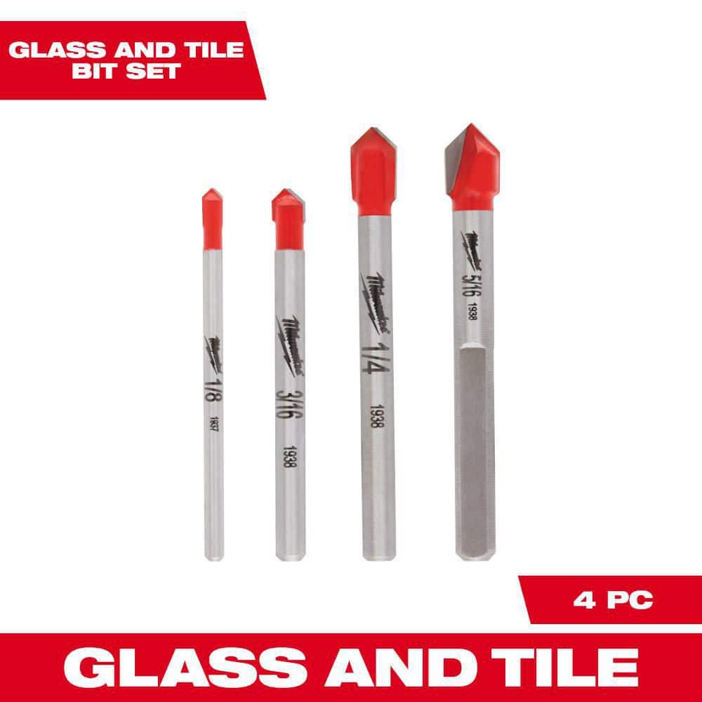

Go to Home Depot or Lowe's and get carbide-tipped tile bits. They're super cheap and cut through steel like butter. Recently came across this revelation when tyring to extract a bolt out of my block and found a random post on the internet.
Is this to extract the stud or just bore it out of the hole?
