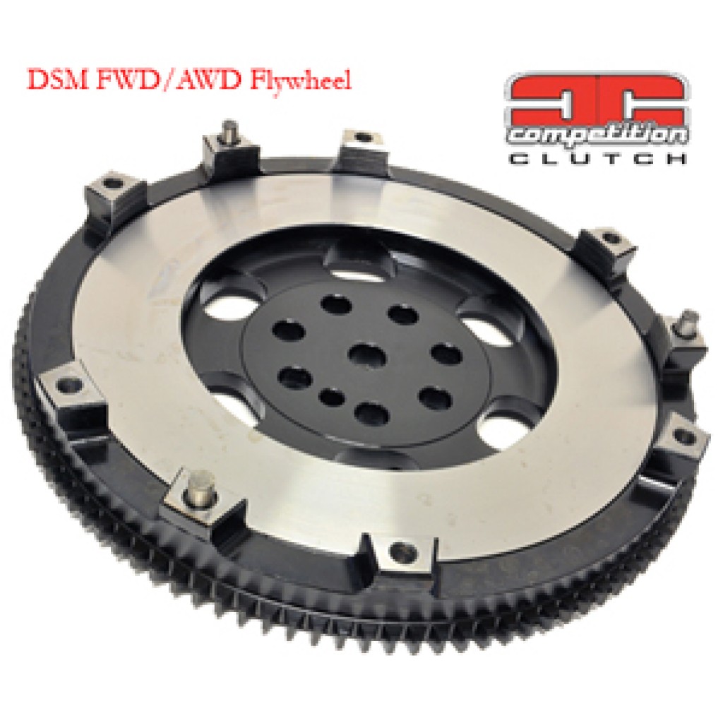

Would these me compatible?
Flywheel
Clutch

I said the flywheels from ACT and Comp Clutch are dimensionally the same, there are differences in between them, but step height, and overall dimensions and weight are pretty much the same.
7-bolt FWD - 110 teeth, stepped flywheel with 0.608-0.610" step height.
ACT - 600165
Comp - 2-735-4ST
