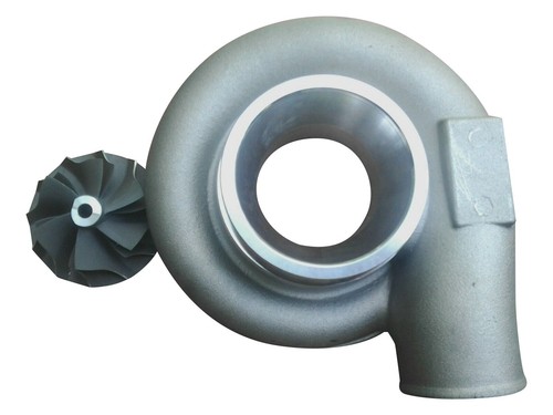

1G Upgrade evo 16g to downfiring 20g comp housing and wheel. Possible? Worth it?

What do you guys think?
There's so many damn 20g options out there that it can be hard to find good info on them. Back in the day I had a sleeper 16g or "bastard 20g" and it was great but I'm even more curious about trying the downflow compressor housing 🤔. Experiences? Opinions? Thanks
That particular compressor housing does nothing except require a 3" (or larger) intake pipe and make it about impossible to affix an internal actuator to the cover.
The Big 16G (Evo III), 18G, and 20G wheels all have the same exducer...so they're just the same series of wheel with a larger inducer spec, meaning their trim calculations are different. That said, if you're looking to upgrade you'd generally want to shoot for the wheel with the compressor map that suits your desired pressure ratio. Where that gets complicated is potentially running out of turbine flow at a given pressure on whatever type of fuel you're running. So a 20G on an unclipped TD05H turbine is going to yield much more of a noticeable power increase over a 16G if you're running race fuel or ethanol compared to pump gas....otherwise the 16G is likely to "feel" faster due to it's quicker response.

I tried that exact housing and wheel on my evo 3 16g. I fabbed up a wg actuator bracket for a cheap actuator. Required drilling another hole in the housing to relocate it. Had to trim a small amount off the fan for clearance. Like already stated, its a bit laggier. I never really got to play with it too much before starting my awd swap so I can't say much about it other then the torque hit of the 16g was gone. It felt like it had more potential up top but then again my 16g tune was never too crazy either .. 20lbs on 91.

Bring this back from the dead. I picked up a E3 16G but don't have a j-Pipe. I'm looking to swap the comp cover for a down firing one so I can hook it up to my FMIC. Is a 20G cover a direct fit for a 16G? I don't want to swap the comp wheel. I just want a down firing cover. Is that do-able?
I've seen down-firing 16G compressor covers on MAMBA Turbo and Kinugawa USA.
