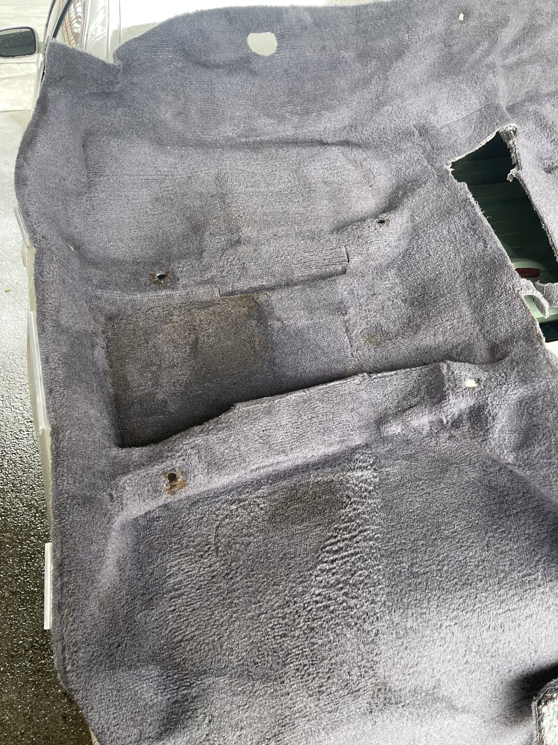

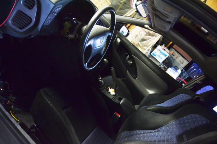

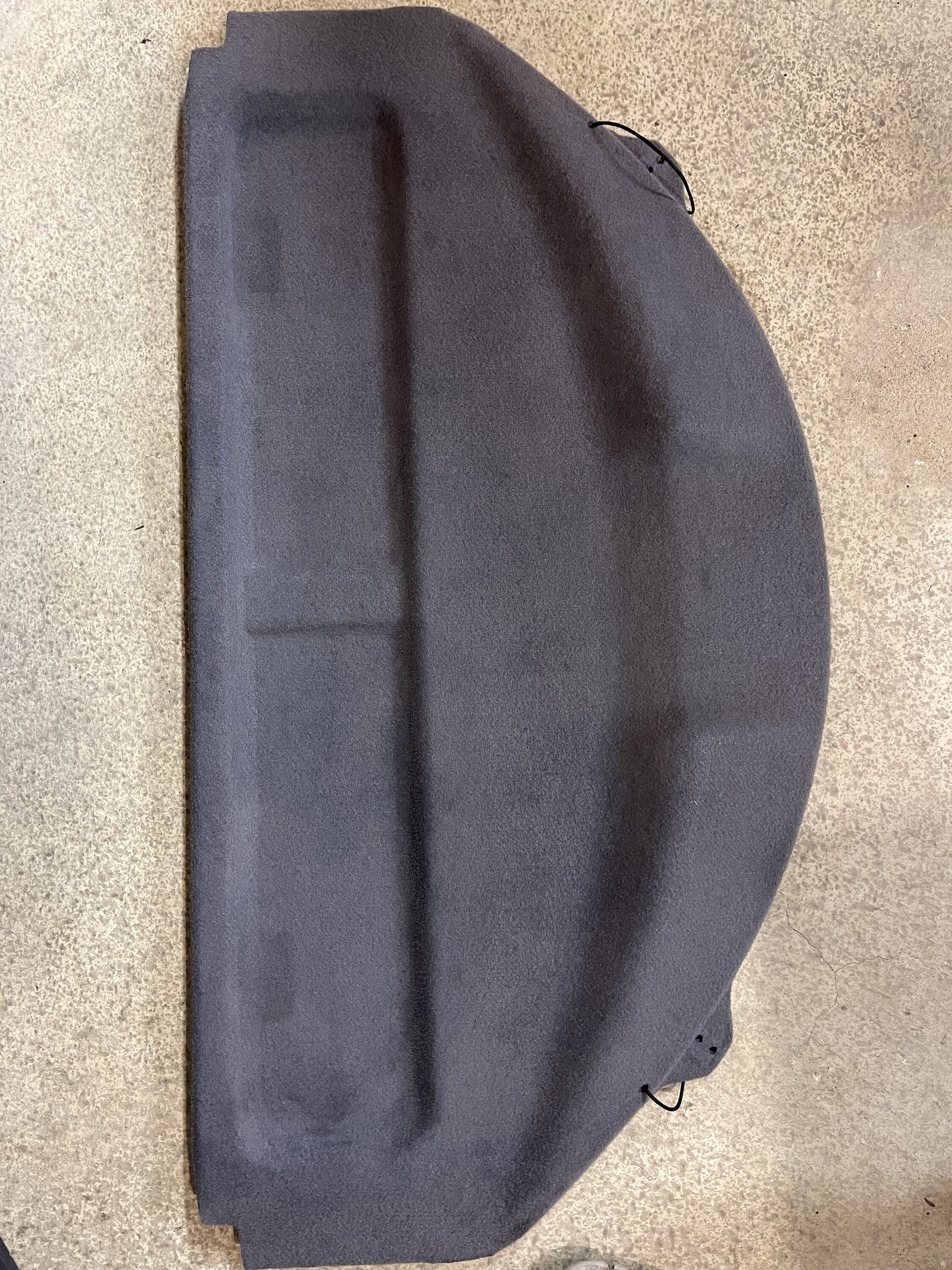

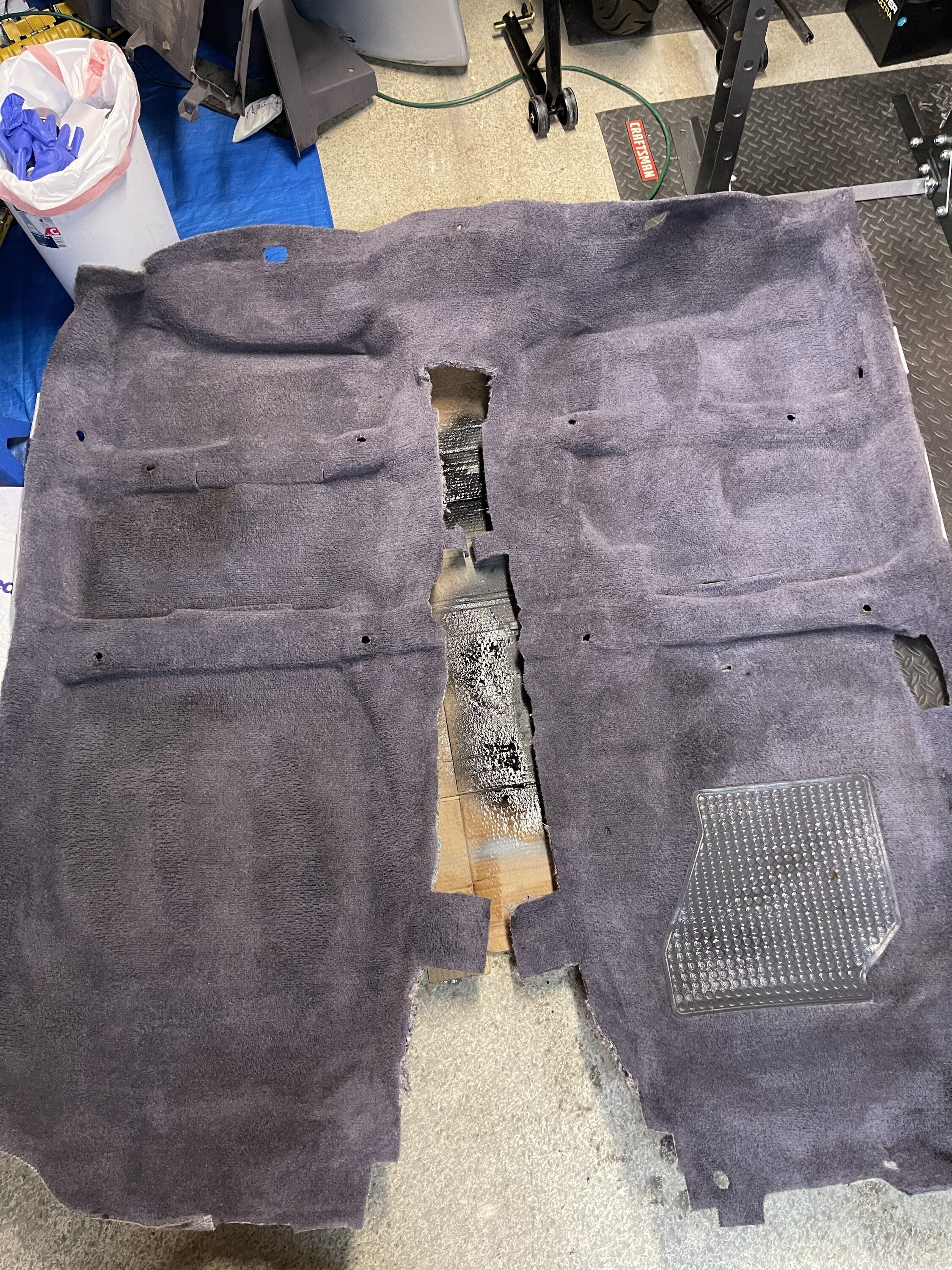

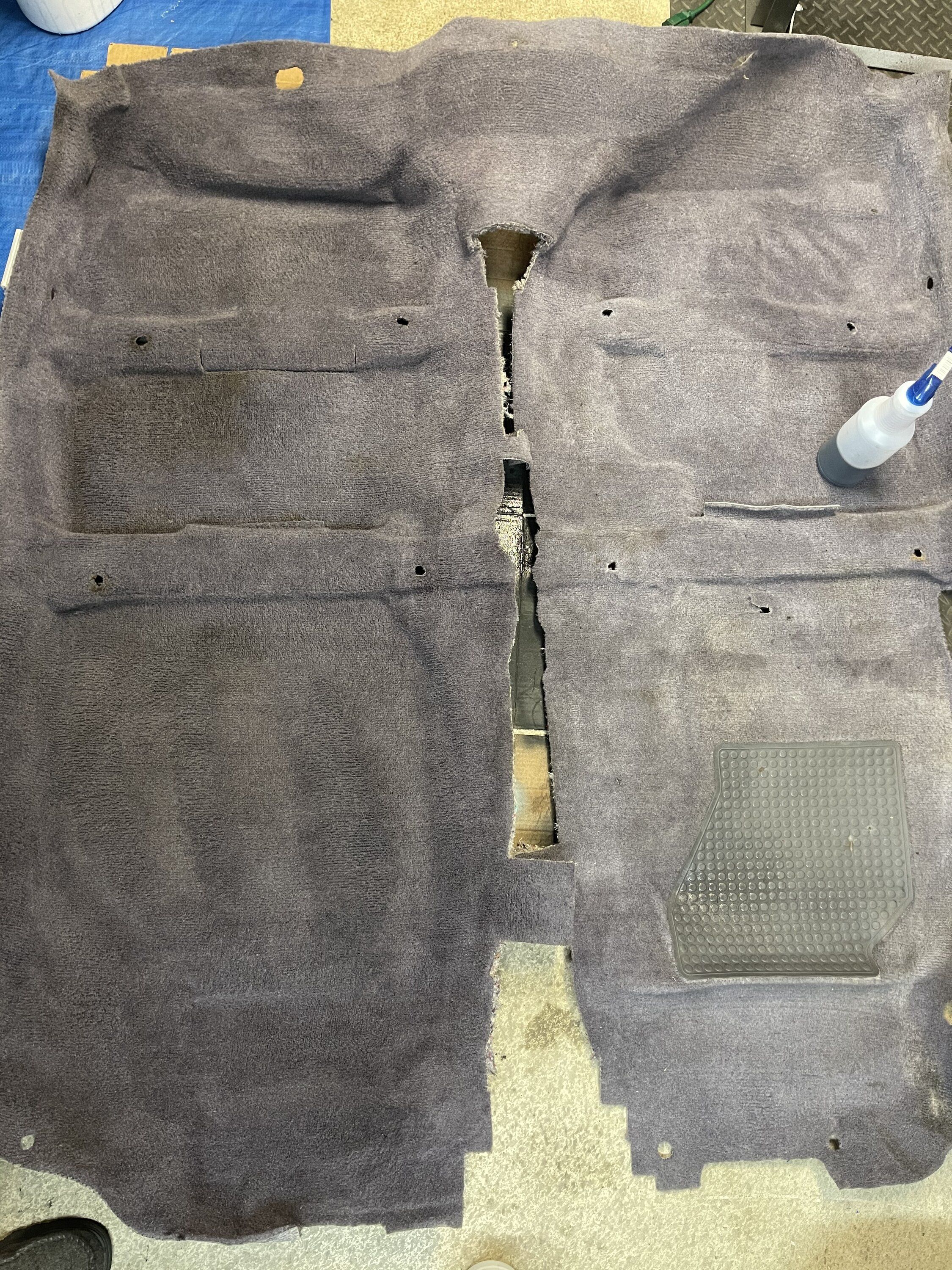

Oh, also FINALLY got around to dying the carpet. It came out amazing and I highly recommend Detail King carpet dye. I also highly recommend for everyone with the grey carpet to go with the light grey if you are wanting to match the color. I ordered BOTH the light grey and the medium abs started with the light. It’s actually a tad bit darker than the oem but in the car you can’t tell at all. It looks amazing. I am super happy with how it came out. I dyed it according to their directions on the site and not putting it in a container and letting it soak. I wanted the oem carpet padding to still be on the carpet and not dyed grey. So moisten the carpet first, then spray the dye and use a brush to rub it in then let it sit overnight. First pic is before, second pic is left half after/right half before and last pic if after but not fully dry yet.
I also wanted the rear hatch cover to match too and it was faded so dyed it too. Be careful when using the brush though and don’t put too much pressure on it! Mine was sun baked and too much pressure was taking off fiber. So be gentle and I removed the rubber things on it to make it dye uniform. Turned out amazing too. The color it is, is how the carpet turned out when fully dry. It’s so close to the oem color.

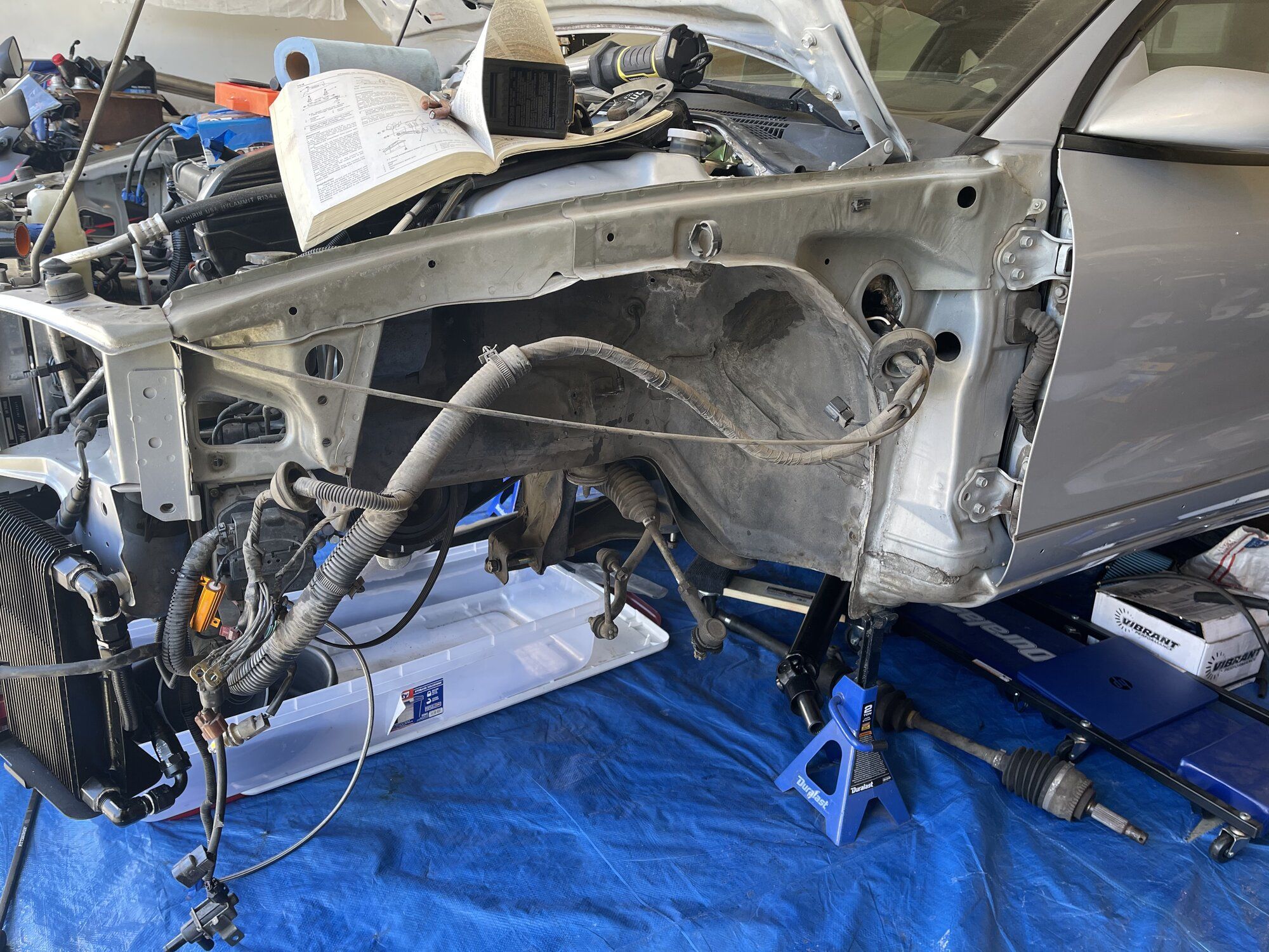

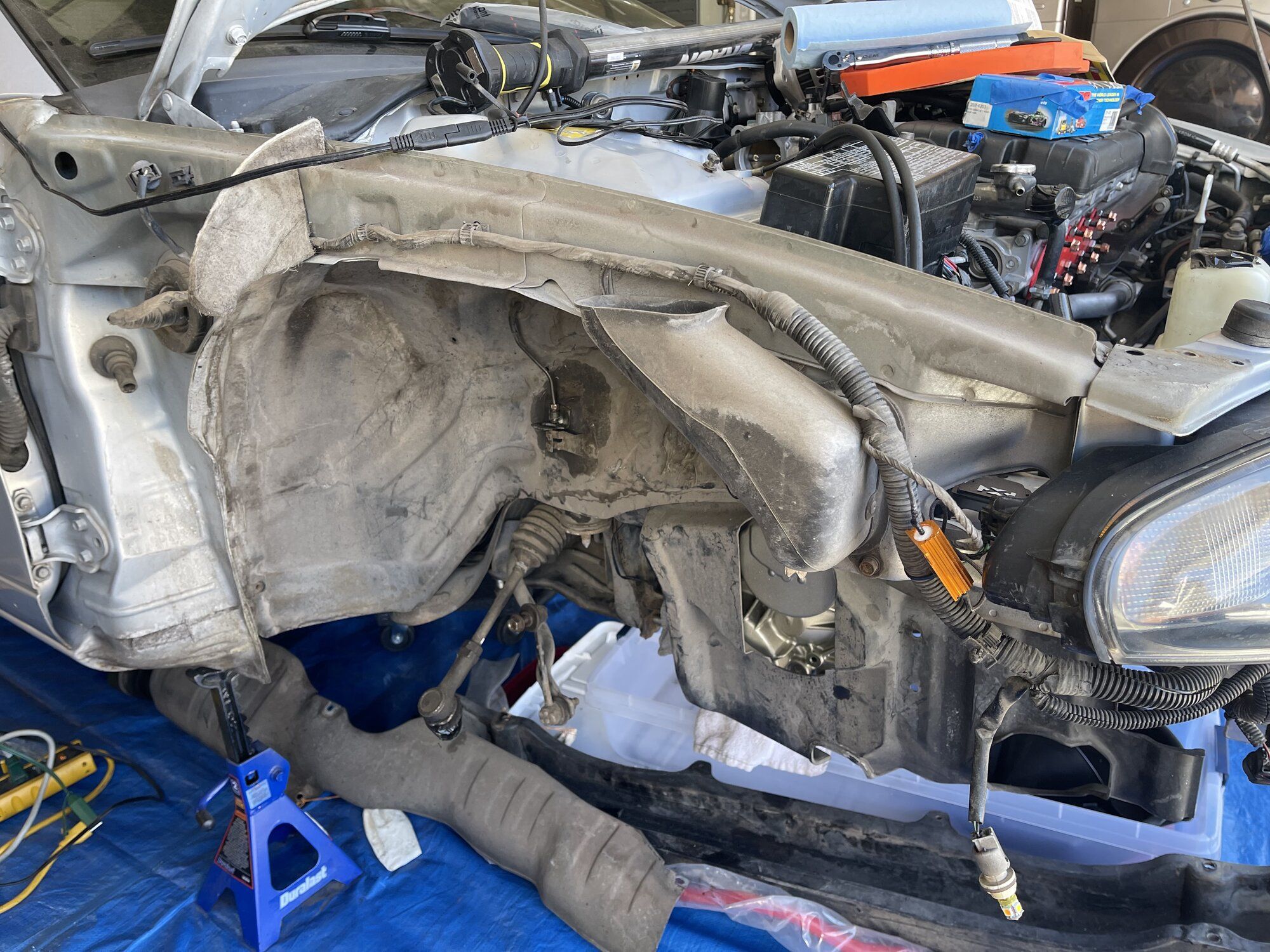

Now I have moved into phase 3 of the rebuild! Ripped all the front suspension out and if I didn’t know any better (which I don’t know what the original owner did) seems the control arms were never replaced. Also got the fenders off and as much of the wire harness out of the way as I can for now. I am super happy with the shape of the metal. It’s dirty but so far I have found zero rust. We will see what happens when I start removing the seam sealer and break through all the dirt and grime though. So far so good.

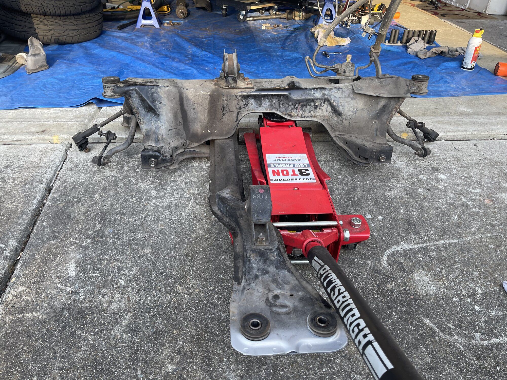

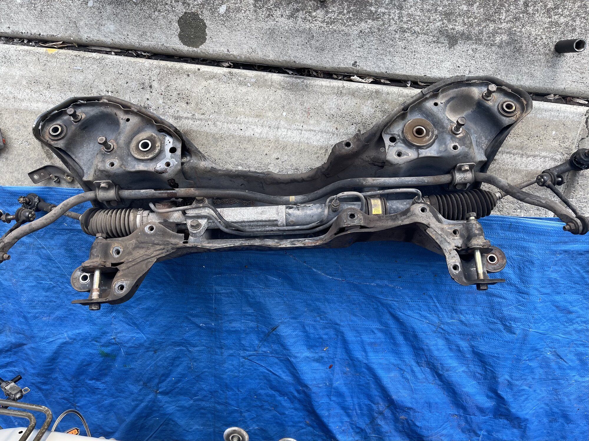

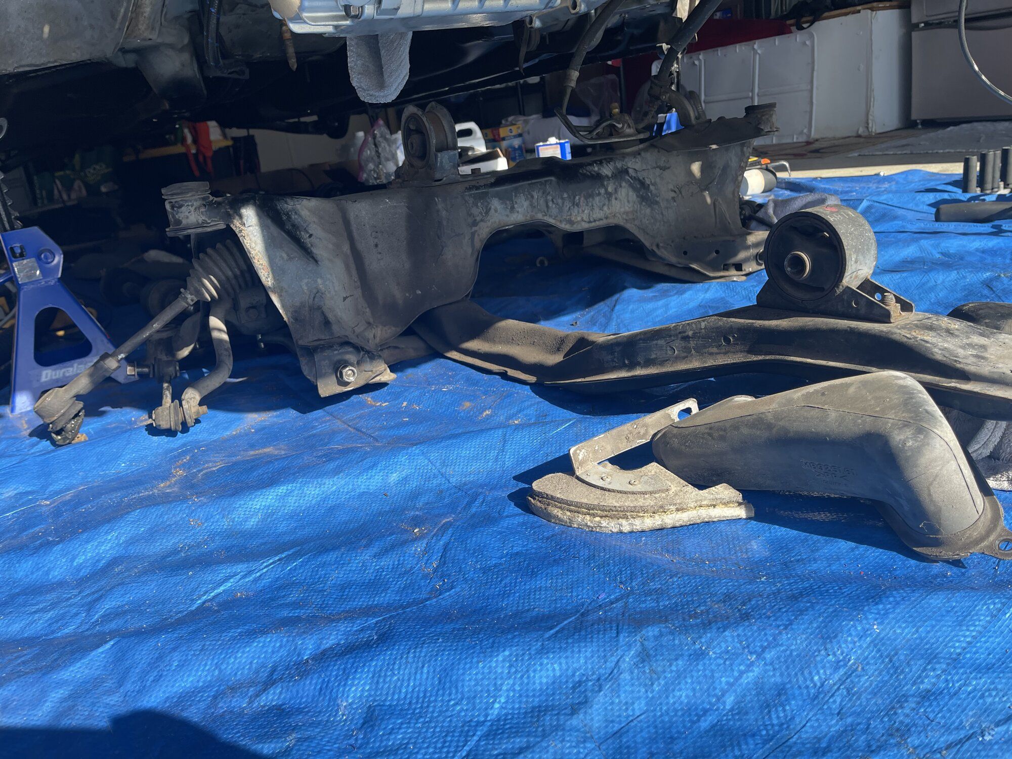

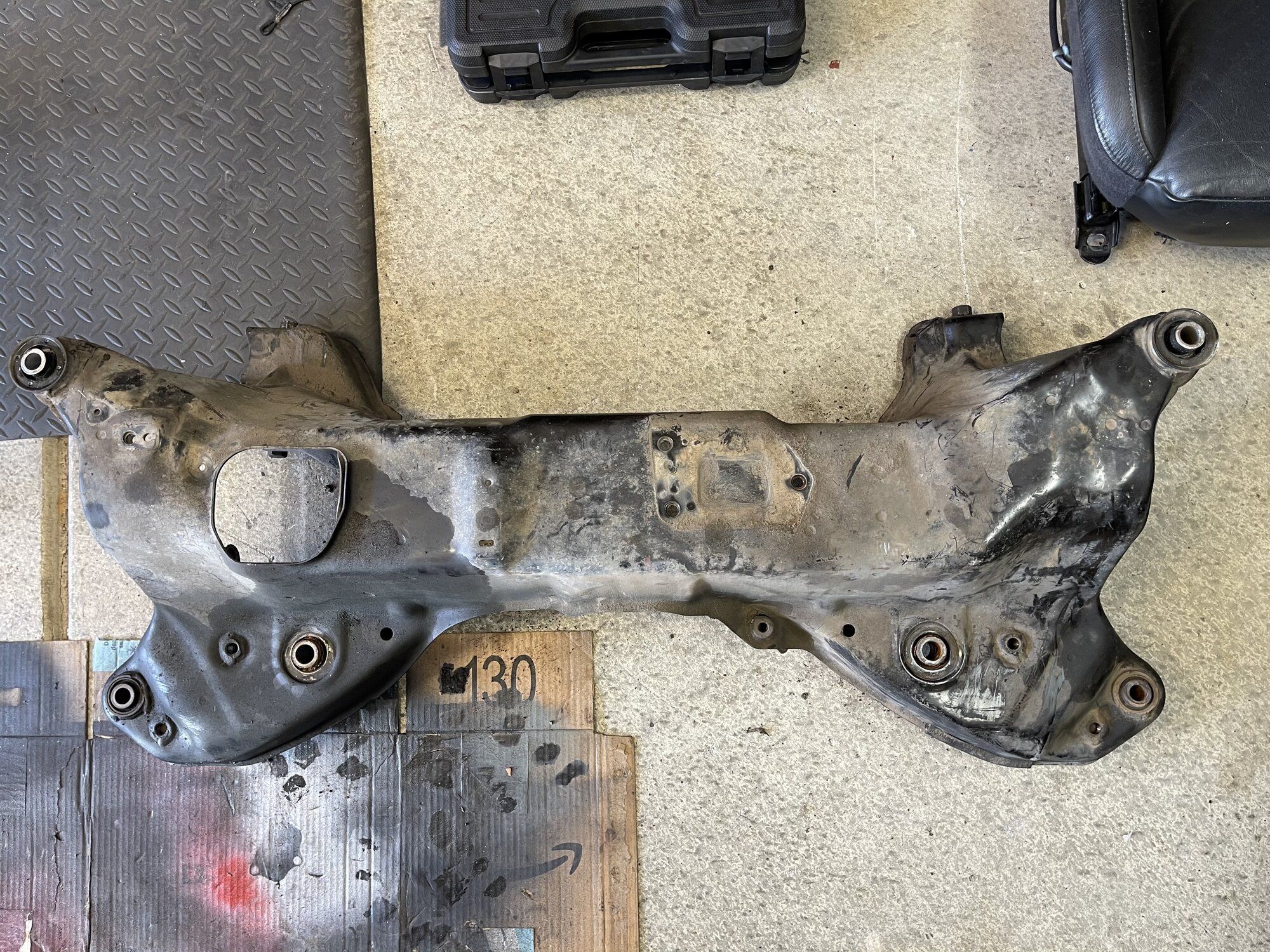

Well got the front subframe dropped with no real issues. I was so worried about the pinch bolt for the steering column being hard to get to but really it was getting the flex lines disconnected that was the most tough. Luckily the car is in such good shape that none of the bolts snapped or had any issues getting things broken free. I am so happy with the base I am starting with abs glad I don’t have to do metal work. Still have to work my way through the seams though and pray for no corrosion.

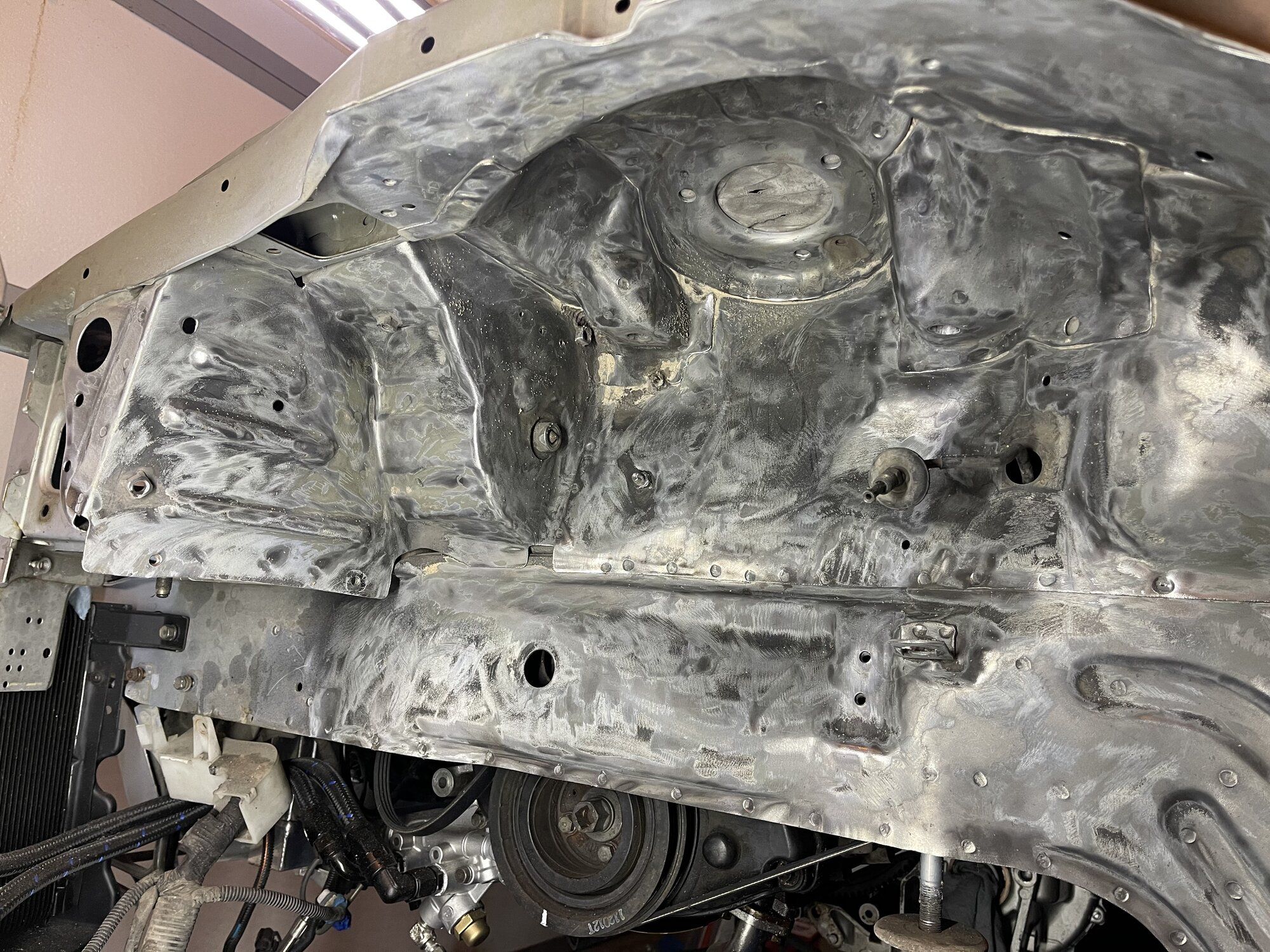

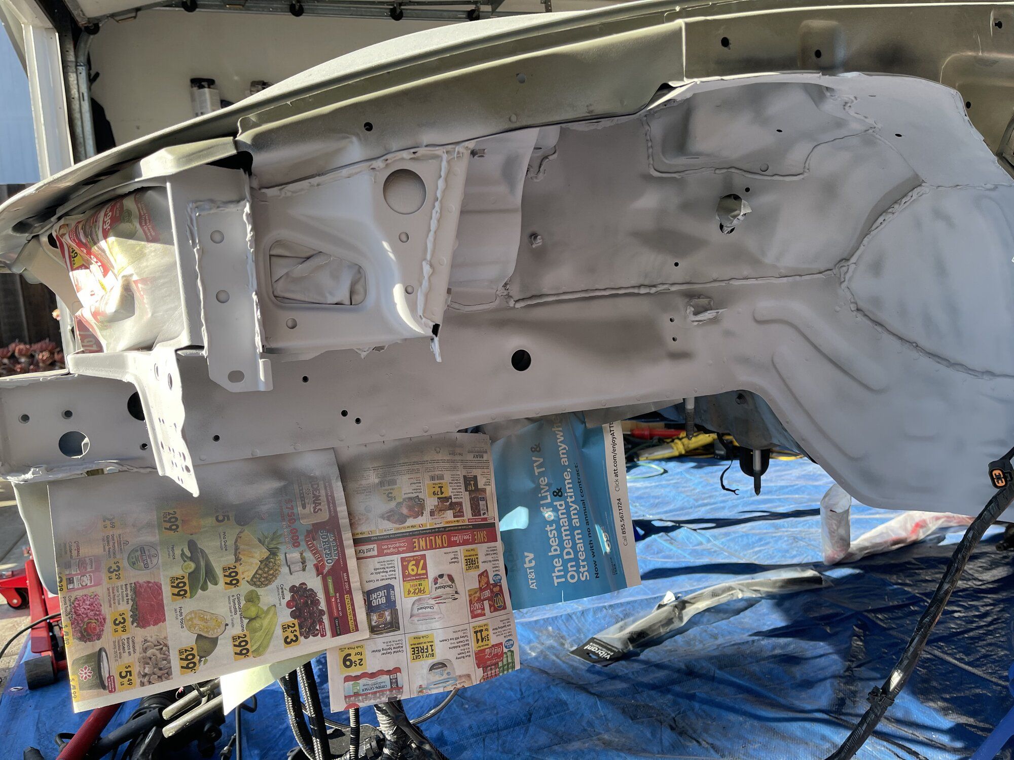

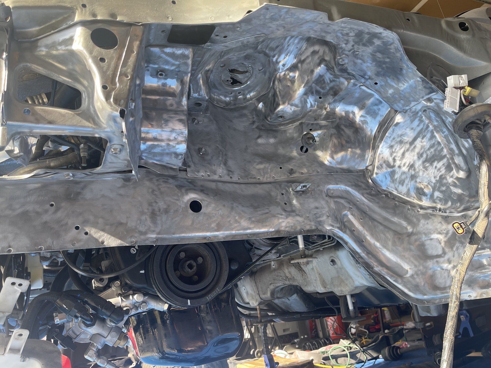

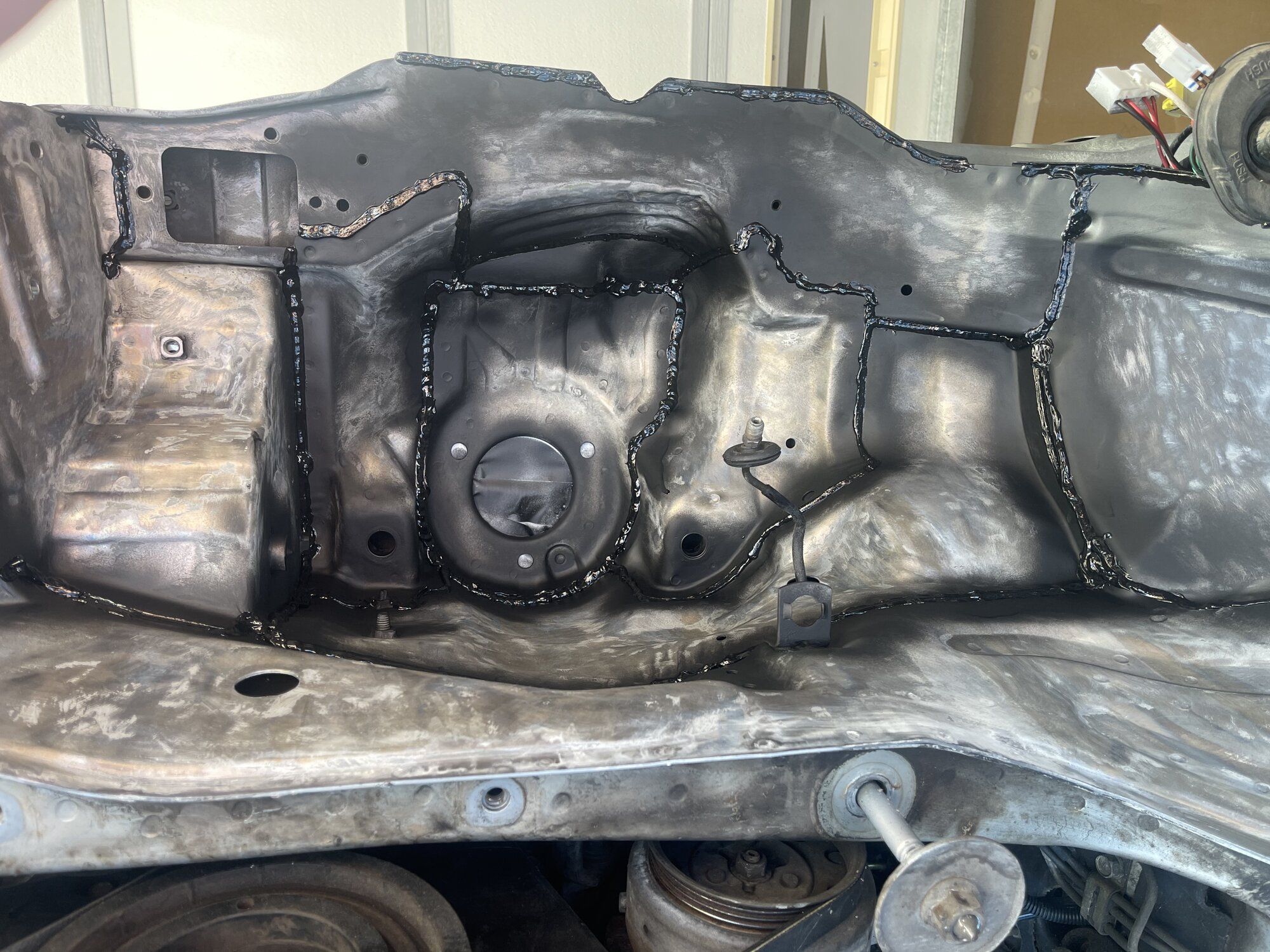

Decided to suck it up and just hammer out stripping the seams and gunk/grime in the drivers side and passenger side wheel wells. Took a solid two days and still have a lot of detail work to get everything fully down to metal, but made a huge dent in all the work it takes. It’s definitely not fun but it had to be done. Wanted to be 100% sure I had no rust in the seams and shock towers. Turns out I am SUPER lucky and there is zero rust!!! I am so happy with that.

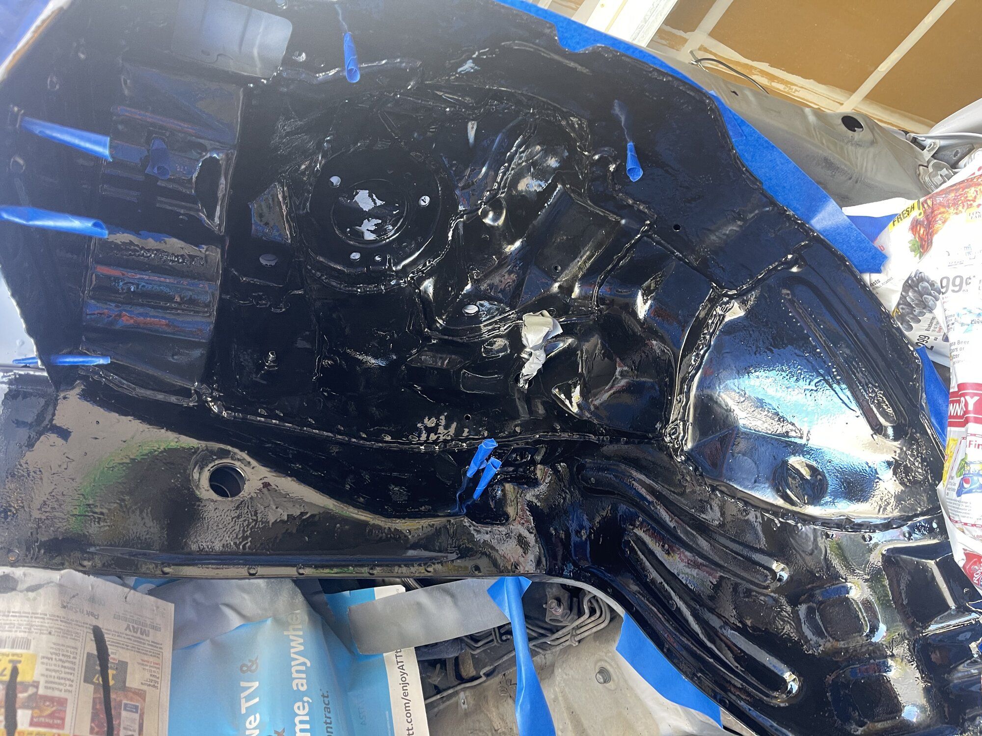

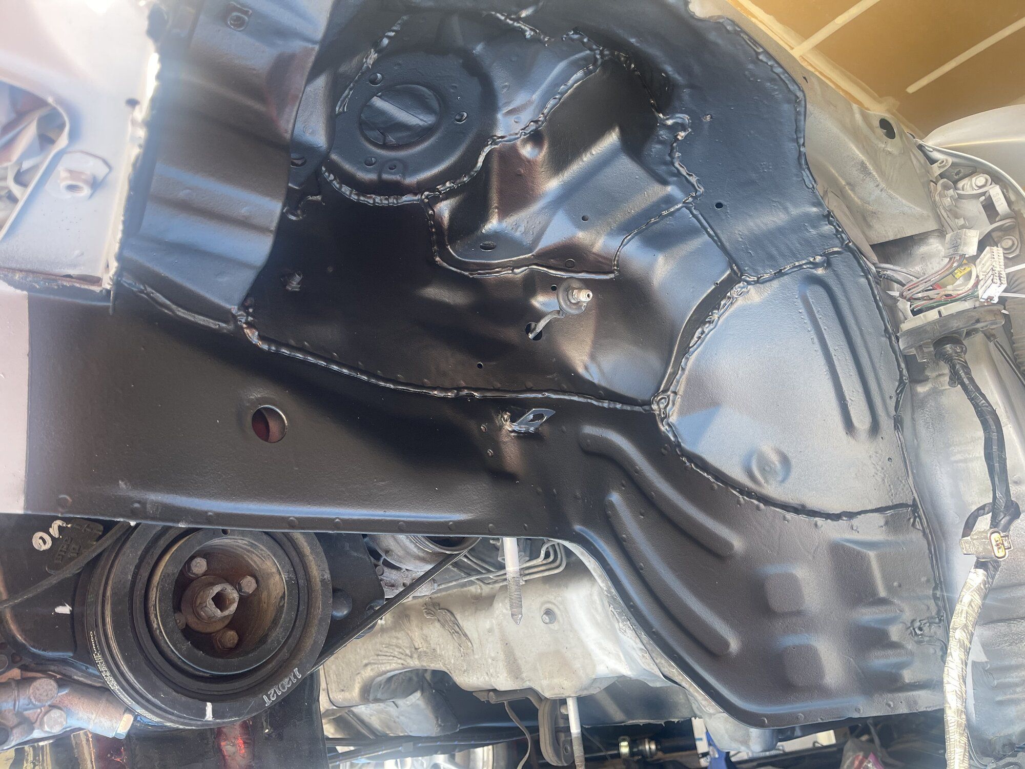

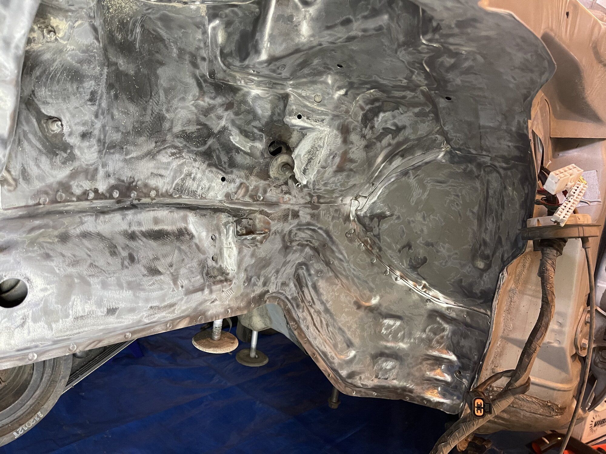

Made more progress on the wheel wells. Got it down to metal and then took the first steps in treating the metal, seam sealing and laying a light layer of rust preventative down. Have to wait 72hrs for the sealer to dry and then start the por15 then undercoating. It’s a long but worth it process.

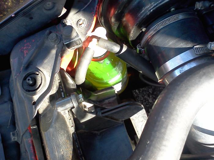

That front opening i would make a cover for it to cap it off. I was sick of water and stuff getting inside so i capped it off and sealed it up as i have no idea why its here and left open.
Also what are those golden things on the fronts in the wiring? That to fix hyper flashing or something
Yeah I have wondered that myself about the opening. When I was degreasing everything and cleaning behind the upper area a bunch of leaves/gunk etc came pouring out of it. Ended up spending more time on getting IT clean and treated than I thought I would.
You are spot on with the golden metal boxes. They are the resistors to fix hyper flash that I originally wired in when I did not have all the space I do now. Going to relocate them to a better spot now though. Probably tuck them in behind the frame.
I need to do this now as for some reason when the car was imported it got added to but now i removed this EXTRA light i get hyper flash! Weird but i dont know why as i been through the whole front now and the oem flash box is the normal one. What made you get hyper flash ?
I swapped all the bulbs to led. As soon as I did that I indeed got the hyper flash. Blinkers would blink super fast and I hated it, so used the resistor values that made it oem spec ohms.

Also now that the seams are dry, (takes 70+ hours to fully cure) got around to treating the metal, por15 and then rubber undercoating the wheel wells. Again, takes so much work and the smell is awful, but worth it in the end. Thing is freaking bullet proof almost now.
