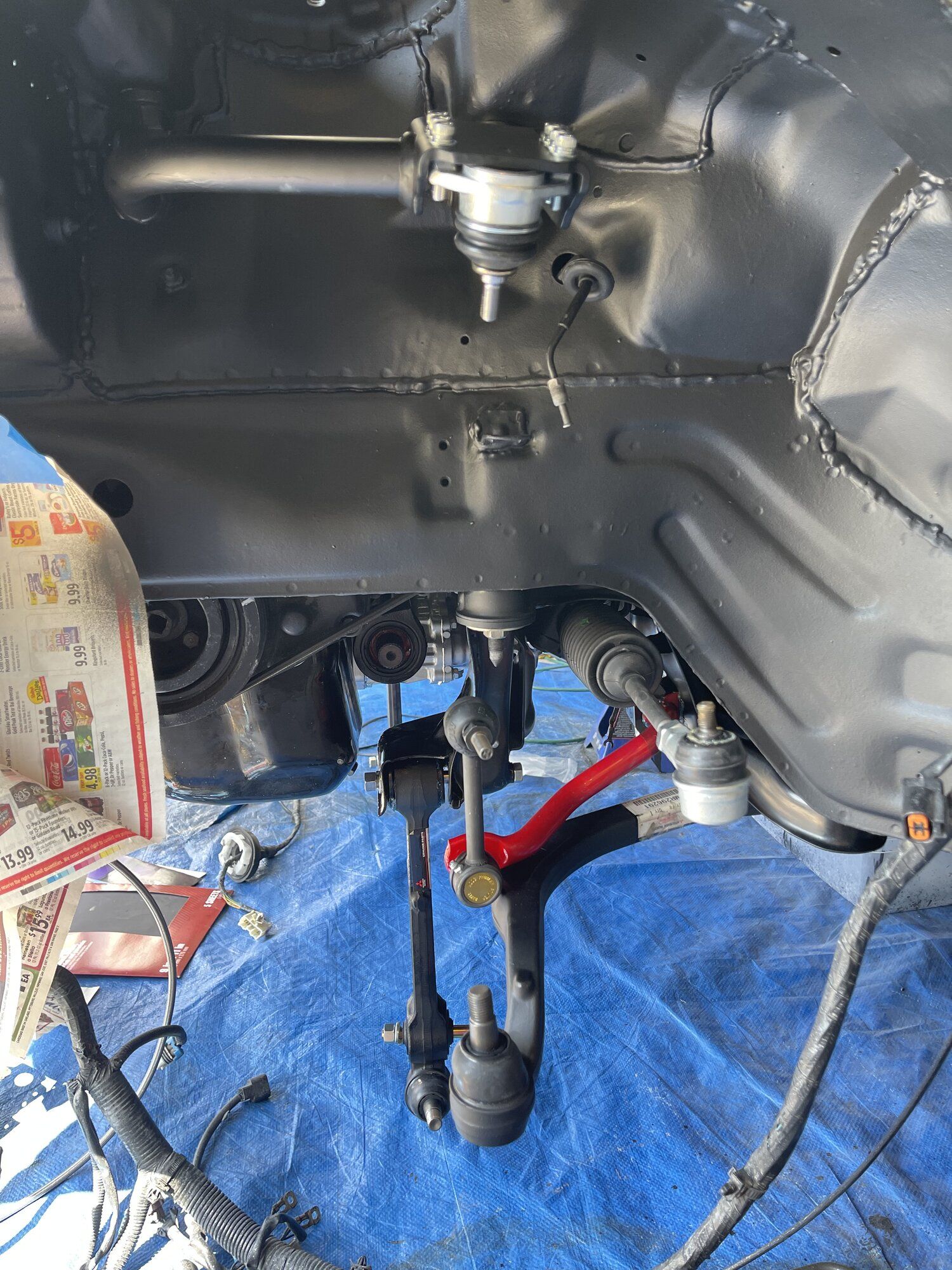

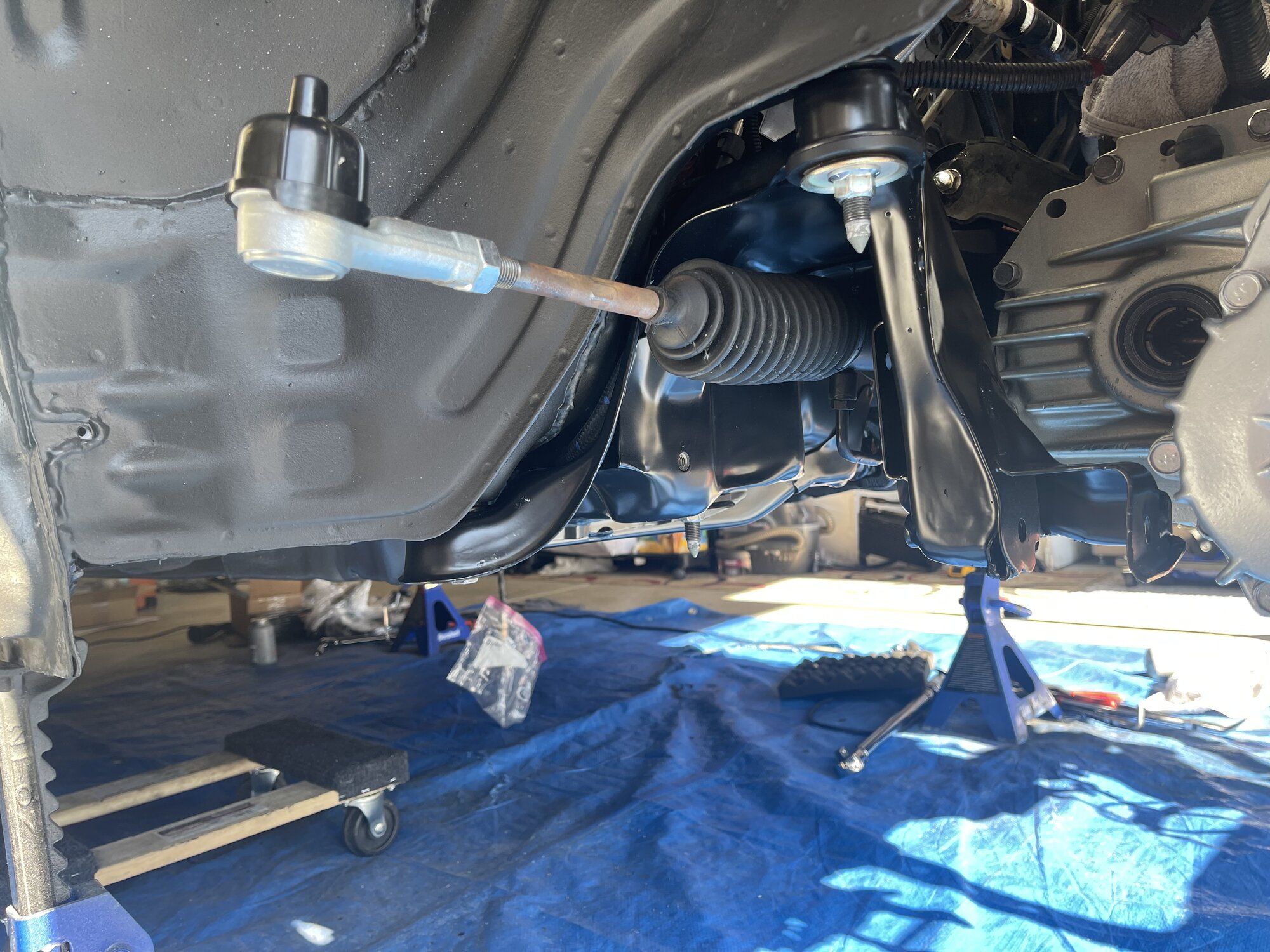

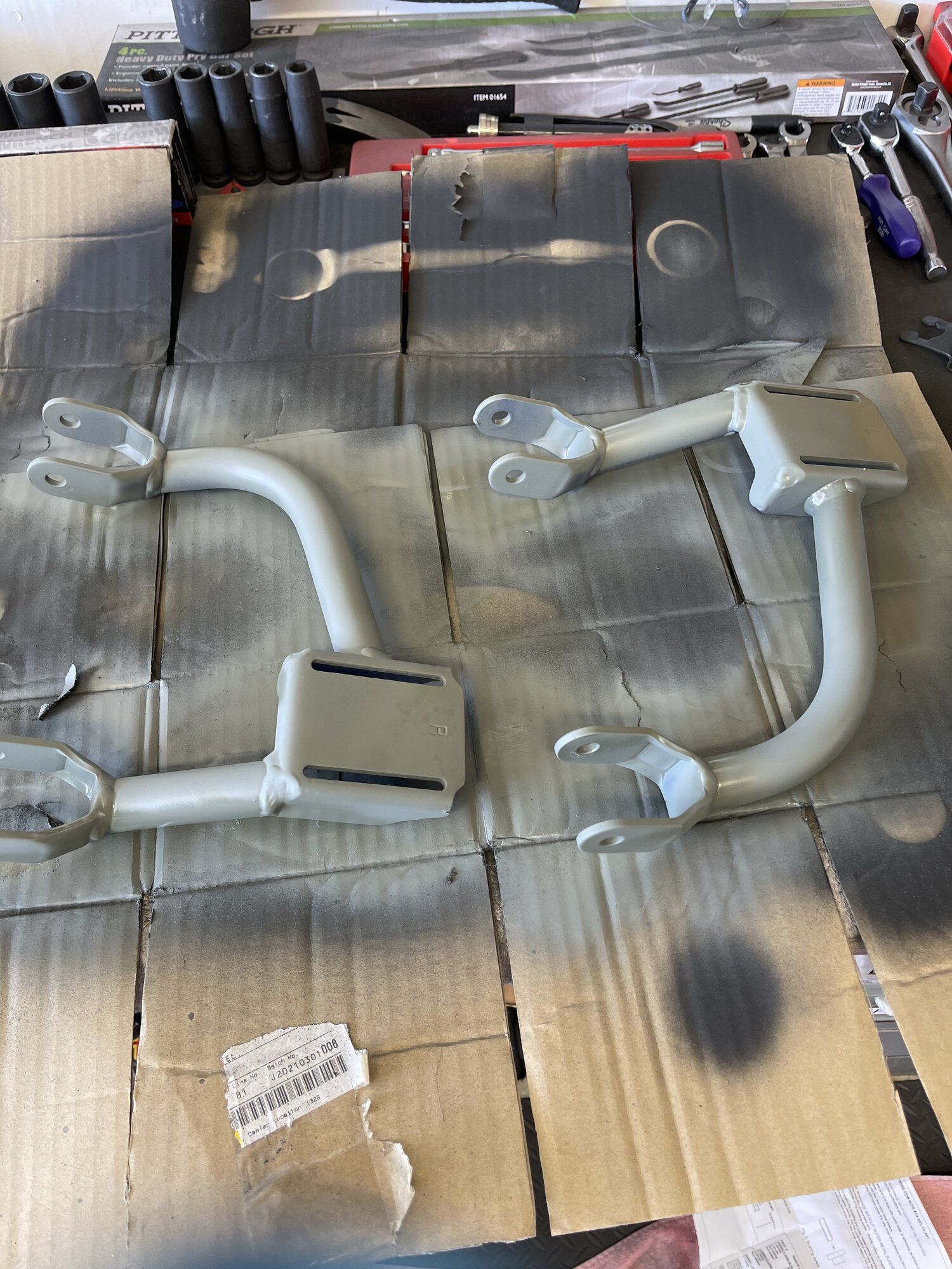

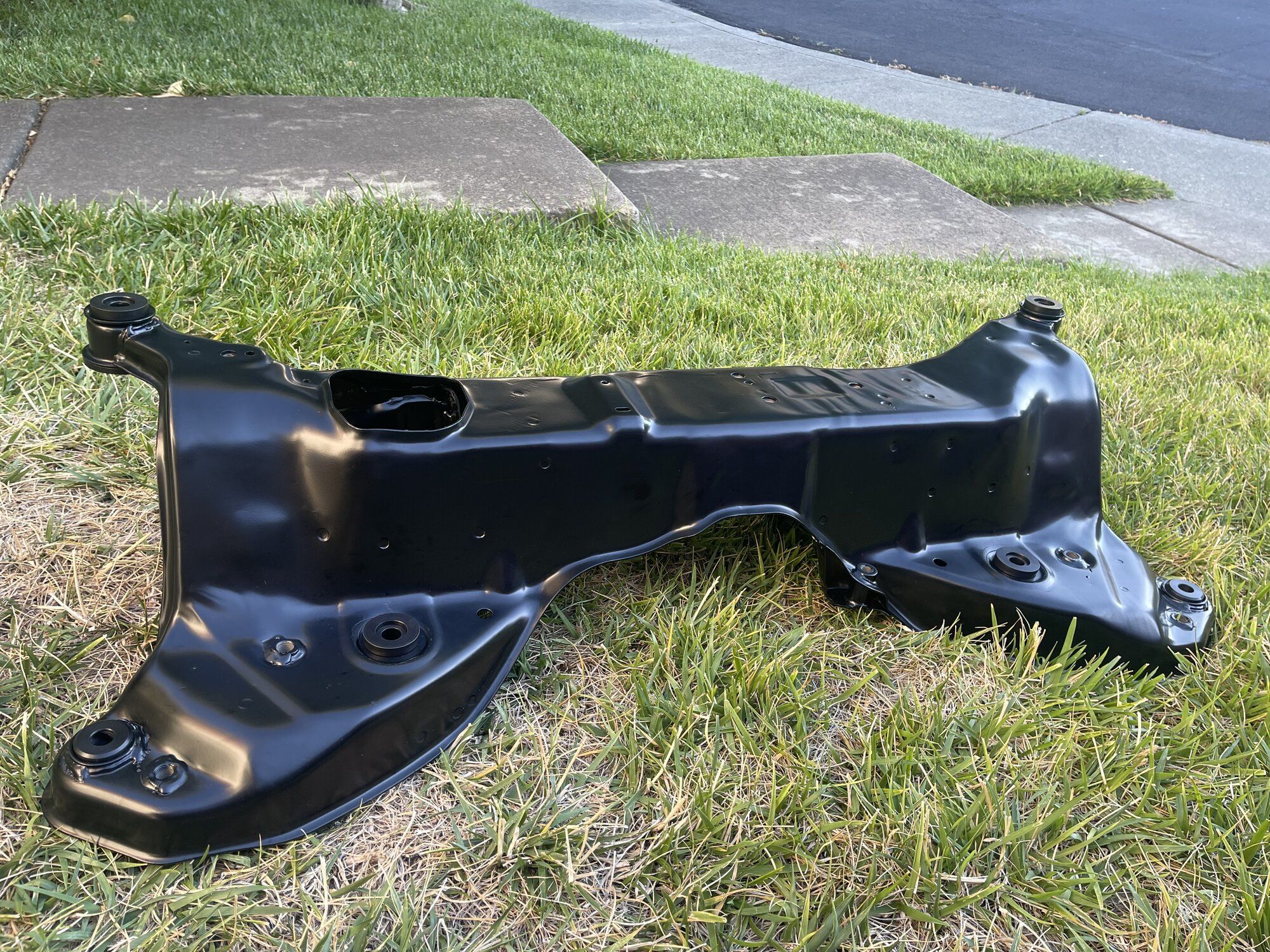

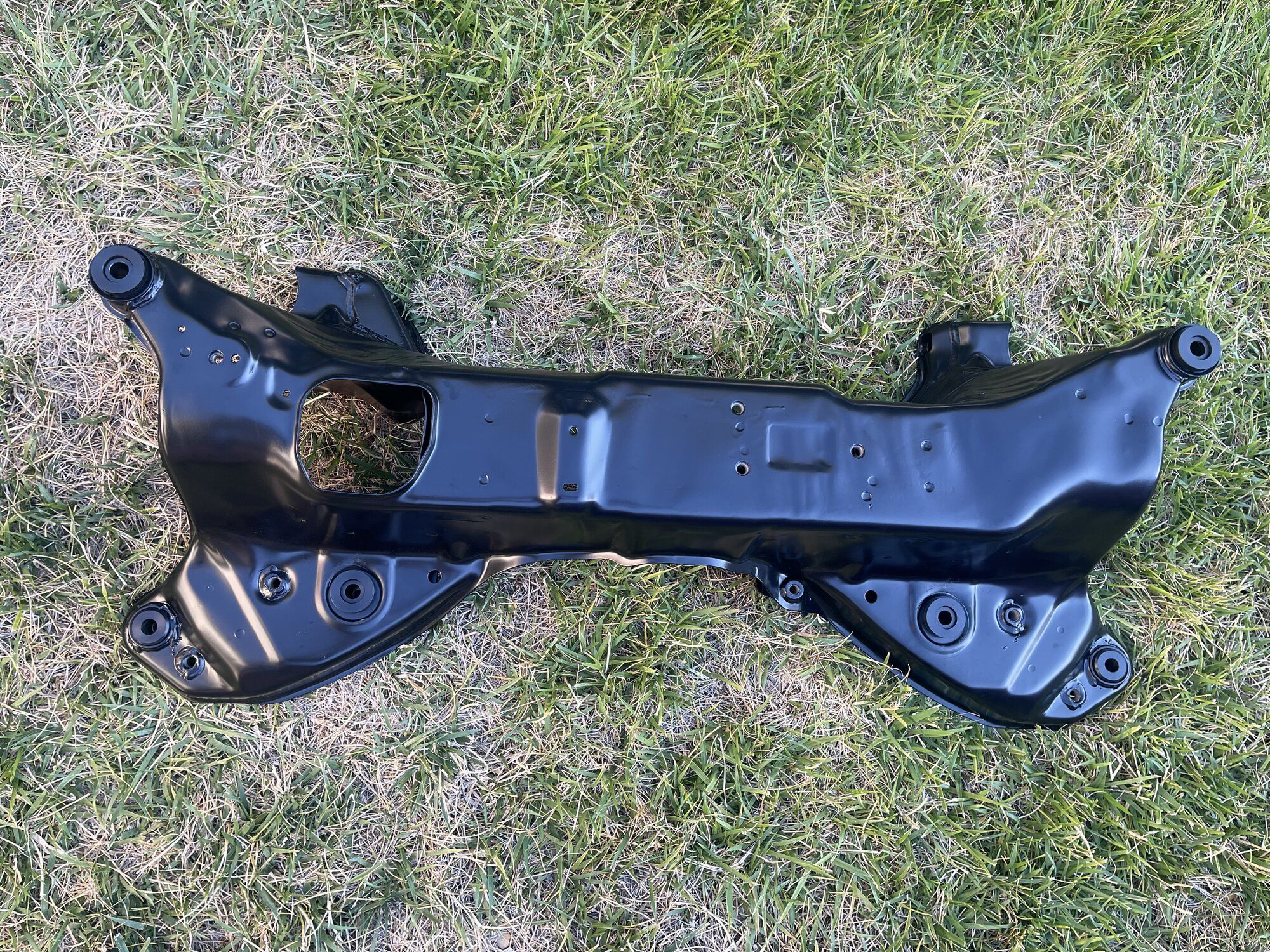

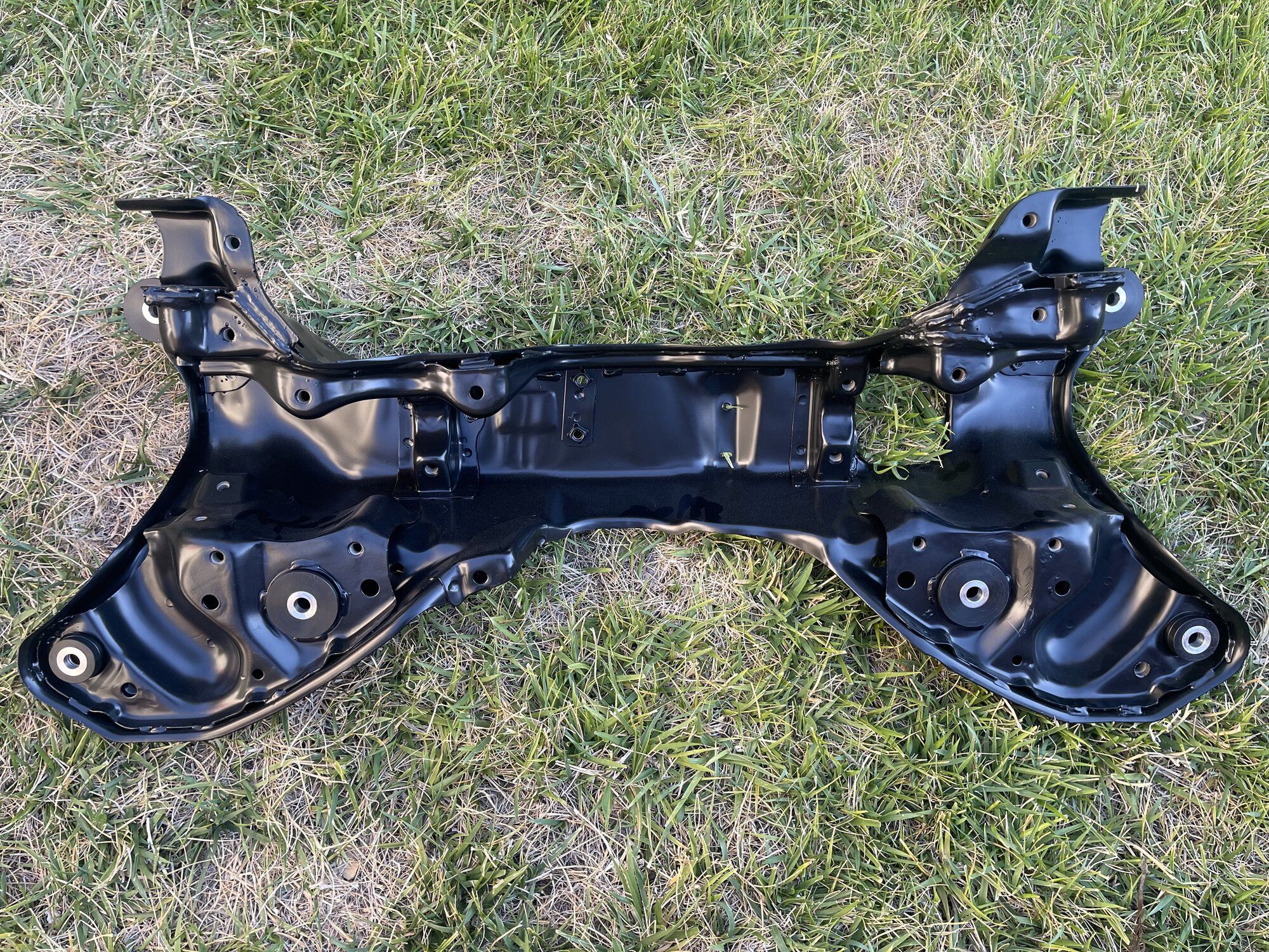

Things are starting to go back together. Getting parts back from powder coat and installed the bushings from @Gsx-Dude. They were a breeze to install and are going to make everything stiff but not as harsh as the solid bushings. I literally can’t say enough about the amazing community we have to make these cars so fun to drive and keep them on the road!!!

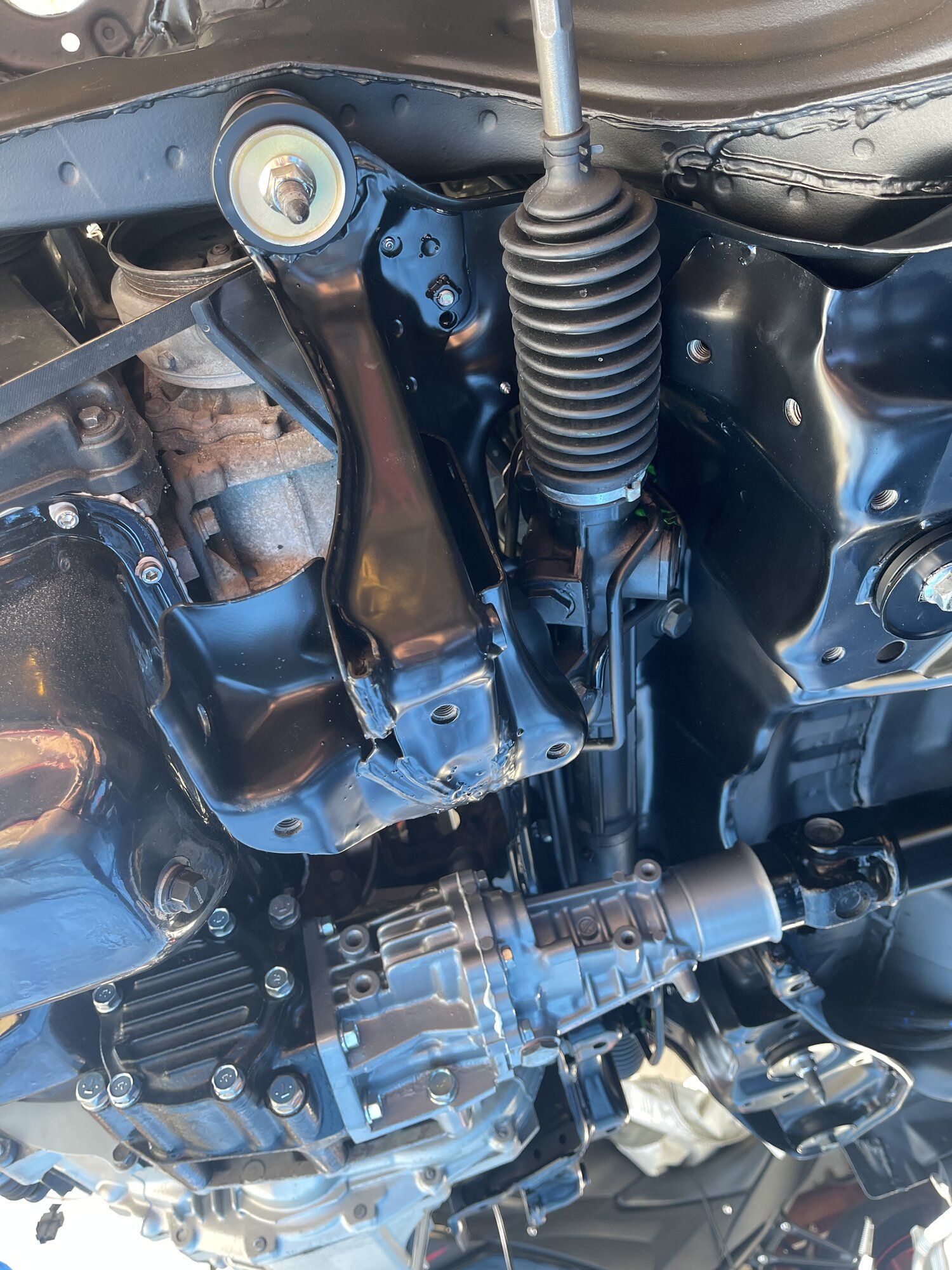

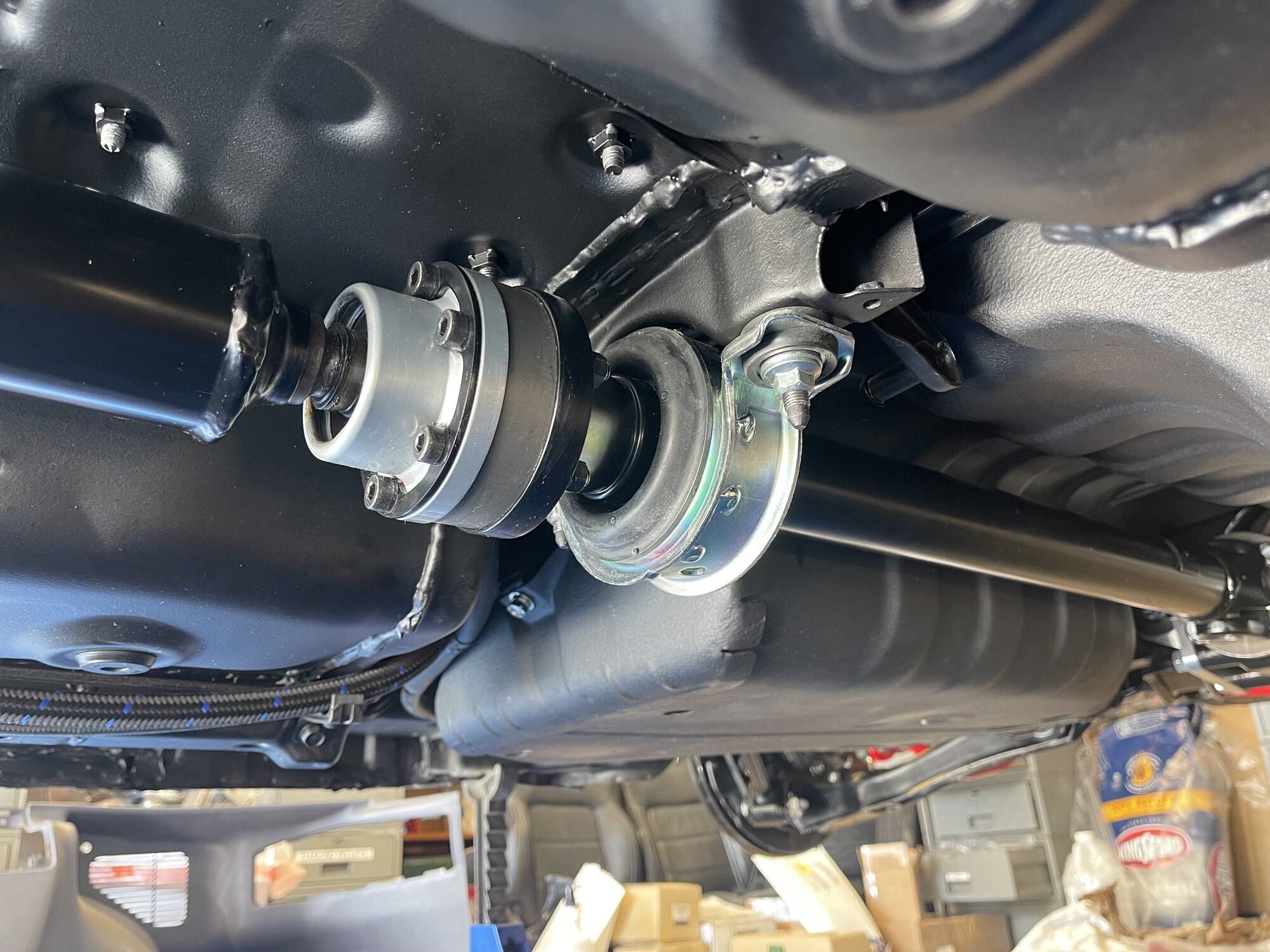

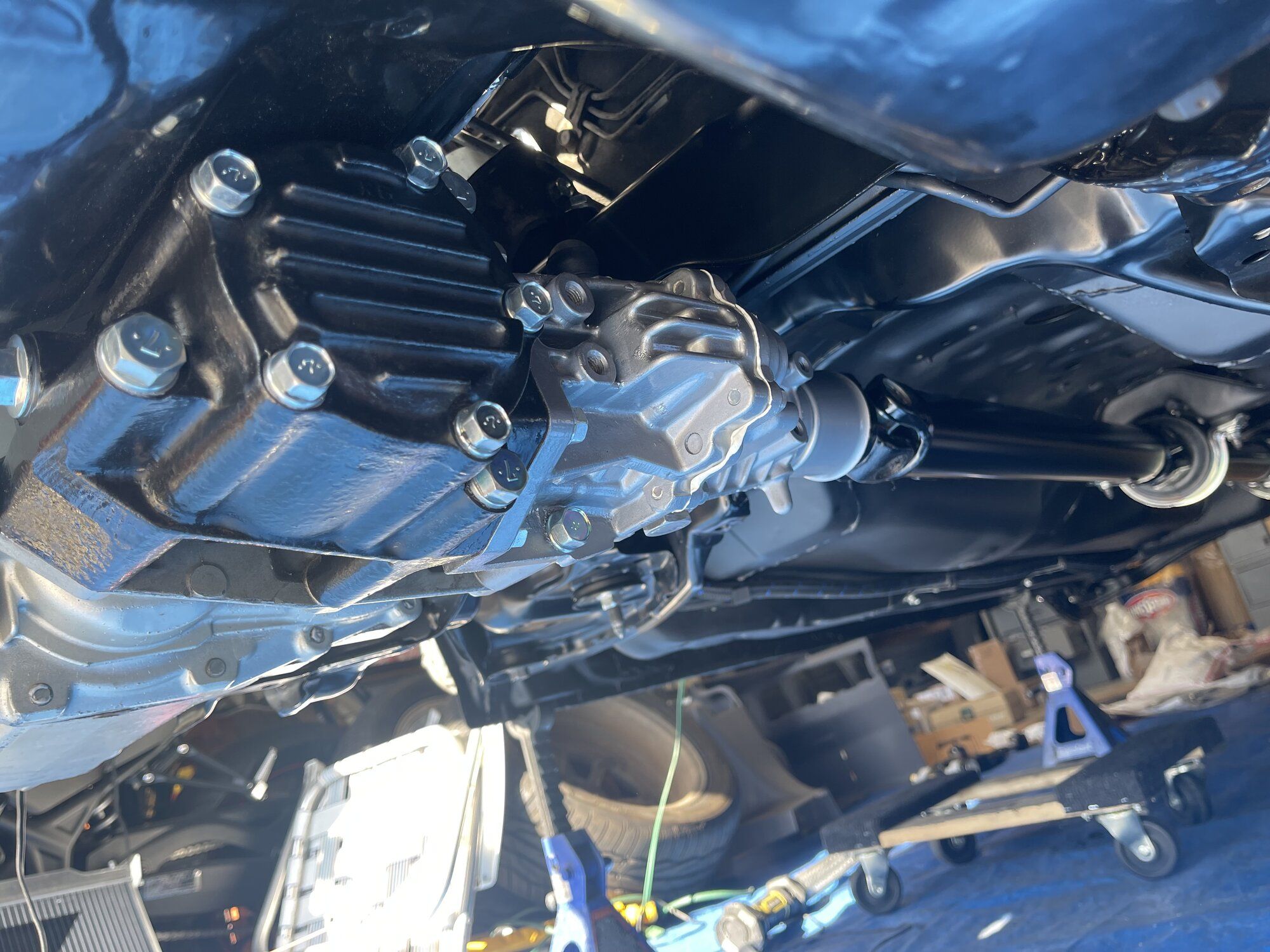

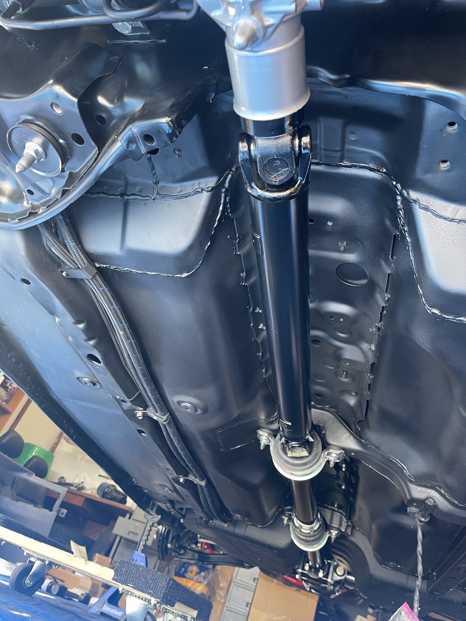

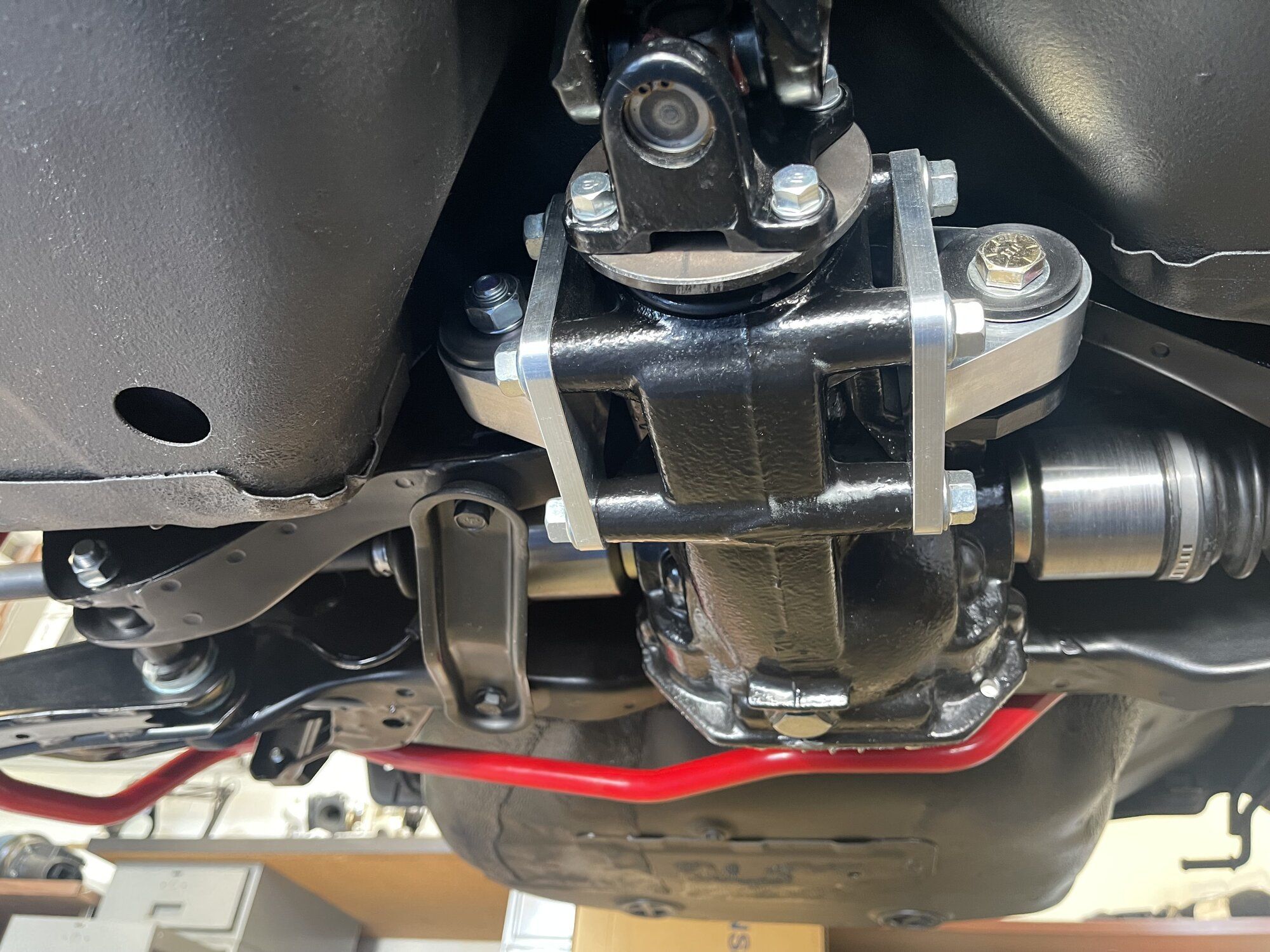

Here goes a long one. I made a lot of progress over the past two weeks. Hung the front subframe and figured…. Why not just go ahead and hang the transfer case and driveshaft hahahaaha! So that’s what I did. I know that sounds like the next logical steps but as most of you know, working alone in the garage, sometimes the big jobs take A LOT of building and hyping up to LOL. I have tons of tips and tricks for anyone that finds this build so please reach out to me with ANY questions you may have about it.
Hardest part to me was supporting the driveshaft with two hands, and two jacks and then getting it in the transfer case, all while trying to keep it level so there is no pressure on the bearings etc. In case anyone is wondering as well, yes everything is OEM Mitsubishi with the exception of the bushings in everything.

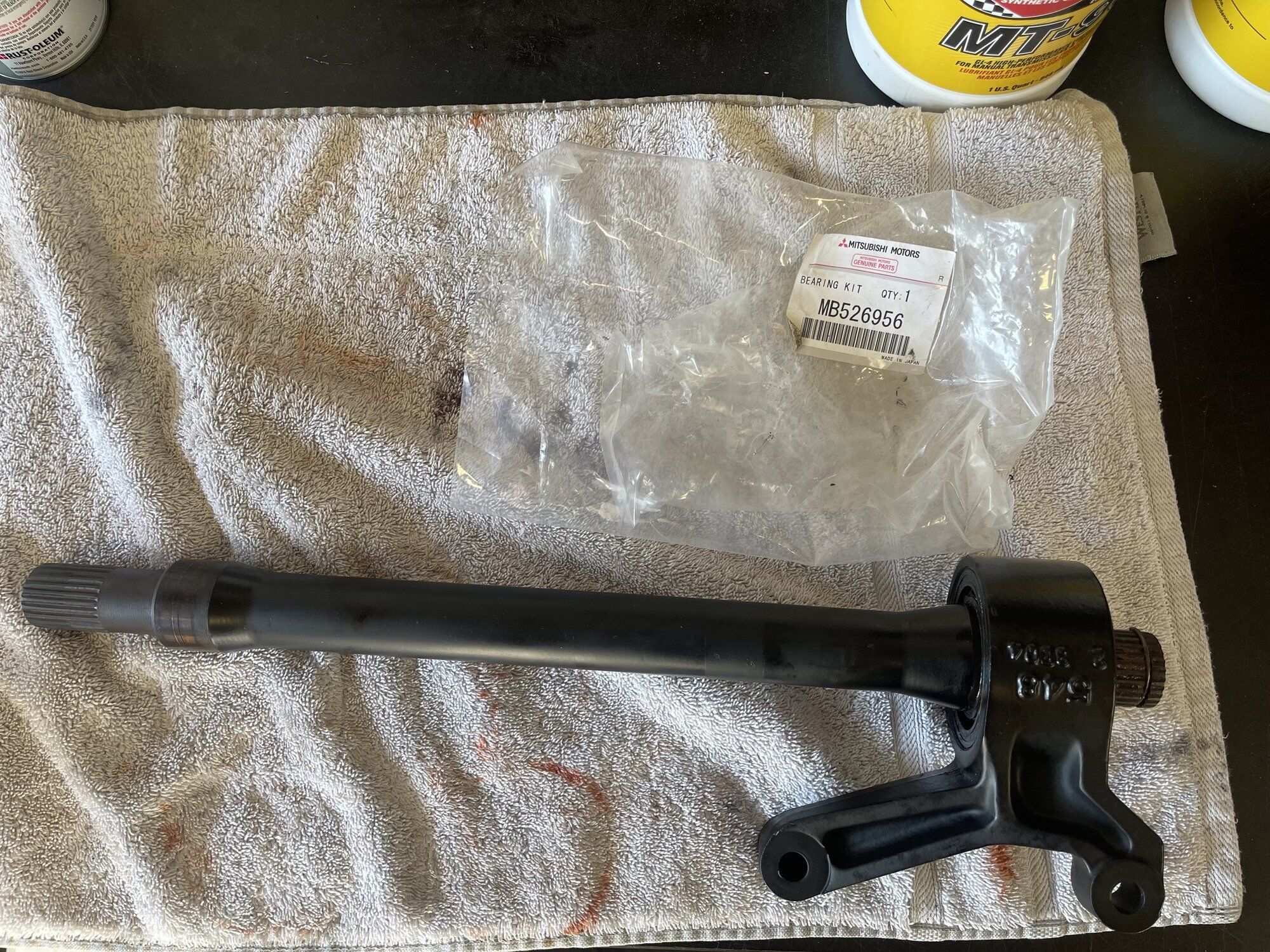

Also finally got around the rebuilding the half shaft once I got it back from powder coating. Had everything stripped and coated then installed the new oem bearing. Harbor freight press has been a life saver and worth its weight in gold for a diy person in the garage!

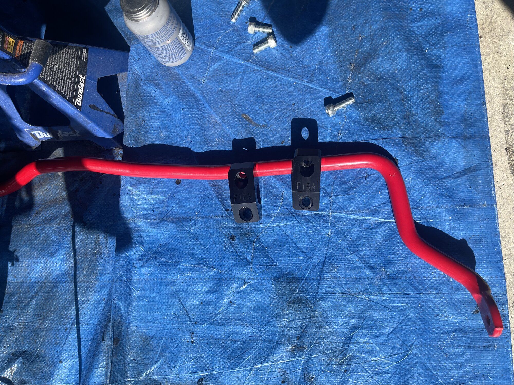

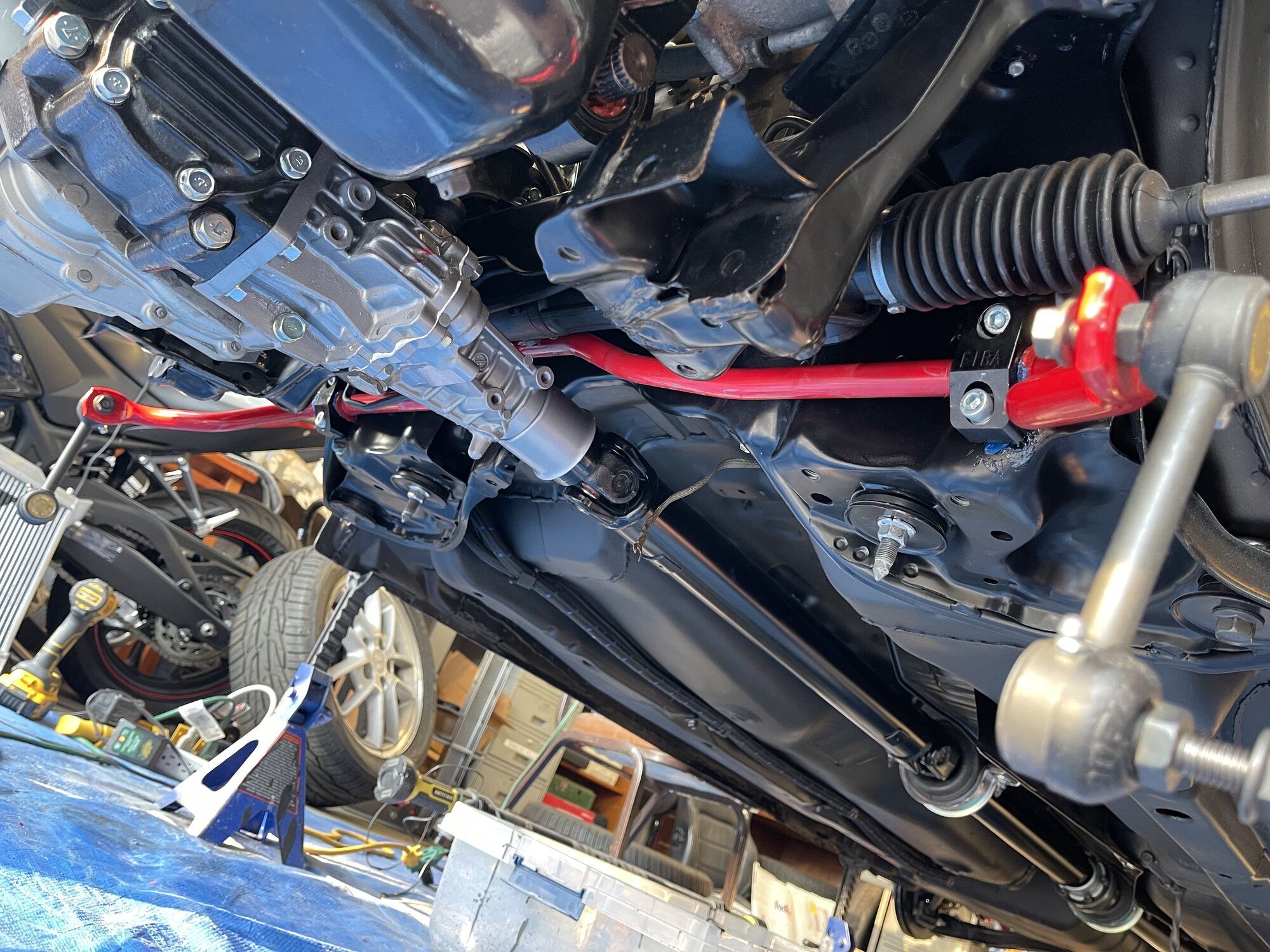

Well I realized today that I should have definitely installed the rm sway bar BEFORE I hung the diff and drive shaft. Got it in after some persuasion from the passenger side, but it’s in and tacked up until I get the knuckles in. Also still loving the aluminum brackets.
Kinda hard to see but I also installed the half shaft for the driver’s axle.

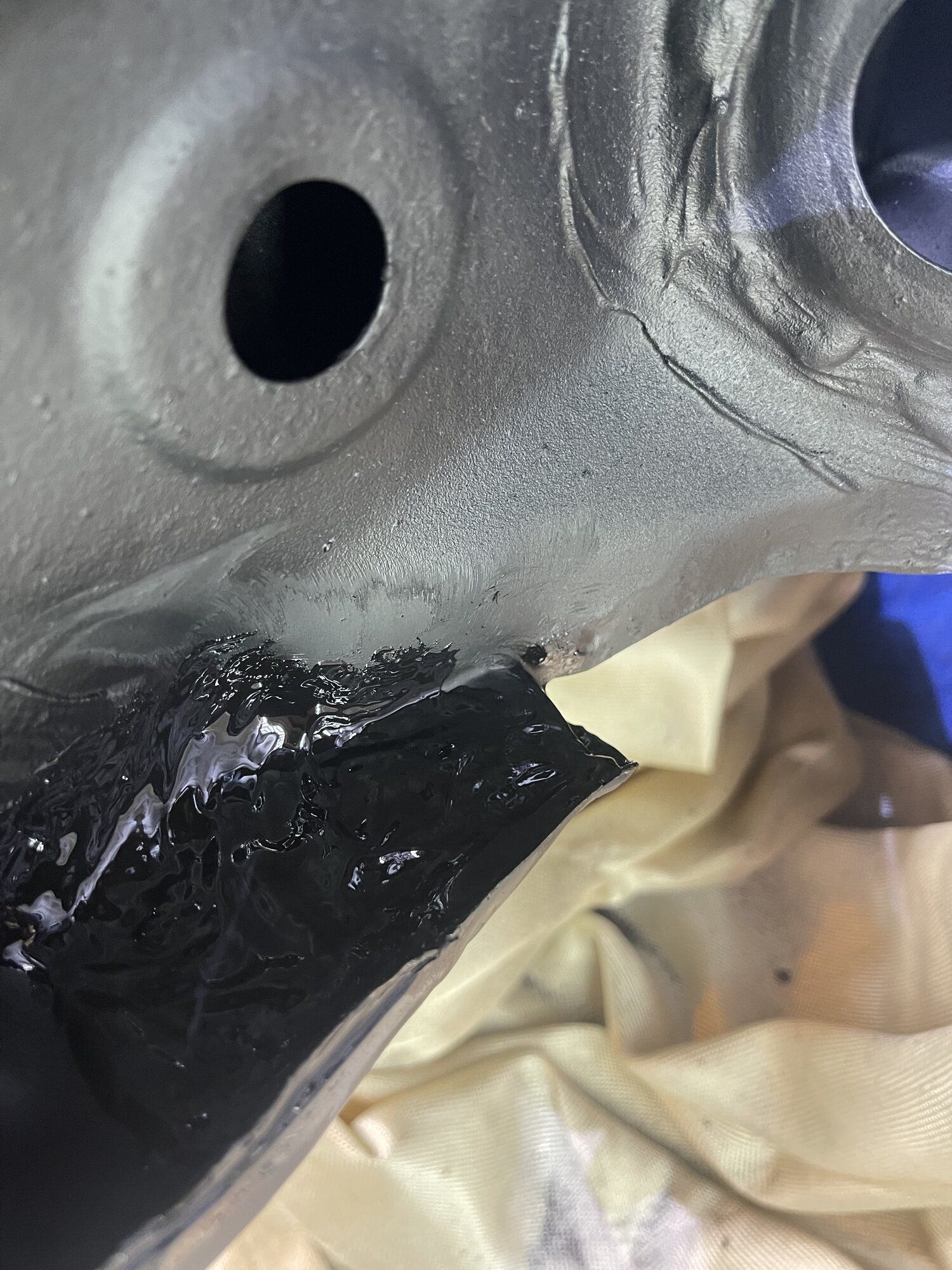

This thread is amazing!! I'm following this same process on my 98 GSX. And also on jack stands... What brand seam sealer did you use? Currently debating whether a brushable seam sealer will be easier to apply.

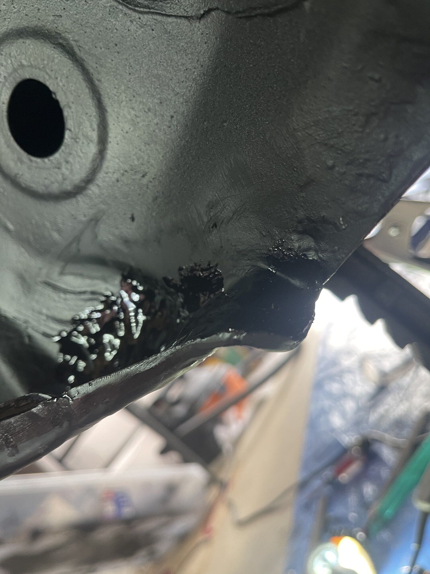

I used the por15 seams sealer. I wanted something that would seal extremely well and would last forever. Definitely better than the oem crap they smeared around on the car. The por15 was super easy to apply and when it dried it was freaking ROCK hard. Again, takes forever to dry so just have to be patient before you cover/paint over it.

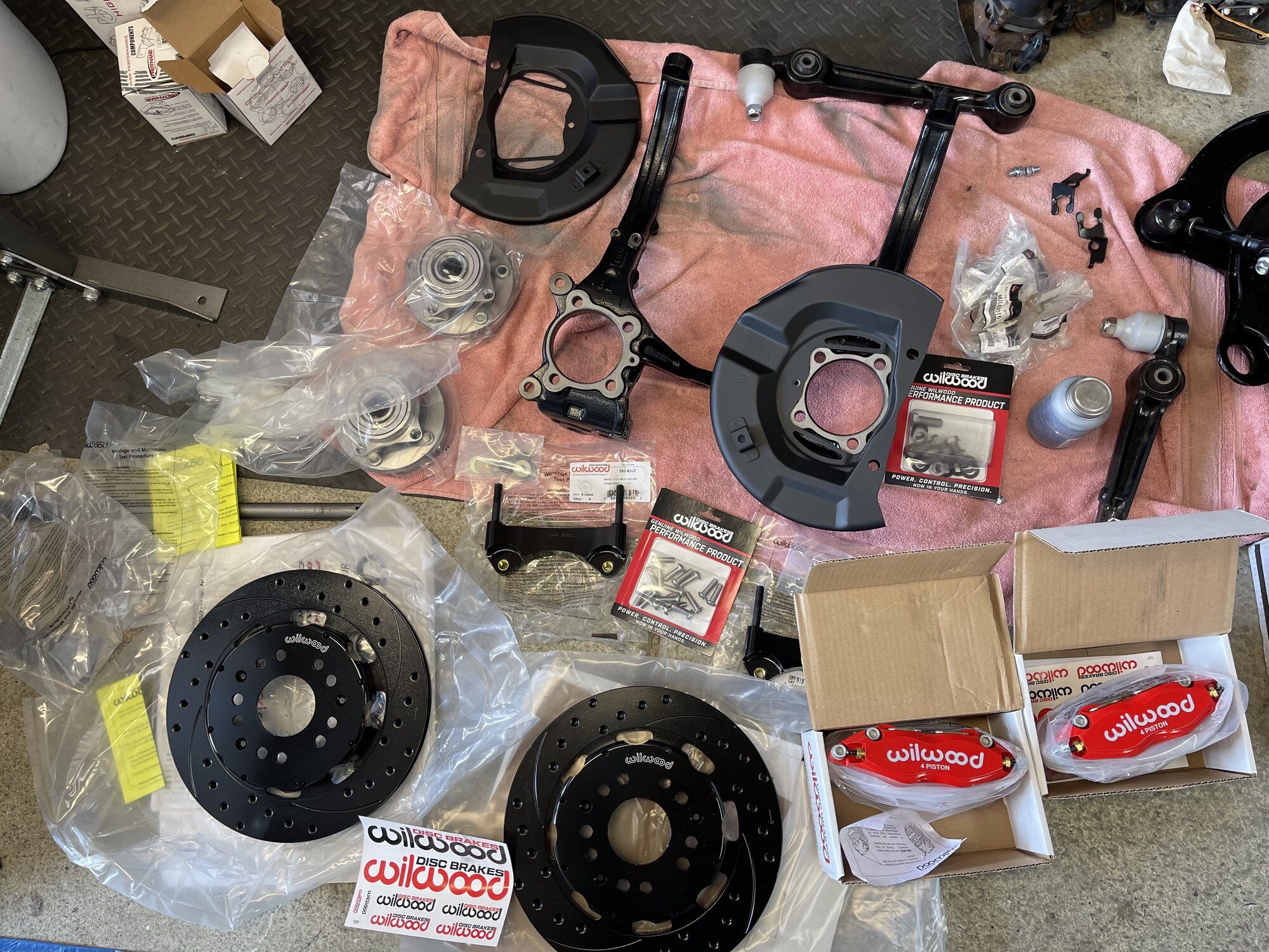

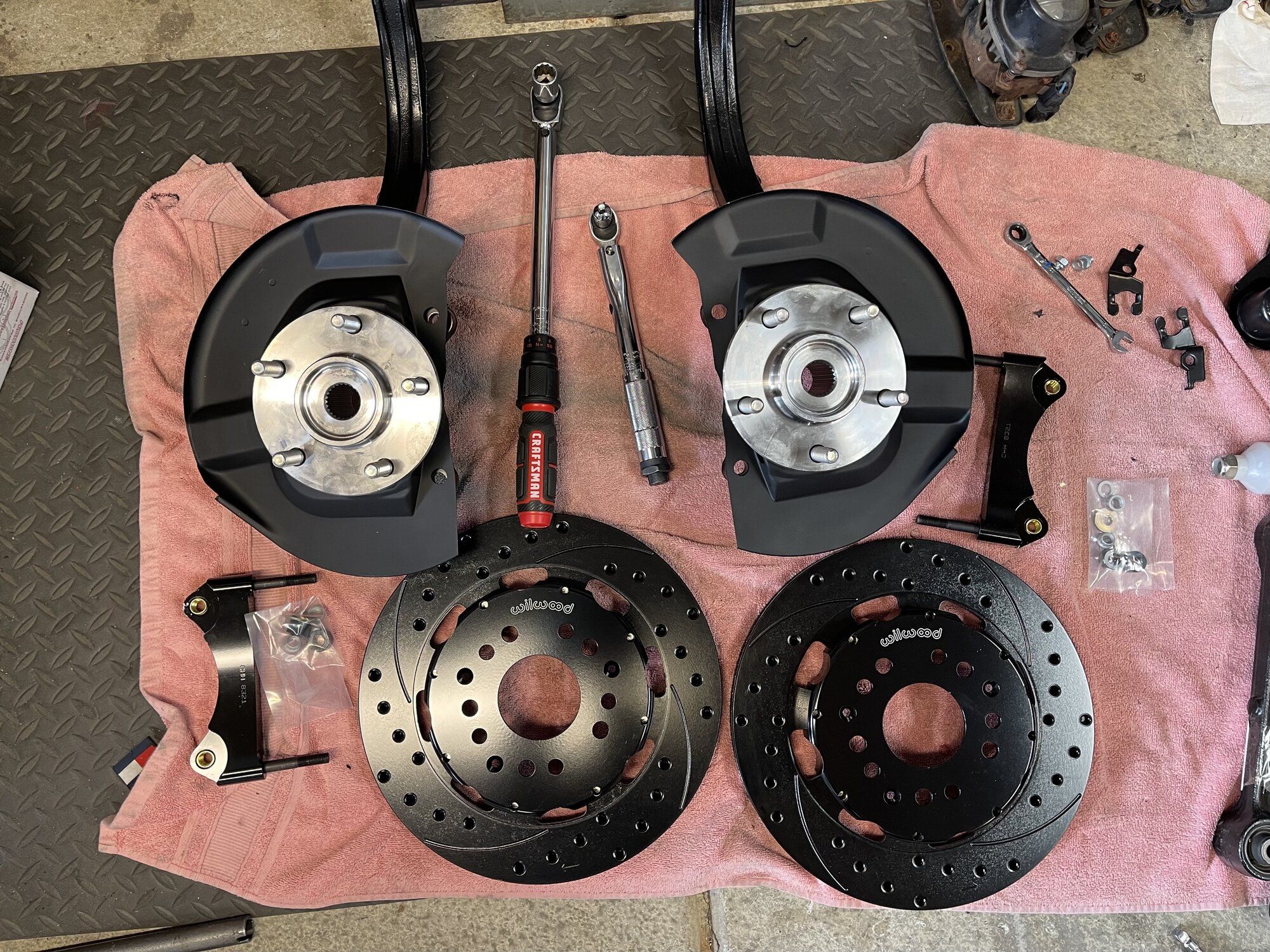

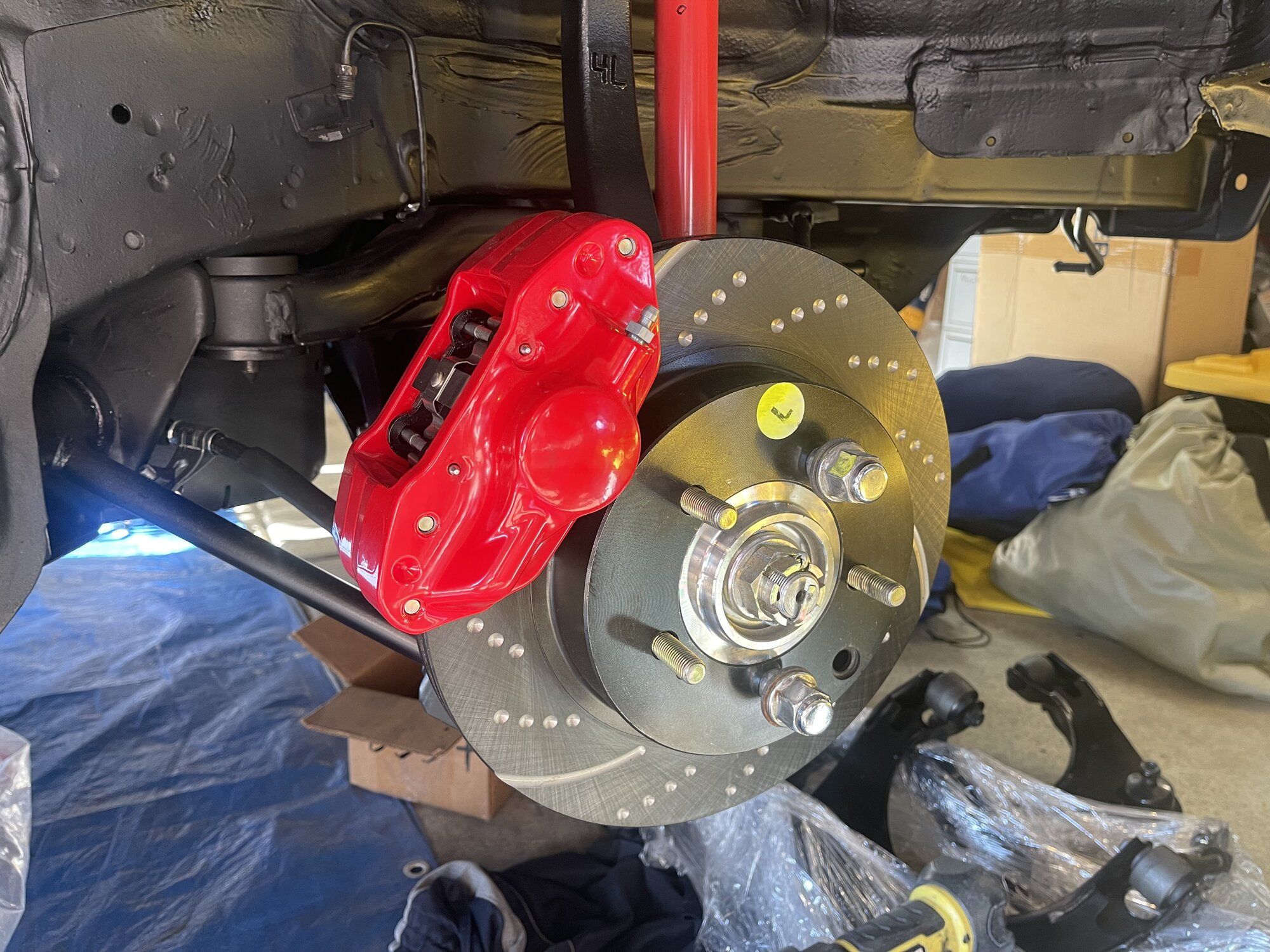

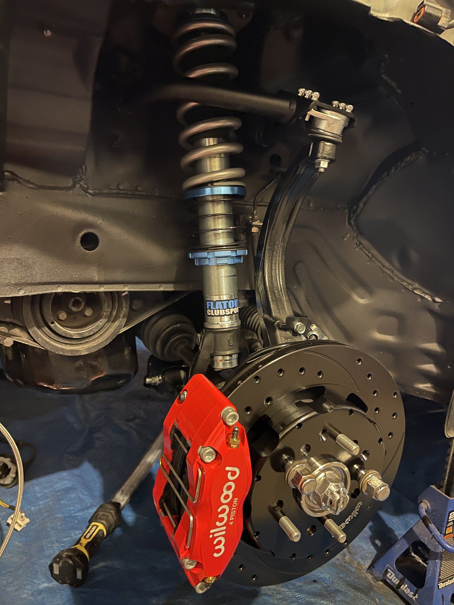

Making more progress slowly, but one step at a time. HUUUUUUGGGE thank you goes out to @Paul@RTM and Ziggy for hooking me up with the amazing Wilwood kit. They are the only place I found the black zinc rotors and even though Wilwood is back ordered they still got them to me!!! Can’t thank them enough for keeping the dsm community on the road.
So knuckles are back from powder coat and installing the new hubs/dust shields. Install says to remove them but I want to modify them to be able to use them still. Took some trimming and fitting but got it worked out.
(For the eagle eye, the dust shields are backwards for now, fixed it before install LOL)
Waiting for final paint to dry before I mount the adapter brackets on the knuckles. More to come.
Btw the install instructions online are awful. If anyone reads this and has ANY questions please let me know. There is ONE write up on here about them but it says mainly refer to the Wilwood instructions.

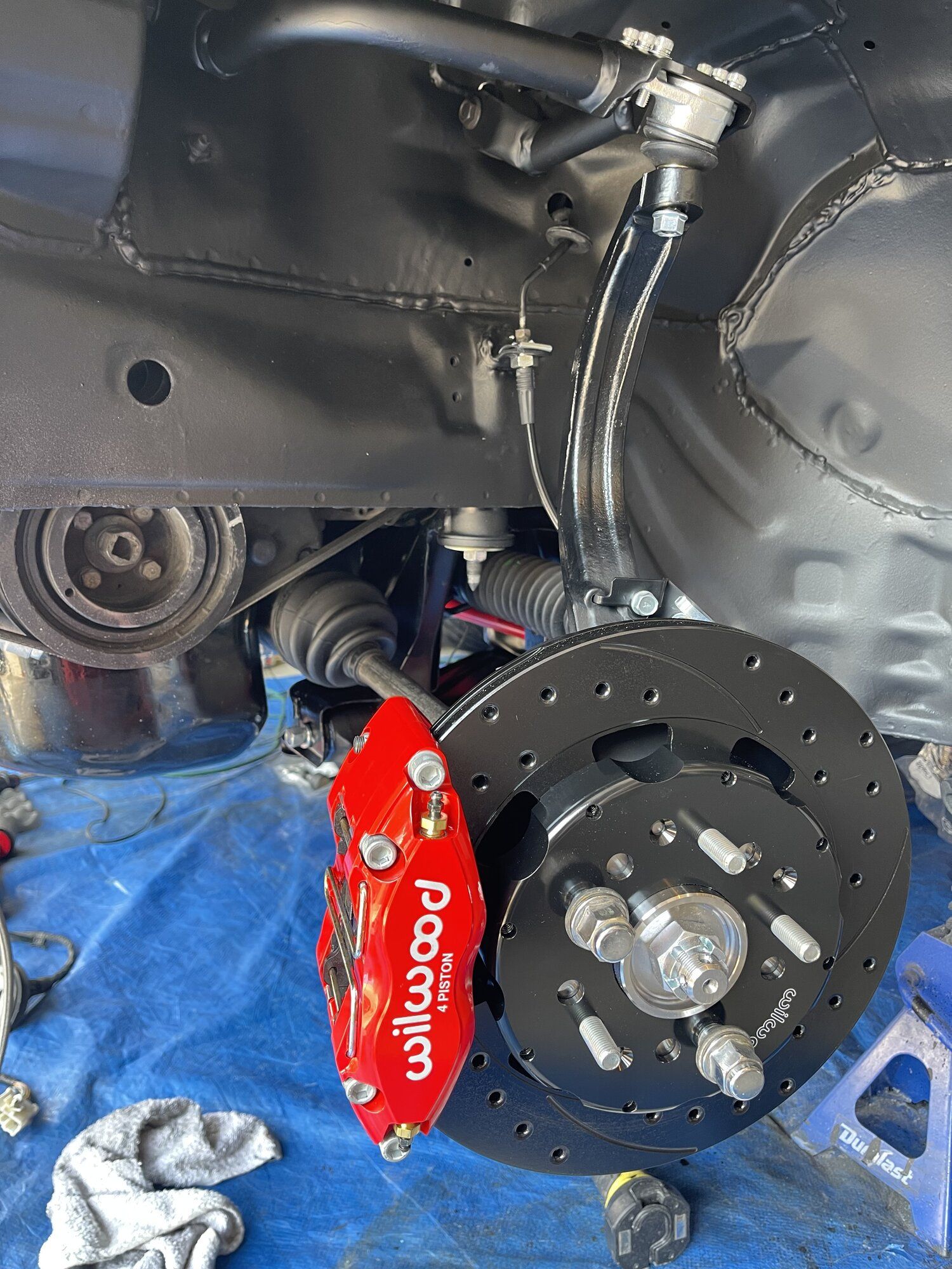

Had some time to wrench this past Monday and Tuesday and got the brakes mounted and shimmed to center. The process was pretty straight forward and I feel like I got super lucky. I wanted to retain the oem dust shield but was worried it would be too thick and would space the caliper too far and not center. Turns out that on my car with the shield and one .005 shim it centered with no issues. So got 90% of the front suspension back in and just waiting on the @Flatout Suspension coils/springs to come in tomorrow! Also again, thanks to @Paul@RTM for hooking me up with this kit!

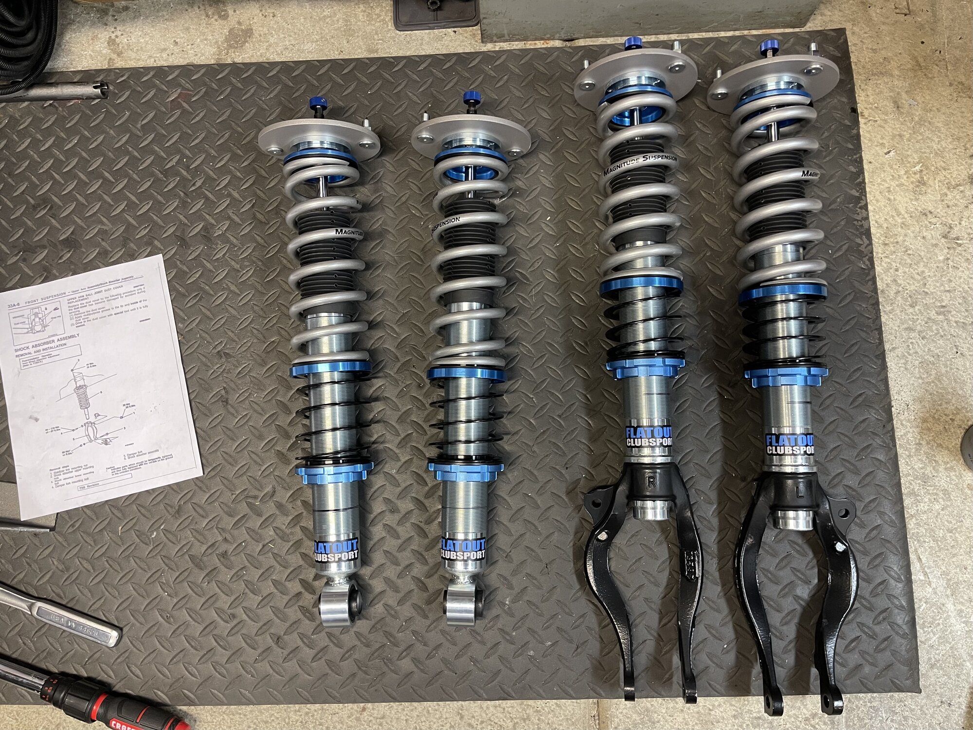

Super excited about getting the shocks/springs in from @Flatout Suspension! Can’t wait to get them put on over my weekend. The quality is amazing and they include this sick build sheet and quality control sheet. More to come when I get them mounted as well and how I set them up. Never installed and dialed in coilovers so pumped to learn on this amazing platform.

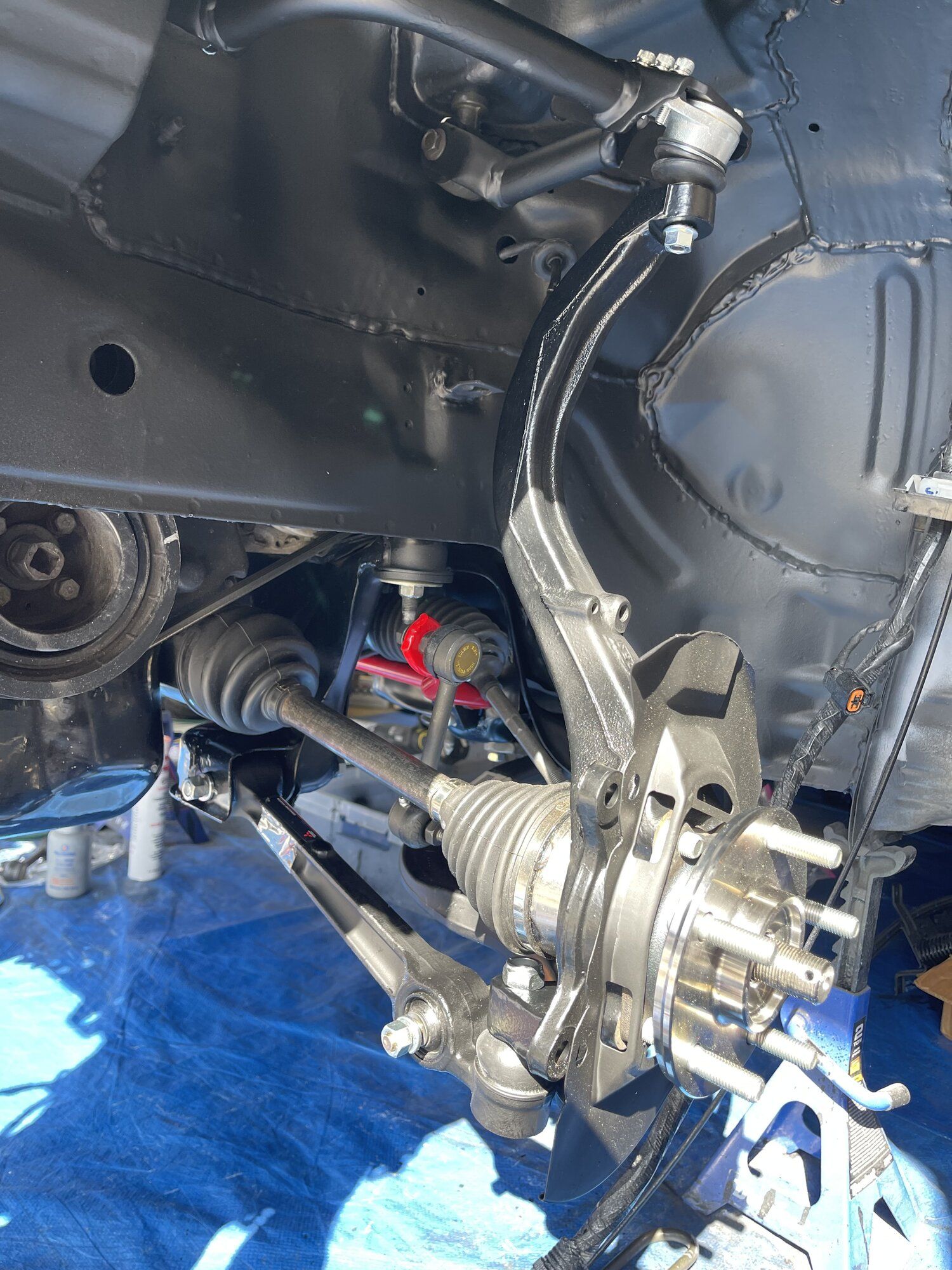

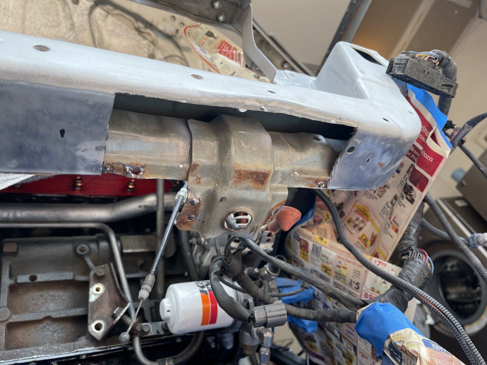

Ok, finally got time to slide these bad boys in and man look good and the quality is top notch. I really can’t wait to finally get them dialed in at a professional shop. Everything went together pretty well. Just a small amount of wrestling with the torsion bar and links. Have the setup to just a general ballpark on height but have no idea what height that is until I get the car off the jacks LOL. Waiting on a welder for my radiator support repair and then it will be time to button everything up and drop the car!

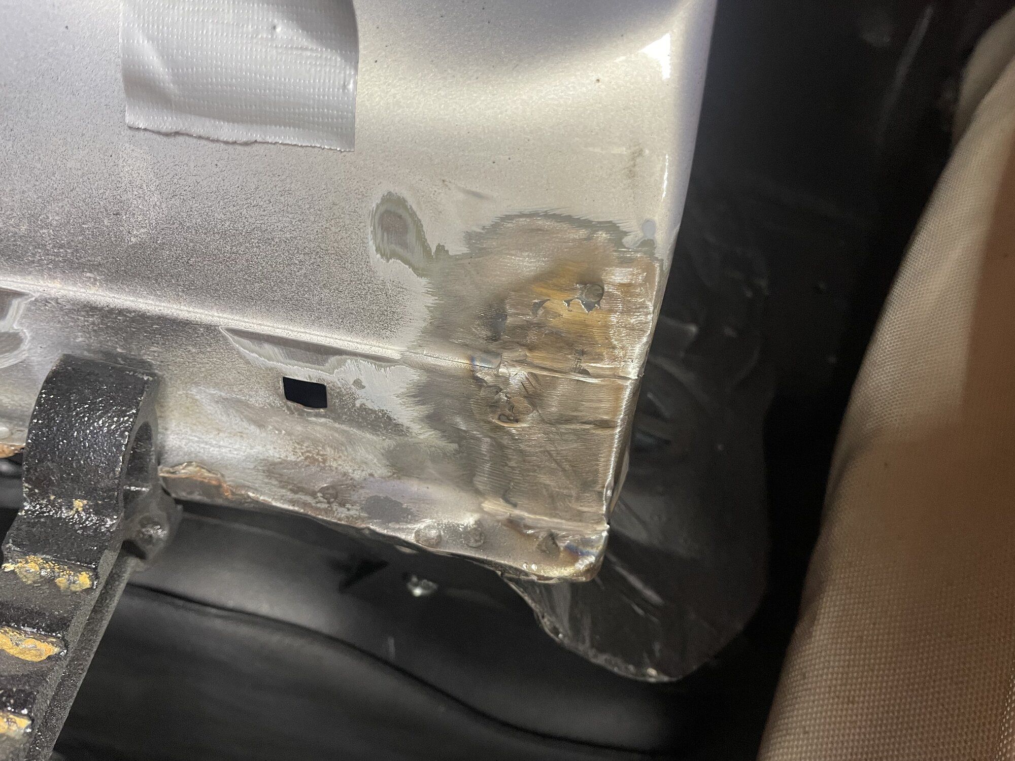

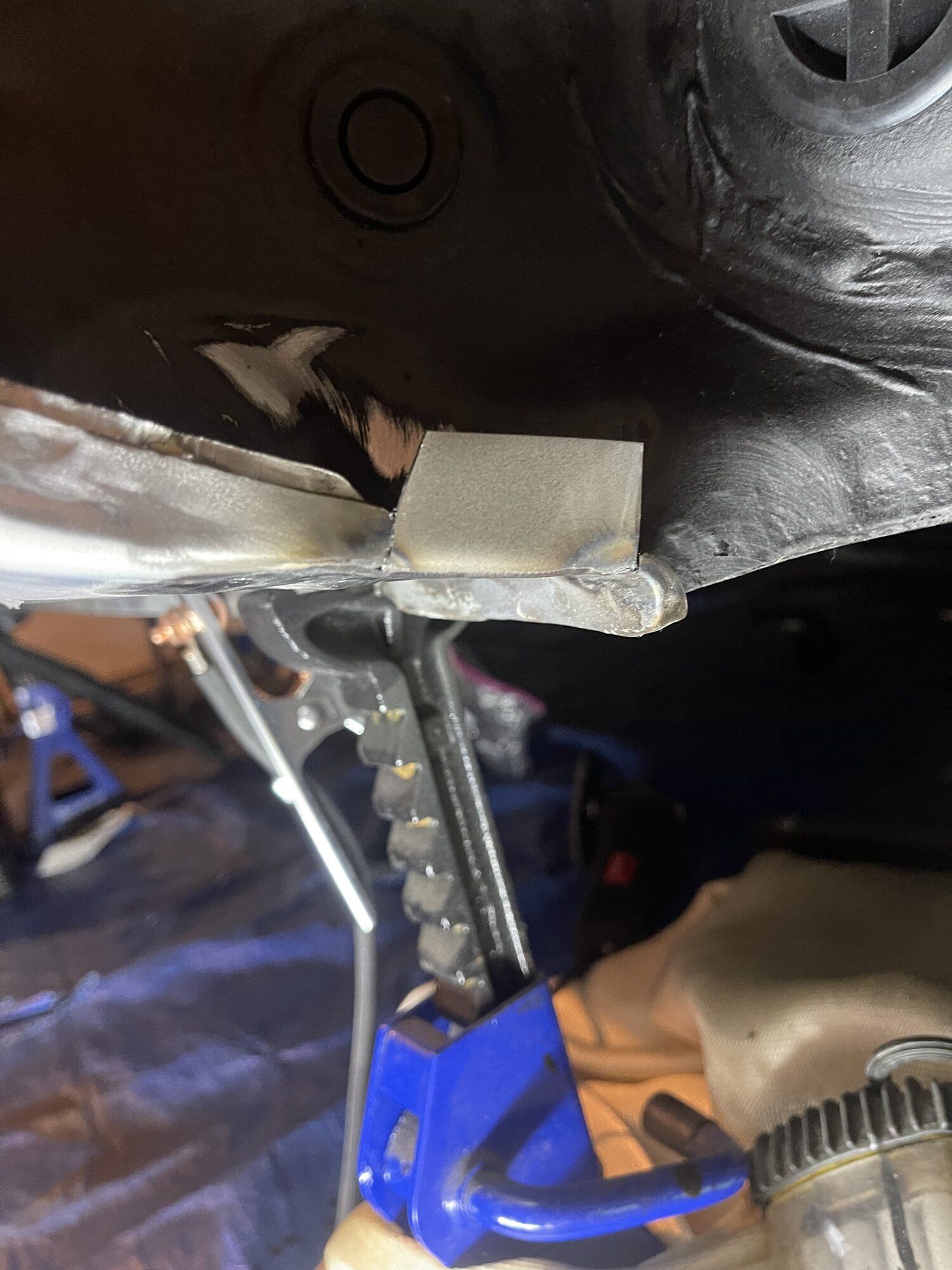

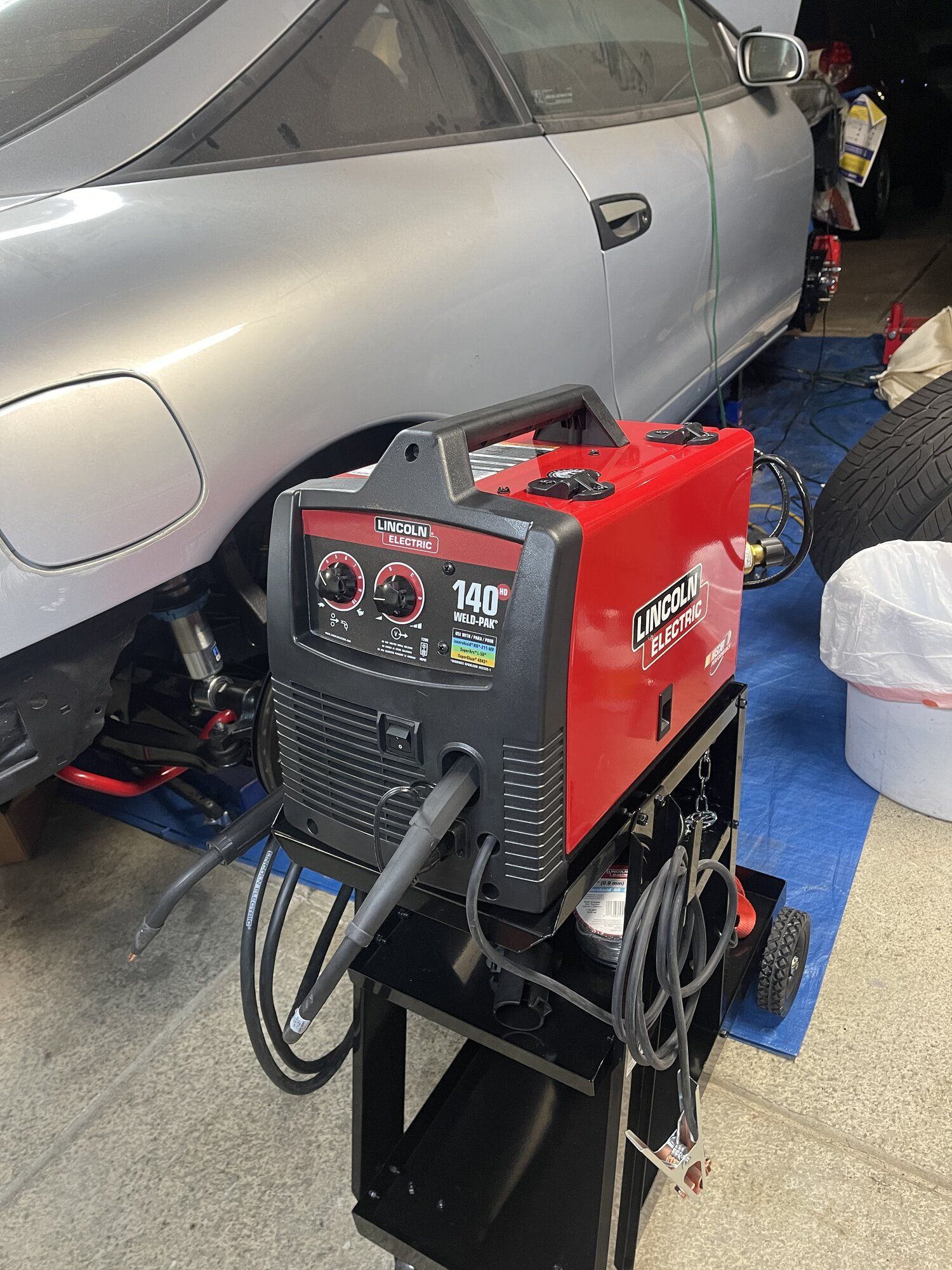

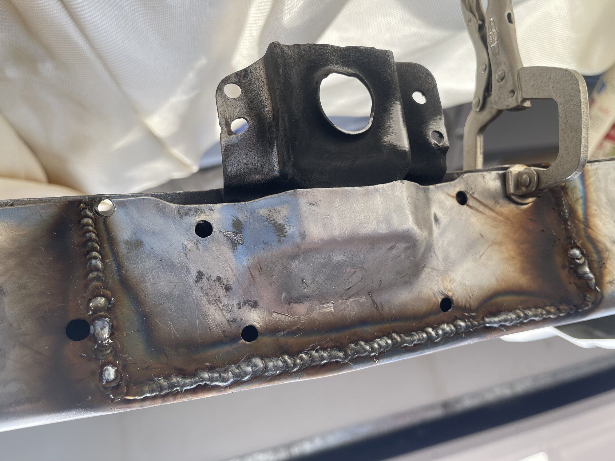

After calling around and asking for a mobile service to come out and help me with some welding I need done, I just said f*** it and bought on hahahaha. I kept either getting ignored or given insane price quotes (which is basically saying I don’t want to do it) so decided to learn a new skill and invest in myself instead. After a shit load of YouTube and practice I finally felt comfortable doing it and sooo happy with how it turned out.

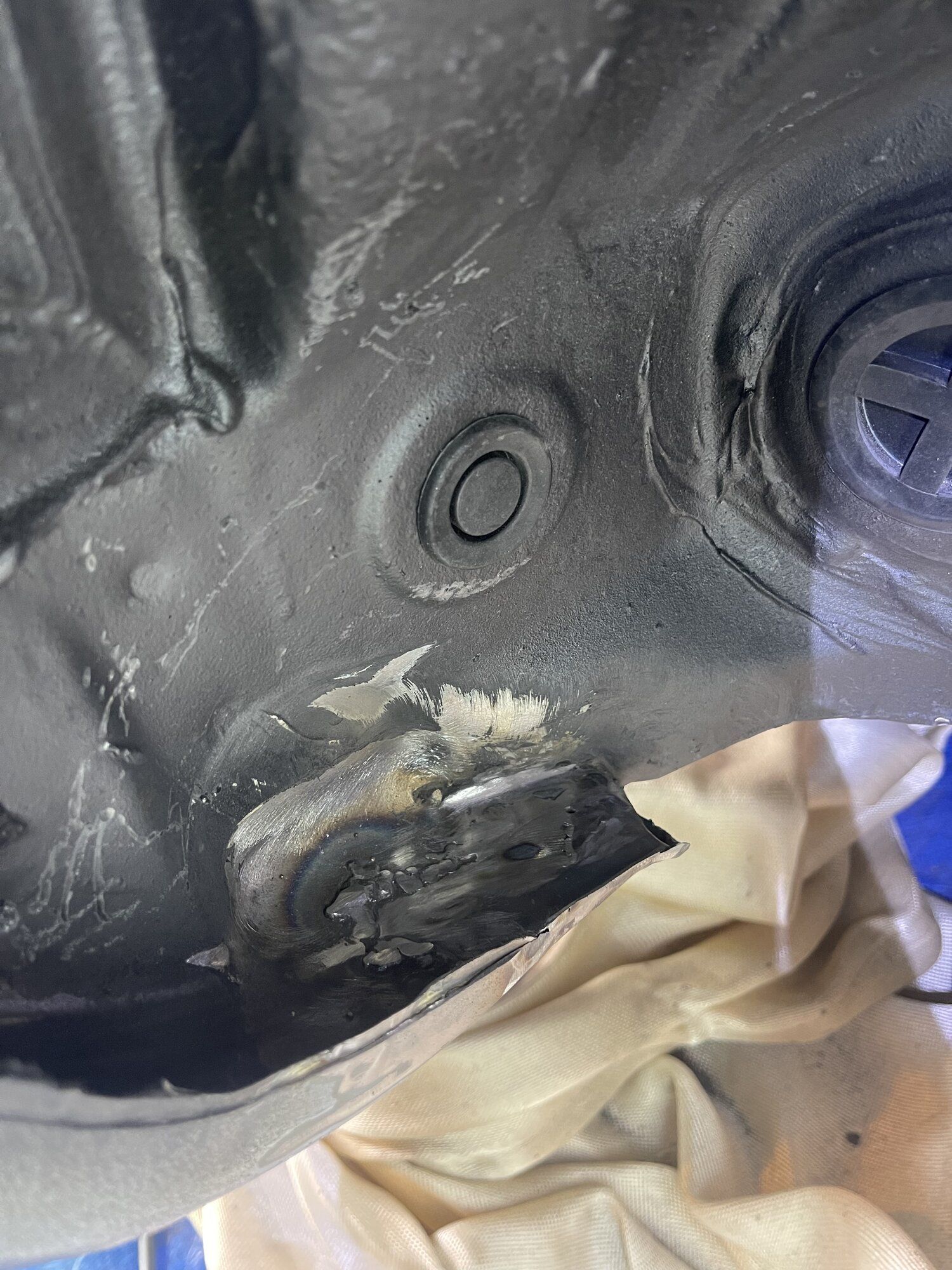

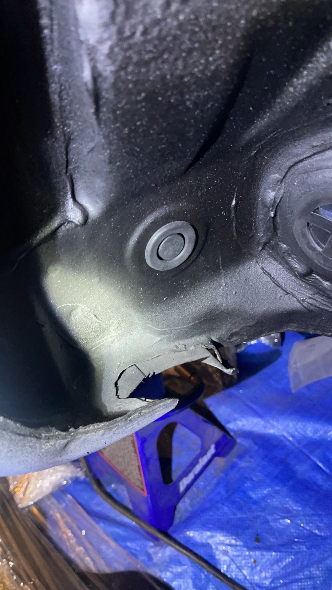

After cutting this out I also noticed that there is possible hidden surface rust behind parts so took some time to neutralize the entire area and then paint
My setup. Running .23 wire.
It’s tough given how thin the metal is but for those reading that want to try this yourself the big key here is go slow!!!! Tac it in by going from the thicker metal over the the thin, then start making quick spot welds over and over. Only do three then move to cool the metal. Just take your time and move on. Do not keep the heat too long in one spot.

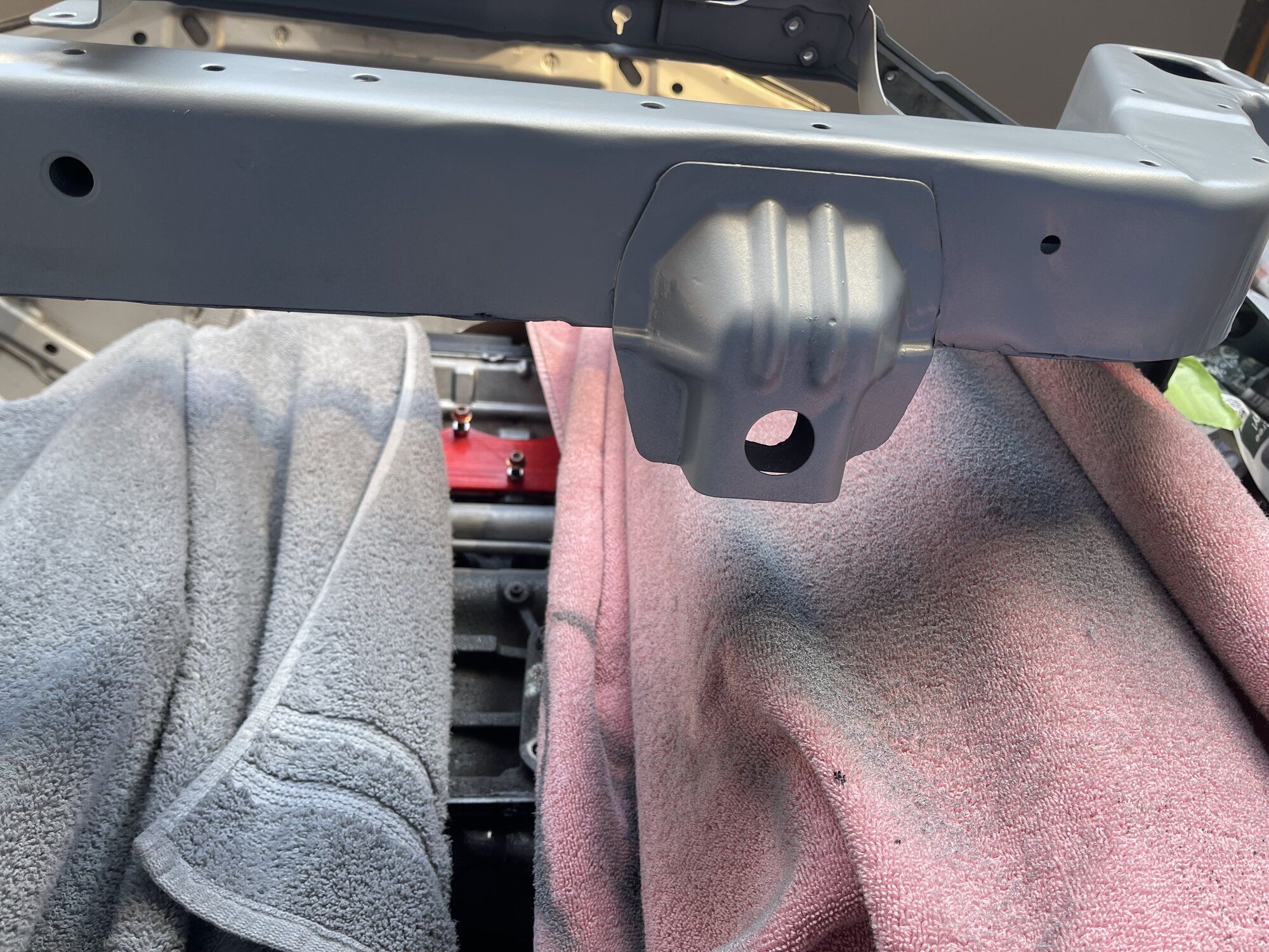

Here is the rocker panel..
And here is the finished front end after grinding and a small amount of bondo. Then painted. So happy with it.
