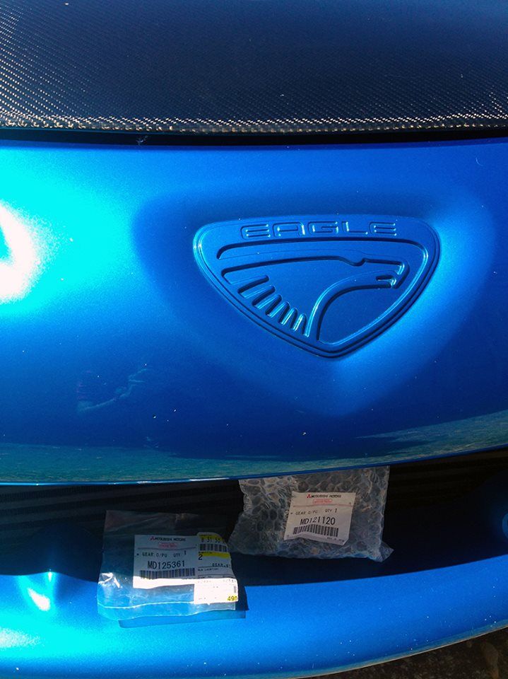

Spring will be here before you know it, xmas is right around the corner, I got a head start last year so when spring comes shell be all set to blast down the streets.
Thanks!
I didn't even wash it in this photo. That California car cover is amazing.... was not expecting it to look like this after 5 months under a cover.
The hatch looks the same as it did this time last year.
However, as you can see, this car does spend a great deal of time under a cover when not in use. I did that for the hood, as well. Since the VIS Hood tend to fade, too. Also waxed both the hood and hatch before they went on the car. So hoping the combination will help make the clear last longer.
And thank you! Always trying to keep up on the car. :)

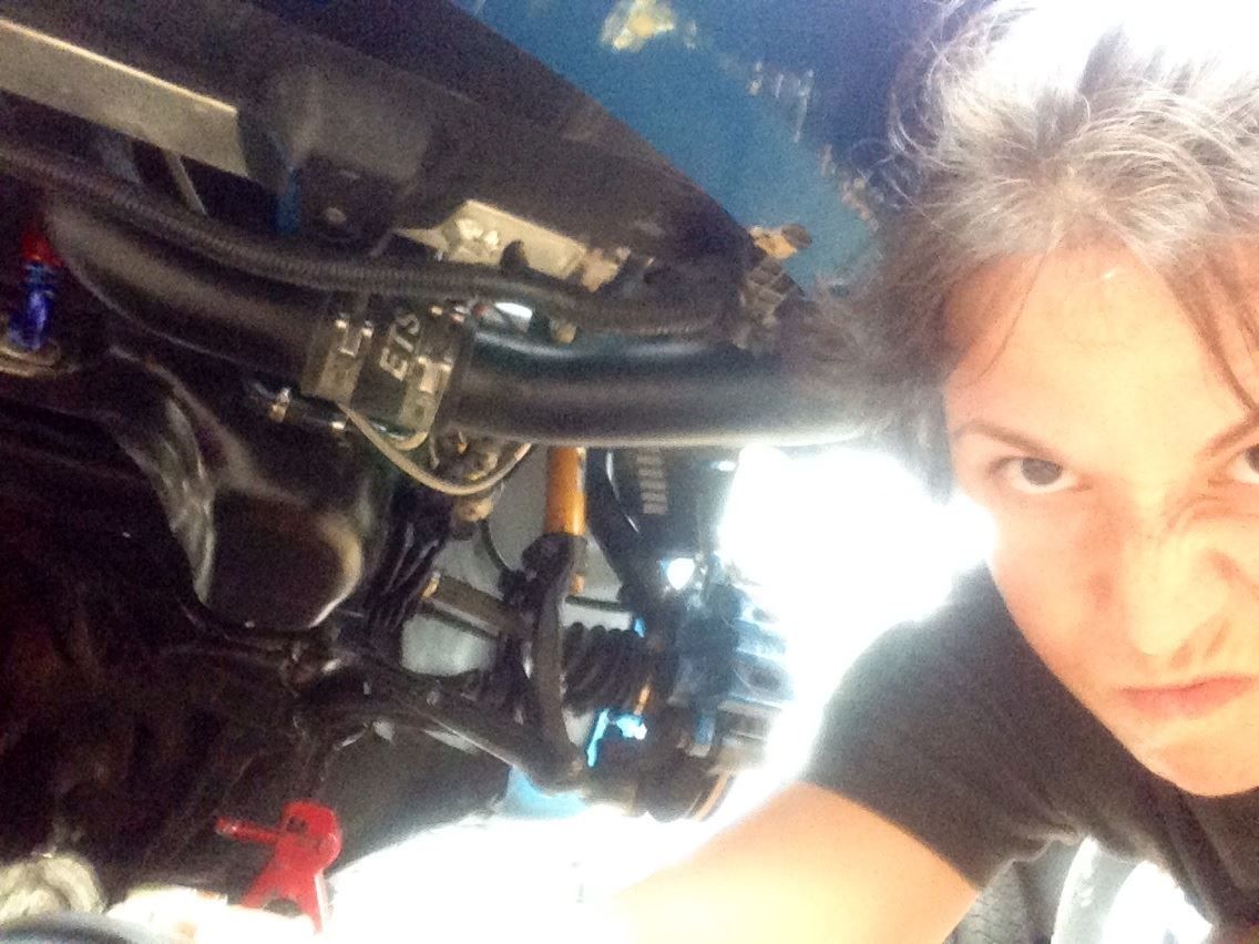

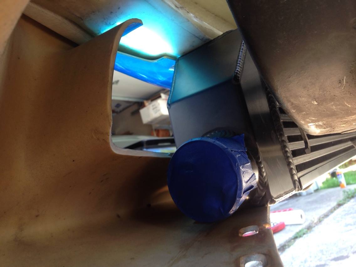

Ok, so the past three weeks have been pretty crazy. Memorial day weekend, ripped the car apart to install a new clutch, t-case, and viscous coupler. Also installed a new intercooler form ETS, as well as tore the front end of the engine back down to try to fix the oil leak. The seal around the oil pump shaft was tore up a little, so figured it was that. Slapped a new seal in it.

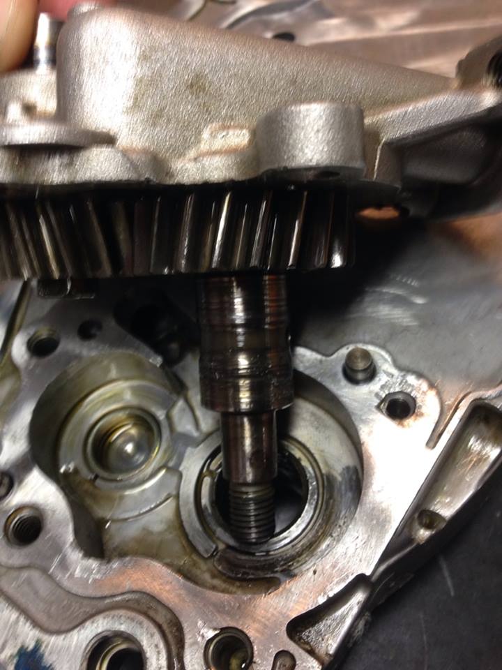

Three days later, got it all back together. Drove the car around the block. It shifted fine, and drove fine..... but then.... saw it. Was hemorrhaging oil. :( From the SAME spot. So parked it for the week.

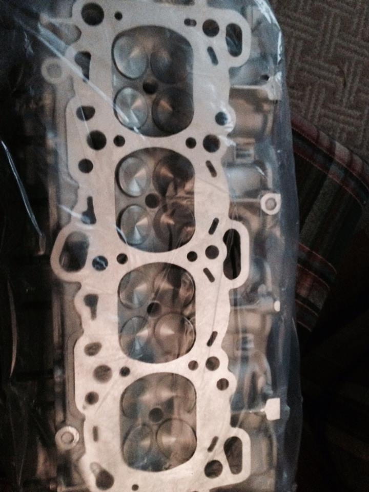

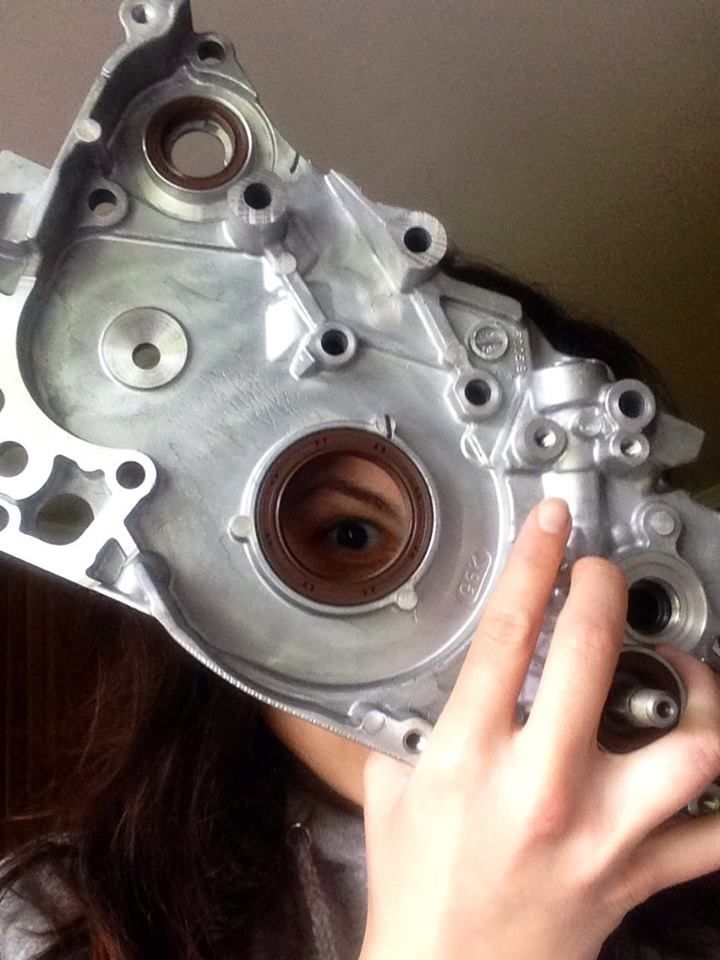

the following weekend, took the front of the engine back apart. Ran the car for a few seconds with the front of the motor exposed. (before taking the belt off) It was spewing oil from the oil pump again. So took the timing off, and pullies. Come to find out the oil pump had a LOT of play in it. Well, guess we found the problem. So ordered up a new front case, and covered the car back up for the week.
Around Wednesday, the part came in. I then had a discussion about the plight of oil pump failures and how they relate to the balance shaft. Without the BS there, the side load on the gears from the belt cause the gears to eat away at the aluminium housing. Some people have found decent luck with using the 1990 straight cut gears vs. the helical ones. So I got a set of straight cut gears to put in the new front case. However, the next engine build will be getting a race balance shaft put back in. I honestly believe that that is still the best option in preventing premature oil pump failure.
I am just glad this was discovered now and not at the big end of the track!
So, got the car back together, fired it up on jackstands, and everything looked ok. So we slapped on yet another new timing belt. (4th one now since october due to oil saturation.. LOL!) Drove it around a little bit yesterday, and no more puddles. *whew!* So HOPEFULLY now she will be set to go back to the track. :)

It is! I really didn't think to much about what a lack of a balance shaft would do after a while. But since the rear one runs right through that pump, it makes sense that it would provide some strength to counter the pulling force of the timing belt on the front gear. I guess it's not to bad if the car is driven normal without a lot of high-rpm use. This car has about 20-30k on its current build. The first year was mostly driving around town/highway. The second year saw quite a bit of track time..... Hot Rod Drag Week, specifically, really put the car under some stress.
I'm going to write the milage down, and see how long the straight cut gears last. See if there really is a difference. In theory, it should help out some with the side load.
