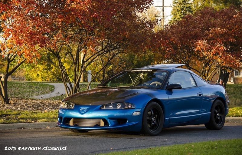

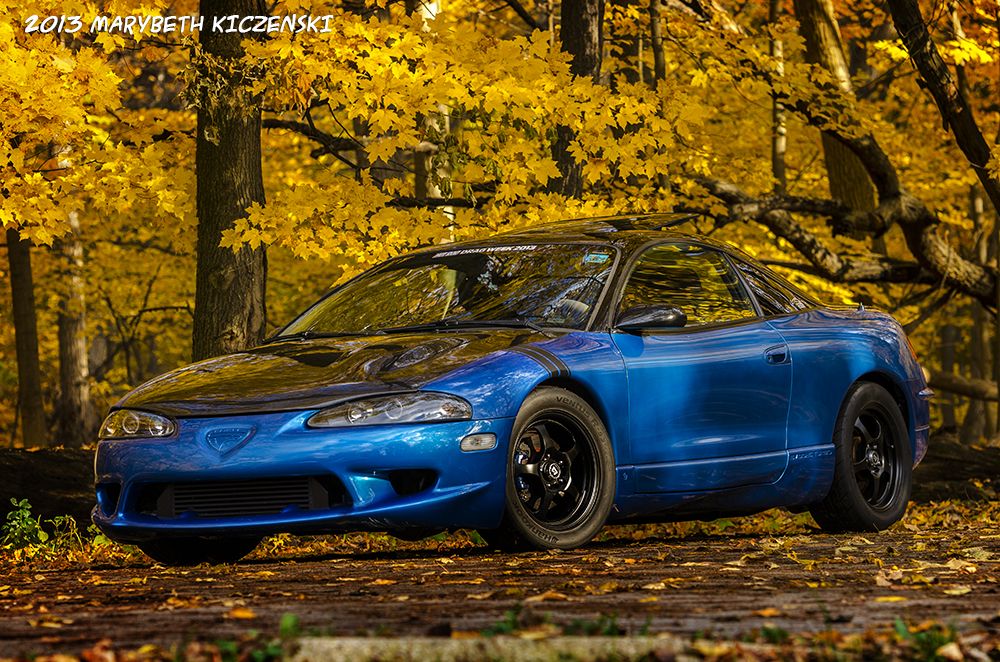

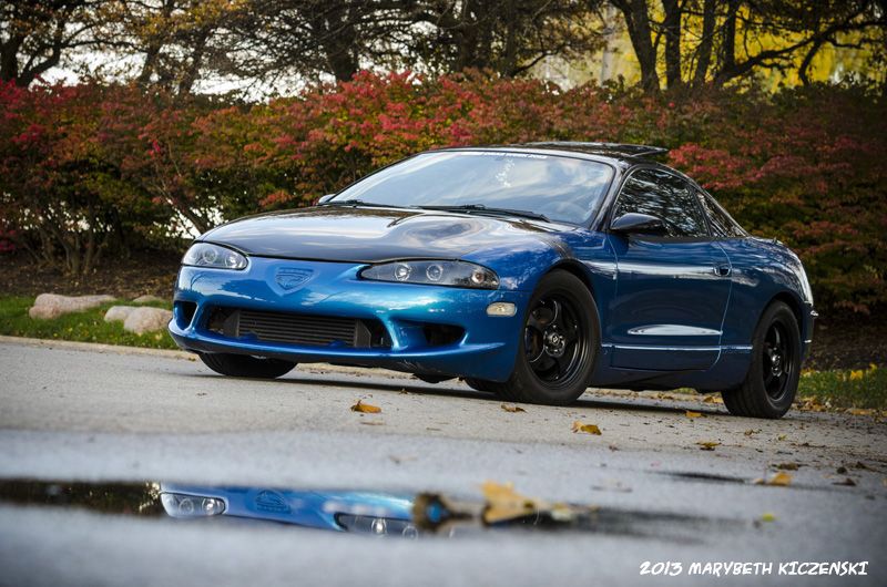

Installed a new timing belt over the weekend, so got it out for a sunday test drive/photo drive.
Planning on hitting the track again this weekend. Not sure how it'll go, since its colder and traction is iffy. But need the practice none the less.
