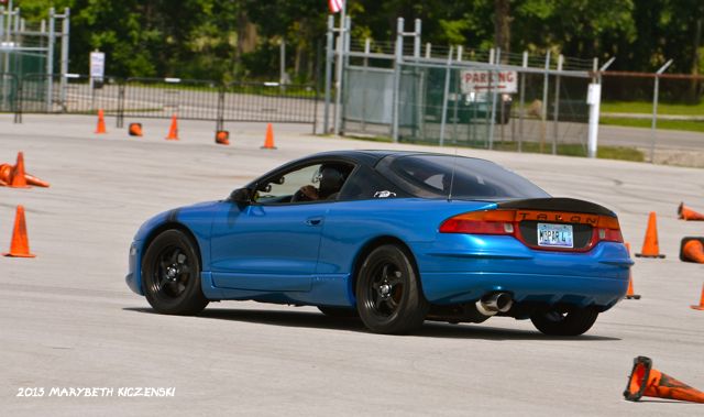

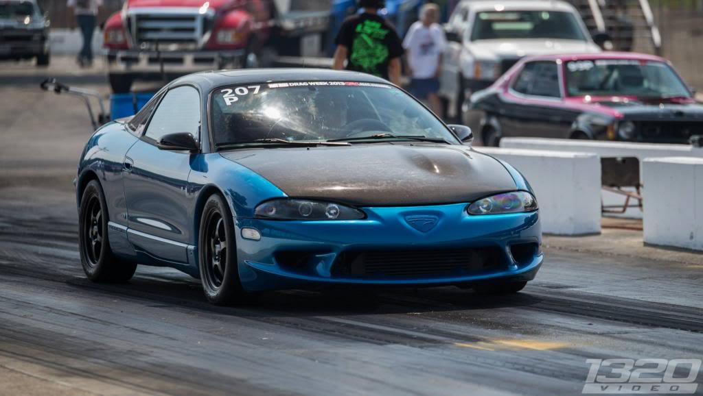

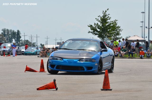

I would like to extend a huge "thank you" to Brian for showing me the ways of the autox over the weekend at the DSM Shootout! I appreciate the tips and tricks! :)
The Shootout was good overall for the car. During the Max Effort drag portion, the car was breaking up real bad in all the gears, so could only muster a 13.2 out of her. However, I did launch it off the 2-step in DSMLink for the first time. Cut by best 60-ft of a 1.8; but the breaking up hurt the time. Unfortunately, since this year the drag passed were hot-lapped, did not get a chance to diagnose the car. So that was that.
Went over to the people at Boostin' Performance to see if they has any spark plugs laying around. They just so happened to, so I bought a new set of four. Come to find out, the car has a cracked plug on #3. Replaced all four and took her out for a test and tune run: 12.500@116. Woot! Back! I ran a few more times, and managed to get her down to a [email protected]. My new personal best. There's still a ton more work on my end to make use of that mph, but getting there! So even though those times didn't count for the Max Effort. was glad to see that it was just a spark plug issue.
Overall, the shootout was amazing. It was great to get to see/meet new people from here, and to get to hang out with old friends! :)

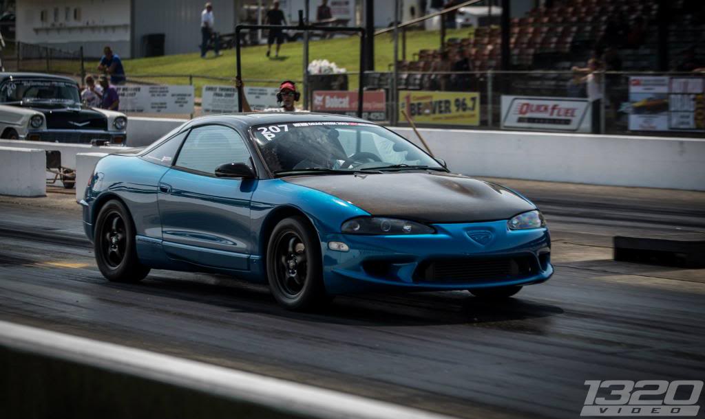

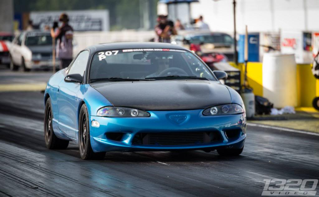

Here's some photos:

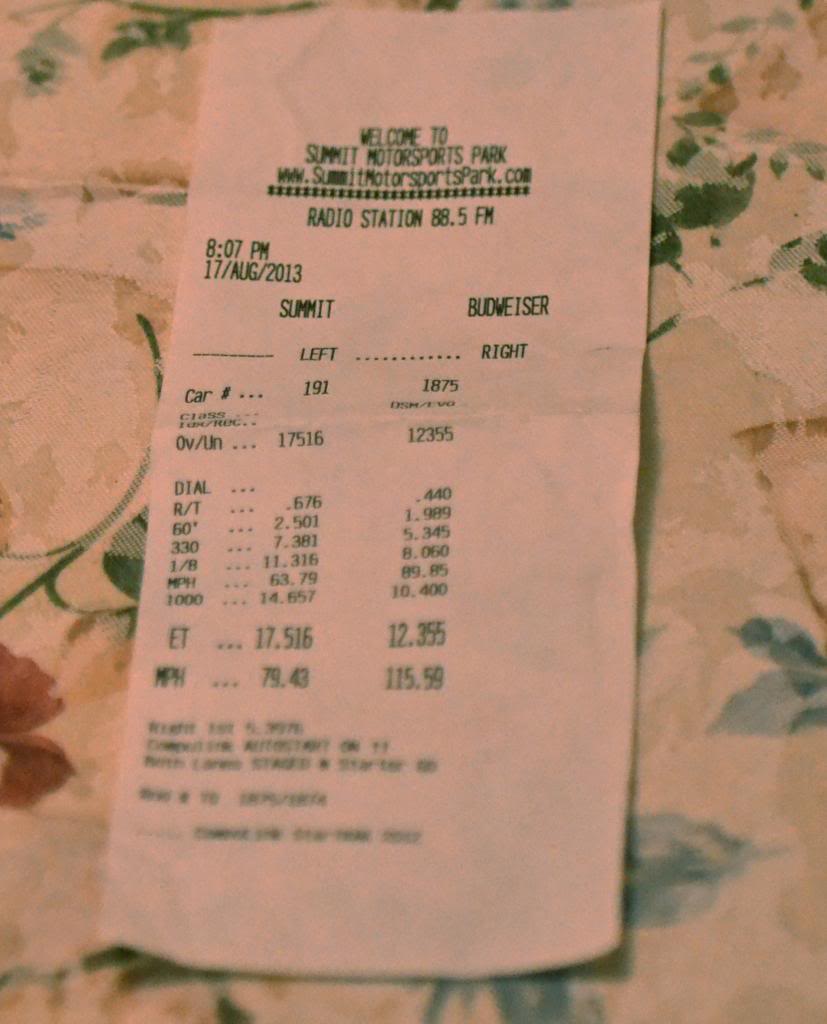

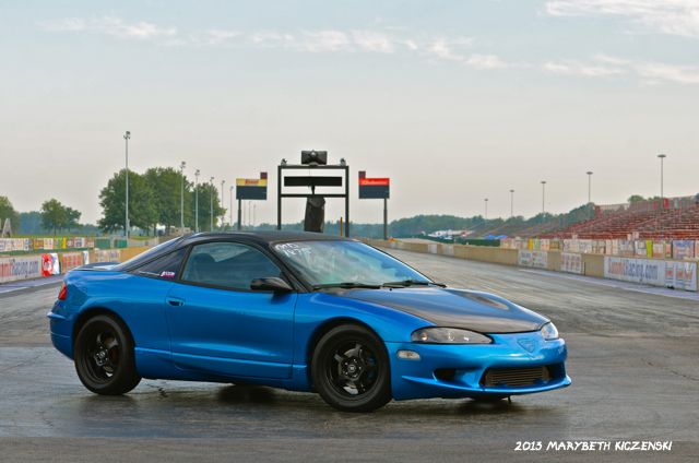

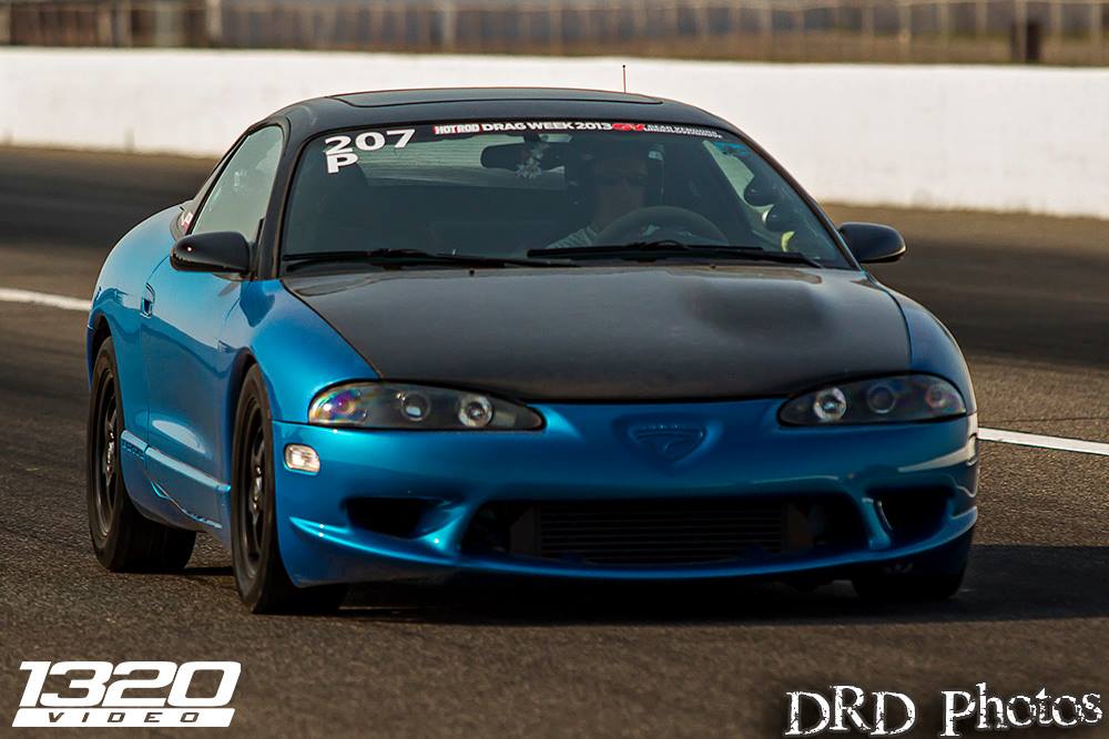

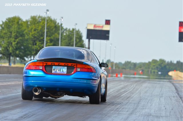

Here's some photos from the event:
