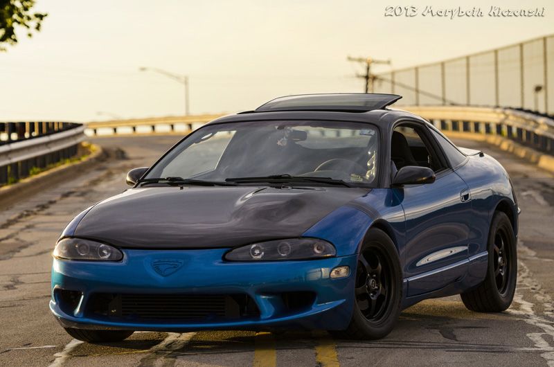

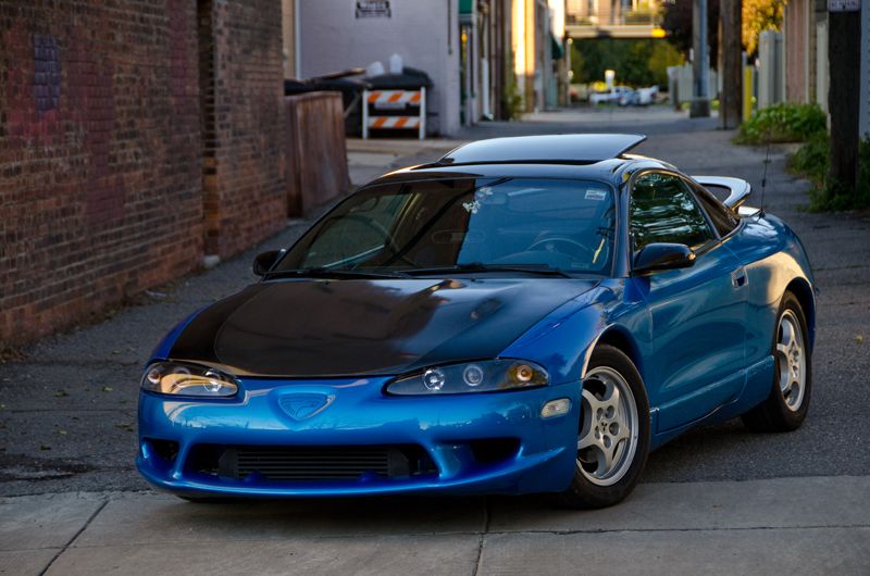

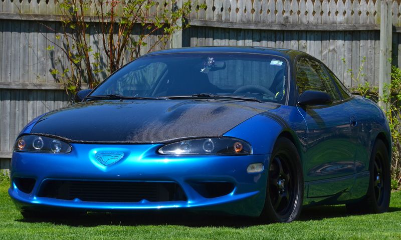

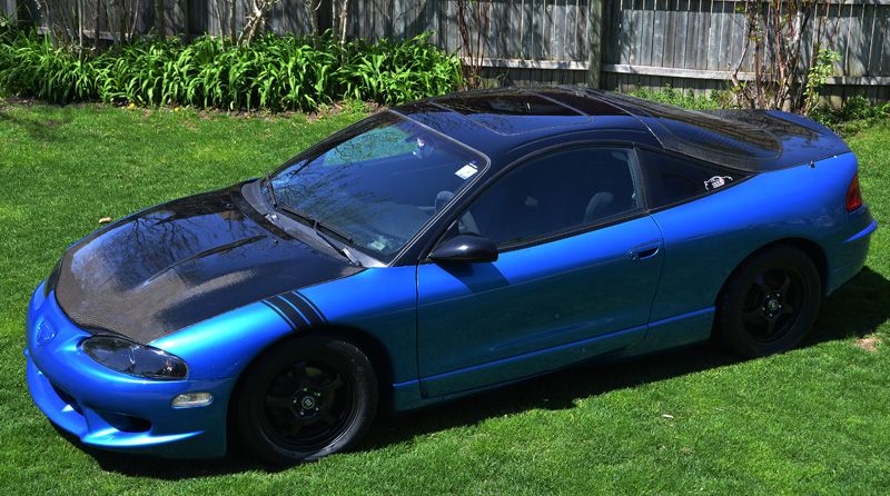

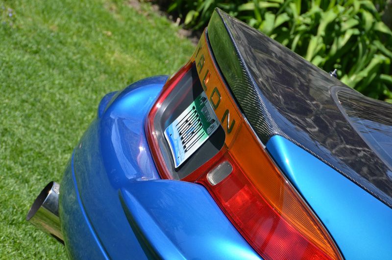

I've considered putting the spoiler back on it. I don't know if I want to drill into that hatch, though. So for now, I'm going to run it spoilerless and see if it will grow on me. Always have loved the high rise spoiler... adds so much character. We shall see. :)
The OEM hatch weighs in at 30# without the glass. This CF piece weighs about 8# So even retaining the OE glass, its still a significant weight reduction. So much so that I don't think I'll be able to use the hatch struts, as they are too strong now. LOL! Might just try one. He did clear it, not sure how many coats or what not, though. I am putting a coat of wax on it right now.

Thanks! :) It's taking some getting used to, but I think it's growing on me! The 2gb Talon spoiler was one of me fav OEM spoilers ever, so it was/is hard to give it up. haha!
Yes, Shane, 22 pounds! That's pretty significant! You know.. you should pester Brian about his CF hatch on the white car he will never do anything with. ;)
Lol, you know Brian, his plans change everyday for that poor car. He'll yell at me one day to come over and put his car together, and the next when I actually offer to he says it's not worth it because he wants to change so much and he wouldn't be happy with it. I might snag his odyssey battery he isn't going to use now though.
I know what you mean about the 2gb talon spoiler though, it is the best looking spoiler imho. However, I think the car looks "tougher" in it's current configuration, especially with the new wheels.

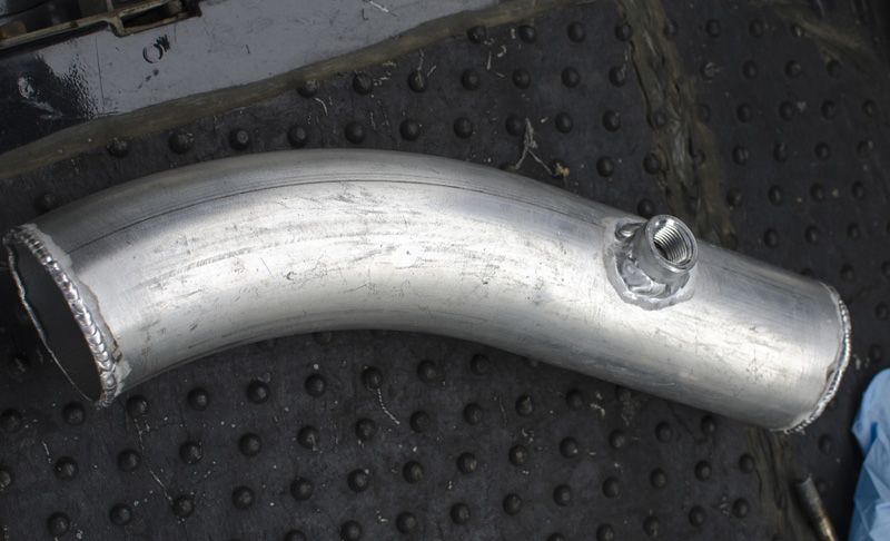

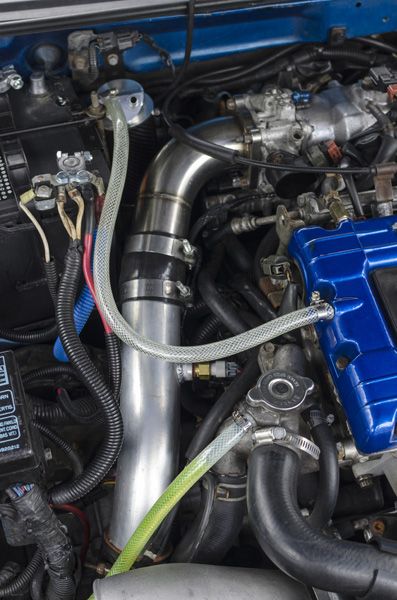

Yesterday spend the day converting the car to speed density, as well as swapping in the 850cc injectors. Since I'm going to be getting the car tuned on 110 (and thus maybe more boost!), figured the extra injector wouldn't hurt.
The best part of this conversion was actually being able to use a scrap piece of aluminum left over from a friend's intercooler piping project. It was perfect!
Just needed the bung for the IAT welded:
Was thrilled, as nothing ever end that easily with a dsm! ;)
Car started up and idled great. Now just have to wait until Thursday for the dyno tuning to get her back in good running shape!

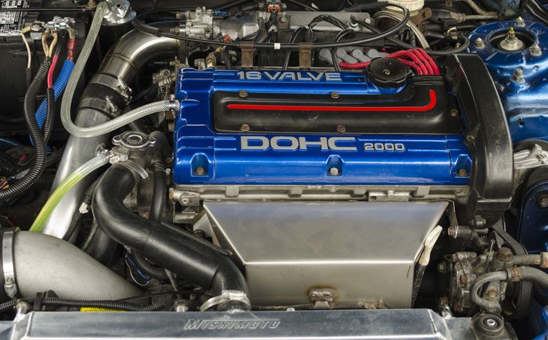

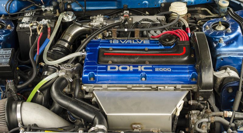

Before:
After:

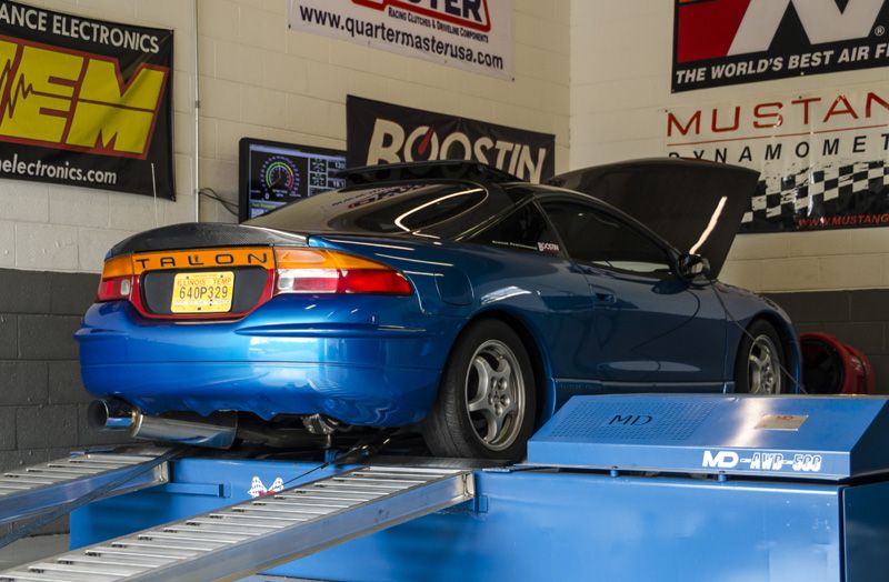

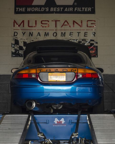

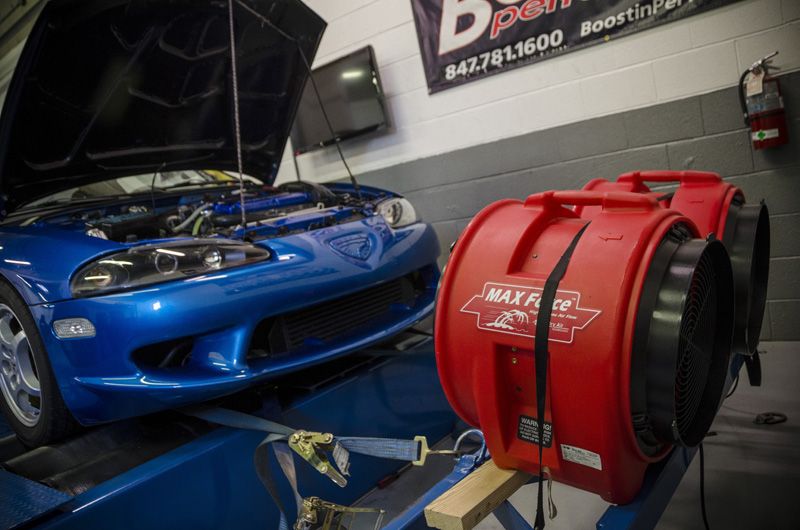

Took her in to get tuned on 110 and speed density. Car ended up making 343HP/327TQ! I was really surprised by this since it is on the infamous "heartbreaker" Mustang Dyno. I swear, Devin works some kind of voo-doo magic or something.
This is still on the 16g that I've been running for a few years now. I'm kinda happy that decided to stick it out with the 16g one more season... nice to know what its actually capable of.

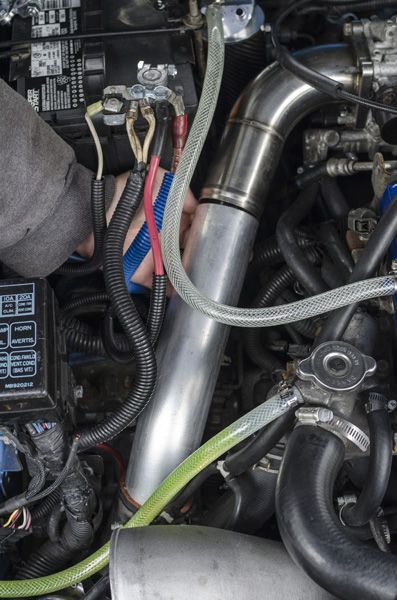

Finally got tot he bottom of the intermittent no charge from the alternator which evolved into no charge at all: broken wire on the alternator relay. It must have been cut before, causing the intermittent faiure; then just broke off. Fixed the wiring, cleaned off the corrosion, and bam! 13.5-14V again. :)
