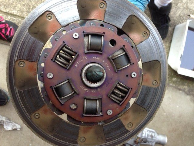

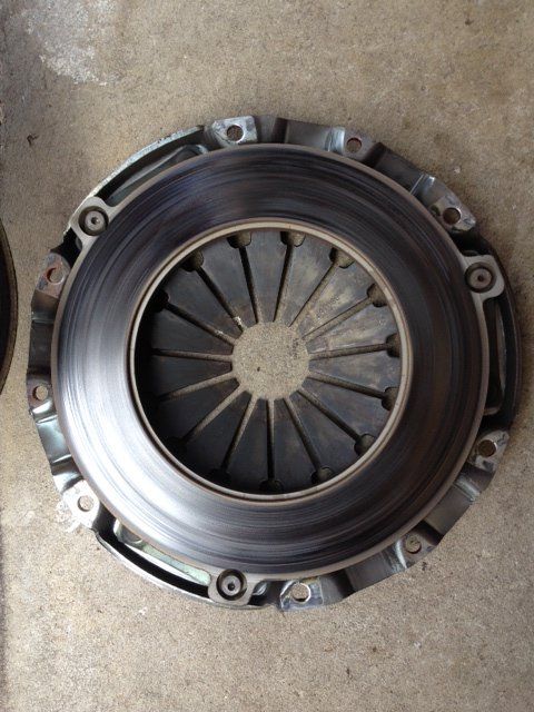

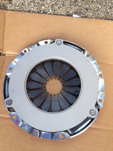

Update!

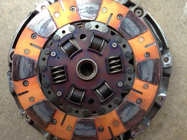

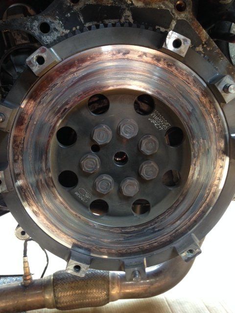

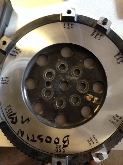

Clutch went in Saturday. Was able to get that trans out and back in that day. Which was a great feeling. Found that the Kevlar disc was toast, so that's why it was slipping. Not sure what caused it to fail with so little miles on it, though. Everything was adjusted per the FMS and book, and nothing seemed out of place. Checked the flywheel step height, and that was also within acceptable limits. So not sure what happened.

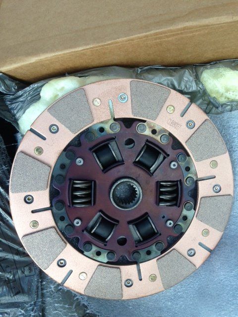

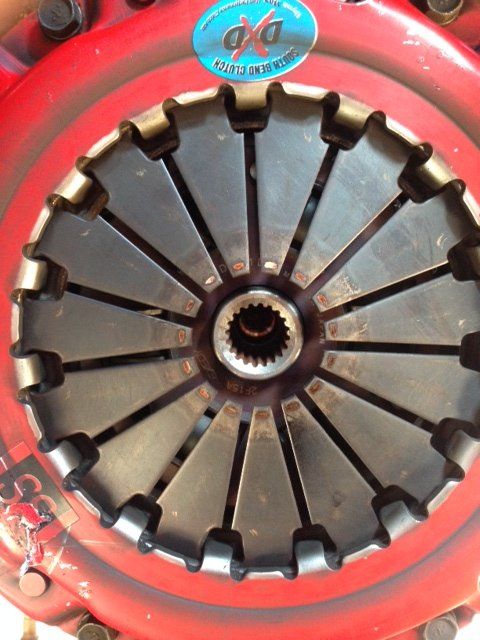

The car now has a full ceramic disc, as well as a new PP and TOB. Might as well start off with all new stuff, as not sure what part was originally the problem.
So here's to hoping that it holds for the shootout!! :)
Attached are some photos showing the old parts, as well as the new parts that went in.
Glad to hear you got the trans in and out with no problems. I'm sure you'll be good to go with the new full ceramic disc. Good luck with it at the Shootout! :thumb:
Aww, bummer!! I loved seeing yours last year! What's wrong with it?
I did take it for a test drive today... I think Tim was correct in thinking the pressure plate was the problem. This clutch is a night to day difference from the last one. Car doesn't fight me for gears, and it is super grabby. However, it only has a few miles on it. LOL! I have to do some driving before next week!!
You're going to love the ceramic disk, it's pretty sick. I barely broke mine in, maybe 600 miles and it hasn't came close to slipping...I can't believe how much power it can hold while keeping the stock pedal pressure. You won't be disappointed.
Good to hear! Honestly, I am really apprehensive right now because of how the last one did not hold up at all. But it seems people have had good luck with the ceramic version. So trying to be optimistic. :)

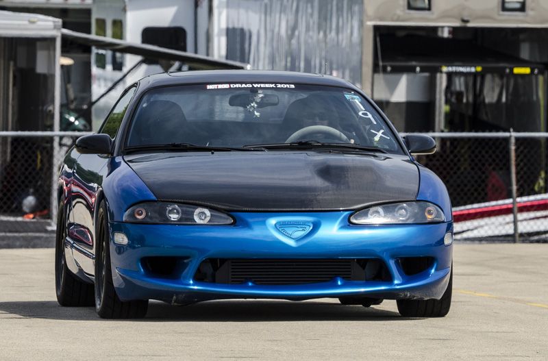

Awesome, I was also wondering what was under your headlights where the fog lights were. It gives that car a nice look, is it like a radiator or an air filter and what brand is it.
Thanks! It is the car's front mount intercooler. I had it anodized black, since I wanted it to be blacked out.
