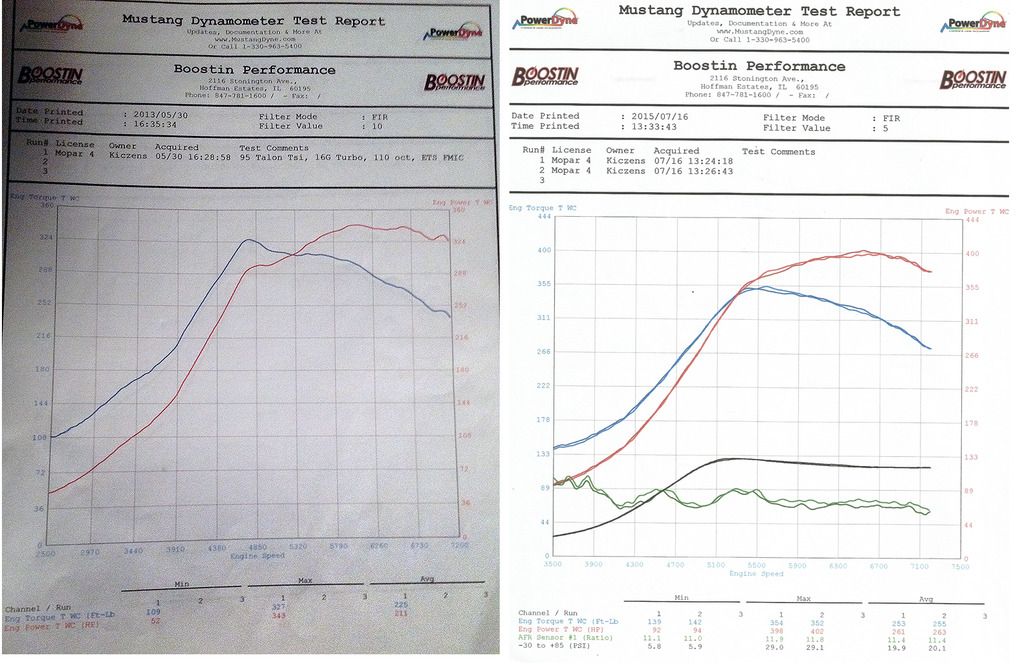

Here's the dyno sheet for those interested. I have both the 16g one and the FP one side by side. As it is kinda neat to see what just a turbo change does. Granted, the FP Green was tuned on less octance; but I was also not shooting for the max output, either.

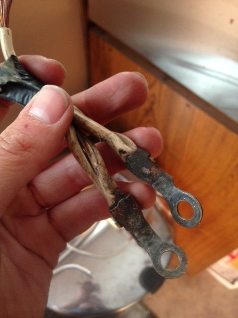

Car made to the shootout and back without a single issue. Then last Thursday the car dies. It pops the big ignition 30A fuse. I manage to get the car to work on the fuse for the power windows before it blows that one. Now it would blow that ignition fuse as soon as the key gets switched to "on". No bueno!!

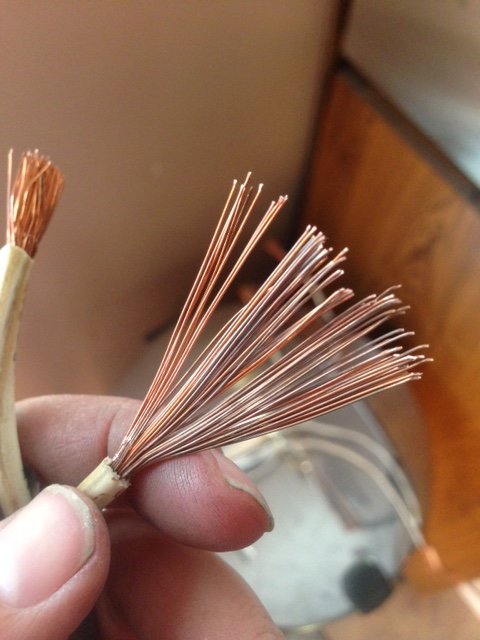

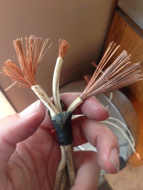

Trailer the car back form work and start to tear into it over the weekend. After about 16 hours, found out that the four big white wires that run from the fuse box to the battery are completely corroded and apparently causing a short. also found that there's a few other shorts the car has, but ones not bad enough to make it pop fuses.
Currently in process of getting it back together. However, I did order up some wiring harnesses from Miller Import Parts. I am going to do what I should have done years ago: strip the harness of all the things the car doesn't use and clean it up. I hate electrical with a passion, but it is something that needs to be done and have been avoiding like the plague.
Here are a few photos of the wires that were causing the issue. Honestly, I was expecting more green corrosion with how it would blow that fuse...
Also, interesting to note is that with the new wires in place, the radio works better, and the car starts quicker. The radio thing is what really gets me. I was having issues with that thing for a few years... just never really worked well. Guess it makes sense that faulty wiring would cause small issues, too! So, if your radio starts giving you some trouble, start checking out your wiring!

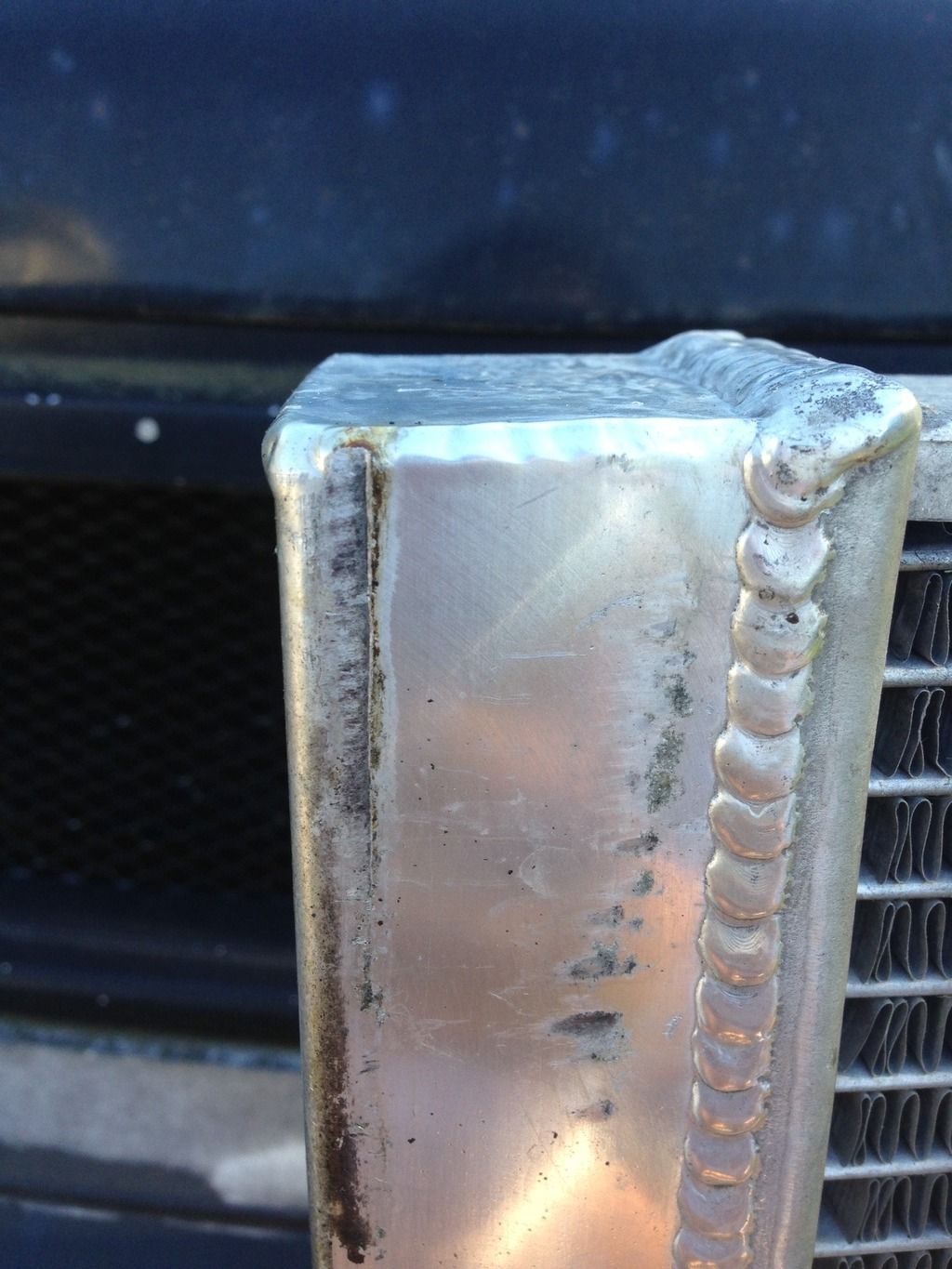

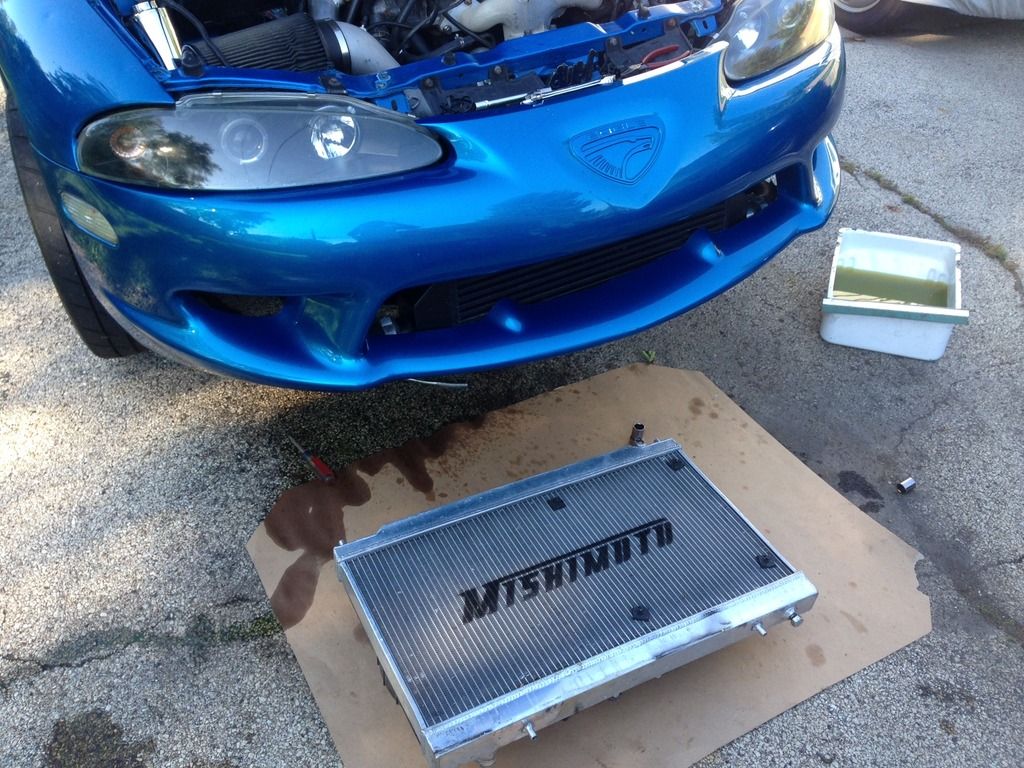

Drove home. I always watch the gauges closely, and nothing was out of place. I get home, and notice antifreeze on the ground. Grab a flashlight, and see antifreeze all over the underside of the car. It was concentrated along the bottom of the radiator. The mishimoto radiator developed a crack along the lower tank and I had no idea. :( So I buy another radiator. Upon draining the coolant, there wasn't much left in the car. I now had a gut feeling that the car was not going to be ok.

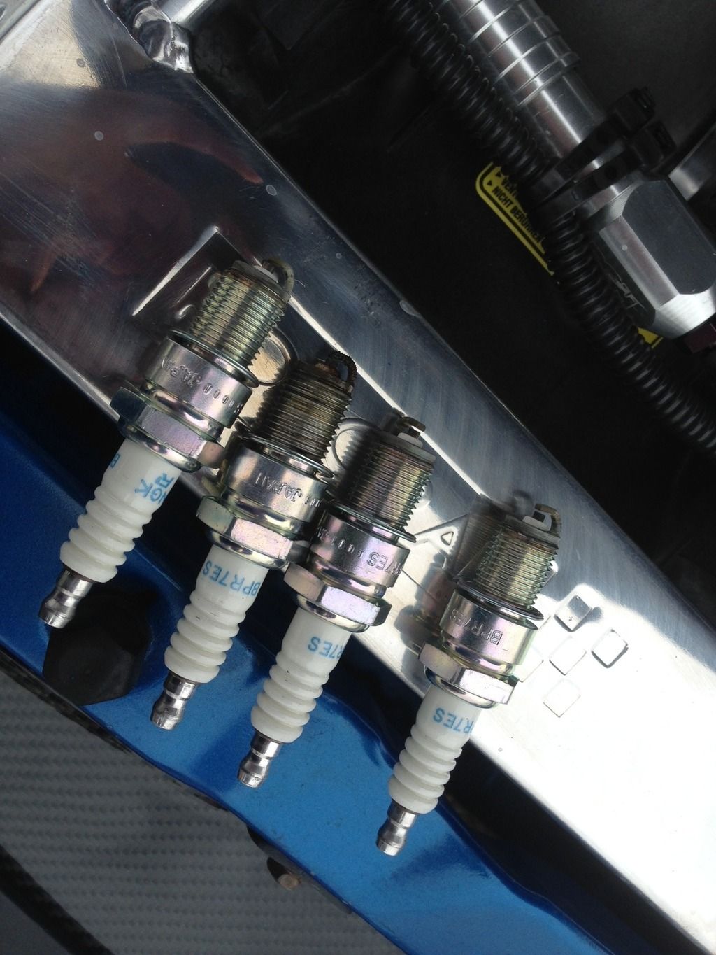

Install the new radiator, go through thew burping procedure. Car seems to run fine, no overheating; nothing. Figuring it was ok, drove the car down to MOD in Normal, IL. It makes it there and back without a problem. We decided to take it to the track Sunday. Pulled the plugs, and #2 looked a little off. Grab the compression checker, and its even across the board. Probably should have done a leak-down on it, but honestly, with it running fine, didn't seem to think it needed that.
Sunday we head to the track. I launch it super easy, (as a result,bogged it), and shifted it easy to a new best trap speed of 121MPH. Go to park it. Notice that it pushed quite a bit of coolant into the reservoir tank. It was also down a little. Top it off and head to the stanging lanes. This is when the car starts smoking horribly. :( Yup, the gut was right... car is hurt. Turn around and go back to park, pull the plugs, and there's coolant all over #2.

Pic showing the spark plugs. These are brand new. That was the only pass on them... you can see how unhappy #2 is.
