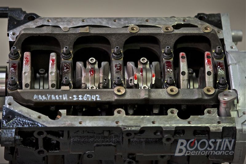

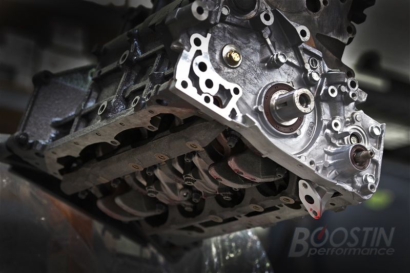

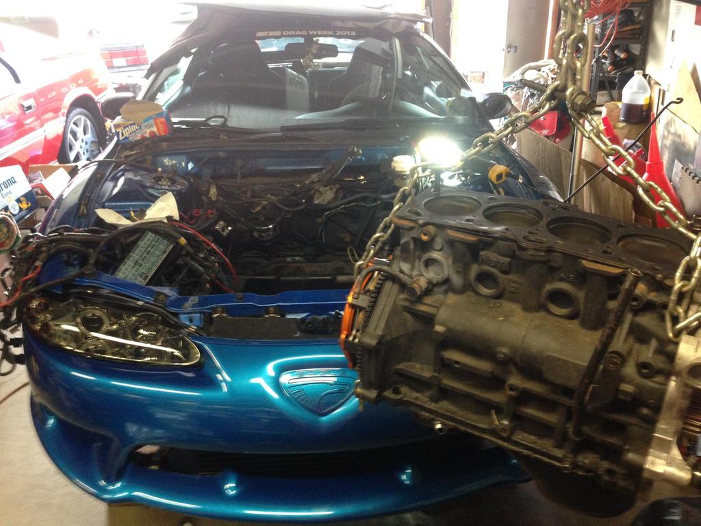

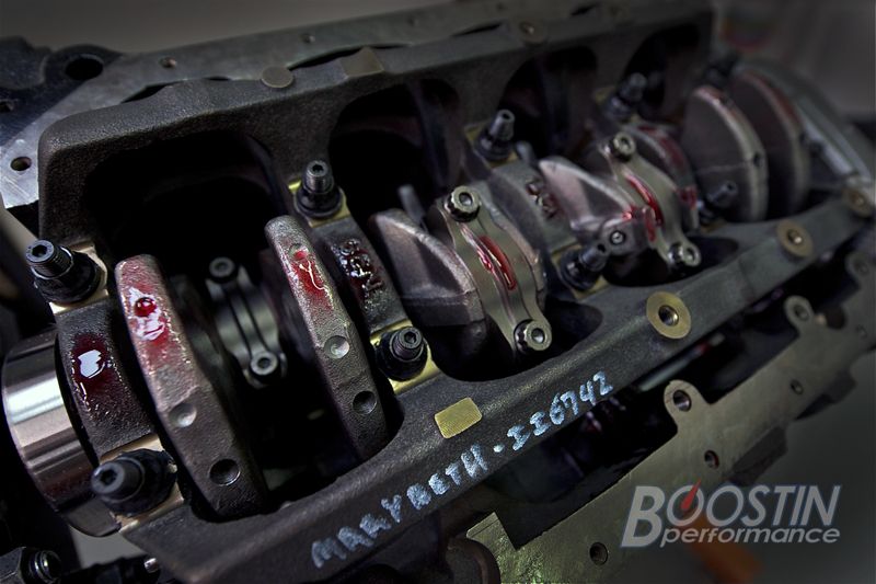

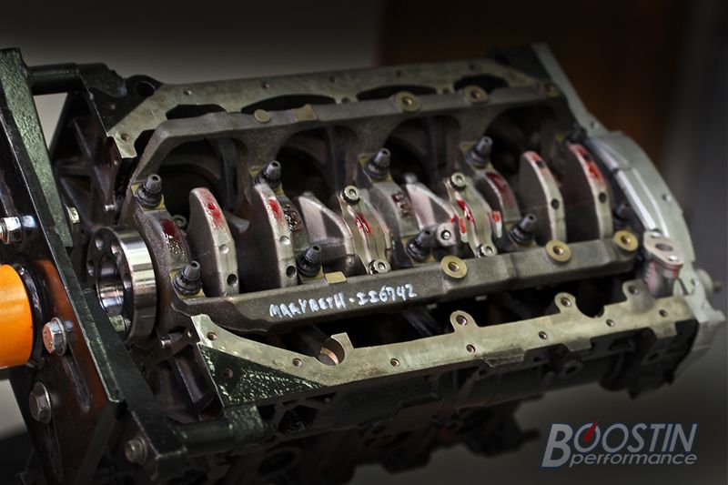

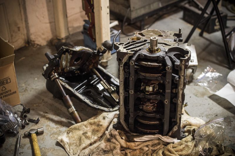

Tore down the spare engine that was sitting in the basement. 100% stock and never opened up 7-bolt. Had somewhere around 120,000 miles. Looks pretty good, so shouldn't need much machine work. We shall see.

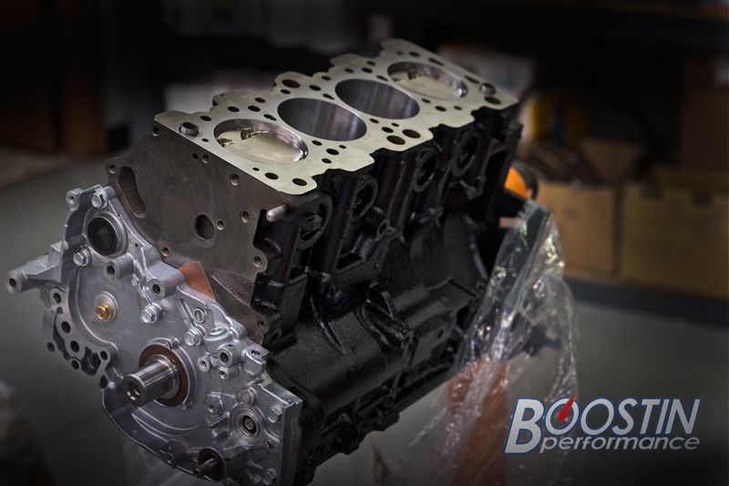

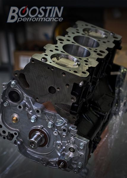

Also made a pretty hefty payment on the motor build itself (Boostin Performance Stage 3). So it is happening, regardless, now! Sticking with the 2.0, but bumping the compression and doing a long rod.

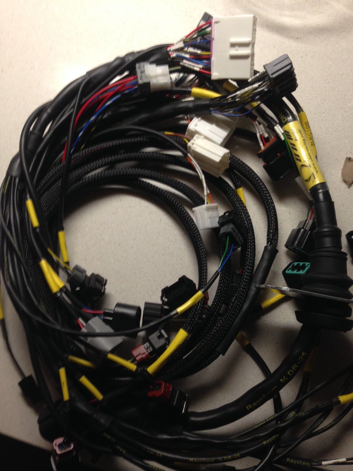

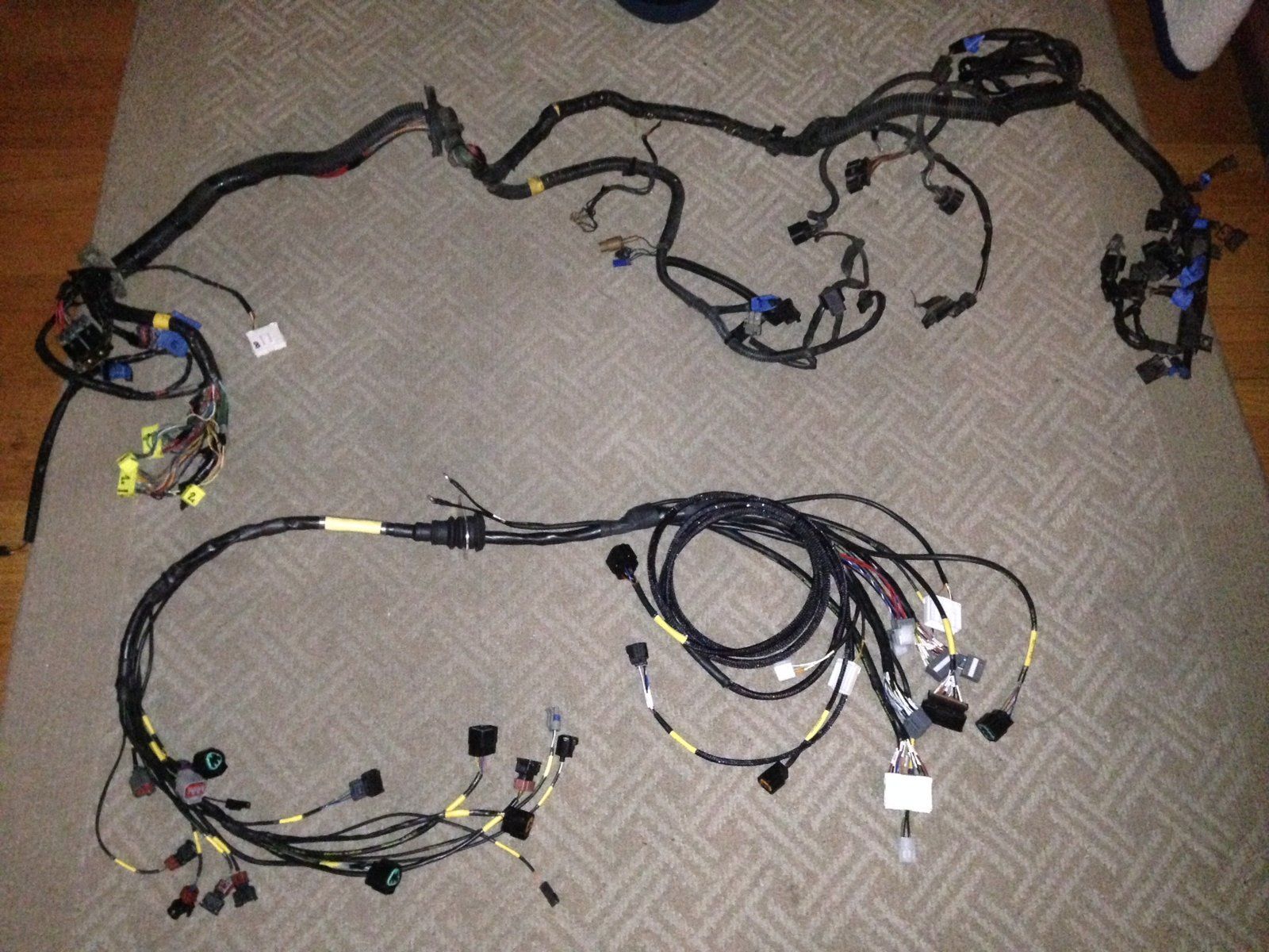

So because I hate wiring, and don't have the patience for it... bought this engine harness from OHM Racing. So far happy with it. Won't really get to test it out for a while, as the car has not been torn into yet. I love the difference in both the weight savings and look of the new harness. So much cleaner. Every wire is labeled, too. Quite a nice touch!
Second photo shows he harness compared to a stock one. (Spare that I have) I probably should have laid them out in the same direction. Ah well, you get the idea. Could have had more deleted off the new harness, but I've kept quite a bit on this car, still.

That's what I was thinking. After fighting for 16 hours with a wiring problem on the car a few months ago, and only finding more issues... car needed a new harness regardless. To me, it was worth the pricetag to save on hours of stripping out unused circuits and fixing other issues. The turn around time was only a few weeks.

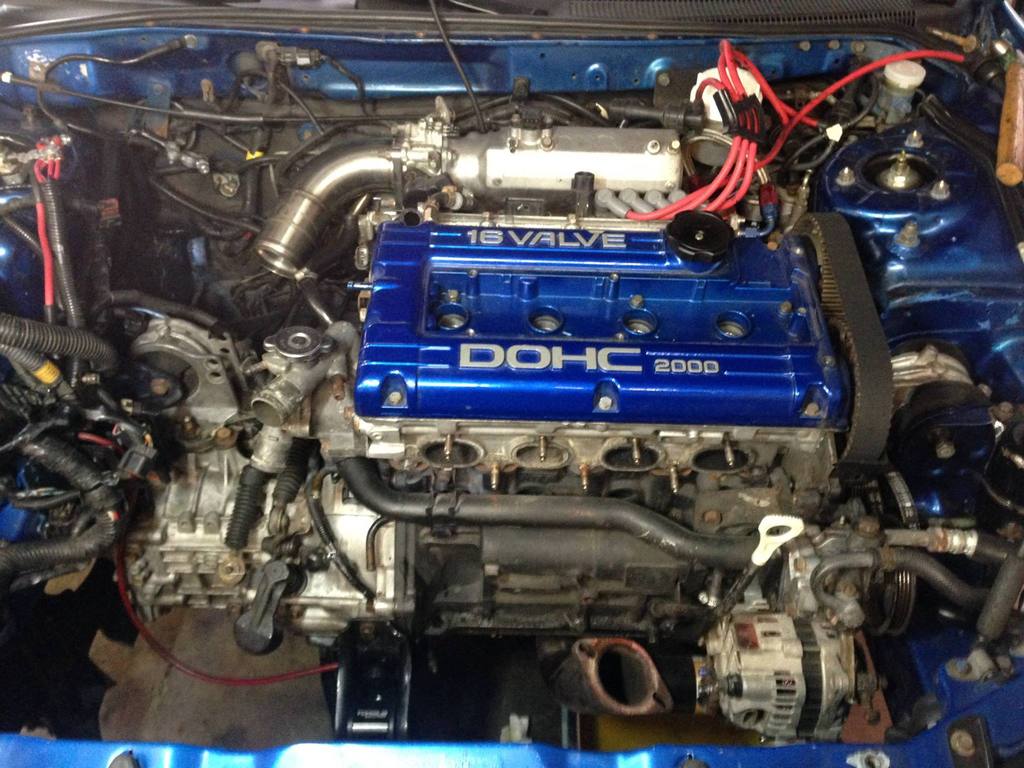

So, we got into hot rod drag week again! The plan is to build the car to withstand a week of drag racing and road miles. Since I also do not have a cage, it need to stay around 11.5 ET. I think that'll be possible on the green xl. :)
I also picked up a set of 12-lb 15x8 wheels that'll have a set of drag radials for drag week.

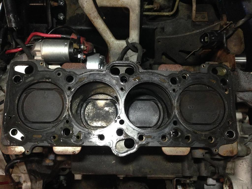

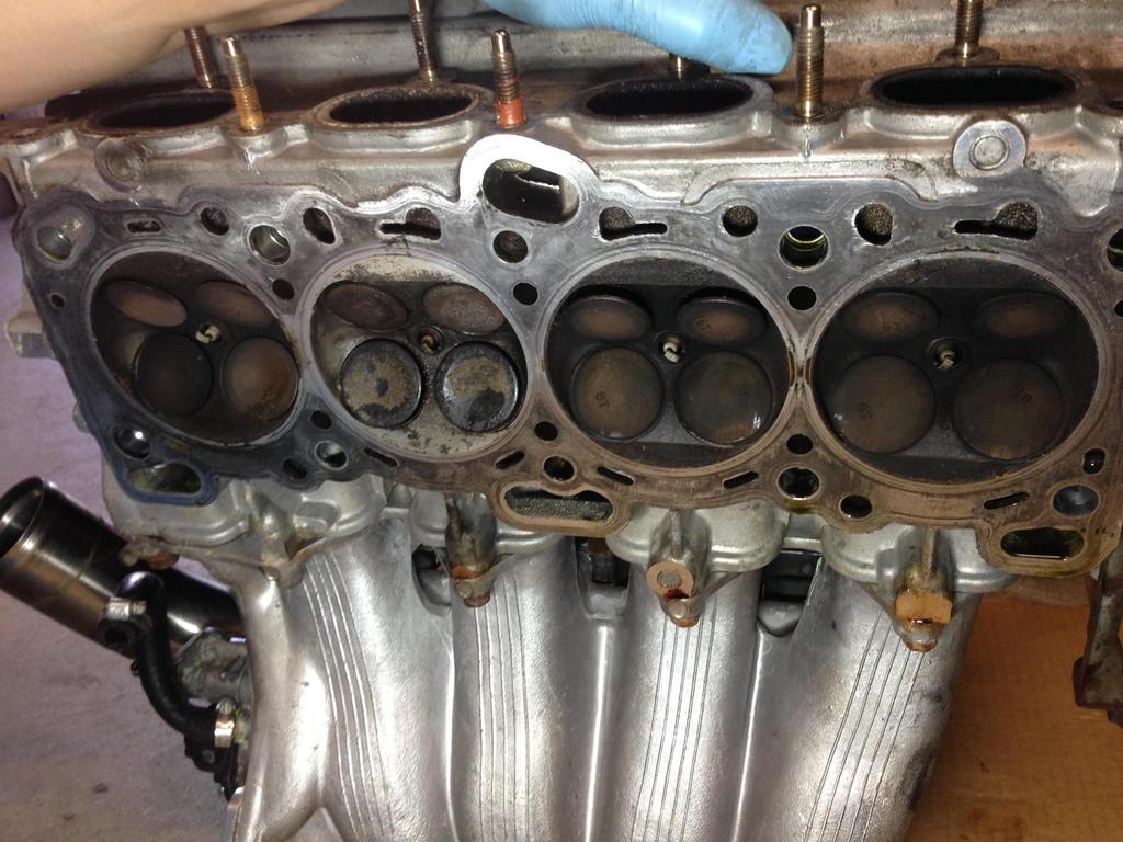

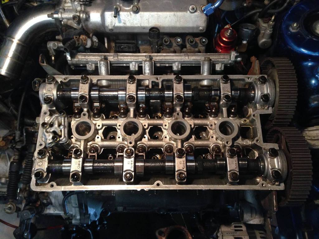

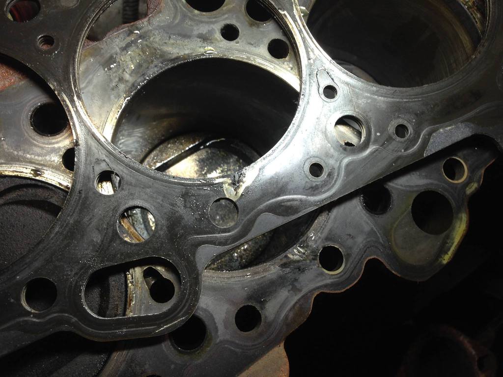

Any idea what caused the HG to blow?
If all goes well, it'll be at the shootout.
I have a laundry list of things the car needs done, so hoping it doesn't fight me to much. :)
Radiator cracked on the way home from Michigan. (5 hour drive). Didn't show any signs of trouble, so didn't realize it was run so low on coolant until I got home and saw the underside of the car coated in antifreeze. :(
Did a compression test, and it was fine. However #3 spark plug looked off. Installed a new radiator, drove it to Mitsubishi owners day and back. It seemed to run a tad hotter than usual, but never over headed. So... To end the season with a "bang"... We took it to the track. Blasted it down to a trap speed of 121mph in the 1/4. That's when it turned into a white smoke machine. Lol!
Parked it for the winter, and here we are!
