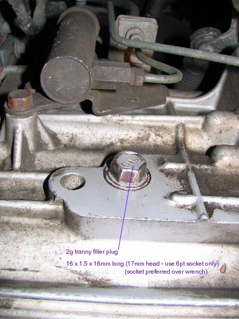

Filler plug loosen tip: If you have a stock plug, use only a 17mm 6pt socket - not a wrench (and not a 12pt socket if possible). The plug's 6 pt sides are slightly tapered (and VERY soft metal) such that a wrench will want to slide off and mangle (and round) the sides (so a future time you'll have to destroy it to get off - personal experience). I had to even hold the socket ONTO the plug with a 2x4 board pressing against the racket (with a lot of force) while turning to keep it from slipping off. And don't overtighten when reinstalling. After a few times of mangling and replacing plugs I finally just got a normal hardware bolt that's not tapered with a washer and it's been great ever since. Bolt is 16x1.5x16mm long.
Stock plug (notice very slight taper and mangle on sides - this is a new Mitsu oem plug removed only once): http://www.dsmtuners.com/attachments/transaxle-2gt-filler-plug-location-jpg.111162/

I didn't really mean that filling it from the top was a shortcut ( I apologize if that was offensive to anyone) I just don't think he knew how much to put in or maybe he thought it should be to the top, judging by the way the rest of the car is done. When I get home tonight I'm going to check these suggestions out, so thank you very much.
Thanks for letting me know as I tend to use 12 pt most of the time. I'd hate to destroy it right off the bat.
