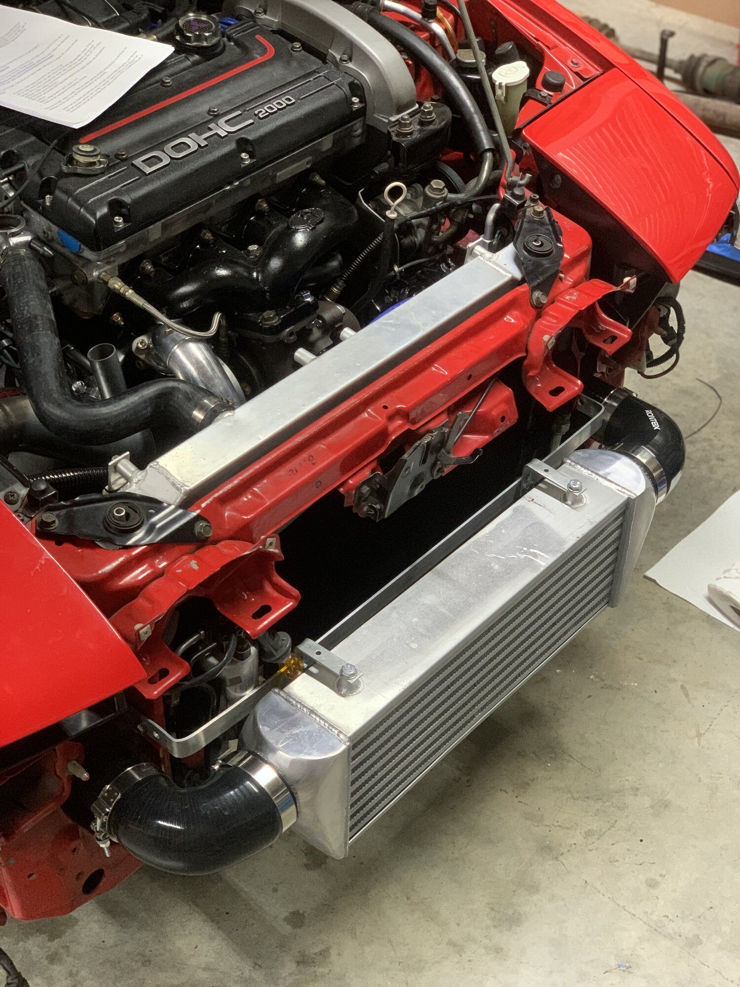

I replaced my AC components and started mocking up my intercooler:

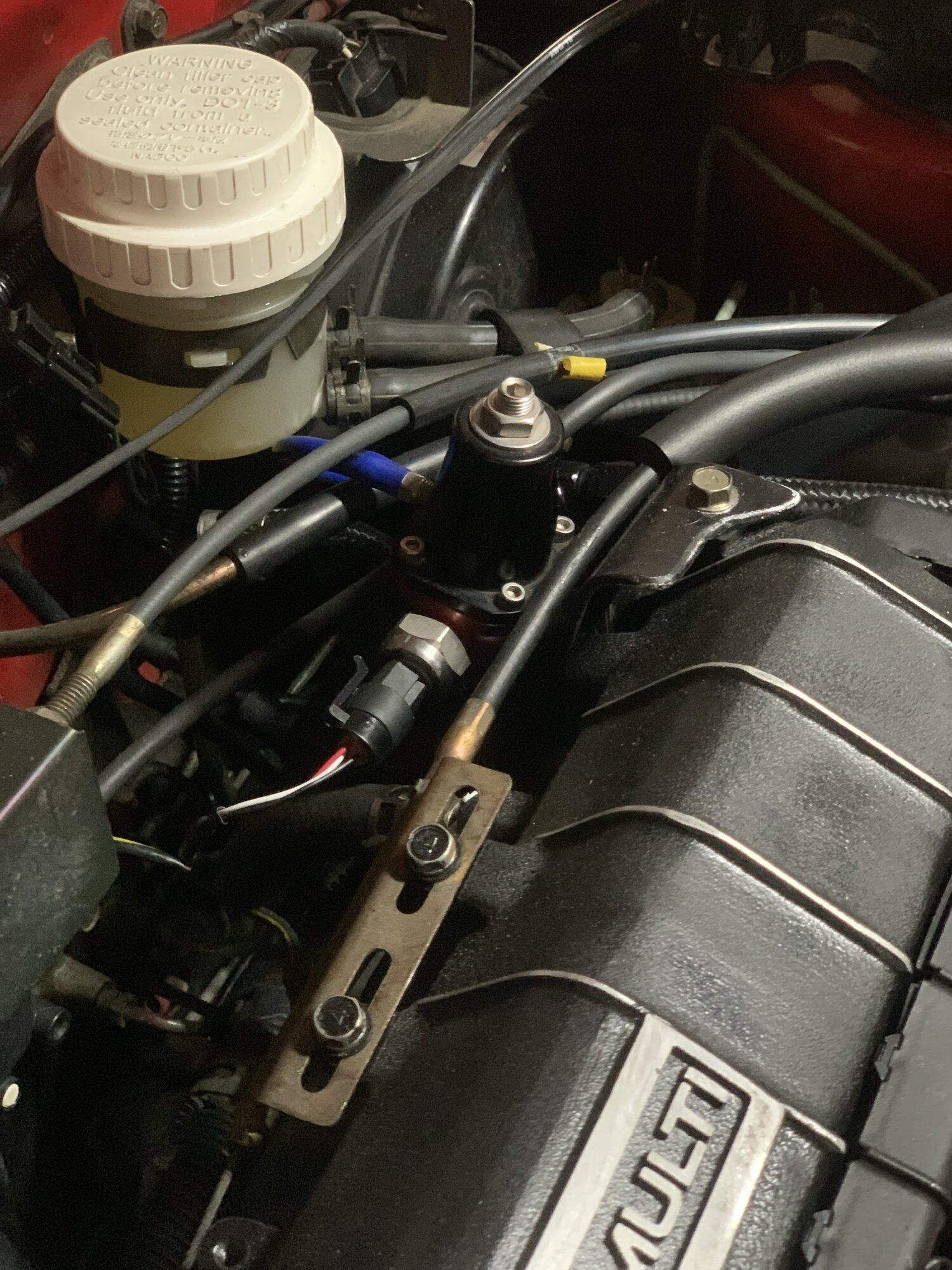

‘Took time out to replace my fuel filter with a billet one (and switched the lines to braided), mounted my fuel rail, installed my FIC 850’s and an aeromotive FPR. Also refinished my stock intake in black crinkle finish, fabbed up a bracket and mounted my FPR to the back of the intake:

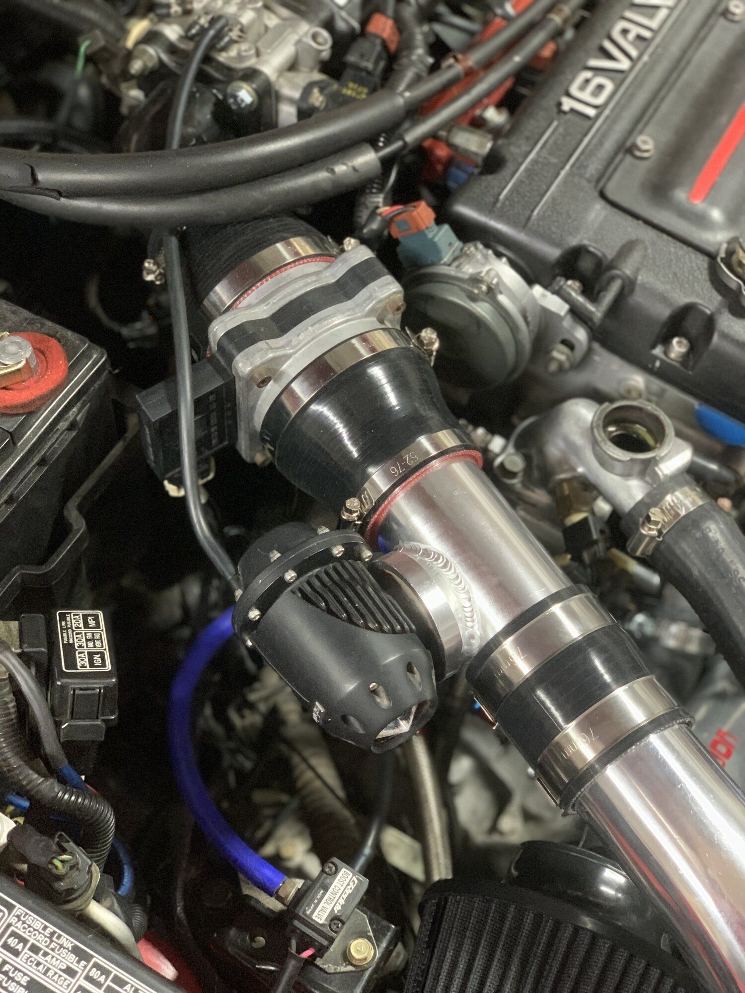

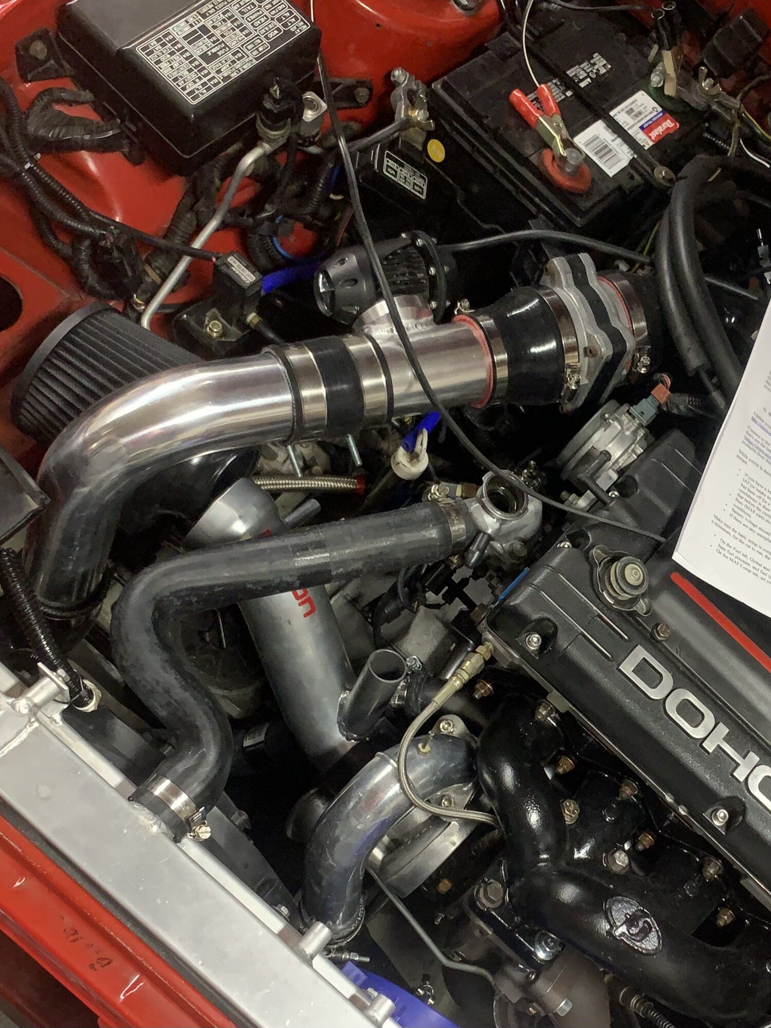

Focused back on my intercooler piping. I had picked up a universal pipe set locally and really didn’t want to spend what people were asking to buy pre-bent sets. I feel like it turned out pretty dang good:
Mounted the 3” GM MAF and HKS blowoff valve at the same time:

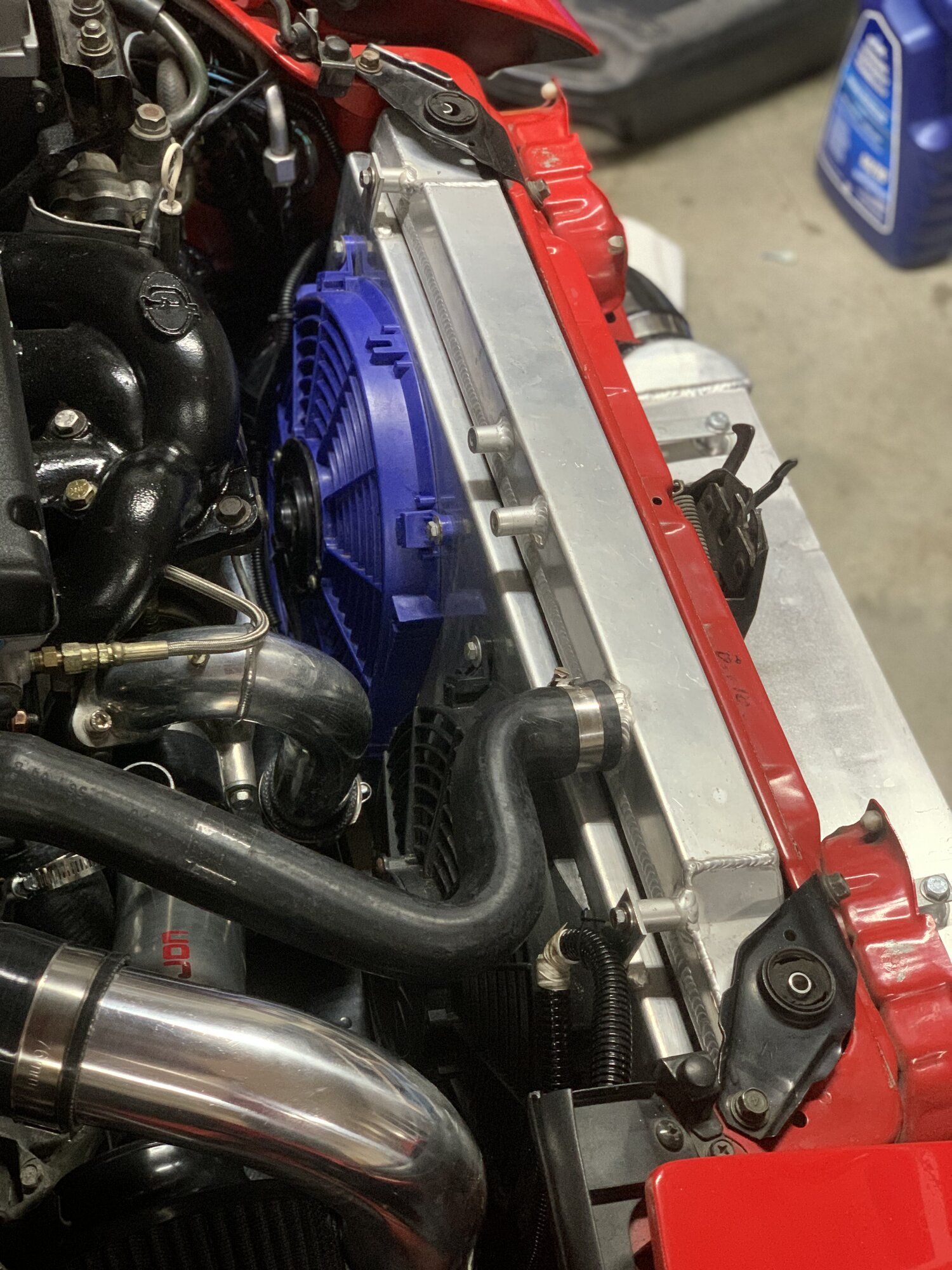

Went ahead and swapped in the aluminum radiator with shroud and fans. It gave me a couple more much needed inches of space to run my J-pipe and intercooler pipes. Man, I’m glad that job is done!

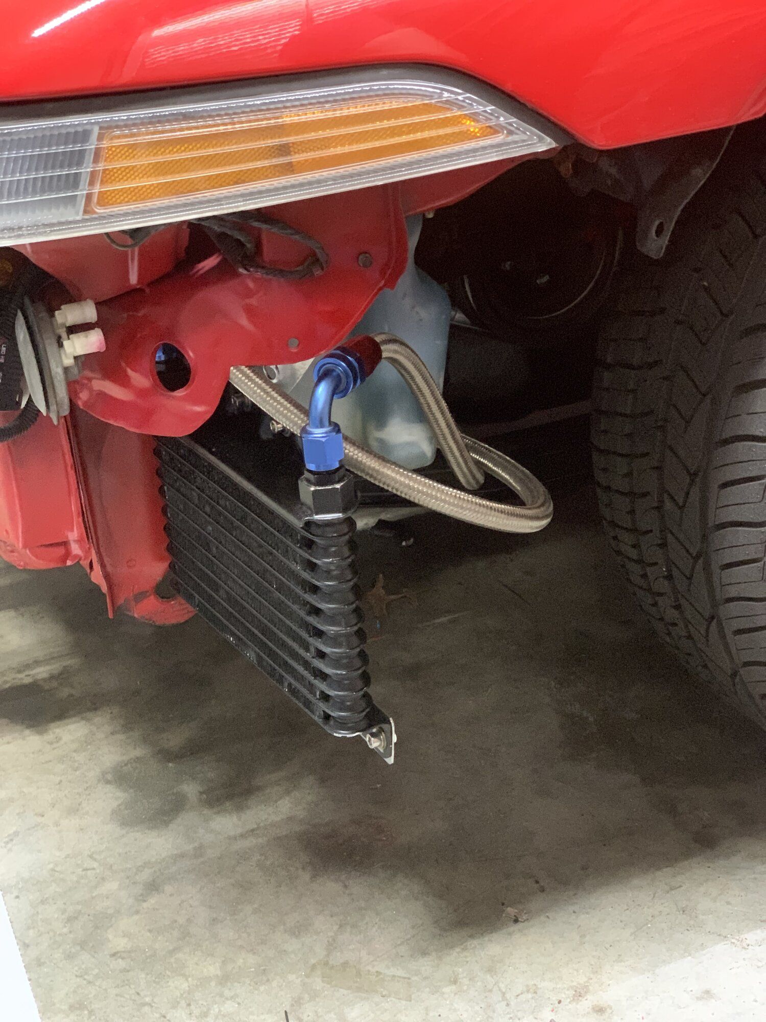

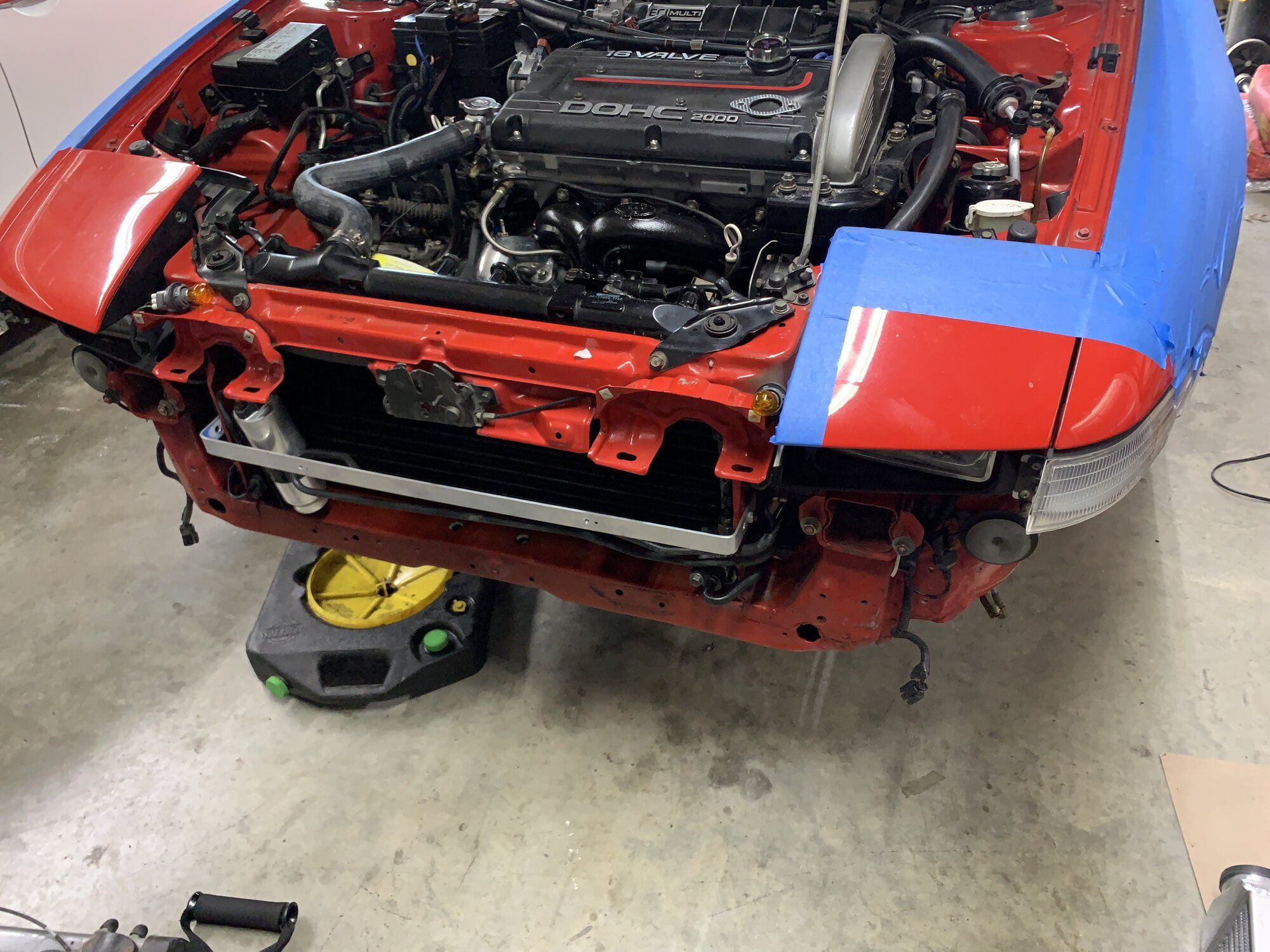

When I purchased the race car project, the PO had run AN 8 feed and return lines for the fuel. Major overkill for me. As he had never run the car, I took the lines and repurposed them. I relocated my trans cooler to the passenger front corner and ran braided lines to it:

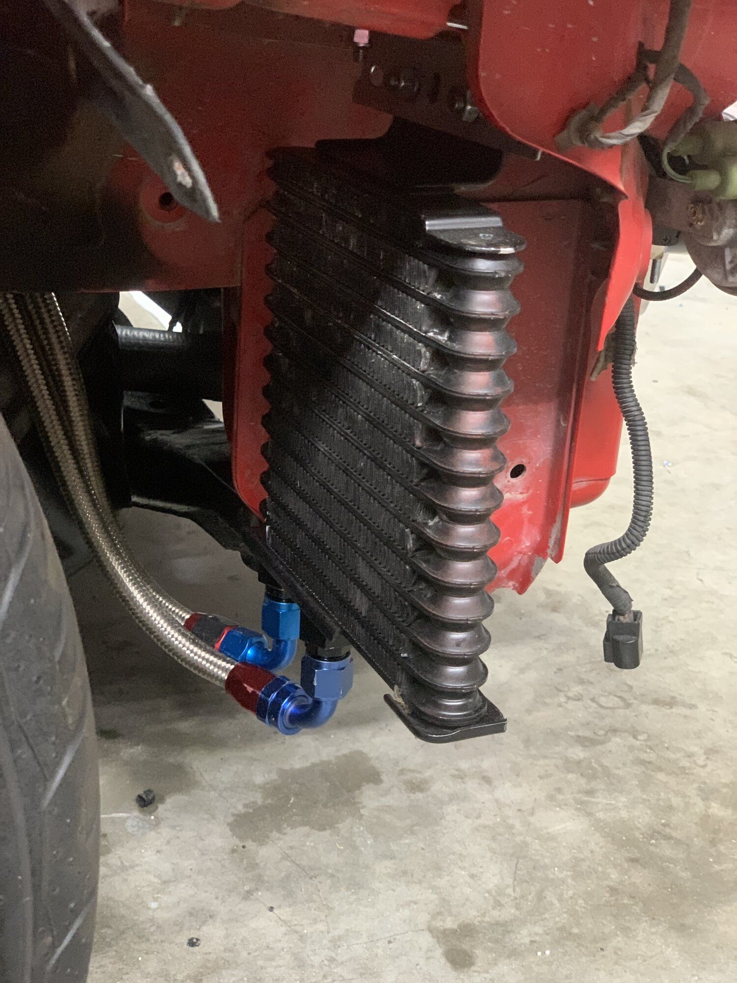

Then did the same to the oil cooler, just on the drivers side:

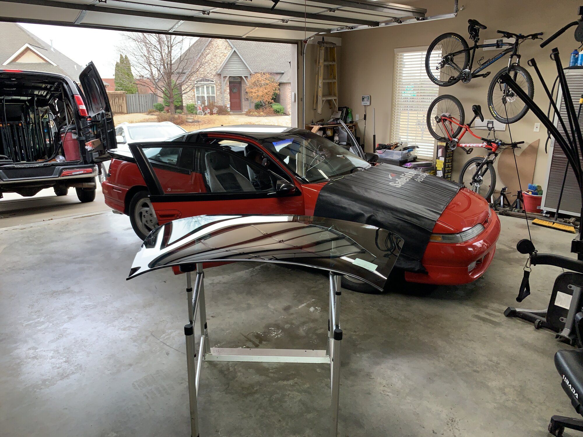

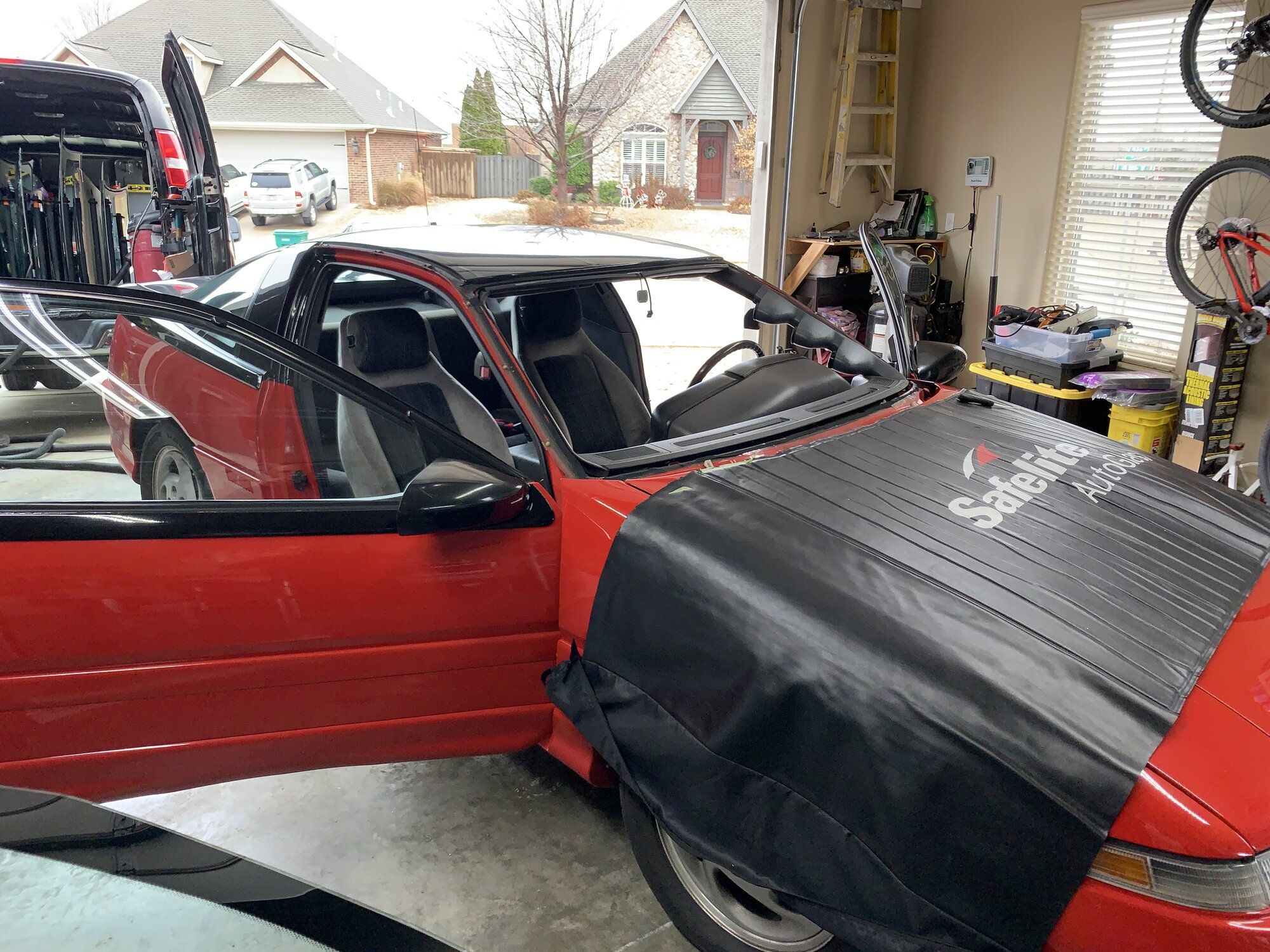

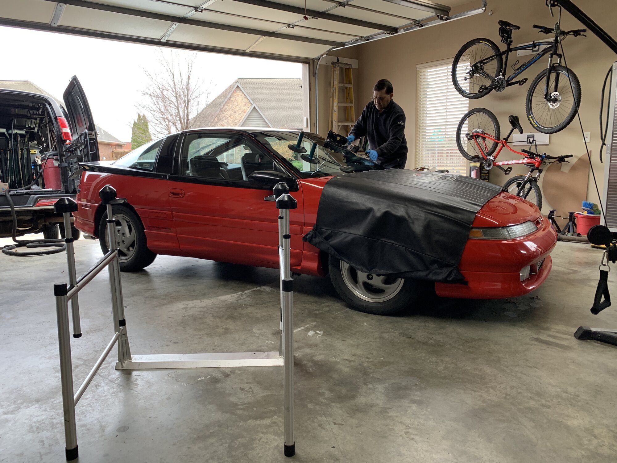

Ended up getting a crack in the windshield, so this weekend Safelite came out and changed the windshield. I’m pleased with the job they did, and new glass is really nice.
