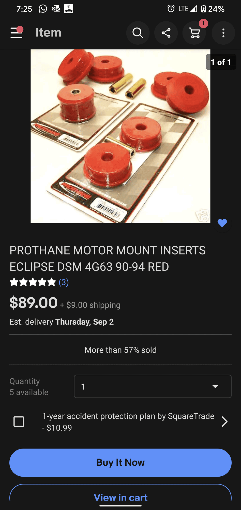

You won’t likely find the driver side mount, hate to say. I spoke to a tech at Anchor, and he said the ones sold for the 1.8L will fit, and can be stiffened by filling the windows in the rubber with windshield adhesive. I can’t say for sure that it works from any personal knowledge.
the other three should be available, but many folks seem to complain about trouble getting the right one on first try. If you could find an OEM source, probably worth the money. If you owned a 90 with cruise control, like mine, then the manual trans mount is NLA.
Mine is a 92' Auto with cruise control. All transmission mounts i found are for automatic w/o cruise control. What difference make the cruise control?
Here is how I did my 90 with poly mounts. I did my 92 auto car also, same thing and Mech Addict is right they will add some vibration to the car.
The 90-only cruise control motor mounts on a little bracket welded into the trans mount. Later units use a vacuum thingy and the cables all run to a mechanism on the firewall. So I don’t think there will be any problem for you that way.
I’d start with the helpful link that 1990TSIAWDTALON posted above...

Going with poly is a slam dunk, though you get more vibration, from what most say.
The drives side mount does basically nothing as far as upgrades go. It's the front and back engine mounts that matter. Keep the drivers side and trans mounts stock unless you enjoy PRYING them out and back in every time you mess with them. I hate the poly drivers mount on mine. Wish it was factory rubber still.
