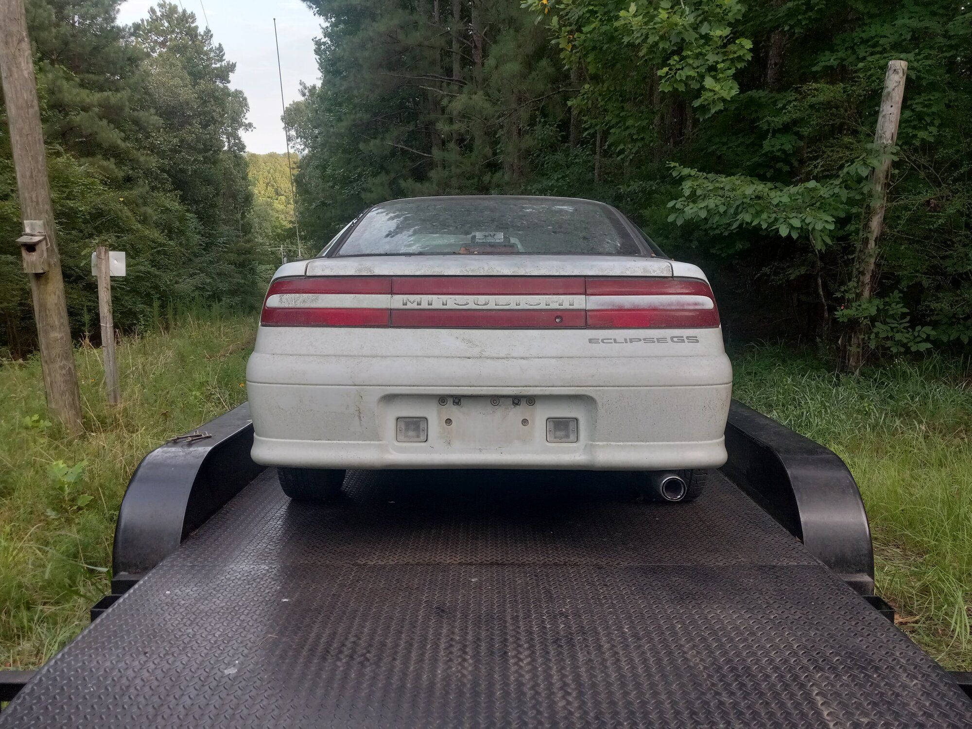

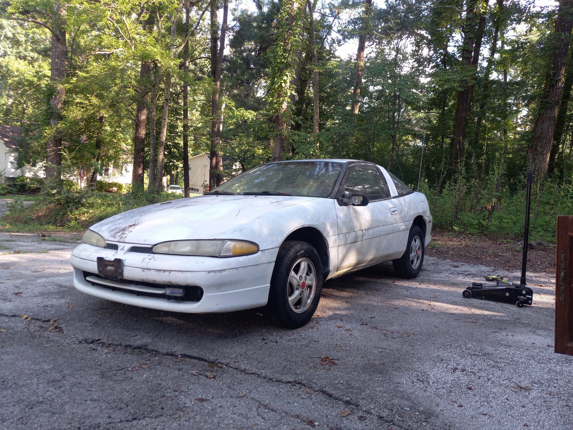

Saved from rotting. Purchased for $500 in a not running condition.

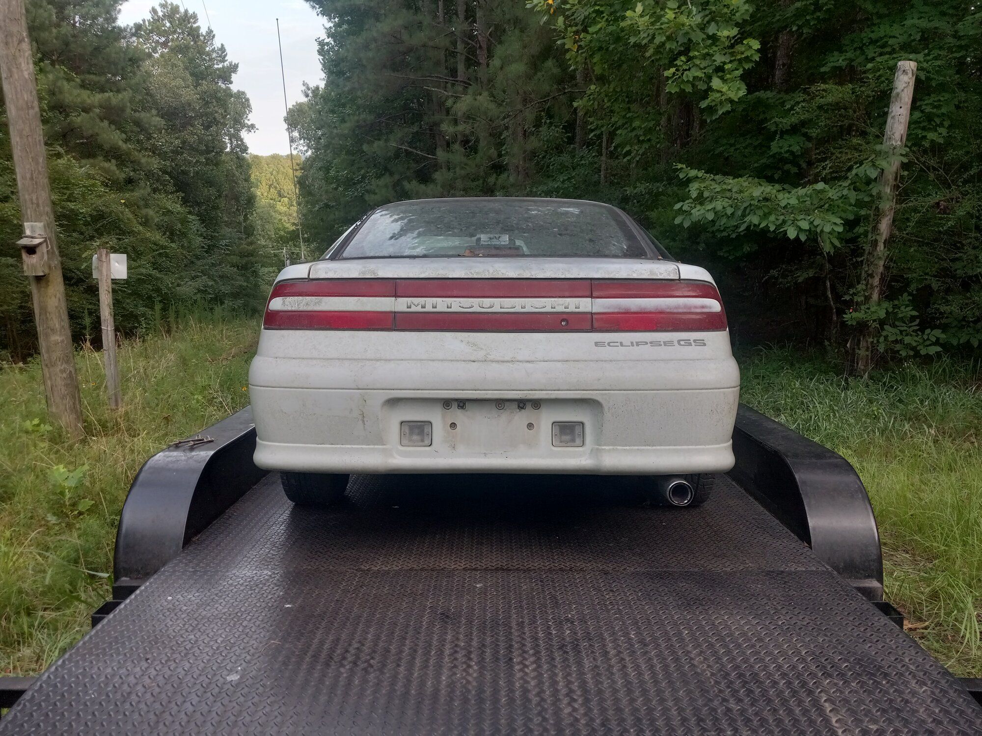

I guess it had been sitting for a little while LOL. Got it pulled out and towed home. First goal is to get it running and that will reveal any drivetrain issues I need to address. Once it's driving decent I can get a game plan of cleaning up the interior and exterior. Definitely not an overnight project but I think I'll get some enjoyment out of the process. I can't wait to get this thing back in commission.

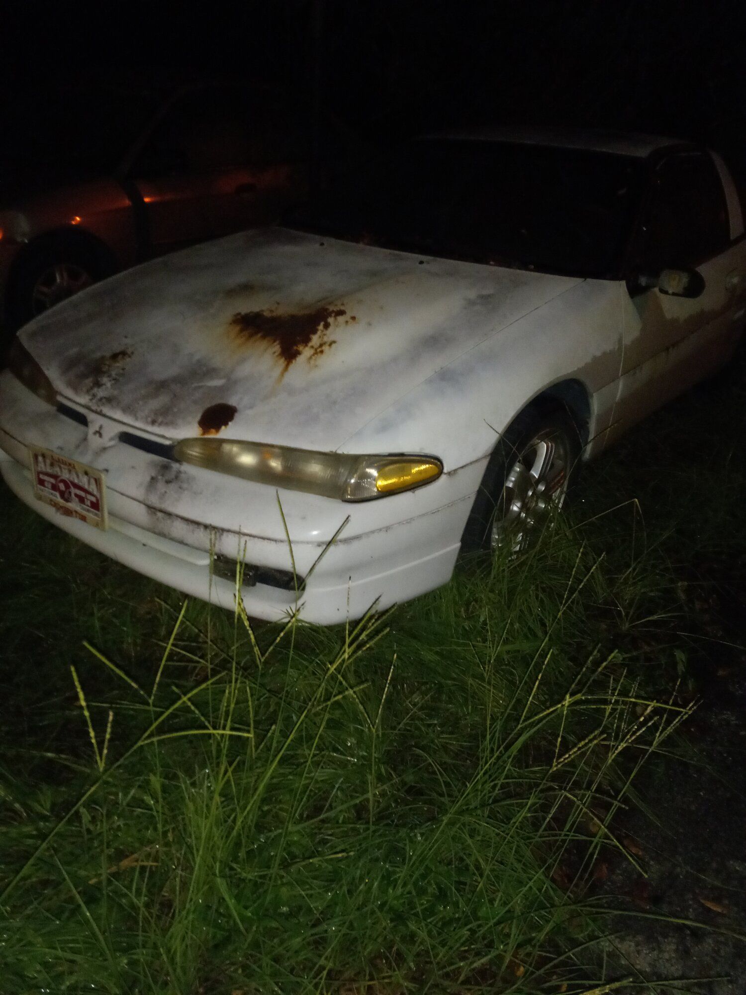

Looking forward to seeing it cleaned up. That poor hood, wonder what happened there.
That rust on the hood seems like the only rust on the whole car. The undercarriage is damn near spotless. I think the sun just ate through the paint and rain did the rest. Plus 31 years on original paint is already a bit much for a car parked outside.

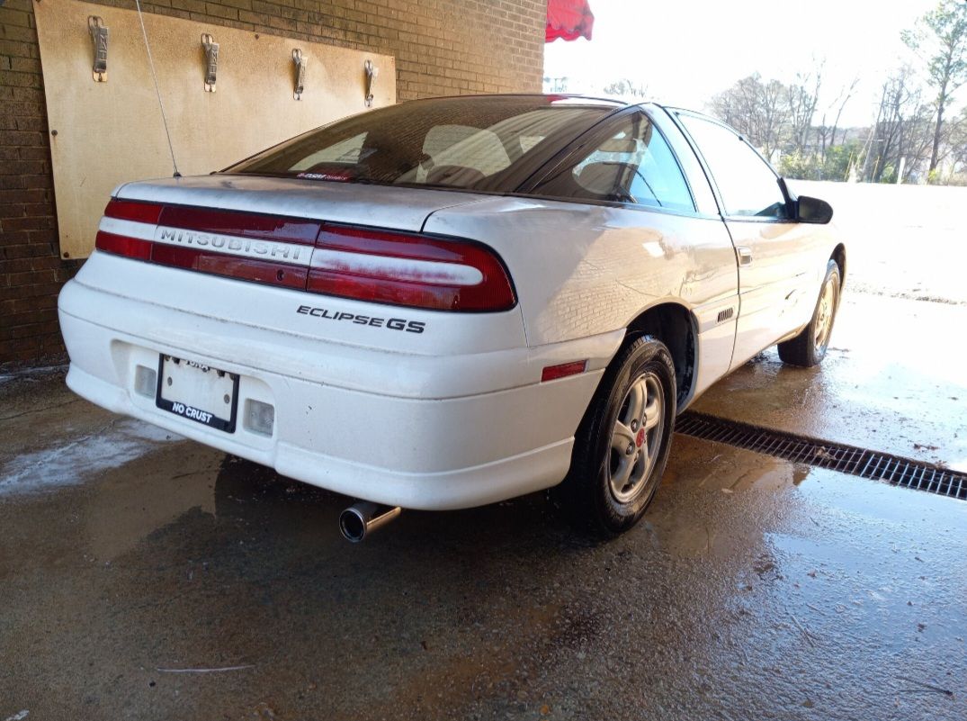

Nice!!! Is this the 1.8 or 2.0? Just saw GS on the rear bumper and could be either!
Agreed!!! Doesn’t matter which motor, it’s still incredible! I catch heat because mine is a turbo automatic….but my response is the same…..it’s still cool!

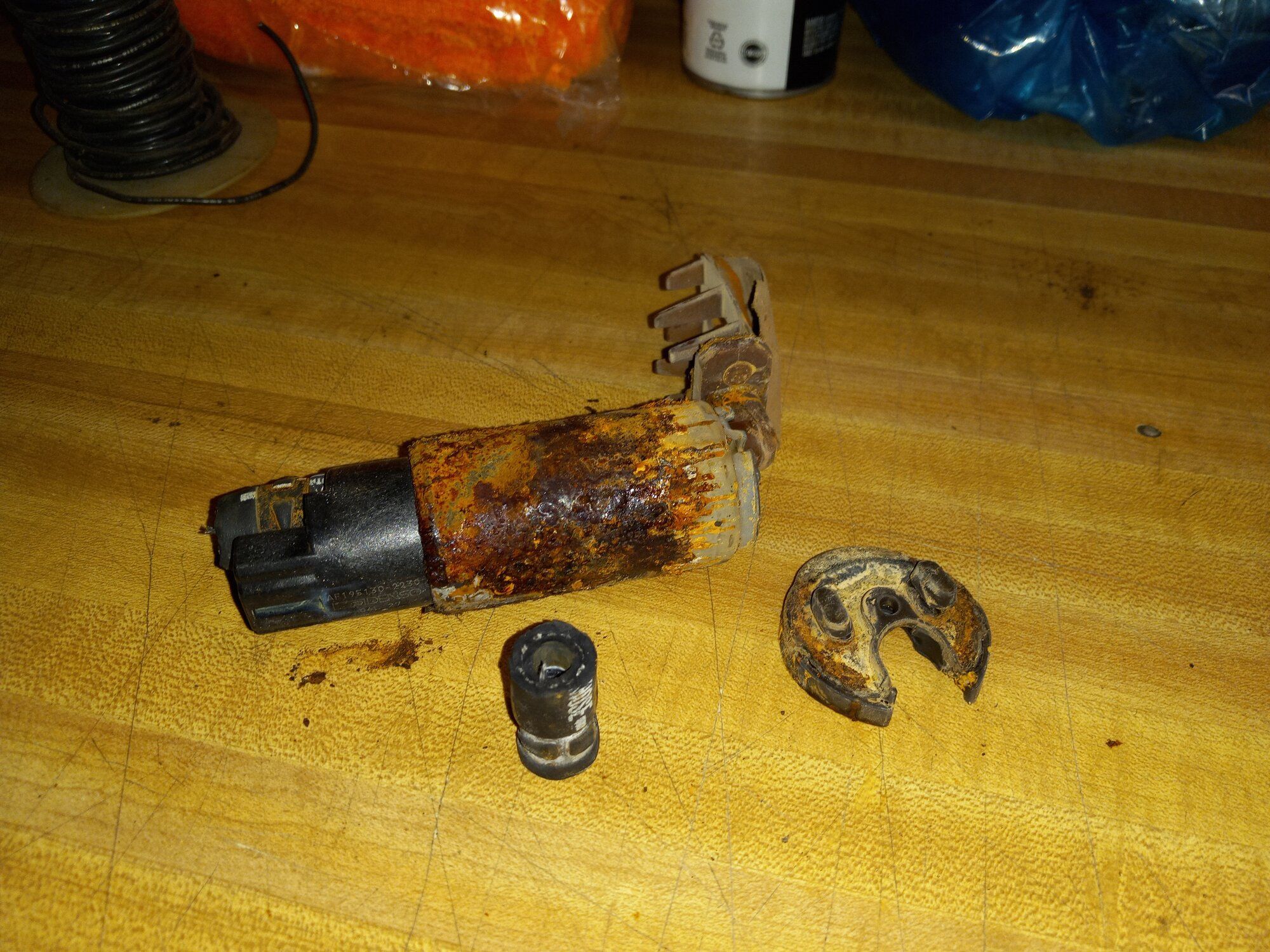

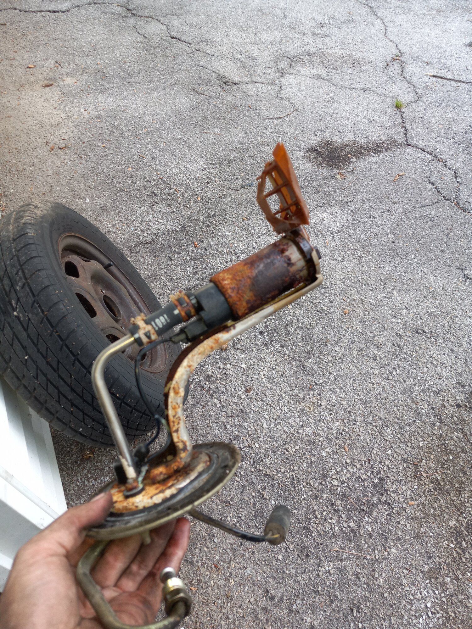

Replaced the fuel pump and MPI relay. It starts easily and idles. I drove around the neighborhood to see how it handles and I'm impressed. I expected it to completely fall apart but everything is tight. Someone kept the steering and suspension maintained.

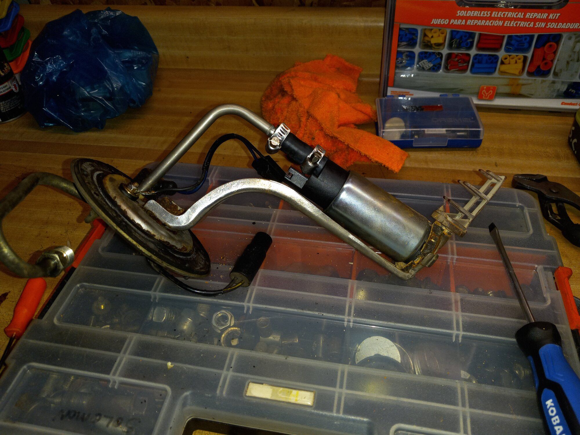

Here's some pics of the fuel pump replacement. Looks like the original pump. I had to do some working with a wire wheel, there was no way I'd put that rusty bracket in a gas tank. The new pump I bought didn't include a strainer so I bought a universal strainer sock and held it on with a stainless steel wire tie.

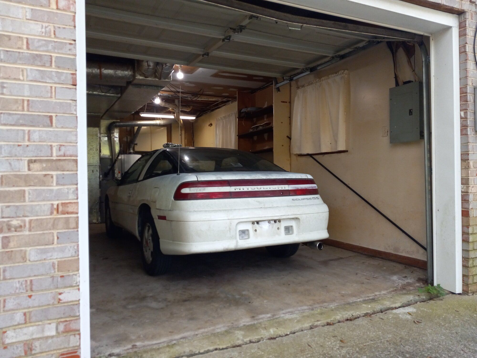

It now has it's own garage space, so I can go ahead and start on the interior/exterior/engine. As far as I'm concerned the transmission can be left alone. It shifts like a new car. Maybe do some axle seals though.

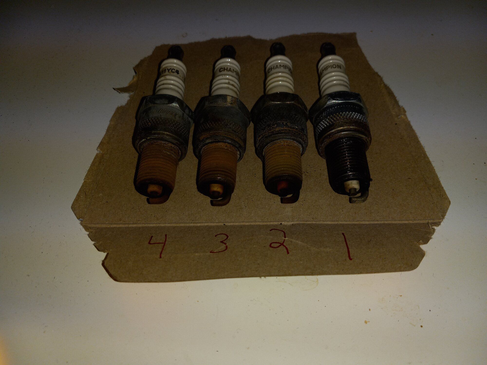

Yes I'm putting NGK in it. Those were Champion plugs.
Cylinder 2 is burning some oil. Hopefully it's just a valve seal or the headgasket so it goes away after I freshen up the top end.
A quick test from an old schooler would be a bit of Atf in the cylinder, disable the ignition and let the starter spin over a bit. Atf has the ability to clean up sticking rings. Plus if mosquitos are bad in your area you will clear them for the afternoon when your finished and start it.
It sounds silly but actually cleans the ring pockets a bit which makes it easier cleanup for the rebuild. And it narrows the question of where the oil may be coming from. Compression test before and after will reinforce your findings. Spark plug in but loose or you'll have a red fountain.
Honestly this method would be good to do since the car had been sitting, a few cap fulls in each after checking compression the first time for all cylinders. Could save you building the lower end if you didnt intend on going full build on your 1.8l. You already have the champions to use for stoppers so you don't paint the ceiling.

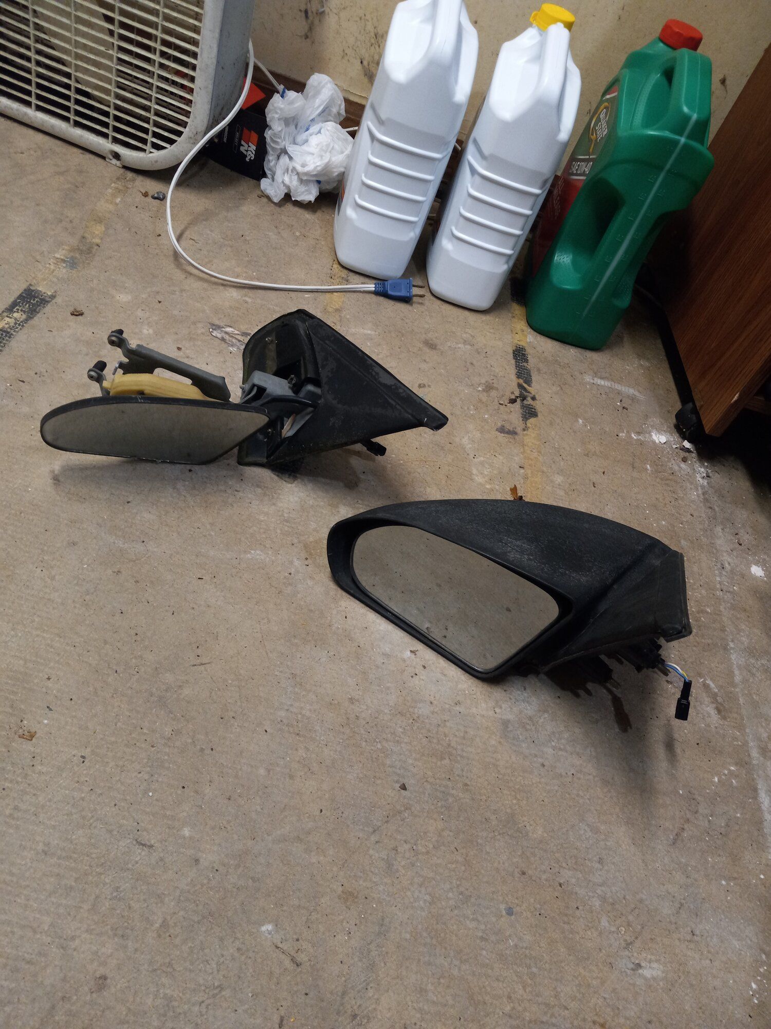

I was able to find an OEM mirror on Ebay. I'm pretty sure that was all I needed to complete the exterior besides a paintjob and tires.

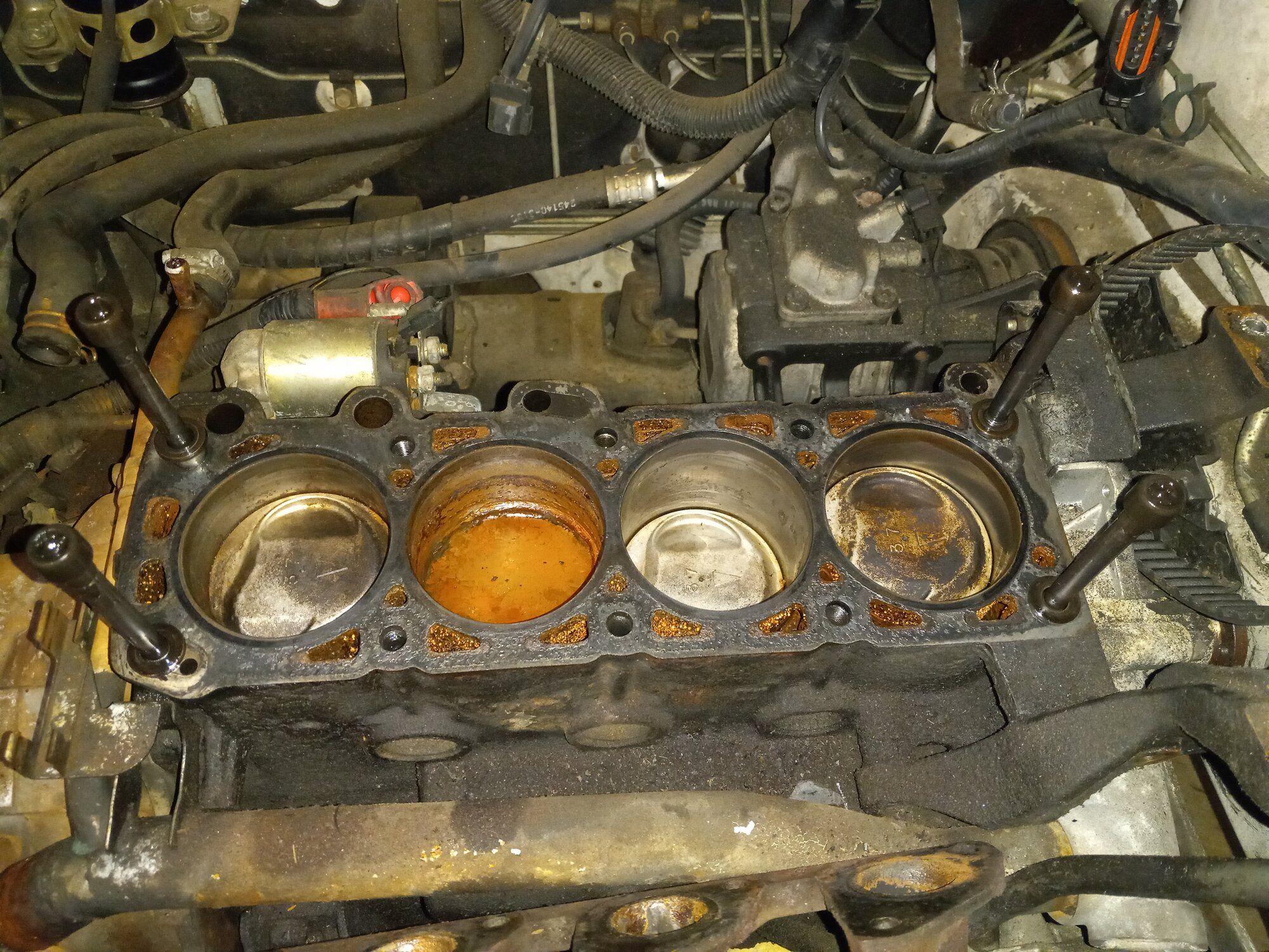

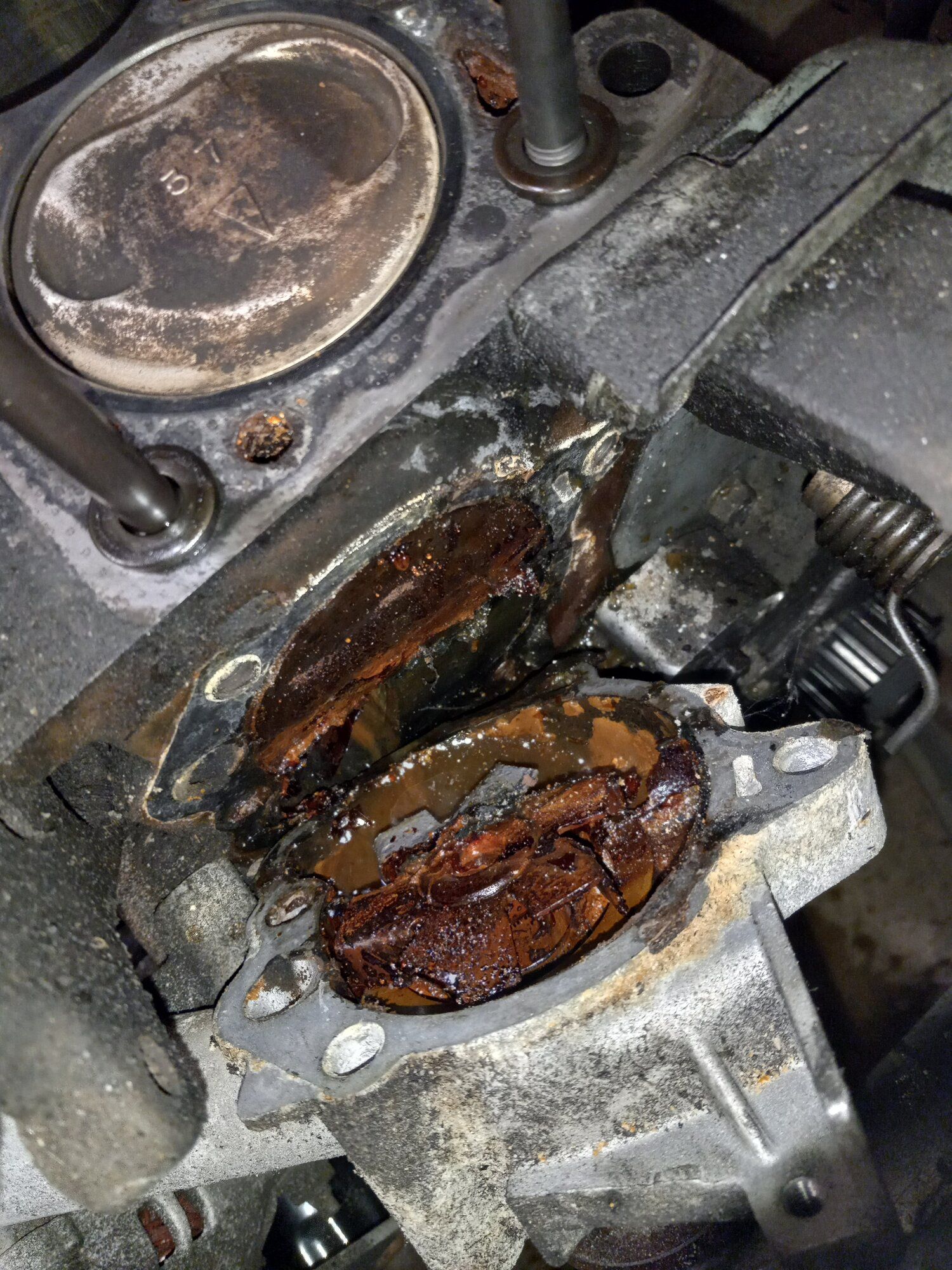

Here's where we sit right now. My hopes of doing a top end only are down the drain. Cylinder 3 has been catching water for quite some time based on the condition of the cylinder wall. I'll be pulling the engine and trans for a full overhaul. I'm not really bummed at all though. I typically prefer to do full overhauls on older vehicles like this. It's a longer amount of time but in the end I can be assured it will be in great shape.
I haven't taken any measurements yet so I won't order a thing until I do. I'll probably need at least .020" over on the cylinders, if those are stock pistons and never been bored before.
There's no way it had that much water in the cylinder when I drove it. I guess I finished off the HG.
