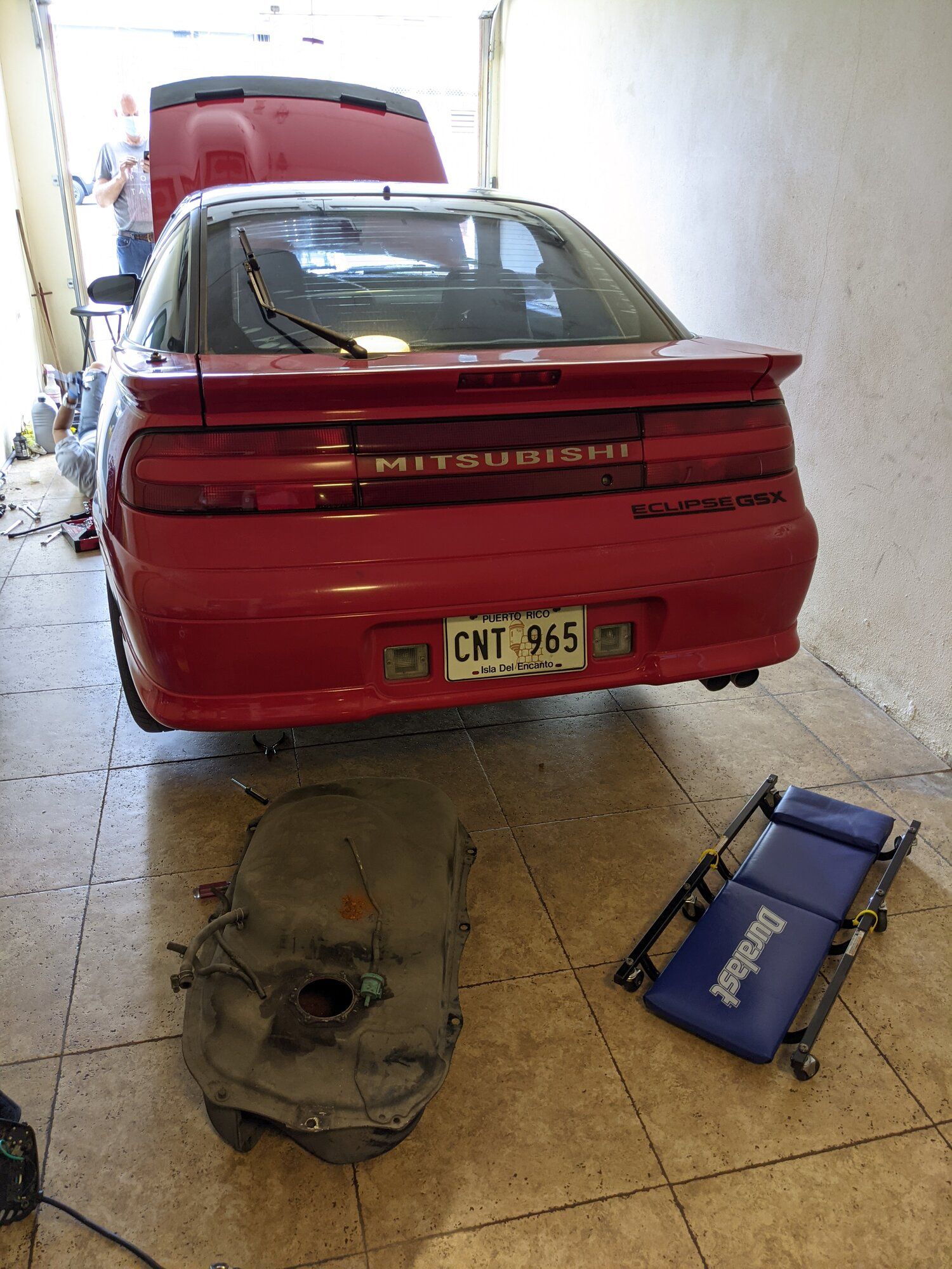

Love the car and totally appreciate your goals: enjoy the fabulous car like it was made. We’re on the same page that way. Mine was unmodified but roughly treated, so my back to fresh is much lengthier. Hope you got the fuel situation sorted out, since the tank is lying behind the car in your photo. Also, others surely know best, but I thought 1st gen Auto used a different turbo than the 14b (13??). Please get some more eye candy on this gem and share some stories about it. Trips, repairs, how you came to own it, whatever you think about when you see it....
Yeah, I'd like to hear more about that gas tank. I'd like to drop, clean and line mine, as I suspect that it's pretty rusty, judging by the orange-tinted liquid that came out of it when I drained it after it sat for over 5 years.
Plus some idiot mechanics dented it some years ago when they tried to lift the rear by the tank, and I'd like to see if there's a safe way for me to undent it.
And it wouldn't hurt to clean, derust and paint its outside along with the tank shield and the part of the car underbody that it hides.

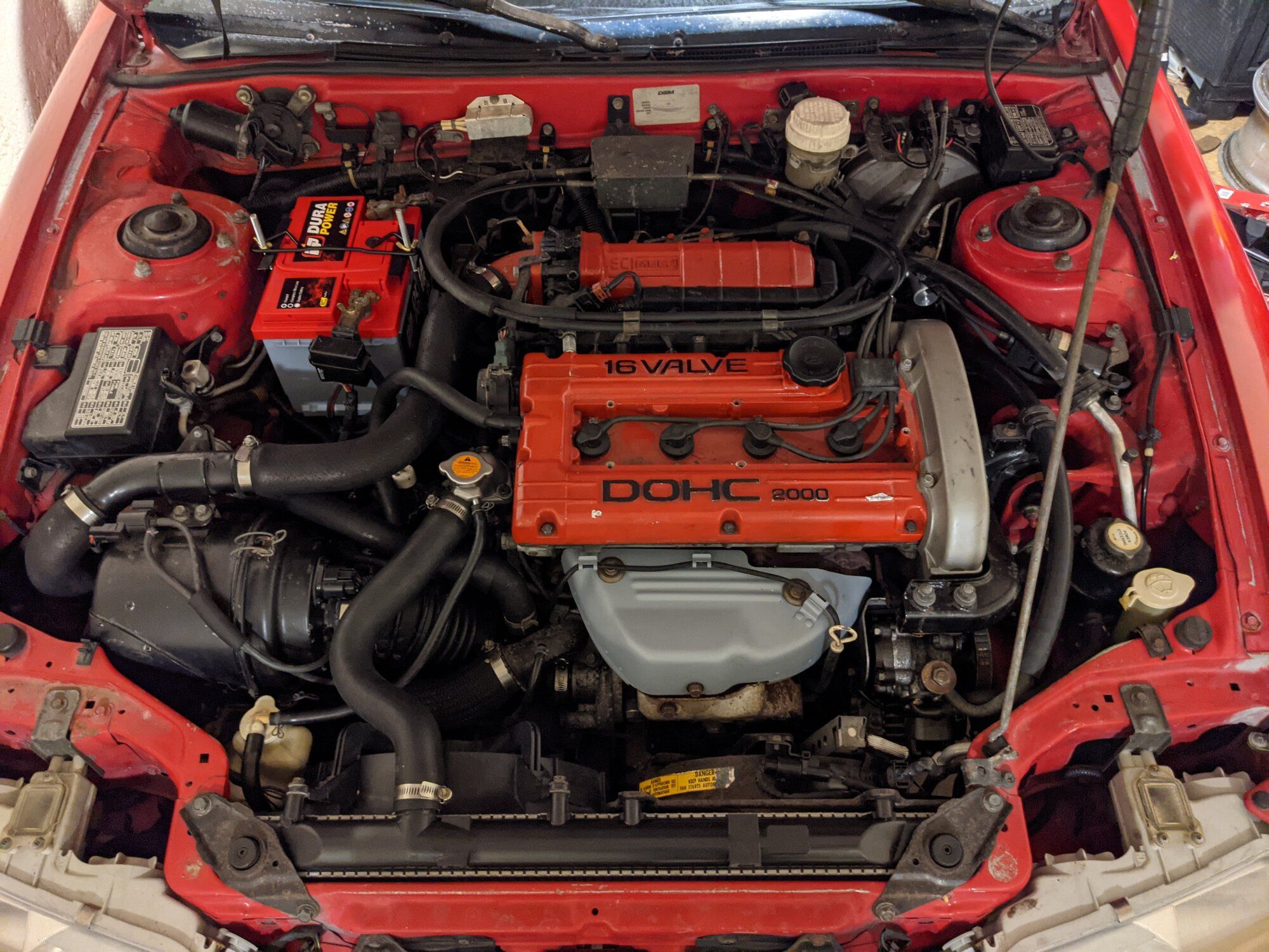

Hello greetings! You're right, it's a 13b turbine. This is my 3rd Eclipse, my first 2 were 97 'GSTs, now I found this gem. Stored for 7 years. The gas tank required service, the Control Arms, Brake booster, Master Cylinder, brake calipers, fuel pump, TCU, new battery, oil, oil filter, gas filter, belts. Next will be Timing components. Car has 124k miles on engine, trans and chassis. Motor mounts are bad and need replacement. I thought it would take me more time to get him running, but thank God everything went well. Crazy to take it out on the streets since here in Puerto Rico 1Gs are very rare.
Greetings! Lowering the gas tank is an easy task. Once down, it will be easy for you to work with it. In my case it was not so bad and only required cleaning. I installed a new pump and it is working very well. I have realized that the arts are hard to come by. A shame that the mechanic dent the tank but I think you can correct it without any problem.
Thanks. My concern is one of safety. A nearly empty gas tank is basically a bomb. I'd like to take every precaution to make it a safe. Would pouring water into the tank after the various lines have been disconnected neutralize the risks?
The stock auto turbo is a 13G.
The only way an empty gas tank would be dangerous if you were welding on it. Drop the tank, completely empty it, let it sit for a few days, and you should be fine. You can flush it thoroughly with water if you want the extra safety.
I just had mine completely cleaned. It had a TON of scaled rust built up inside, along with the old varnish that used to be gas.
Water, yes you can do that. Is not hard at all and yes, safety is the most important thing.
