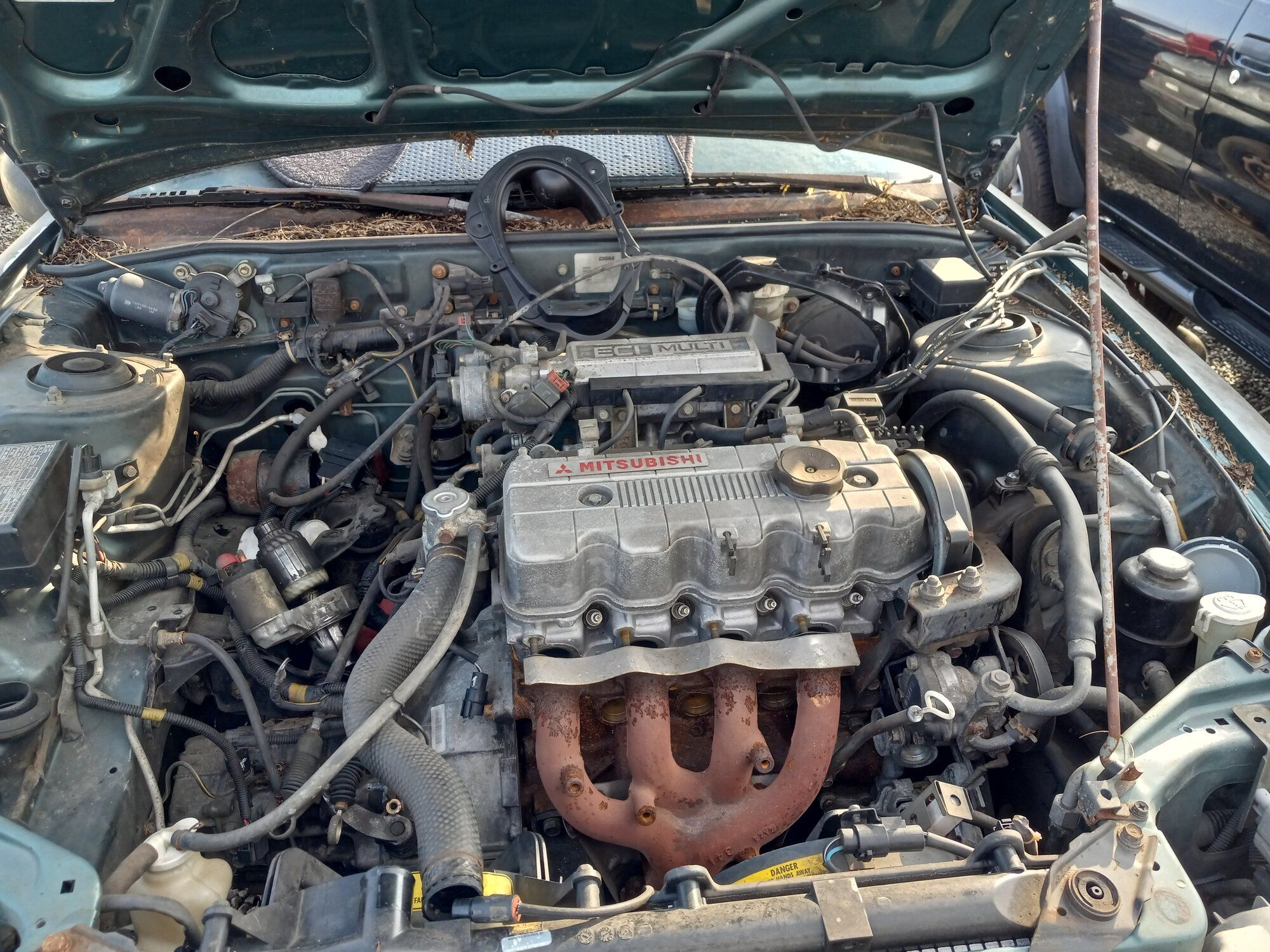

Saving An Eclipse!
Saved from rotting. Purchased for $500 in a not running condition.
I know they make aftermarket oil pan gaskets, but from the factory isn’t it just silicone?
That’s a big pile of heads! I wonder how do they keep up with all that
I'm not sure how it is from the factory, but there was a gasket when I took it apart. And yea it must be tough on those guys at the shop. For the past few years it's always been at least a week wait time for a full head service, I've even been told 3 weeks before.

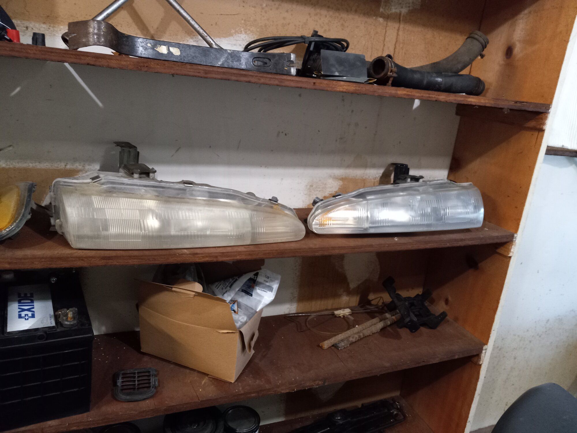

I restored the driver side headlight today. Will hopefully get the passenger side done tomorrow. I'm also considering swapping to LED bulbs as well but I haven't even seen the brightness and light pattern of the original bulbs yet.
That seems quite similar to the process on a 2g. I didn't have to damage my connectors though. They fit right on the bulbs. I'll have to double check but those even sound like the same type of bulbs used in a 2g? If that's the case I'll try to remember which brand I bought and just re-order them.
I thought so. So in theory I won't have to modify anything to swap over, if I can find the same ones I used in my 2g. I remember the low beams fit directly in but the high beams gave me a slight issue because of a cooling fan on the rear but I was still able to use the metal clip to hold it in firmly. If this plays out I might have to update Marty's thread! :thumb:

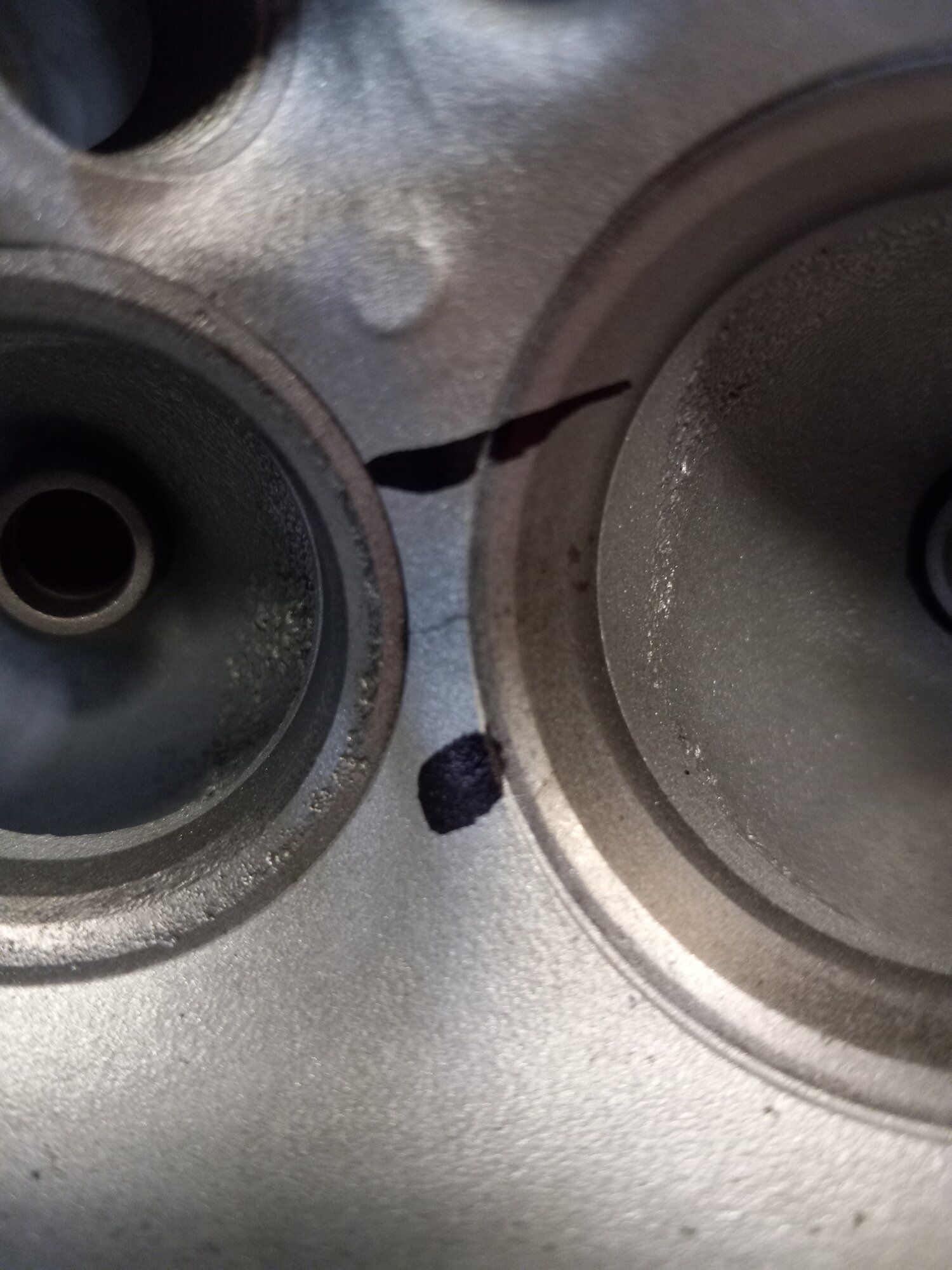

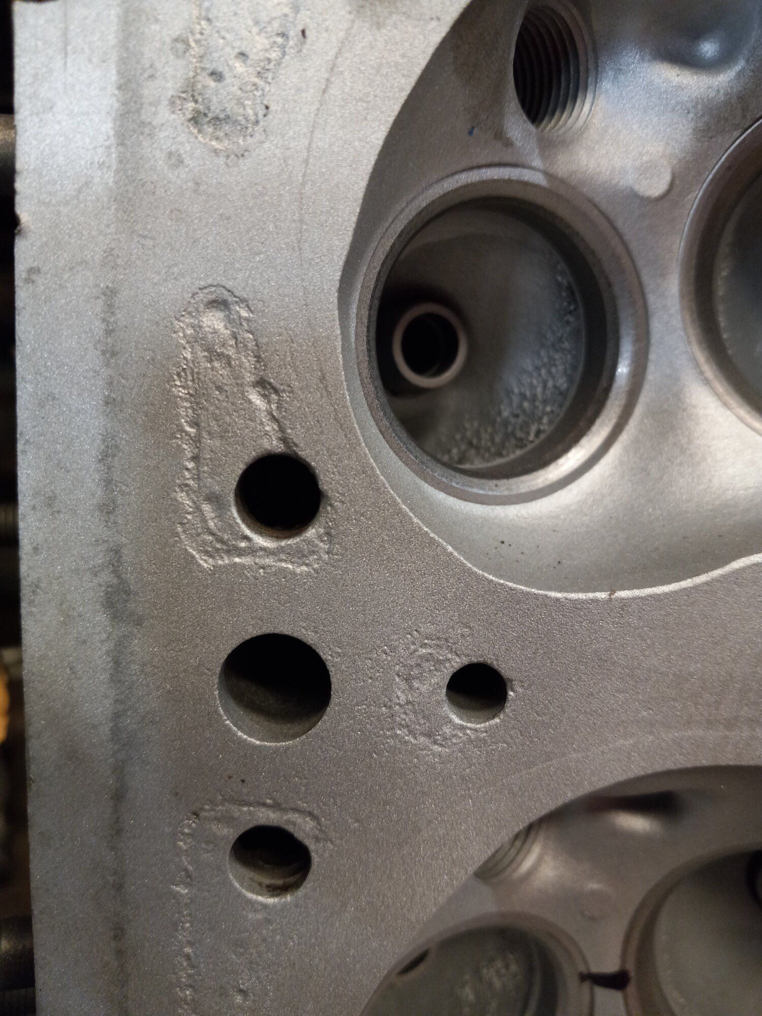

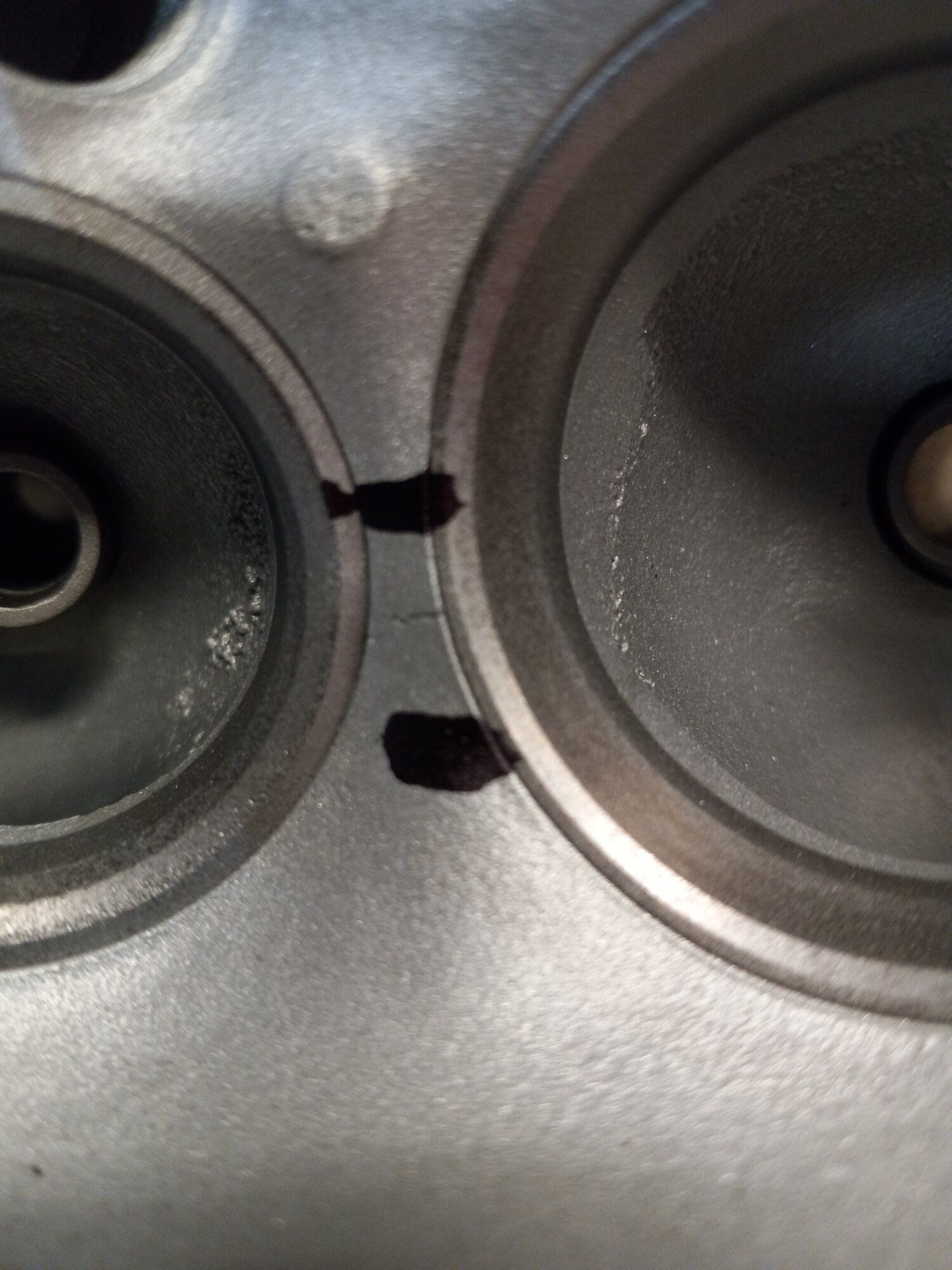

I just got a call from the machine shop. They said my head is cracked in multiple places and warped too badly to be resurfaced. Keep in mind it's been over a month since I dropped it off, and I had the car running fine before... I'm going to pick it up and have a look for myself. If what they're saying is true I might be in a hard spot with this car. I would imagine good heads for a 4g37 are few and far. Might end up doing a 4g63 swap just for convenience.

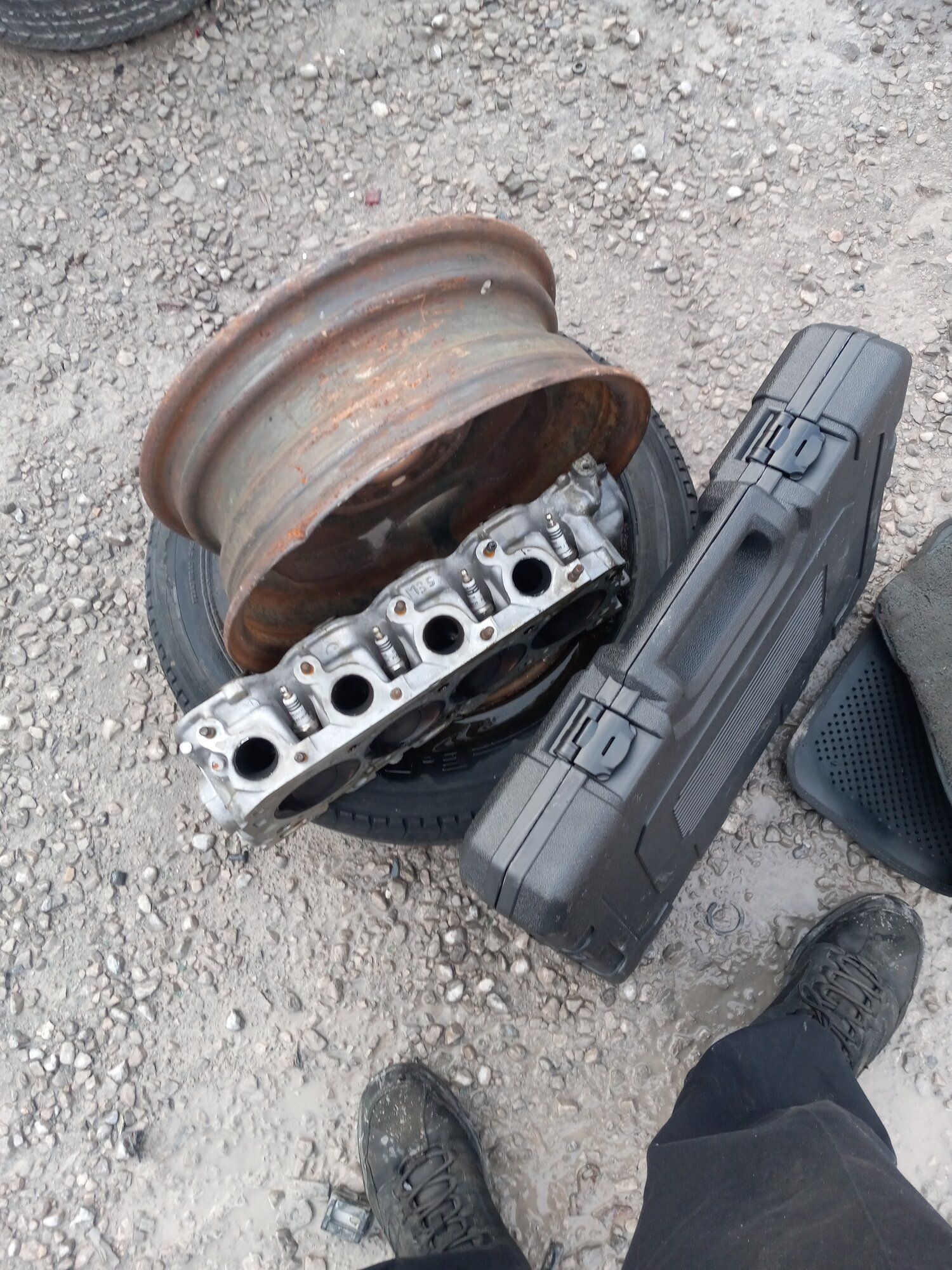

It's been a while since I messed with the car but today I got something great from the junkyard. To my surprise there was a 92 Eclipse with a 4g37. So I grabbed the head from it. It looks like it was rebuilt very recently and I don't see any cracks. I think with a cleaning, checking and resurfacing this will work good on my engine. Before I found this head I was very deep in thoughts of doing a 4g63 swap LOL But I guess she'll keep the 4g37 this time around.
I also bought a random floor mat while I was there to safely and cleanly transport it.

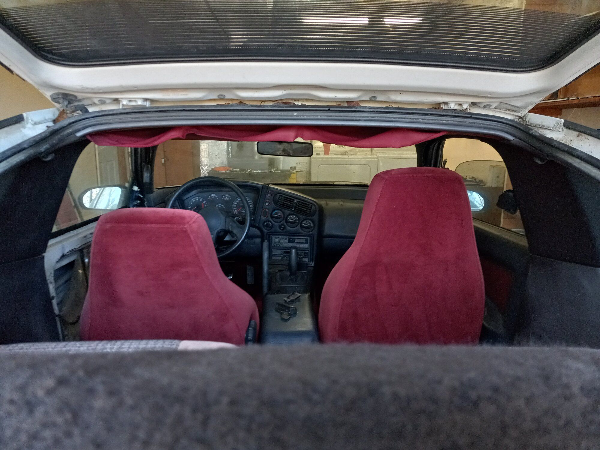

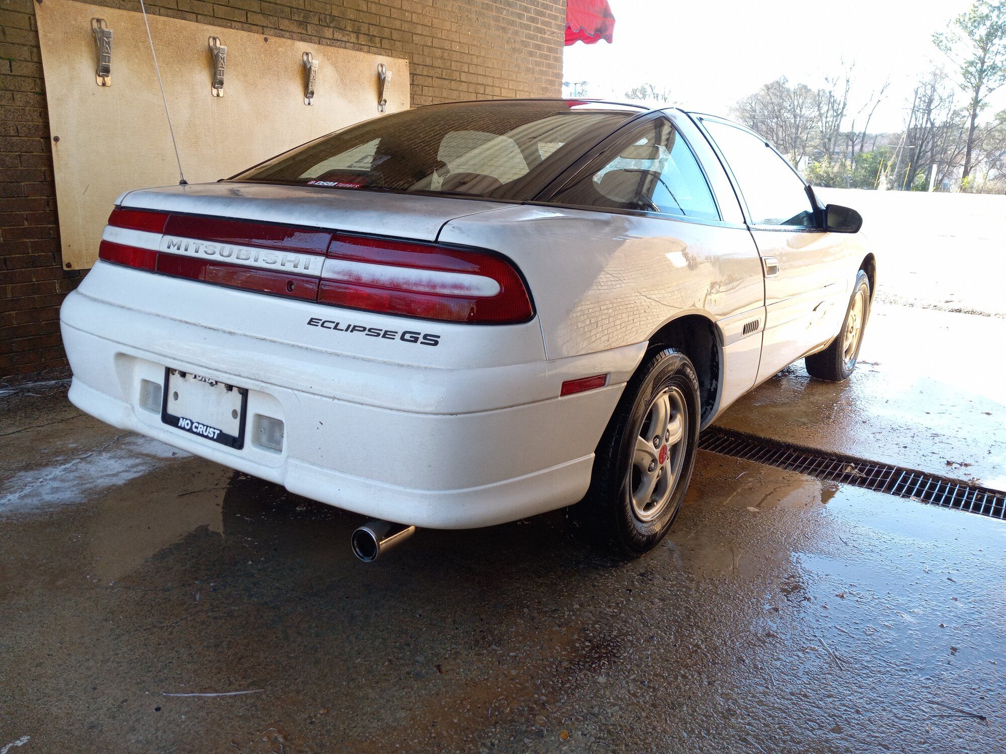

Now that it runs I figured it was time to take it out for a wash. This might have been the first wash in a few years. The soap provided at the carwash was not strong enough to cut through all of that crud, but it's significantly more appealing now anyway. Side note, this is probably the slowest car I've ever owned LOL . Even at WOT in 1st gear it has no pep to it, but I suppose it runs well enough to serve it's purpose as a vehicle. What could you expect with 92hp anyway. Reminds me of the 1971 Volkswagen we used to have. Just a bit more stylish. Oh and I also thoroughly vacuumed the interior and found some missing pieces under the seats. I'm about to have it fully reassembled on the inside hopefully.

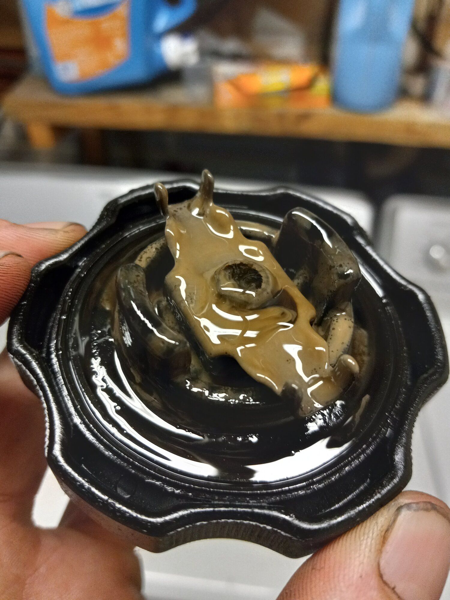

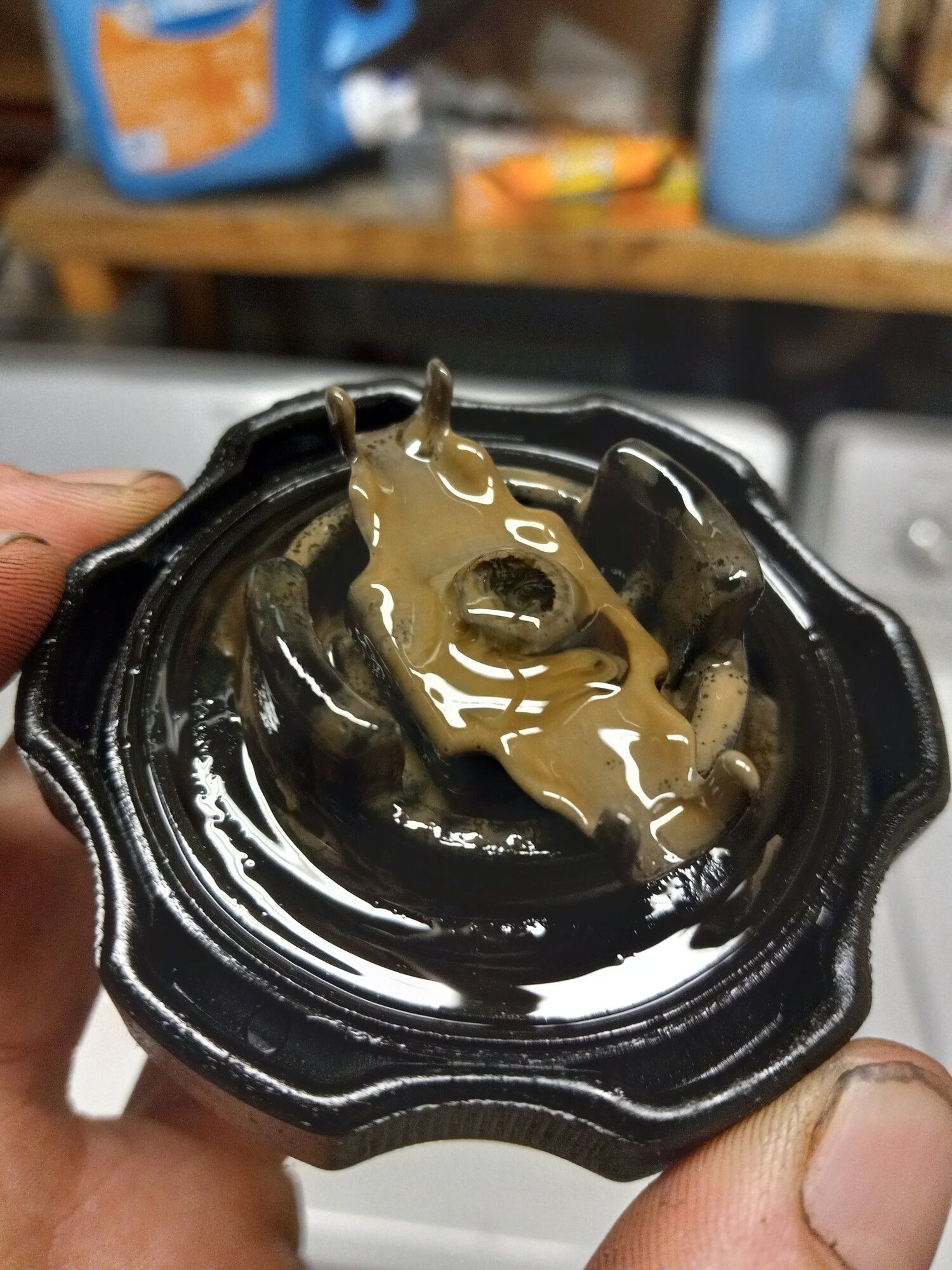

So I found this interesting piece of information while changing the oil for the first time after the rebuild. The oil is heavily contaminated with coolant! The only thing I can suspect is a crack in the block. I know the head and head gasket are in excellent shape. And oddly enough the compression results are very healthy on all 4 cylinders. So possibly a cracked water jacket sharing fluids with an oil port? Just not sure how we could have missed that while going through it. Can't say I didn't see this coming though. The car sat through at least one winter with a half empty cooling system. Should have just 4g63 swapped it like I wanted to.
Damnit! Maybe just residual water/moisture in there and worthy of a quick cheap oil change to see if it's significantly better?
Changed oil again and still heavily mixed with coolant. Runs hot, even though the temp gauge is reading normal. Cylinder 3 lost 10 psi compression since the last time I tested so either a crack in the block is worsening or the thinned oil is damaging the rings.
This being said. 4g63 swap in progress. Still need to find an engine, ecu and wiring harness. My 4g37 harness and ecu will be for sale. But not the engine. I want to tear it open and see what failed me.

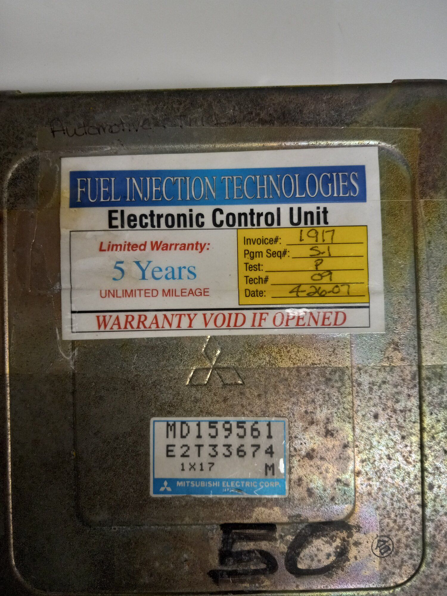

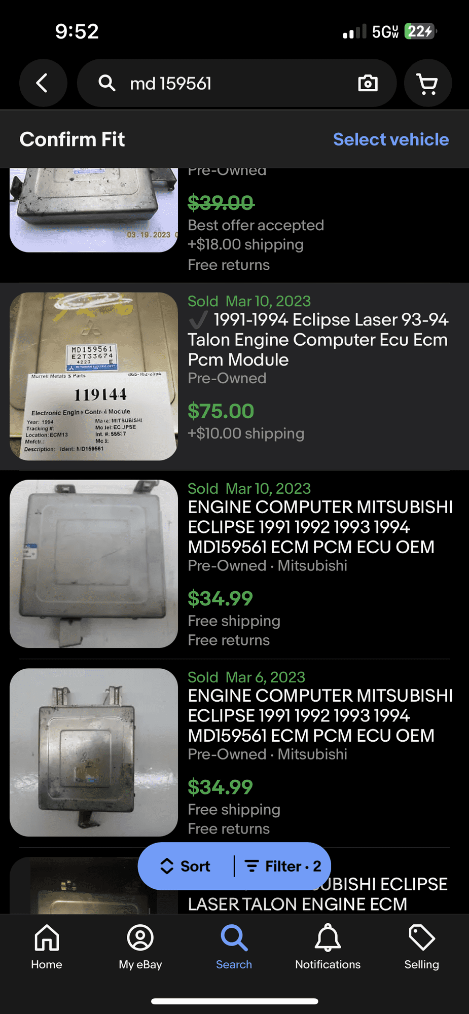

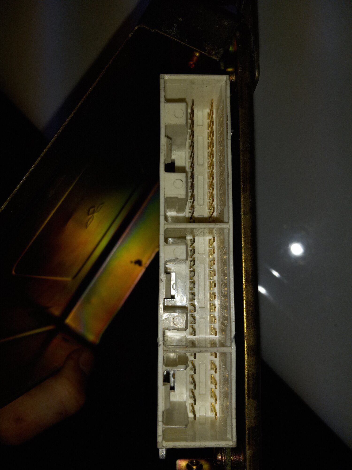

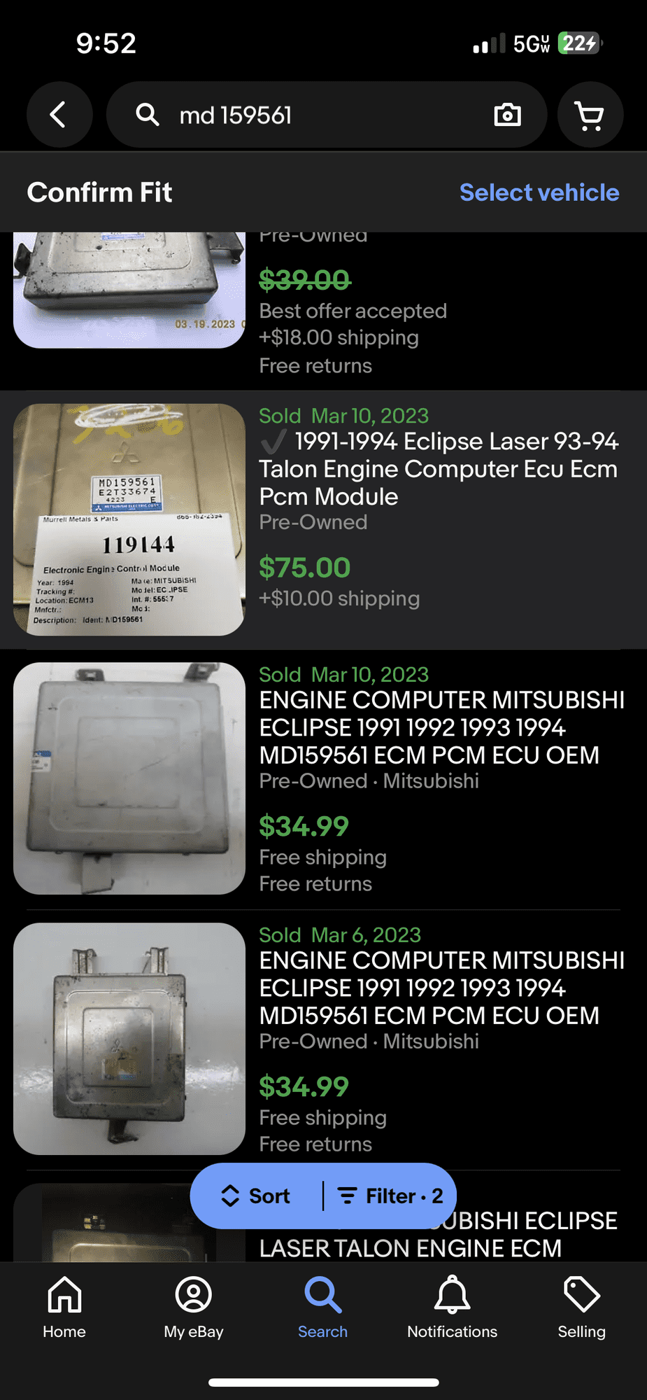

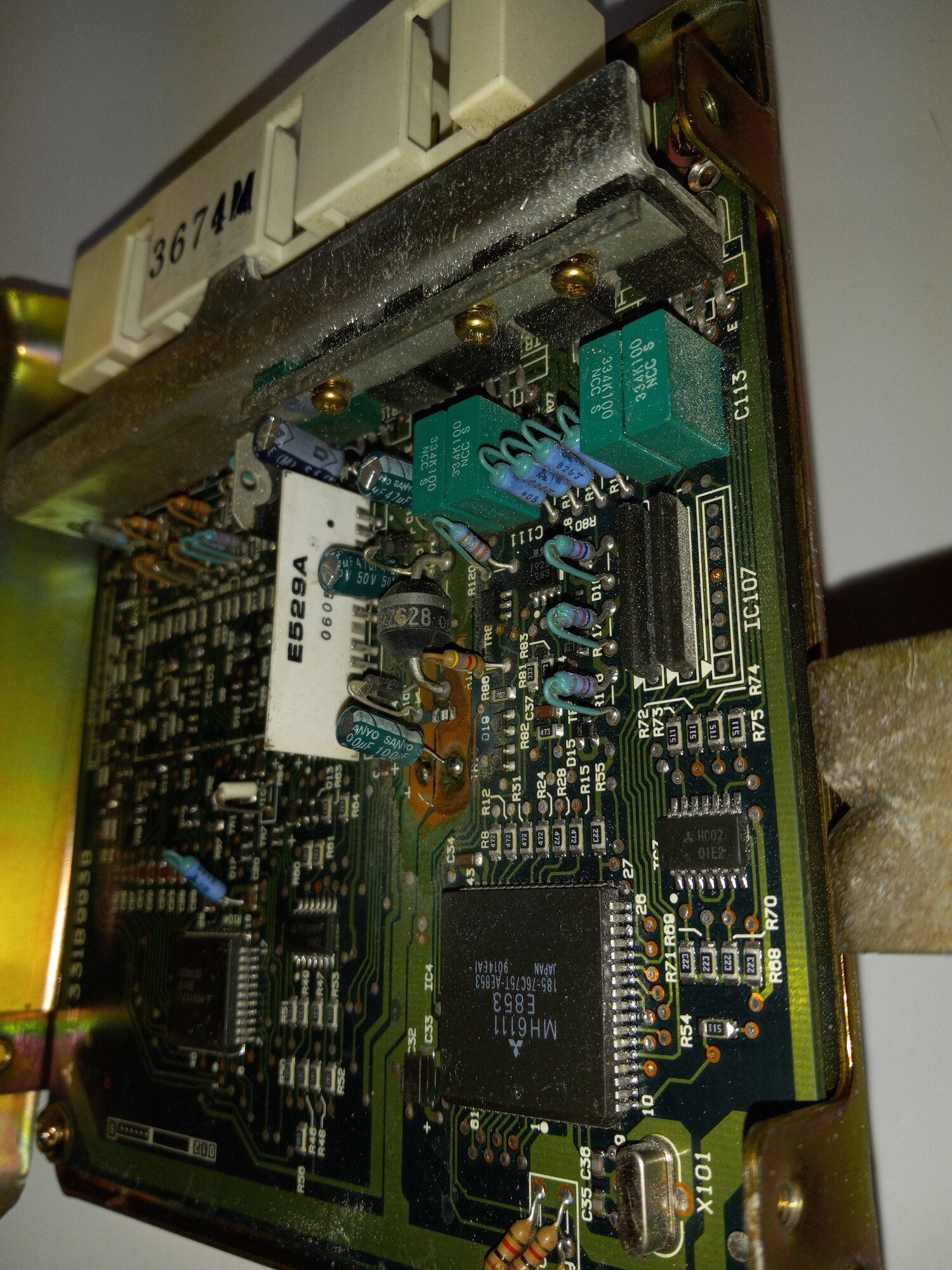

Good news is that the ecu has already been replaced with an OEM unit and is still in great shape so I should be able to snag some cash for it. Anyone have suggestions on a good selling price? New ones run $250 and more (not oem).
Probably not the $$ number you’re looking for , but here’s a list of recent sales for that part number.
Oh wow. Probably because of how much the new ones cost, everyone wants the cheaper ones haha. It was worth a shot though. I also find it interesting how many have been selling, they must go bad quite often.
