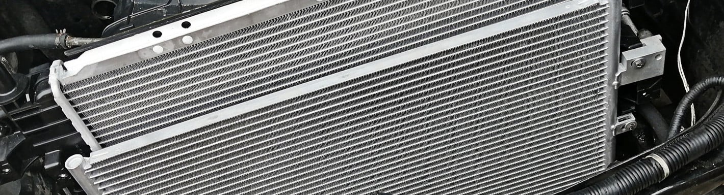

Thanks for the links Marty. Unfortunately those won't work with the 2gnt's. Of course I could probably make them work. I just want to keep my heat and don't want any kinks in any hoses. Use this picture for reference, the upper connection point is towards the passenger side of the car while the one for the turbo models is almost dead center.

I couldn't see where the bottom fitting was. Everybody's pictures are from the top, and I can't blame them. You don't want to see the bottom of my car.
Your engine bay sure looks CLEAN!!!!
