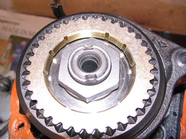

No but you better drain the oil out first or you'll have a mess. And lock the shafts together to hold them to tighten those 36mm nuts (otherwise you'll never hold them solid enough) and then stake them (notice how nuts are staked to prevent nuts coming loose): https://www.dsmtuners.com/threads/5th-gear-shift-inside-tranny.480233/#post-153435439.

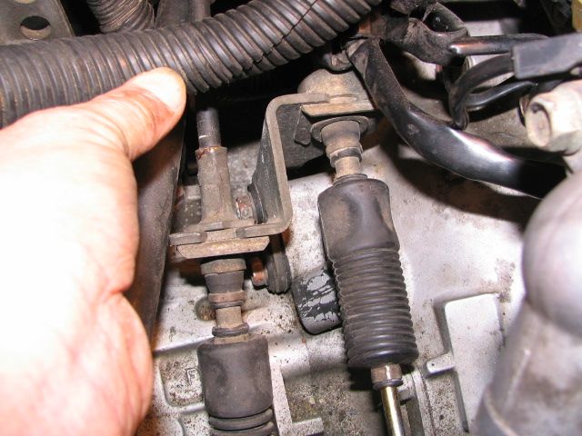

Also make sure the shifter cable casings aren't moving around when shifting which will cause those problems. Have someone shift while you watch under the hood. Here's how they mount onto the tranny bracket: https://www.dsmtuners.com/attachments/tranny-shift-cables-in-mounting-bracket-on-tranny-jpg.131662/. The outer casing should not move.
To hold shafts, if you can't lock tranny into 2 gears at once, try holding the other 36mm nut while tightening this one with a torque wrench. It won't hold the shafts as solid while tightening but may get you by. Make sure you stake the nut to prevent it from coming loose (https://www.dsmtuners.com/attachments/reverse-syncro-new-on-5th-gear-slider-jpg.226616/). Use gasket sealer on cover upon re-assembly.
Here's what 5th gear/fork looks like in the FWD tranny with the 36mm nut removed (you'll see under that end cover).
