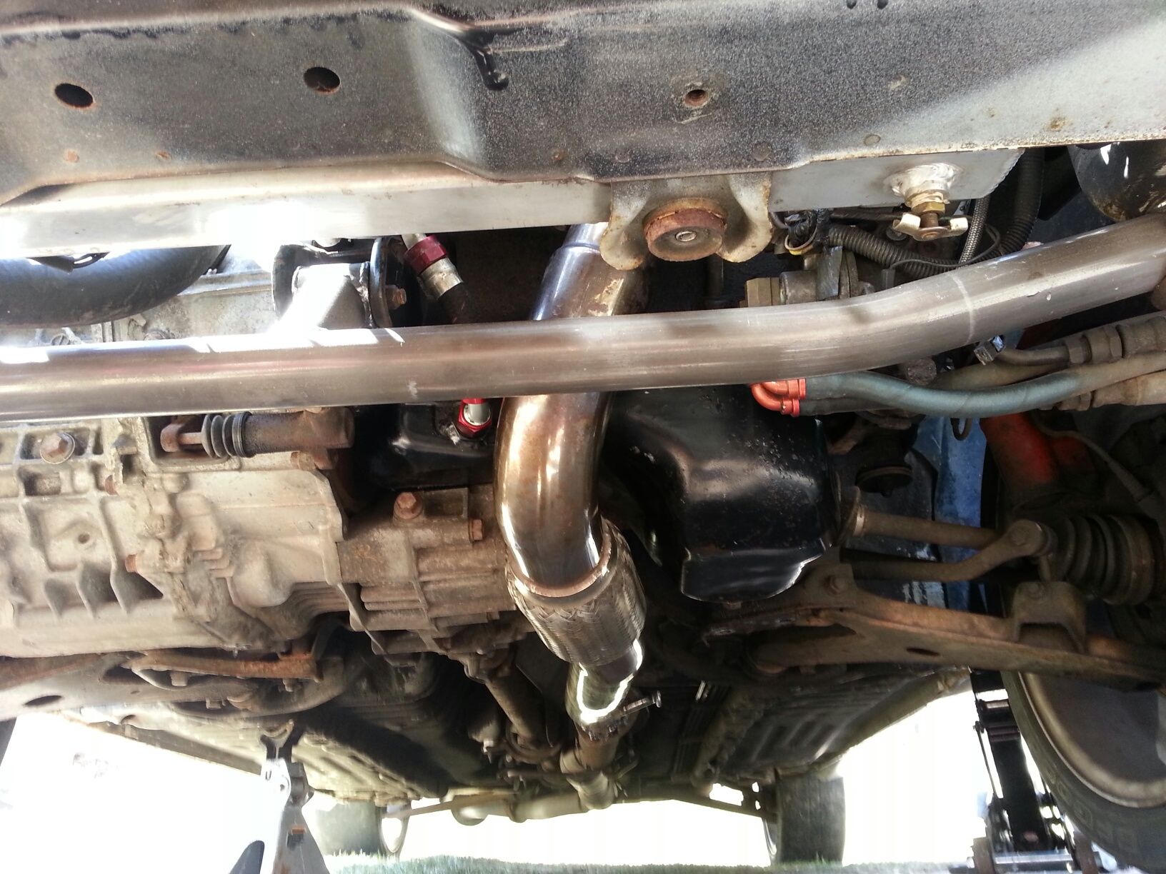

bought the car with 80k on the chassis and after being around the dsm game for awhile now i thought it would be time to make a rele fast street car!! a 10.50 street car!!!

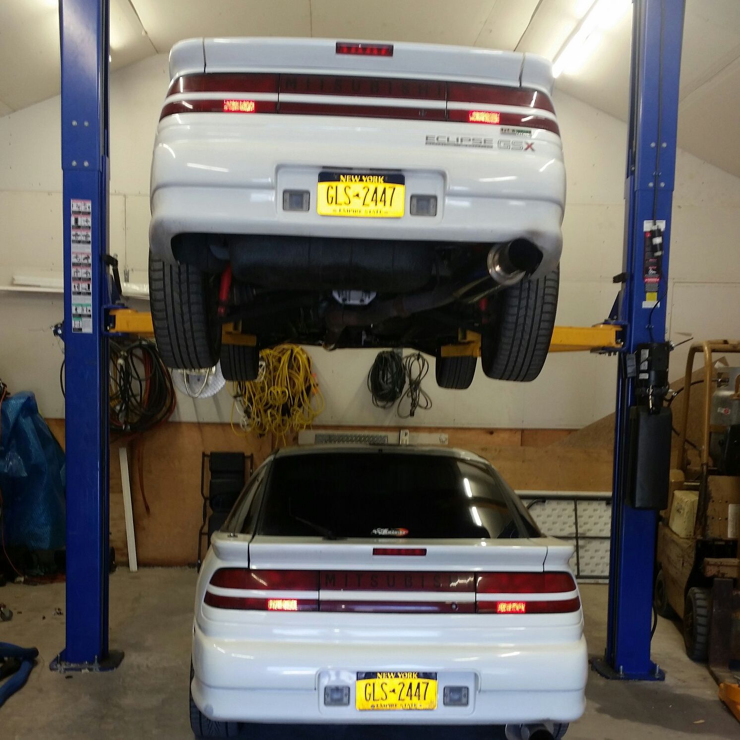

here we go on the lift ready to remove alot of shit!!!!

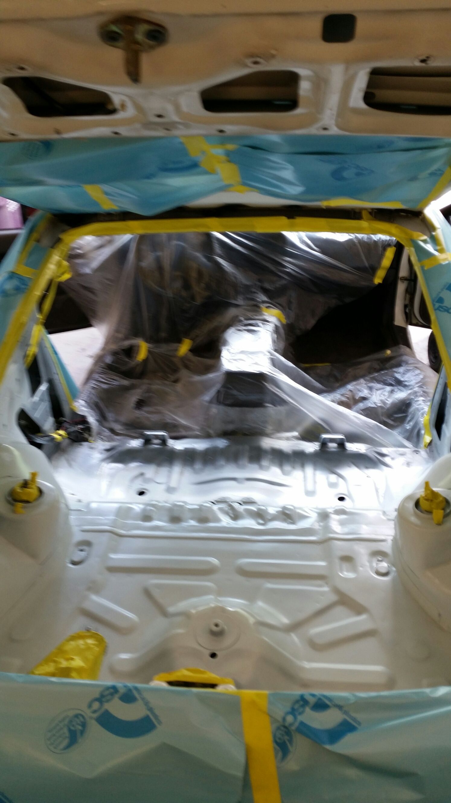

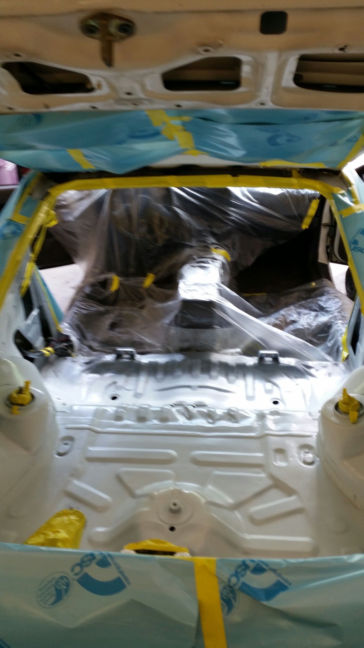

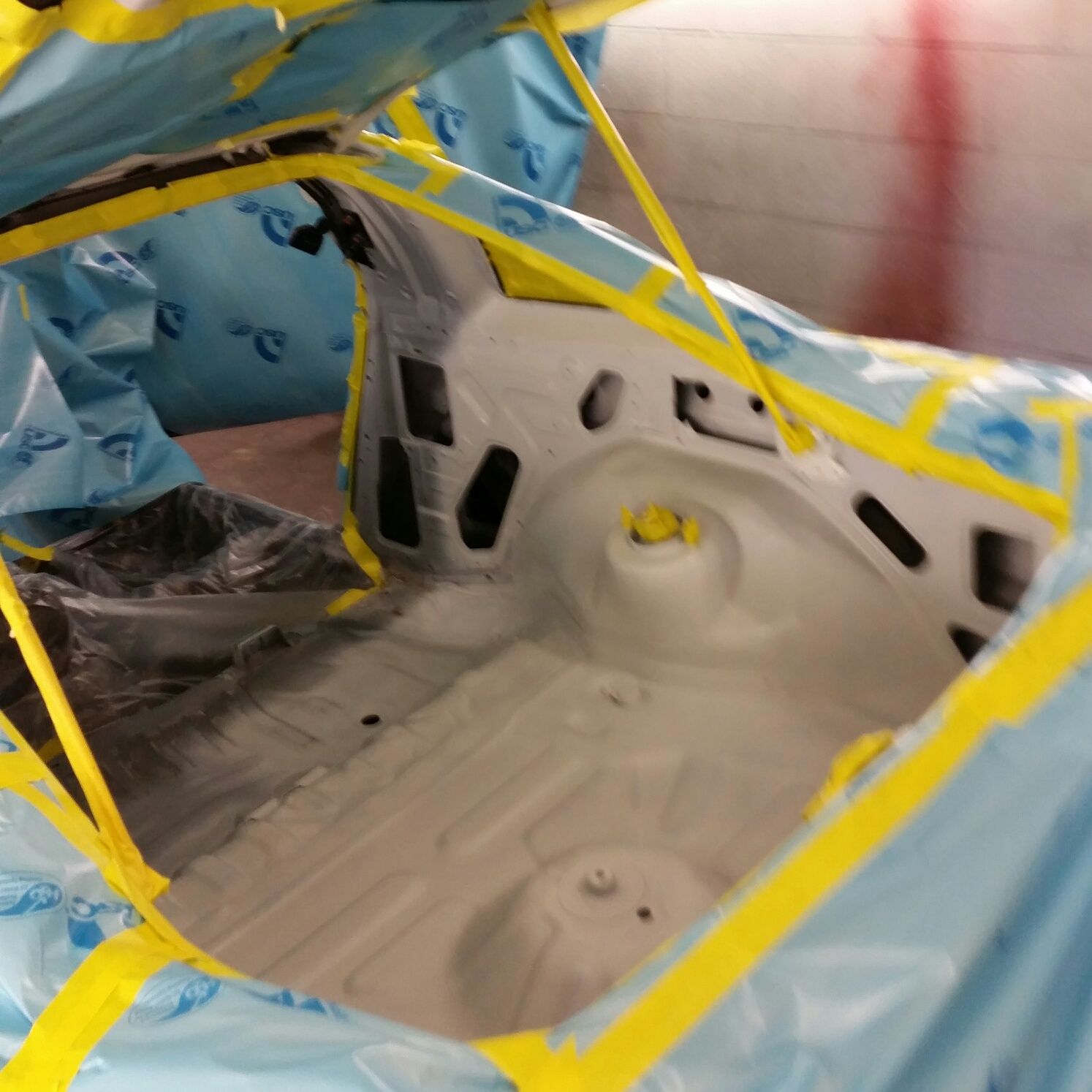

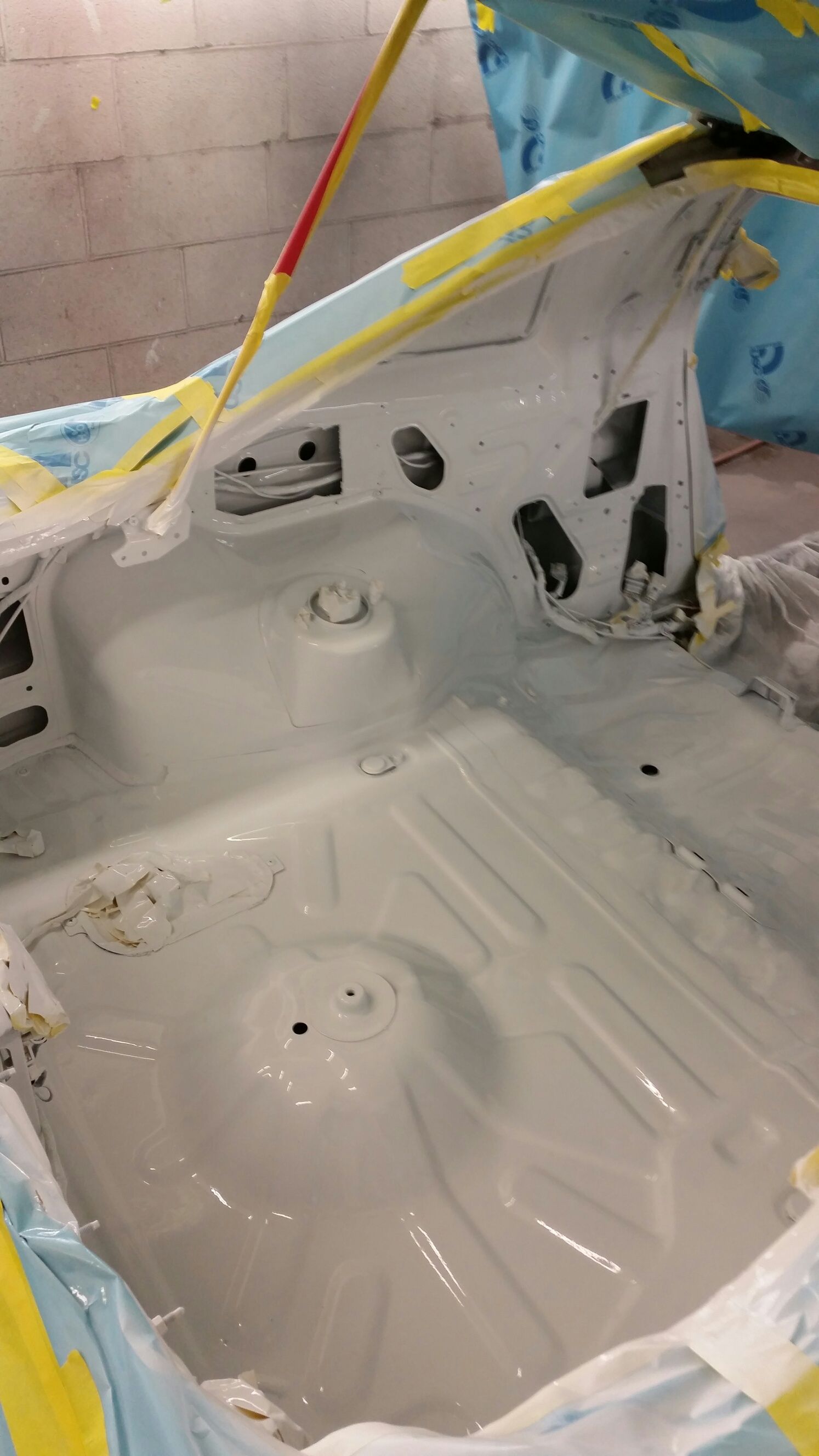

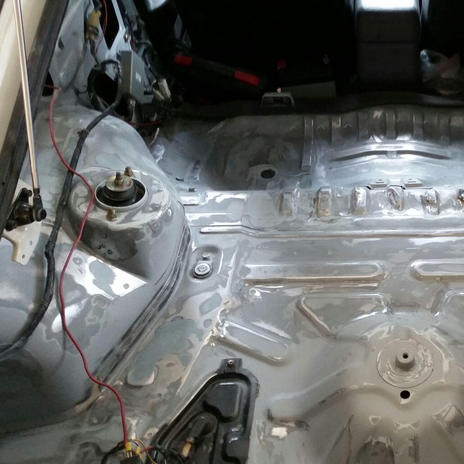

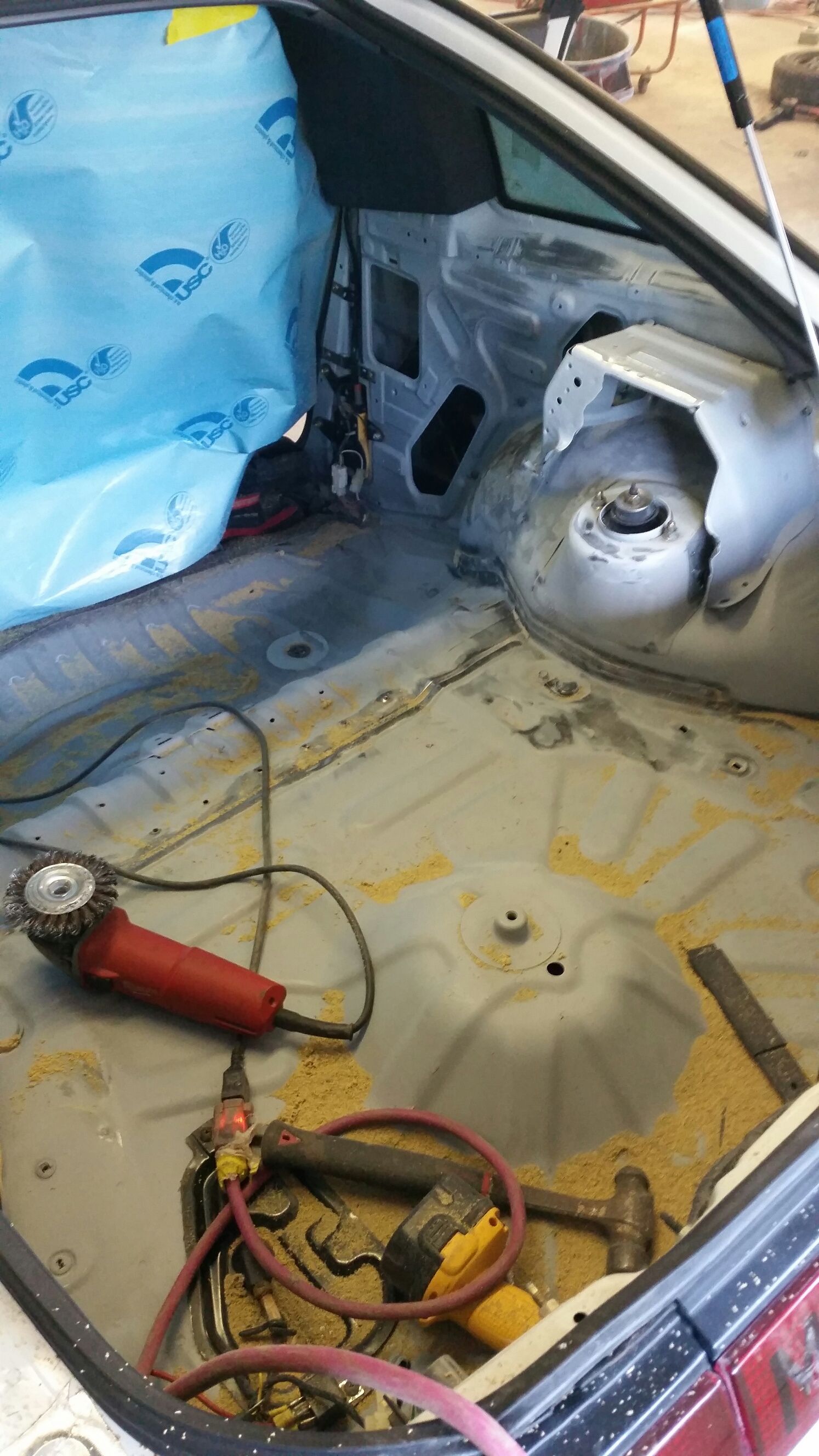

started cutting out everything in trunk area. including sound deadening material and braces. stuff that was not usefull at all!!

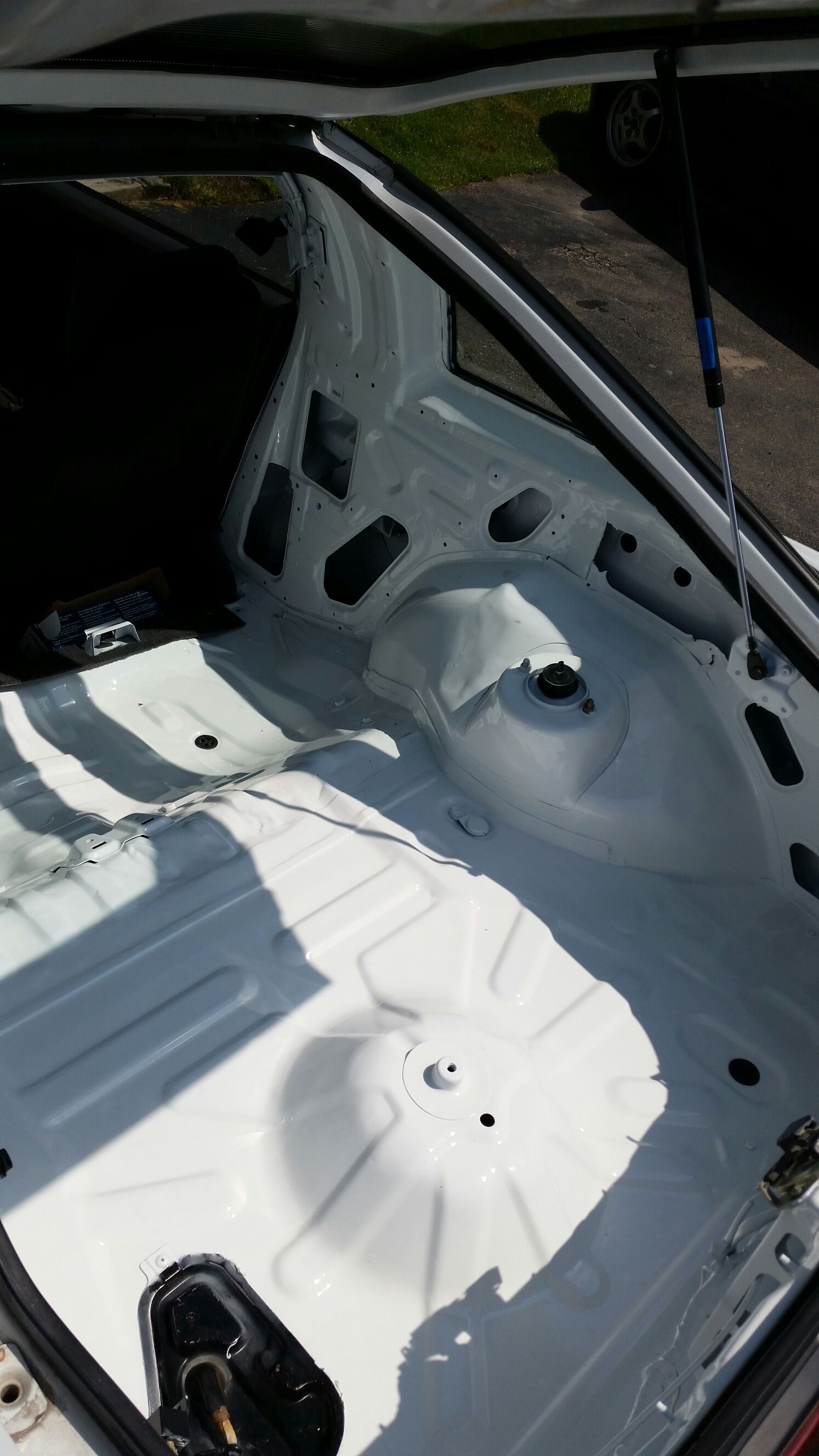

after everything was removed ready for paint!!!
and nice and glossy. clean
somewhat finshed. lots of detail left....

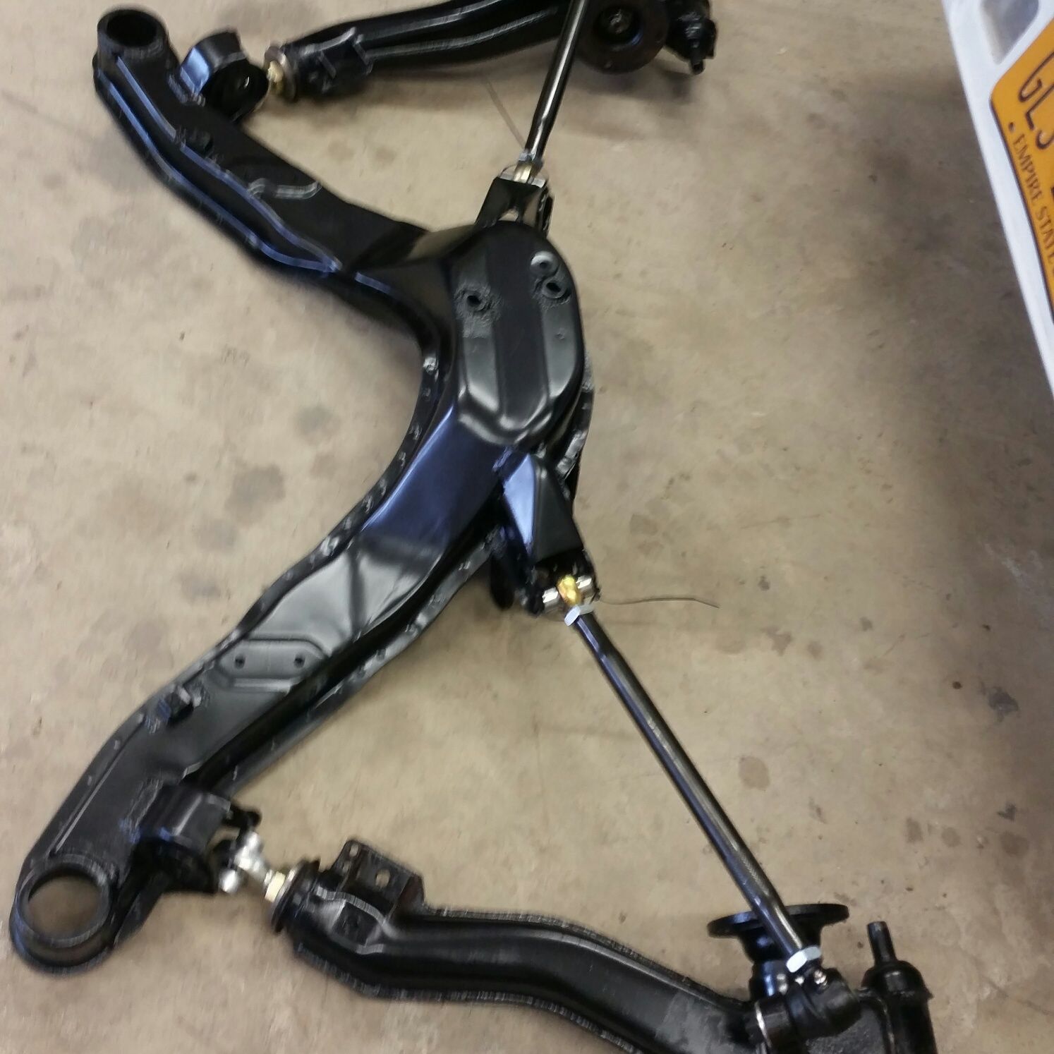

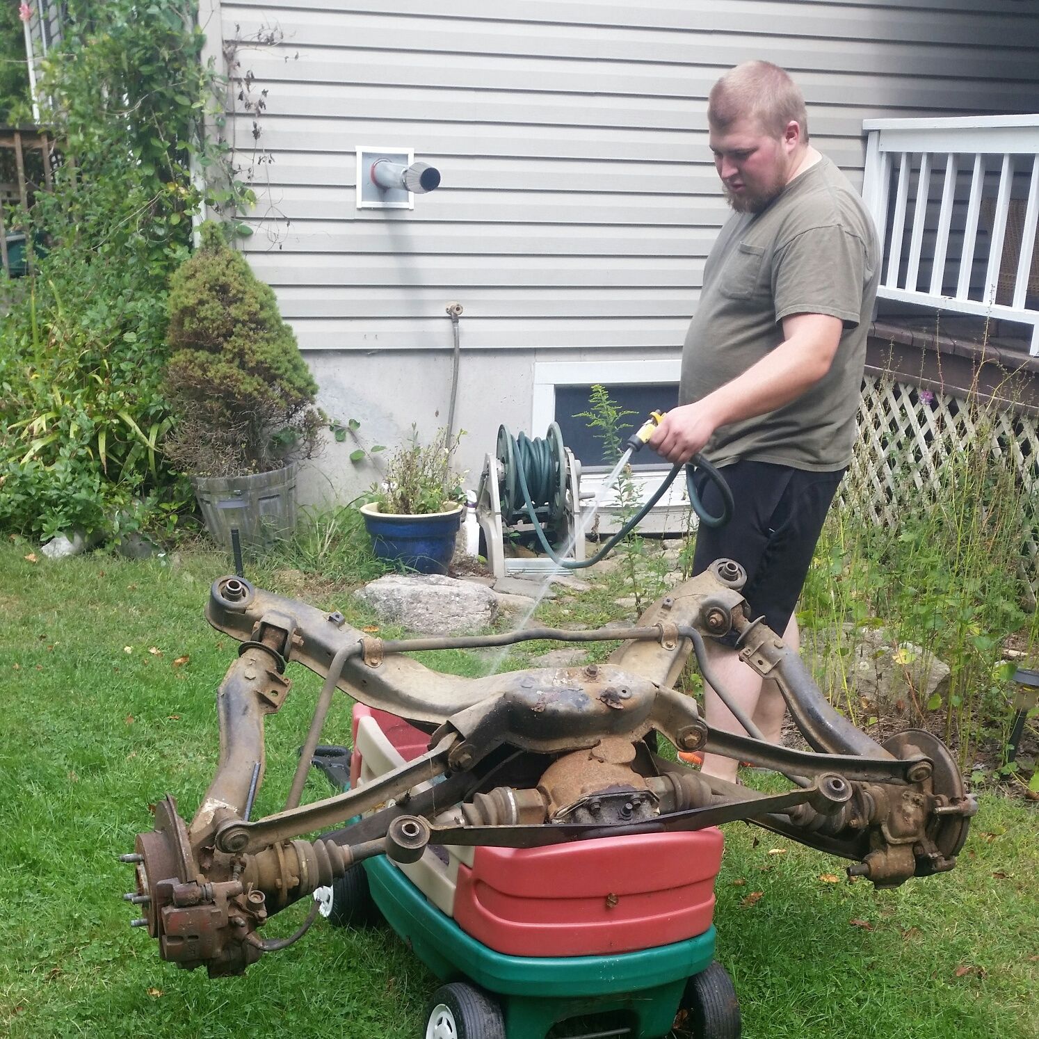

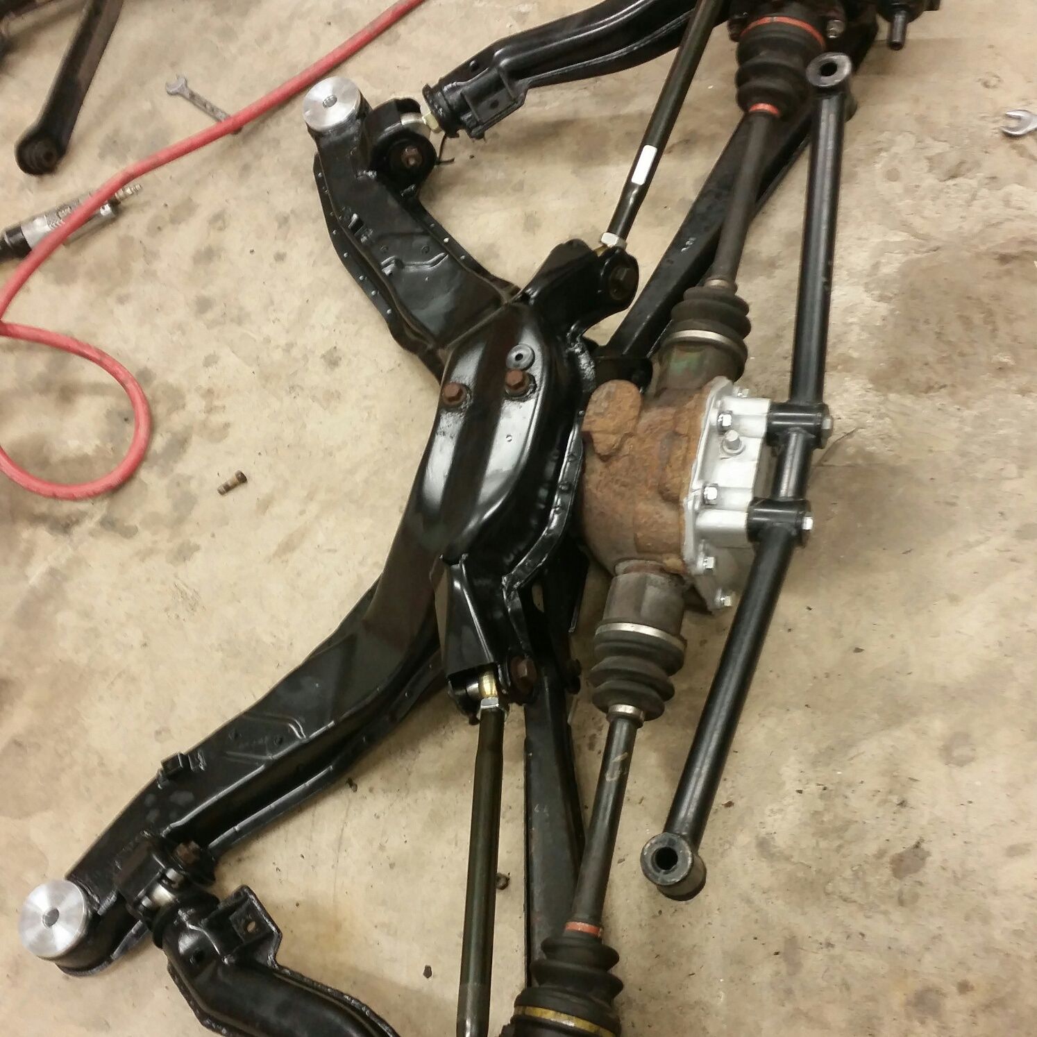

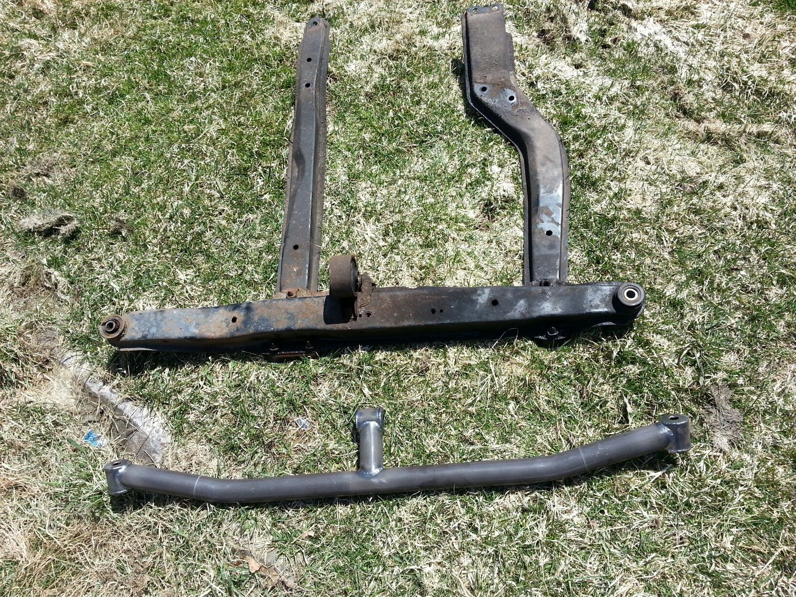

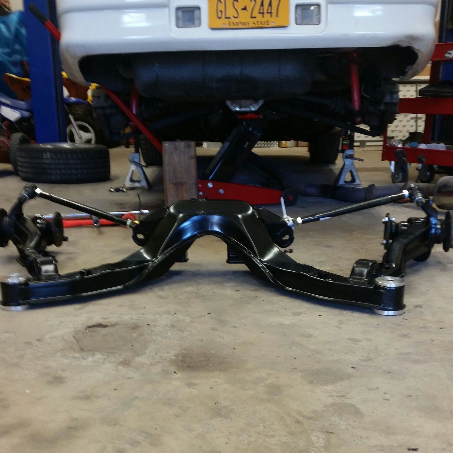

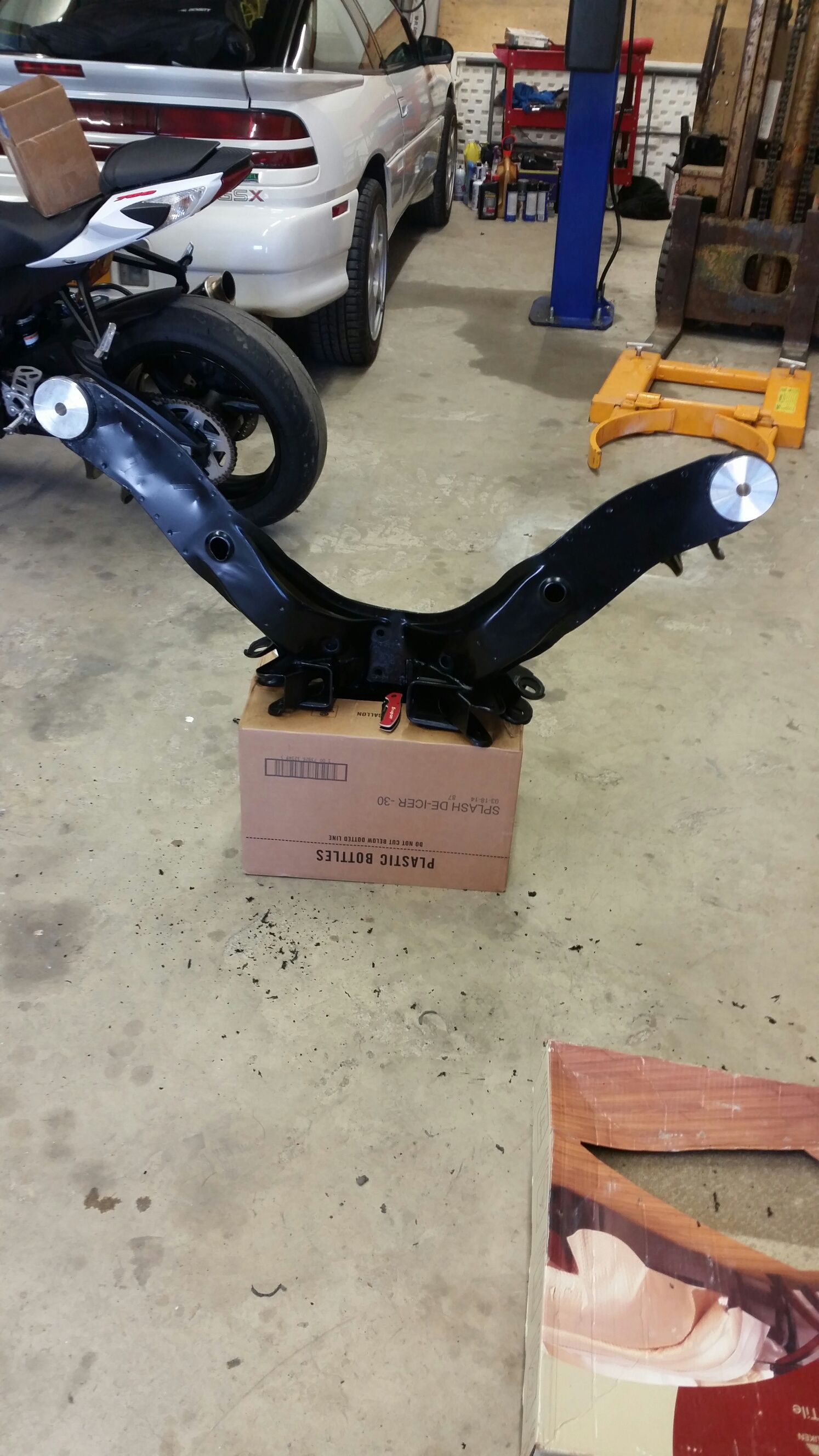

Now on for the good stuff! me and my friend kyle parted out a race 1g and i grapped this subframe from him. clean no rust. cleaning getting ready for paint!!!
I started from the front of the car to the front on this build!
i orded every bulfab option you can buy.

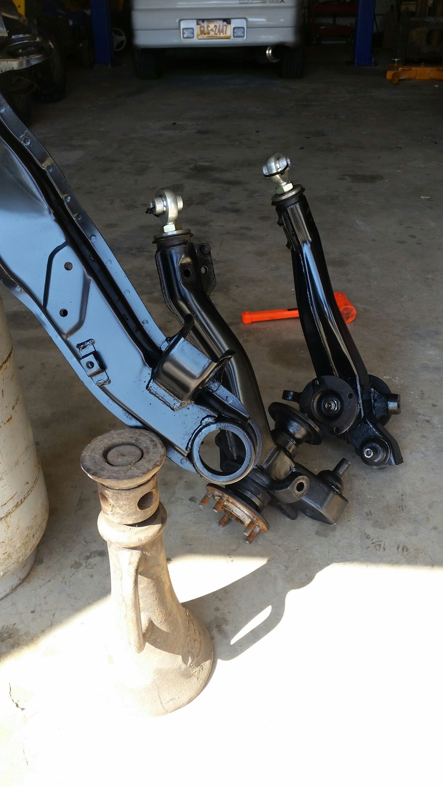

3sx controll arms
the car already had a 4 bolt lsd when i got it so i was soo excited i didn thave to buy one!

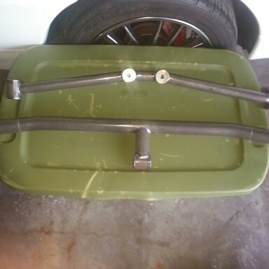

BULFAB FRONT CROSSMEMBER
3SX UPPER CONTROLL ARMS

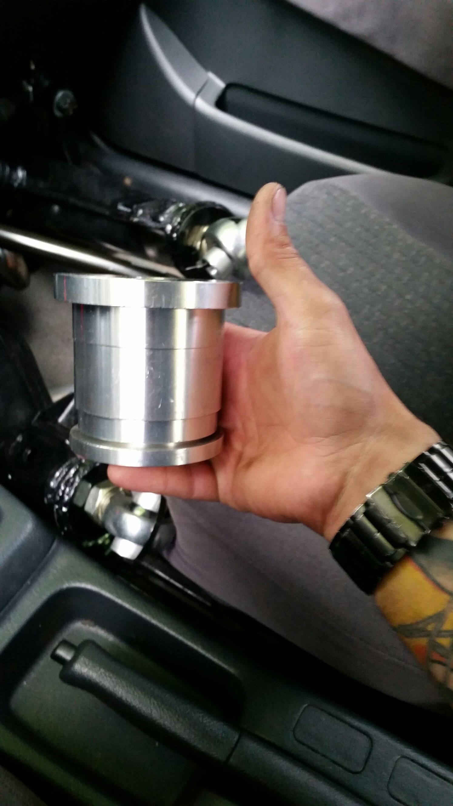

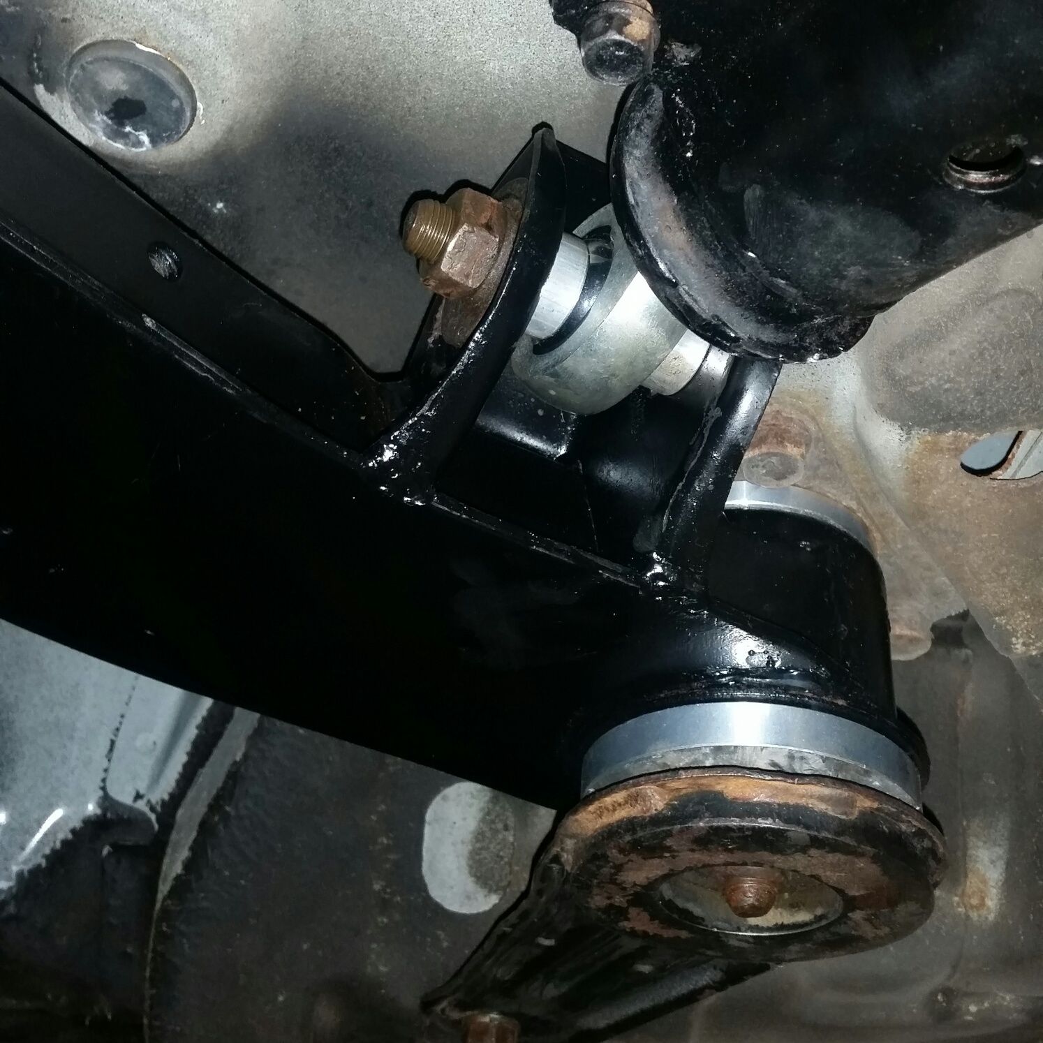

bulfab solid rear subframe bsuhings

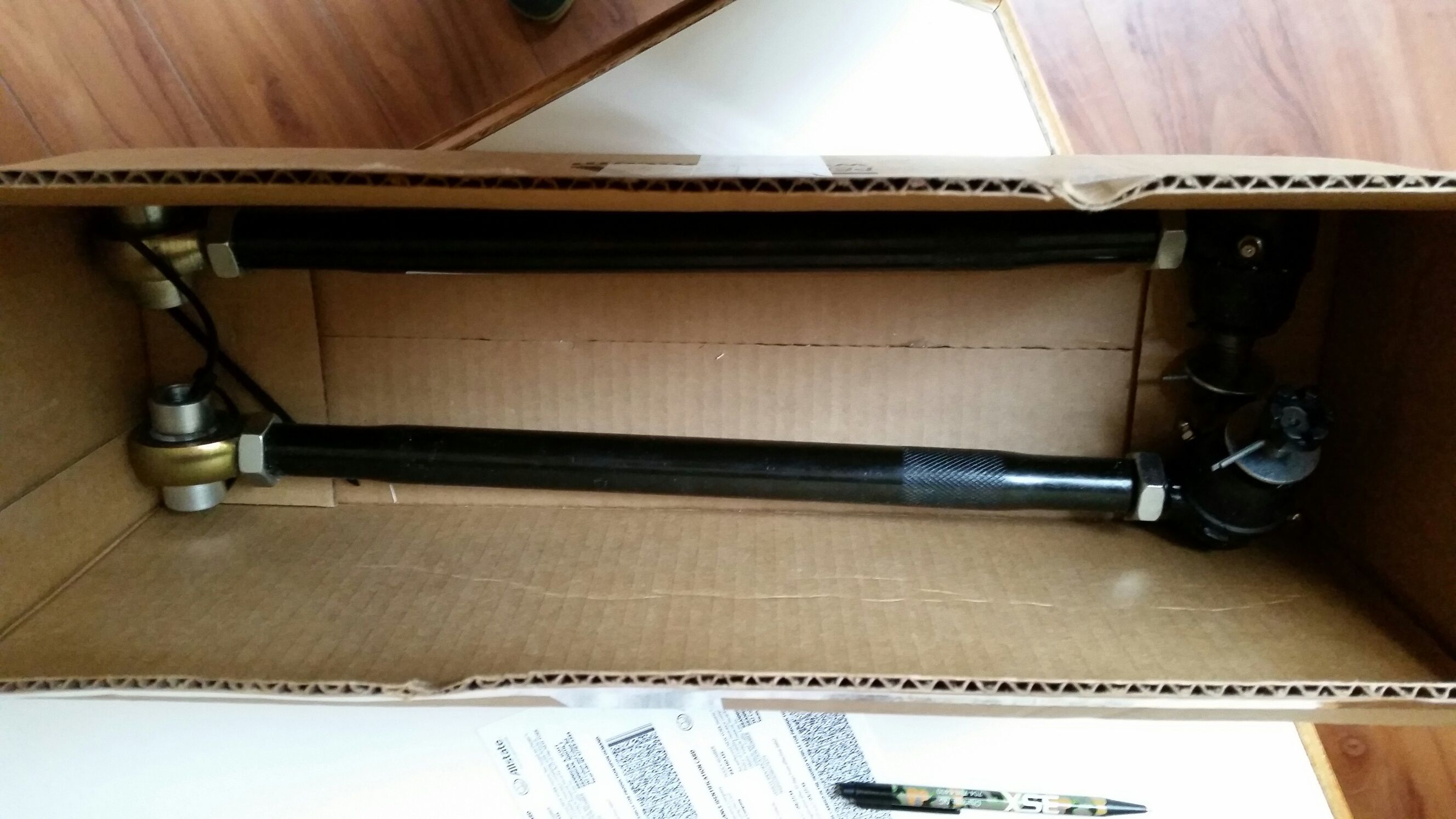

jays racing toe eliminators." helped out a lot!!!!!!!

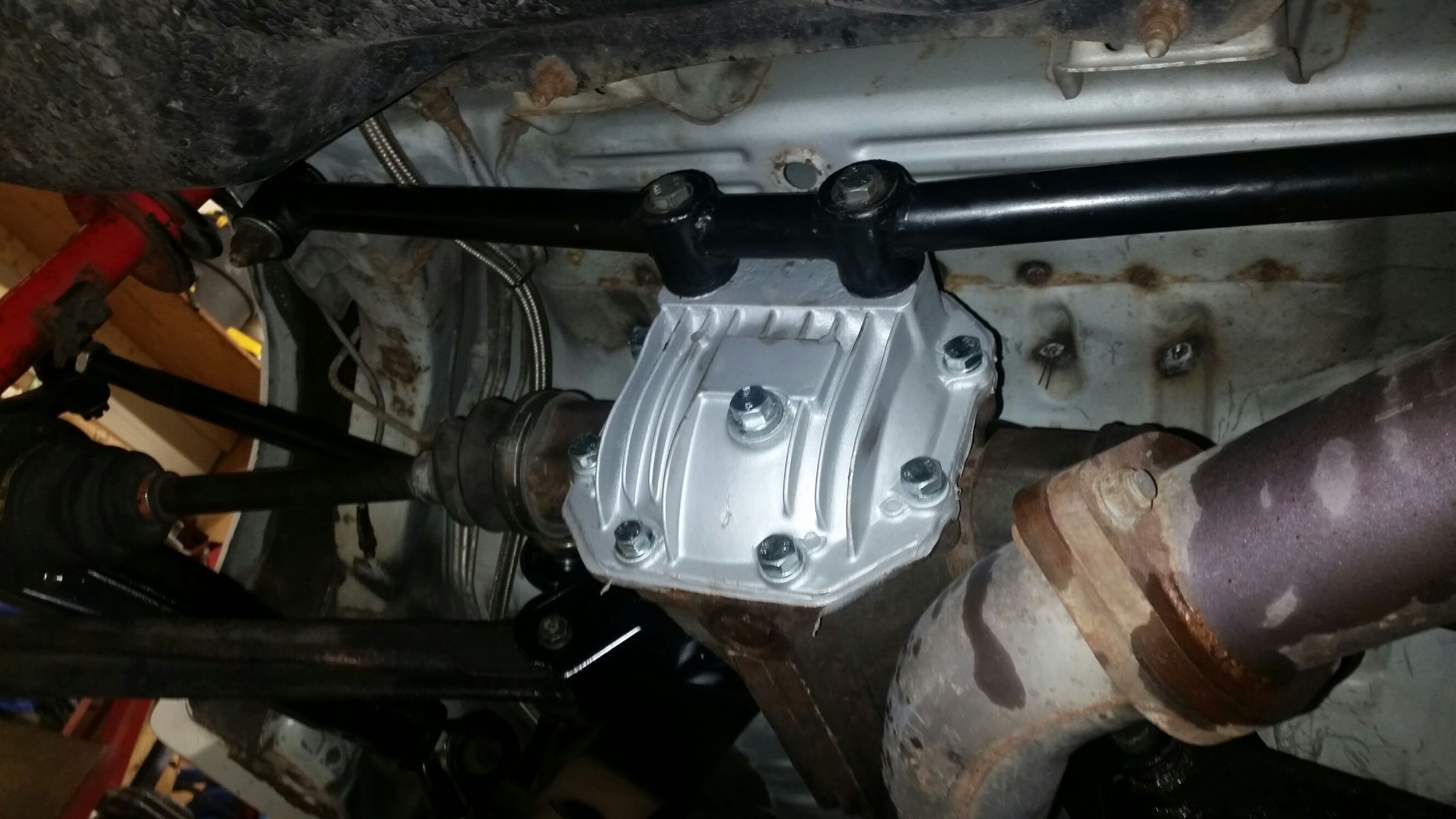

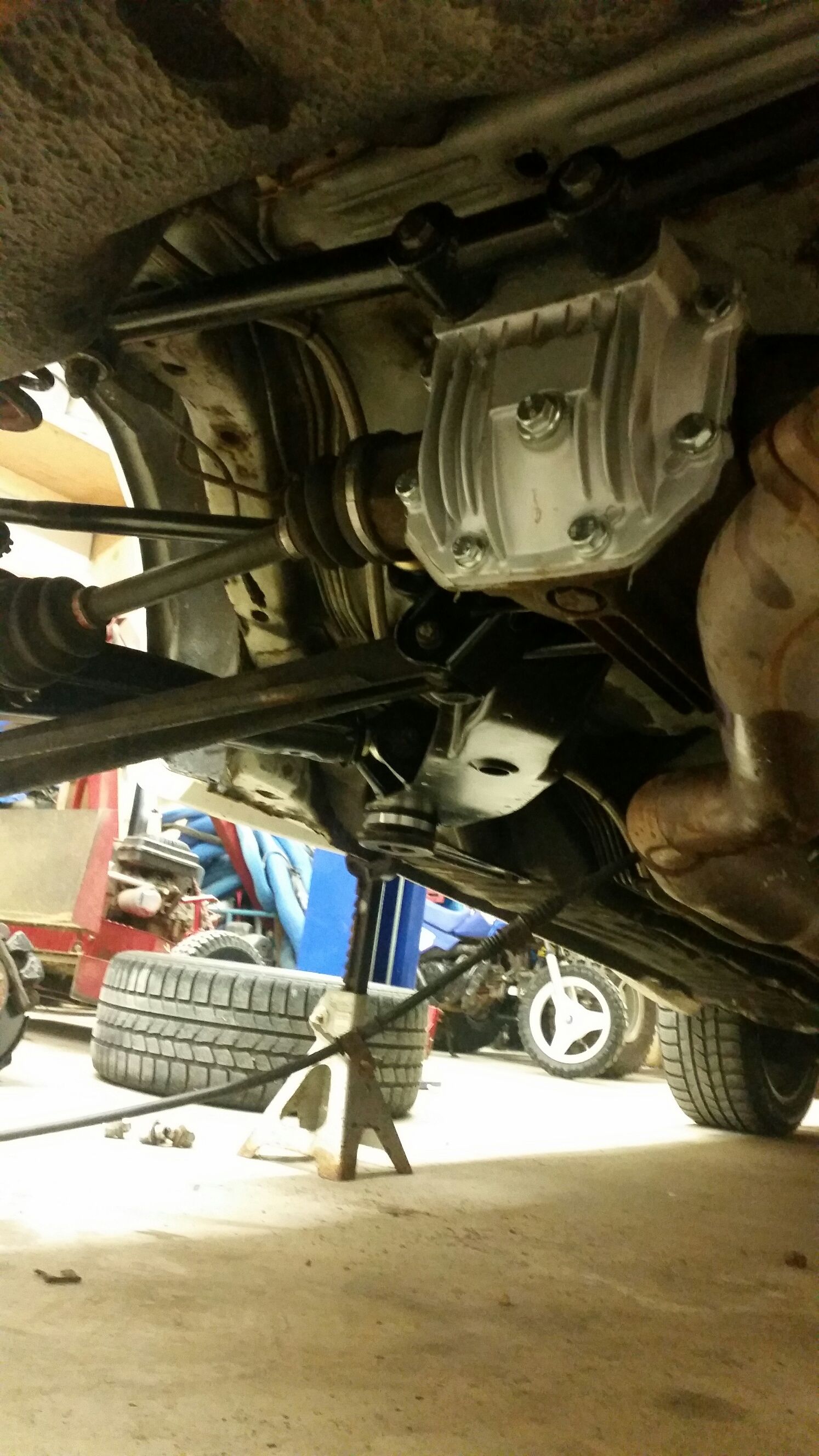

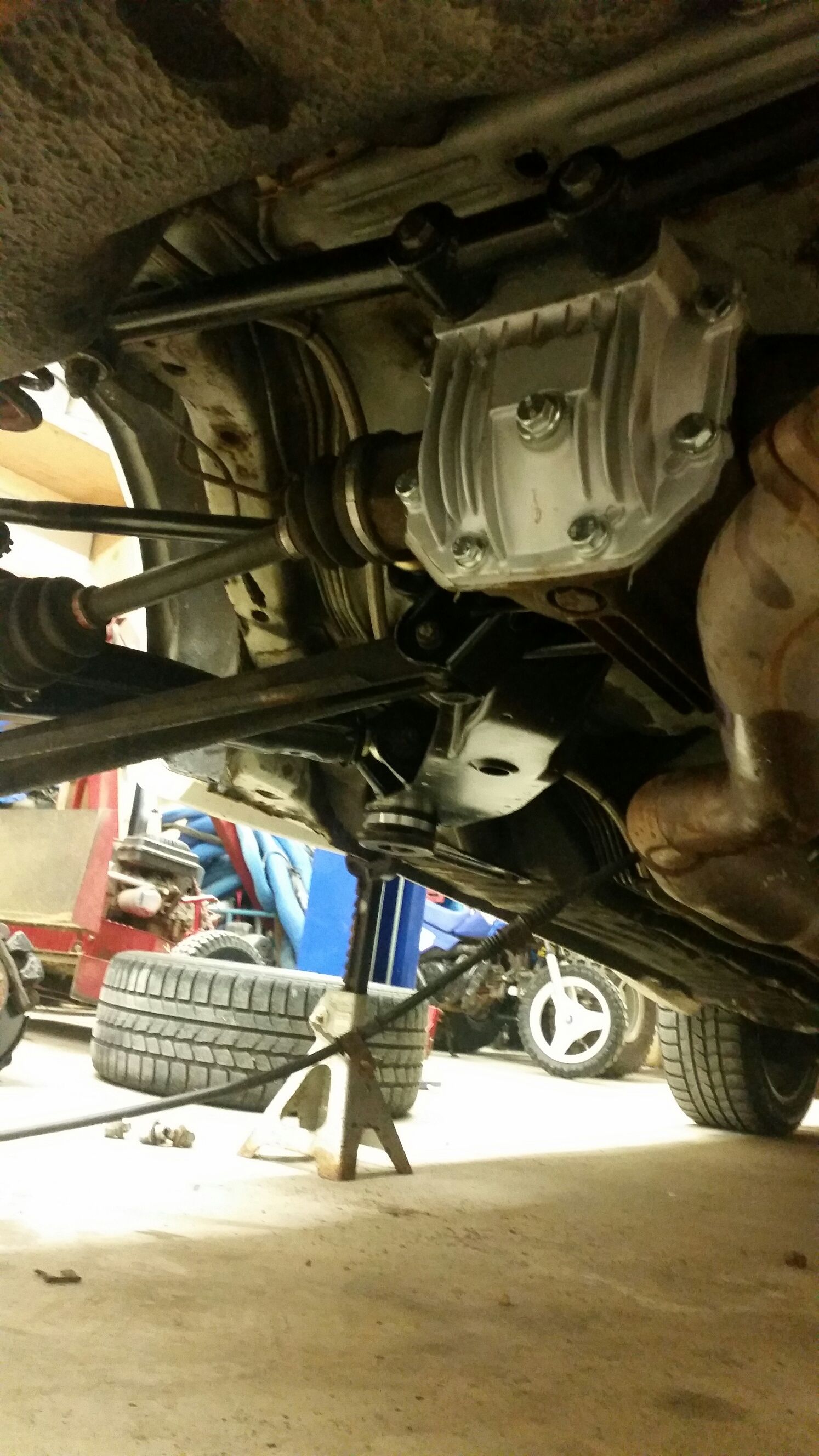

cleaned up the rear diff cover and replaced with grade 8 bolts and washers.. exhaust looks shitty but will be switching over to aluminum rele soon. everything bit counts!!!

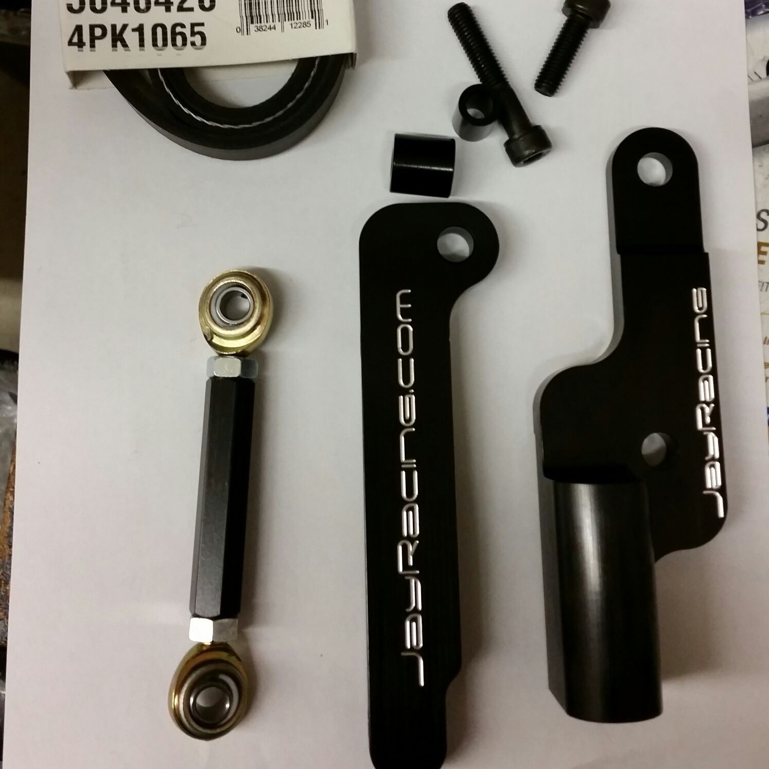

figured out while i was shopping id buy a jays racing altenator relocation kit.. well worth like 125 bucks.. keep that heat away from charging system

here is with the bulfab front cross memeber installed

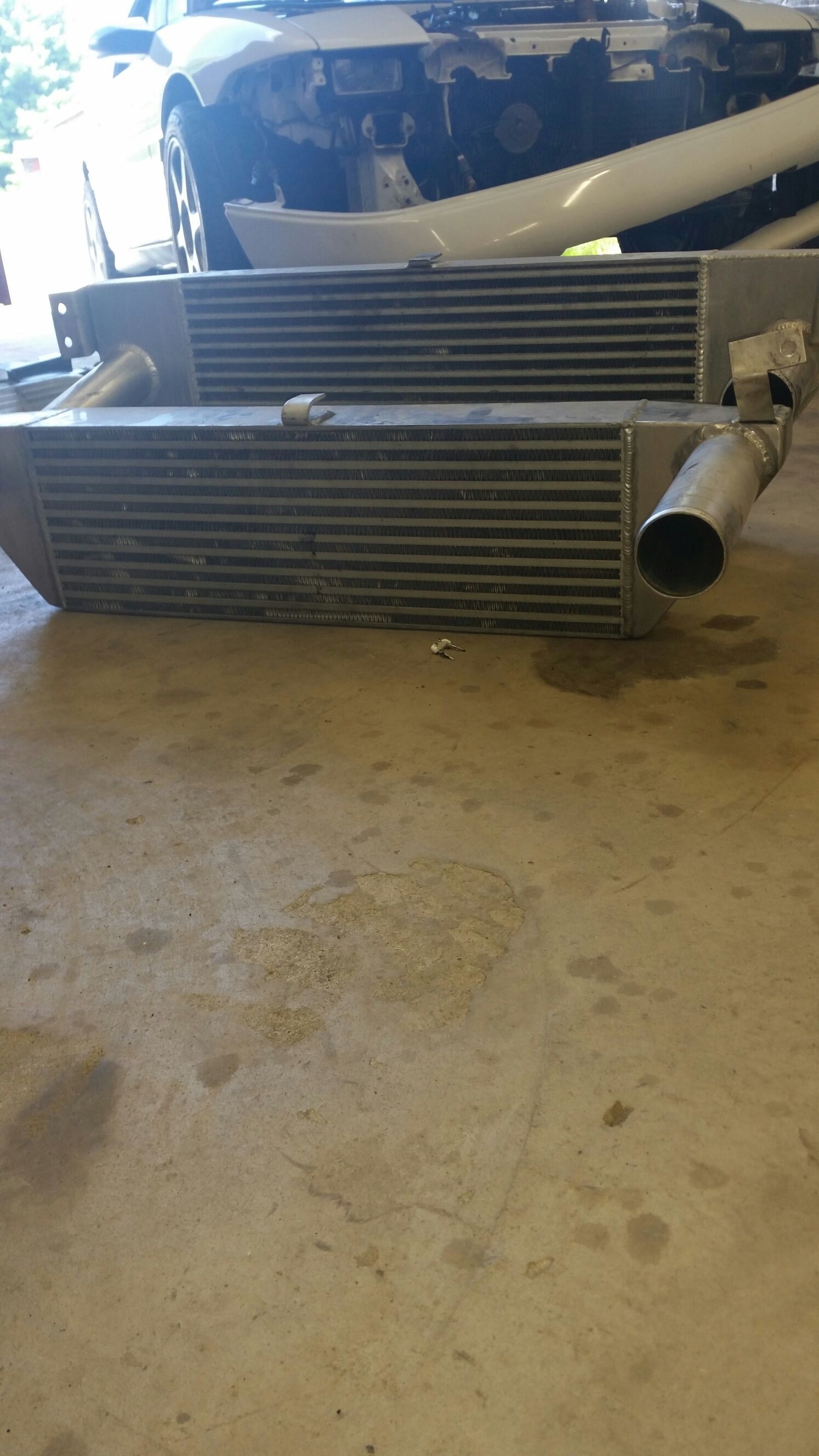

slowboy race core vs vrsf core big difference
[DOUBLEPOST=1413092716][/DOUBLEPOST]
new core installed
Looking good so far. Love the attention to detail, keep up the good work.
Also, I might be seeing things, but that extender arm on the jay kit looks half the length of all three kits I have, 2 for my 1g 1 aluminum 1 steel and the other is a 2g kit. Or is it just the picture?

Awesome Build! If you don't mind me asking, what brand intercooler piping are you running? Or is it custom?
the intercooler piping is all 2.5 inch custom. im working on making the chasis lite weight . curently the chasis weights 2660 pounds on the local weight station.i try to do a clean gut job if it makes sense.. if i remove it . i try to paint it and make it look good when im done
i took out
bumpers front and rear
evrything from seats back including wires and and boxes.
light weight controll arms
bulfabs front and rear kmember bars
everything underndash
rear wiper motor
evreything in hatch
exhaust heat shields gas tank heat shields
all sounds deaden material in car. fire wall blanket
ac power sterring gone..maybe some more
im curently working on light weight hatch and doors.. but i rele clean job. lexan rear window. and removing crash beams in door.. trying to get car to bout 2450 2500 pounds...

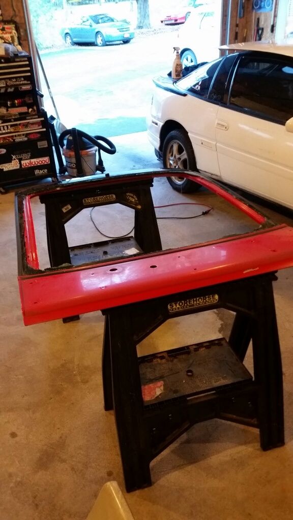

here is a hatch that i pickup from my friend kyle removed window. and all the hatch bullshit. literaly weigth 20 pounds.. going to paint it and do a lexan rear window

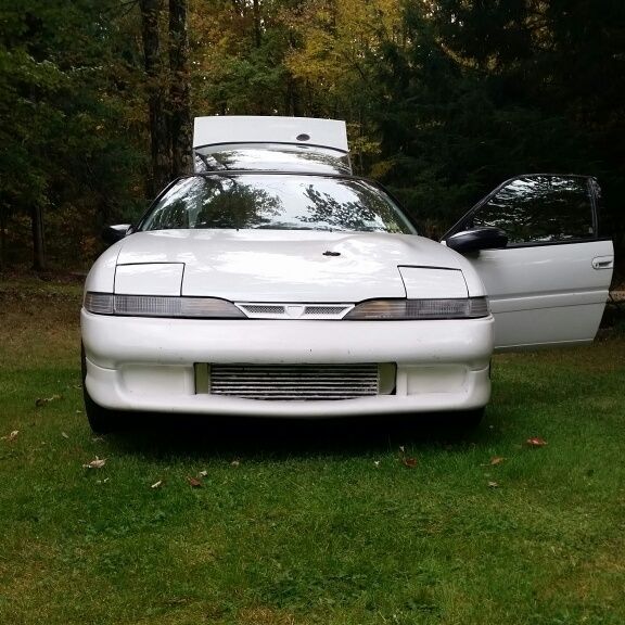

made some custom bumper covers and painted them white

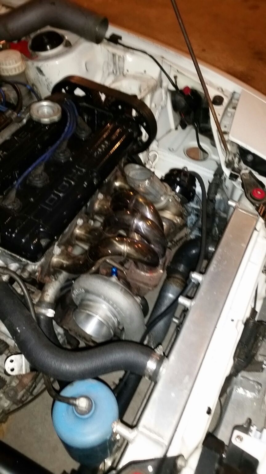

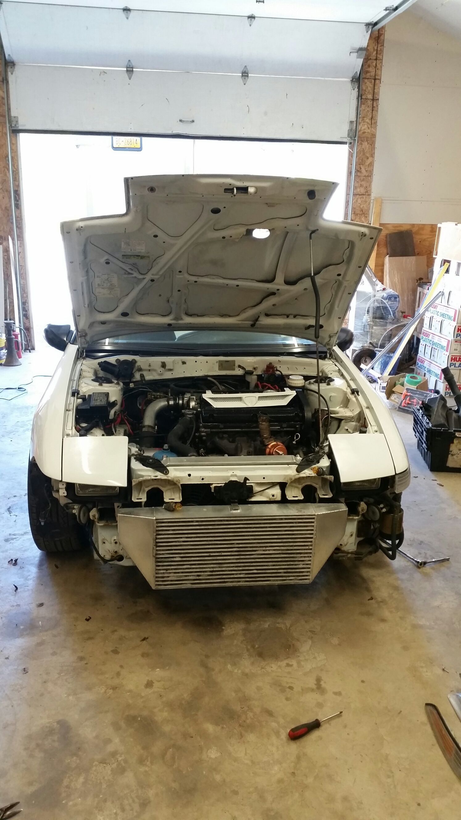

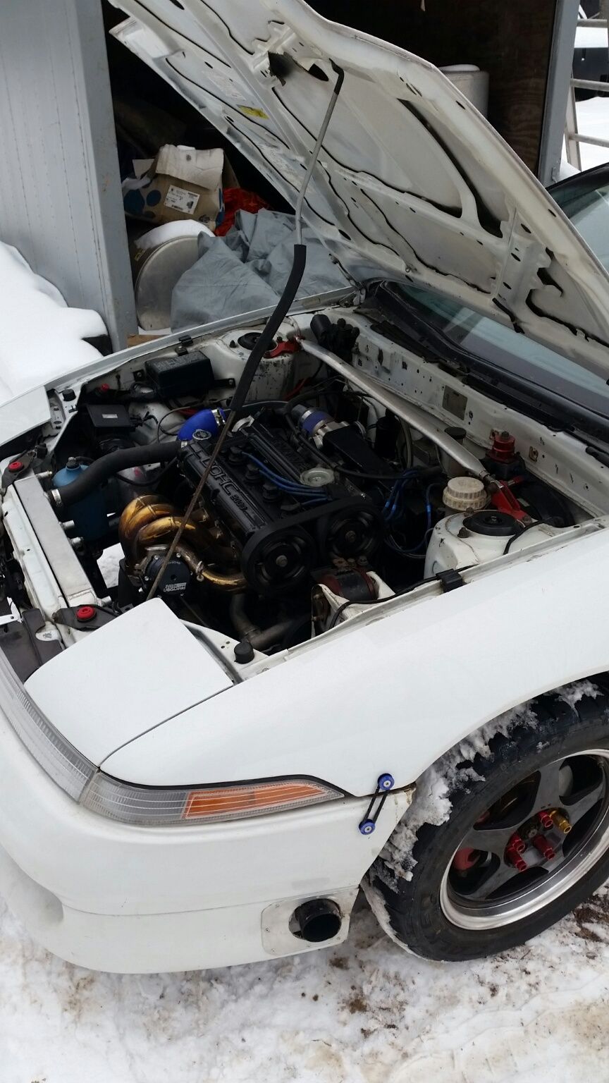

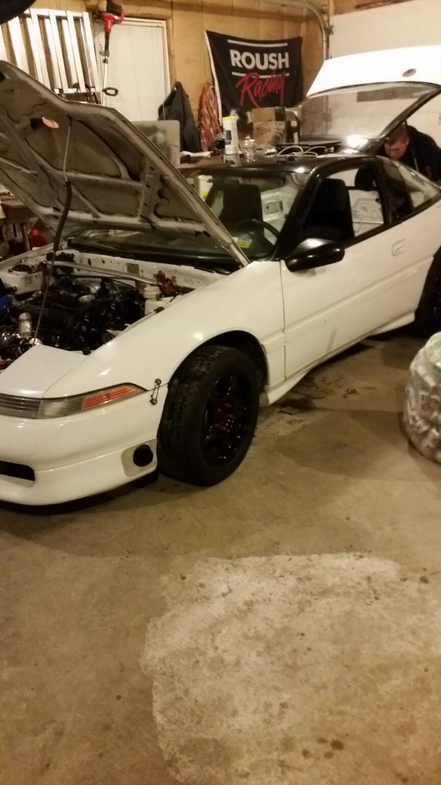

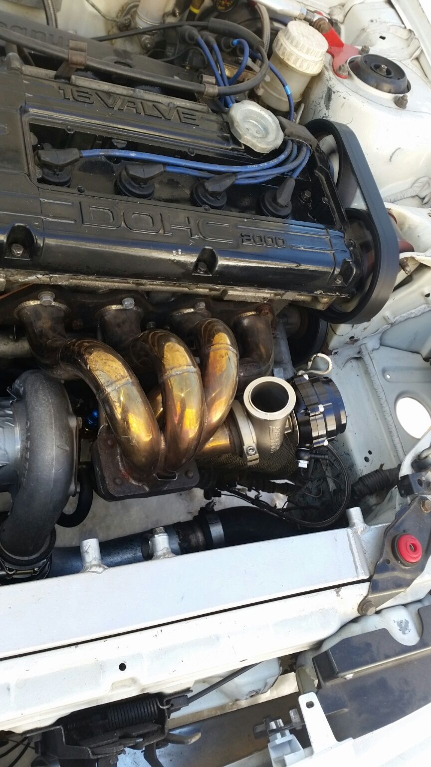

here it is guys the start of 2015 race season.. 10.50 index car.. car was converted to e85..
liste do of new mods

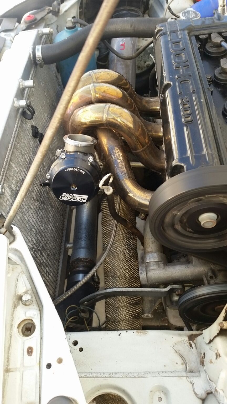

gt358r dbb
dnp t3 manifold
prescion 46mm wastegate
3 inch upper intercooler piping
eclink sd kit with aem 5 bar map
rx7 fd wheels with 225 50 r 16 tires " wide"
custom side exhaust
more weight reduction

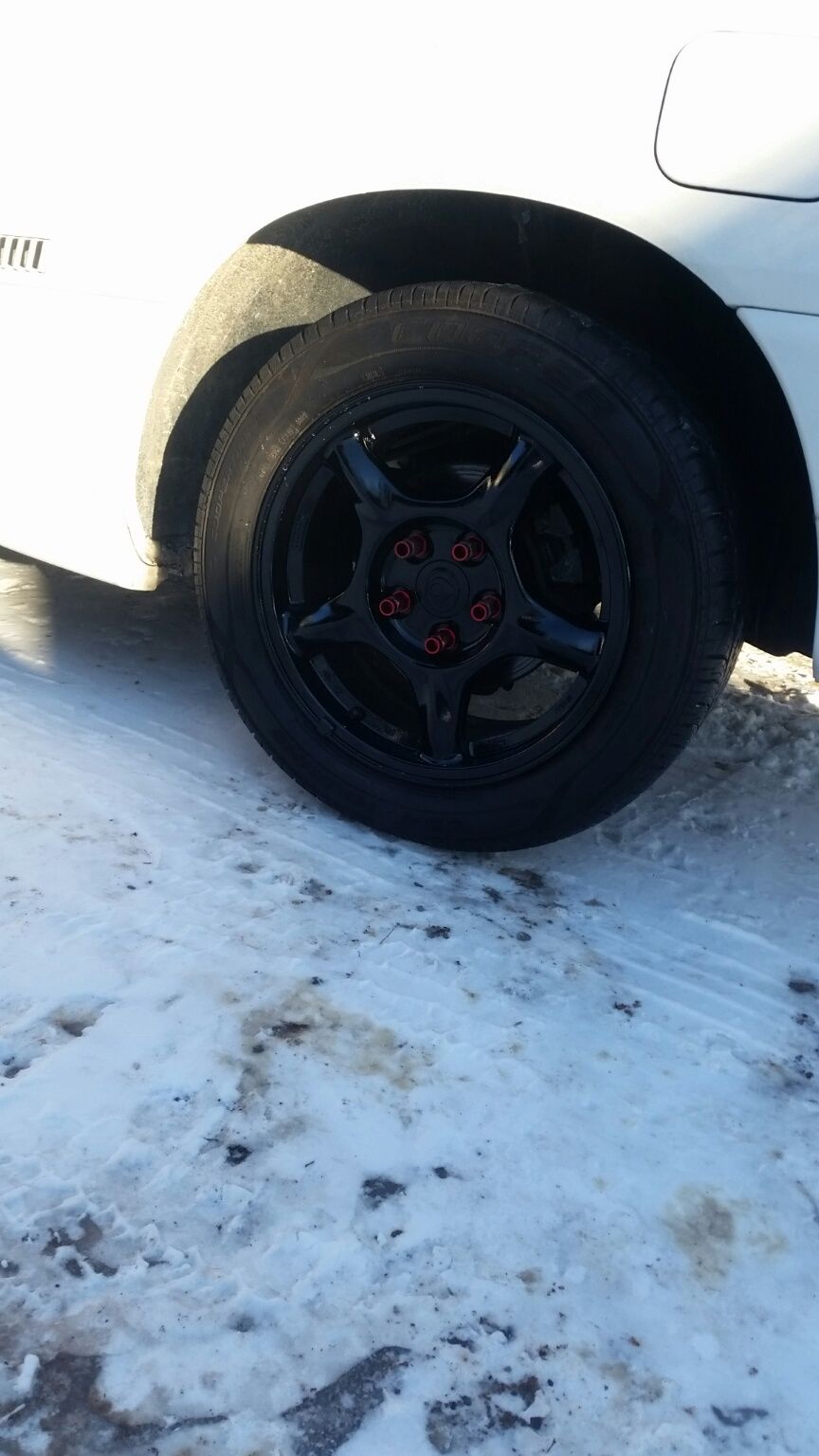

here is wher ei had rota slips.. didnt like the look fd wheels all the way
looks wayyyyyyy better with rx7 wheels now need to paintblack

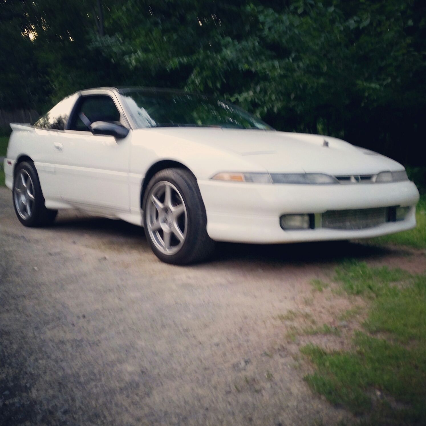

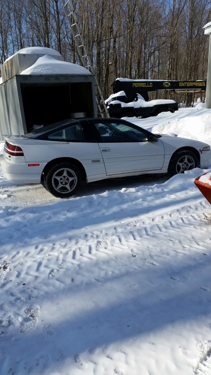

and here she stands as today.. looking to buy coilover and lower bout an inch and half..
me and kxfreak " kyles new car!!!

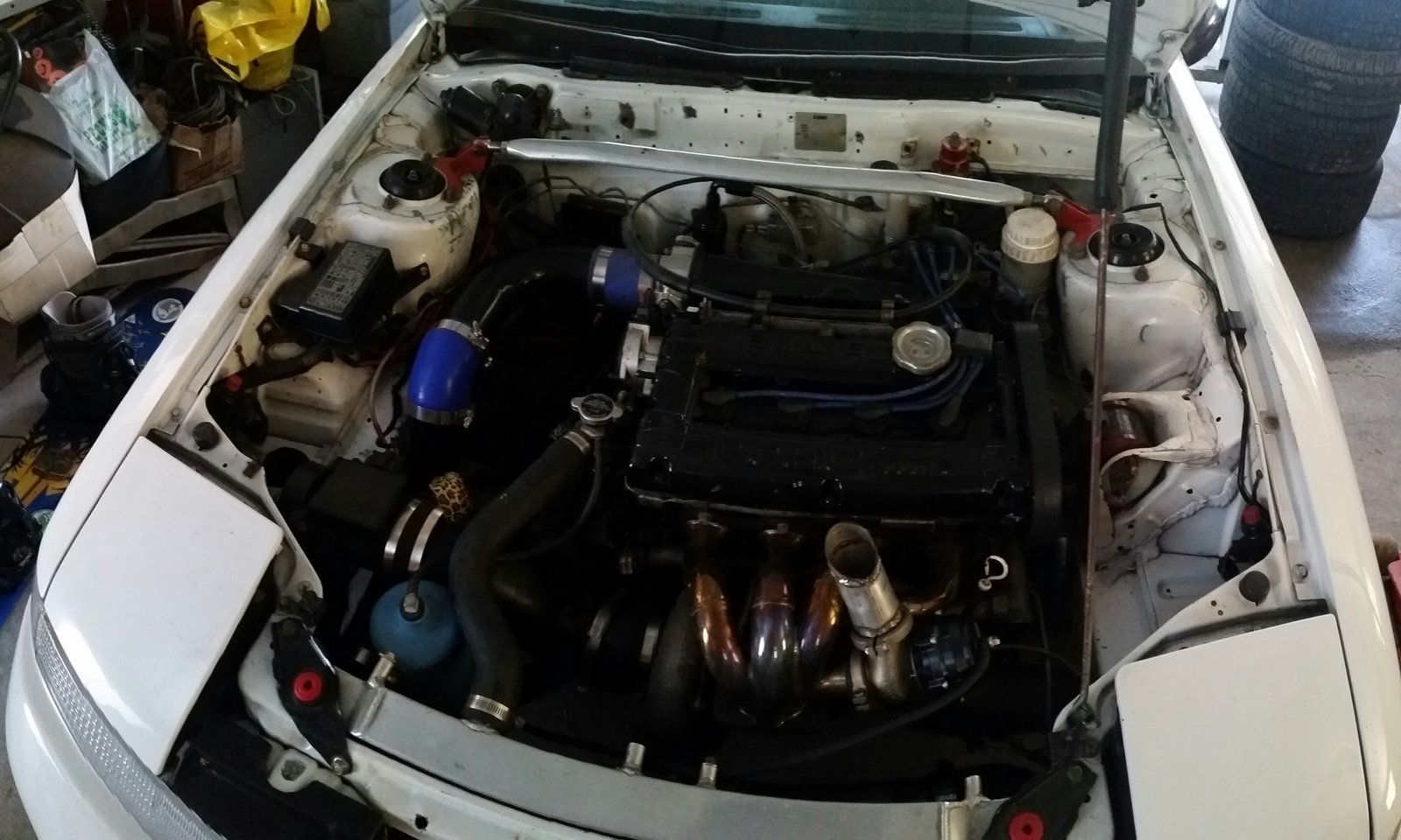

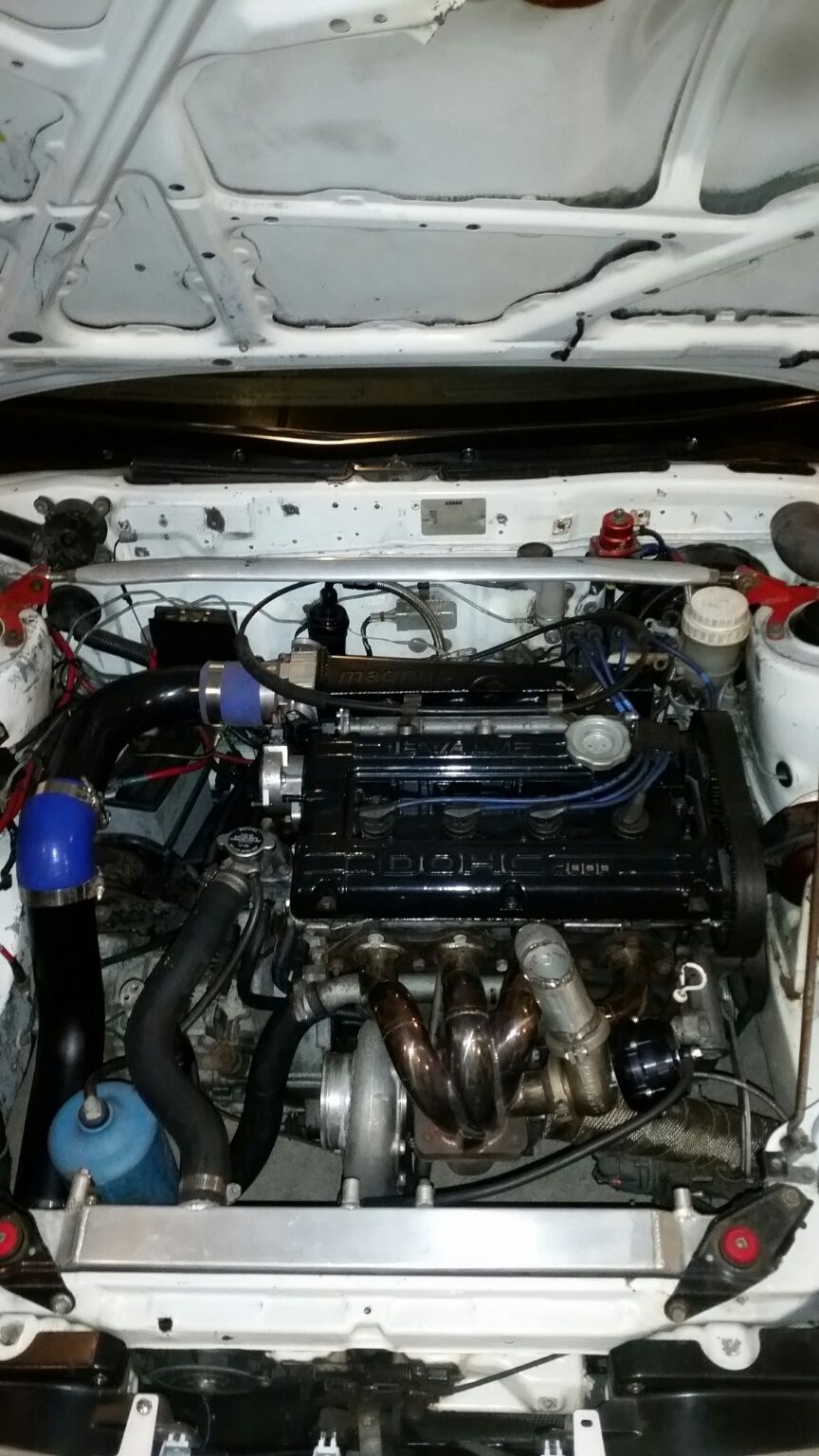

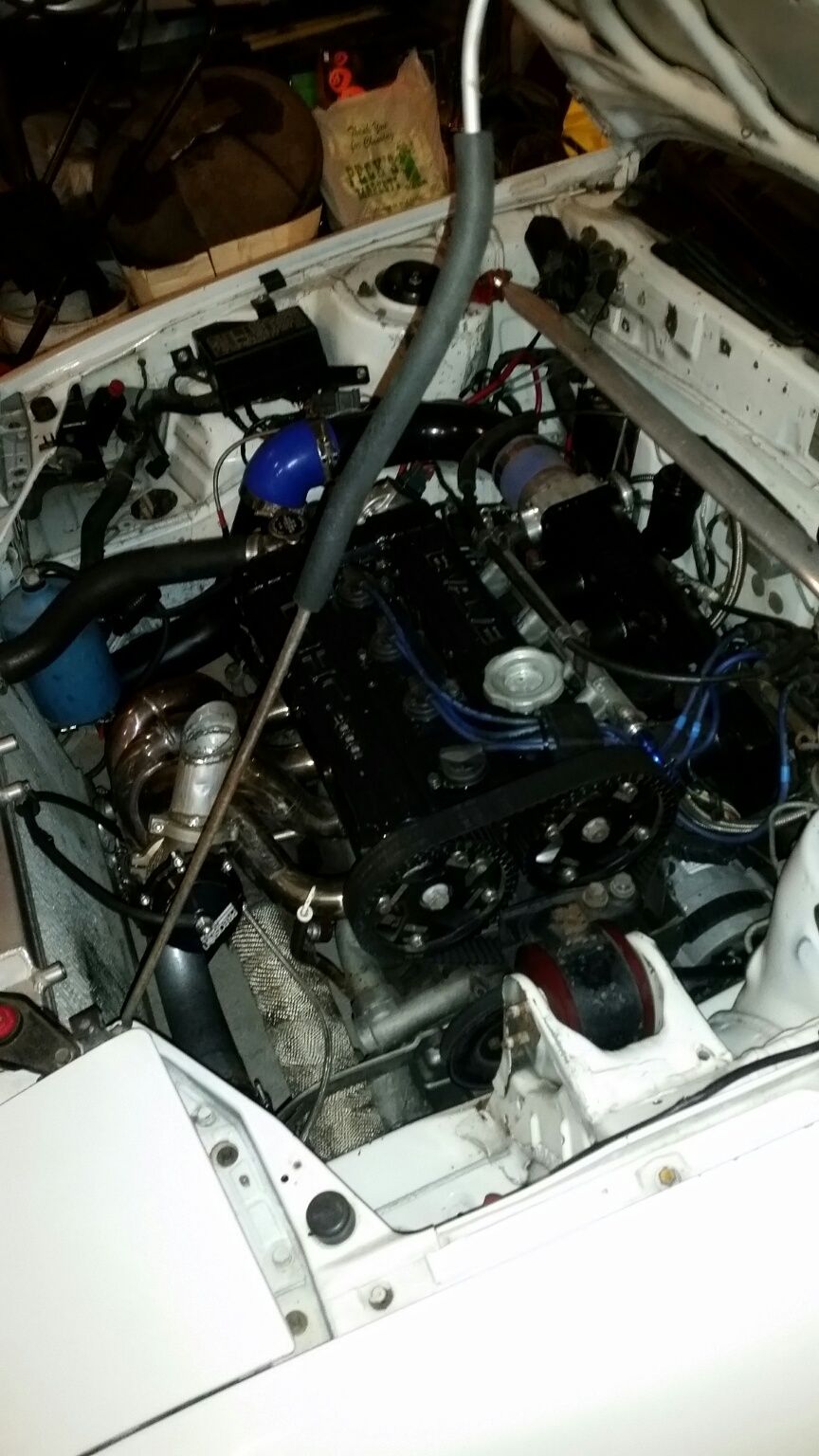

engine bay
soon the car will be getting my tial 50mm bov welded on as well as my gm iat. convert to speed density and off to drew j tunning in rome for a tune... also wanna get coilovers and lower my car a little.. i dont like moster truck status LOL..more updates soon
