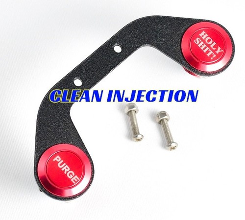

Link to push button shifter on my steering wheel. I really like it! It is easy to push and allows me to keep both hands on the wheel.
I got them on Ebay, but it looks like the company no longer makes them on a bracket like I got. Clean Injection was the company.
I do. Differently better then letting go of the steering wheel all the time. Thanks for the idea Marty. You have been a great source of info since i got back into DSM's. Cant thank you enough.

UPDATE: The push buttons that I used are back on the market. If you get ahold of them, they can laser etch whatever you want on the button, just not alot of room.
