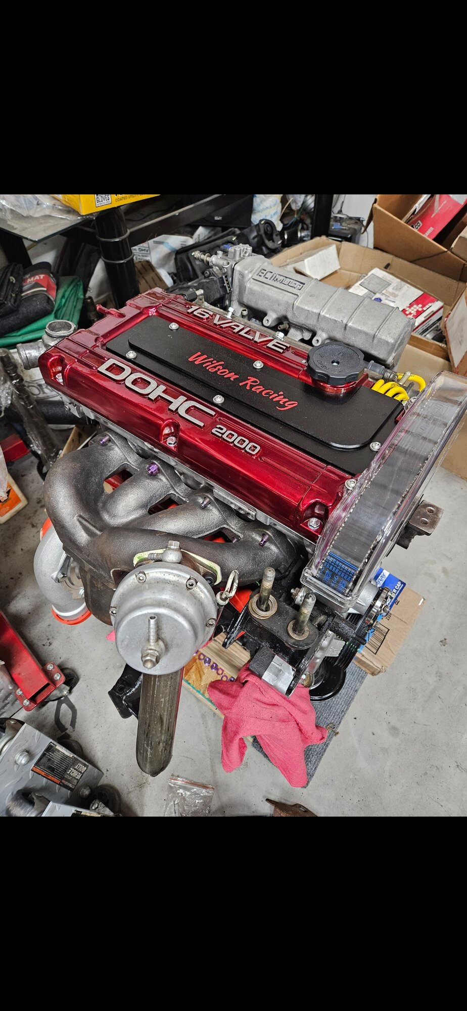

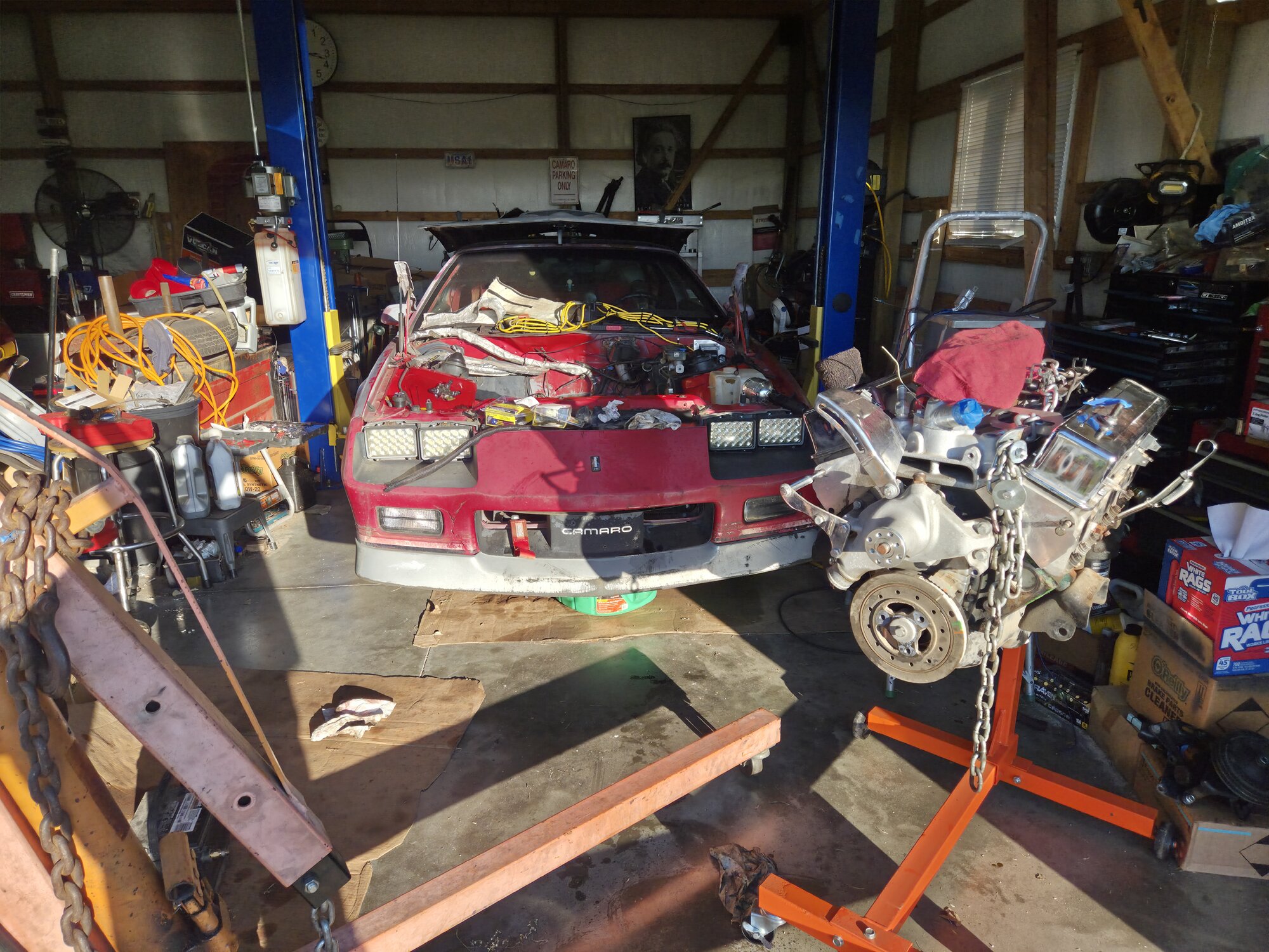

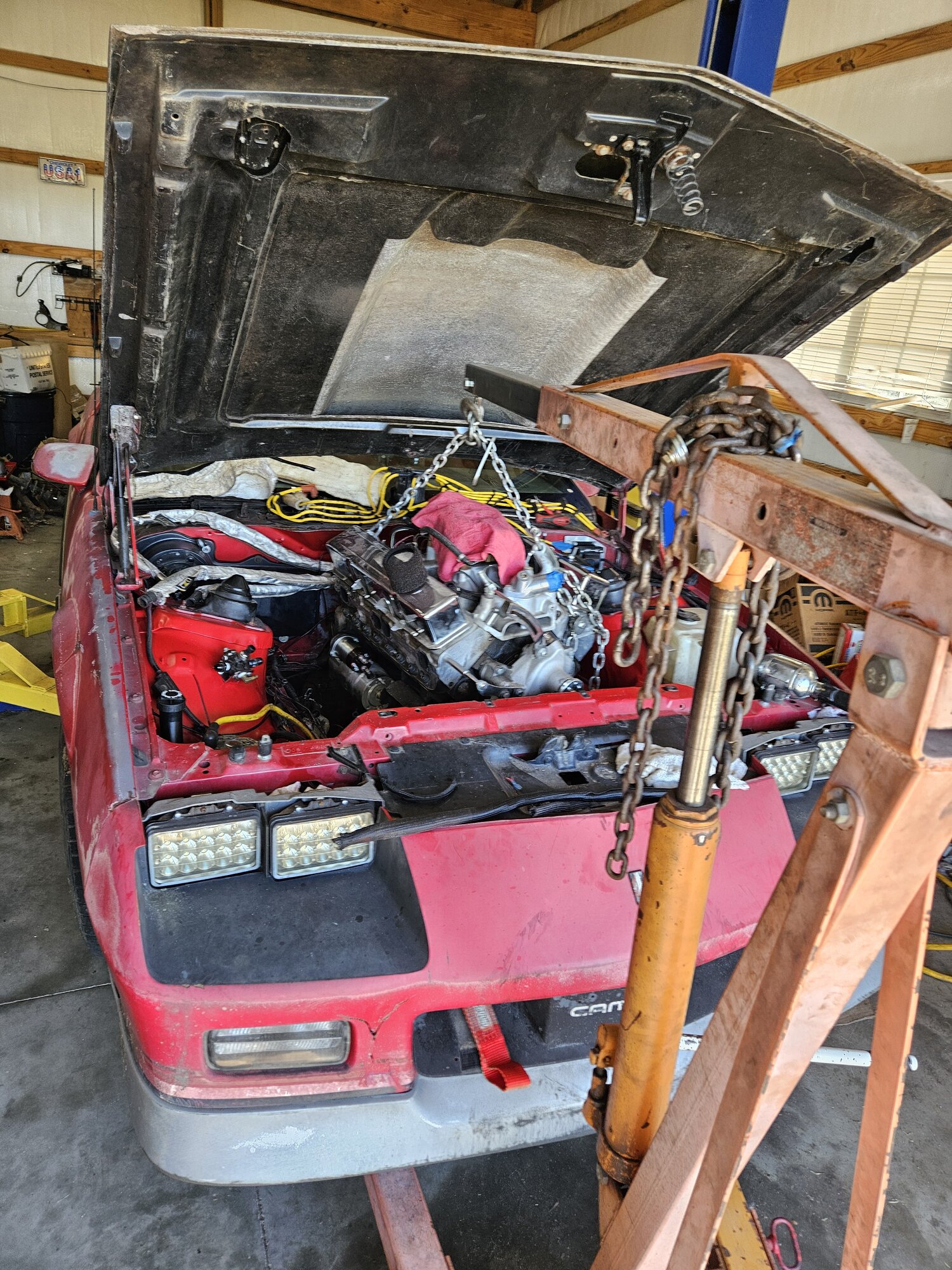

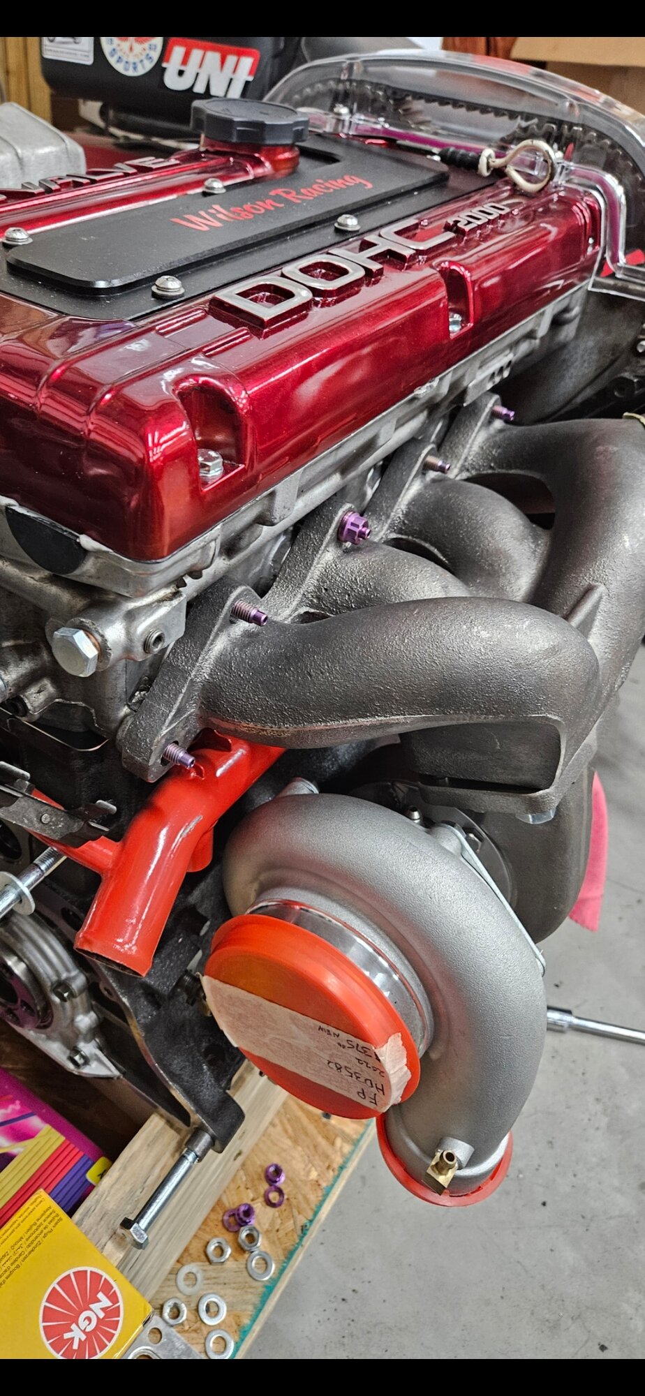

Well here is the latest of the "herd", a 1992 "racecar". It has been started, it's up to someone to finish it. Instead of going to a HAM Radio swap meet, I went to Topeka KS to pick up this "Gem". It's rough & missing parts.

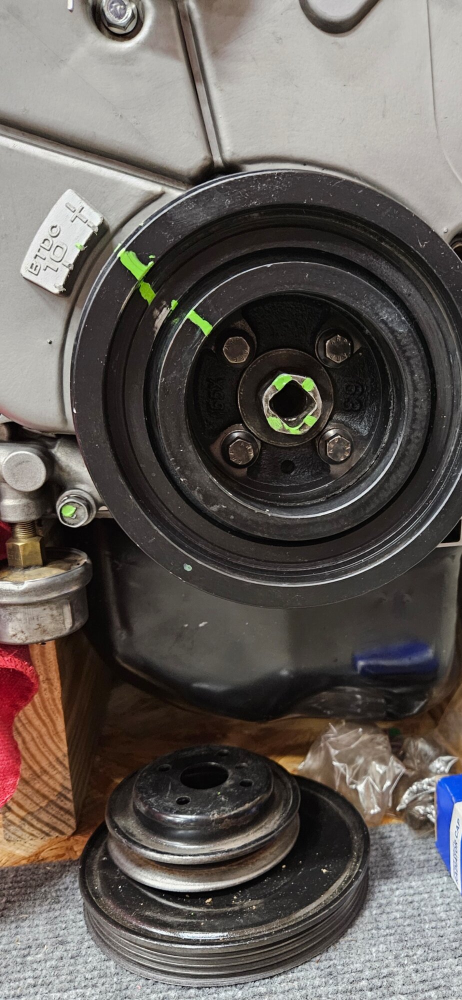

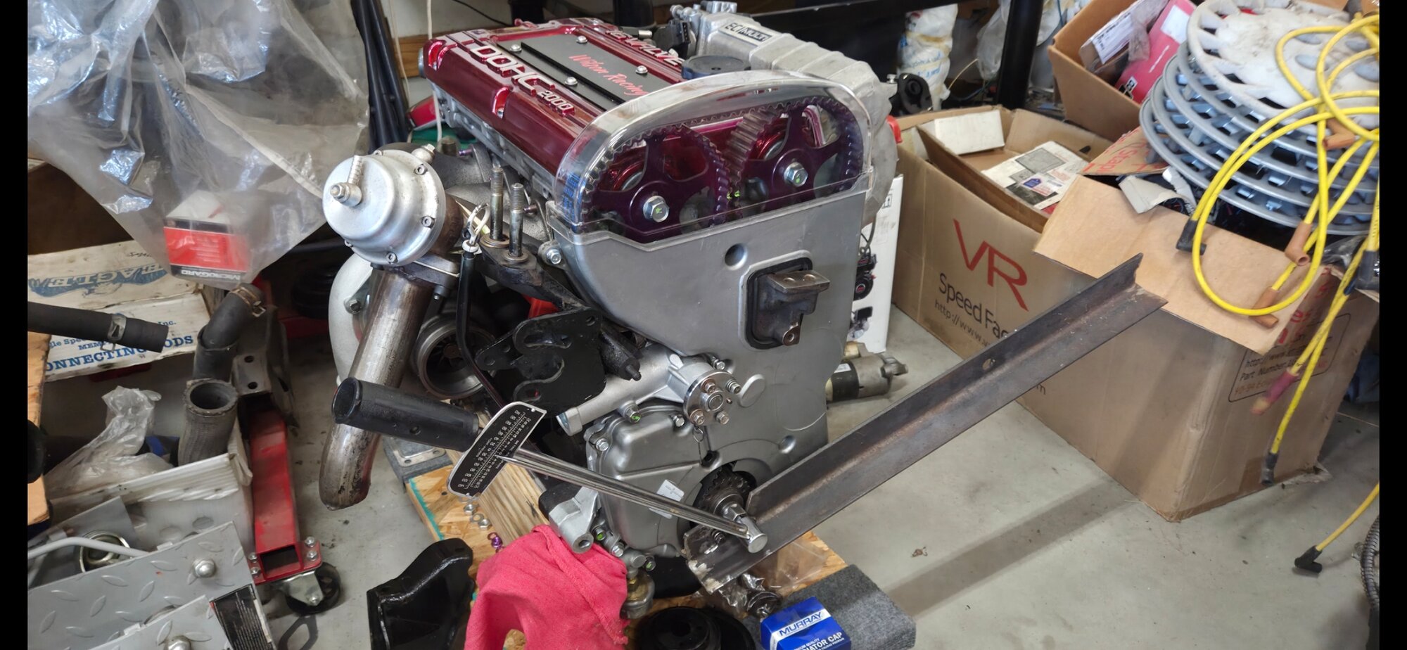

Timing gear locked down at 100 ft/lbs and Orange Locktite. I made the holding tool a few years back when my son and I put a different set of gears in his rear dif on his 86 Z28 and needed to hold the pinion flange while crushing the crush sleeve so I put one extra bolt hole in the tool and it doubles as a 4g63 crank holding tool. 👍

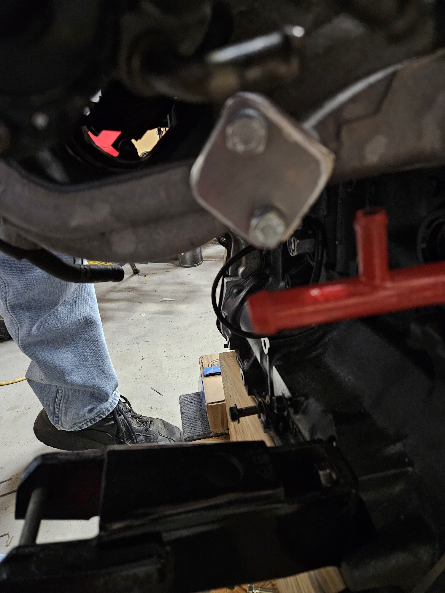

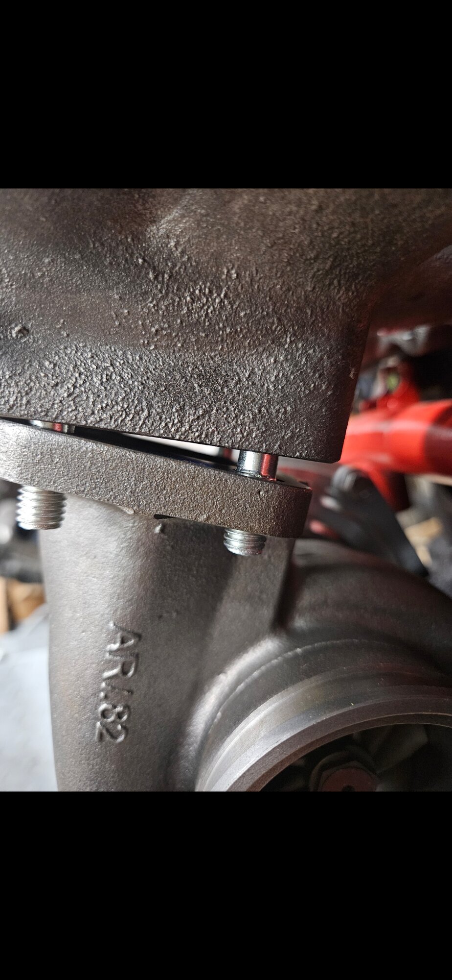

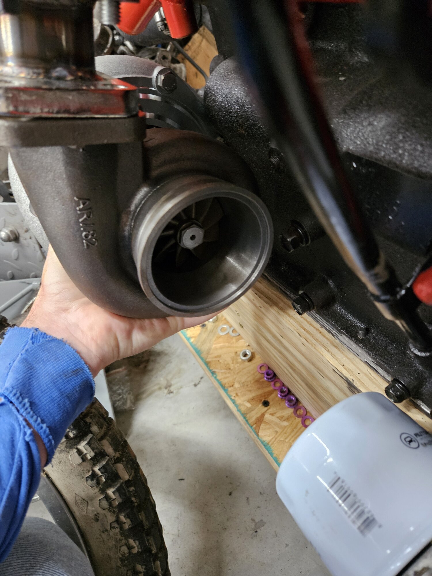

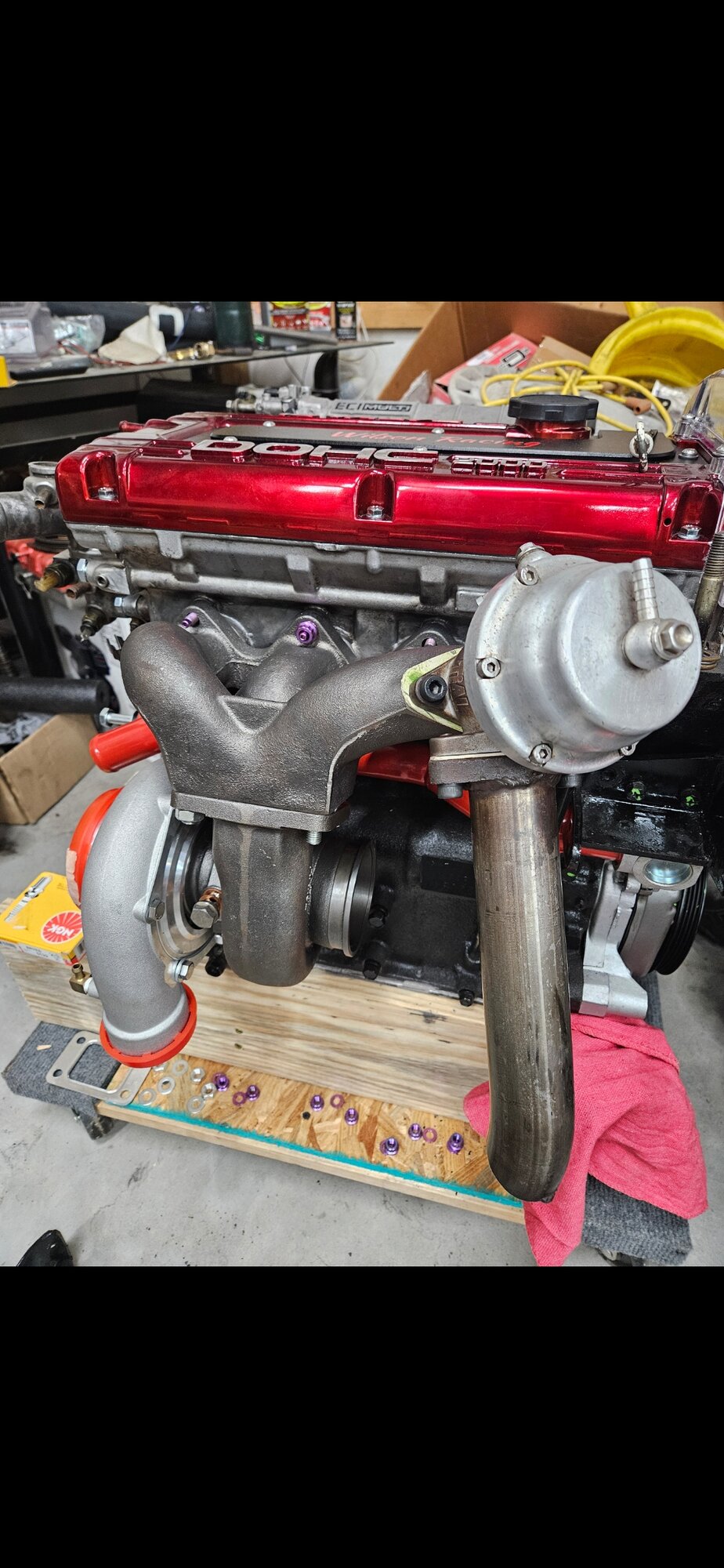

I am watching the classifieds for a T3 Manifold since I have block to turbo interference. 😕 I also remarked the correct TDC mark on the balancer.
