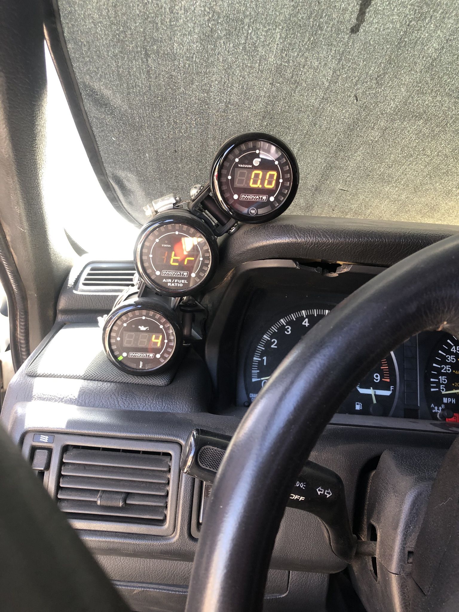

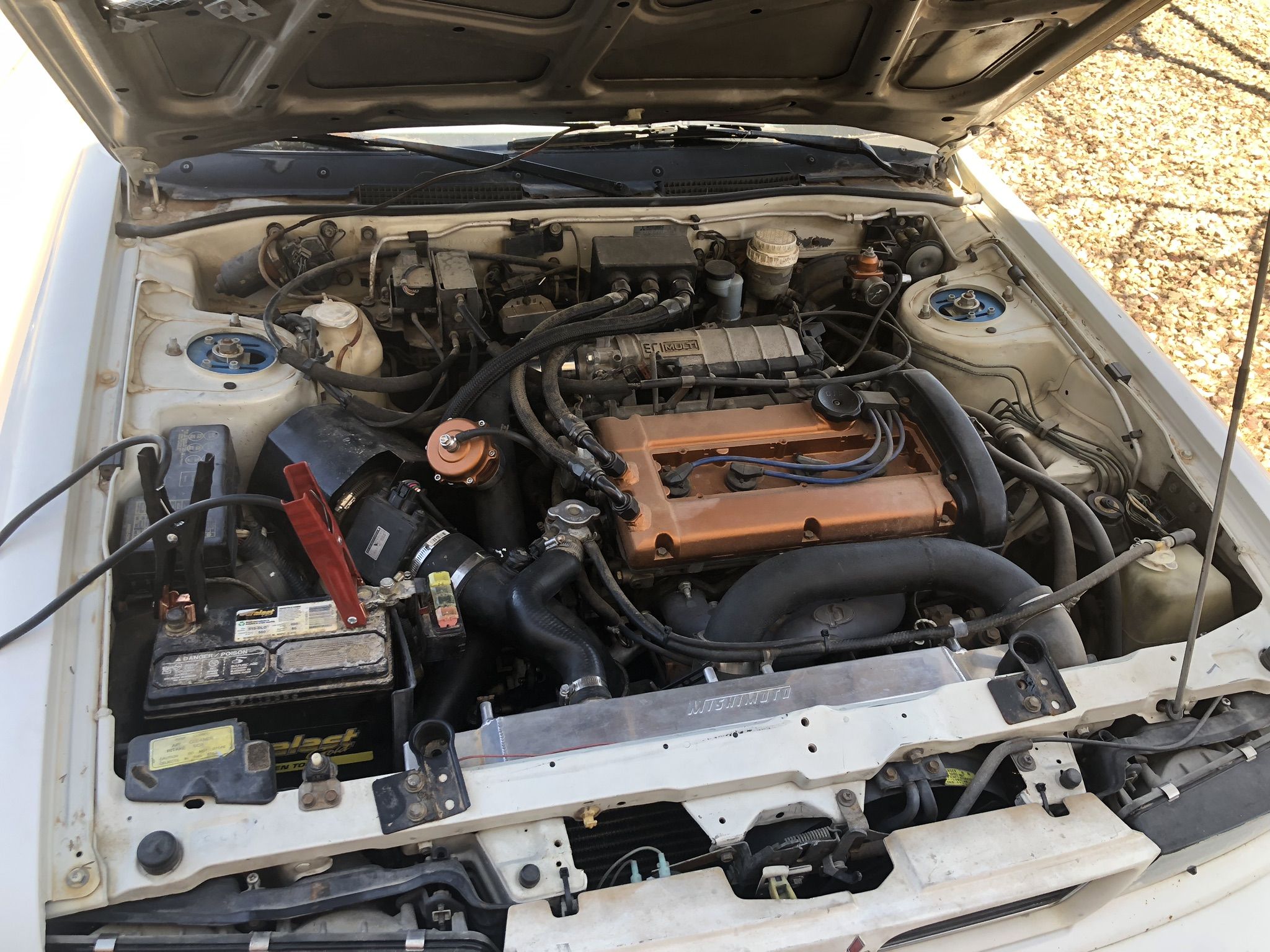

Mods currently are an FP red, FP manifold, ETS 1g street core with Tial BOV/38mm Wastegate. It has an old school buschur turbo back, 2150FIC's. Suspension is a set of modified evo 8 JIC coilovers, staggered 17x7.5/8 FN01RC's, 5 lug swap and stoptech pads. It's tuned on an evo 8 ECU with dual function Innovate gauges.

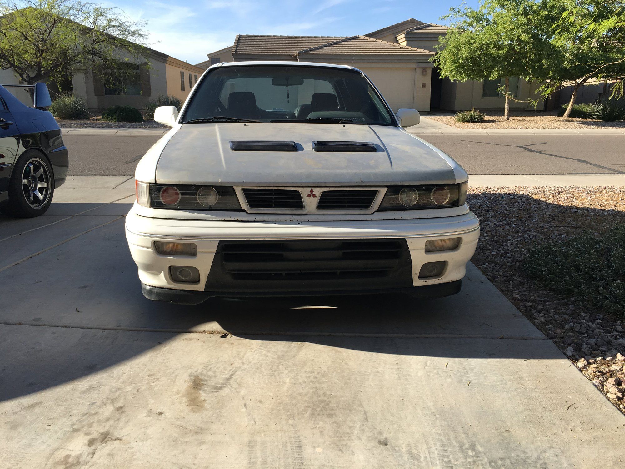

The headlights on the car have always been pretty poor. I've been lucky enough to find a couple of sets of rare crystal 93 model headlights but the light output was still fairly poor for my liking. I decided to tackle a set of projects into one of my sets and I was completely satisfied with the results. I added demon eyes just to try my luck at it. I rarely have them on other than to show them to people.

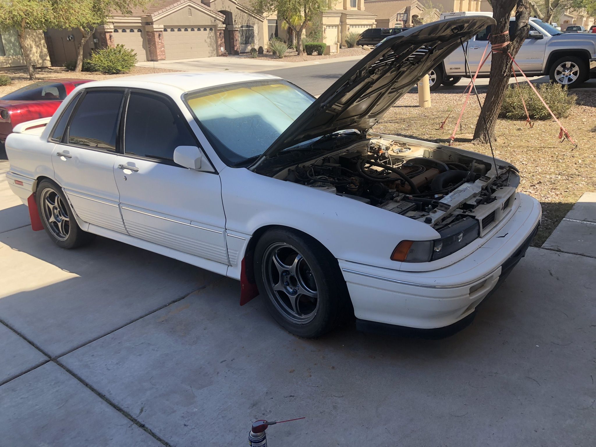

I put a 16g on at 190k to replace the wore out 14b but the itch for more power in the daily was there. I decided to pick up a (now orange) FP red. It came with a punishment o2 housing with a tial wastegate. I grabbed an ETS 1g street core and had a buddy build some intercooler piping. This car still has AC and I run a full size X-line 1g radiator. It was a challenge putting a back door intercooler on the car with AC and full size radiator, but it worked out well and I still have ample room to work. At 200k after installing the evo ecu and turning on launch control/NLTS the original clutch's life was cut short during a 2-3 NLTS which bent the 2-3 shift fork. I installed a v-drive QM twin to get me to MOD that year and just dealt with the shift fork. I finally had time to pull the trans apart and it's currently sitting on a work bench waiting on build parts. I have gear drive discs to convert from the v-drive that will go back in when its done too.

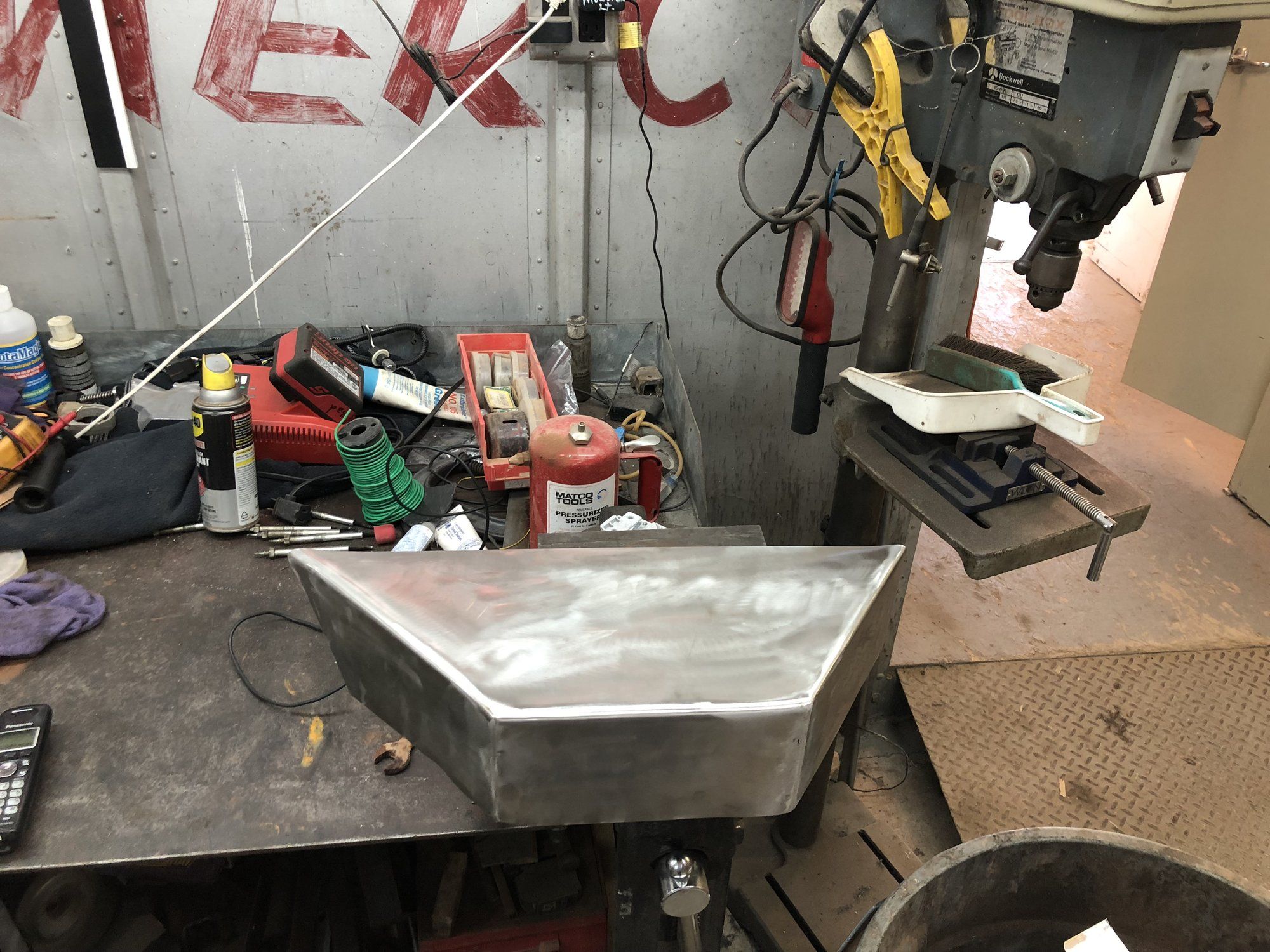

Had some free time at work one day and I have some sheets of stainless. I have an FP manifold blanket but wanted to put a nice heat shield over it. A few hours later I have a heat shield ready to be polished up and bolted on.

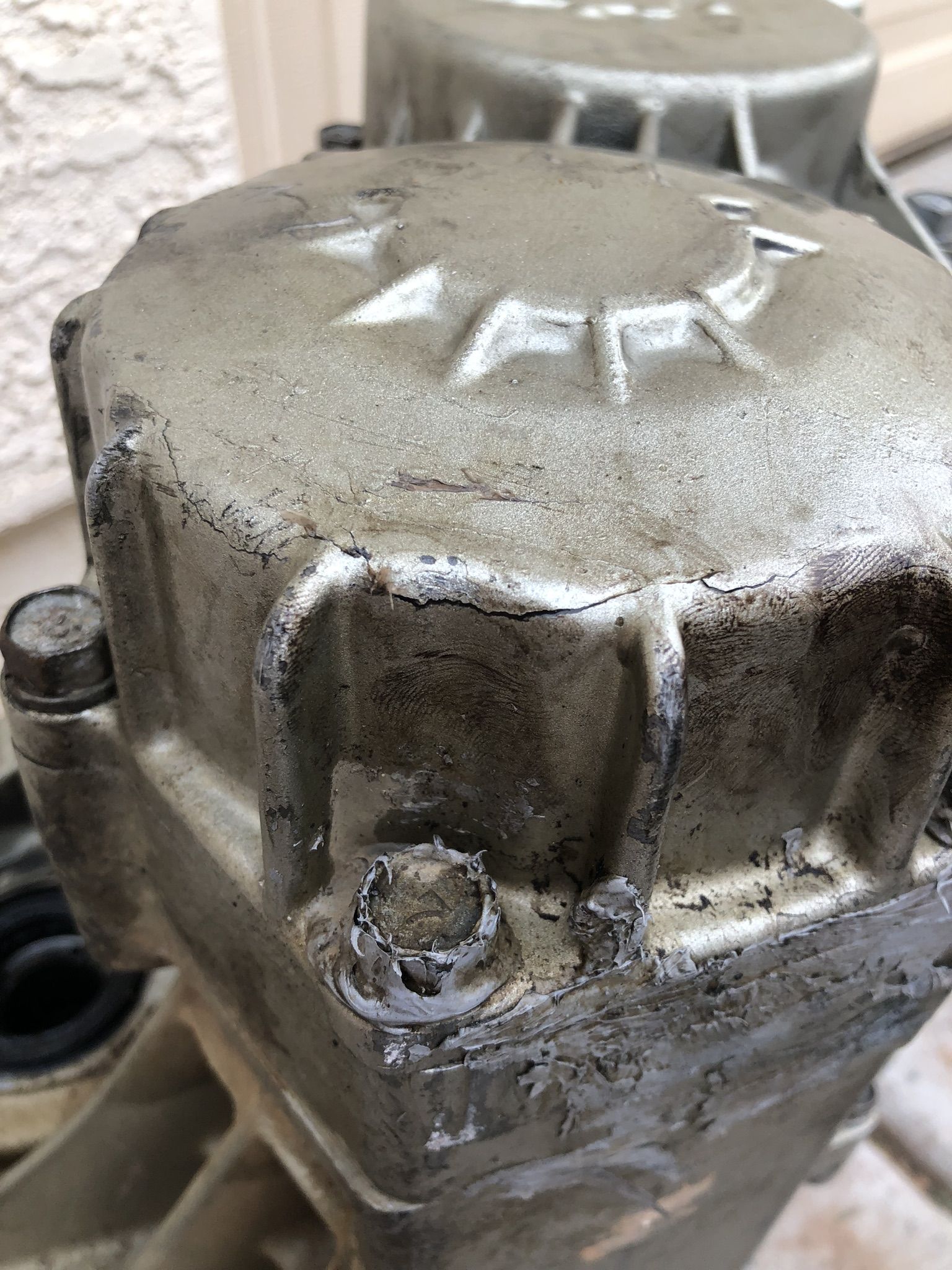

This car has been down for almost a year now, I'm glad to finally have it running again as of this weekend. After having issue after issue dealing with the major trans companies on here, I finally said screw it and purchased a built trans and tcase to put in this car while I decided what to do with my stock trans. I was really skeptical on buying a used built trans as it seemed like everyone was selling a "stage 4" but no one ever had paperwork, no way to verify anything actually done to it, and it was always something they bought second hand- far too much risk for me since I know how dsm owners can be trying to pass off garbage as gold. After passing on countless "built" trans I ended up grabbing a jacks stage 2 with a fresh tcase off a member on here. My biggest requirements were that it A) shifted perfect, and B) didn't have a welded center diff. I was lucky enough to get this one with a 4 spider center in great shape, with paperwork.
I was a little upset to find the package covered in trans oil when it made it to my door. I assumed the worst right away, and while this wasn't a horrible fix, I'm still waiting on Fedex to finish my insurance claim for it. Looked like they dropped it on the end case and cracked the whole end case. I picked up a new end case and swapped it on and put it in this weekend.

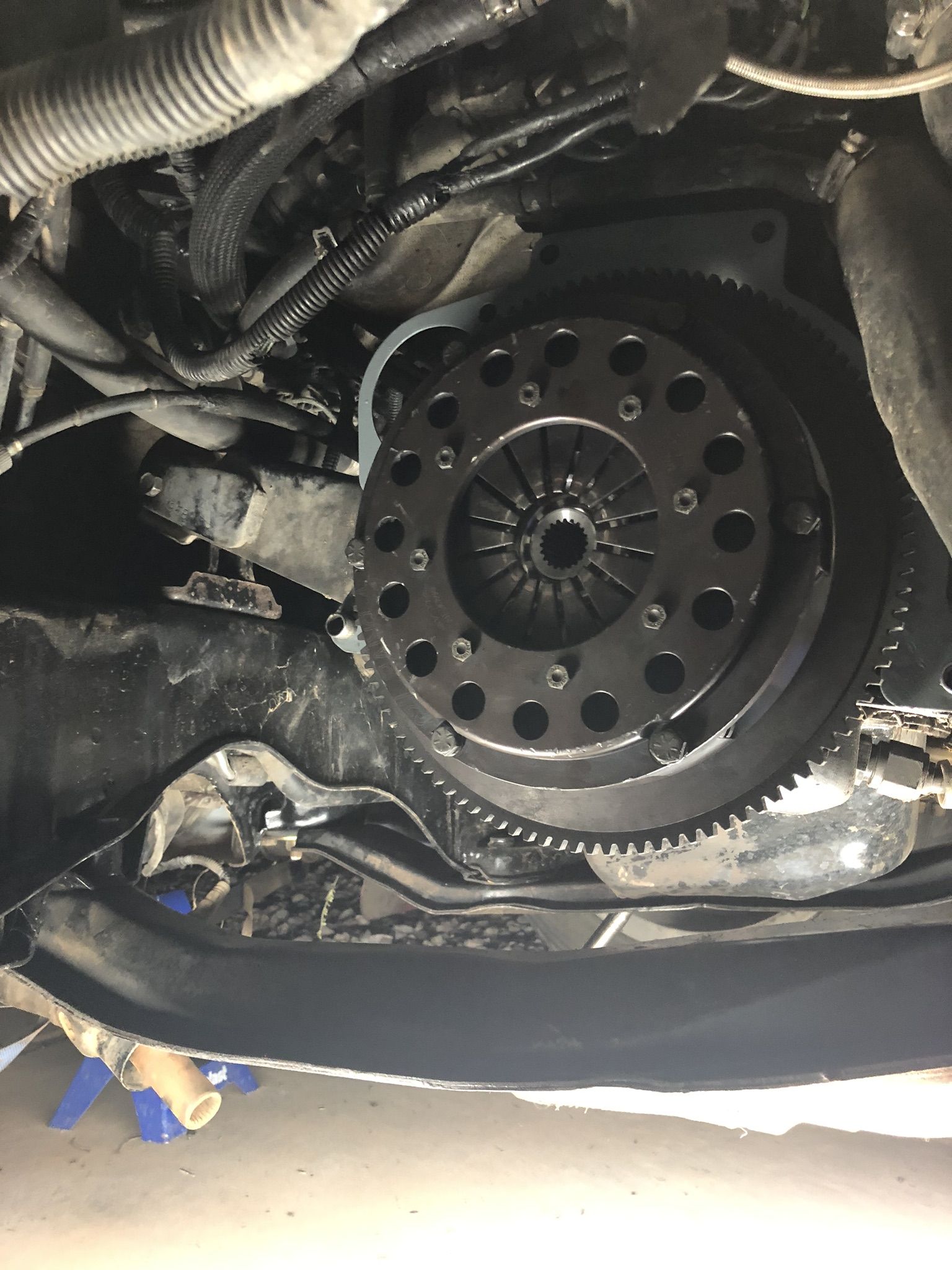

One of my good friends/customers knew I was having issues with my v-drive clutches on my twin disc and was awesome enough to get me a set of gear drive discs to upgrade my twin disc for christmas 2 years ago. Finally got to try them out after waiting all this time! I bought this clutch second hand with supposedly 50 miles on it, in typical dsm fashion it wasn't as described, but I got it cheap enough that I just ate the cost and dealt with it. Flywheel resurface, 2 new gear drive discs, and I'm ready to rock again.
This thing is still annoyingly loud, but its way better than it was with the v-drive. I have an exedy in my evo that's super quiet in comparison, and every other car i've installed one of these in has had a loud exhaust. For a daily with a quieter exhaust it can be annoying. Part of my quest for a good daily again was to remove the poly mounts I installed the last time I had the trans out. 3 fresh stock rubber mounts and this has become 10x better to drive.

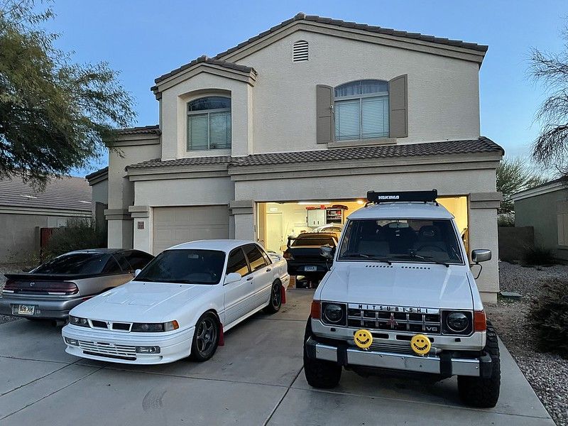

I forgot to mention I picked up a C5 super cheap to use as another nice daily. Getting back into the galant was quite the change going from a torquey v8 to a 210k 6 bolt stock bottom end car. I've been road coursing the vette and I can't wait to compare how the galant does compared to it. They're 2 very different chassis that you have to drive very differently, so it should be fun. I just got done doing poly bushings, wheels, and a nitrous kit on the vette, so we'll see how they compare.

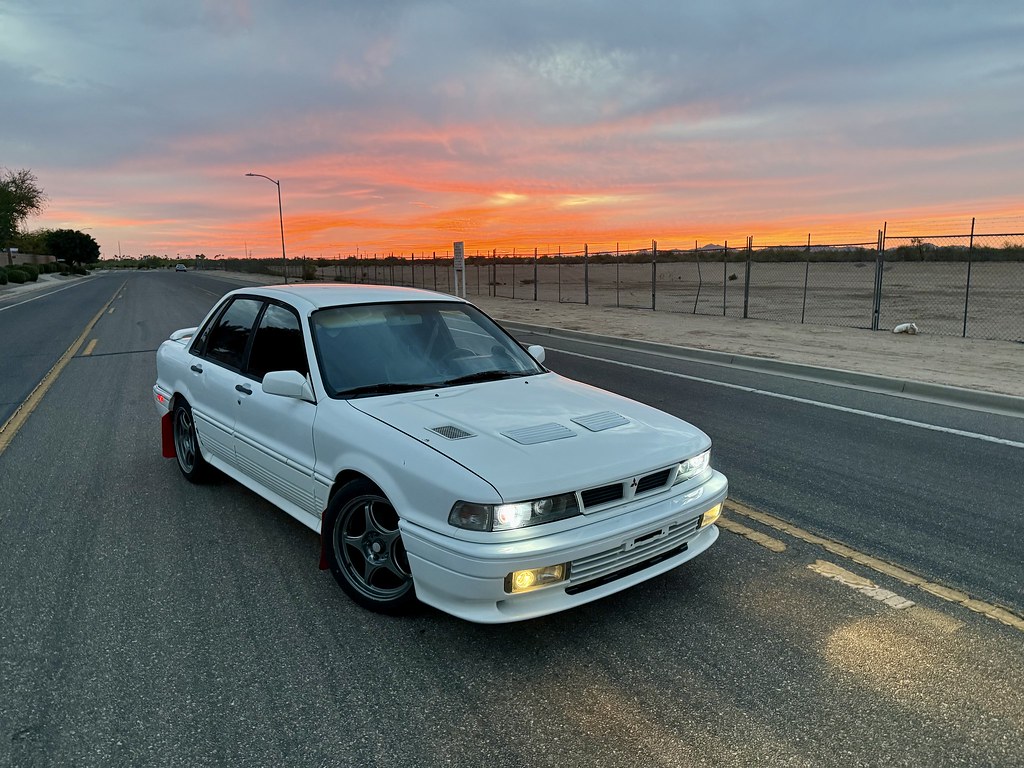

My favorite picture I have of this car, while out dialing in the DBW we had a crazy sunset in the background. I wish the car was clean for the picture but it still turned out great.
