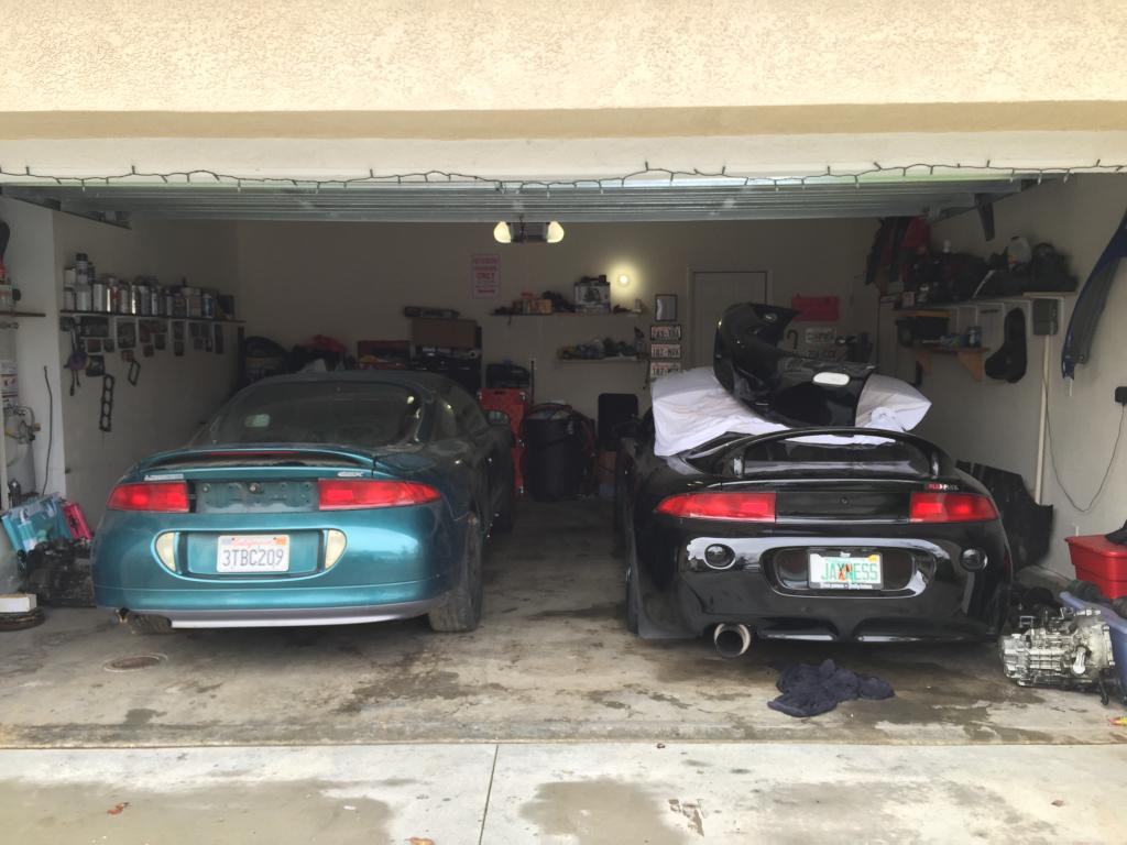

Anyways... I found an AWD donor shell! Its complete (no engine), all I need is an AWD flywheel and to cut my existing GReddy exhaust to work.
I work 60 hours a week and I had surgery lately, so thats been slowing me down. Its coming along veeeeeery slowly.

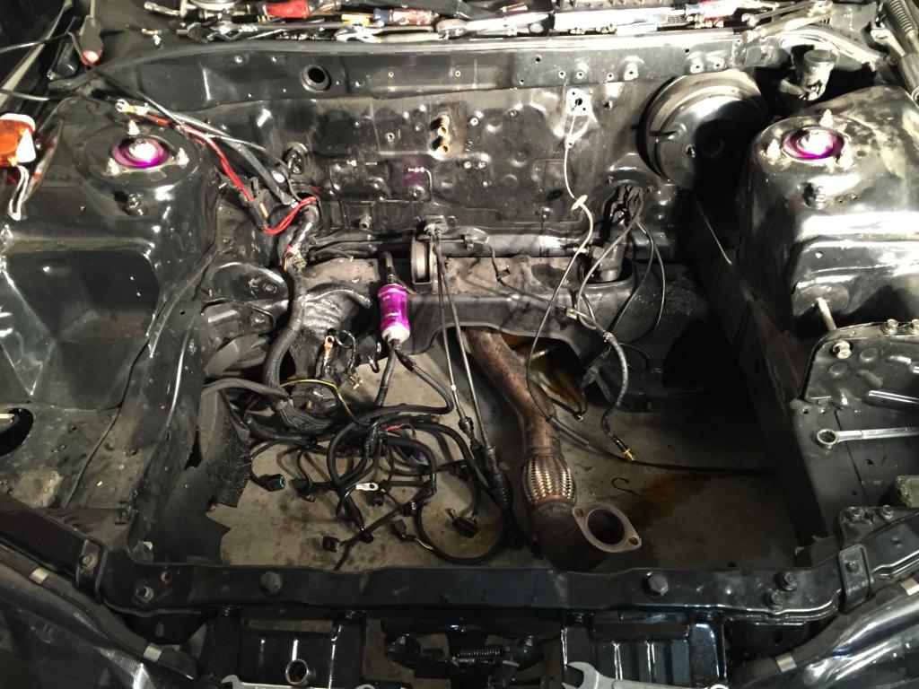

Pulled the engine in my car to prepare the block for a new 2.3l bottom end

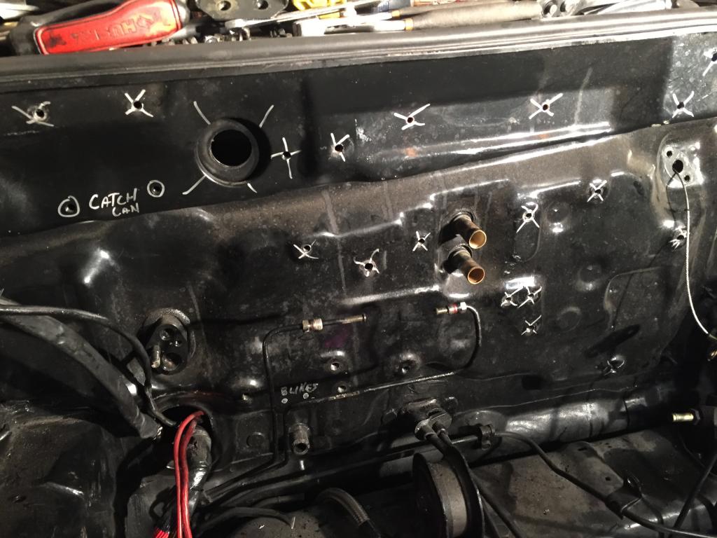

And to start shaving the bay...

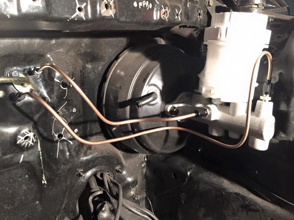

With a 3g BMC and brake line tuck behind the firewall

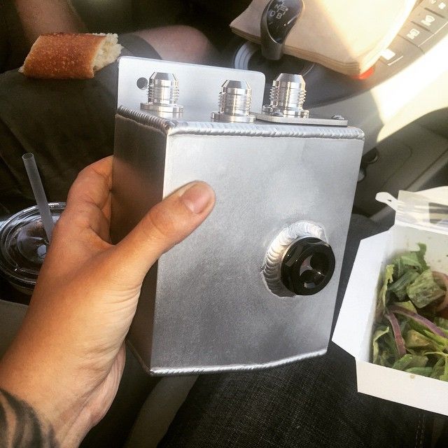

And I finally picked up a Calan catch can! :)

The brake line tuck is interesting, not sure if I have seen it done behind the firewall or not.

Ive seen the brake line tuck on other cars, and I like how clean it looks. I didn't want to paint over them, it seems very half-assed. If I took them off to paint, I might as well move them completely out of the way, haha.

What did you use to build the brake lines, any write-ups/videos you watched first or any advice? I'm installing a staging brake and I'd like to use hard lines but I've never built them...
What color are you going to powder coat that Calan catch can?
I found this video helpful, it tells you a couple different options when it comes to technique.
Im going to leave the catch can bare silver. Ive got enough pink & purple in my bay, Id like to leave some things silver as a contrast.

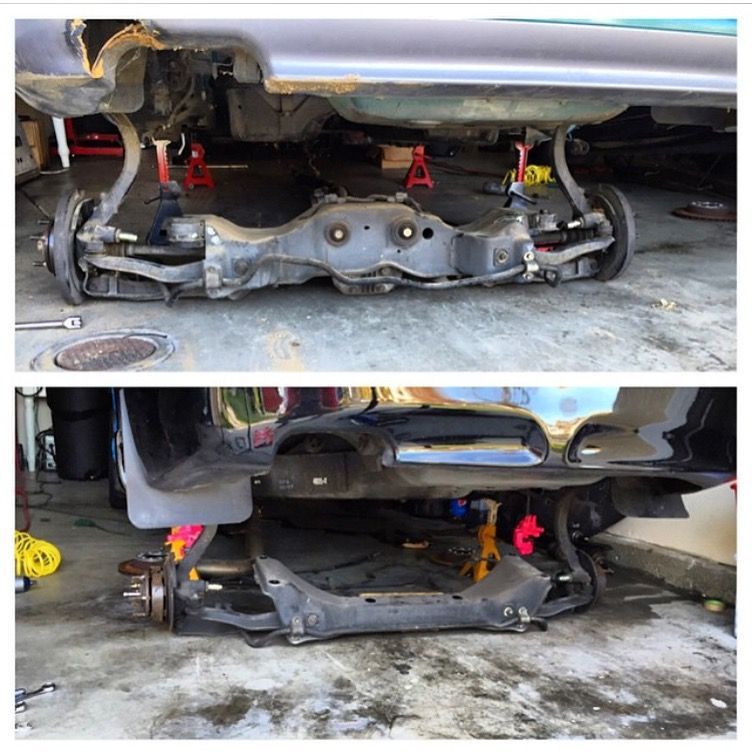

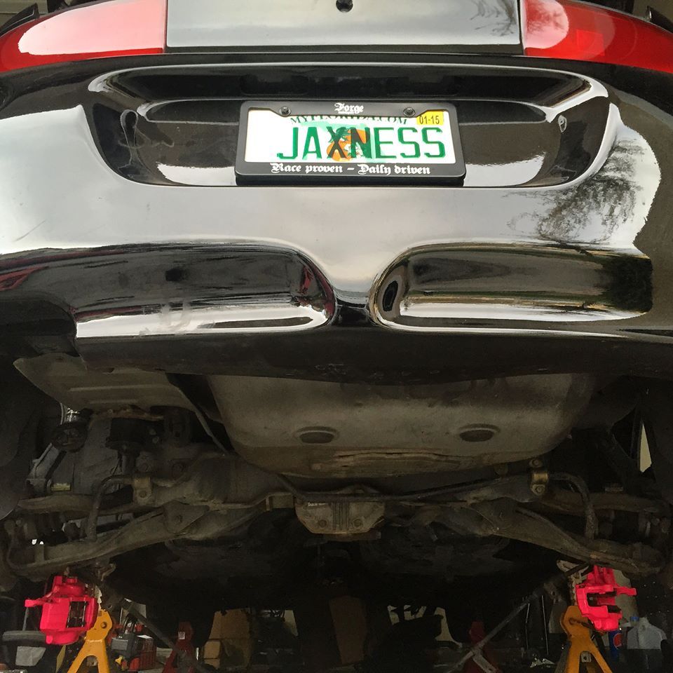

Rear subframe is in
