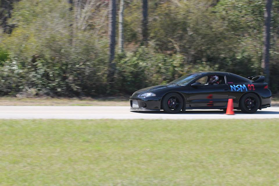

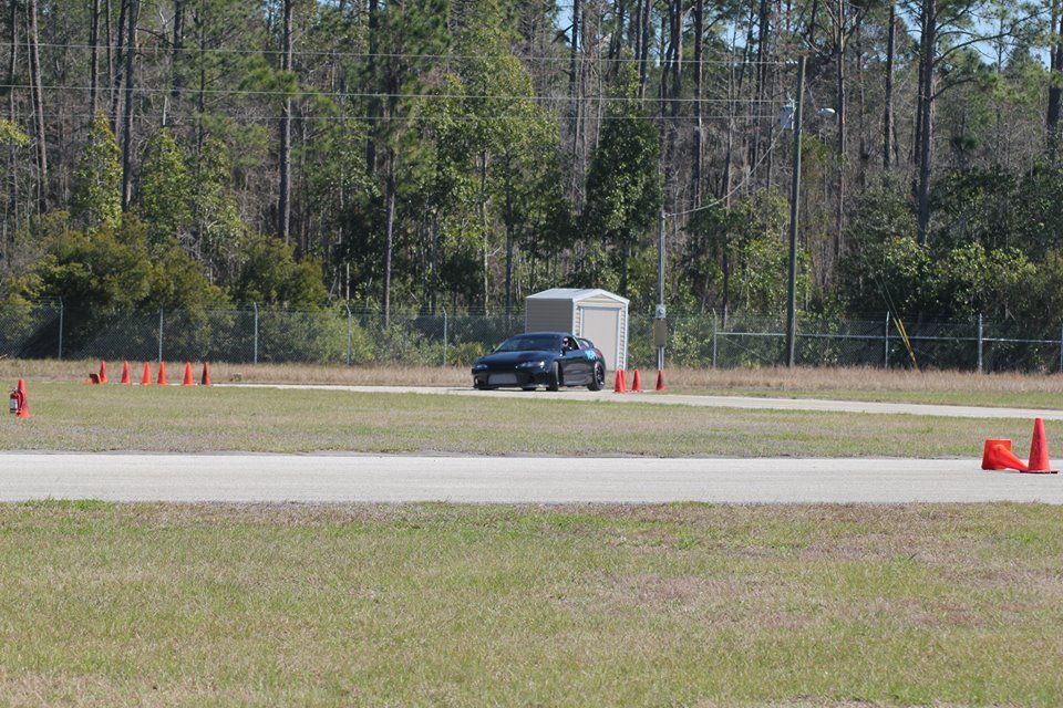

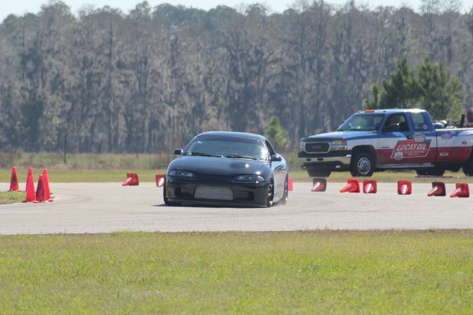

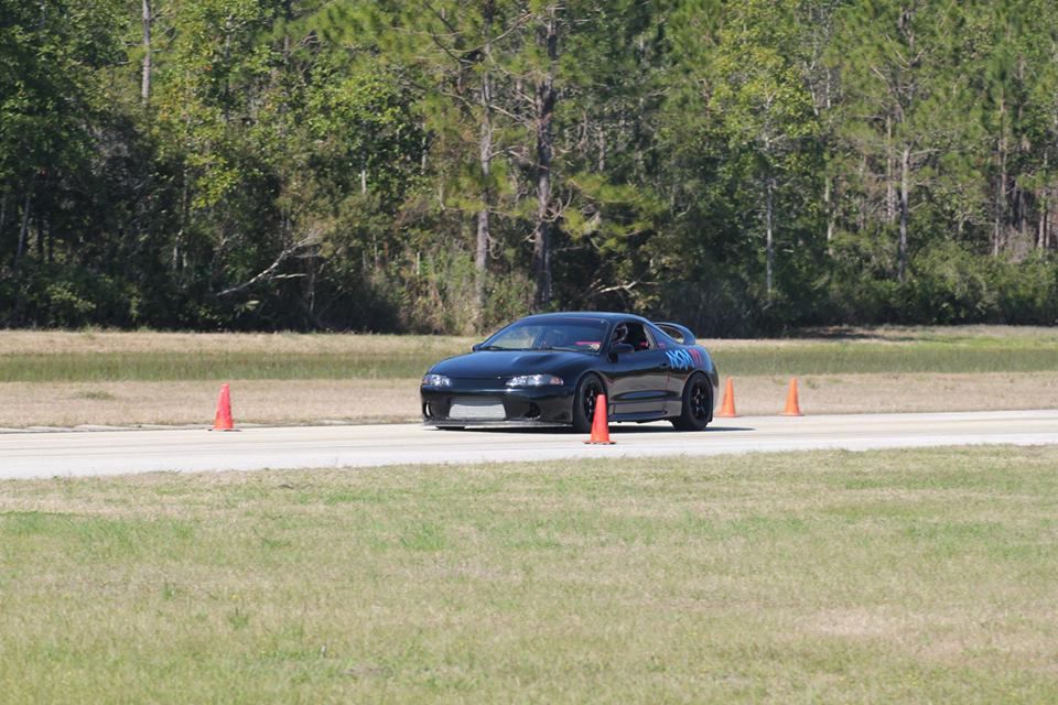

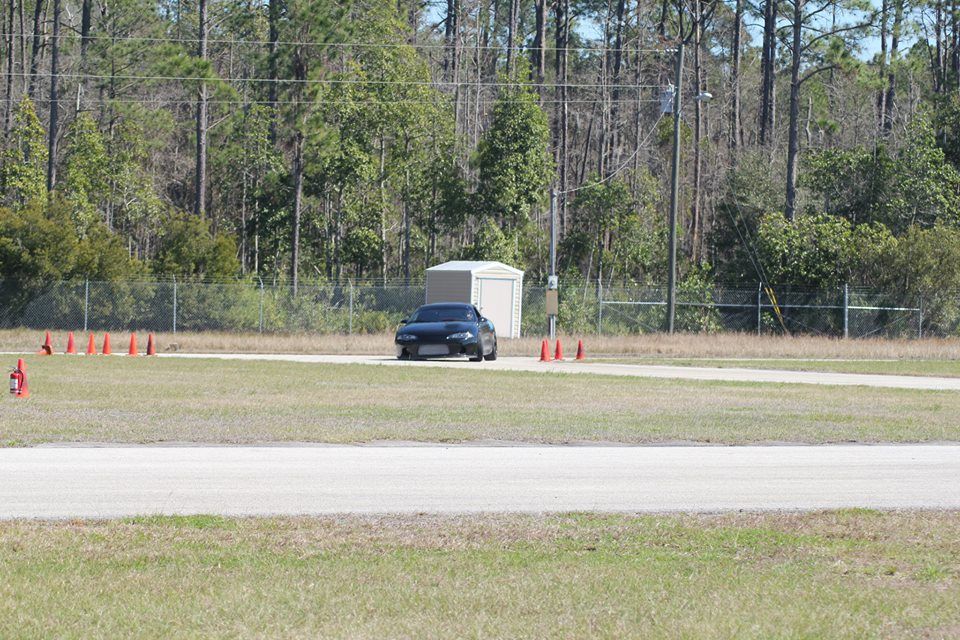

So my car has been unable to race since being rear ended twice, but I finally got the opportunity to get back to an auto-x track.
I was prepared with MUCH better tires than I had at the Shootout, 255/40/17s Bridgestone Potenza RE11a's. We had a field of 100 drivers, so we each got 4 passes. I ran a 72, 69, 68 and a 67. Each pass faster than the last, and in the top % of my novice street class.
Most importantly, it was a BLAST. This is by far my favorite thing to do with my car. :D I need to invest in a GoPro next.
