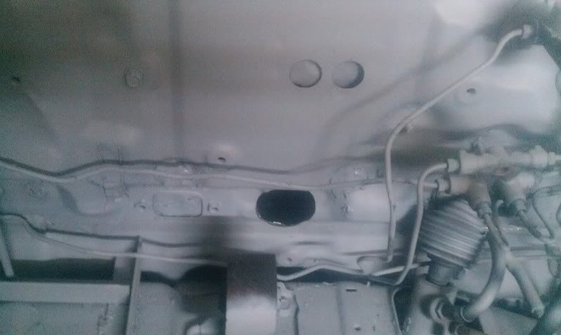

I unbolted the proportion valve and bent the lines away from the firewall, theres a good 4-6 inches or so in between in some areas. I originally wanted to remove them as well, i mean shit i took everything else out but ive rounded of most of the brake lines on the proportion valve :ohdamn:

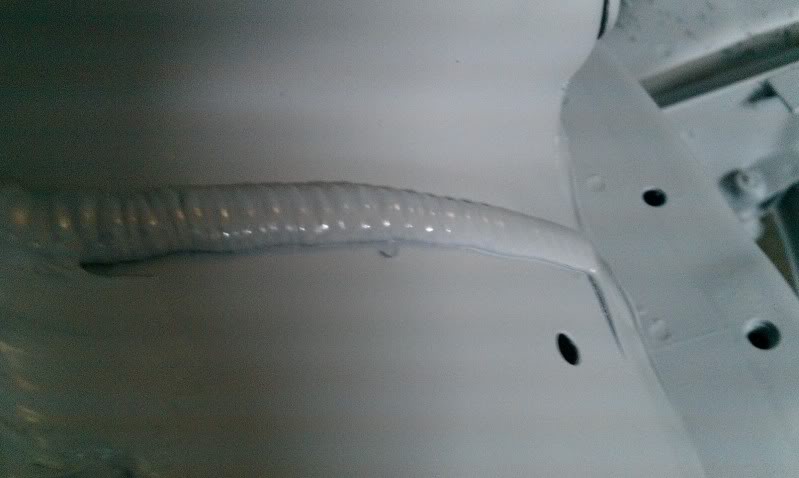

all the primer is dry, and has been for a while but it will not dry on this .. shit ..
whats wrong? i wiped everythinf with acetone and allowed plenty of time to dry..
That seam crap requires a special paint. In terms of what most would consider non paintable. Basically it takes for ever to cure..
I simply remove it, it looks better and can be replaced with stuff that can be painted that is a lot smoother. After fussing with a razor on my black car I pulled out the wire wheel on the white one and it cleans that shit off to the bone but it makes one hell of a mess..

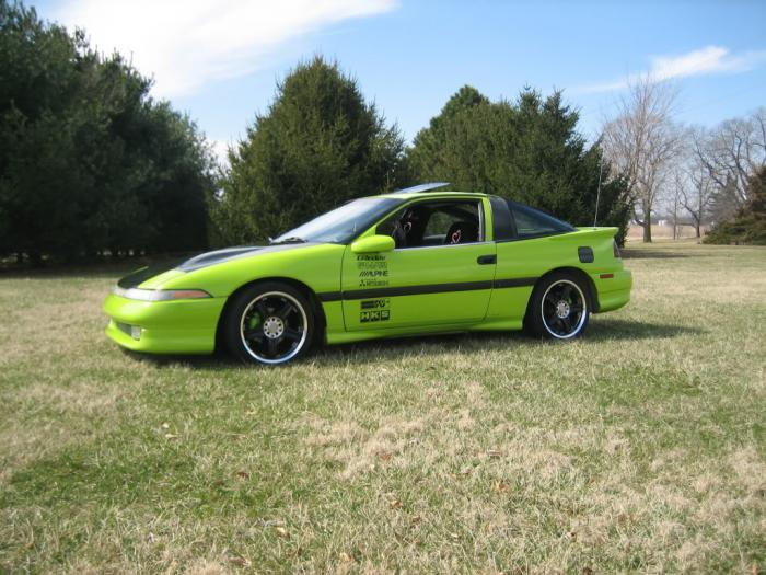

As far as the green goes, I'm not a fan. Even the owner of that car wants to repaint it. I agree on the typical white black and red DSMs but typically the best looking DSMs are white black and red hahaha.
I'd love to do some funky color for my own build as of now I think the white one will be a matte white with a matte black top but even so its still a panda. Hell I feel the same way with the purple accents but then I can't really think of anything else to use being from Sacramento (Kings) it just fits.

About the green, i agree with you about it being a loud color and people automatically trying to hate on it. but i feel that really pertains more to a street car. As a drag car in my mind that kind of justifies the Paul Walker paint job? haha. And i like black.. white, and red.. But they are ALL black white and red ROFL
Guy who owns a race car fab shop in town has a wagon with a green, purple, white , and checkered flag paintjob on it, looks really silly but .. well just look!

i removed that seam sealer crap off my engine bay and filled it with bondo. when i shaved my engine bay.
I noticed you did that! i didn't want to go as far as that but i do admit , yours looks amazing!
just sand it down with a disc and try putting high build primer there? or sandable primer?.. i would guess just build it little by little very thin until you can work with it then i guess...
just a thought.
Could i just continue with what i am doing? I will not be setting the engine back in for a month or so. Would it be cured by then? I am new to the body work stuff, i know i dont want to halfass it. If i had to scrape it off, it would be with a razor blade and sandpaper and may come out looking worse then how it came from the factory with that wanna be weld looking caulk shit.
I've done it with razor blade and if you do it right ti actually can be smooth to the body and there is no need to ad anything else. It is 100Xs easier however to use the wire wheels to get ti all out. The seam is normally sealed on both sides so not much to worry about.
It will eventually dry but it will always be a delicate spot meaning it wont take any abuse or abrasion. Get some clear on it and let it cure under some lamps for a while and you should be fine. It'll look a million times better with it gone though LOL.

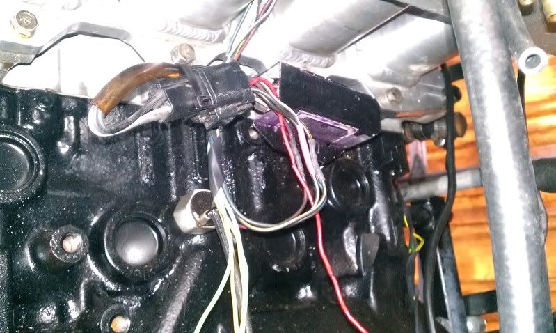

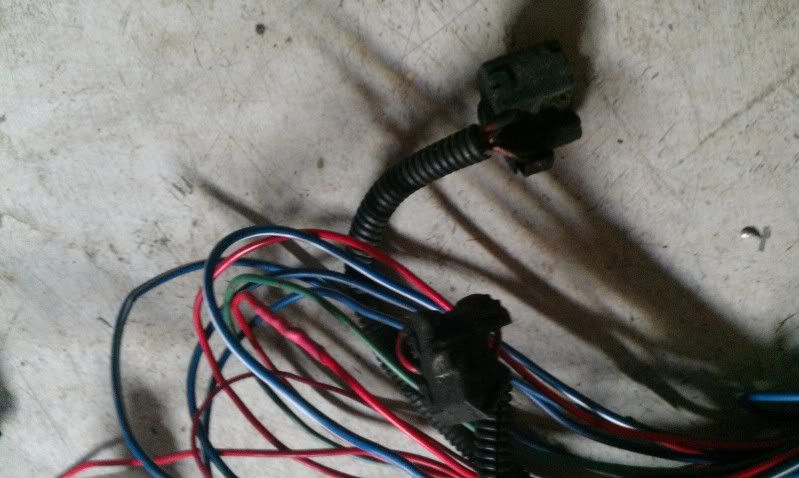

Got some injector plugs off of my donor car, finished my ecu harness. Finished my chassis harness. Waiting on my beautiful florida weather to warm up a tad before i paint the bay.
Only plugs going to the front are the headlights ( still have to wrap my wiring.
My engine harness all hooked up. Still have to wrap and run it.
Thinking my resistor box is going here

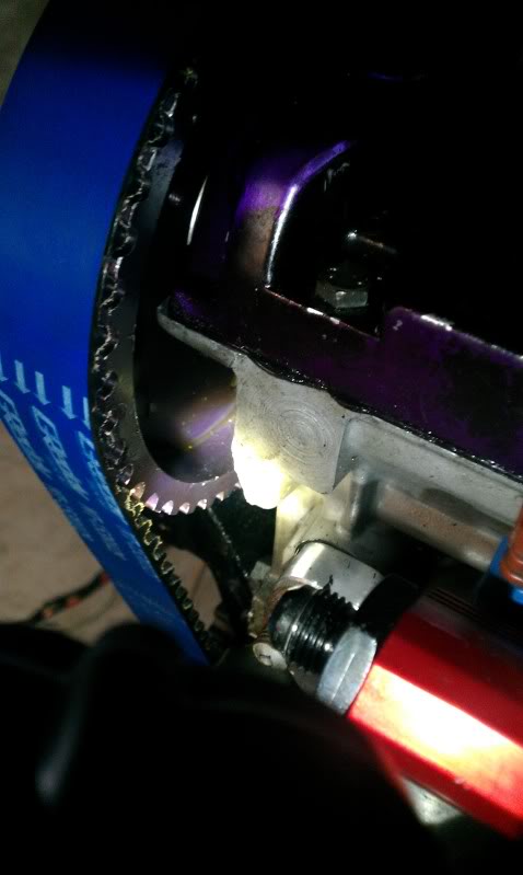

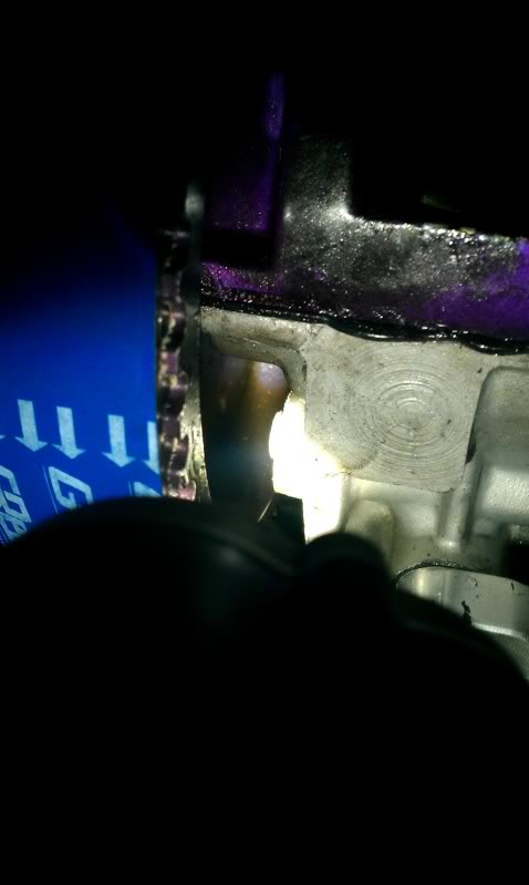

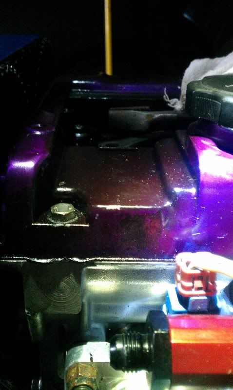

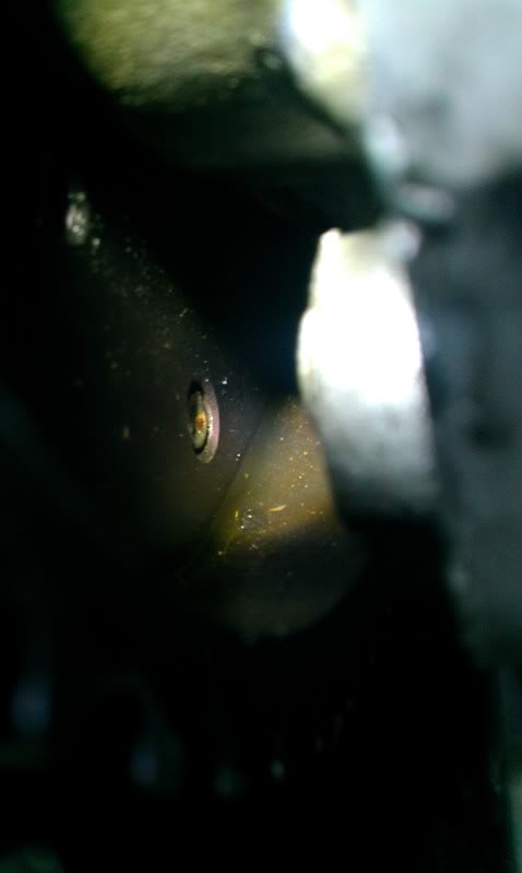

I would have oil sling up on my windshield during driving , i think i found the cause.
I believe it was the oil cap ( i know for sure is leaking ) was leaking on the VC and traveling to the cam gear, or could be valve cover gasket, or the halfmoon.
would travel here
Down into here
Ah still some in there..
Pain in the ass.
I just ordered an ebay oil cap that i will double seals on if it leaks.

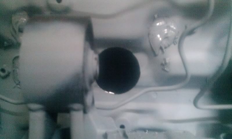

Purchased a holesaw bit today to cut a hole in the firewall for my wireharness.
Should be a good spot for it.

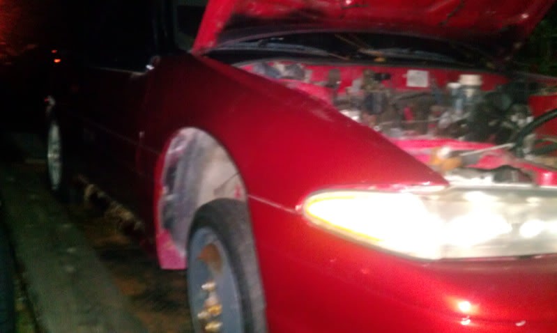

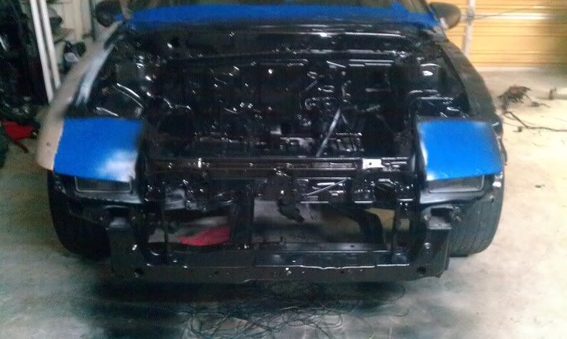

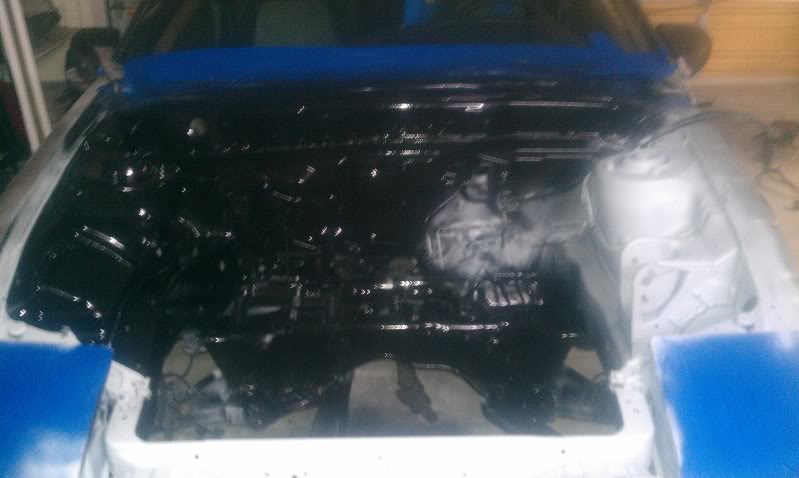

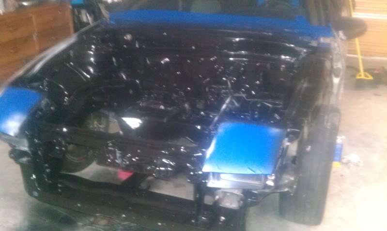

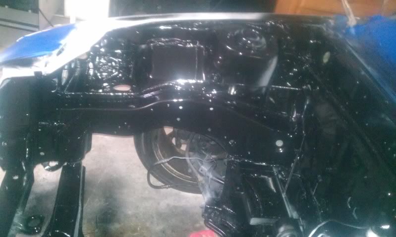

Now let me start this off by saying "I am not a painter, i dont paint, i have never before"
With that being said! i painted my engine bay tonight ROFL i opened the door to my garage with the heat on, and the garage was 74* so i said what the hell and went and bought some paint.
Cheap stuff , but as a painting noob it looks legit!
i have no idea how to adjust the gun, there were three knobs, i figured out one was for air pressure, one was for amount of paint sprayed, and the other was for how wide you wanted the spray pattern, and the end of the gun had the knob for up and down , or left to right.
pictures i just now notice, i forgot to tape my lights up.. there is primer and paint on my freaking headlight lens.
Hey my first time ever, priming , painting, hell even holding a spray gun! LOL. Does it look terrible? i don't have the experience yet to know if it is good or bad. I will have headlights, thats the only thing i left up front from the chassis harness, i will put the motors back and just leave them down, or use the manual adjusters to raise them.
I'm sure i can get the paint on the lens, if now it will be a good excuse to get new lights!
Not horrible but I know it probably looks better in pics than in person LOL. Makes sure you put a heavy clear coat over that paint. That Lacquer crap fades fast and it is brittle. It wont take much abuse.. I would have recommended a valspar tractor paint or something similar that is a one stage paint and by themselves is cheaper than Duplicolor..
Like I mentioned before, you wanna remove as much crap as you can and mask everything else unless its being removed or repainted later. Gives it a professional look when you have the final product. Keep up the good work though. I am definitely not knocking it, you're going beyond what most would and I commend you but I am just giving some pointers for future reference.:thumb:
