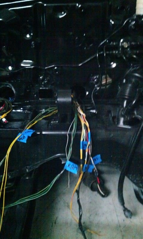

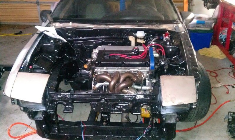

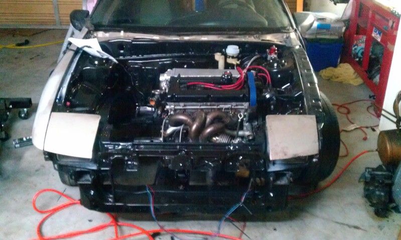

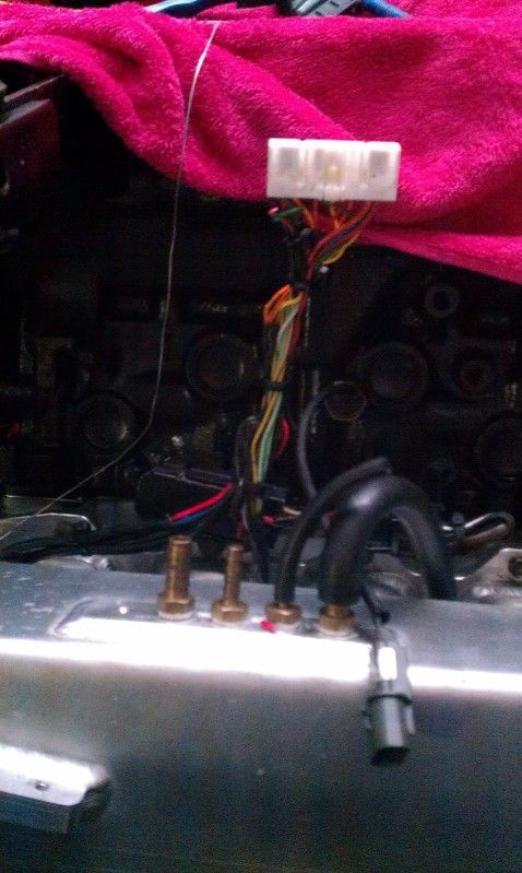

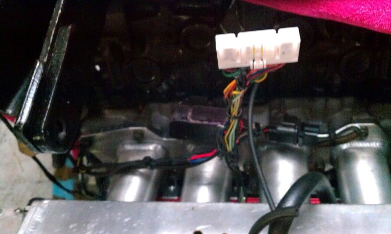

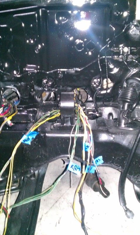

I added one large connector for most of my wires for the engine bay, with the exception of coil, power trans, and maf.
Started fixing the broken picture links, i will finish them tomorrow :(

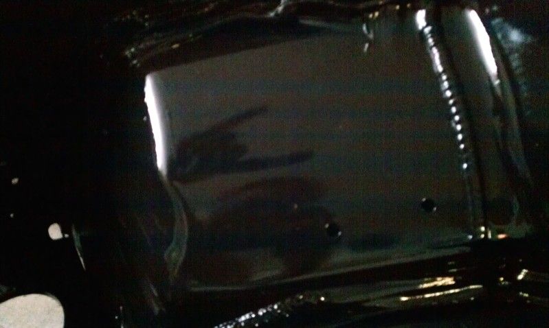

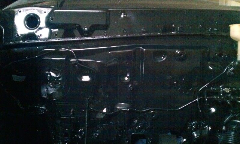

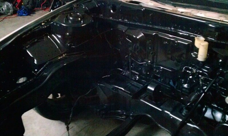

i clear coated the bay.
For my personal reference mainly, the plug i added

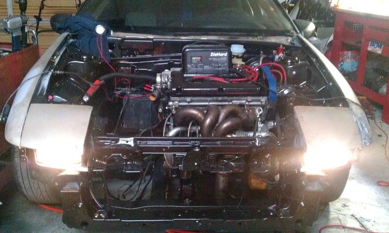

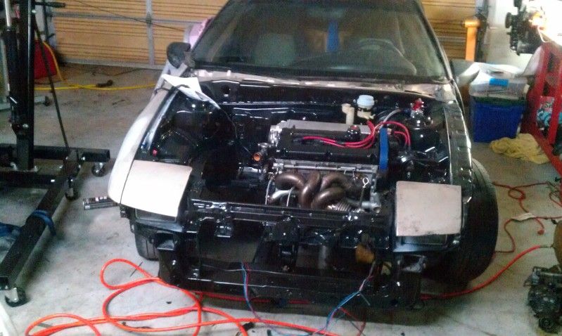

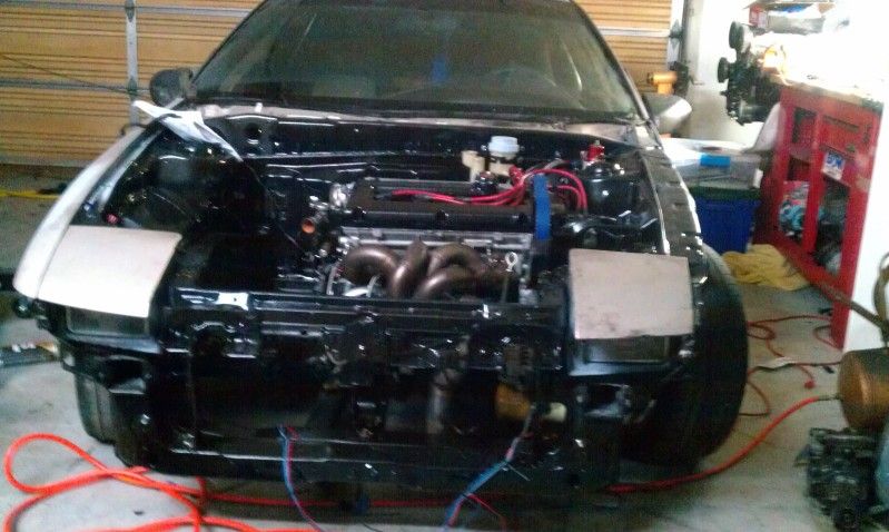

Dropped the engine back in!

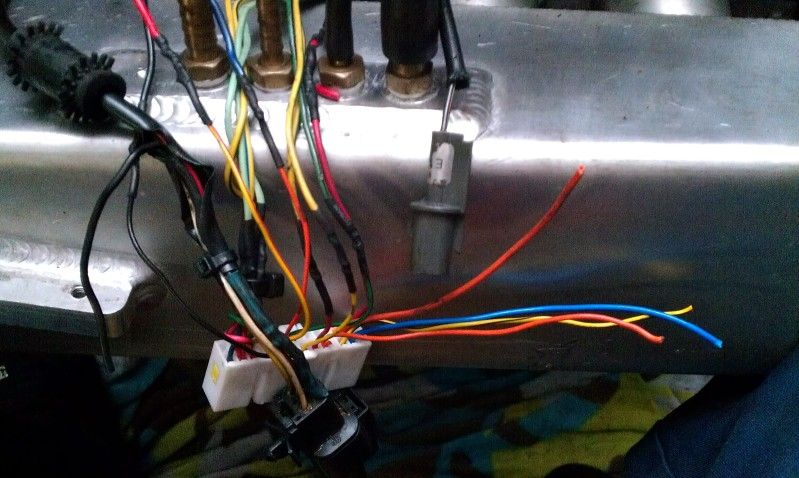

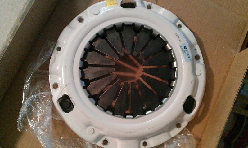

All the wiring is in, the battery isnt in yet, still waiting on the clutch to come in so i can button it together
im not sure how to wire the headlights, i thought i could take the wires from one plug, tap into and extend them to the other headlight, but the lights are very very dim when i do that, maybe that is the correct way after all and i just dont have enough voltage i would loveeee some insight, ive posted three different places.

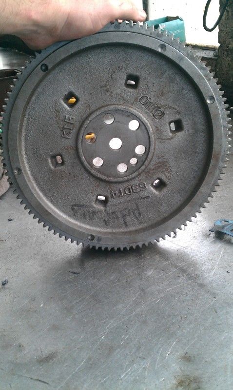

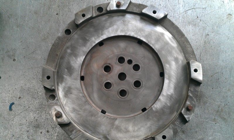

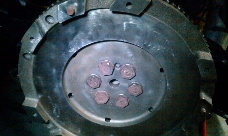

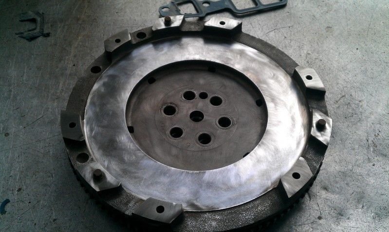

Not sure if you noticed the flywheel i was using, it was an xtd, and it was drilled and slotted.. first time ive ever seen that. I dont think it performed well, and i believe it may have contributed to my excessive clutch wear, so i dug up the brand new ( 2 years ago ) stocker that i had balanced. and decided to use that instead!
had a buddy come over and help me with the headlight issue, and yes the wires feed both plugs, they do not have their own power supply like i thought that did. my batter charged positive clamp was only help together by rubber insulation, the wire was severed, fixed that and BAM!

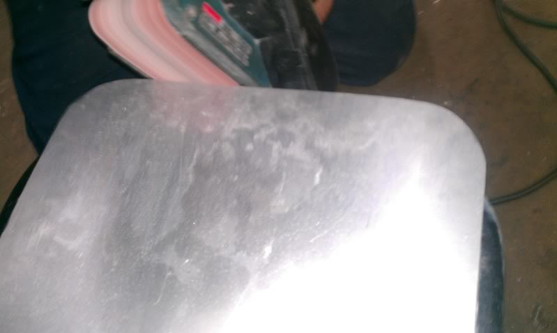

hey man for your body work you should get a sander and feather it all down to the Metal if you want but after that you can paint it works better than using that stripper crap

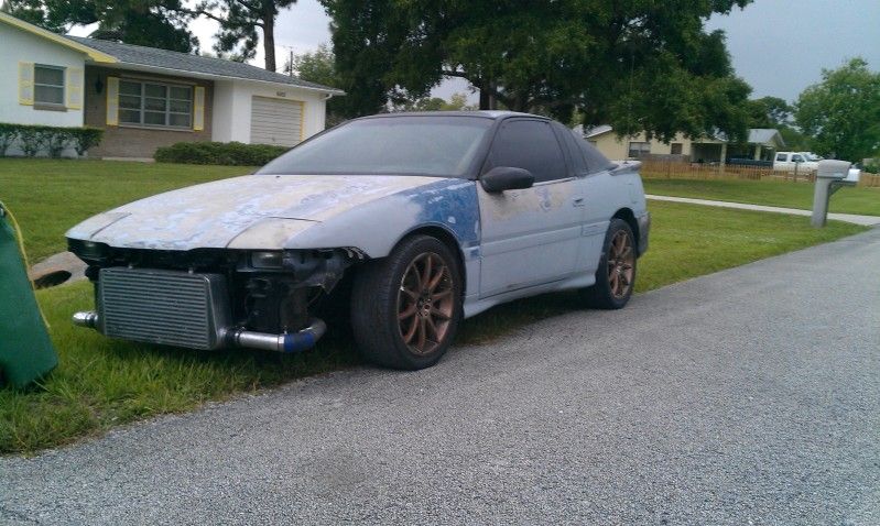

Been quite a while since i've updated! So what the hell.

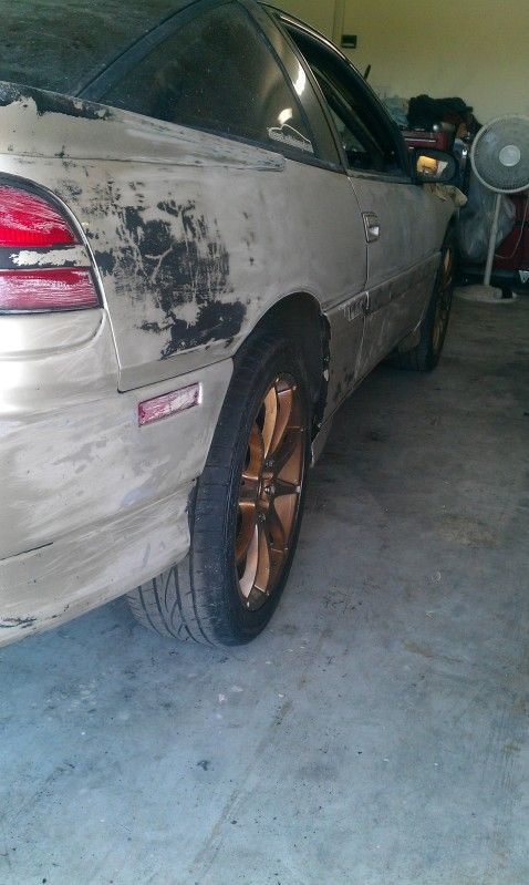

Ok, those pics were probably taken around the same time i last posted! Not a WHOLE lot has changed since then but ill post what i have.

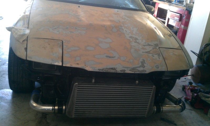

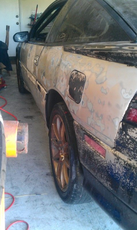

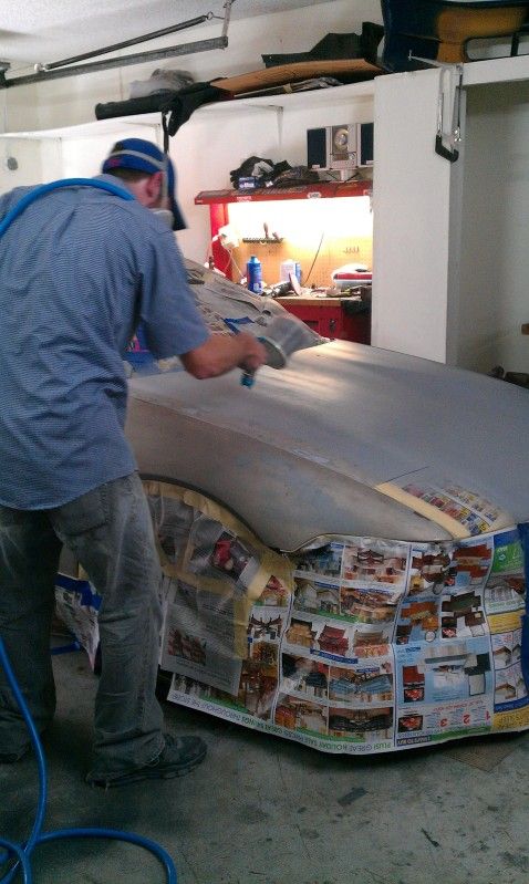

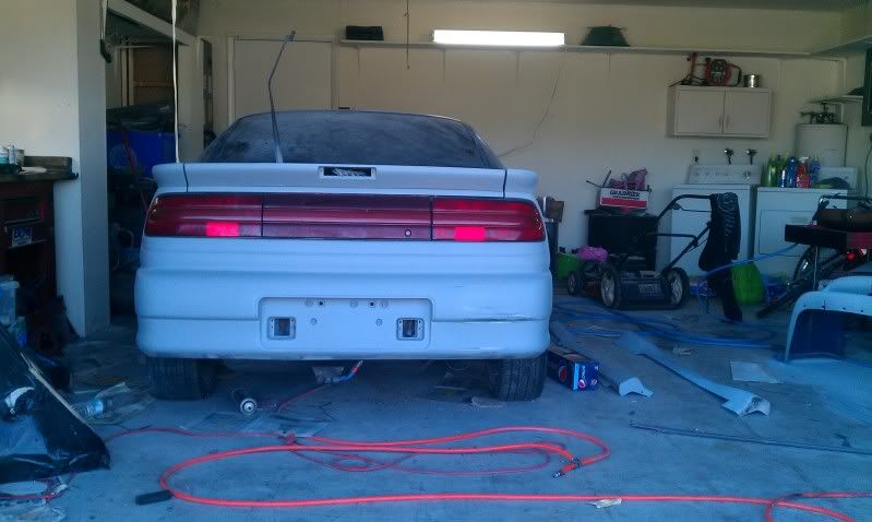

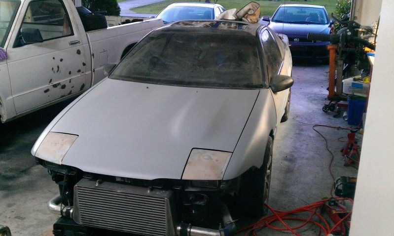

First off its mainly about body work, which i am terrible at, had a friend come to help .Come to find out my car was alot larger of a project than i originally thought Loads of dents, the roof was the worse.

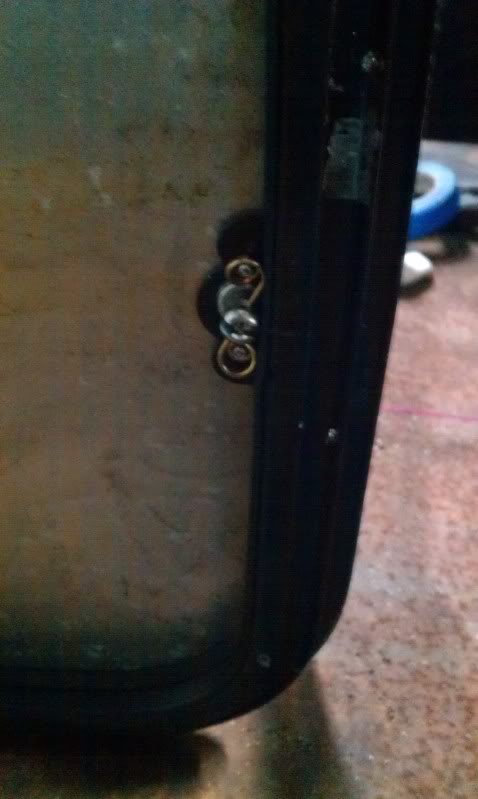

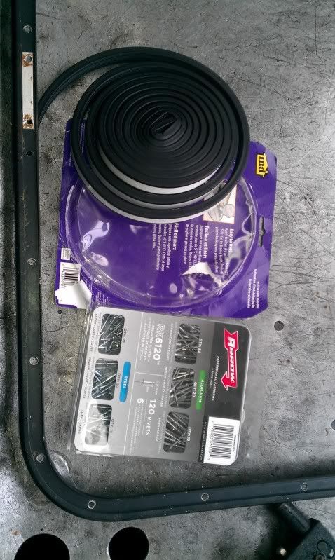

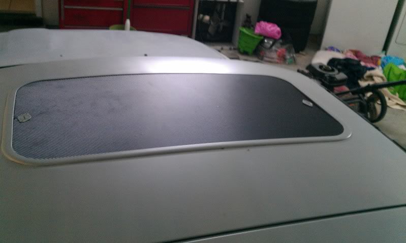

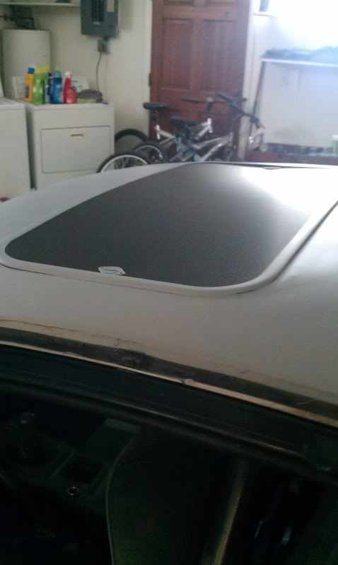

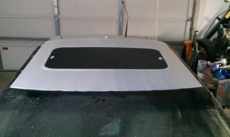

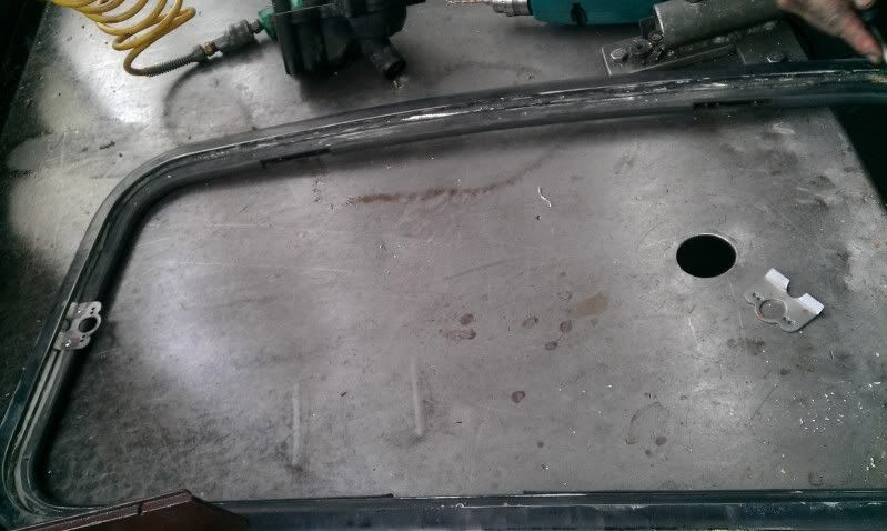

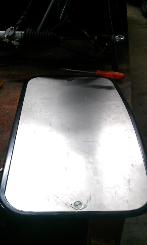

I had quite an issue finding a replacement sunroof at a reasonable cost, i wasn't all that partial to it anyways.

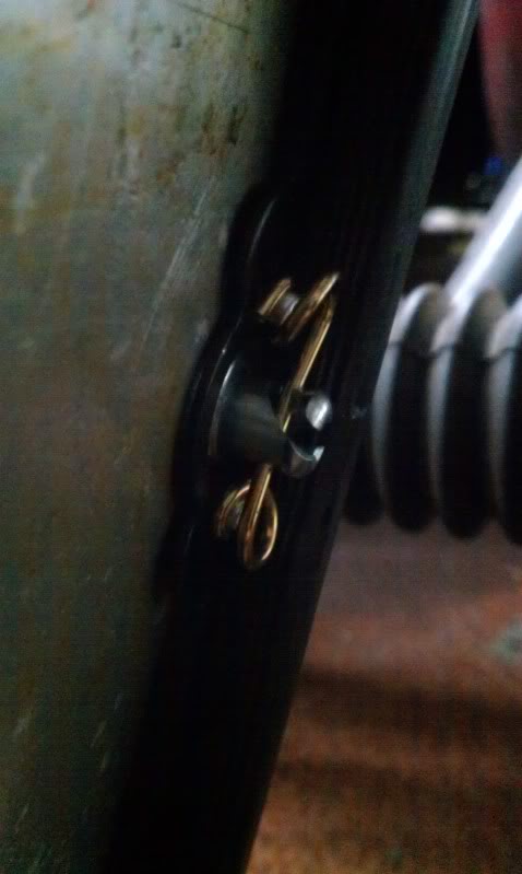

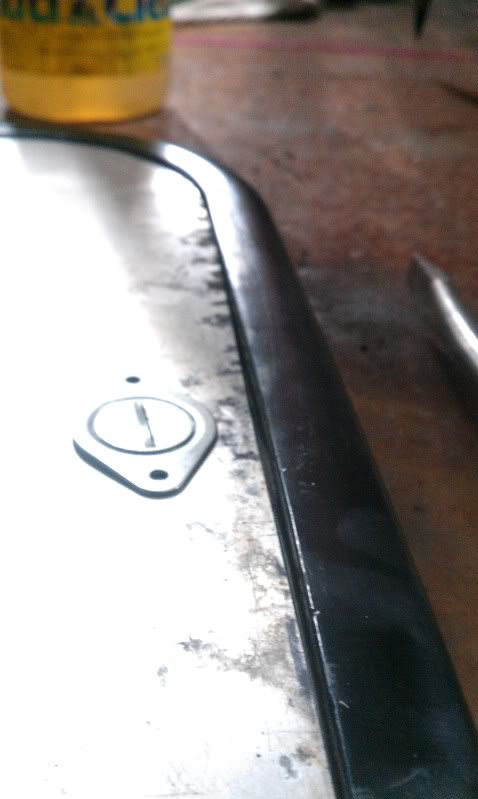

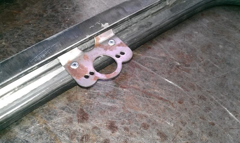

So http://www.dsmtuners.com/forums/custom-fabrication/450228-made-sunroof-plug-w-dzus-fasteners.html

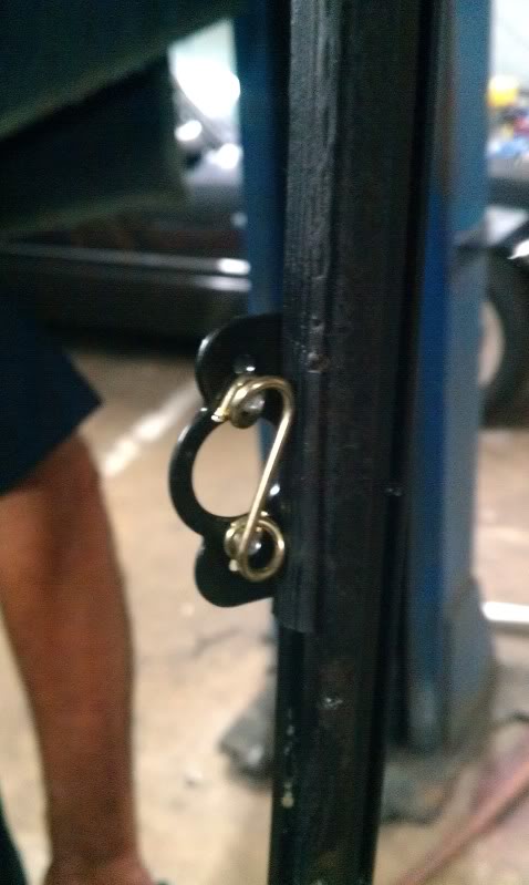

Has a total of 6 fasteners 2 front 2 rear 1 each side. bi*** isnt going anywhere this time around.

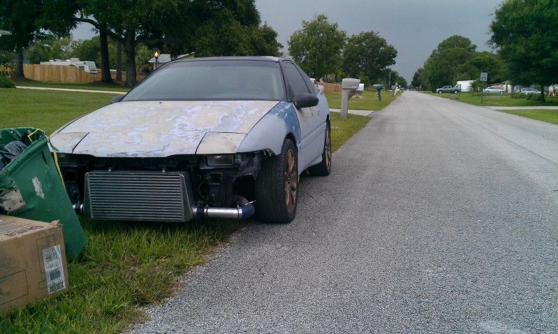

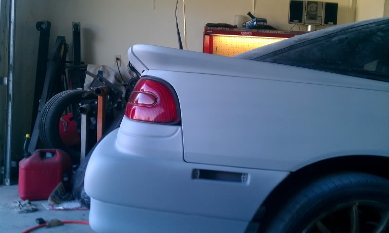

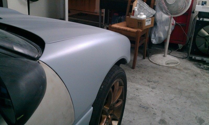

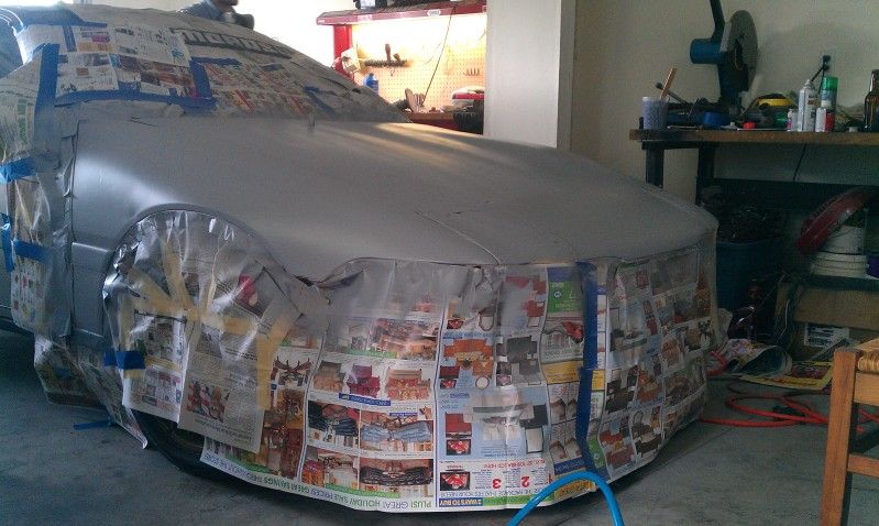

Finished priming the car, or trying to!

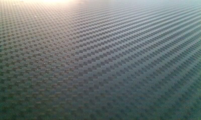

Put some carbon fiber vinyl wrap stuff on the plug!

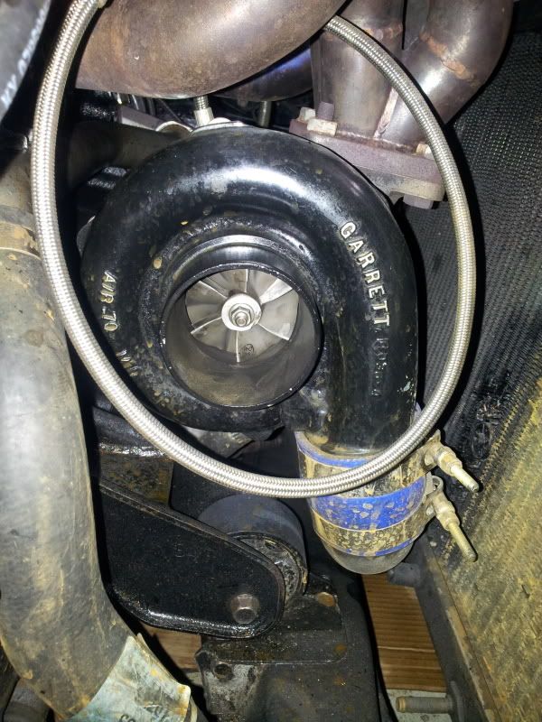

I also need to start looking into turbo upgrade, and a cam upgrade. The comp 101200's are decent but i would love to go for a kelford 272-280.
and my turbocharger was designed for an aircraft although it hauls ass, it has quite a long spool time and i believe possibly a bw366 or something similar would be an immense upgrade.
I may be getting a bonus at work possibly $1,000-$2,000 Which could land me into both of those upgrades as well.
Oh you did!? i was going to wait until i had the manifold tacked in place to update!

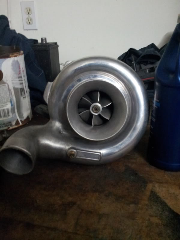

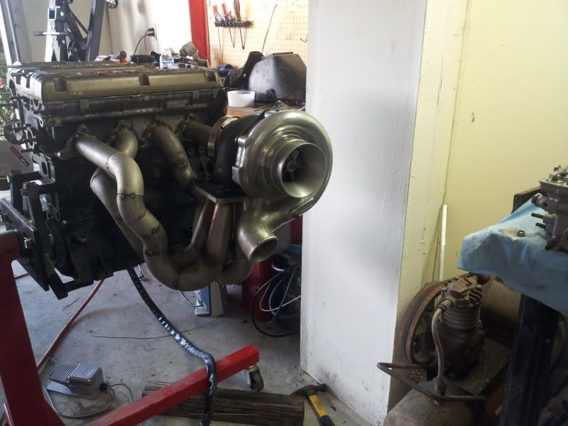

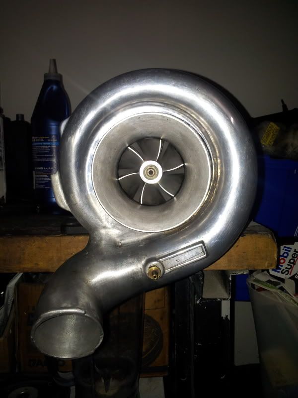

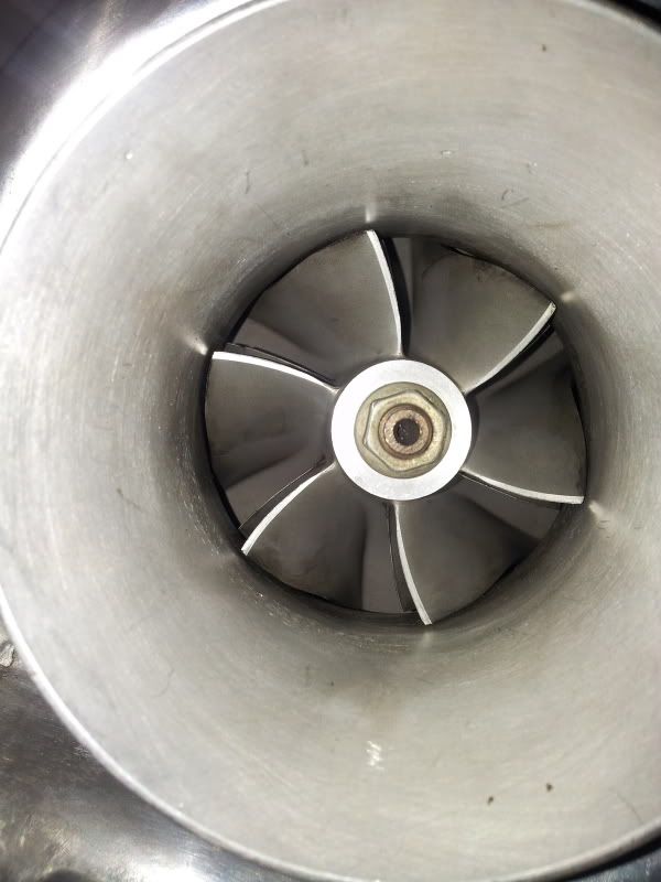

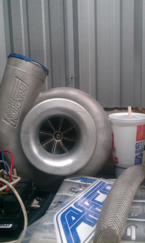

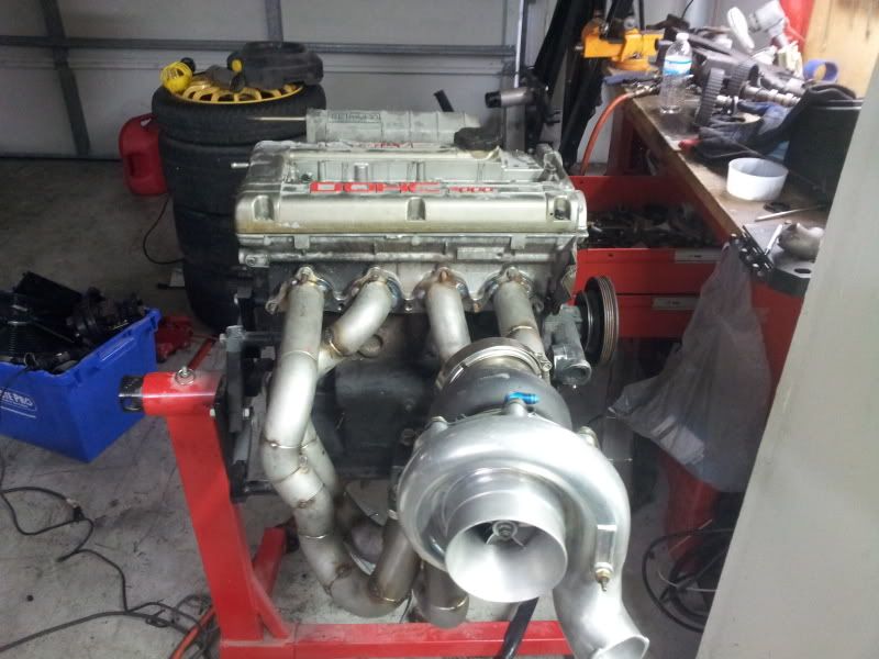

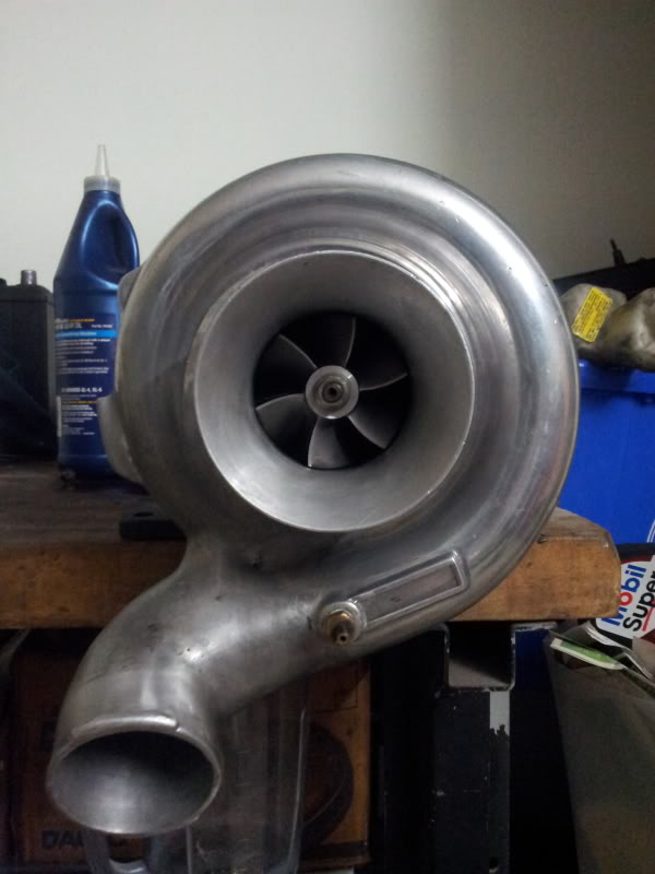

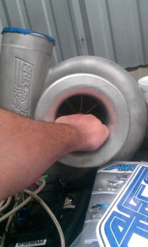

my current turbo, actually a 61mm, instead of the previous thought 67.
The new one! either 65, or 66mm previous owner measure 65 i got 66. not to worried!
Its not straight off the shelf super shiny brand new or anything. But for my budget and power goals, it should perform well!

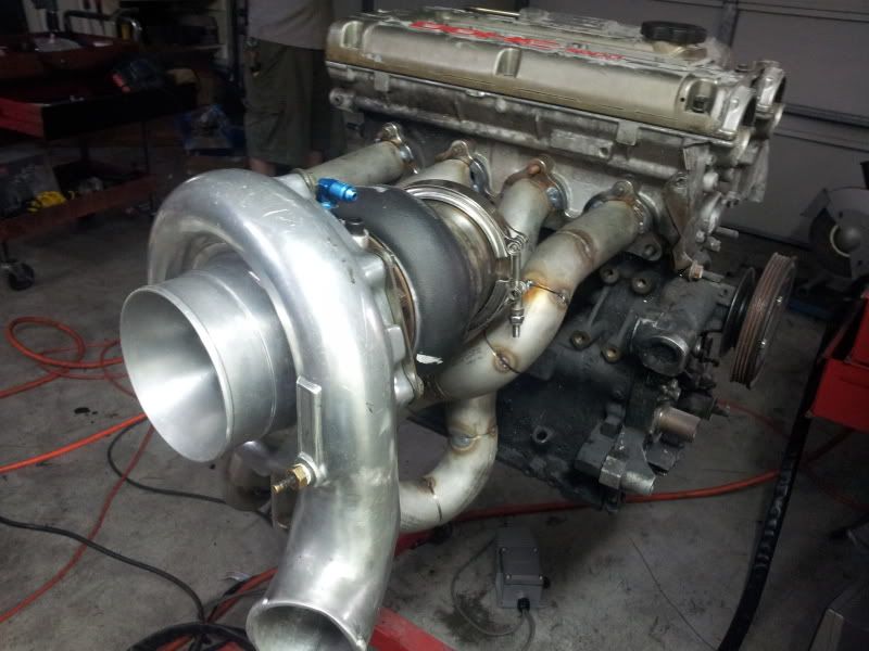

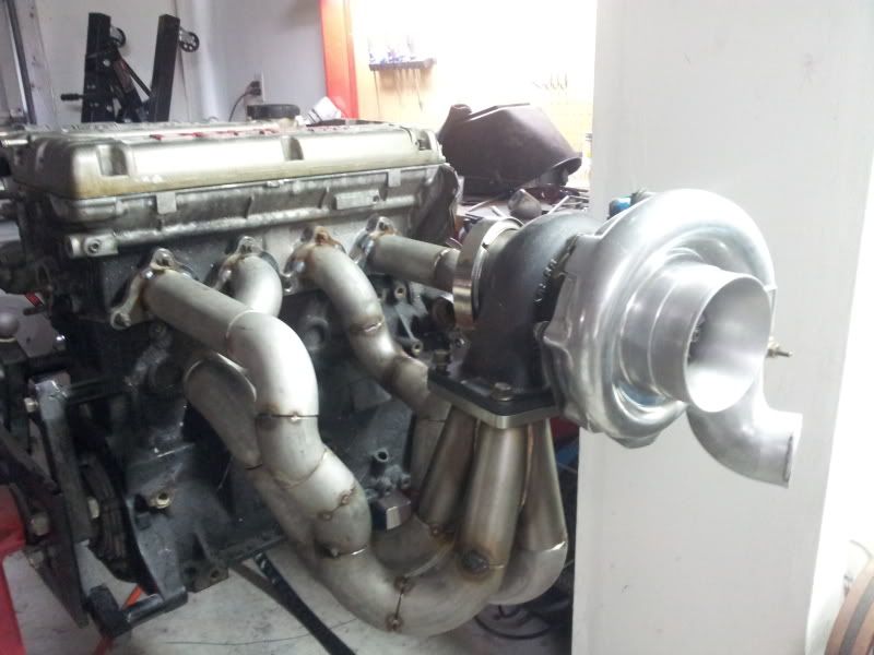

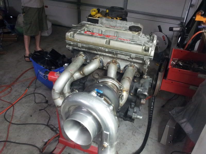

If all goes well, my turbo should be playing peek-a-boo about here

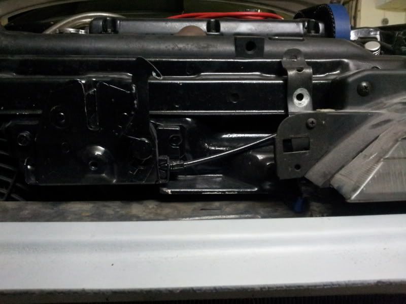

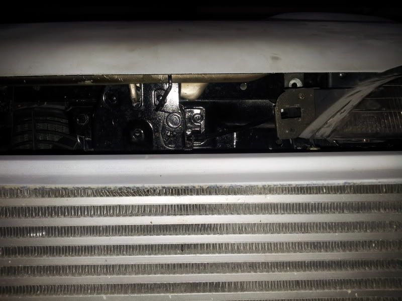

i will have to cut the core support to fit the turbo, remove the latch assembly and go with good ole hoodpins!
Most likely going top mount for hood clearance issues, but i will just have to see how i can fit everything. the manifold *looks* somewhat easy, but then factoring in twin gates, and a downpipe. This turbo has a 4" vband outlet for exhaust, so i purchased a reducer from acestainless.. among quite a bit of other things ;) Its still a little ways away from that being done.

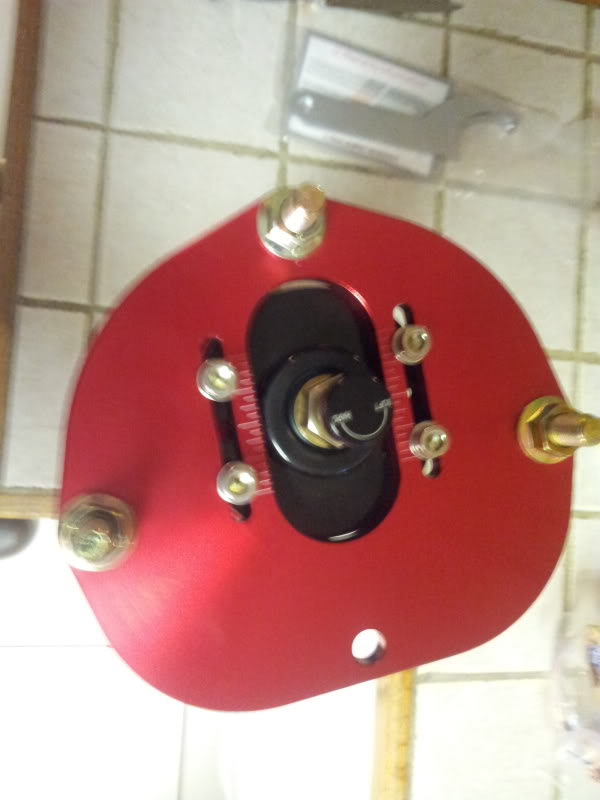

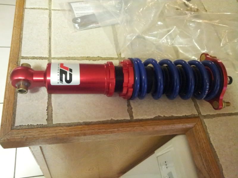

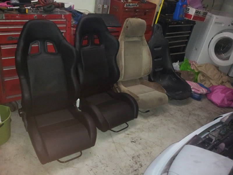

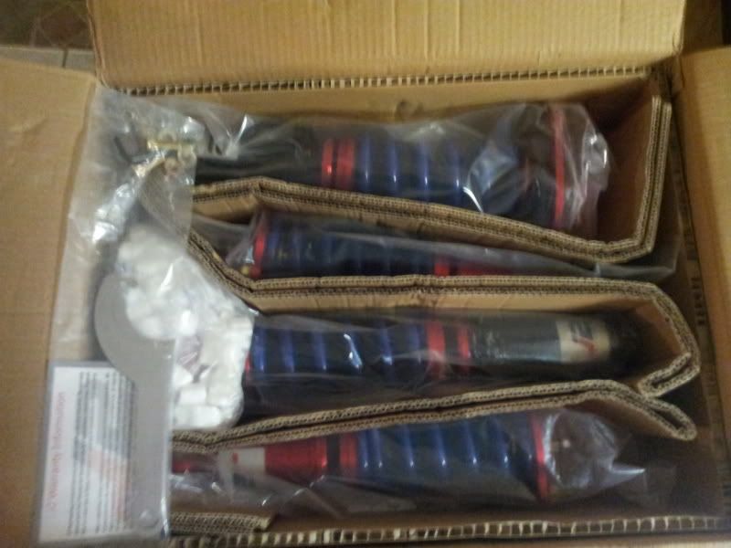

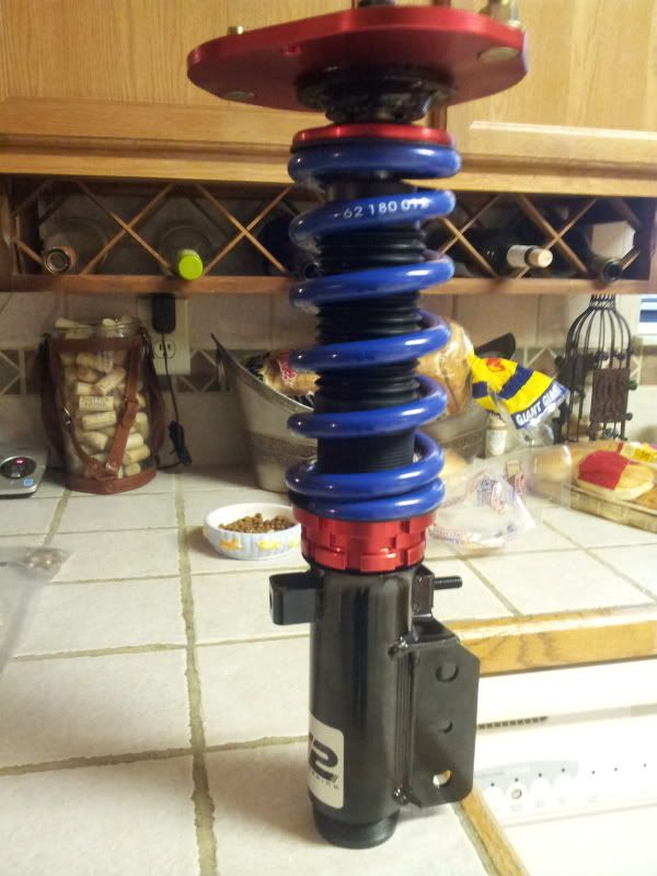

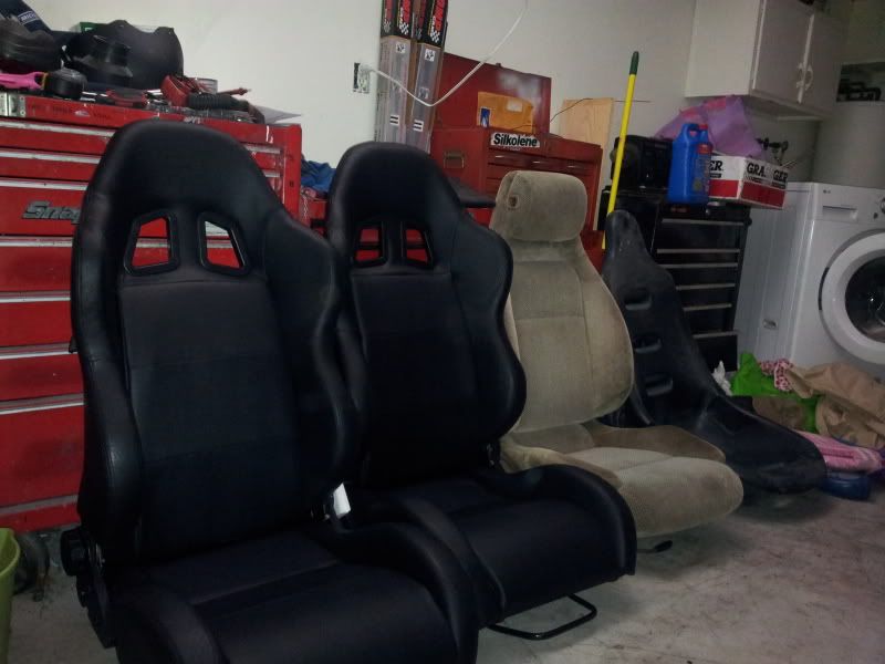

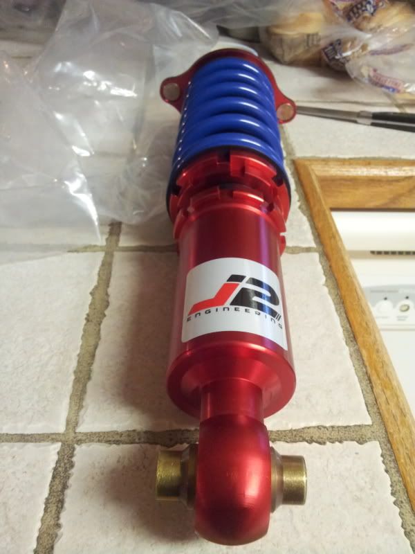

My seats came in tonight! i've got to go pick them up right now. And i also purchase new coilovers, J2 engineering which came in, i also have pics of those!
This nut right here, is down to ####.. haha terrible humor.

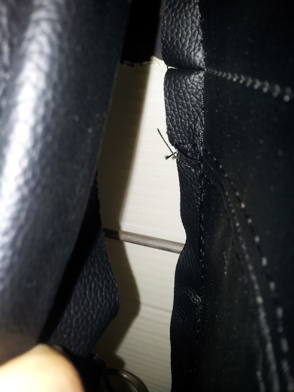

Yea... so there basically no real structure to these seats.
I like those seats! Btw I talked to the guy more about the turbo. It is an old school turbonetics t66, that apparently only has like 50 miles on it from his is300. Then it sat for 4-5 years in storage.

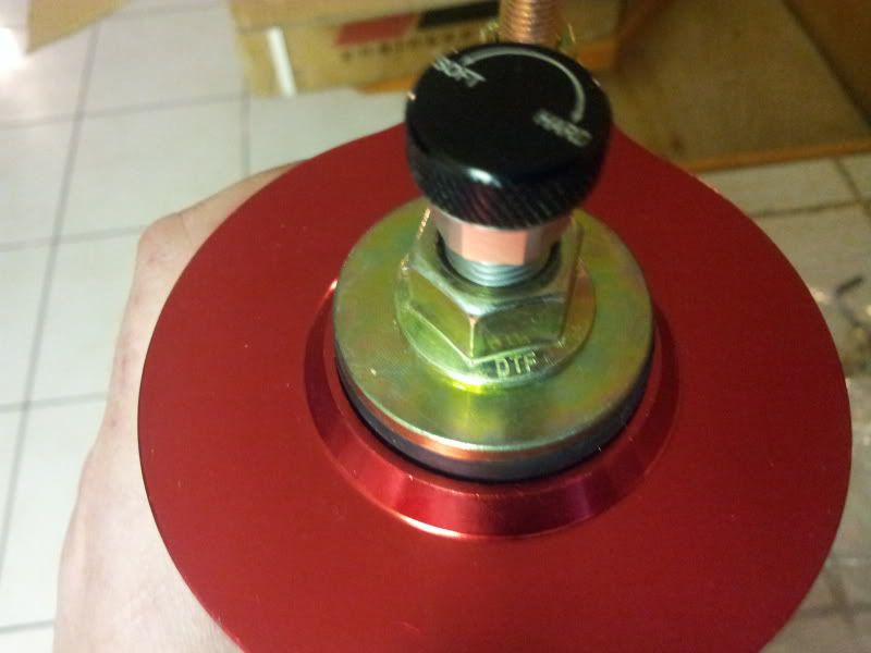

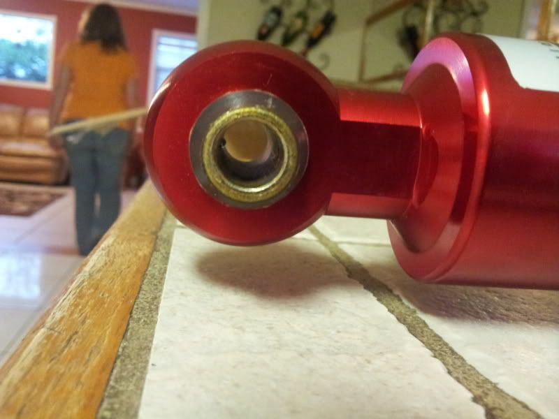

Anybody familiar with drag suspension? its a "32 way adjustable damper" should they be set high? or only in the rear?
Guy gets a dsm , not even running for 1 day- then is all over the dsmtuners forum pssh. LOL!
I set mine as stiff as I could in the rear. Didn't even touch the front. My 3100lb car has been low 1.3's

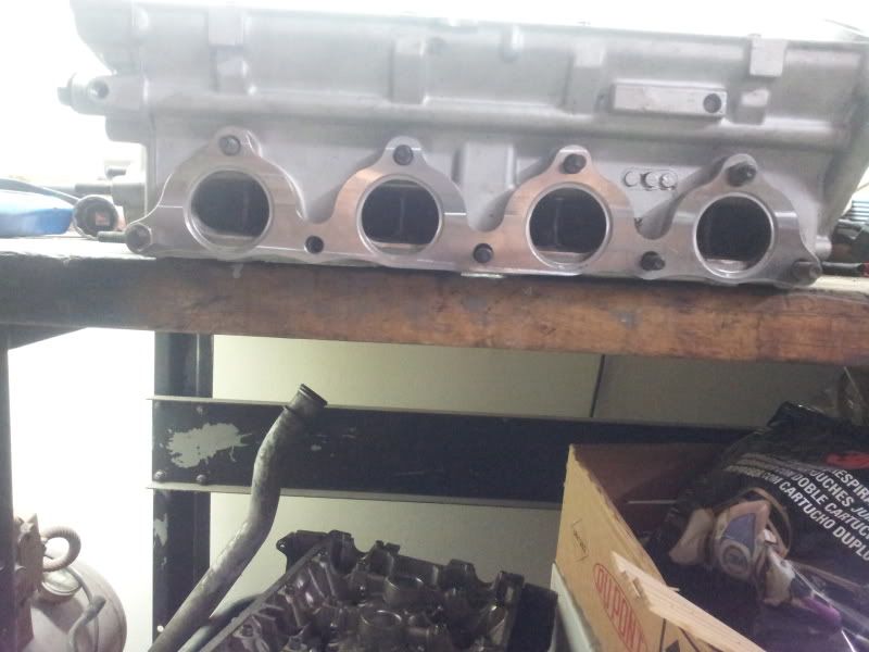

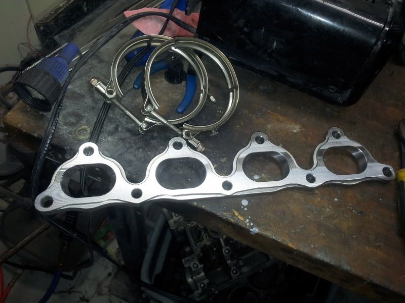

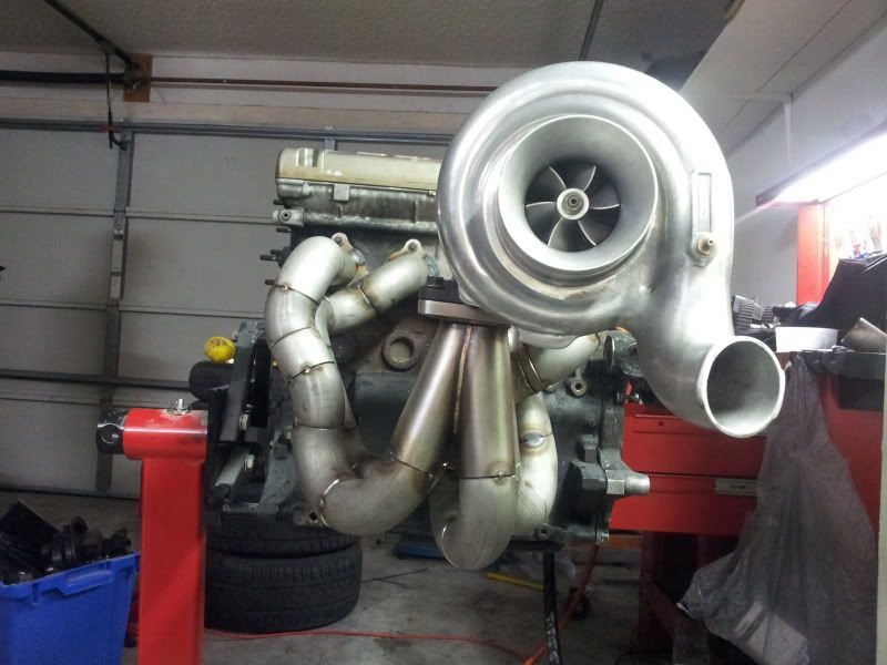

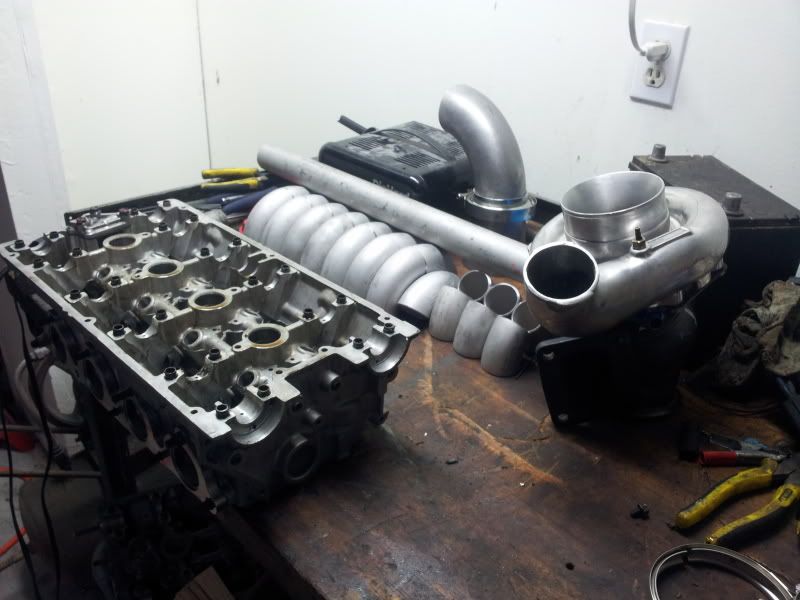

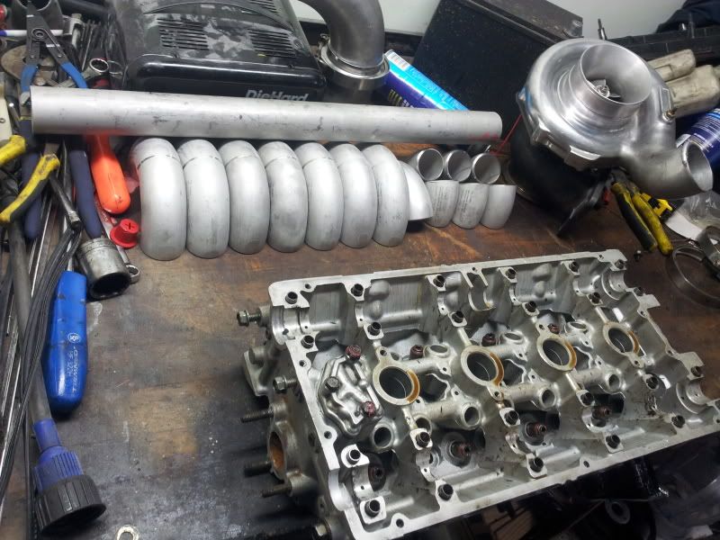

Most of my manifold materials came in!

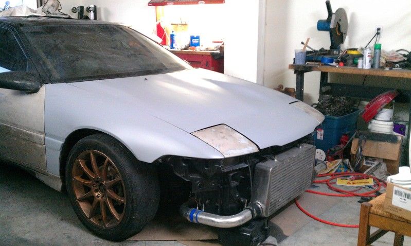

Car is still at the paintshop, looks like it is still about 2 weeks out for that.
I may go grab it one day so i can at least tack a bar from my head flange to the turbo collector , so i can at least start fabbing up my exhaust manifold.
I still need to install my seats, coilovers, manifold, and turbo! I also want to cut the front end off of the car like i see alot of other drag builds doing. But i feel like i saw a class rulebook of some kind state that it was prohibited. i may be mistaken.

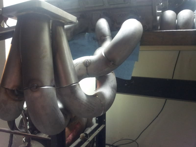

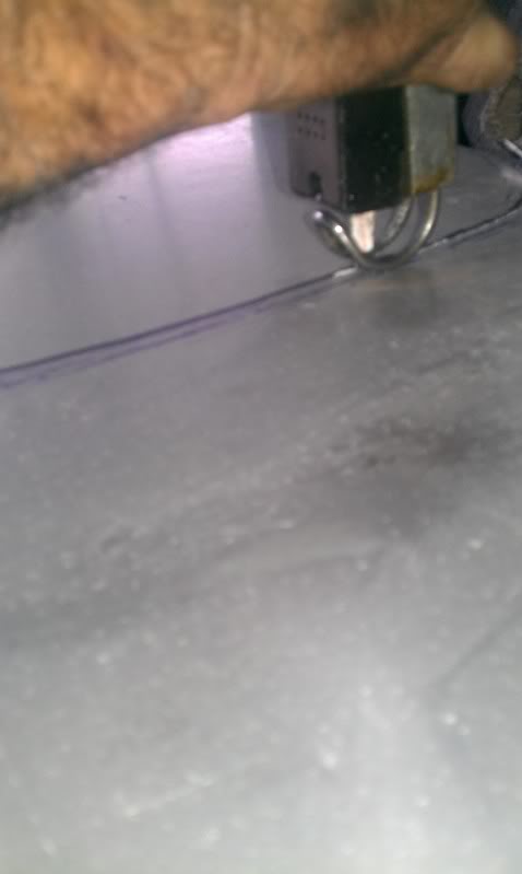

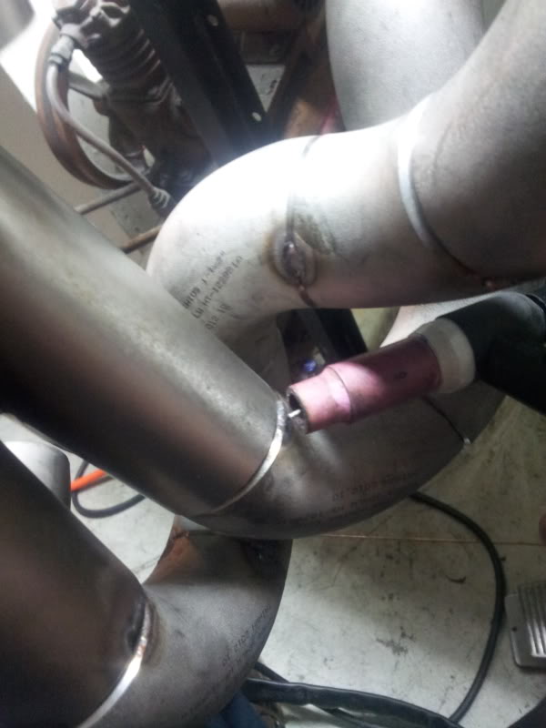

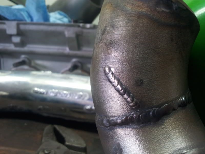

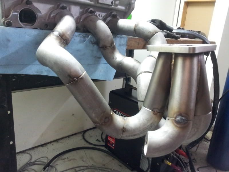

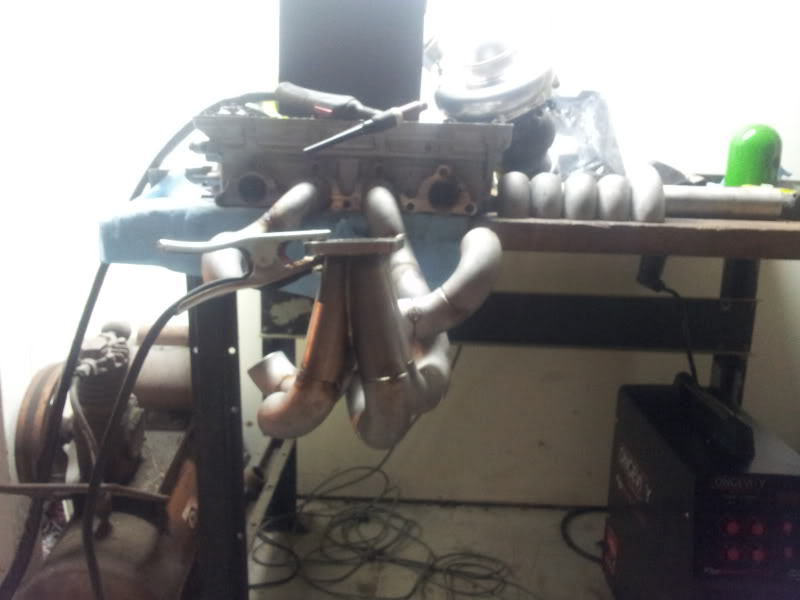

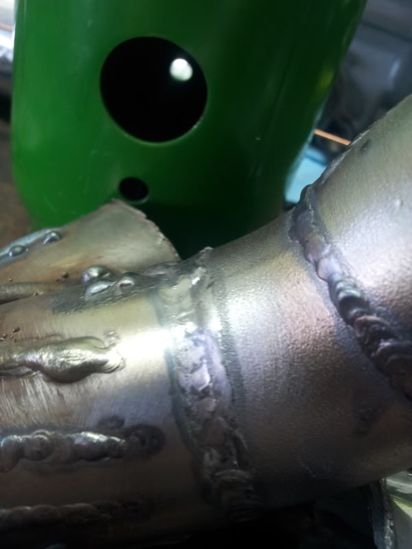

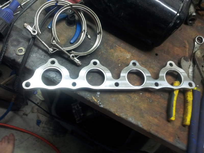

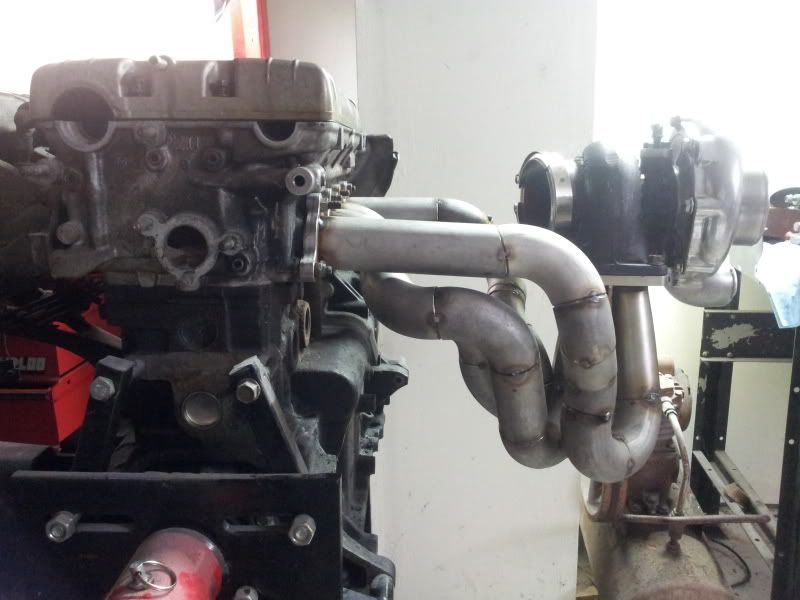

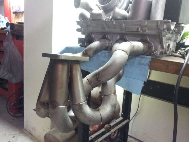

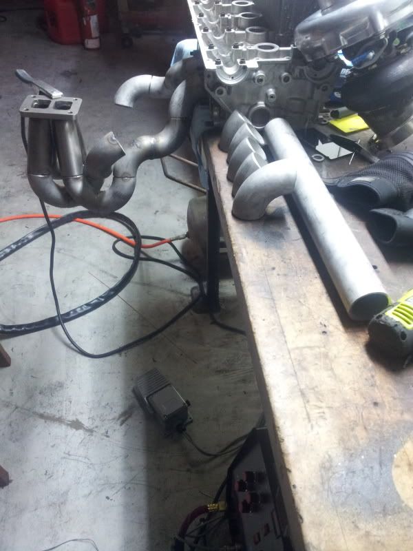

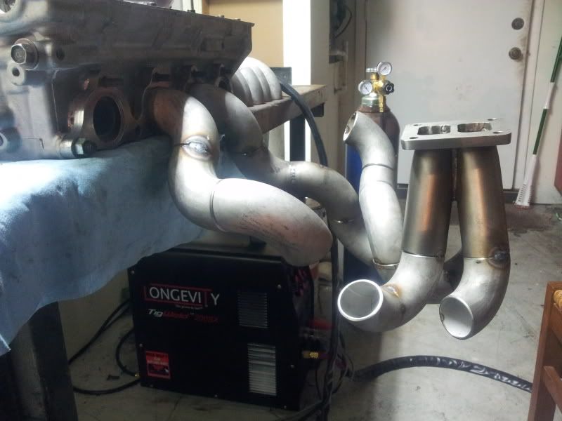

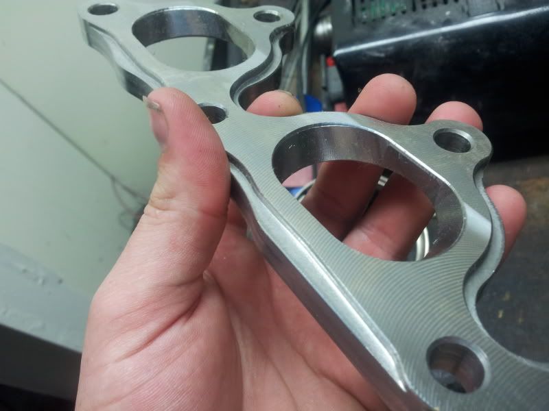

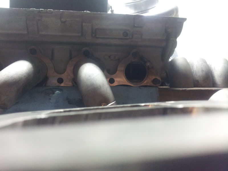

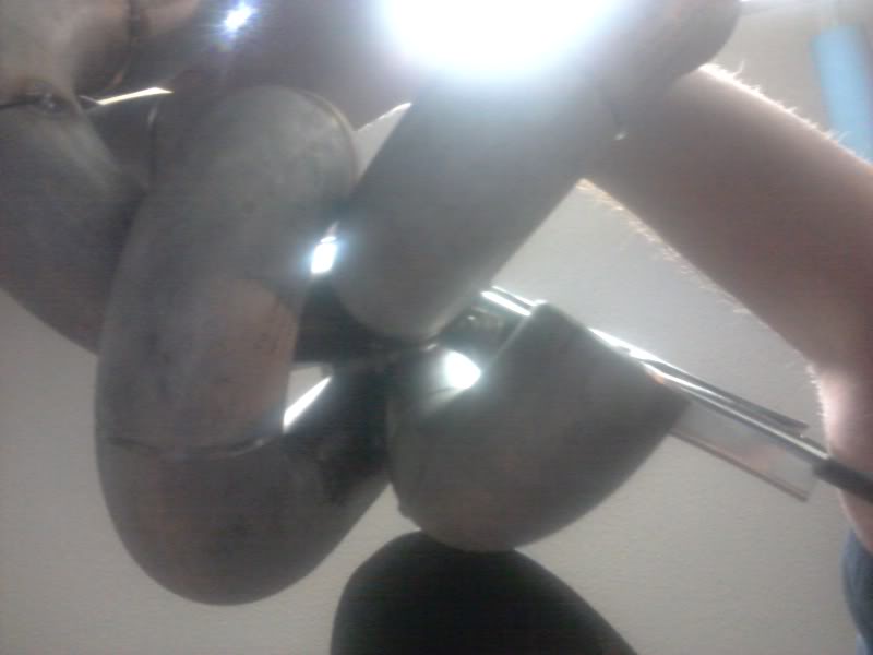

So i bought a Tig Welder , and i have never used on before, so i have been kind of practicing with it tacking this manifold together.
I didn't want to get too involved in it because i need the car to mock it up, its still at the paintshop....
So i went and took a bunch of measurements and just started playing with it, making very small tacks.
One thing lead to another and now ive got this LOL...
I wasnt going to weld up this manifold myself, but i dont know i am starting to get fairly comfortable with welding

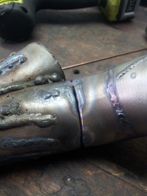

I have only been doing it for about 2 weeks and i can lay some decent SS beads i suppose.
Ignore all the ugly ones to the left, those were with a mig welder on the wrong polarity..
