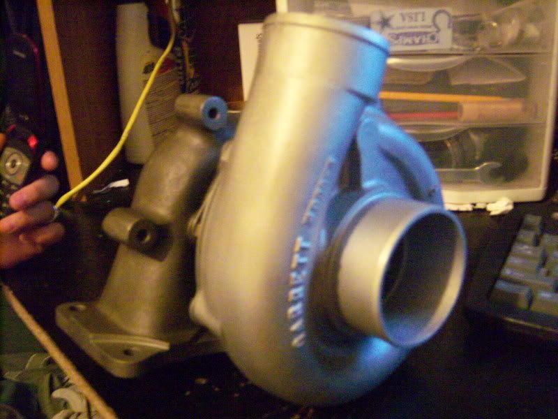

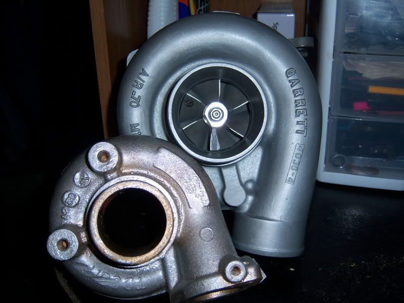

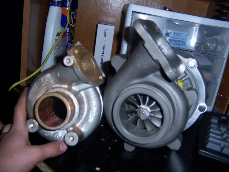

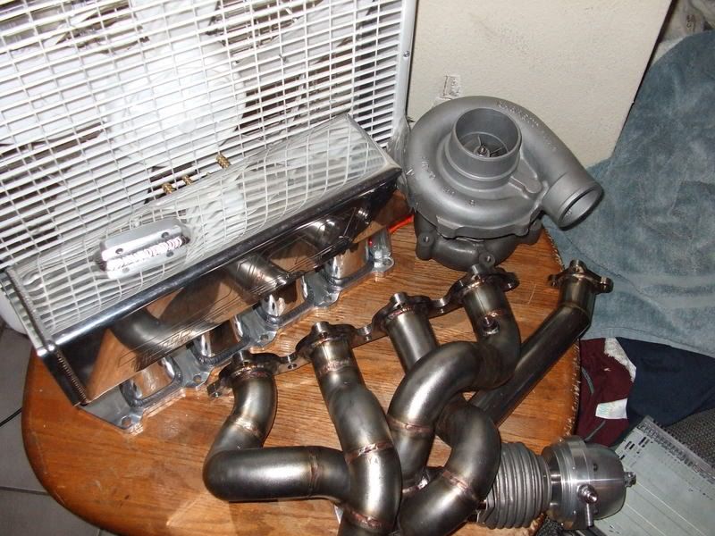

had a turbo build for me an an aircraft turbo shop, 400$! its basically a t4 t67 of some sort.
punishment racing t4 manifold! jmfab race styling smim, order with nitrous bungs , unpolished, they polished it on accident ,didnt mind the polish job free :thumb: but really wanted nitrous, so had to send back

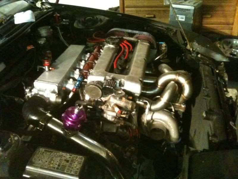

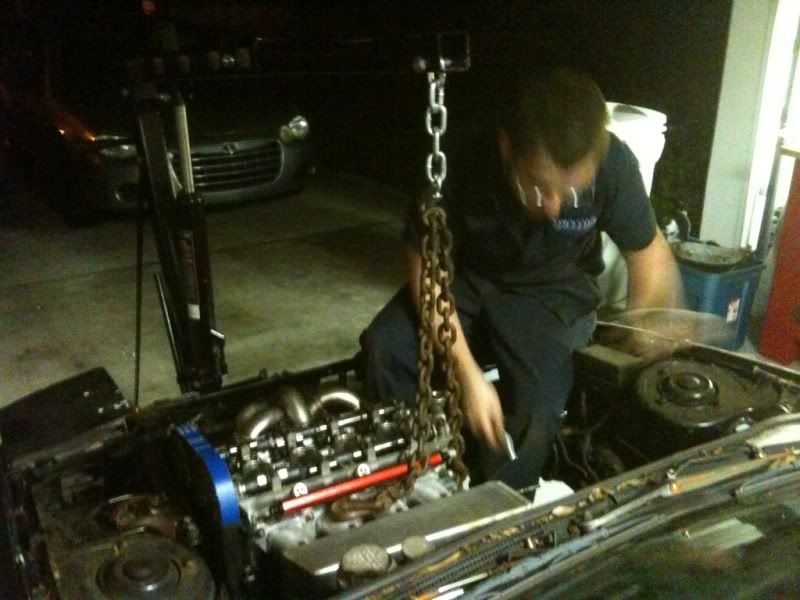

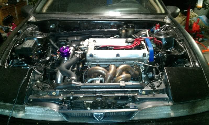

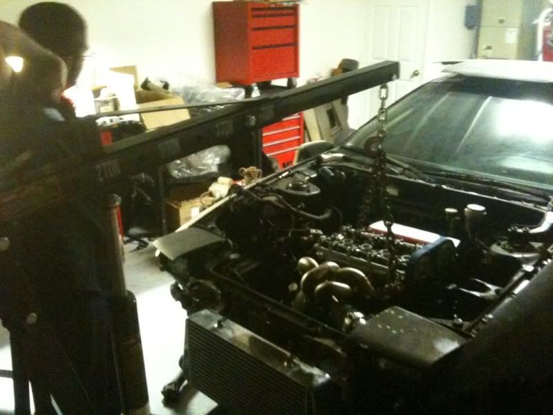

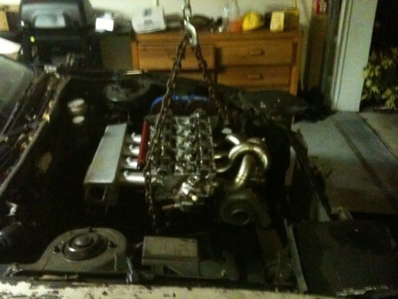

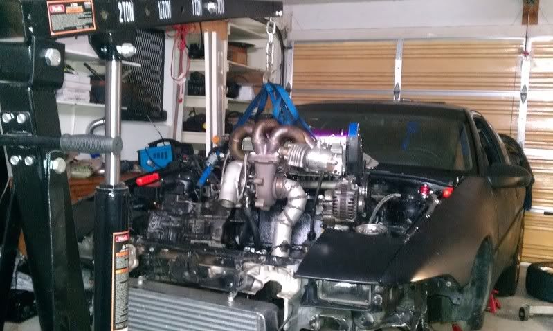

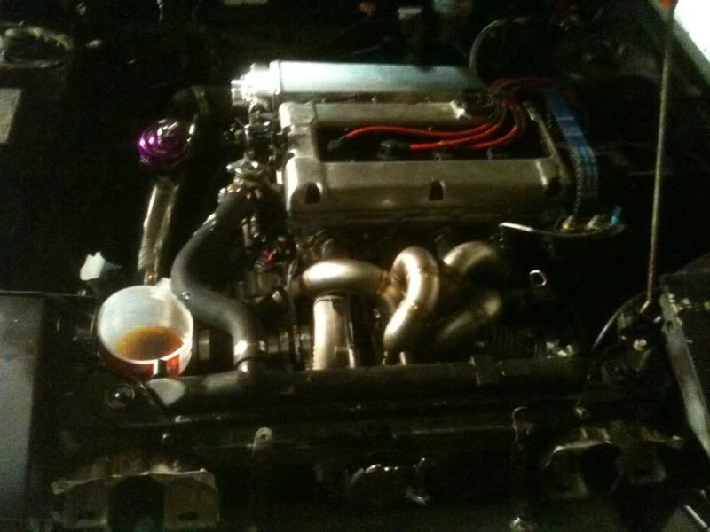

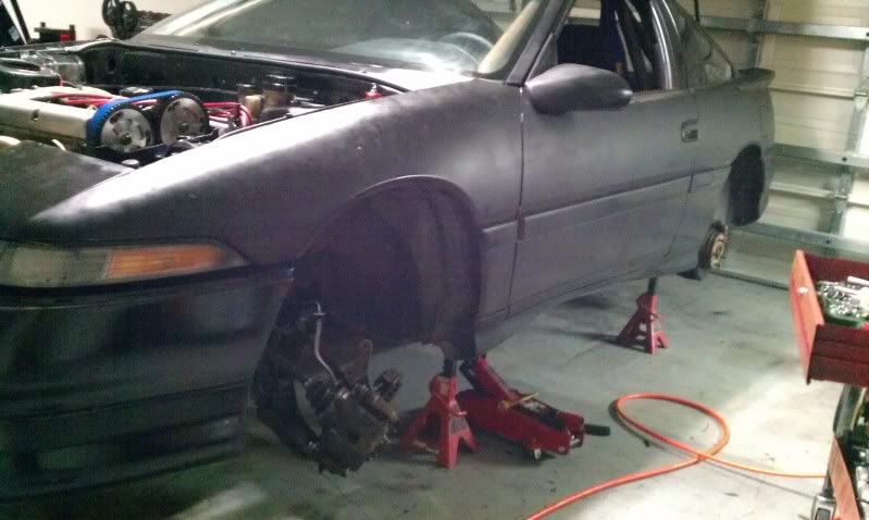

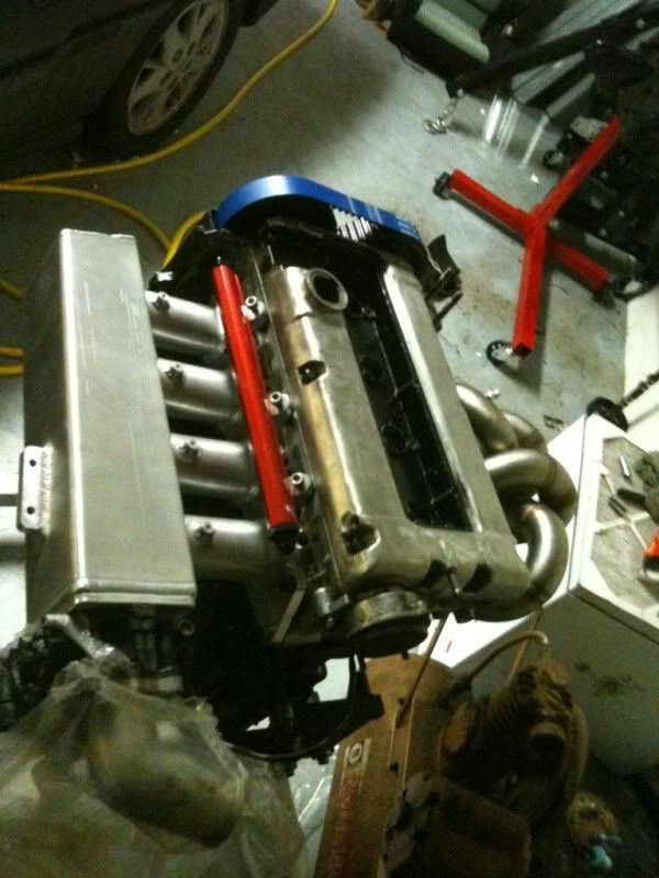

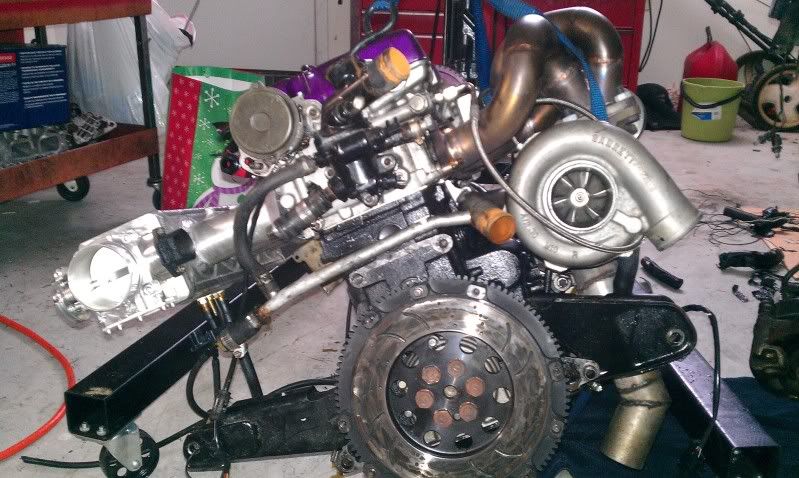

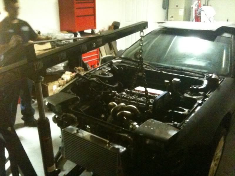

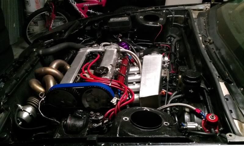

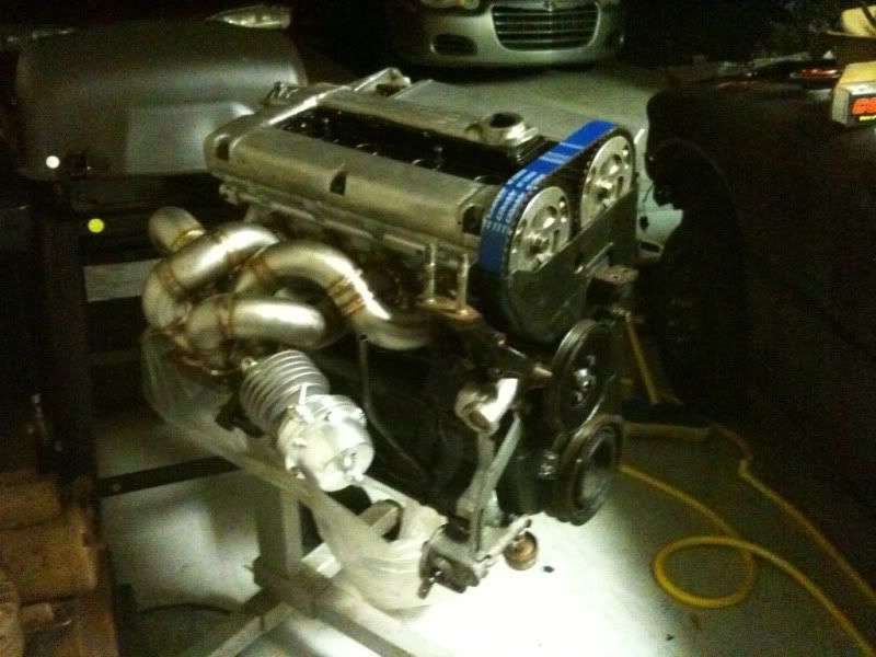

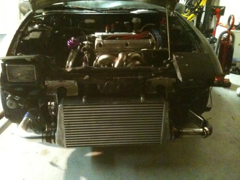

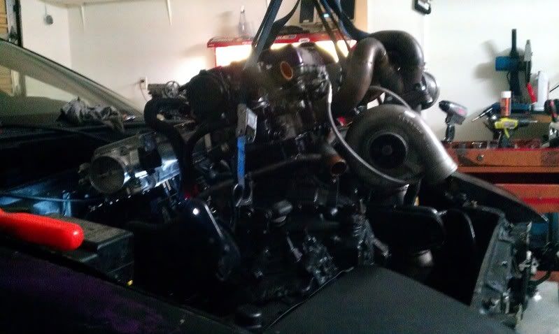

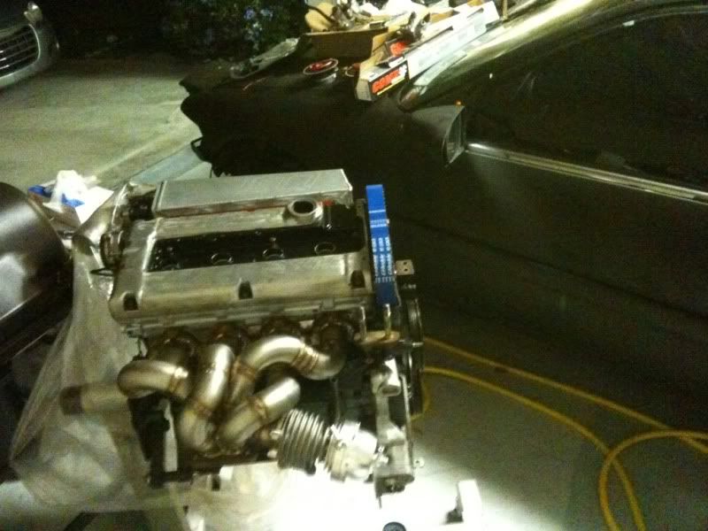

took the engine off the stand and set it in the car
finished buying the few parts i needed and bought some i really didnt but had income tax money so i bought anyways! i also relocated my battery to the subframe using a 51r

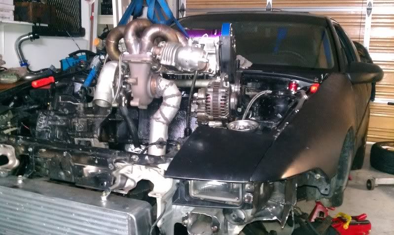

put it all together!

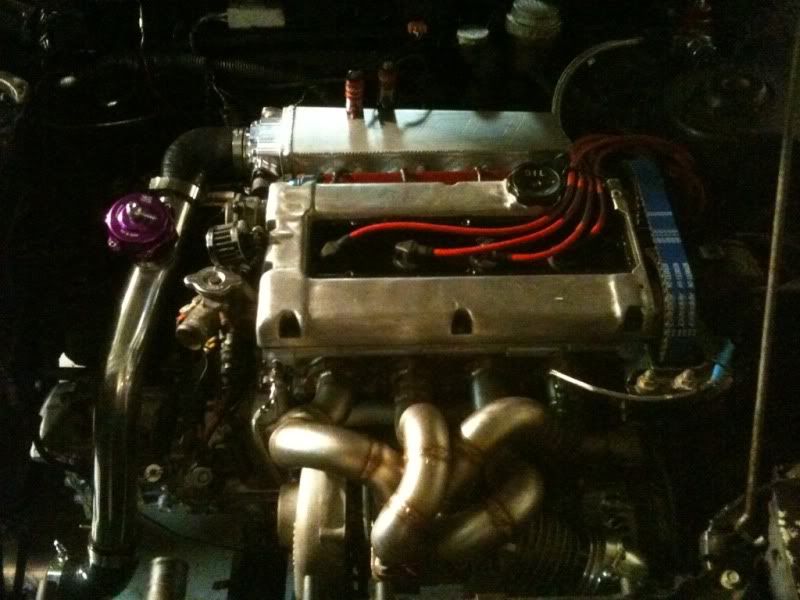

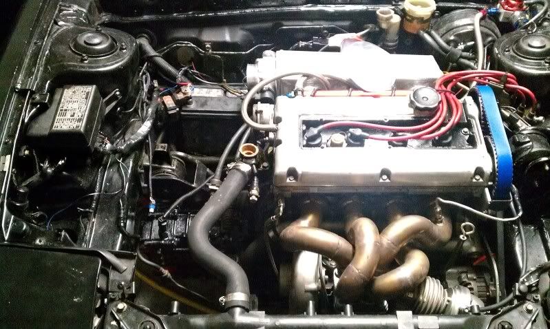

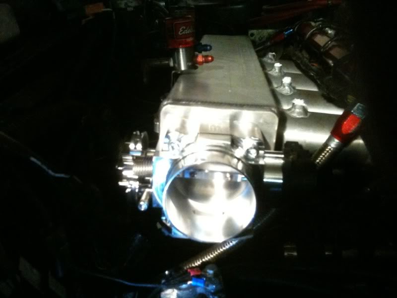

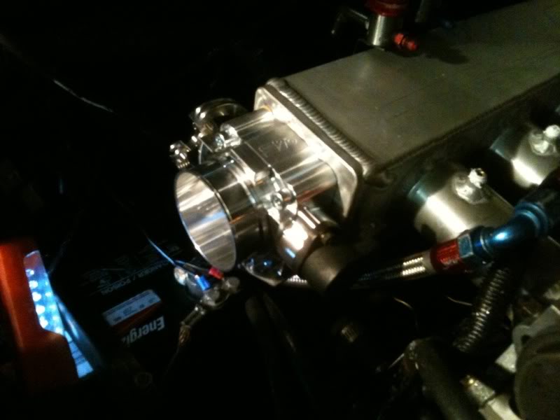

car is ready to run! i ported the manifold to fit the new larger throttle body and did an absolutely terrible job and cleaning the shavings (used a vaccum cleaned with manifold still attacked to the head) car wouldnt start took off the head (son of a bi***) shavings caught in ALL of the valves and they wont close project stopped right there and car went for sale.5,000 for the car ALL of my spare parts the red gs(t) and the open trailer, i was tired of it done working on it, thought it was be a nice down payment on an evo.

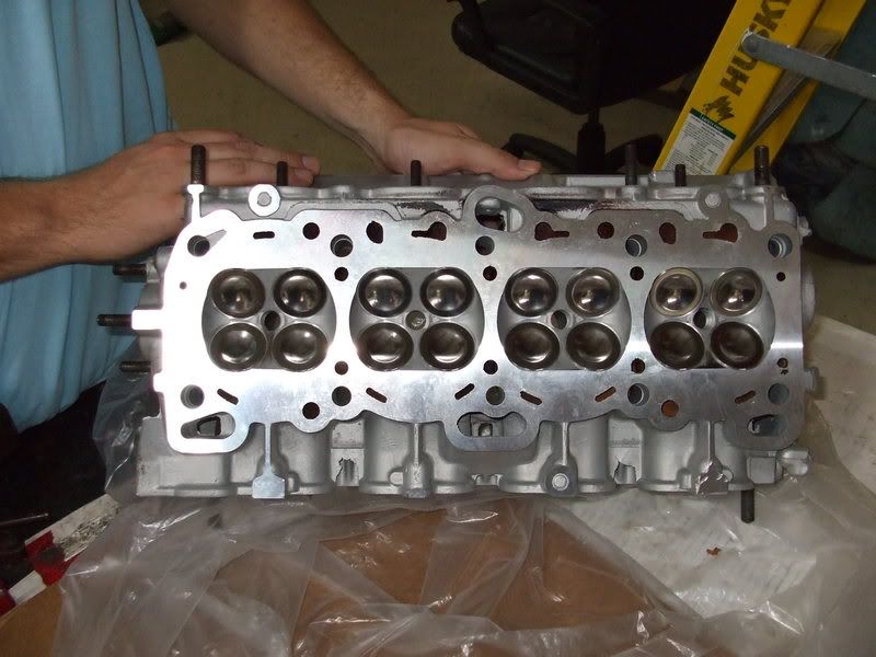

well if you read the "i've had it!" you will know i just put a new head on that car (the red 4g63nt w/ turbo) RIGHT before it started the rod knock, that head sat for maybe 7 years or so, but was still in excellent condition, so i gave it a thorough cleaning and put my comp 101202's in it with the stock springs just to get it running to sell it easier ( this was a few weeks ago ) and after that i proceeded in getting the car to run correctly with the new SD setup and fixing all the leaks and what not and getting it tuned, well i fell in love with the car again and immediatly took it down from where i was selling it (ebay, dsmtuners, craigslist and the bulletin board at work)
This is where my journey catches up with the present i have been out of the dsm game for quite some time and am trying to immerse myself back into it. i am still fixing the leaks i found the largest appearing to be from the oil pan , i used the gasket that came with my kit, why wouldnt i have? it was the oil pan gasket after all, well after reading apparently its a terrible idea to use the gasket , use rtv instead. DUH! years ago i wouldnt go anywhere without rtv! ( dsm is slowly coming back to me! ) however i forgot how much of a pain in the ass it is to remove the oil pan on the awd, especially in the garage without the proper tools ( breaker bar for cross member ) as i progress i will keep this updated with LOTS of pictures and videos!

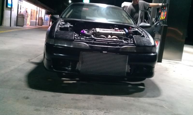

first start!
first cruise , after some rough idle and cruise tuning.

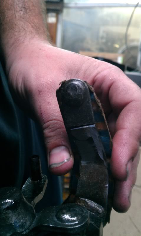

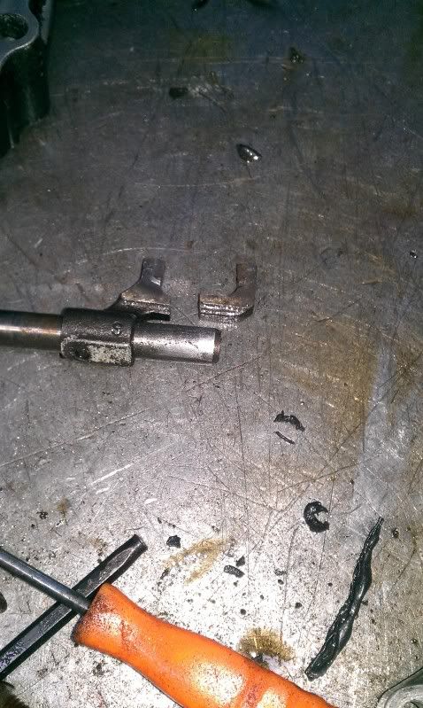

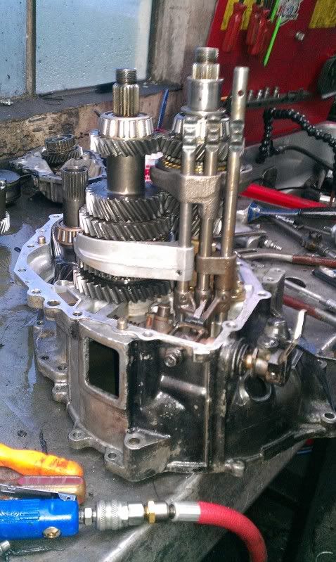

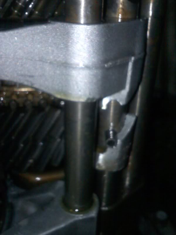

Second major issue was the transmission
Thread : http://www.dsmtuners.com/forums/drivetrain-tech/416781-91-94-shift-assembly-90-a.html

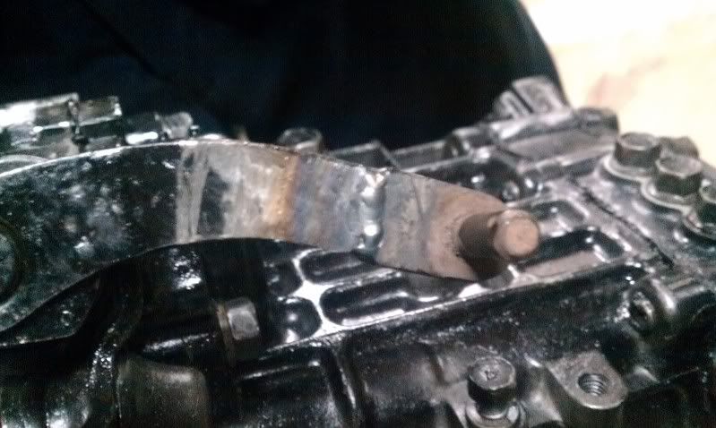

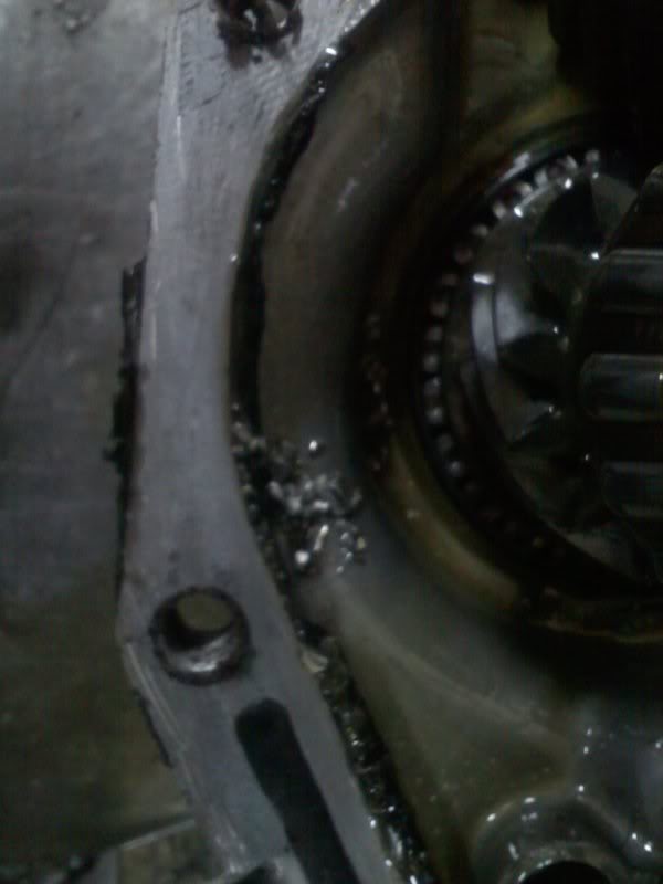

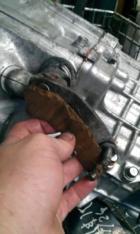

i previously broke a shift cable , and i have a 93 gs. robbed the cables from that and also robbed the shifter base, and the linkages on the tranny. well i could not for the life of me get the horizontal arm off of the transmission so i ghetto rigged an adapter that "worked" and by worked i mean it went into all the gears.

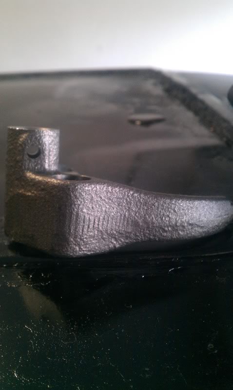

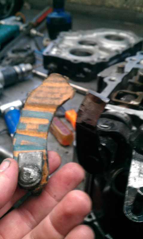

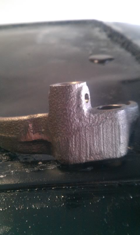

while trying to tune the car with a buddy driving and me tuning he snatched 3rd quite hard ( large fellow ) and broke the shift fork
Note this fork was allready modified , i added extra aluminum after the roll pin to give it more stability!

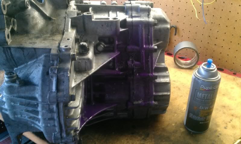

so i bought the evo shift fork (steel apposed to cast aluminum) shop cost 55$ from dealer
got it all buttoned up and painted my transmission purple
..... just kidding haha.. its black
got it running again a day later, time to get her tuned! I drove this time while my buddy logged the car, i snatched 3rd but not too hard. BAM! another long drive home stuck in 3rd gear.. wtf after smoking the clutch at every stop light to get it rolling i made it home. Theres no way i broke that steel fork so ripped it out AGAIN..

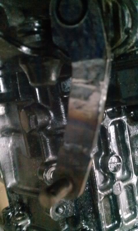

after this mishap i searched until i found an answer. my ghetto shift linkage adapter was off, so i was "overthrowing" 3rd gear and causing it to break, dumbass me. Decide to fix this shit once and for all, except i STILL cant get the damn pin out of the linkage , tried heating the hell out of it, beating it , pb blaster (w/e LOL) drilling out the hole. nothing so i had to make one.
i have 4 or 5 transmissions around , all 90 except my gs trans so i mocked up an arm
cut off another 90s end and attatched to to my existing
VOILA! easy fix and no more 3rd gear problems.. NEXT UP!! clutch issues... saw this coming pretty sure i killed it driving home in 3rd gear TWICE across town. xtd clutch from ebay whodathunkit slips when boost hits, i am still clutch shopping waiting on income tax, leaning towards quartermaster twin or ptt not sure yet, any input? EDIT: 5/29/12, i went with a single disc clutchmaster fx500, see how this works.(lack or money obviously)

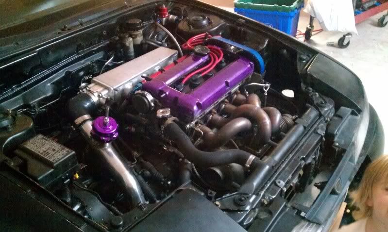

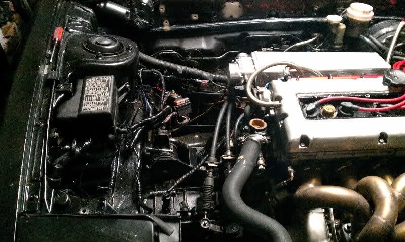

cant do much tuning so i decided to make it look a little nicer, wires were everywhere and i wasnt using hardly any of the extras anymore so here comes my wire tuck
Thread:
http://www.dsmtuners.com/forums/appearance-interior-exterior/416389-engine-shot-suggestions.html
before
after, i know its hard to see
a video , with a fairly clear engine bay shot.
http://s48.photobucket.com/albums/f224/mxdawg121/?action=view&current=VIDEO0081.mp4

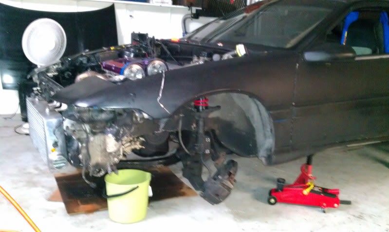

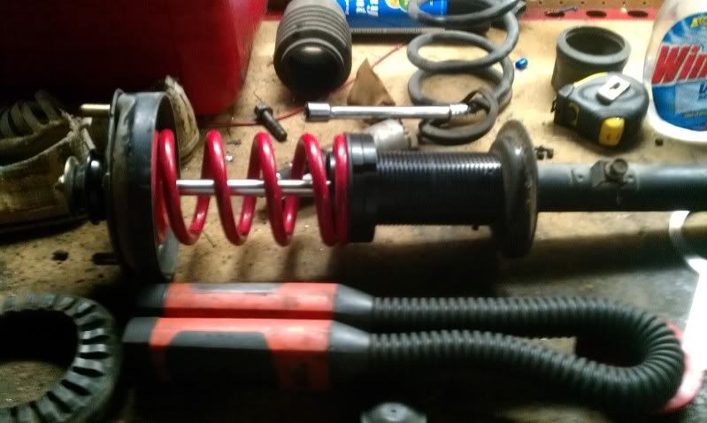

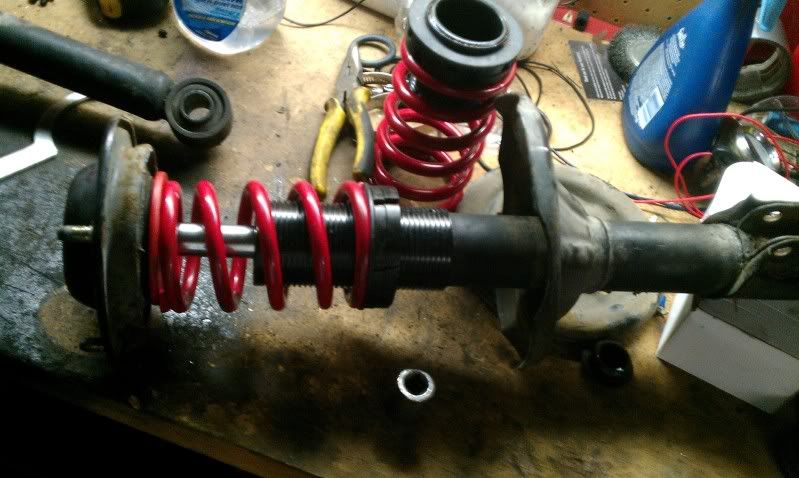

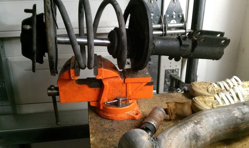

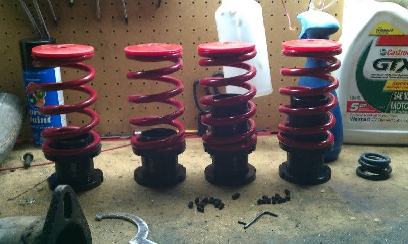

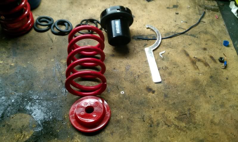

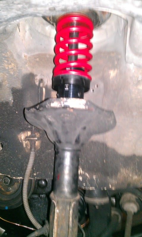

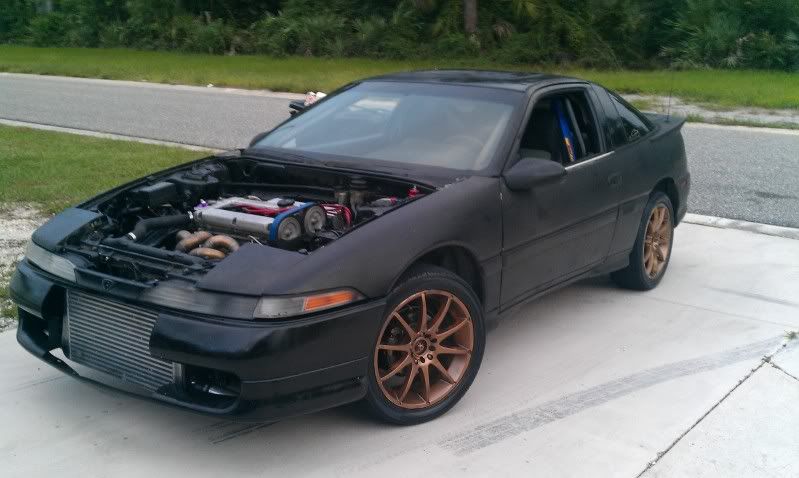

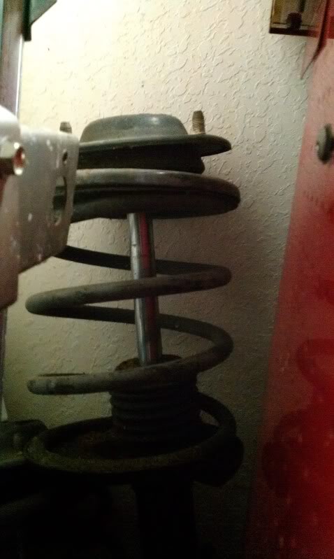

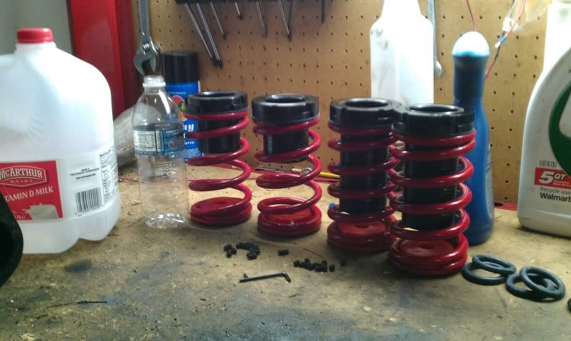

after my practice launches i decided the car needs some sort of different suspension, maybe lower the front a little bit. i bought " el cheapo ebay coilovers " 57$ shipped to my doorstep. i figured what the hell.
Epic Thread : http://www.dsmtuners.com/forums/newbie-forum/418730-ordered-el-cheapo-coilovers-wtf.html
starting ripping out the old.
NOW i posted this picture originally as a JOKE
<a href="http://s48.photobucket.com/albums/f224/mxdawg121/?action=view&amp;current=IMAG0374.jpg" target="_blank"><img src="http://i48.photobucket.com/albums/f224/mxdawg121/IMAG0374.jpg" border="0" alt="Uploaded from the Photobucket Android App"></a>
but after my buddy came over he made me actually do this haha.
http://s48.photobucket.com/albums/f224/mxdawg121/?action=view&current=VIDEO0095-1.mp4
after a pain in the ass install and lots of " throw the springs away " from all of you ( ROFL ) I got them together!
Now
Before
After anticipating a terrible ride , drove the car around for a little bit. For anybody interested. these coilovers are not that bad at all, the ride is just the same as ANY other lowered car ive ever driven or been in i wouldnt, but i could definitely daily drive this car , would not bother me much at all. besides crawling in and out of the roll cage, and lack of power steering. the launch doesnt have nearly as much spaceshuttle launch movement , still some for decent weight transfer but i can see the road when i launch now! my launch seems to be much better, on the street at least, sadly never got to compare 60' #'s but eh what can you do. still breaks them all loose.

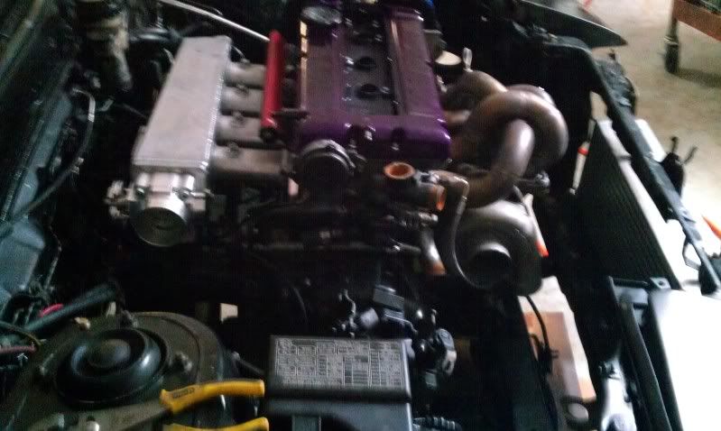

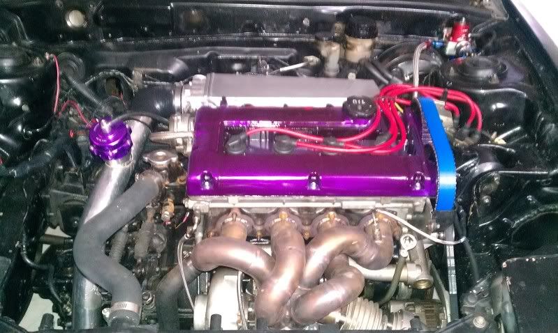

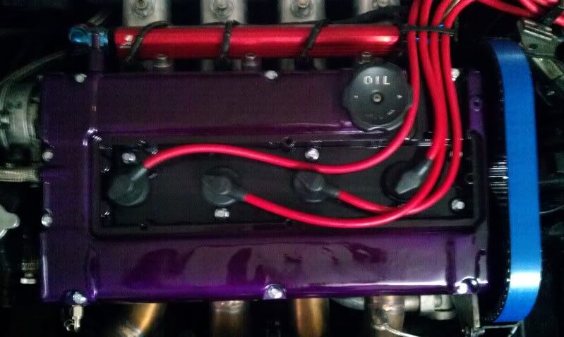

Lets see ... what else.. OH! i painted my valve cover today! a duplicast purple something or other. not loving it, not hating it.. not sure how i feel. What do you think?

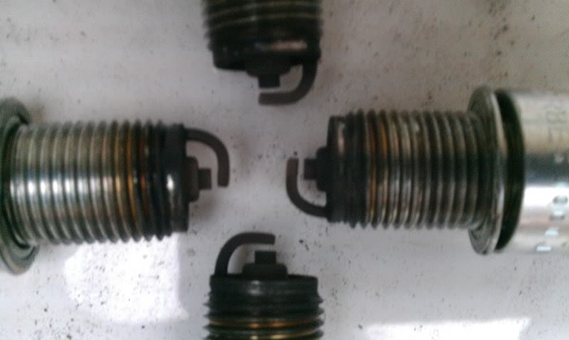

was also having some spark blowout not sure why, plugs look a little dark but i am not sure thats why it was blowing out, switched back to bpr6es's from 8's and gapped to .20 as apposed to .25, cleared the blowout up after that.

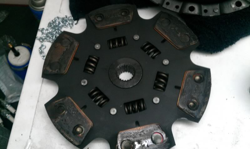

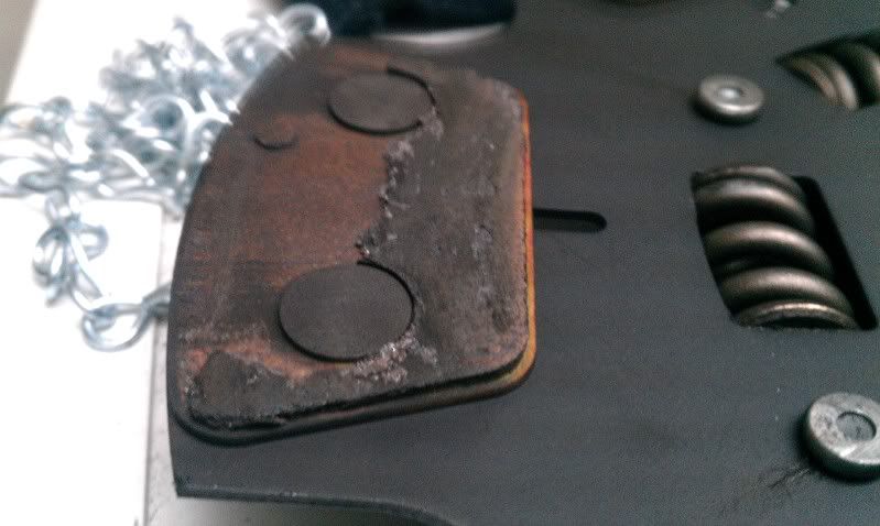

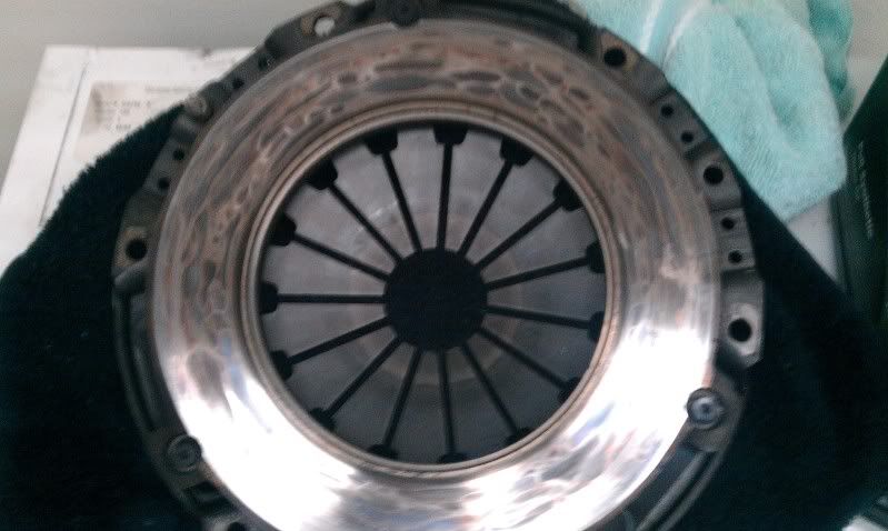

i am looking for input on a clutch decision , if you guys have any recommendations i am all ears!
One step forward 5 steps back!

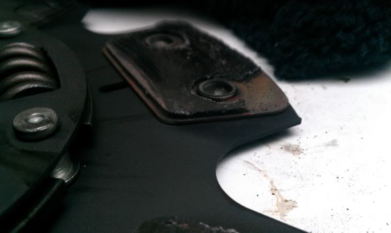

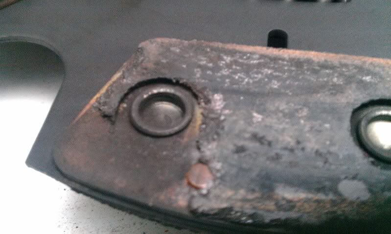

If you have been reading , i am having clutch issues , car is just sitting with the occasional cruise. so i decided at 1:30am this morning that i want to remove the engine and trans until income tax comes around for my clutch :thumb: during this time i will do a full wire tuck, including a fusebox relocation.

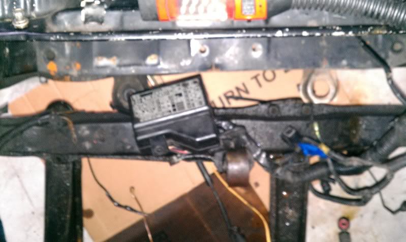

If you need any help or advice on the fuse box relocation let me know I relocated my brothers.
Looks like its coming along,as for the clutch I'm not 100% sure what are your hp goals?
ok awesome, i was kind of putting it in different areas seeing if i liked it.

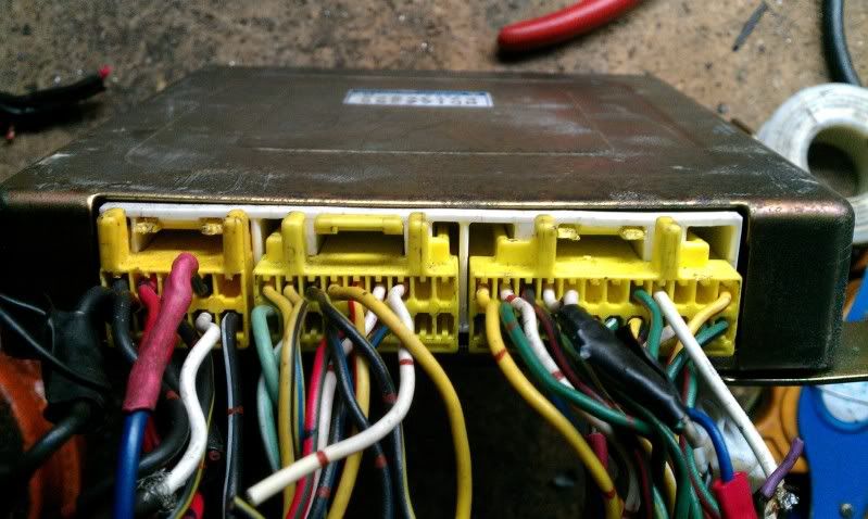

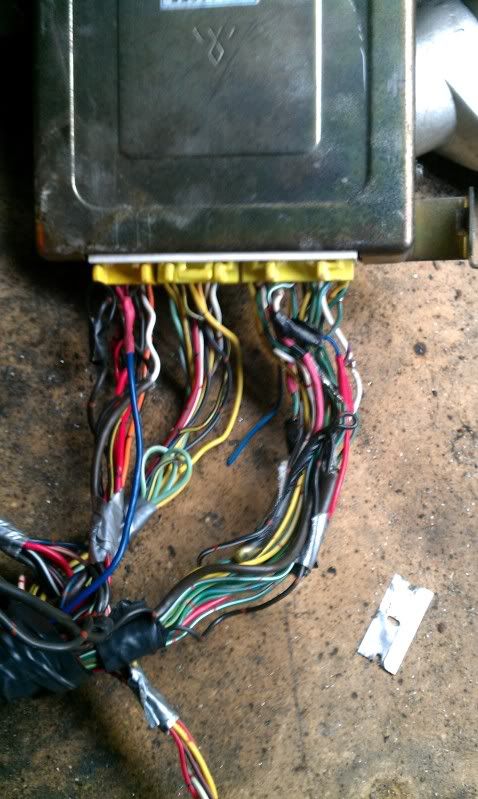

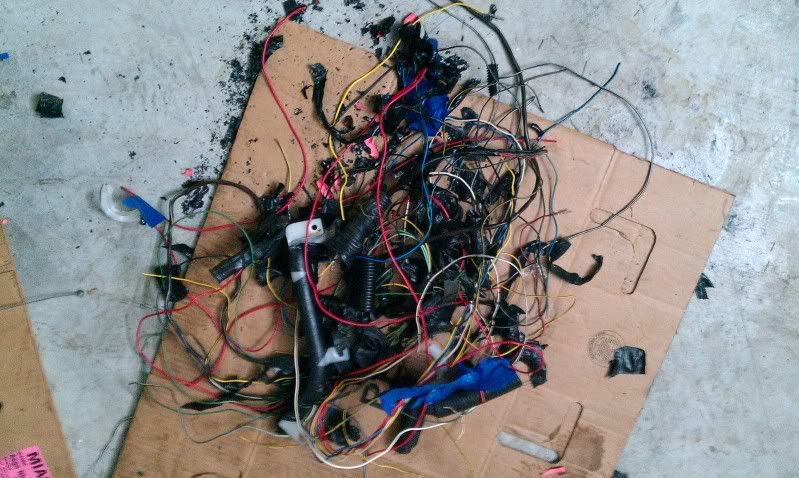

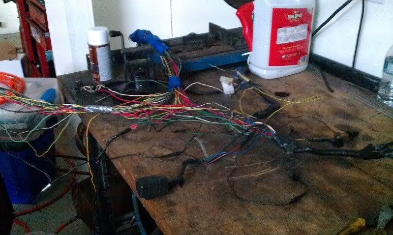

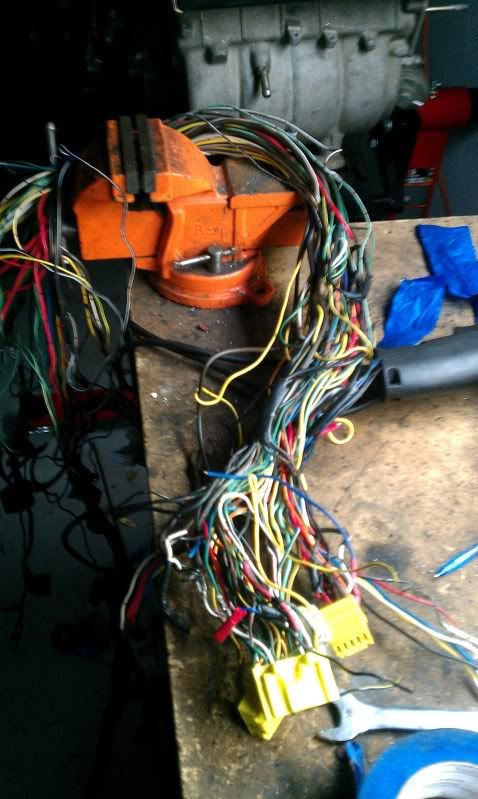

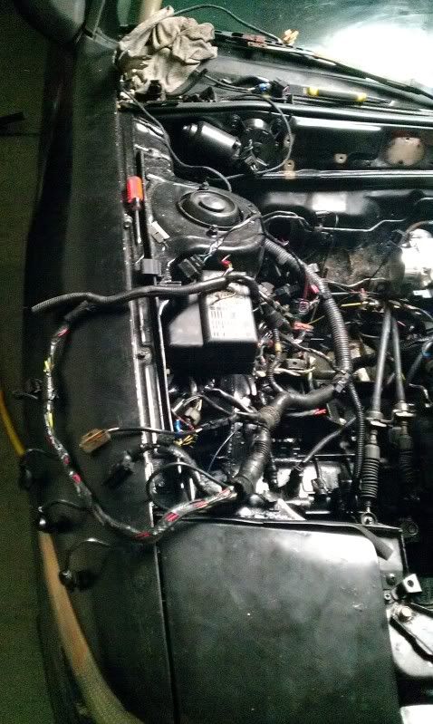

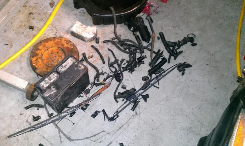

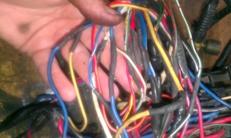

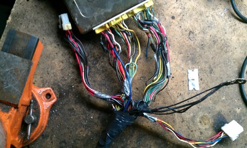

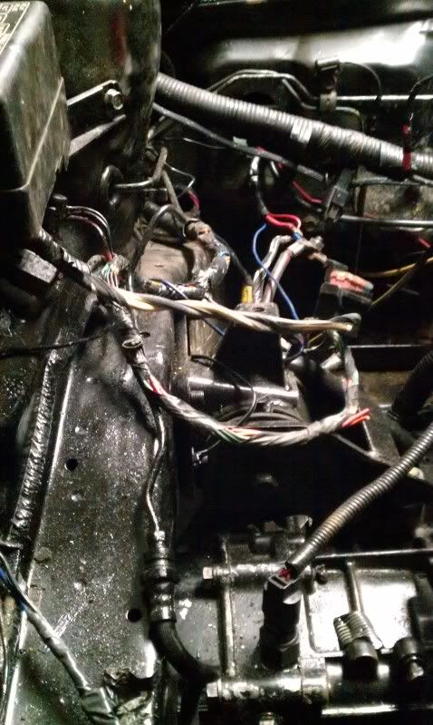

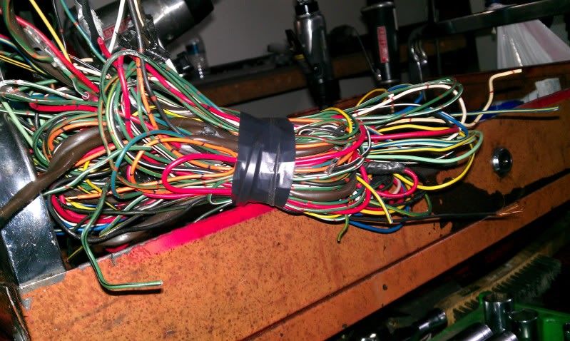

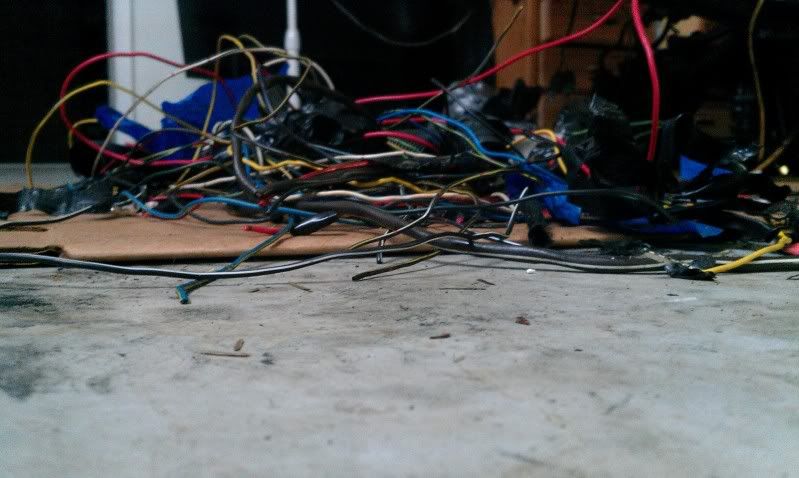

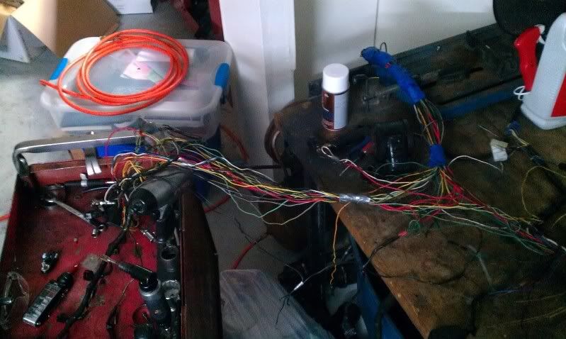

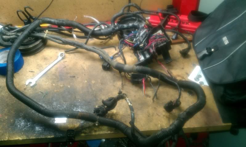

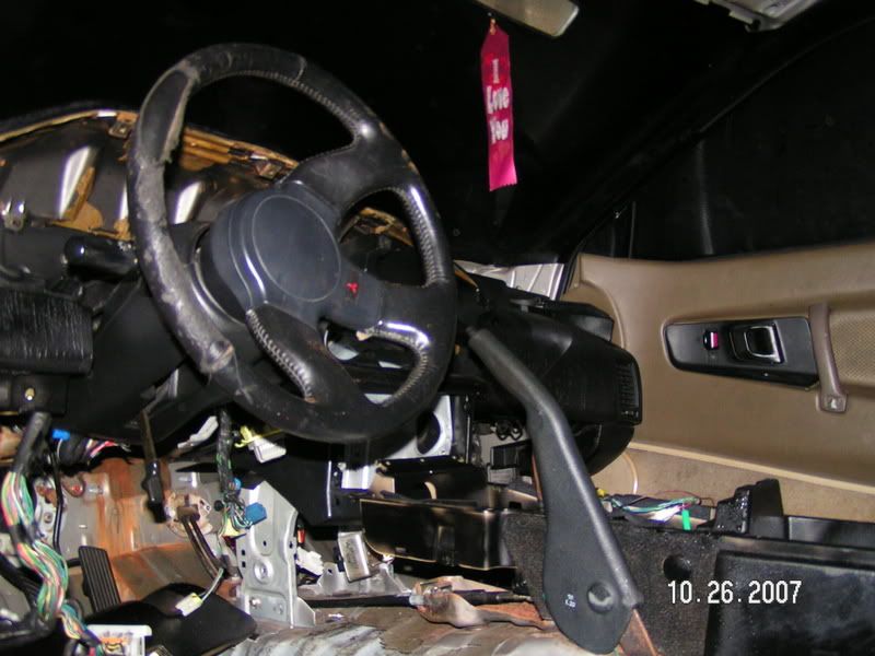

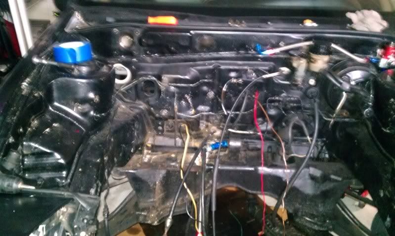

Well i got the harness out and i bit off more then i can chew im afraid, but i have commited and i will finish it. Question on the harness, could i just plug all of my sensors to their plugs and run my own wires to the ecu plugs ? seems like it would be significantly easier to wire what i need , rather then remove what i dont i would assume.
Thoughts? yes , but i dont think i will venture into that. the cost of the wiring & then it will require a shut off switch blah blah , i am just not ready for that yet. once i get this harness finished i will be a pretty happy guy! the engine stuff is easy , same with the transmission , but this harness .. sheesh.
Its pretty simple and relatively cheap.i did mine for under 50 bucks and i have a breaker so when a fuse blows or something happens it automatically kills all power to the car.
If I do battery relocation it will be one of the last things, I'm looking for help with the wire harness, is there a simple way to condense it ? Seems I only use about 12 plugs , cas, mafs, tps, knock ,coil , power transistor, Injectors, coolant temp, water gauge, with the exception of the noise filters I feel like I could get rid of a lot of these wires.
Yes you could do that but be prepared to spend ALOT of time on it. You would have to depinn every wire that you will not be using. I recall looking at a post about it but cannot think of the name.:hmm:
Eh depinning is easy , I just wasn't prepared to spend this much time on the wiring . Although I have to wait till march to get a clutch anyways. That clutch and flywheel was from eBay so who knows, maybe they were thinking of cooling the friction surface more then actually have a friction surface.
By the way , I was looking at your article? How did you have extra wire? It seems pretty tight when its in the engine bay, all of the lights to the fuse box I mean. Did you extend your wiring ?

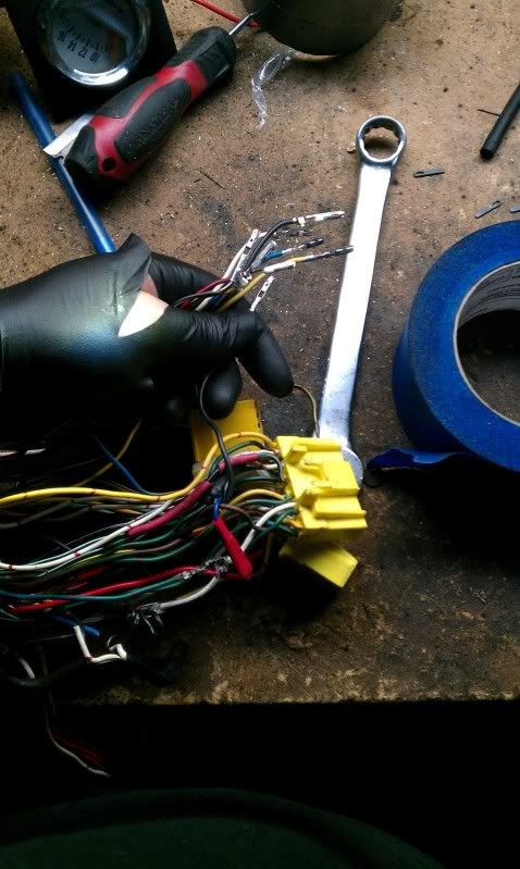

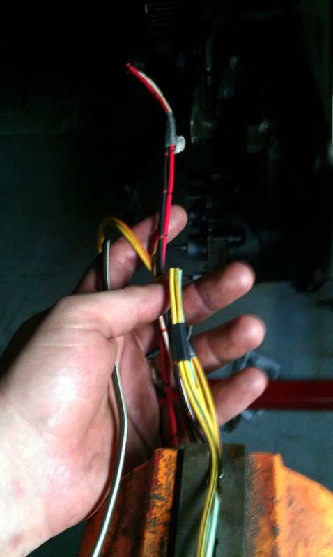

the wire harness rewire is actually going pretty smoothly as long as you keep track of your wires, and only cut ONE wire at a time move it aside then continue cutting the rest off of that plug , untangling along the way and wrapping tape around the end of the wires to write on. 3 of 4 of my injector plugs fell off due to the age of them, so i will have to purchase more ( they would wiggle loose during wot pulls sometimes anyways)

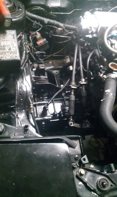

Well i finished the harness for the most part, by finished i mean the ecu part.
All there is left to do is connect the pigtails i left on my sensor plugs to the harness and make a hole near the bottom where the ecu is the other side of the firewall, and run them through.
i have a bad feeling that something didnt go right, everything went WAY to easy and things are never that easy. if anybody if familiar with the wire harness, do i need the air flow sensor reset? i dont believe so since i am only using, baro intake temp power ground for my speed density.there are also green wires leading to another plug they are the same colors as the airflow sensor and i believe baro? but they dont lead to the ecu.
Anybody who can shed light will be much appreciated , i wont be able to test this harness till around march.

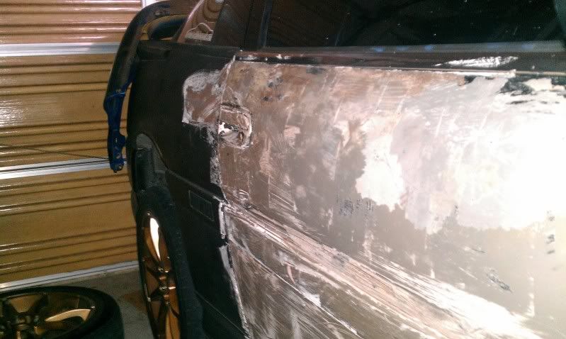

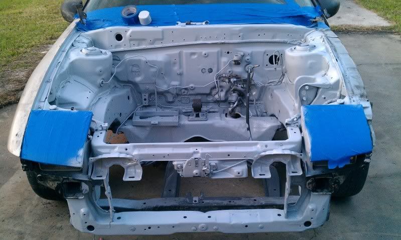

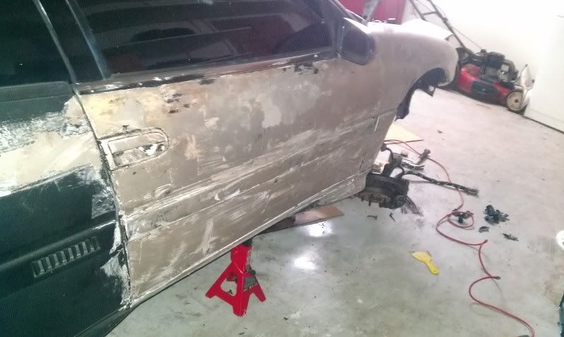

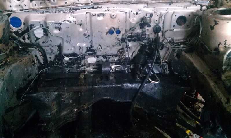

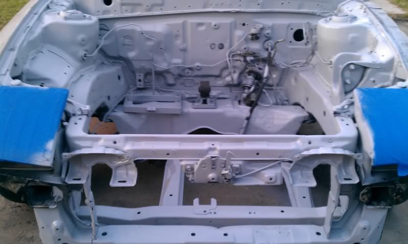

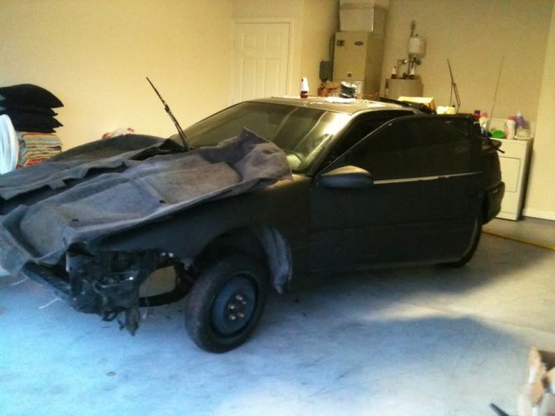

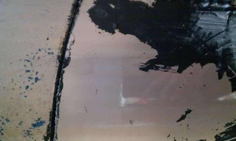

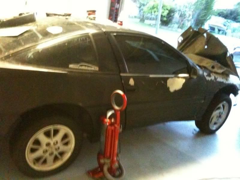

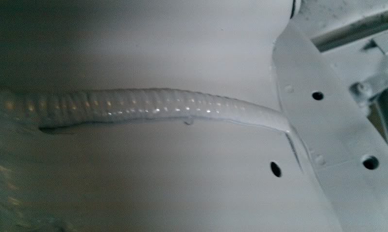

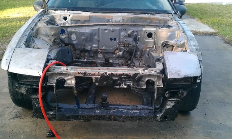

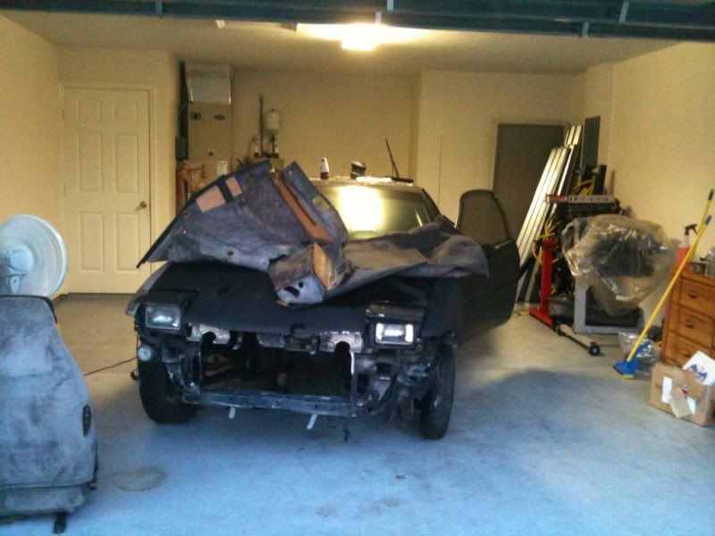

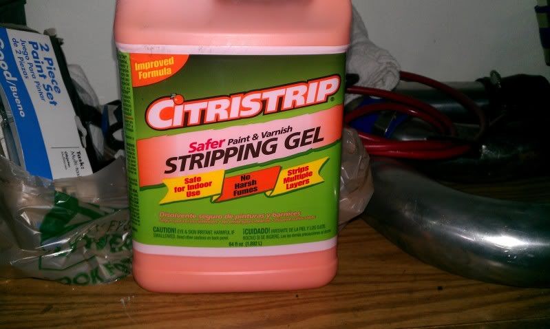

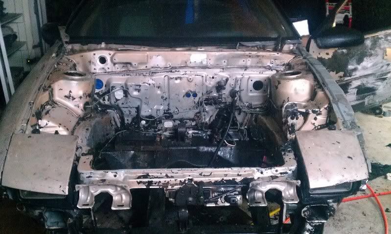

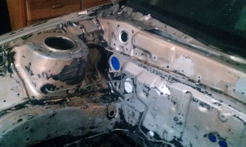

I have a few projects going on right now, one is removing the old black spray paint ( or the multiple layers of spray paint )
theres even some good clear coat left underneath!!!
still a long way to go, as of right now the paint will be darker charcoal body with black roof/hood but everybody knows things change ROFL
then the connector is gone! thanks!

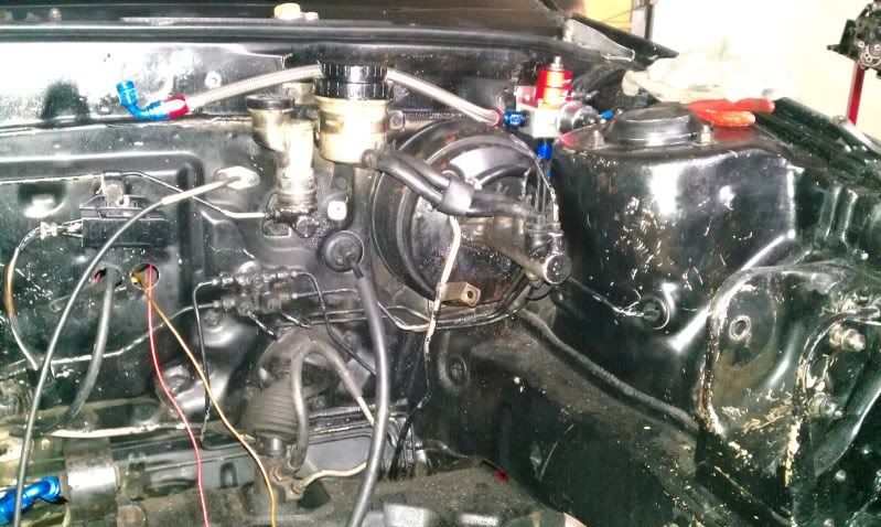

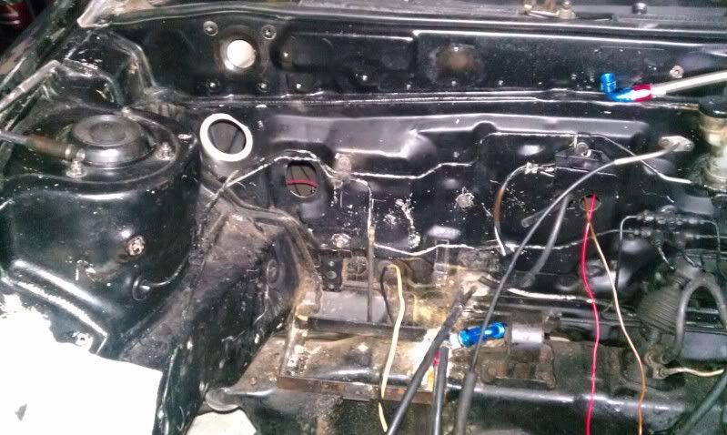

I have bounced back and forth around the idea of the fusebox, as of right now i am going to put it in the glove box like i originally wanted to but after removed the stuff i dont use, i.e foglights, hazards, turn signals, and horn. most of this is either non functional currently or unnecessary for drag racing and will alleviate alot of wiring, i am contemplating removing the flip up light motors and just leaving them down and my brights on for city driving ( 500-1000 miles a year if that ) that would save more wires and a little weight. i bet they are 5lbs+ each.

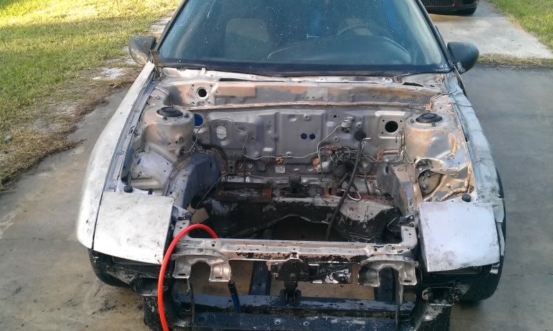

Did some more paint stripping tonight, my father brought over a pressure washer only to find out it didnt work :ohdamn:
removed my brake booster ... pain in the ass..

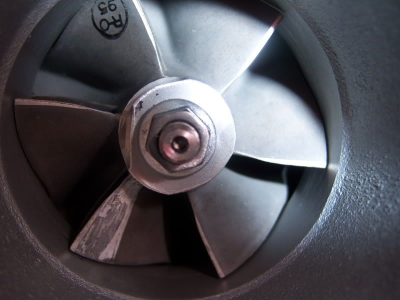

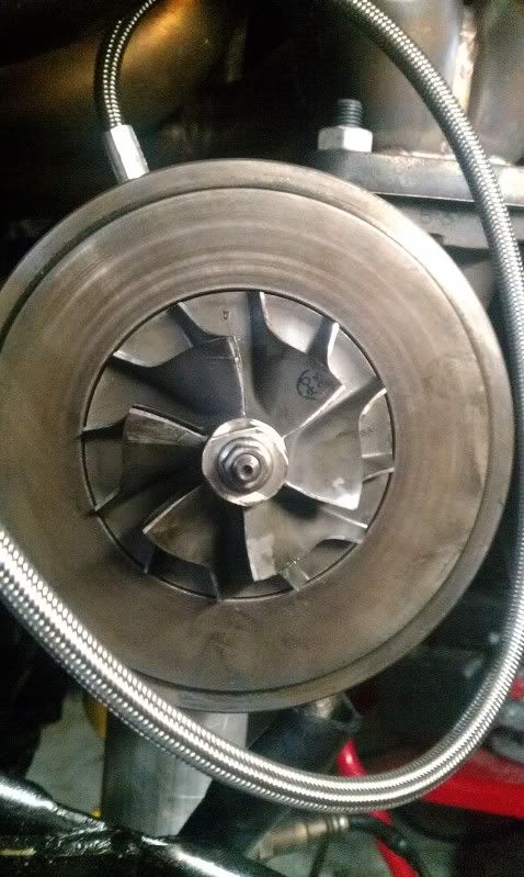

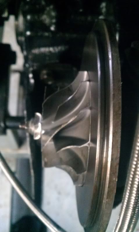

took off my compressor cover to measure my compressor wheel and realized i dont have my micrometer
thats about all for tonight , i wanted to pressure wash the engine bay clean and start prepping and priming for paint but eh what can you do. Happy New Years!
